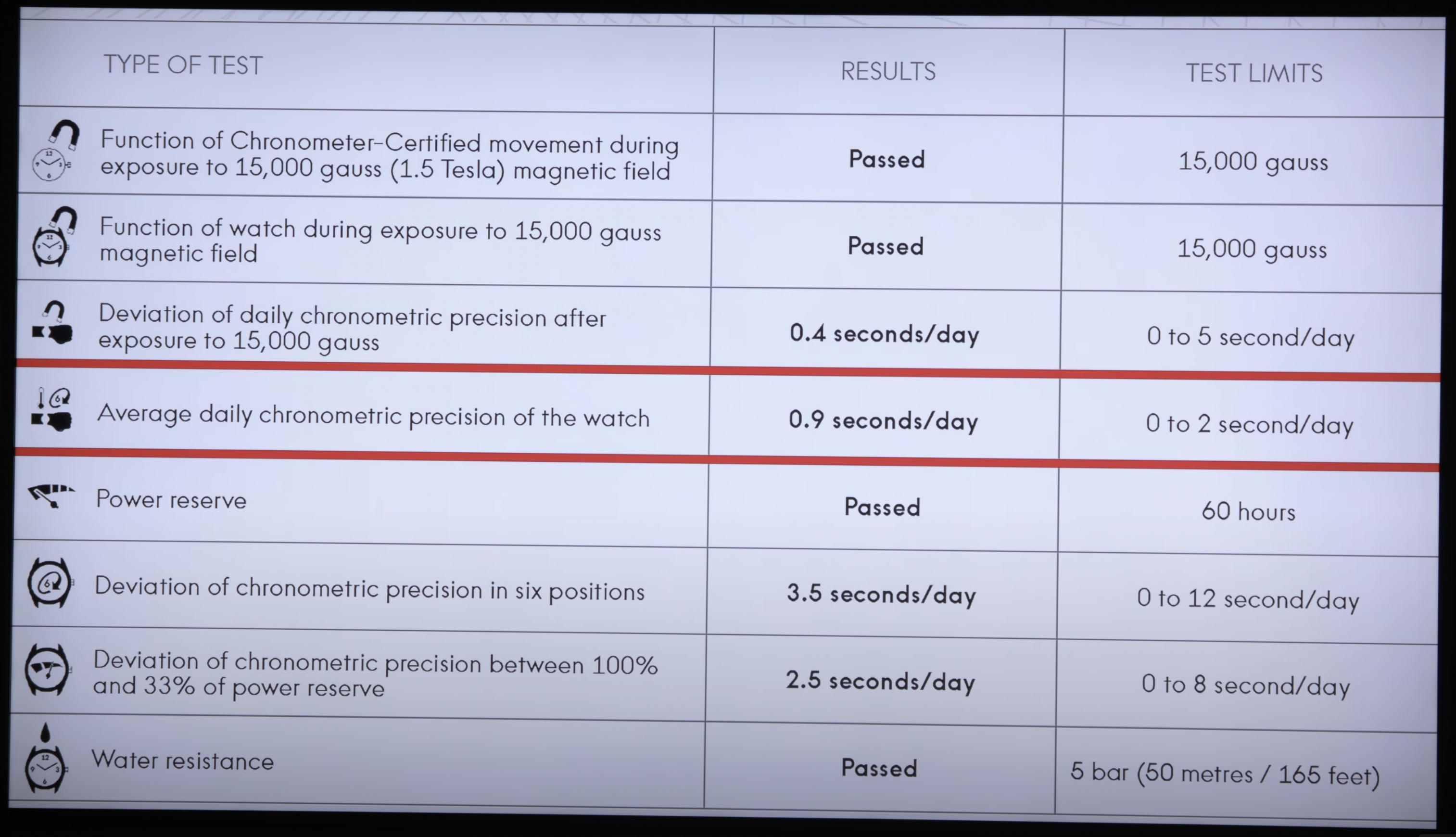

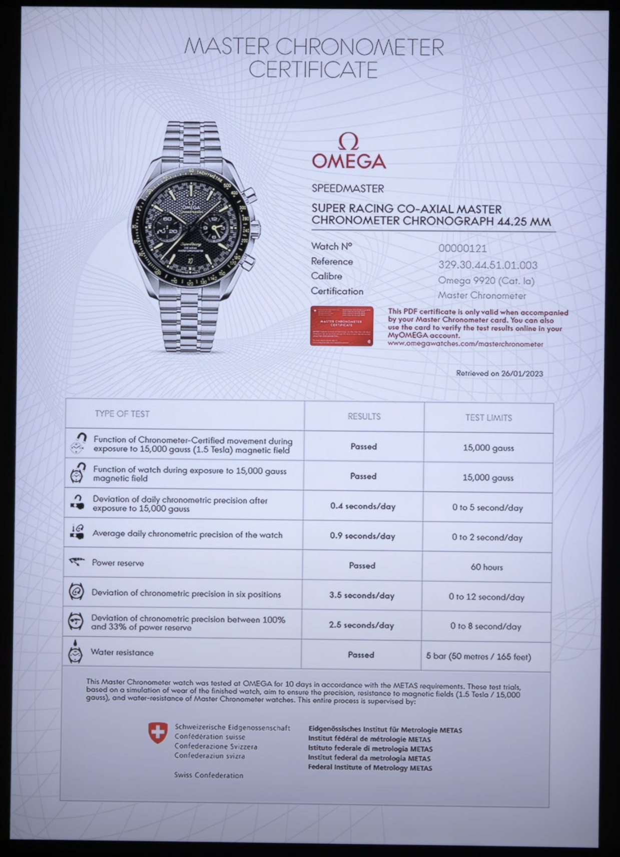

Does this imply that the watches still only need to pass METAS aside from their mean daily rate?
167
409
In case of a Spirate-enabled watch the "master chronometer" certificate has a revised "test limit = 0/+2 s/d" for test "Average daily chronometric precision of the watch".
Different limit is nothing new. "master chronometer" certificate already had different test limits depending on movement size:
0 to +5 seconds per day for movements with a diameter greater than 26 mm
0 to +6 seconds per day for movements up to 26 mm and over 20 mm in diameter
0 to +7 seconds per day for movements up to 20 mm in diameter
Now they just added another technical/technological factor that influences test limits.
Is that the only change in the spec? No reduction in delta?
So far, it appears so...but I'm not sure I would take a marketing image as gospel...
If the only change in spec is mean daily rate, I'm not impressed. I've had 7750s, and now have a Blancpain, that had near zero s/d mean deviation with 6 position delta of 2s/d. I guess this "improvement" just makes poising and regulating easier (so Omega can use lower grade techs? ).
