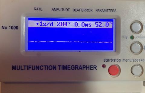

Coincidentally he just got back to me. He says "In my opinion it does not need a complete overhaul. Amplitude is pretty good, over 280. Did apply a little oil on the pallet fork jewels and gear jewels, the balance looks good." Pressure test and lubricant O ring all for little money.

What sort of pressure test was it? He has the lift angle set wrong on his timing machine, BTW, so the actual amplitude is slightly lower than what is shown on the machine.
