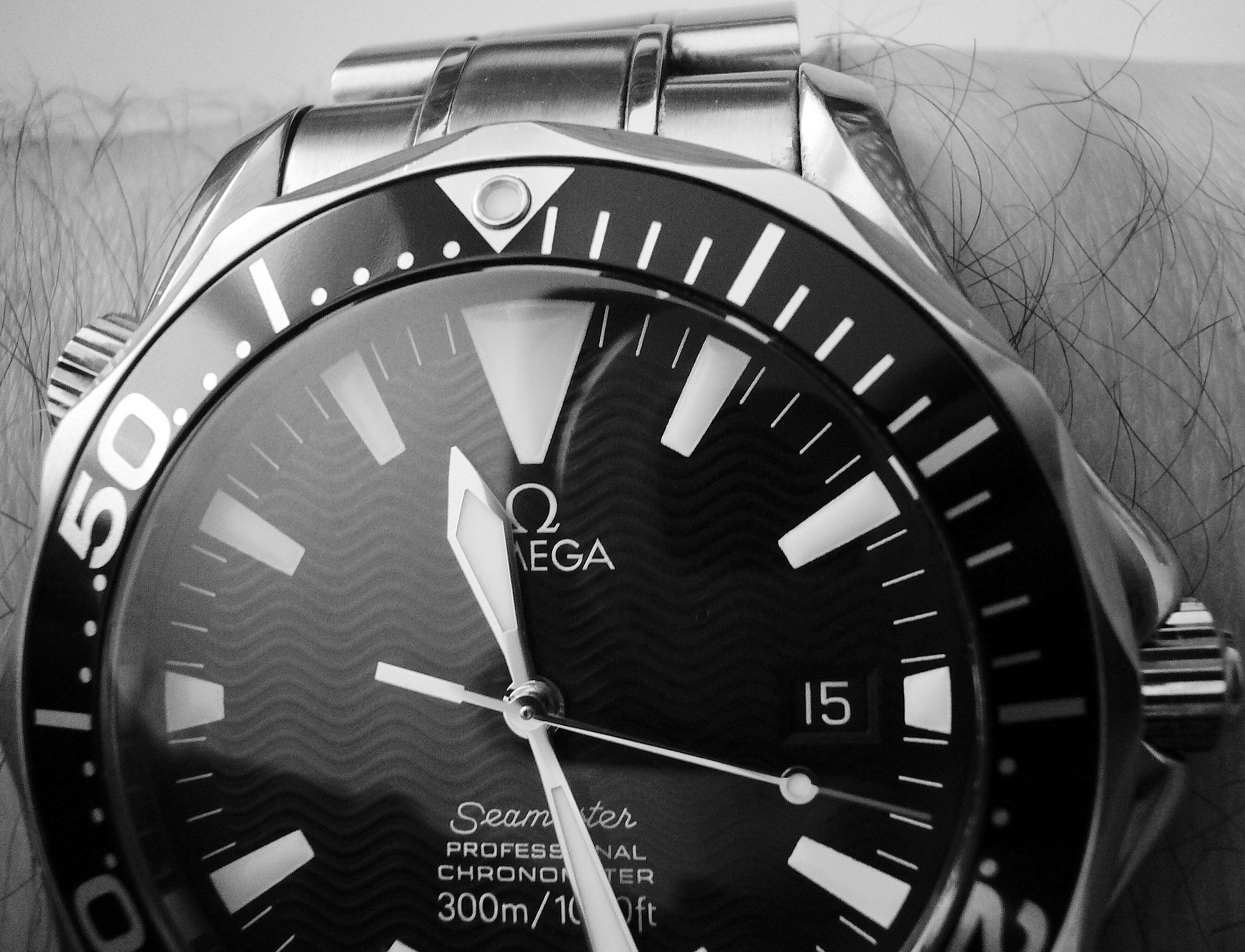

I just purchased this 2254.50 and it is running consistent 15 seconds slow per day. Previous owner did not have serviced and does not know history. Do you think it's time for a service? If so any recomendations? I live in Detroit, MI. Should I send into Omega?

You have a watch that could be more than 20 years old with no service history and it is running slow? Of course it needs a service.

12 plus years old most likely never serviced. Send it to an independent watch maker even. I recommend Archer on this site or TimeCare Inc or better yet Phillip Ridley. Might cost less too.
210
683
Best to know if a watch needs a service is to use a timegrapher. With that, amplitude and beat error can tell if the watch needs a service.
Deviation per day can be indicative or not. It can be necessary only an adjustment.
In my experience, I saw:
-watches with devotion per day of less than 10 seconds, and amplitude of 150-200... they need a service
-watches with high deviation, like 20-40 seconds, but good amplitude ... usually, they only need an adjustment
-of course, watches with high deviation and low amplitude (that’s the usual), so a service is neeeded.
A better parameter to know if the watch needs a service is to monitor reserve de marche. If it is far away the time it should be, it sure needs a service. No doubts.
In order to be safe, if you don’t know the history service, you should go to a watchmaker. He will tell if only adjustment or full service.

Thanks for all the advice on the matter. I will definitely take it in to my local guy for an evaluation.
