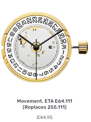

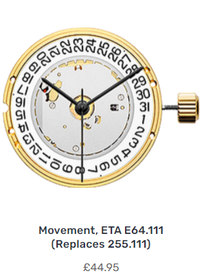

This shows an ETA E63.111 is a replacement for a 255.411 (not a 255.111) so, don't buy this as they are both 10.5 ligne and the 255.111 is 11.5 ligne, the same as the Omega 1432. So many of these numbers are similar that it's easy to look for the wrong thing.
According to various sources, the E64.111 replaces the 255.111 but sometimes these are not exact (as has already been pointed out). Gleaves have these (UK based) and they are about £60 delivered if you have an account with them. @watchyouwant also linked to an ETA E64.111 but in Australia and it would be far more expensive because of that. Picture from Gleaves and you need to add VAT and delivery:
If you just need a circuit for your Omega 1432 or ETA 255.111 (part #4000) because the battery has damaged one connector (which is part of the circuit), then the circuit is the same for 255.111, 121, 122, 411, 421 so you might be able to get a working watch as a donor. Your movement looks to have seen better days but it may be recoverable.
Unless you buy the vacuum sealed new movements, they will be loose pack and really should be serviced before use but, you may be fine depending on how they have been stored - that's why I would recommend Gleaves or Cousins (about 10% more expensive) rather than eBay. Really, you need a watchmaker for all of this but, it's up to you.

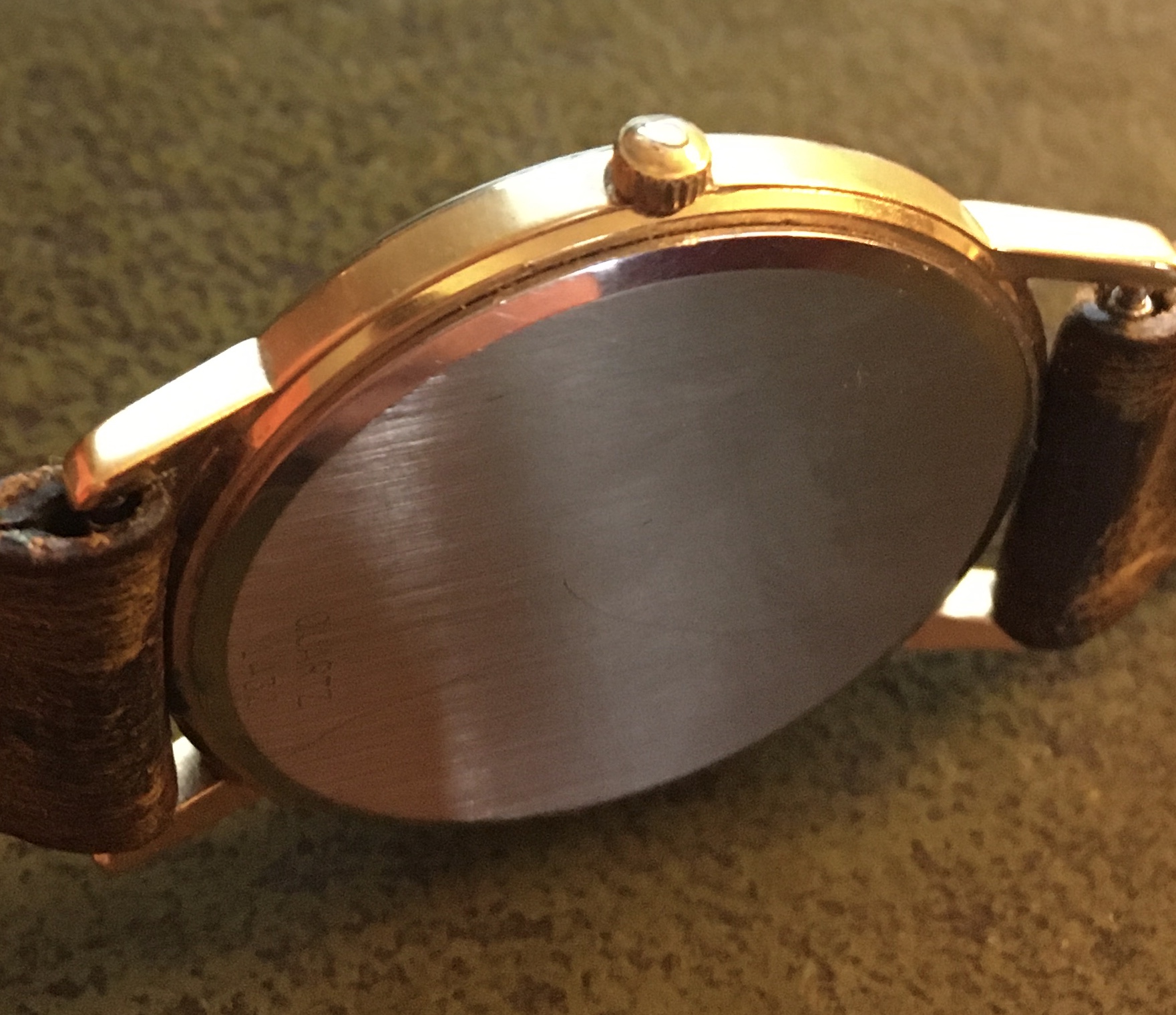

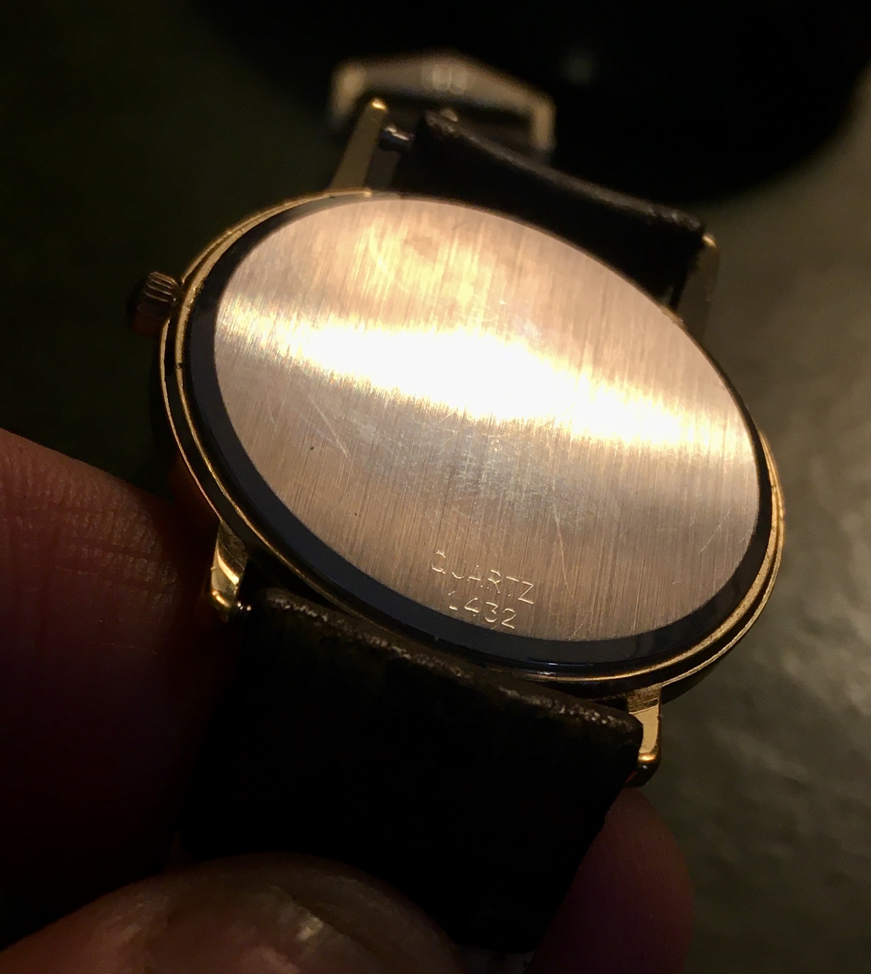

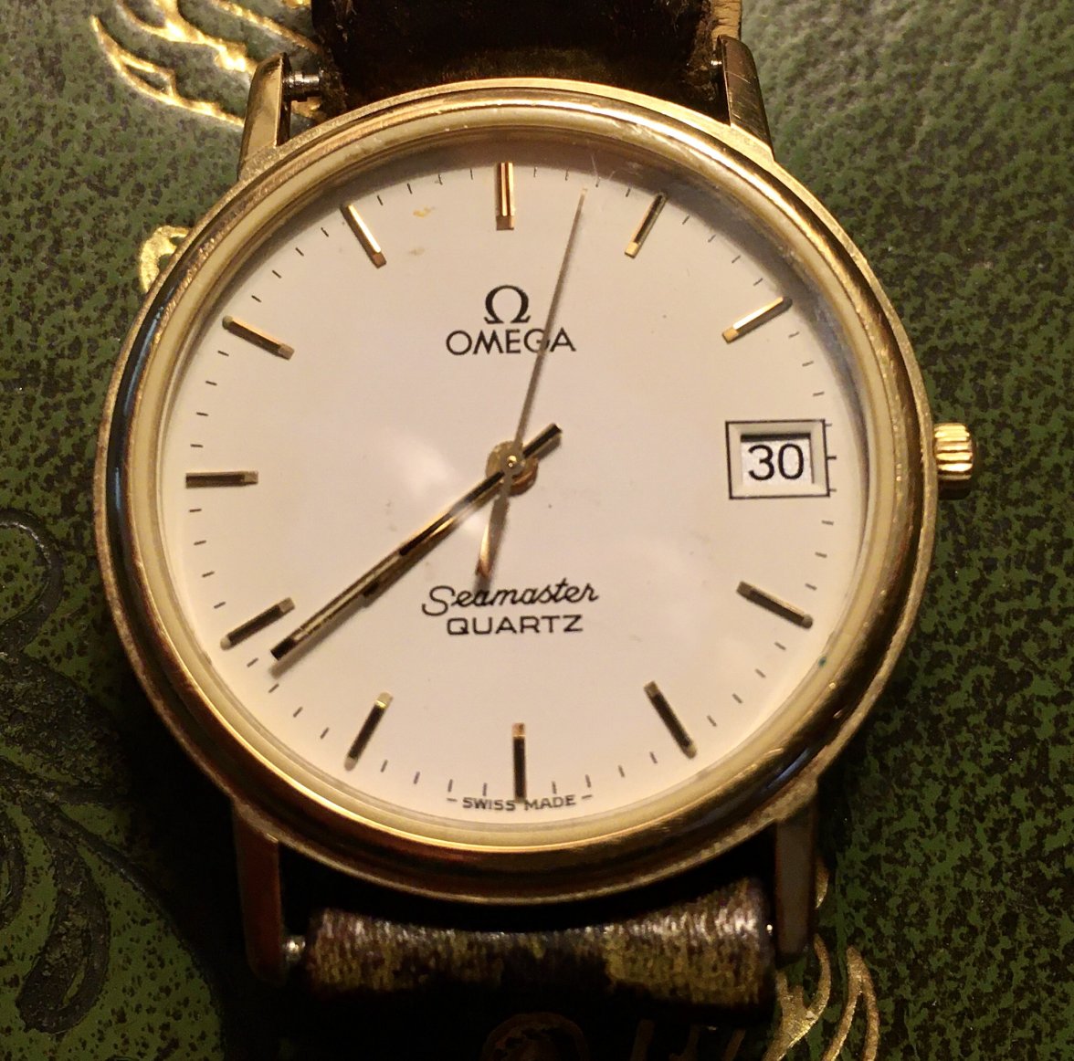

I bought this Seamaster Quartz many years ago, and before it was put away in a bottom drawer was running slightly slow. The battery is now dead and I haven't attempted to change. I have the original receipt/proof of purchase and wonder whether it might be best to sell as is, and if so on ebay/or elsewhere, or whether I should try to repair? If the latter, do others have advice as to the most cost effective. Any thoughts as to likely value? I am new to this so apologies if the questions sound very uninformed!

I found this new 255.112 on ebay - https://www.ebay.co.uk/itm/293051217304?ssPageName=STRK:MEBIDX:IT&_trksid=p2060353.m1438.l2649
Looking at http://www.ranfft.de/cgi-bin/bidfun-db.cgi?10&ranfft&0&2uswk&ETA-ESA_255_411 it would seem to be a perfect replacement as the 255.111 appears almost identical to the 112?
Does anyone know of any differences that might present an issue, but for £25 it might be a good and cost effective punt...
