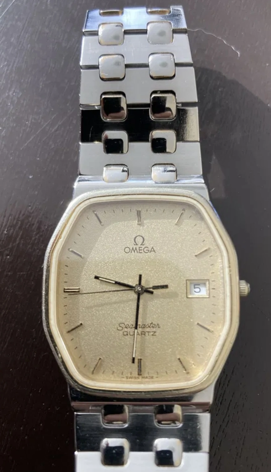

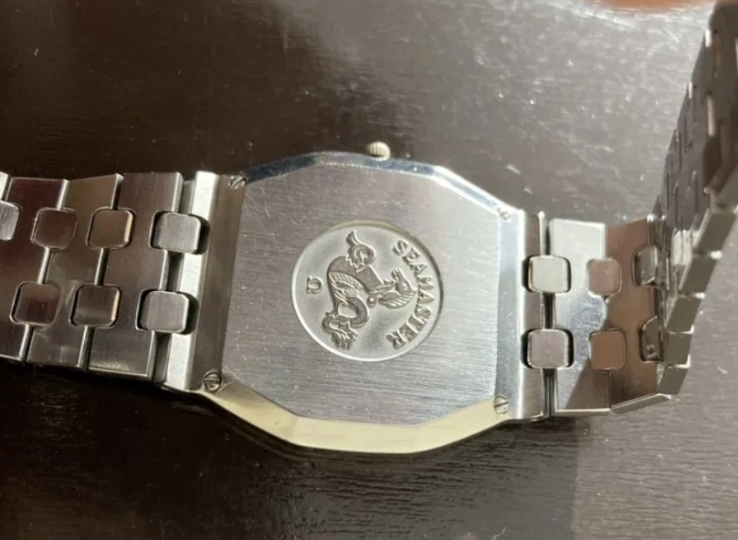

Hello guys,
I’m new here and would ask for a favor.
Could you give an opinion for this watch that I’m eyeing.

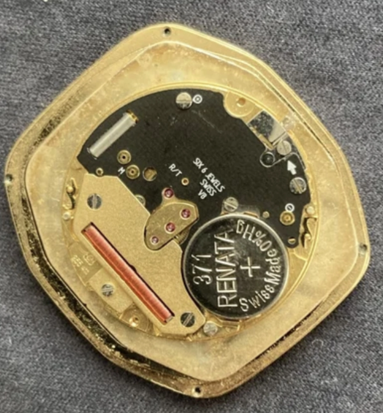

My only concern, there is no Omega branding on the movement, actually it’s branded ETA 255.411 as far as I can see from the pictures.
Thanks in advance
76
70
From my point of view the case, dial and hands are real but the movement was replaced. There should be an Omega movement cal. 1430 but was replaced with an ETA 255.411

It's not the original movement, but Omega 1430 is a ETA255.411 movement decorated with Omega brand on the black circuit board. So functionally, this watch is no different than the original.
18,847
39,195
The original 1430 probably failed and was replaced with the ETA.
It's the same movement, made for Omega by ETA, just lacking the Omega stamp and engraved caliber.
If it was a collectable watch I'd pass, but this is not and for a daily wearer, I'd accept the change.
16,000
48,138
Chances are the movement is original, but with the ETA circuit assembly replacing the failed original.
18,847
39,195
Train bridge on a 1430 would be engraved with the serial and the plate would be engraved with the caliber, so this is just a 255.411.

If the guy makes me a good deal, I’ll take it, I really like its vintage look

Even the ETA movement is similar with 1430, without the original Omega movement the watch will always be considered a franken.

What about if I source an used omega 1430 movement and swap it, is it going to not be franken anymore?

Omega movements are engraved with a serial number, and that number should correspond to the production date of the watch. Of course, for an expert, the watch would still be considered a "franken" if, for example, the serial number on the movement indicates a production period from 1970-1980, while your watch model was made in 1985. 😀 Anyway, it would definitely be better if you could replace the current movement with an Omega 1430. With a quick search online, you can find an original Omega 1430 movement for under 100 euros

Alternatively, you could replace it with a brand new and readily available ETA caliber E63.111; newer technology that's capable of COSC chronometer certification.

So good luck finding one that has not had the movement replaced at this point. In the case of this era Quartz and the value no concerns at all.
And then factor in the cost of a watchmaker to change the movement.
And the possibility that the hands may need to be replaced after being removed and fitted to a different movement.
You are rapidly nearing the point of over capitalisation.
It's not a valuable collector piece and there are probably thousands like it in the world where water ingression or battery leaks have toasted the original movement so getting a genuine movement would be low on my list if this was just going to be a daily watch.

It's not a collectible watch, as long as it's running, why worry about it.
