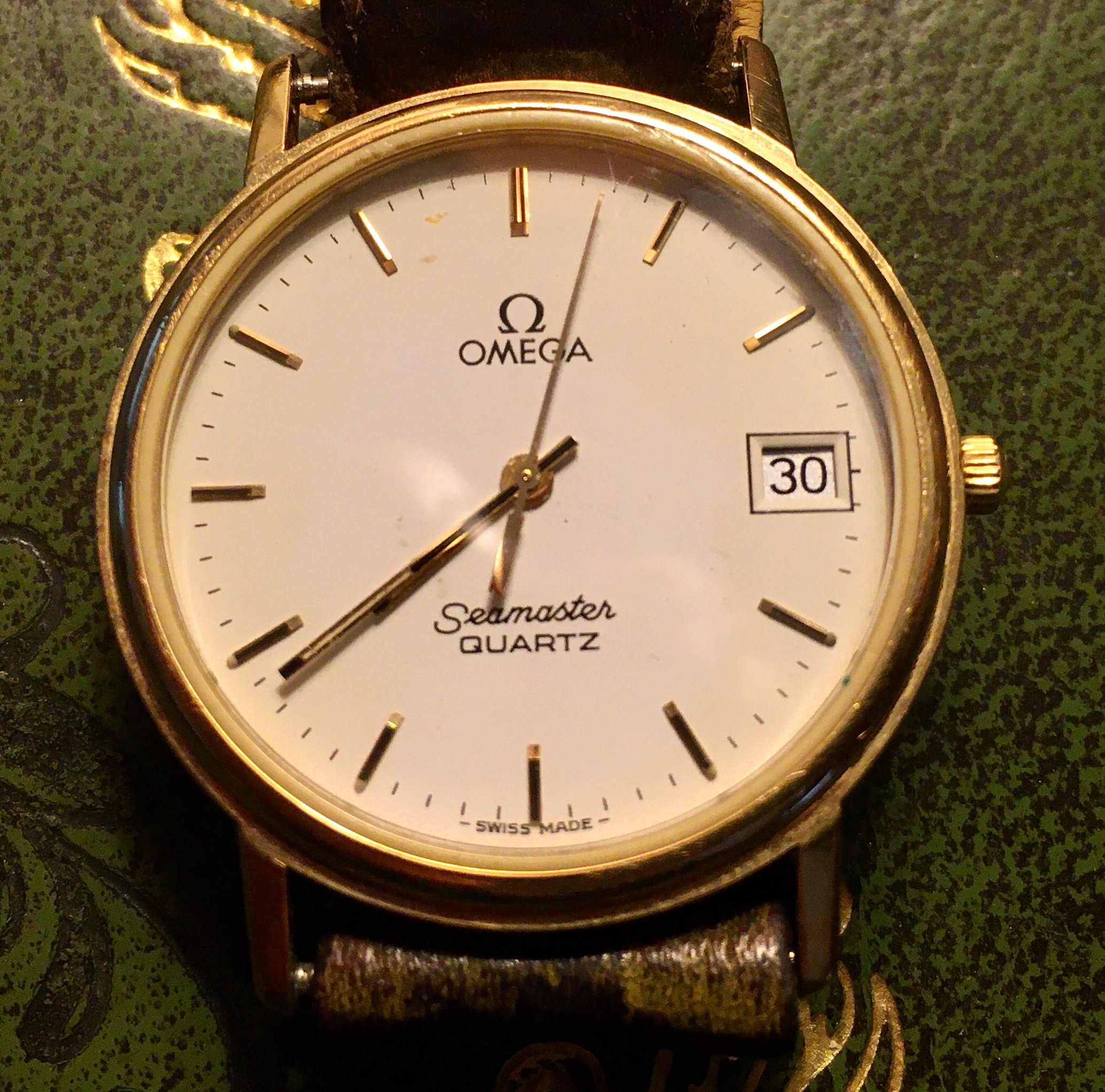

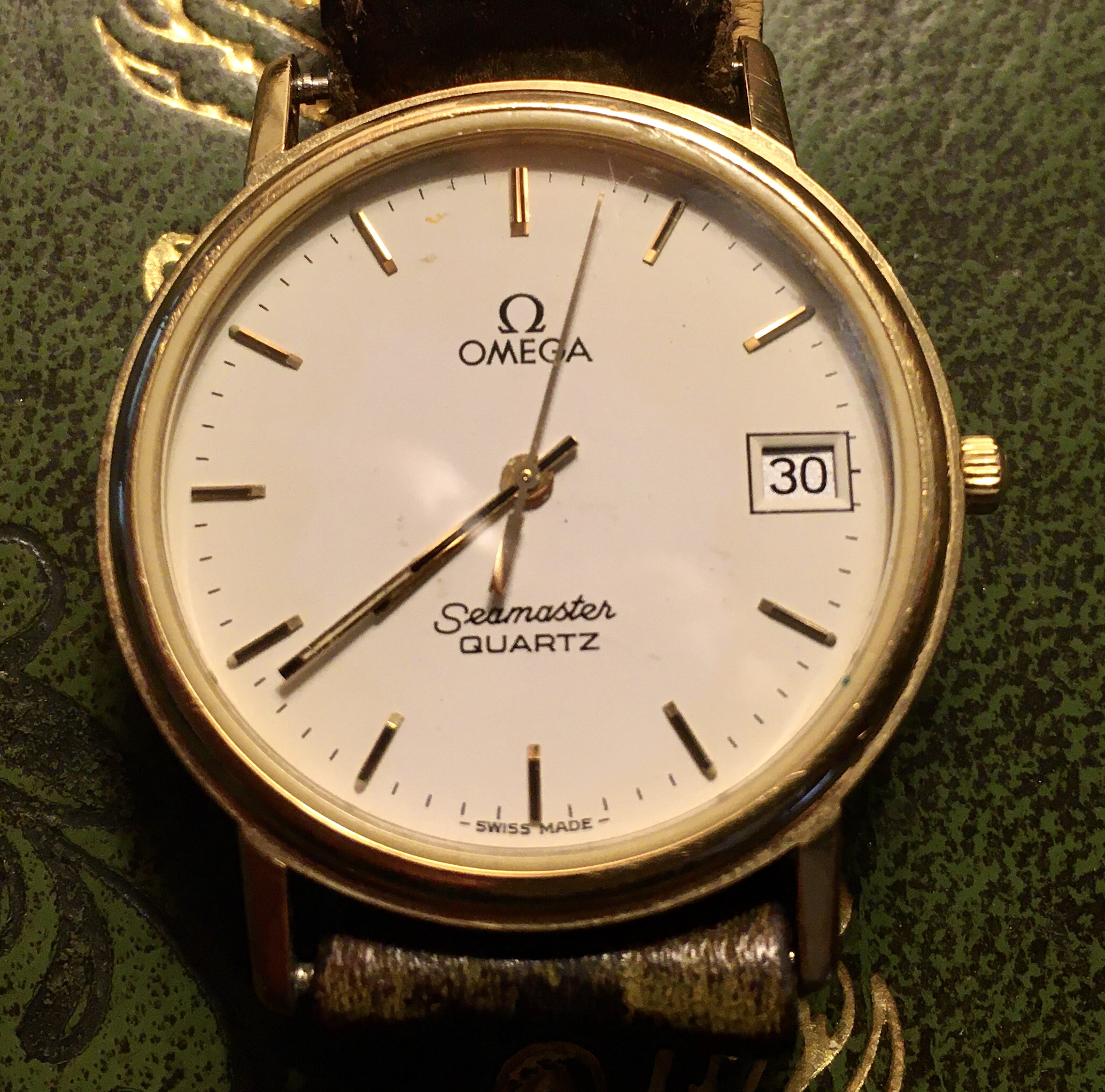

Grateful for any information/thoughts on my best way to proceed.
I bought this Seamaster Quartz many years ago, and before it was put away in a bottom drawer was running slightly slow. The battery is now dead and I haven't attempted to change. I have the original receipt/proof of purchase and wonder whether it might be best to sell as is, and if so on ebay/or elsewhere, or whether I should try to repair? If the latter, do others have advice as to the most cost effective. Any thoughts as to likely value? I am new to this so apologies if the questions sound very uninformed!

If it is full of acid due to a leaking flat battery (all too common) then it is worth practically nothing. If after a new battery is dropped in it runs then its worth maybe £100. I'd try a new battery myself and see what happens. ebay is the best bet. If it doesn't run after you try a new battery, don't be a dick and pretend you have no idea about the condition, tell the truth either way.

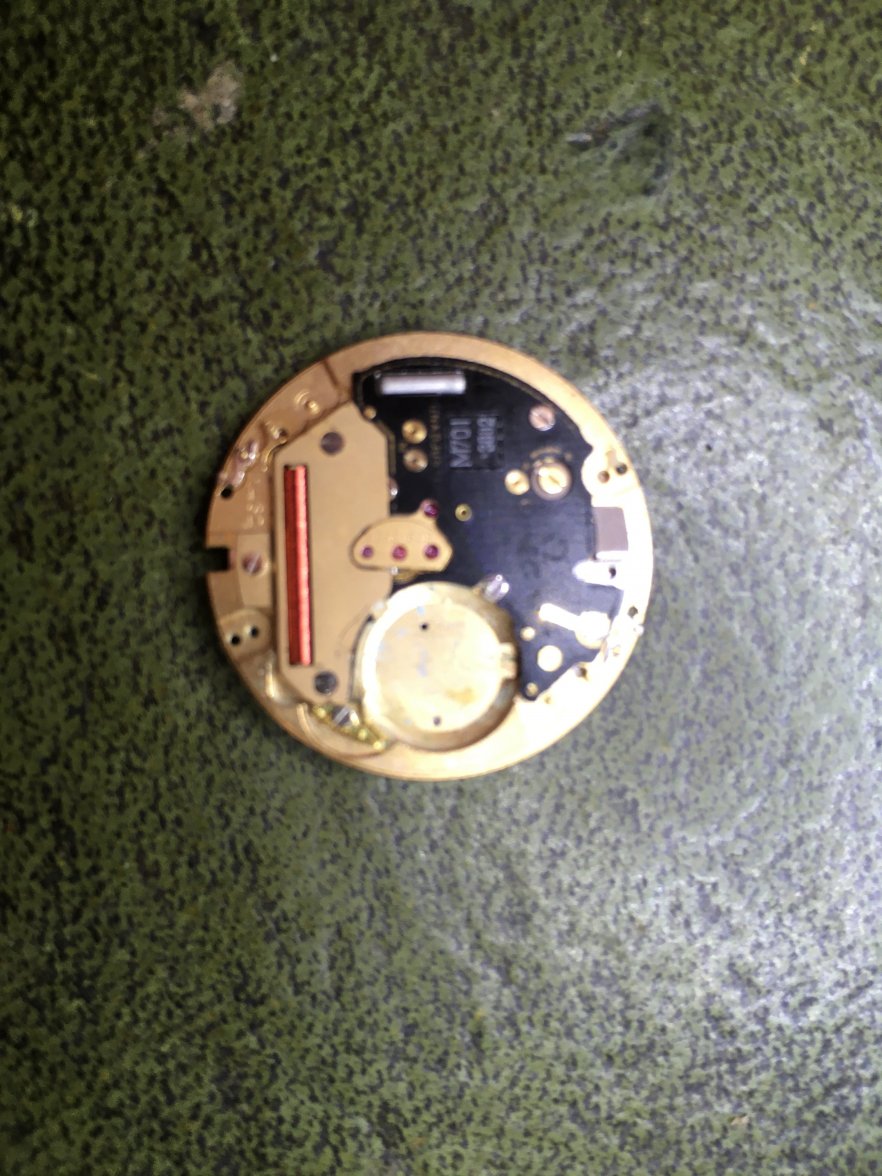

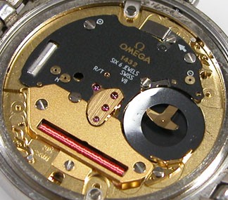

So having replaced the battery it appears the movement is indeed shot as you suggested; can anyone advise what would be an affordable modern replacement for the 1432 calibre/looking online just now the ETA E63.111 appeared as an option, but would be grateful for any advice if this might indeed be suitable. I am keen to get it going and keep the watch if at all possible.
Many Thanks
513
339

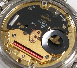

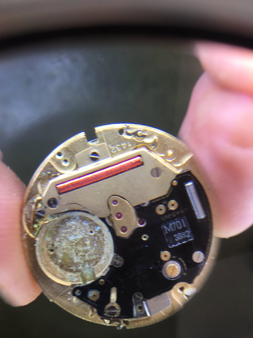

No wonder that it wont run there are some parts missing:
Beside the acid onto the movement which is a very bad thing to.
The Omega 1432 is technically the same as the ETA 255.111 but both are not in production anymore.
So maybe it would be a good idea to see a watchmaker to check if your 1432 could be resurrected.
30,285
78,163
Battery has leaked, one contact is missing...unless you can find a complete circuit, it's probably not worth trying to repair.
The 255.111 is the replacement - discontinued but you could likely find one.

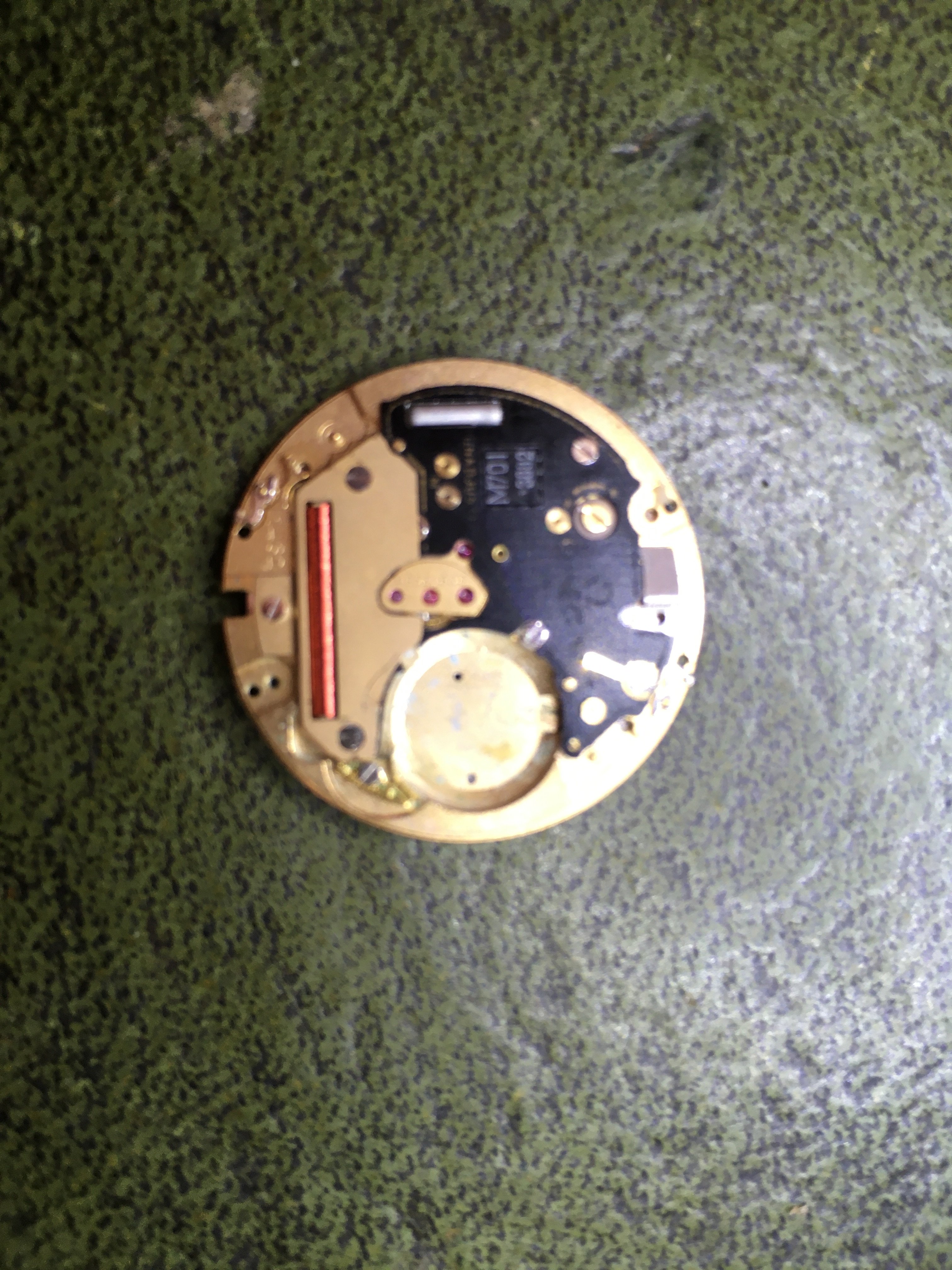

You guys! Where is the adventure?
Unsrew the board, clean it up with vinegar & cotton swabs [ The circut board ] and the plates where the residue is present. Don't drench it.
Inspect the undeside of the board see if the chemicals wicked into the board, if yes, Kaputsky!
Looks plausible, put a new battery contact on a couple of insulators & see what happens.
Vinegar, because it is an alkaline base chemical, not a car battery. Also use alchool or distilled water to remove any traces of the vinegar.
What you gotta lose....
One of the other problems with quarts analog watches is unclean service area when energy cell is changed. Iron particulates seem to be attrated to the motor magnet. [ Wonder why? ]
I serviced an early QUARTS OMEGA that was very unique, iron filings bigest problem.
Also found in the jewelers back log an early 18k GP,
seviced it, called the owner. "Your watch is ready!"
Response, "I was told no parts were available & they would buy it for scrap!" I don't know anthing about that, sir! Sir, your watch is ready, I would pick it up!
Iron particulates from unkept bench bigest problem.
