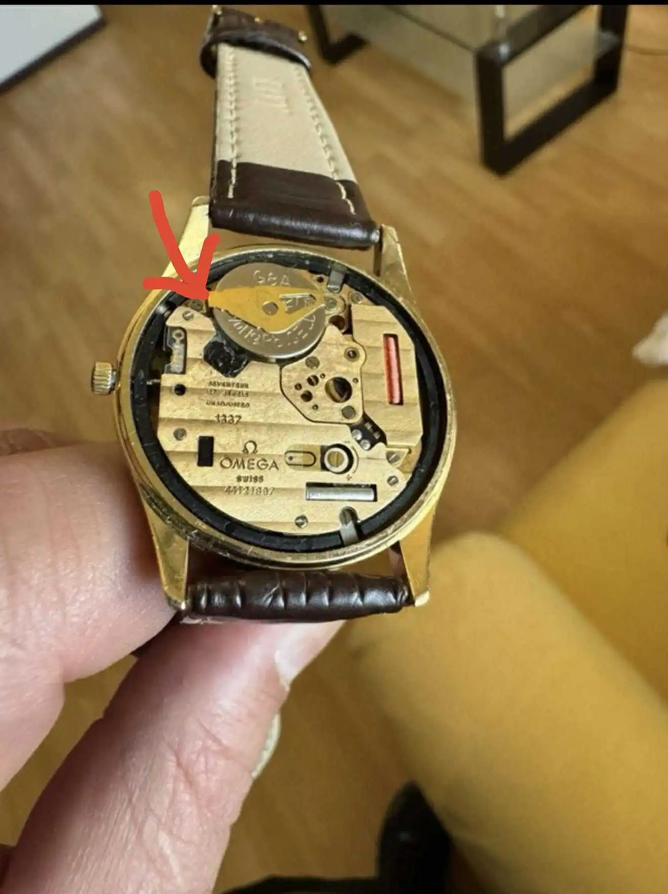

Posts 2 Likes 0 Hasnat 路Jul 19, 2025 Cam anyone please help what screwdriver to use to tighten the marked screw on the battery holder frame? Tried 0.8. seems like the head is a bit thick so doesn't hold on slot.馃槄 Thanks in advance.
Posts 18,579 Likes 38,570 JimInOz 路Jul 19, 2025路Melbourne Australia Screwdrivers "off-the-shelf" often (90% of the time) need to be dressed to suit the type of screw being worked on. Select a screwdriver of the correct width, establish the type of screw head slot (narrow? wide?) and then dress the tip accordingly. Some very good info here. https://omegaforums.net/threads/basic-watchmaking-tips-stems-and-screwdrivers.157128/ Thread 'Basic Watchmaking Tips - stems and screwdrivers' 路 This is #12 in my series of basic watchmaking tips. Combining two shorter topics here, because of a need I see on the forum for one, and a request was made to me via PM for the other. First... Archer 路 Mar 11, 2023
Posts 2 Likes 0 Hasnat 路Jul 19, 2025 Thank you so much. Its very informative and I have found the possible solution. Have a great weekend.
