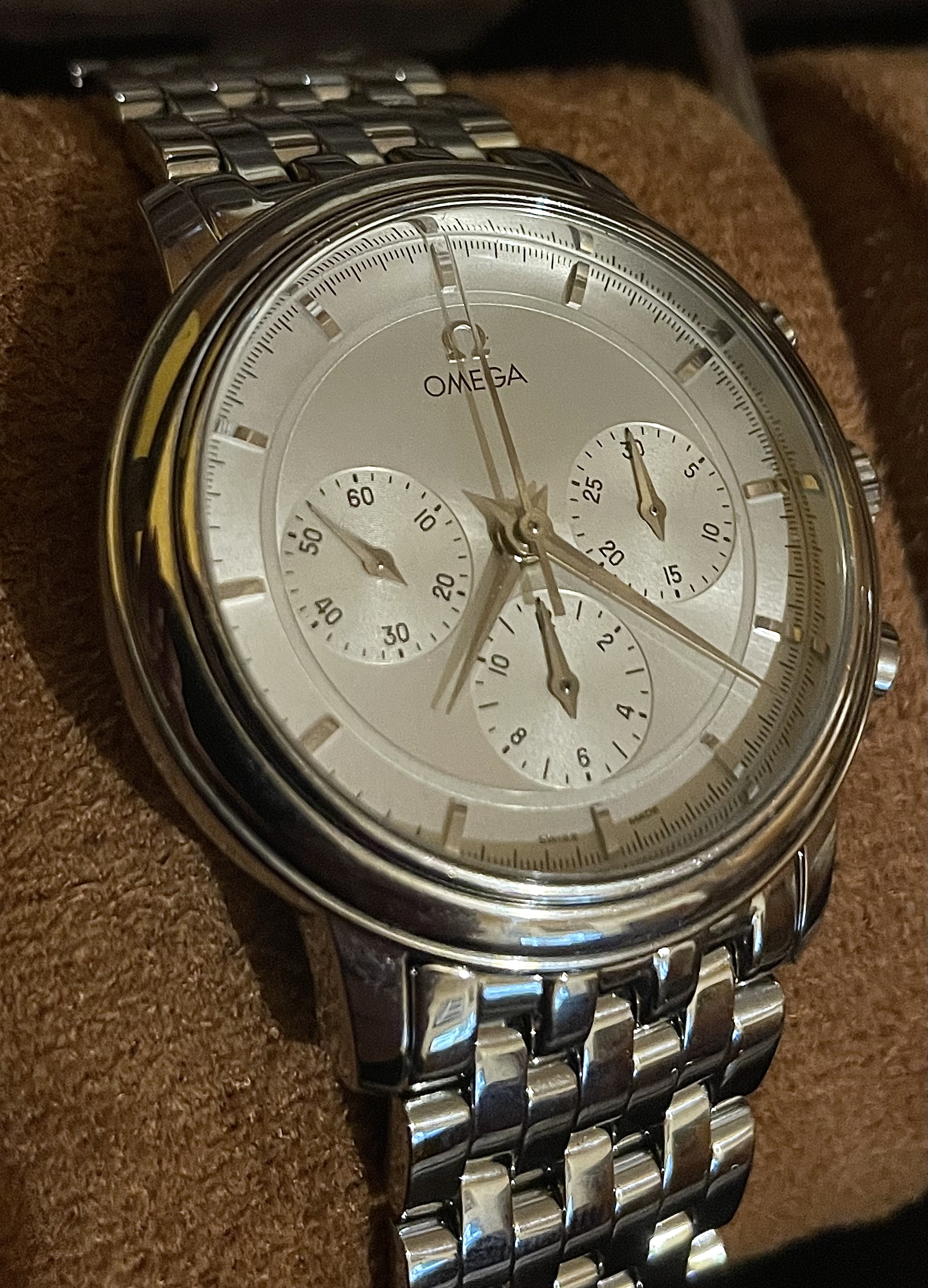

I picked up a silver dial model with full kit, a few months ago, from Japan but from a different eBay dealer. It was my first purchase from the Asian market and I was very pleased with the speed of delivery and the fact that the description was completely on point. Should be back from the spa in a couple of weeks.
522
2,563
I'm really happy with mine and glad to have picked up a bracelet, so it's silver all over now just like your one. Since coming back from the service it has kept perfectly consistent time at +10 seconds per day, every day.

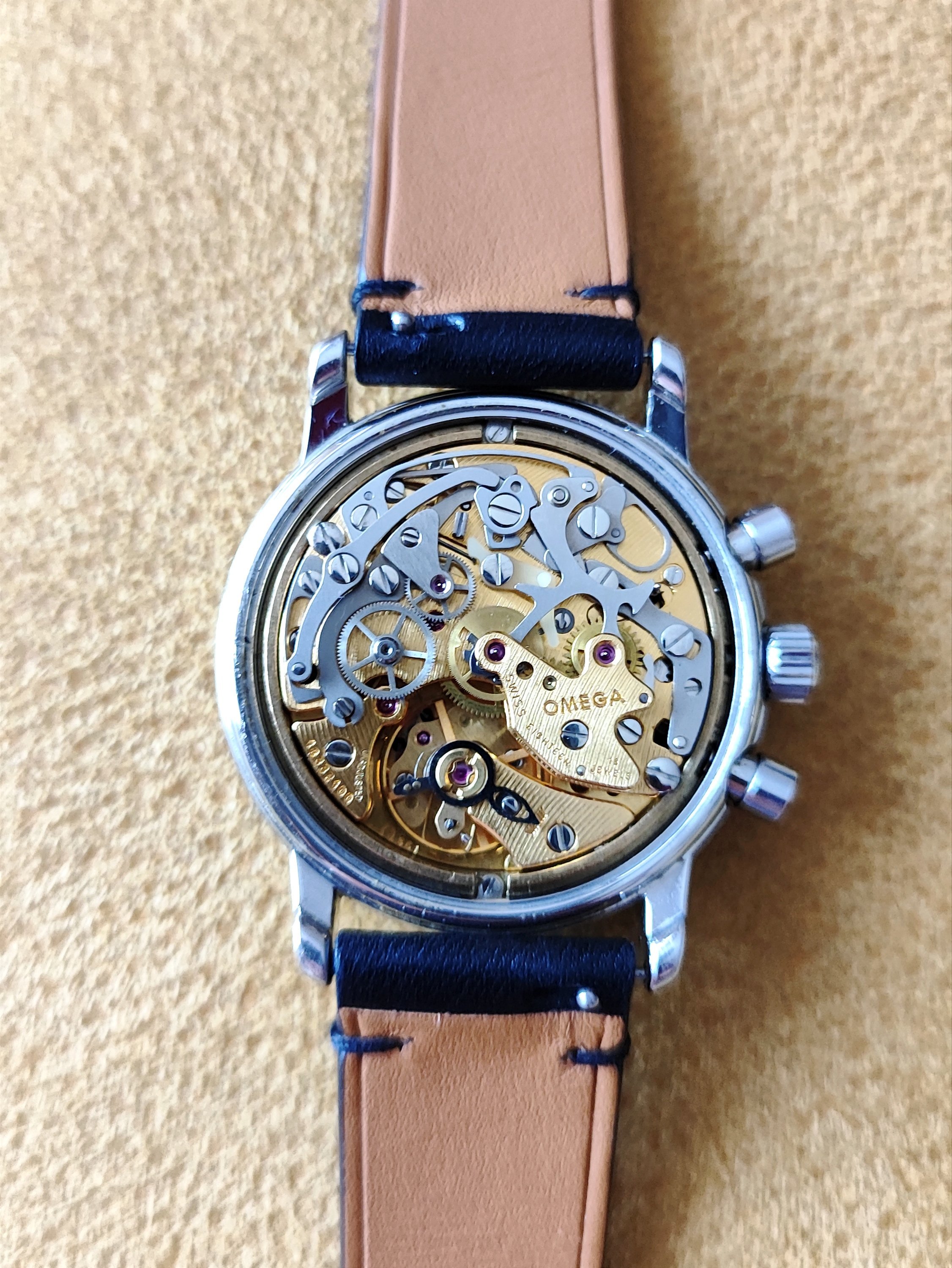

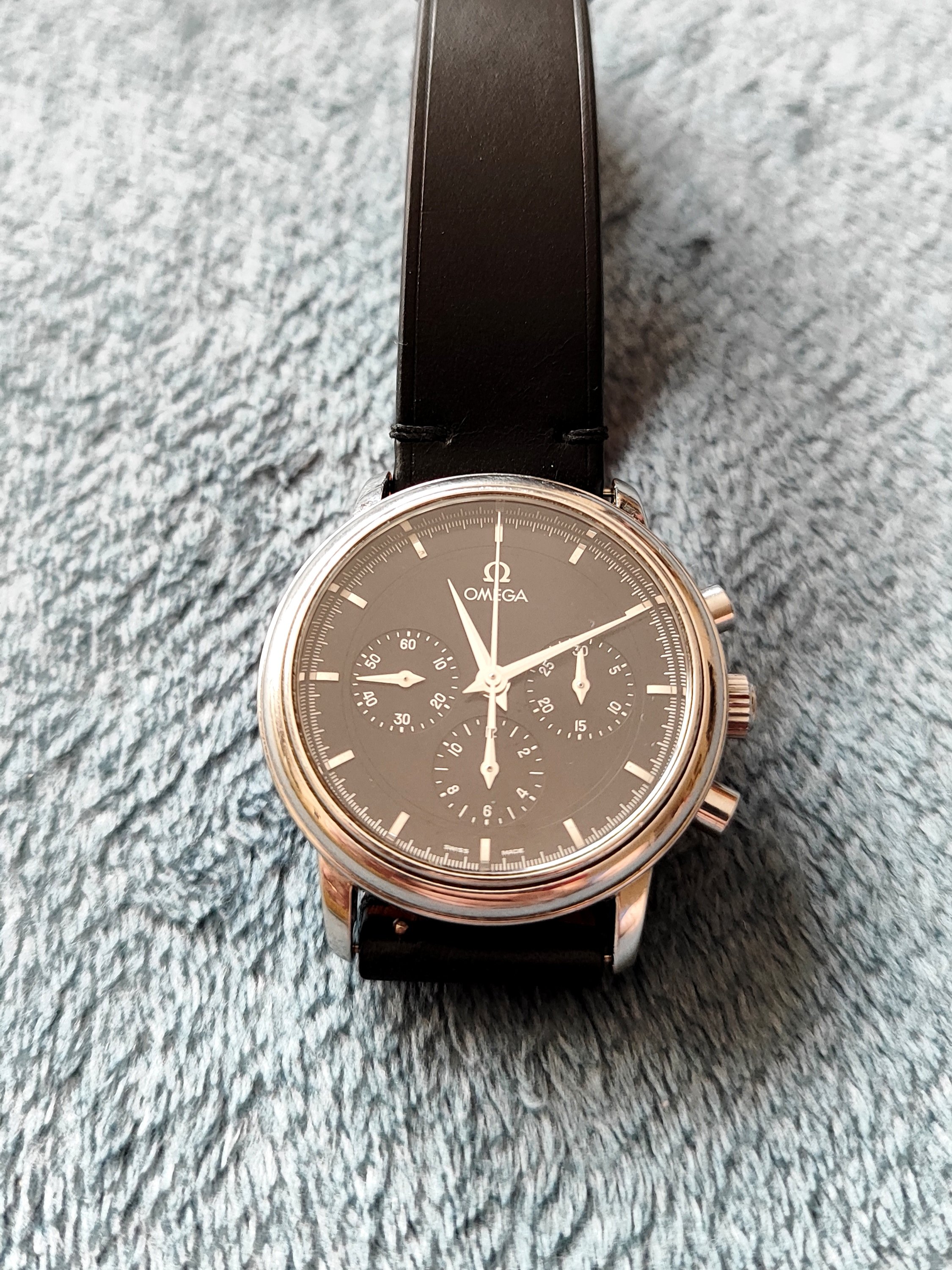

I didn't even know these existed until I was offered one and decided to go for it. Here's mine, stainless steel with a black dial (and a temporary strap). I'm really loving it's classic look and the 861 pedigree.
522
2,563
Really curious that your one says 18 jewels, whereas mine says 17 jewels, despite being from that time when the 861 was using 18 jewels. It's not quite clear why Omega did this, however it was seen in other references as well around that time. I am guessing they continued to use the old 17 jewel plates while they were in stock, suggesting your 861 was one was one of the very last made.
671
2,005
That's interesting. Is it an actual 17 jewels (if it's even possible to tell) or a 18 jewels with an older bridge? Seems weird for Omega to just slap an older, non-matching bridge because it's still in stock.
522
2,563
The 861 was originally 17 jewels, however they switched to 18 jewels at some point in the 1990s I recall. I believe all of these were 18 jewels, however all the examples I've seen to date have been marked as 17 jewels. All of this was in the lead up to the 1861.
The 18th jewel is visible, but I gather of little real benefit and one might even suspect it was added more for marketing purposes.
There was an earlier thread where this was covered:
https://omegaforums.net/threads/861-movement-in-a-4835xxxx.82387/#post-1058764

the 18th jewel started to be present on the 861 and lemania branded ones in 1989 or so. The 17 jewel mark on the movement oersistedted for a year or so. You can date 1989-1990 watches by having 18 jewels but marked 17.
522
2,563
I seem to recall serial number on mine was later than that, yet still marked at 17 jewels. It was originally sold in 1997.

That does not match my observations of the omega and lemania versions of the movement.

Yeah that is bad info, that reflects the markings on the movement, not the presence of the actual 18th jewel. Its pretty well documented that 1989 was the first year of the 18th jewel, and was not marked as such until late 1992. This also caused some confusion in regards to the 861 and 1861 and the thinking the 18th jewel not being present until the 1861.
Unless you want to argue with extracts from the archives for multiple watch brands that use that movement. The 861 was also used by SINN in some 903's with Lemania branding. These also share the 18 jewel marked 17 jewel oddity from 1989-1992 or so.
