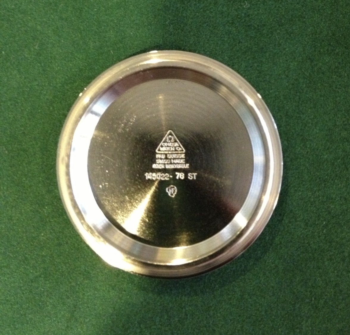

I need help with a vintage Speedmaster that I purchased 8 years ago from a local vintage watch shop. I'm no expert with watches and bought this off the back of buying a new Speedmaster and then wanting a birth year watch.
The watch didn't come with box or papers but I do know the serial number as the jeweller opened the back to show me before purchase and I noted this down. I did take images of the mechanism but they are so blurred that nothing can be made out in them and could literally be any watch. I have a decent image of the inside of the case cover though but I appreciate this only gives a very limited amount of information.
The watch came with it's original steel bracelet but I took this off the right away as I don't like steel bracelets but I also figured it would be best to keep this in good condition. I replaced with a new Omega leather rally strap which I think suits this watch much better.
I'd like to try and find out if all the parts are original and the exact age as far as possible. Please can you let me know what information/images are required in order to do this and whether or not I should purchase a tool to remove the case back myself to obtain good images or wait until after lockdown take to a jeweller to do this. I'd prefer to remove myself to allow me to take my time getting good images of the inside for future reference.
I'd also like advice on whether it's worth spending the money getting Certificate of Authenticity or an Extract From The Archives through Omega and what I should do with regards servicing the watch as I'm reluctant to have the original parts replaced.

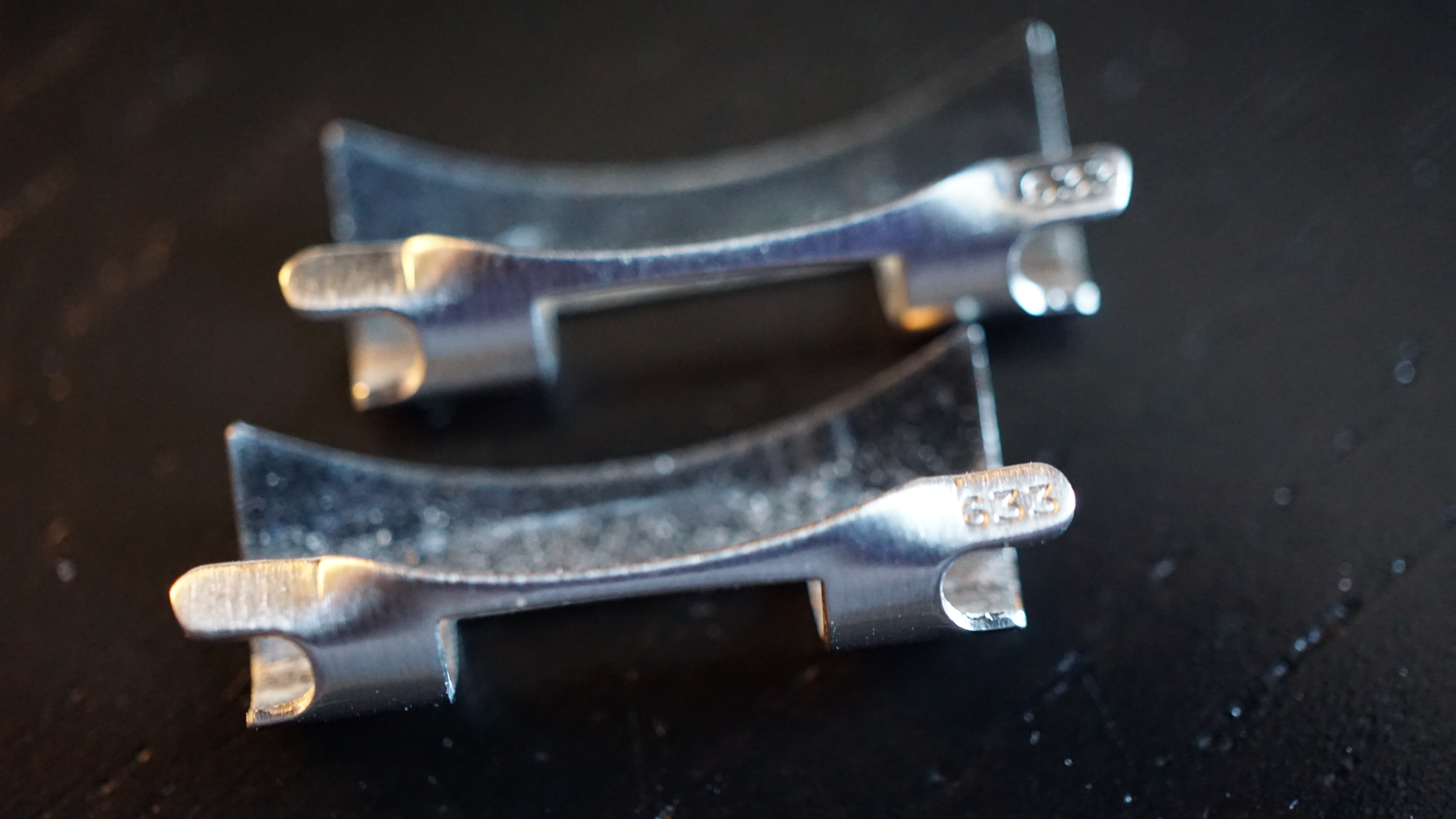

From my humble knowledge everything looks OK for a -76: Dial, bezel but wait for the experts!
Confirmation for the reference number inside the caseback is still necessary.
Case looks a bit polished
Check out this:
https://speedmaster101.com/145-022/145-022-71-74-76-78/
Please add a large straight on picutre of the dial!
EDIT: 1171/633 bracelet would be correct also for a -76
Check out this:
Thanks Passover,
Relieved to hear everything looks okay/original. I'm sure you know much more than I do but I will be reading up on this to confirm everything is original now that I've been pointed in the direction of a couple of websites.
I've ordered a "ball" to open the case back and this should arrive on Sunday. However, I'm certain of the movement number because I created a document when I was researching the watch before I even found the one I ended up purchasing and I noted it within that document plus it's noted on the receipts too.
What are the implications of the case being polished? Is this good/bad?

I don't know if you will succeed opening the case with a ball, be careful!
Having a picture of the inner caseback and the serial number of the movement it is not necessary to open the case IMO
145022-76 ST right?
Seems like you have a correct vintage Speedmaster but wait for confirmation by others.
Is there lumious (yellowish) material on the hour markers?
When a watch case gets polished material is removed and the case starts loosing its original look.
If you enjoy wearing your watch this shouldn't bother you too much 😀
