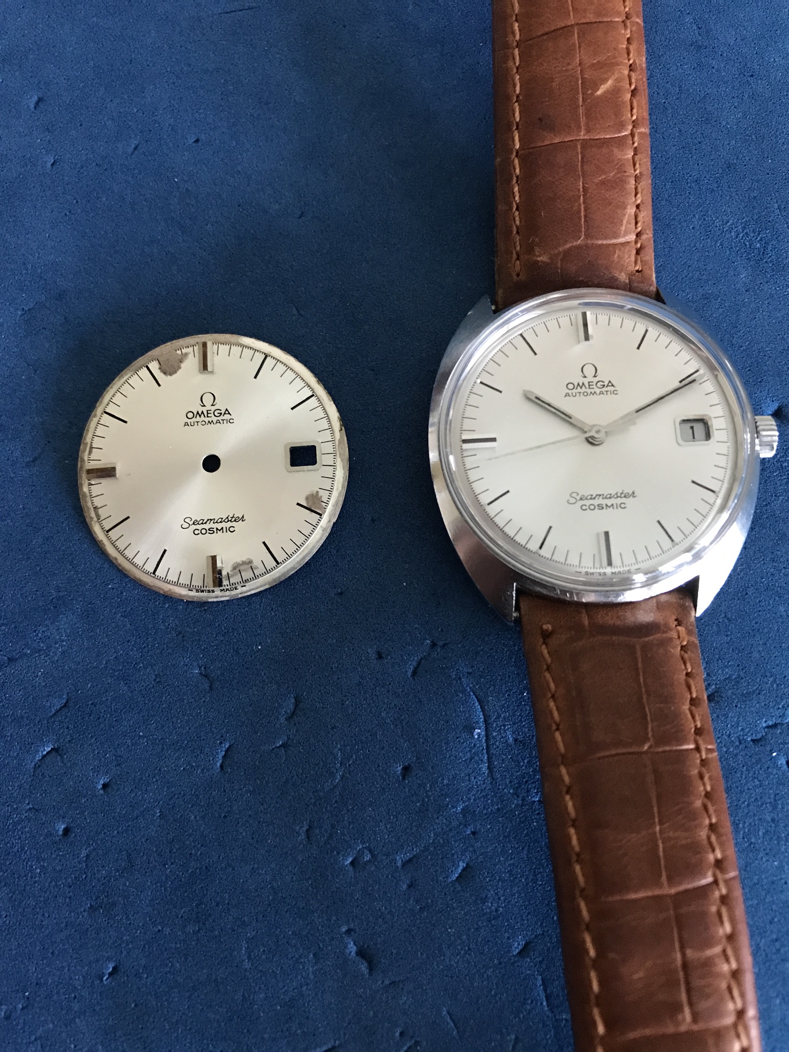

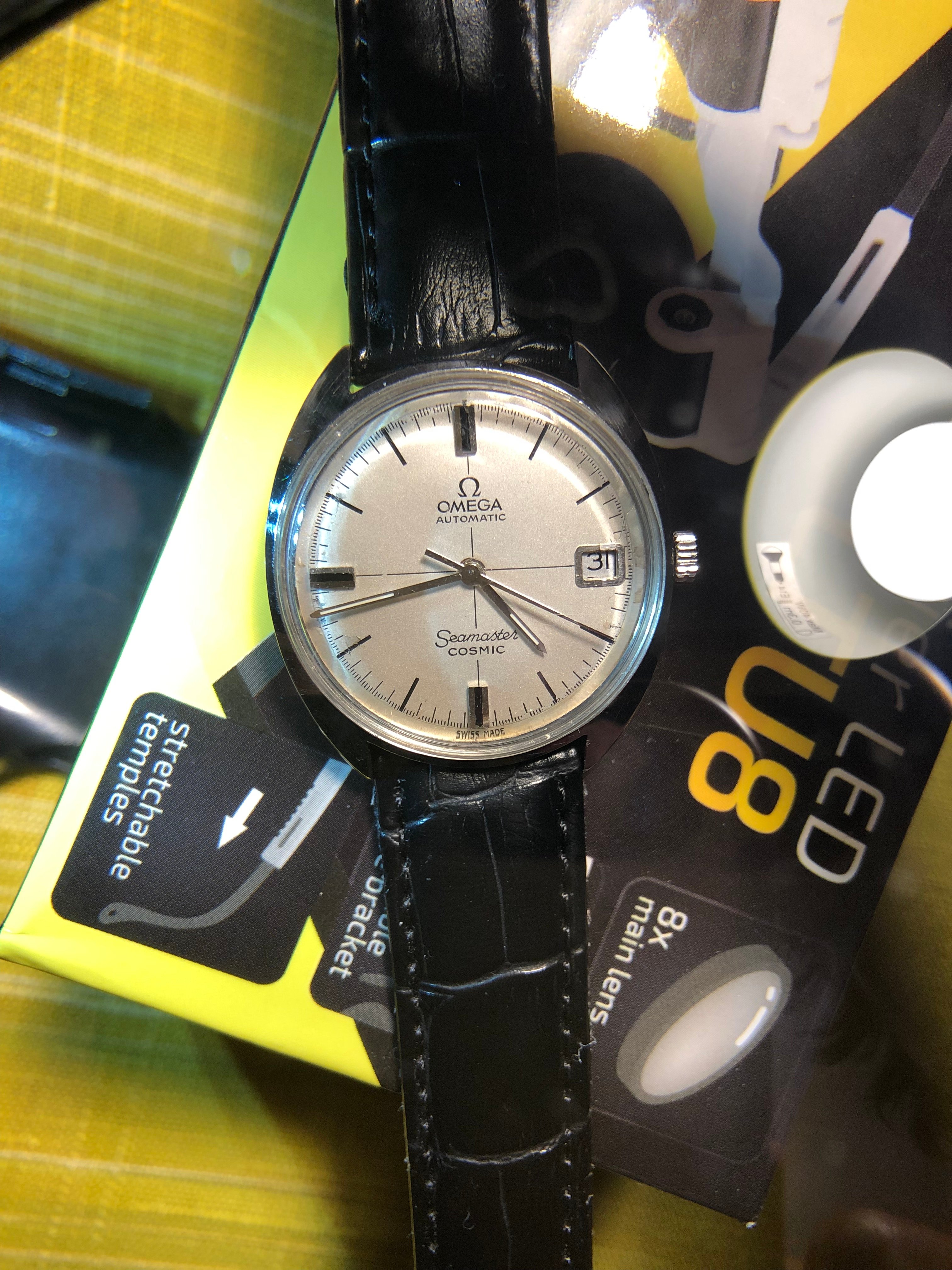

I asked for a photo of bottom of the dial as something about the ' swiss made' didn't look right and was sent the attached photo.
It looks to have some appropriate age related marks on the dial and I assumed that as they are front loading these are to be expected. Despite extensive images searches I cannot see another similar dial but there appears to be so much dial variation. The hands also appear that they might not be original.
Any help or opinions would be greatly appreciated.

Agree, hands are incorrect and there is something amiss with the date wheel, not aligned properly

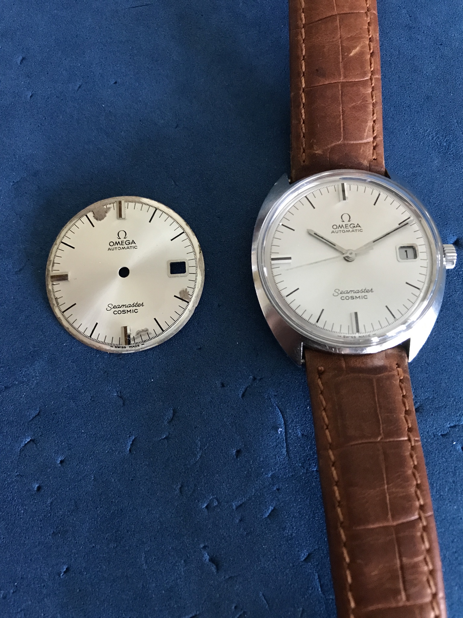

I have one, but had to change the dial as it was damaged ( on left)
13,555
23,503
Agree with @Sherbie, the hands have been replaced but the dial looks ok (aside from damage at various point along the minute track?)

Looks like a redial to me. I don't like the Omega text, and I really don't like the Seamaster signature, especially that capital S
After opening up the link and seeing the other pictures I agree.

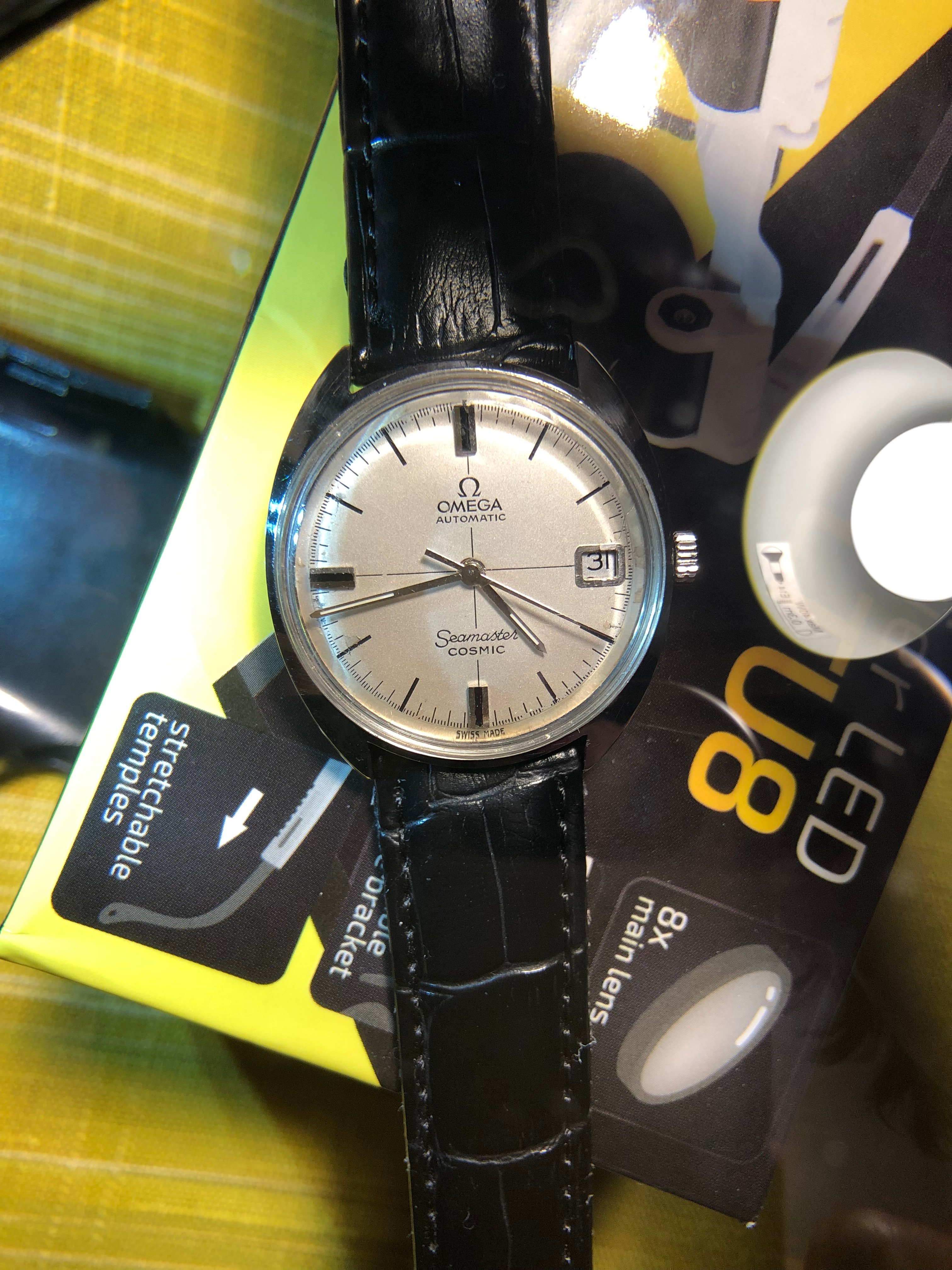

I agree about the lettering, looks off. I believe hands should have black inlays. Here’s mine.

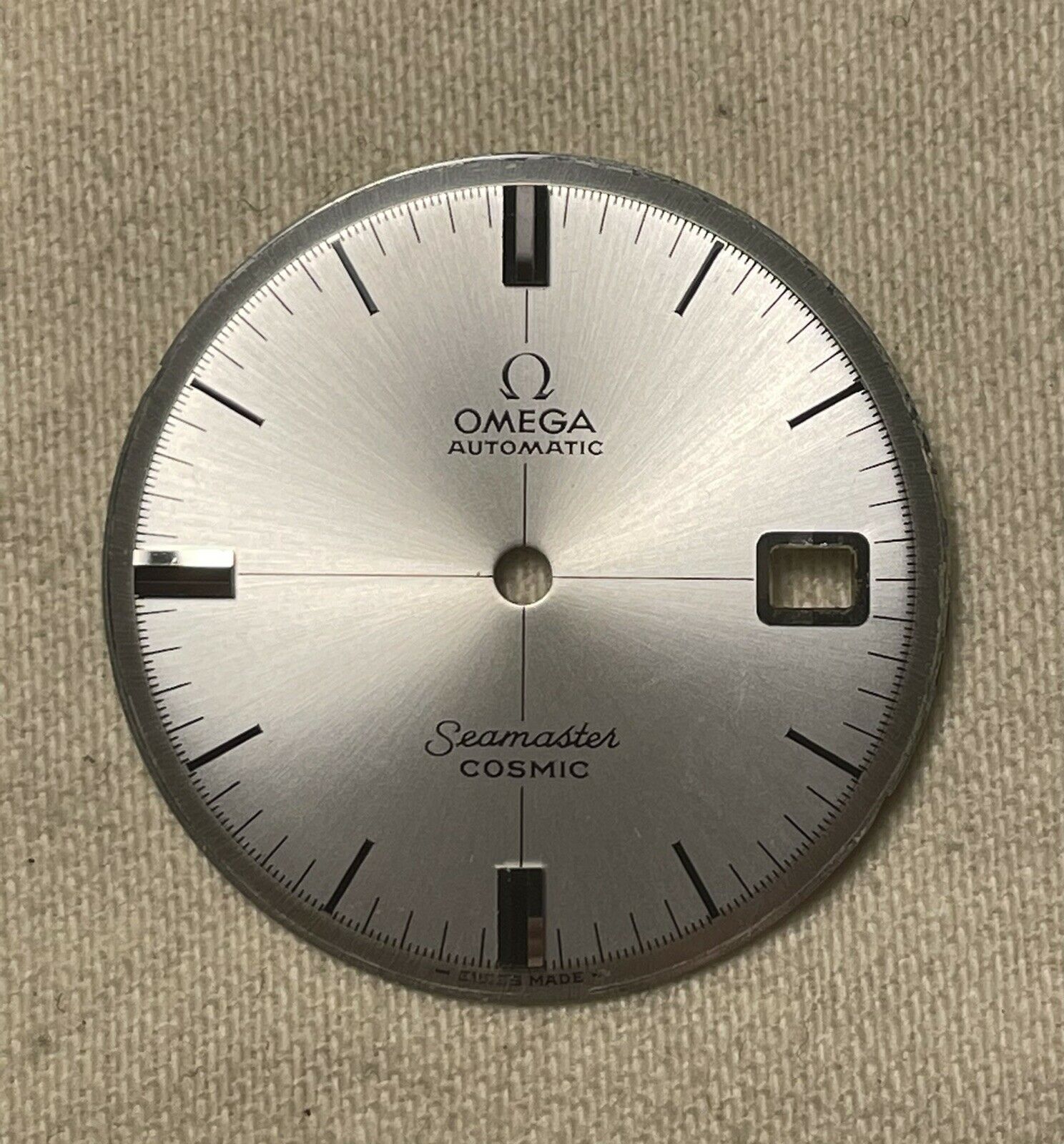

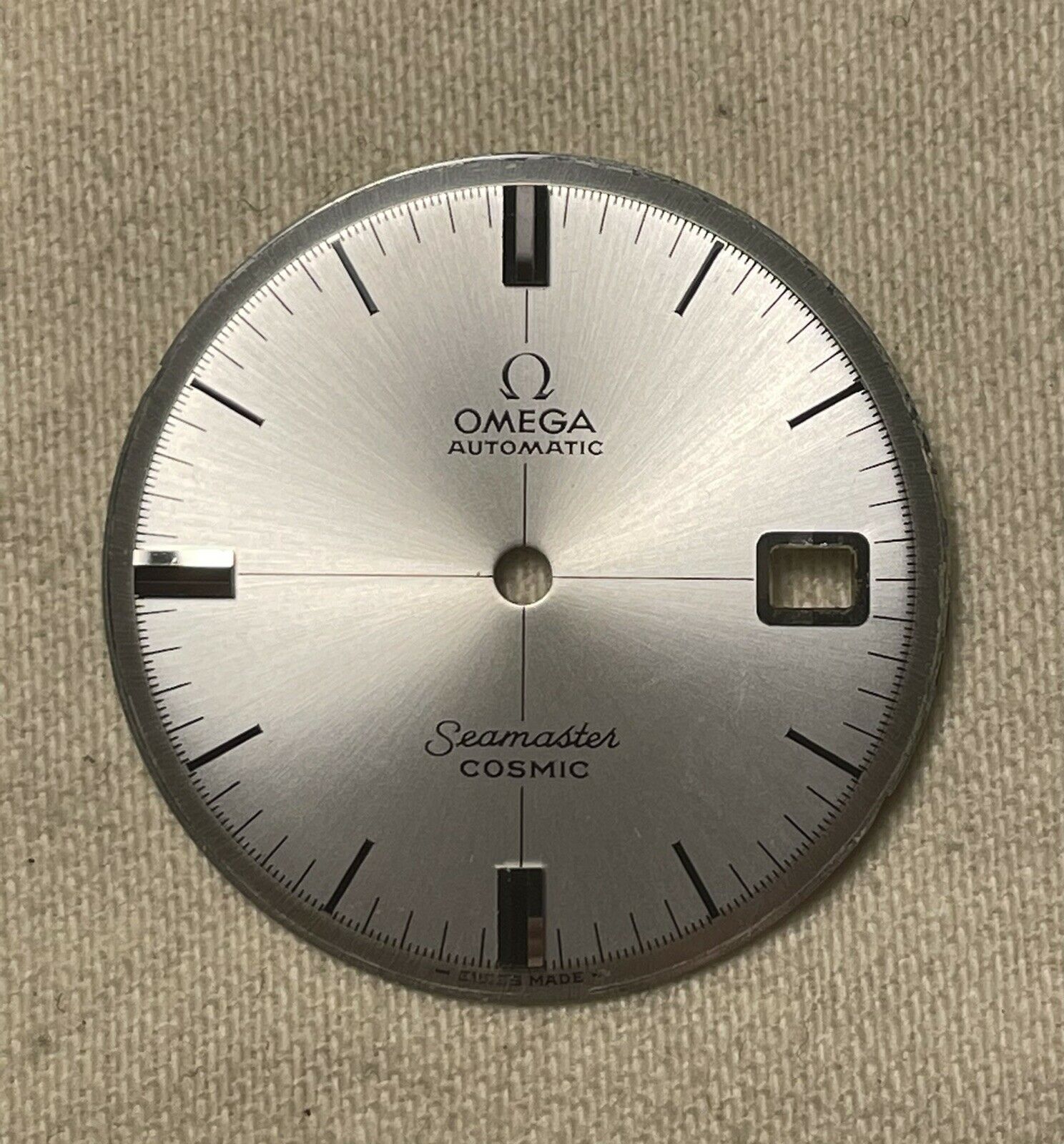

I vote redial. The font Is off and the way the minute track is flaking is not typical. Additionally, these crosshair dials had a brushed metal finish and not a "sparkling" surface as seen in this case. Most times when the watches are redialed, the surface is damaged so they can't reprint and lacquer the dial to maintain the brushed metal finish, so they paint the dial with a metallic paint to compensate. Here is a photo of my dial:
