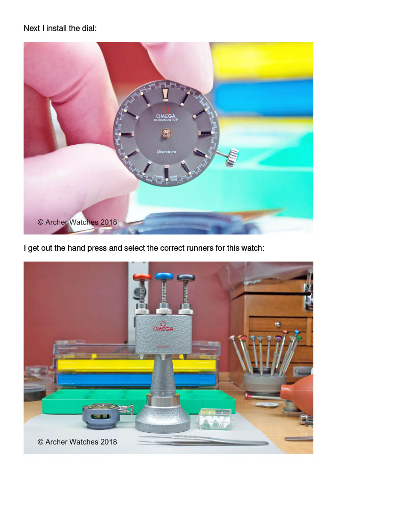

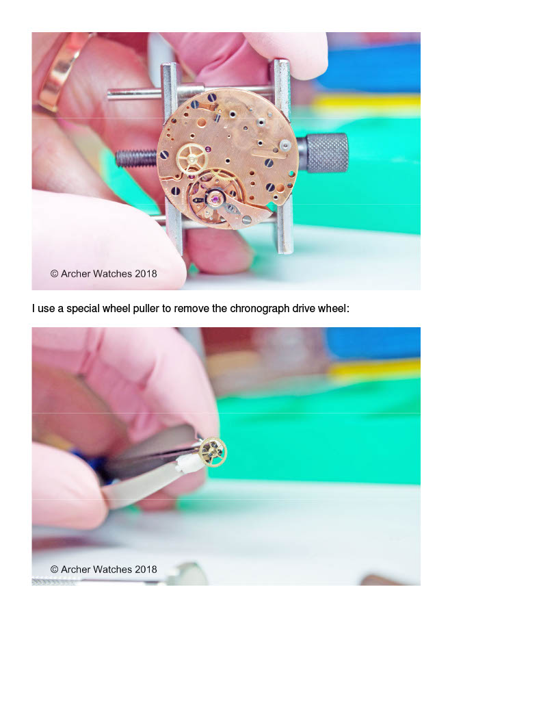

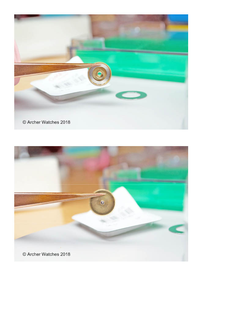

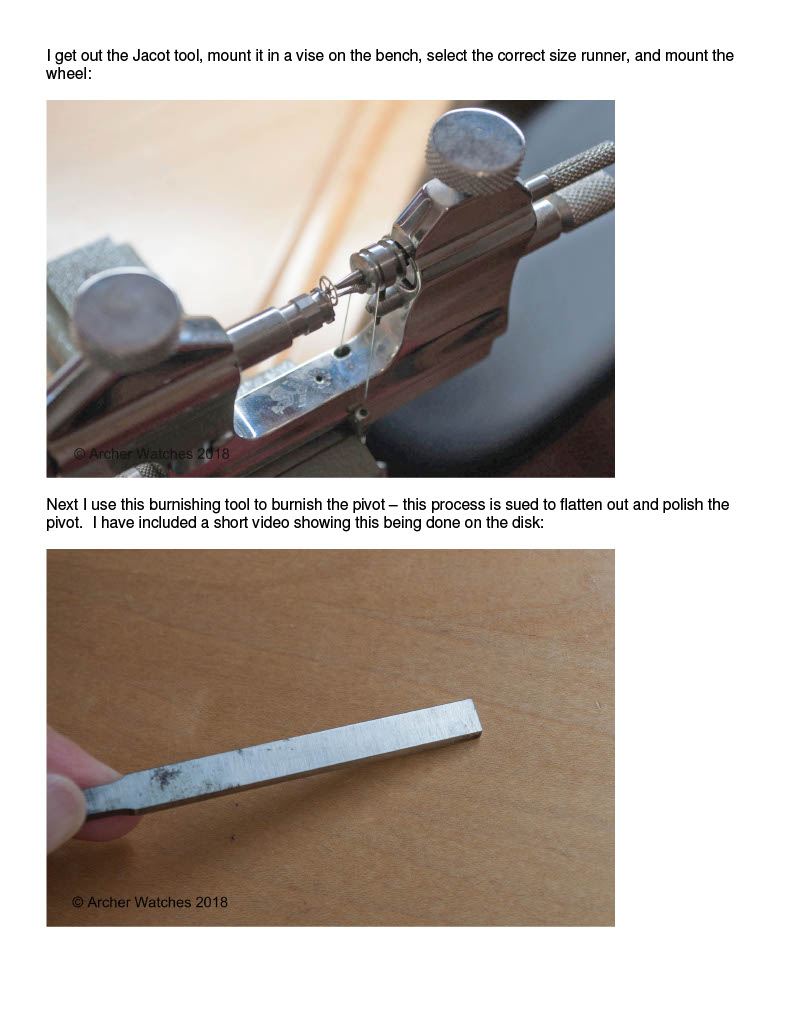

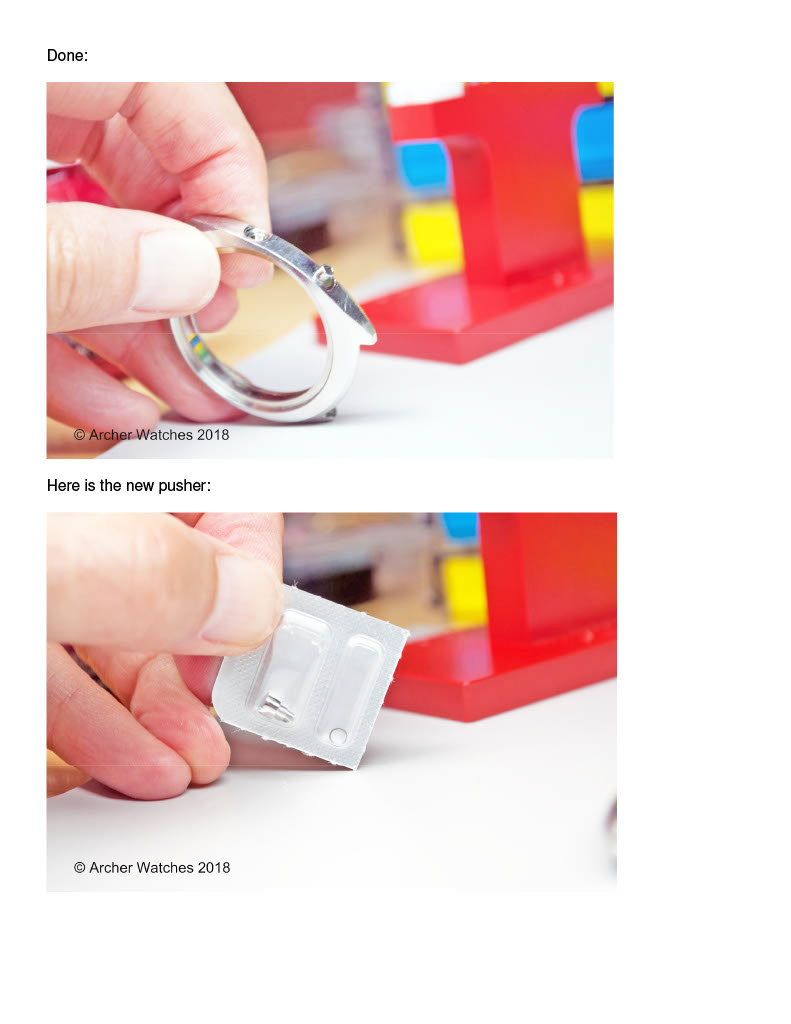

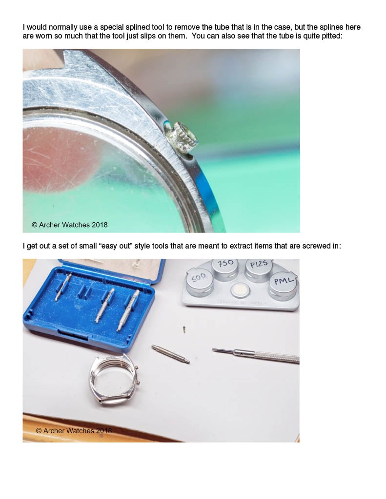

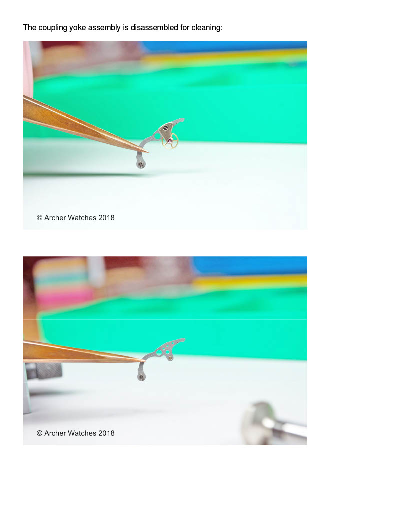

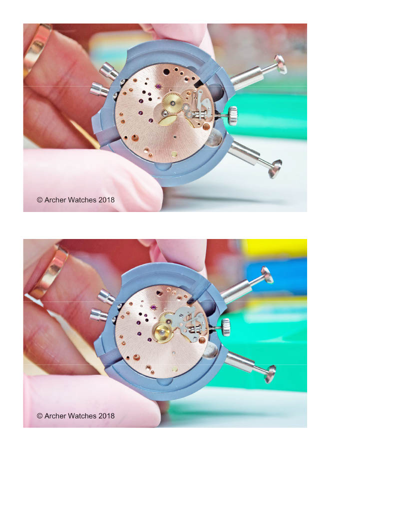

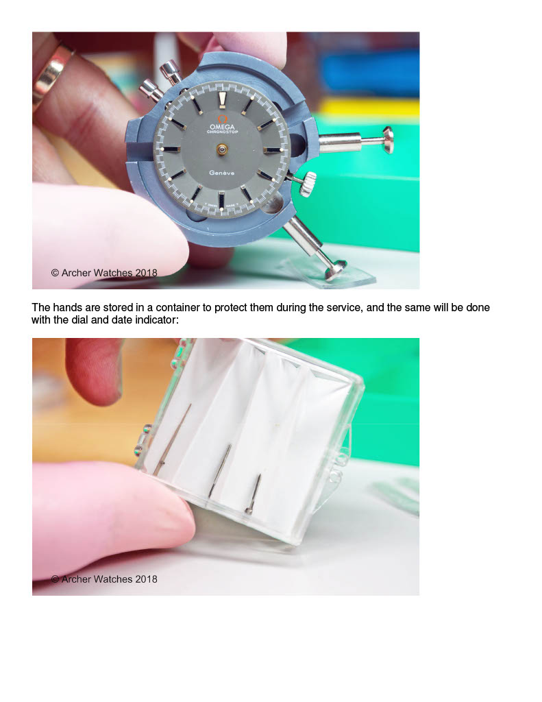

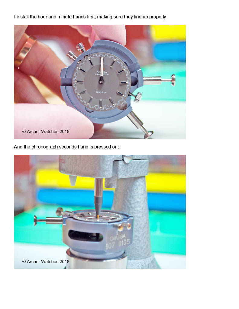

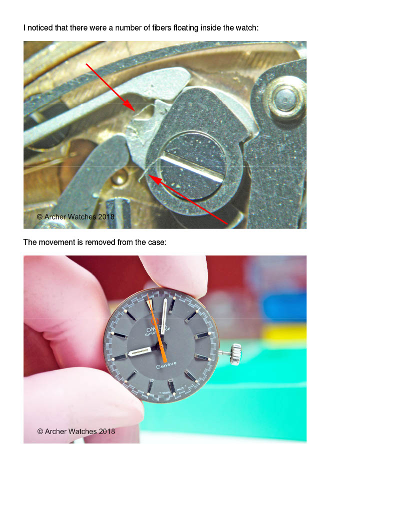

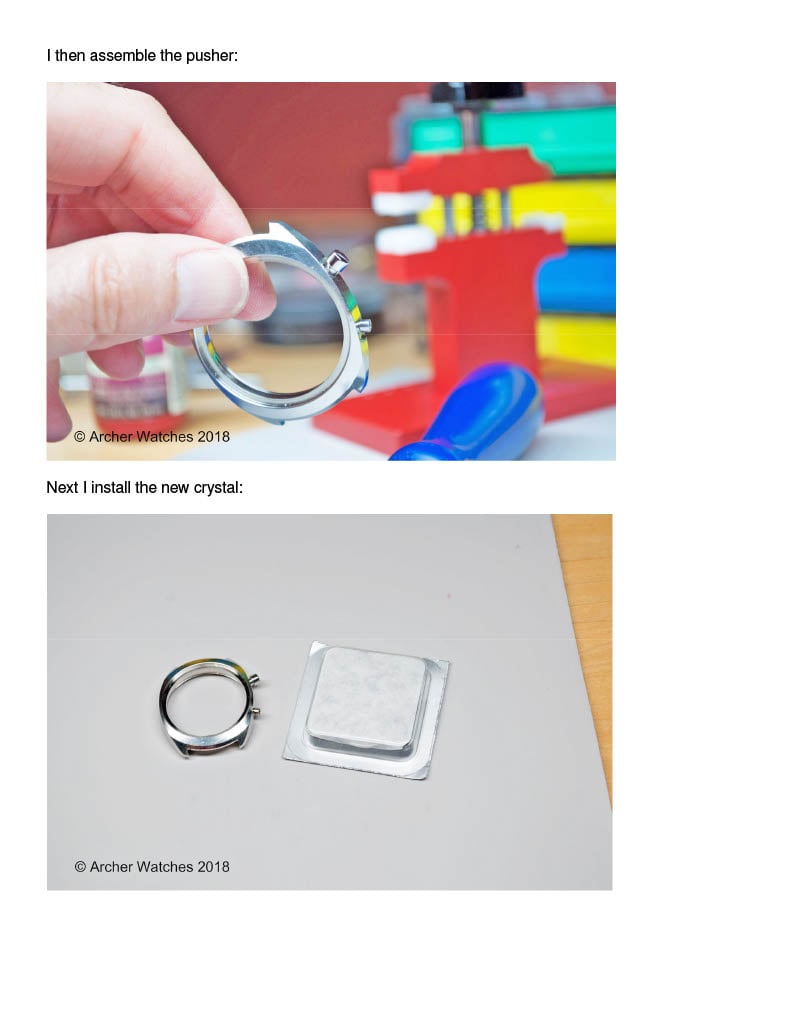

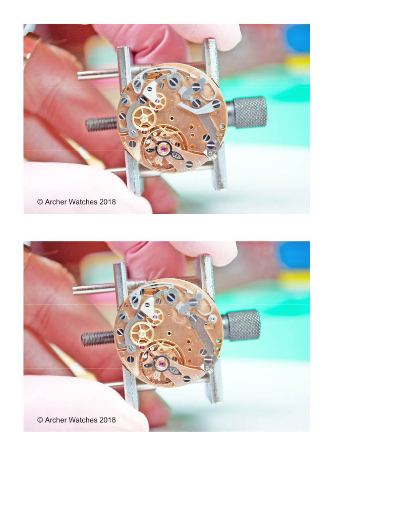

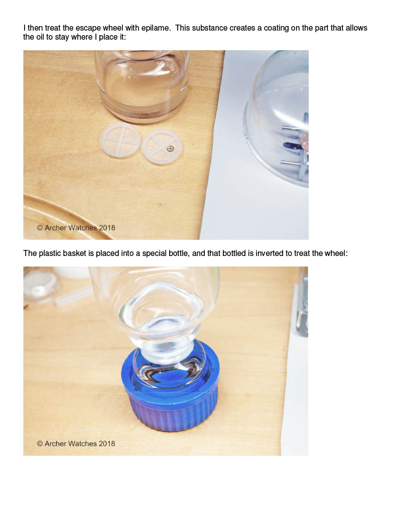

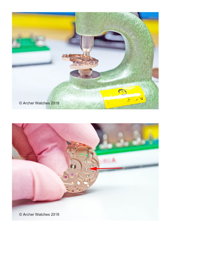

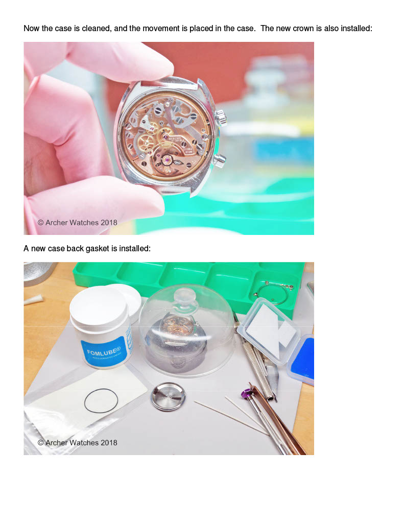

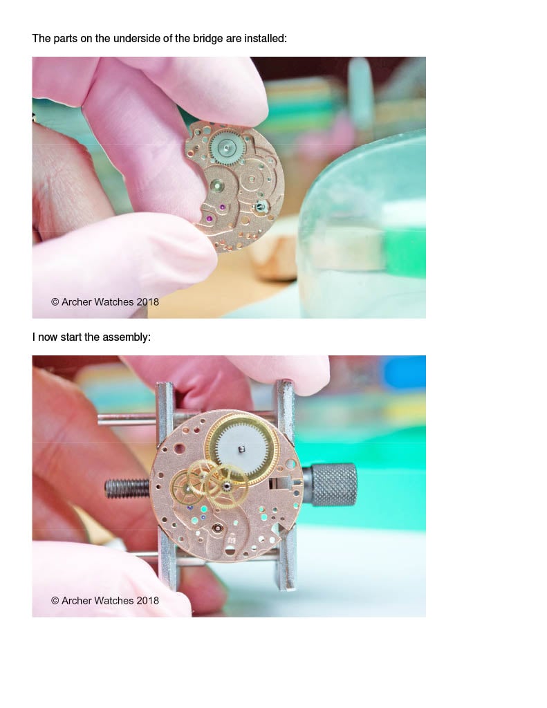

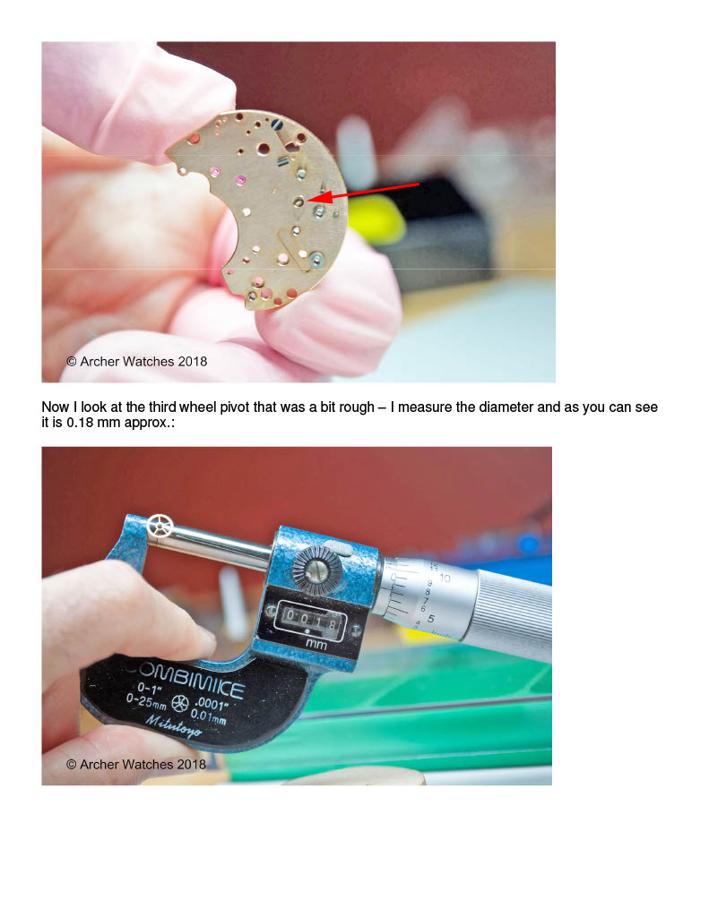

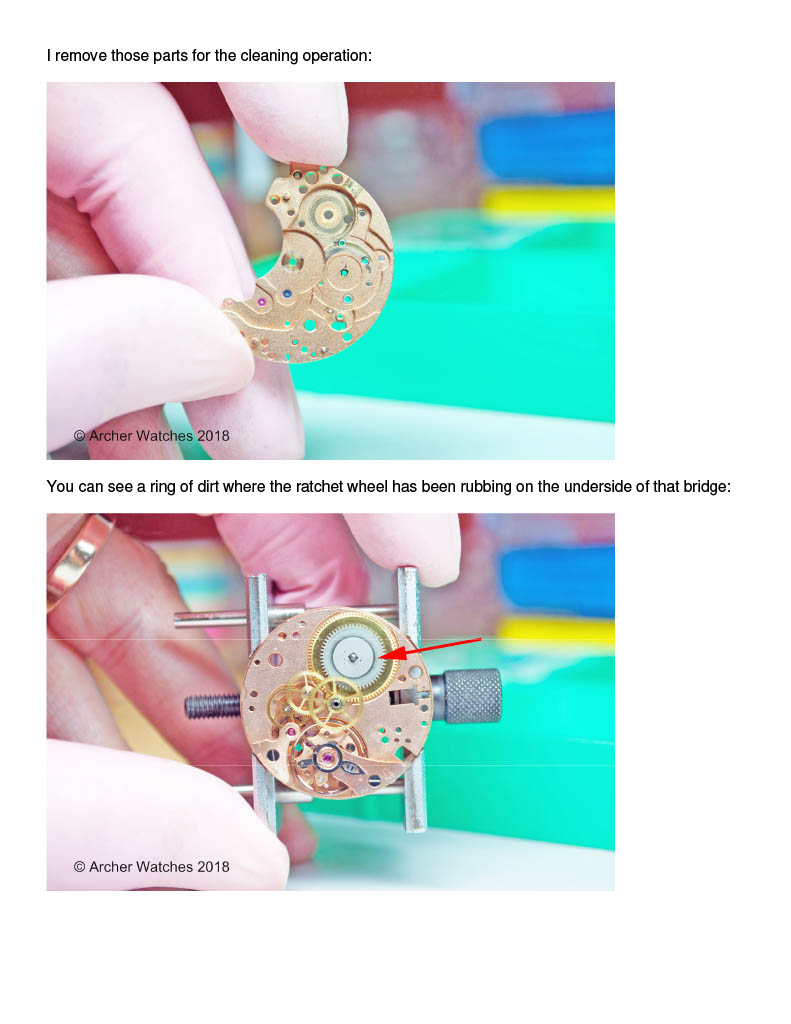

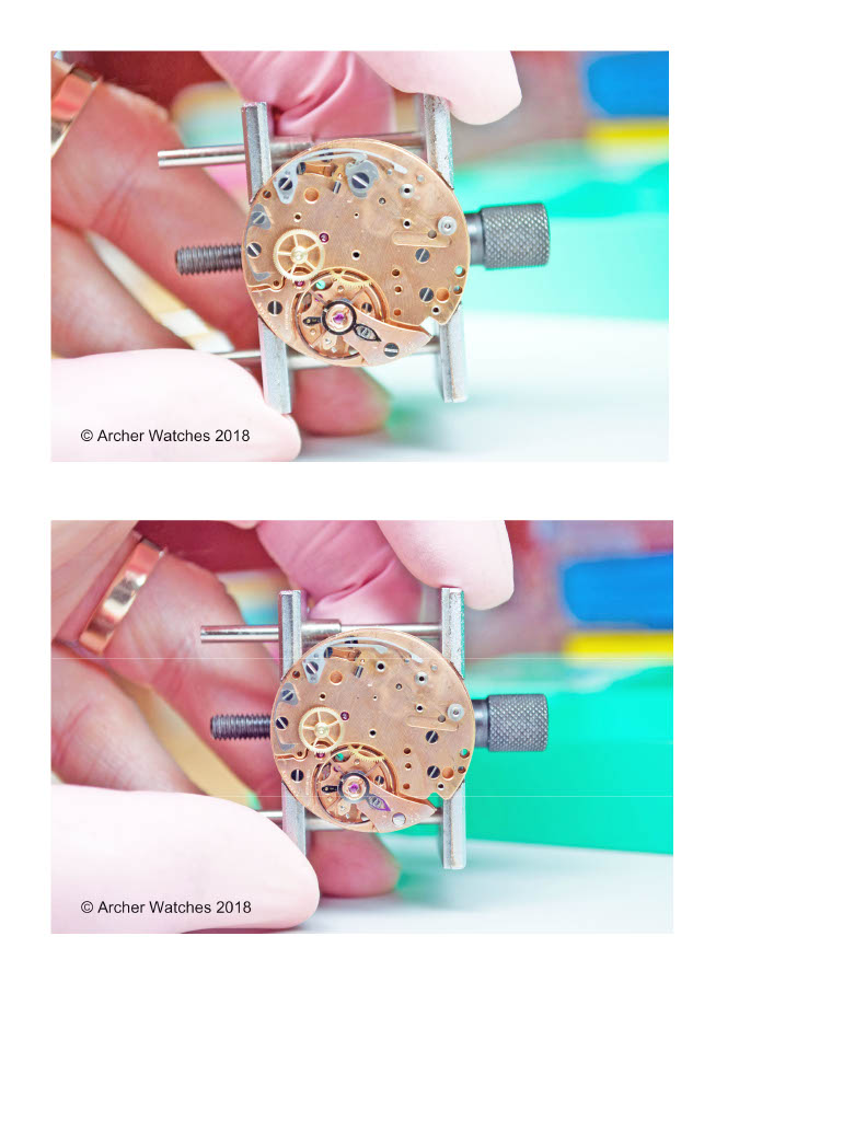

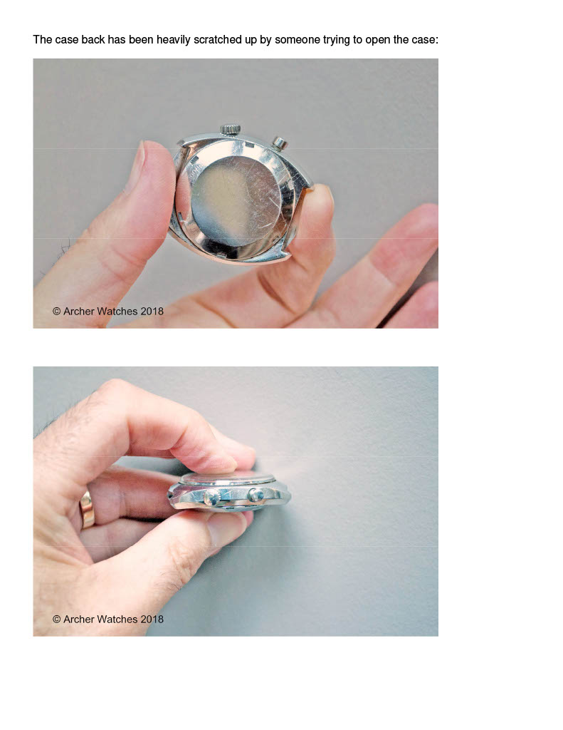

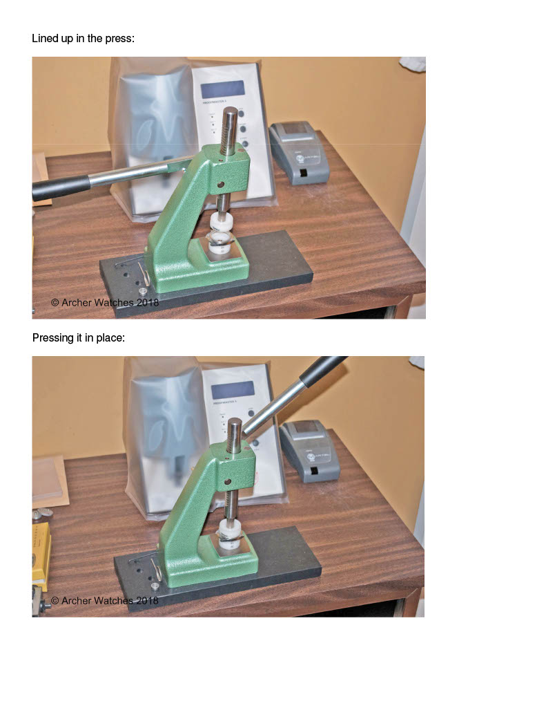

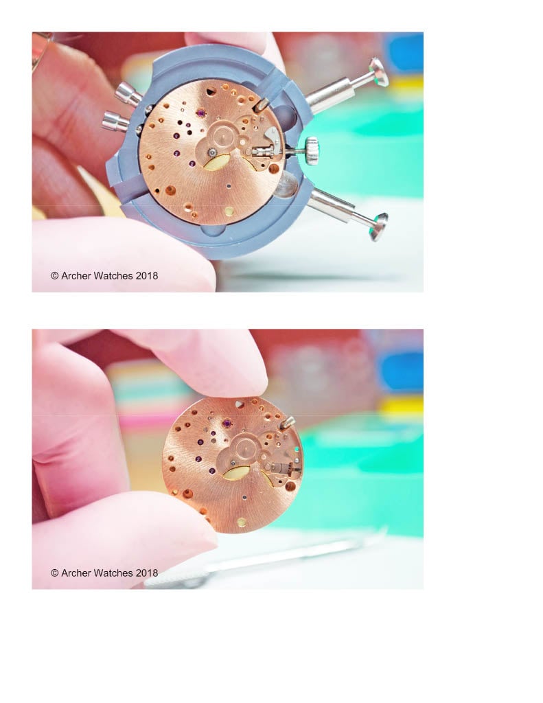

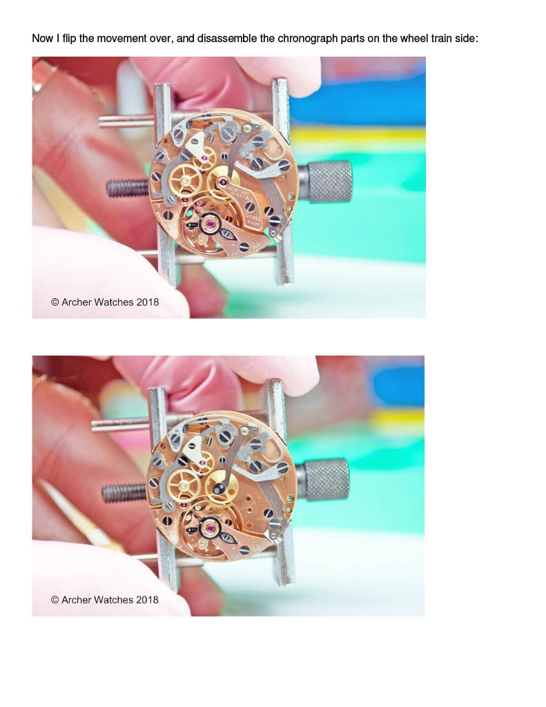

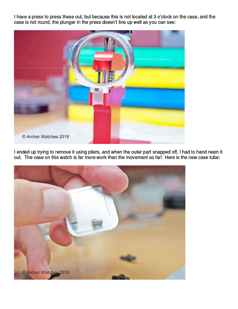

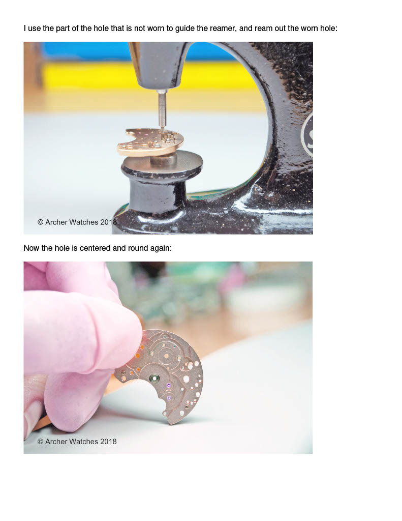

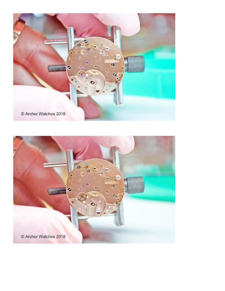

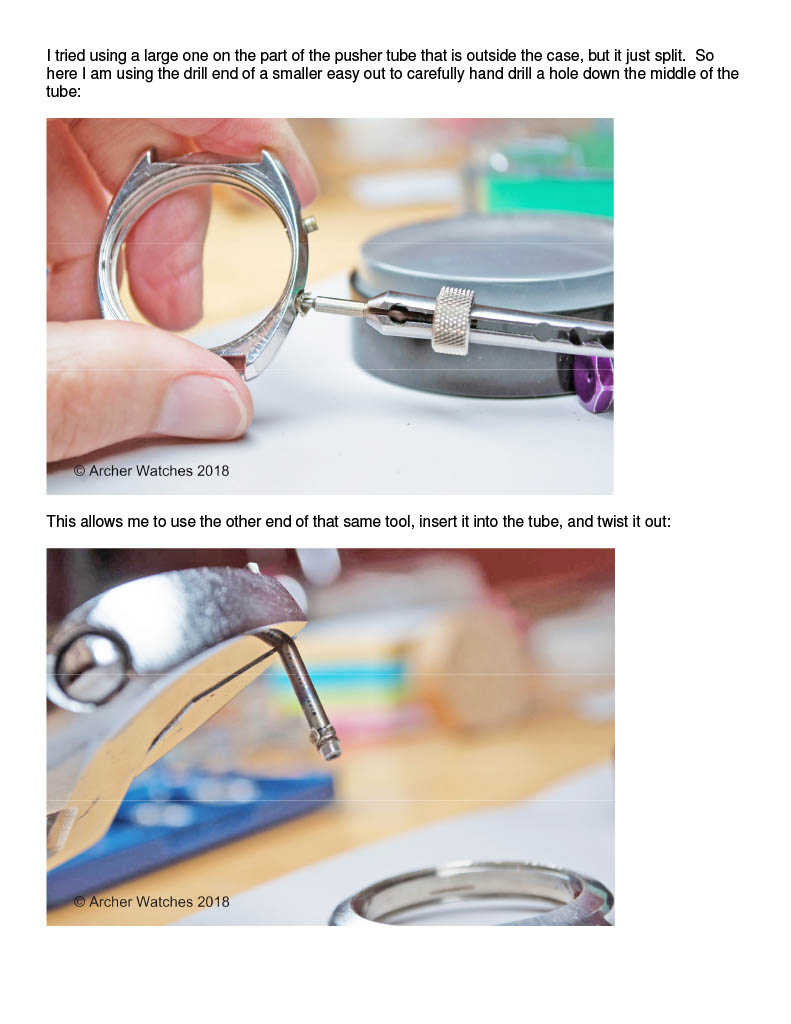

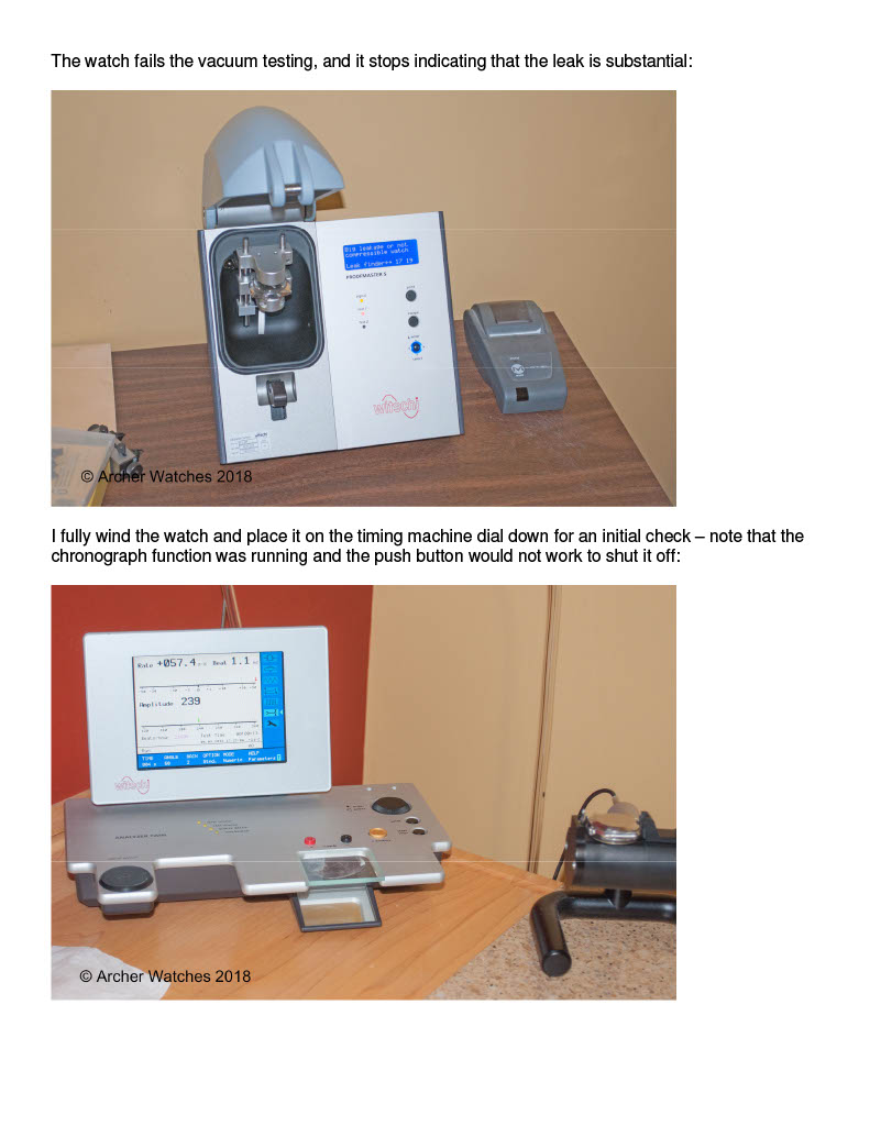

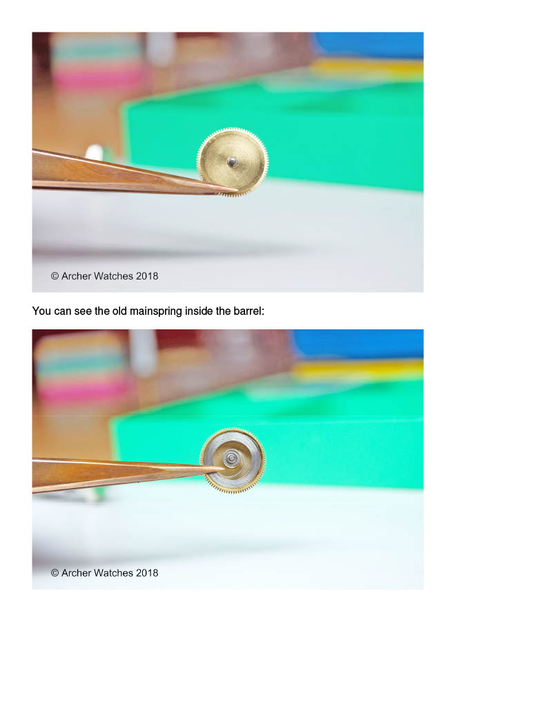

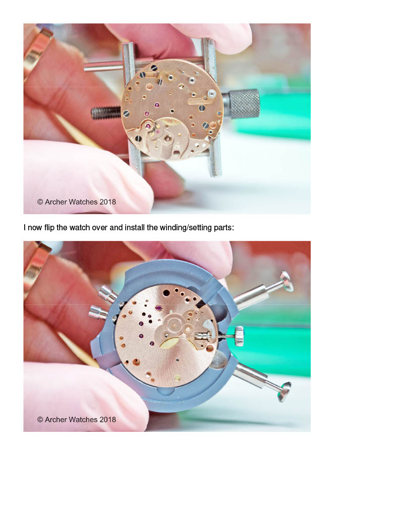

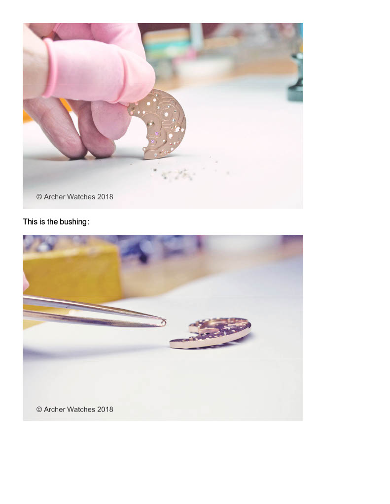

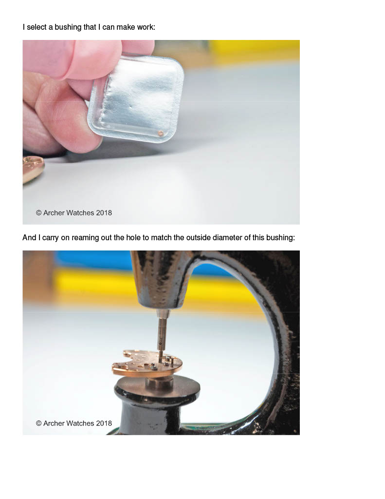

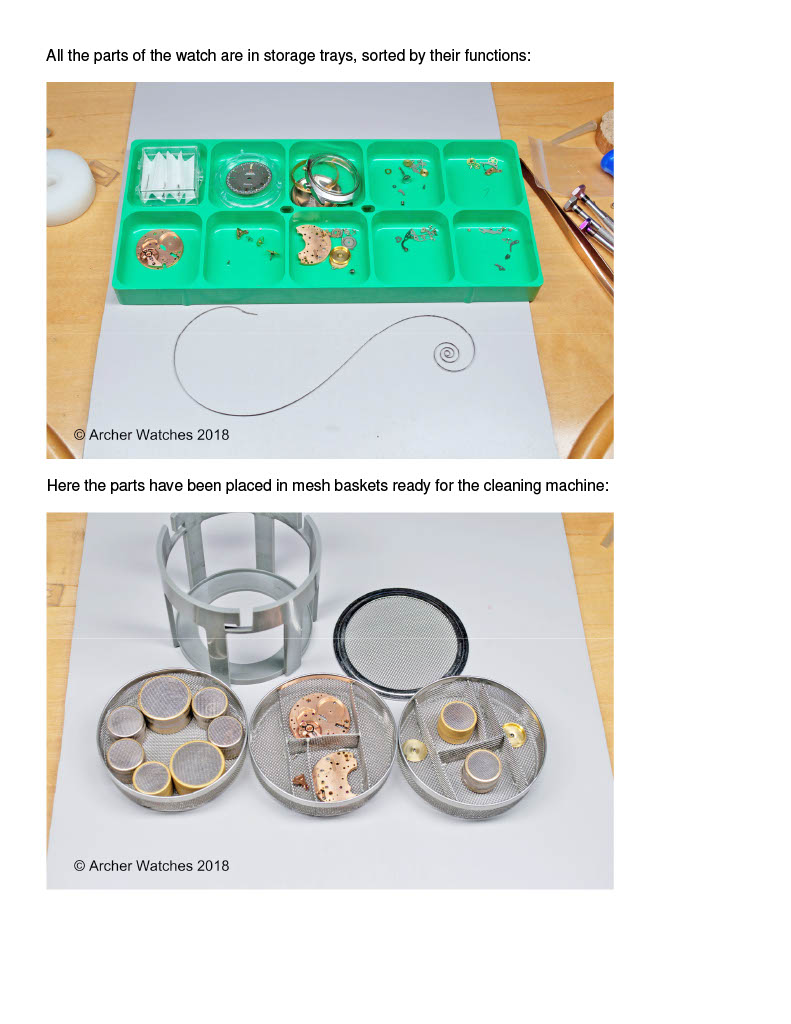

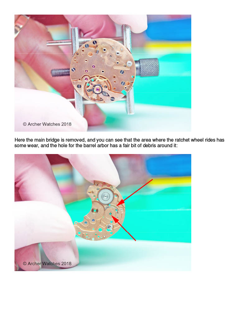

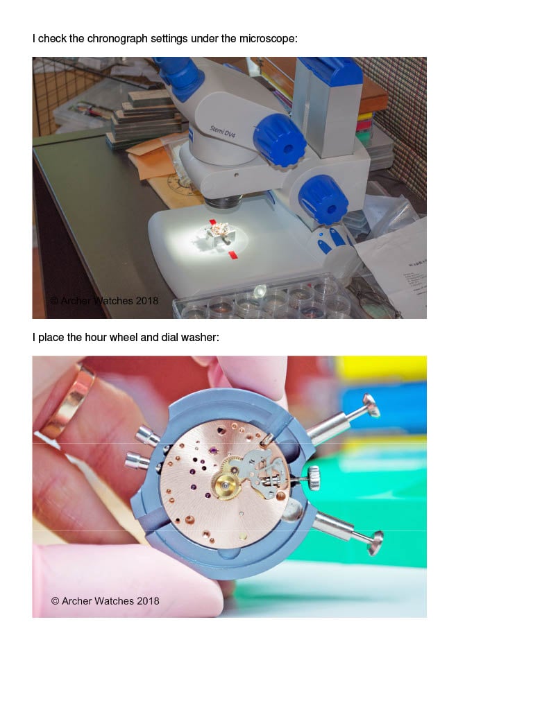

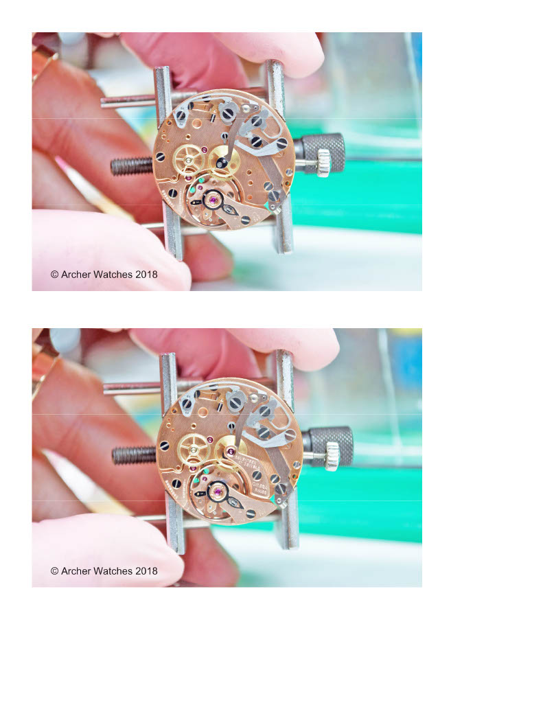

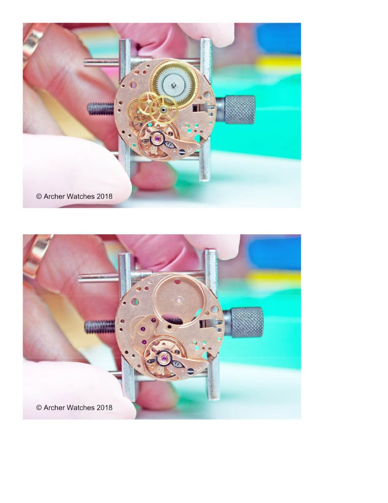

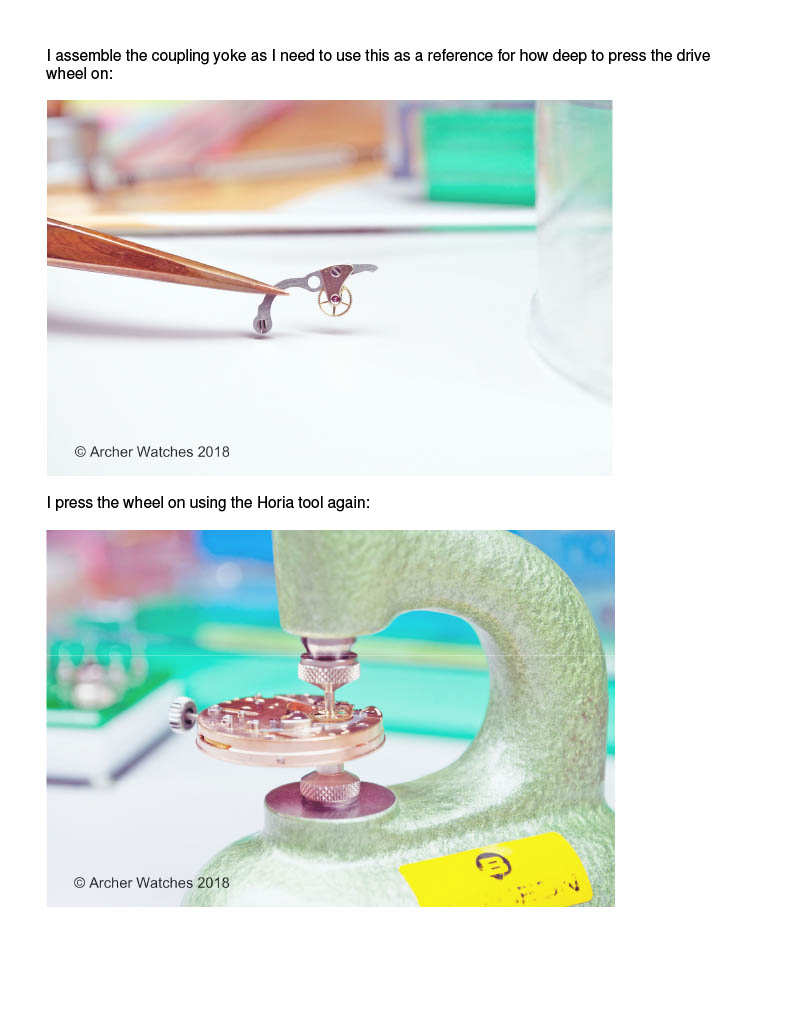

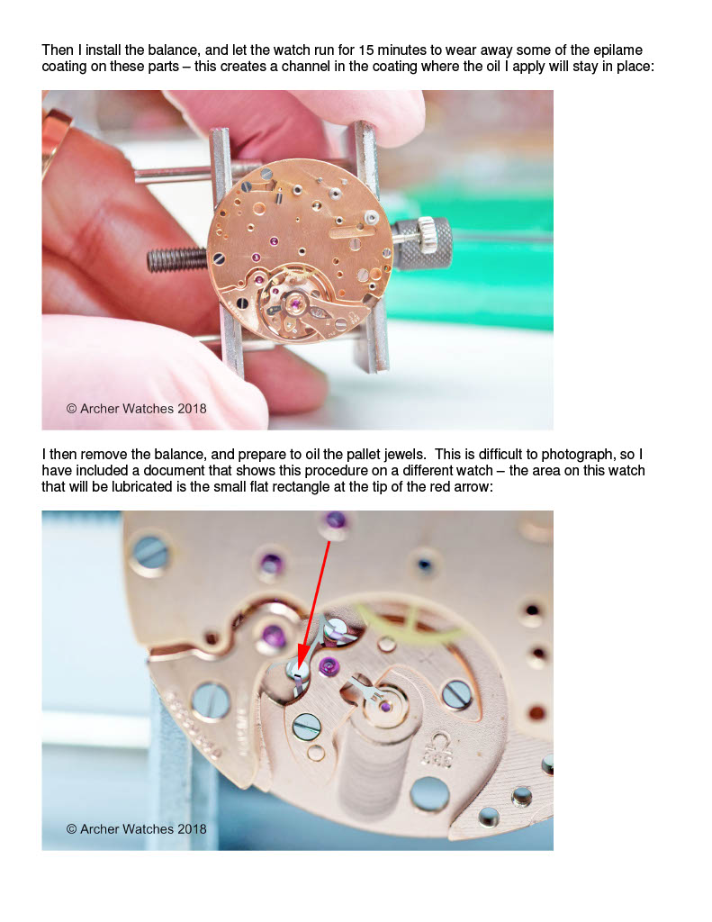

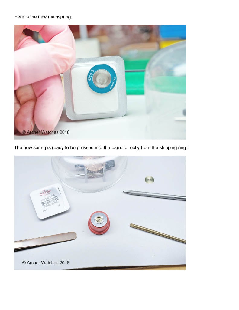

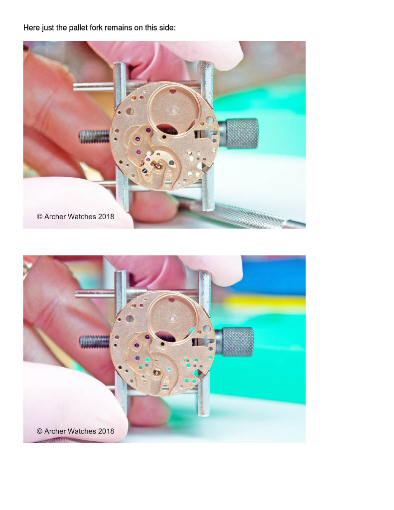

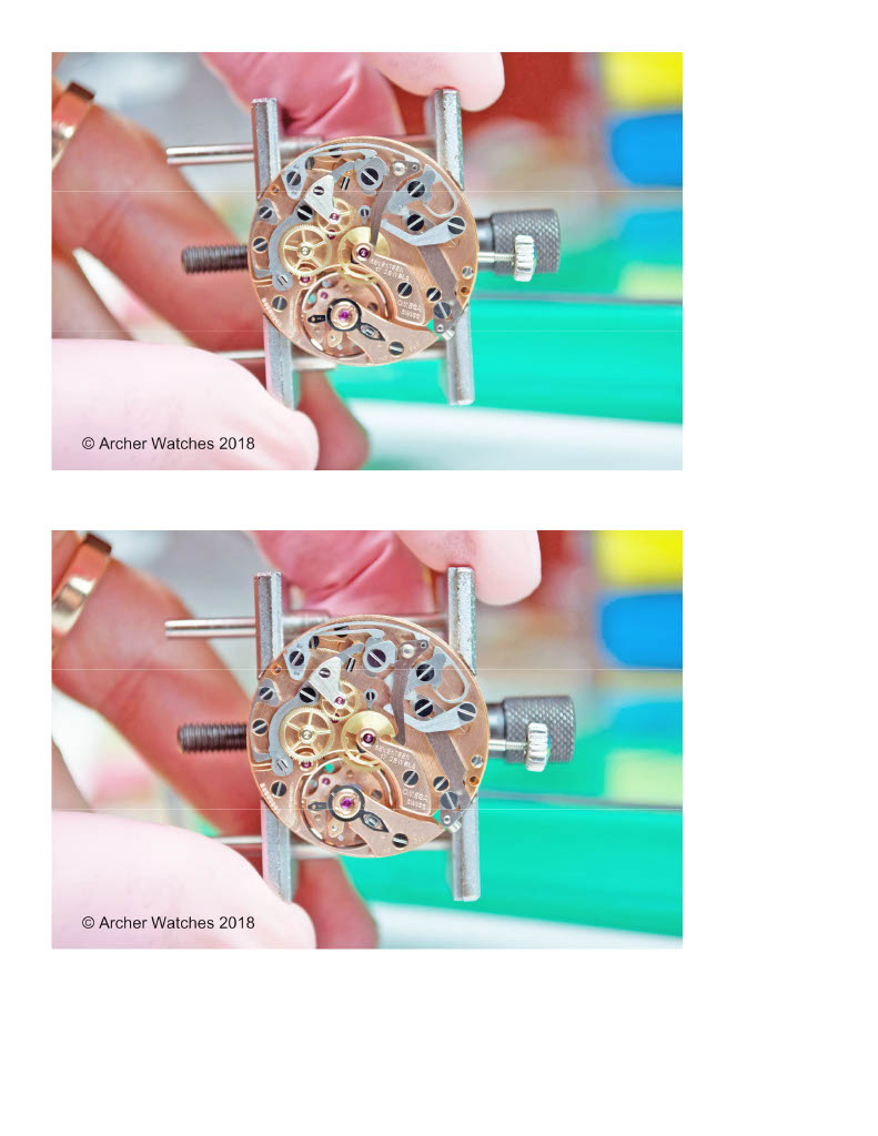

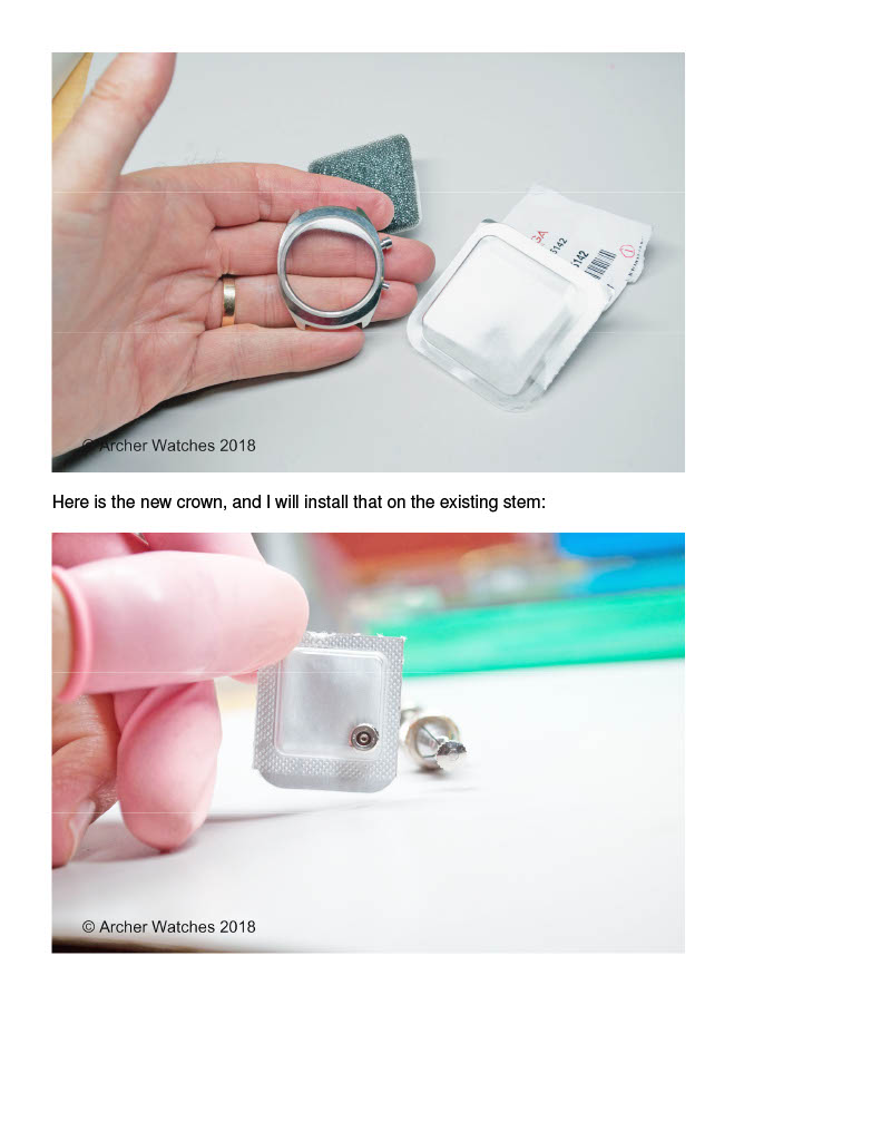

In 2018 I picked up a Chronostop that needed some repairs. Below is the service doc sent back with the watch. I've probably gotten as much enjoyment looking over the PDF as I have wearing the watch, and I love the watch 馃榾
Hopefully others enjoy seeing what went into getting this watch running properly again.

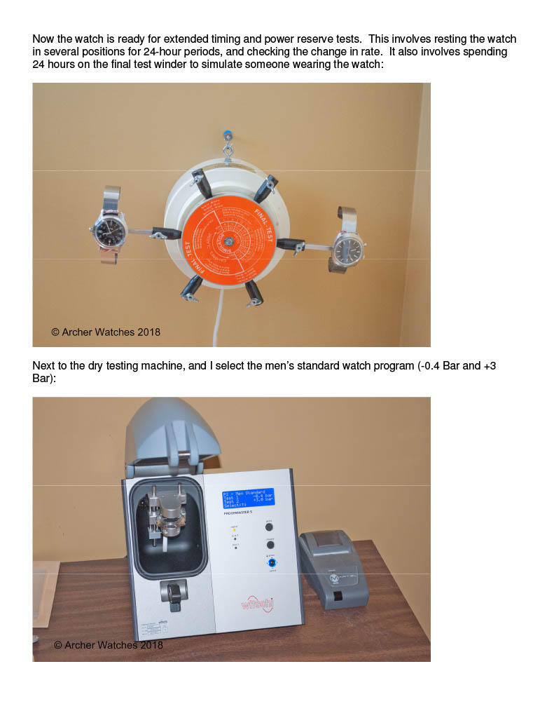

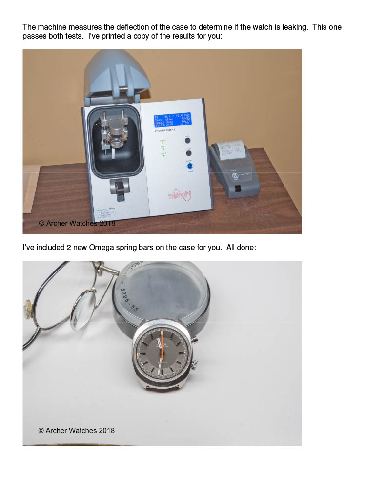

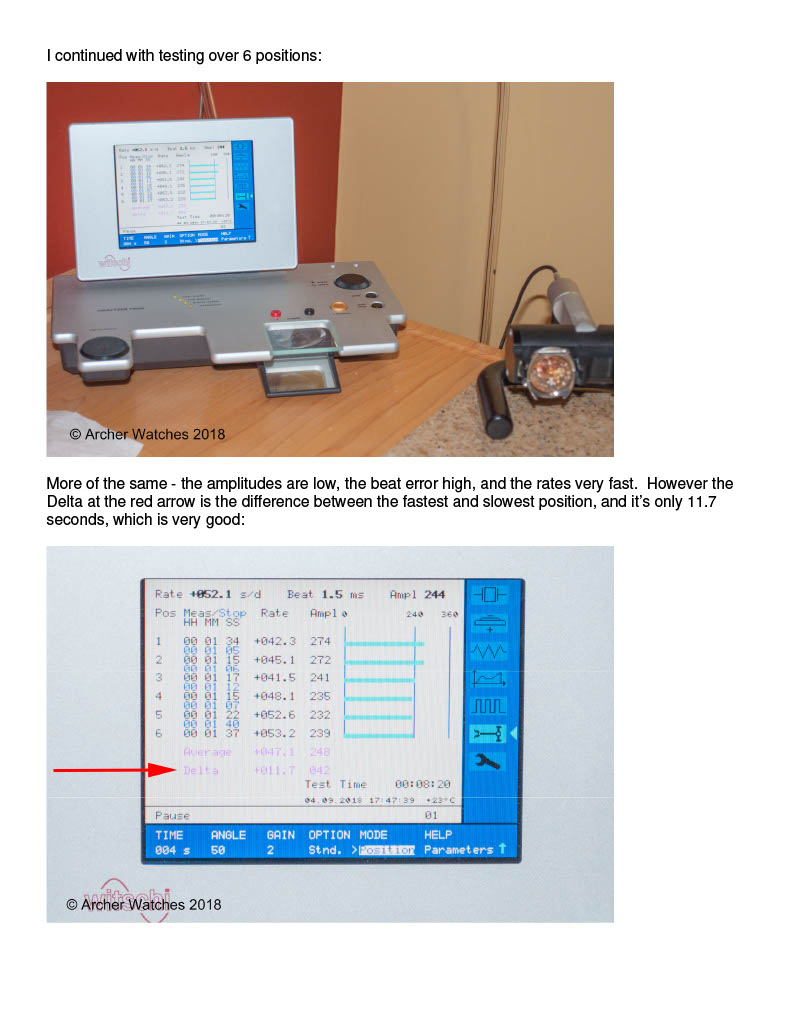

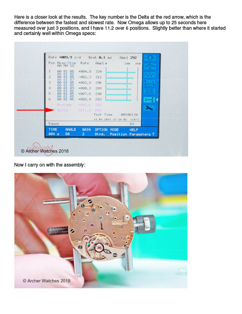

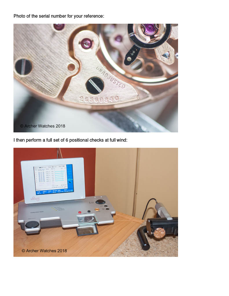

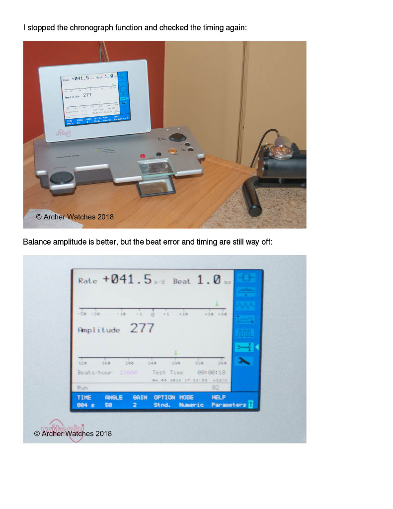

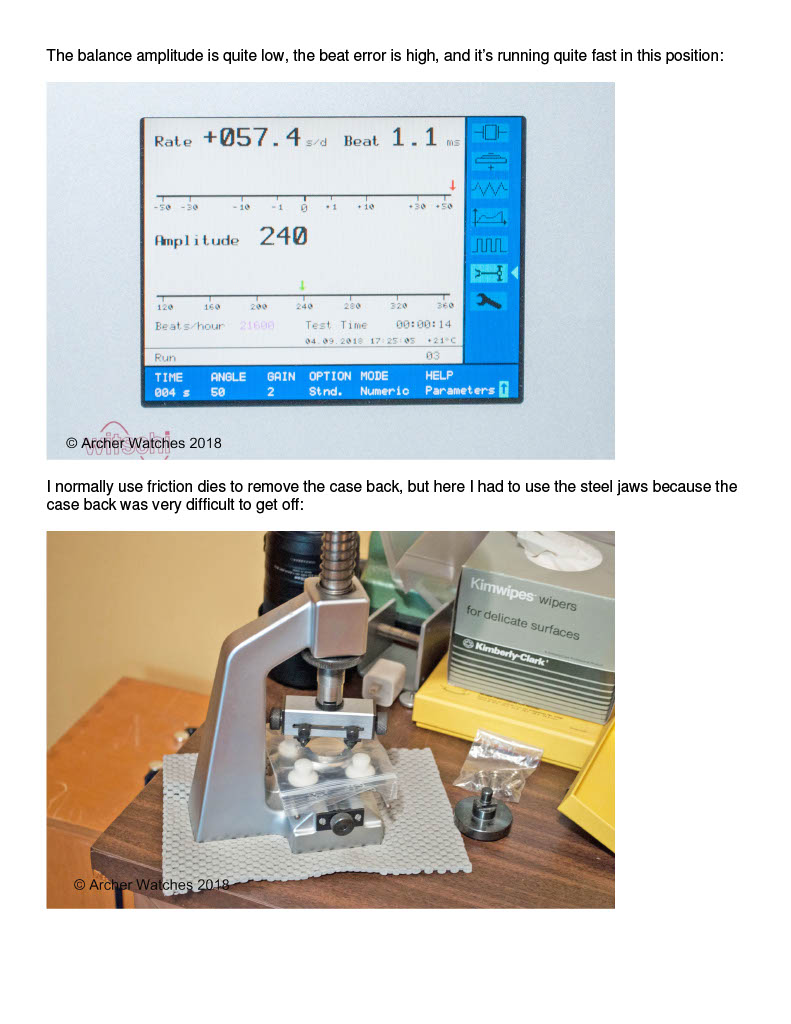

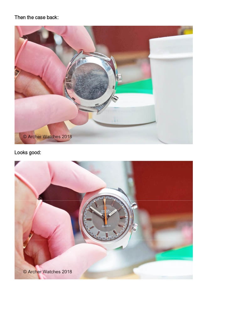

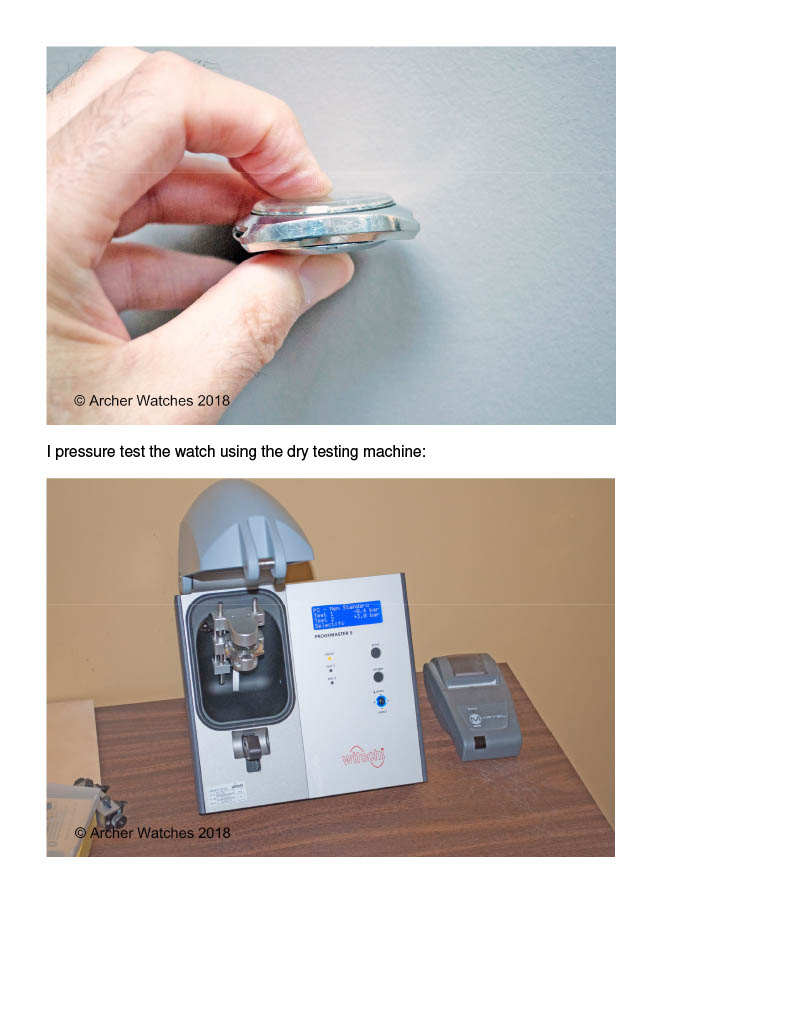

This watch does not have a seconds hand, but using the minute hand and checking the timing as
best I could, it appears to be running well within specs. I measured the average daily rate to be about
1.5 seconds fast. There is a small amount of positional variation, so the fastest position is crown up,
and the slowest is dial up - you can use these positions for storage overnight to help adjust for small
gains or losses during the day.
The watch did pass both of the pressure tests, however water resistance is not a permanent feature
and must be maintained, and that includes regular pressure testing to ensure that water resistance is
maintained as well as replacing gaskets.
