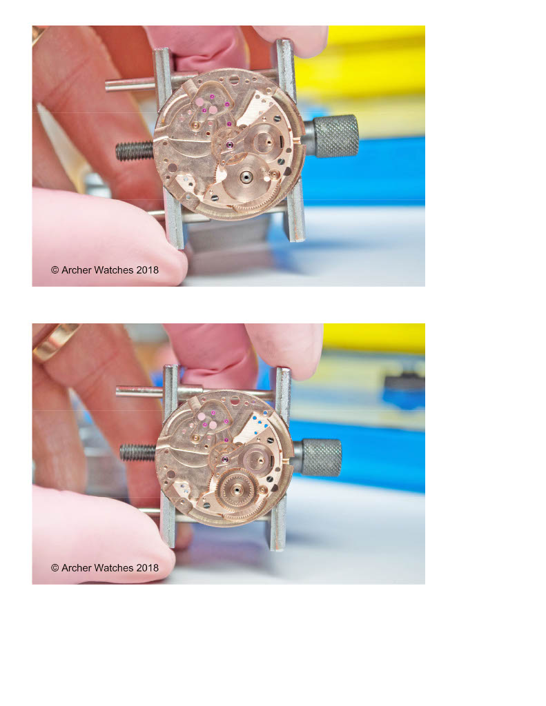

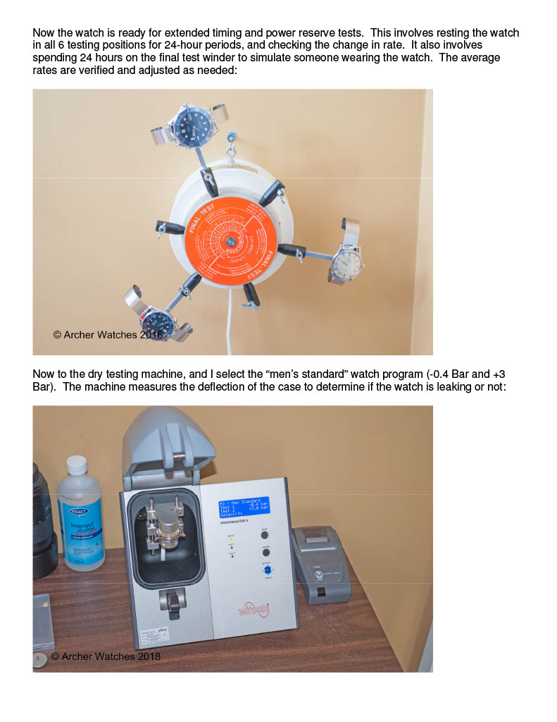

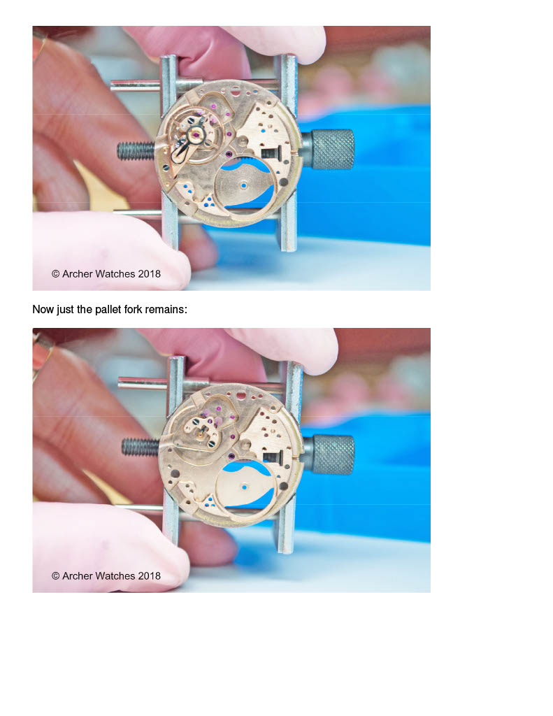

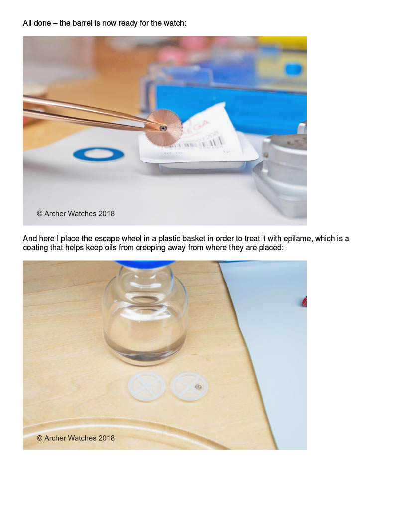

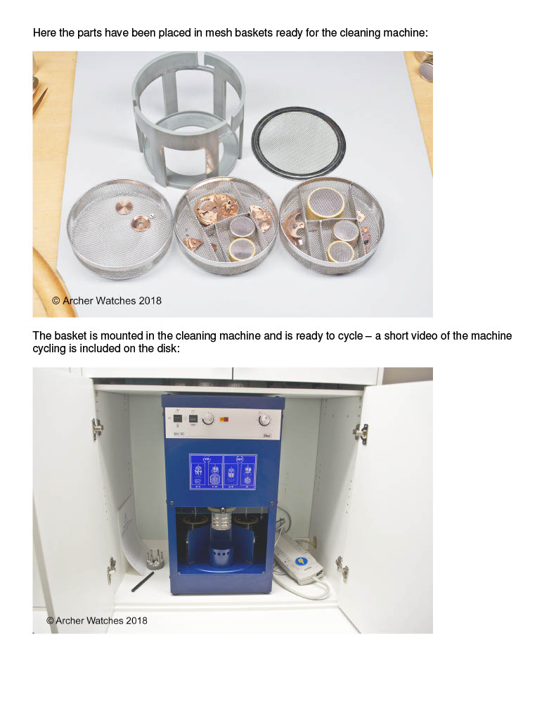

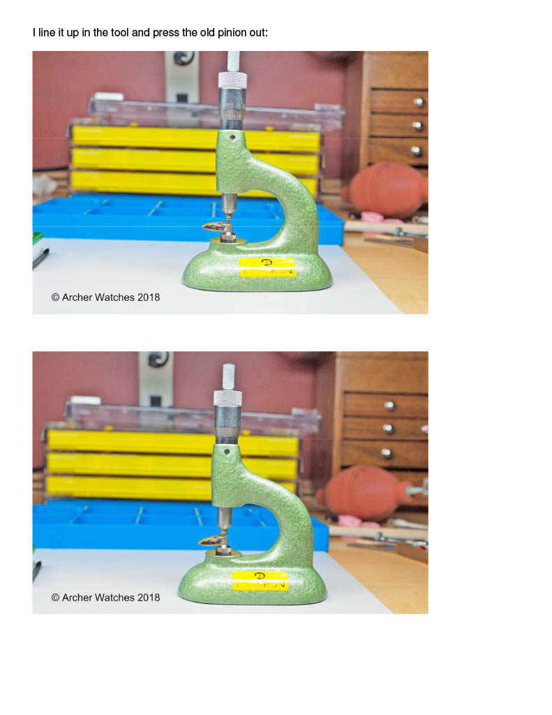

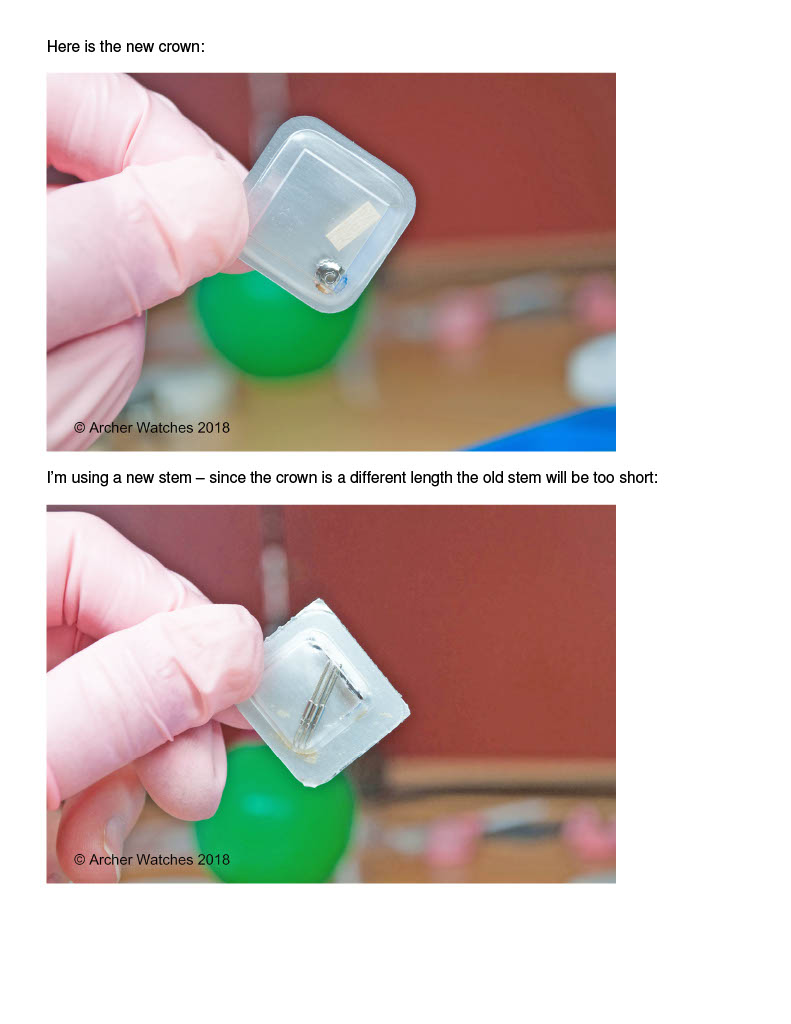

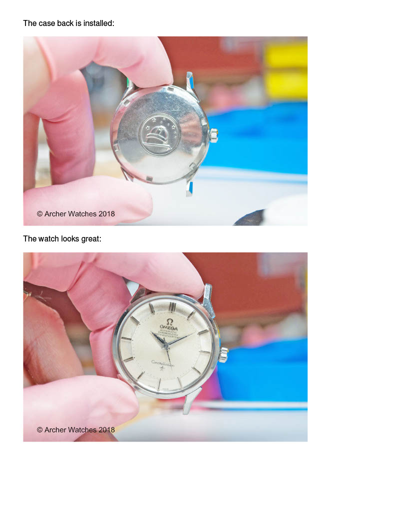

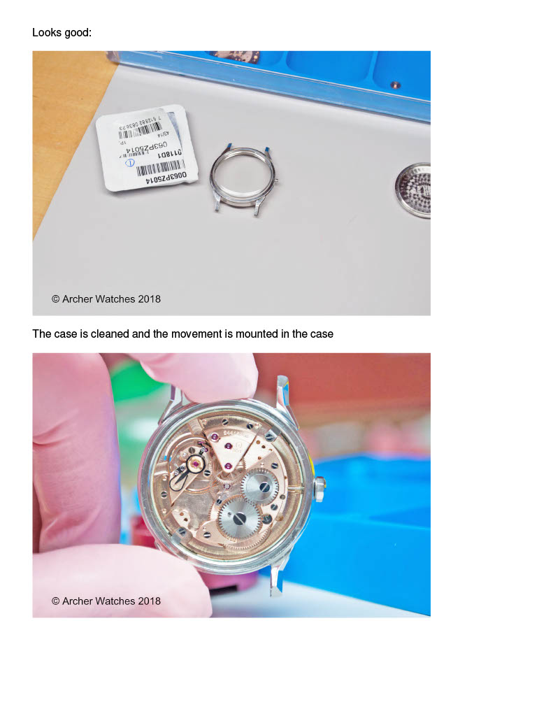

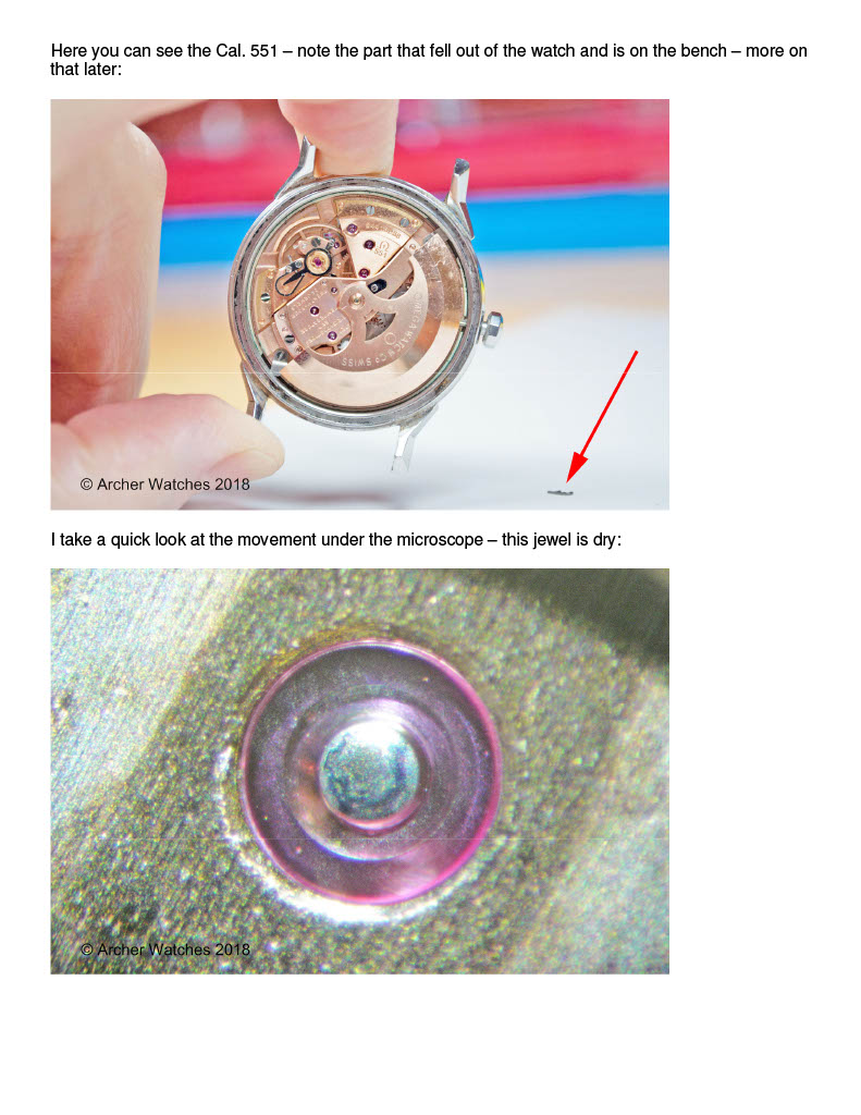

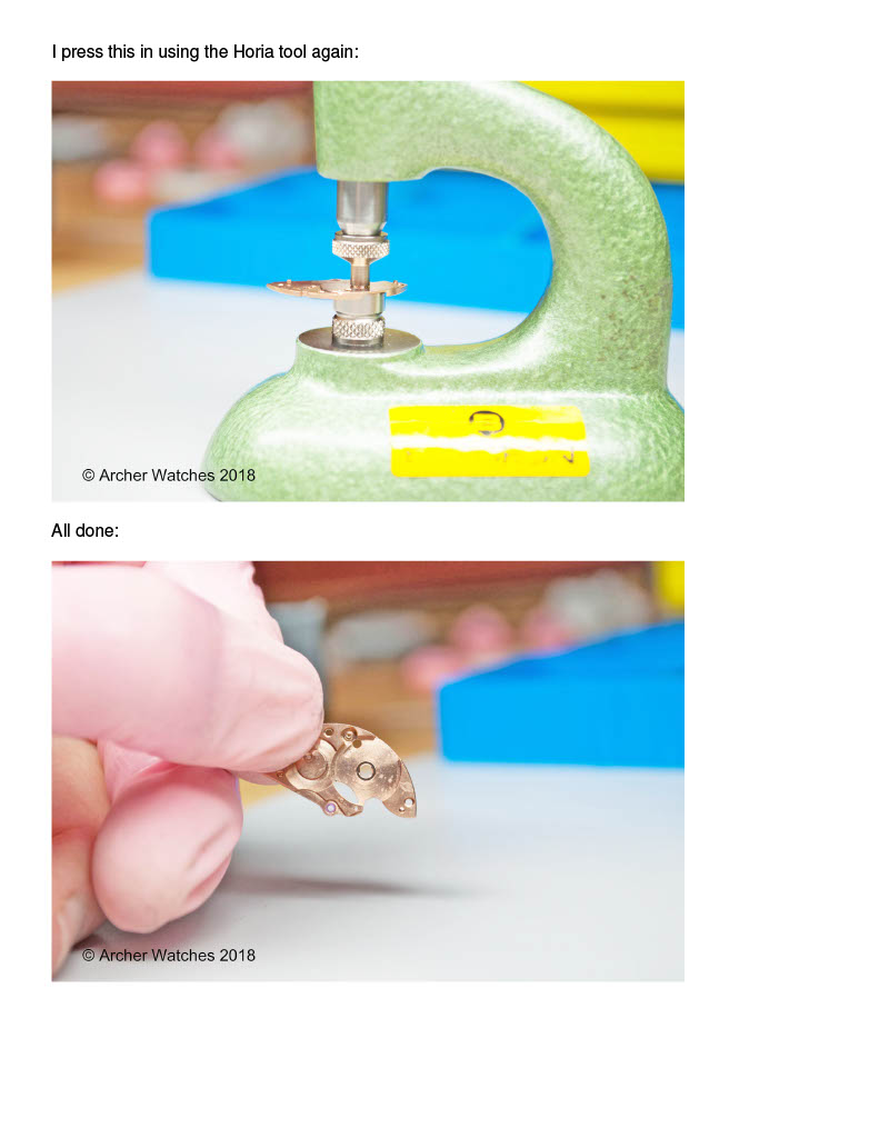

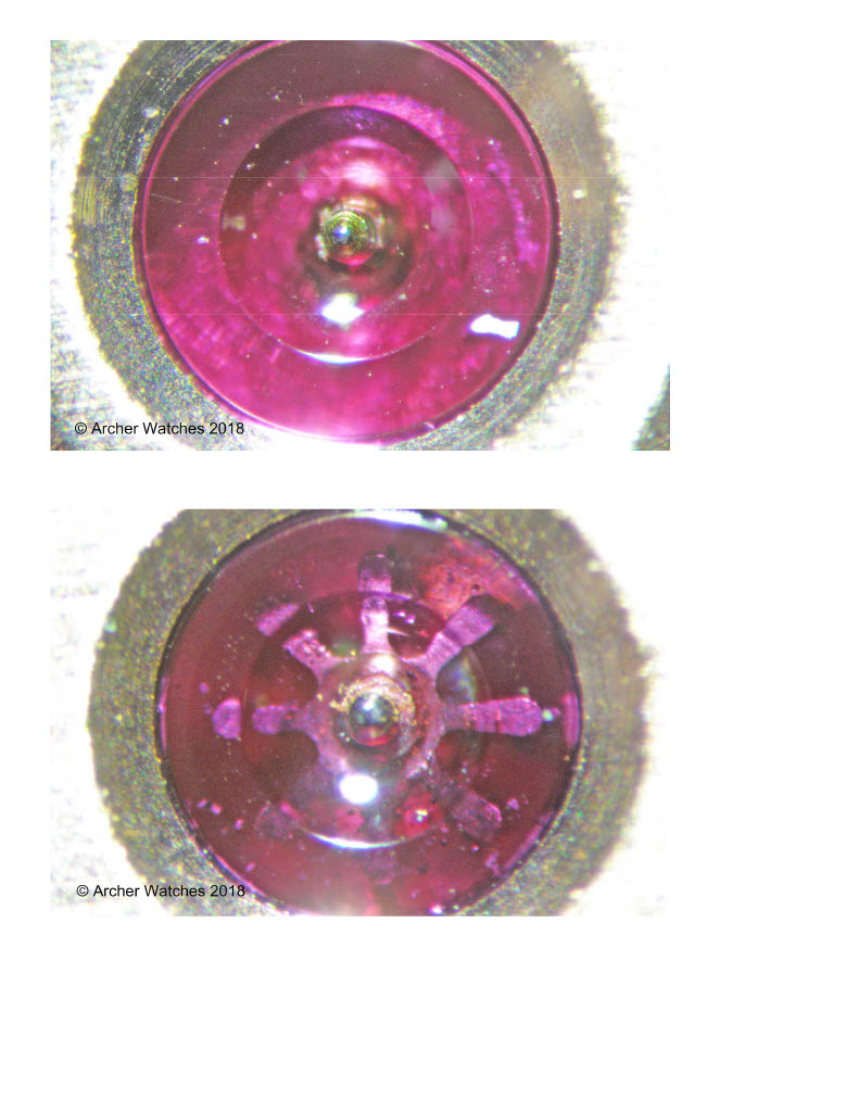

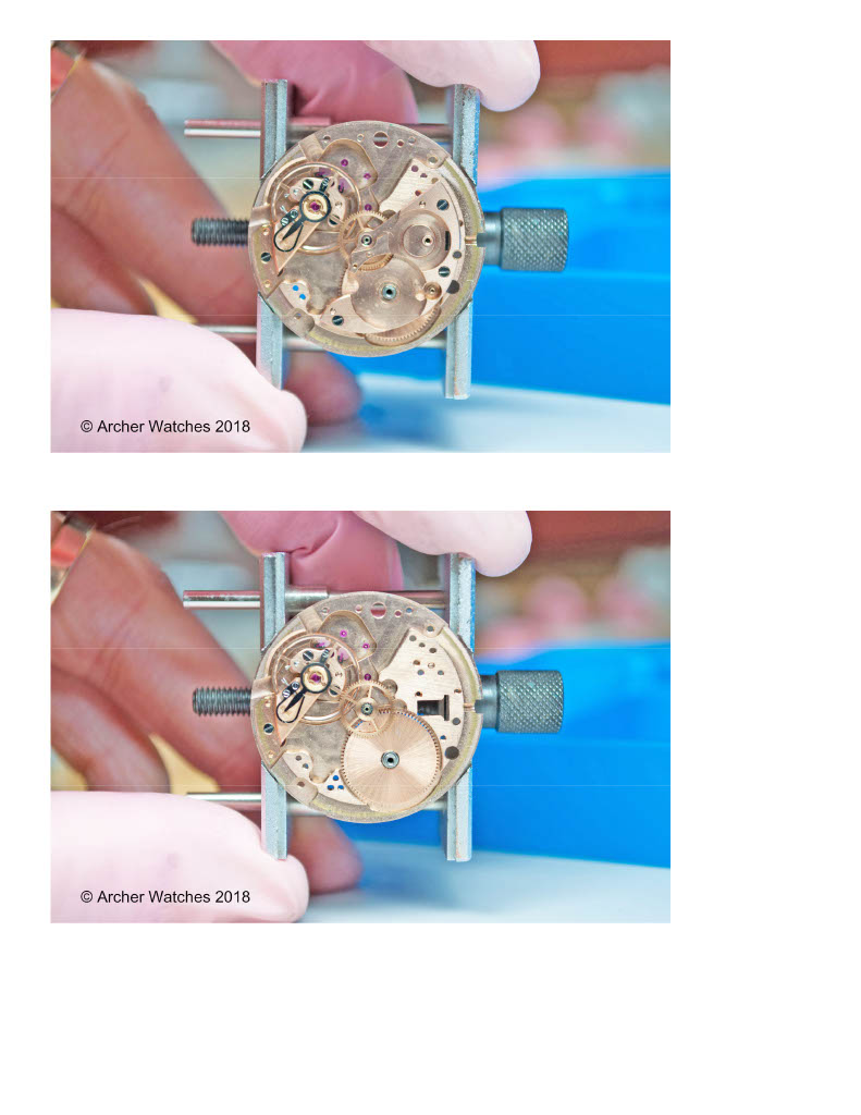

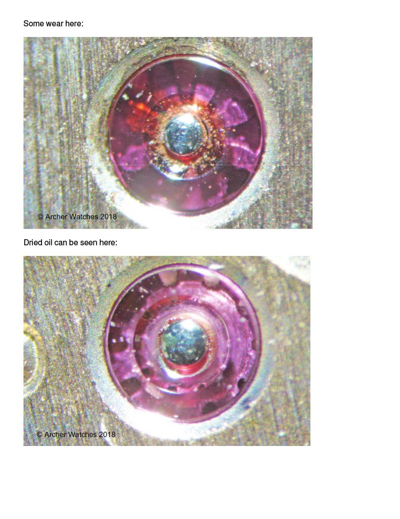

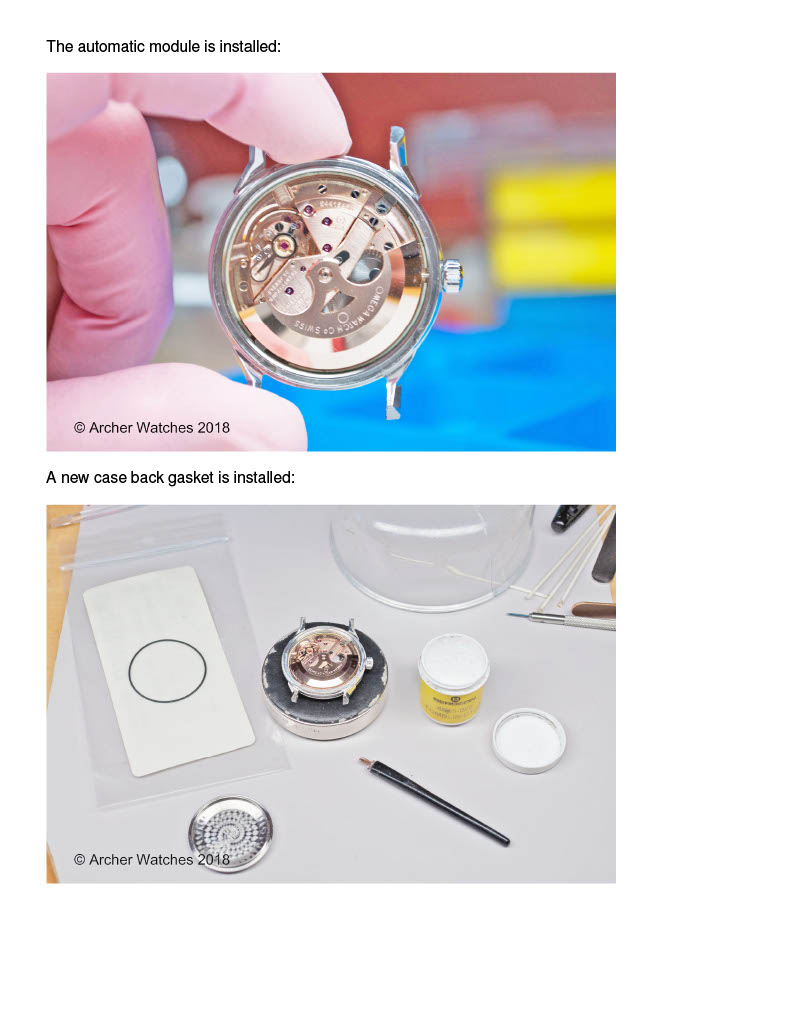

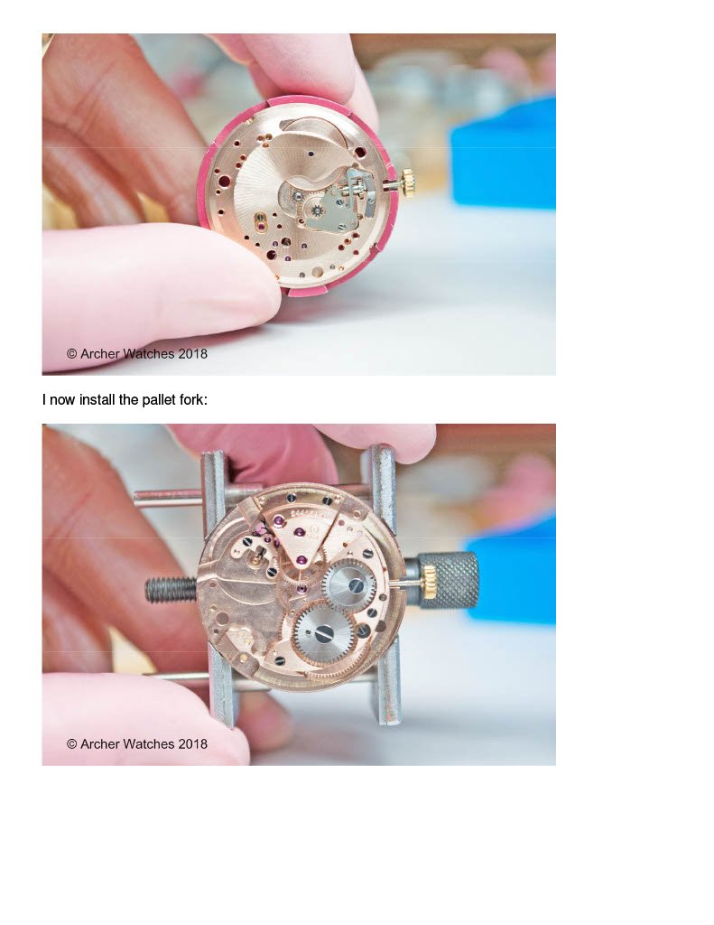

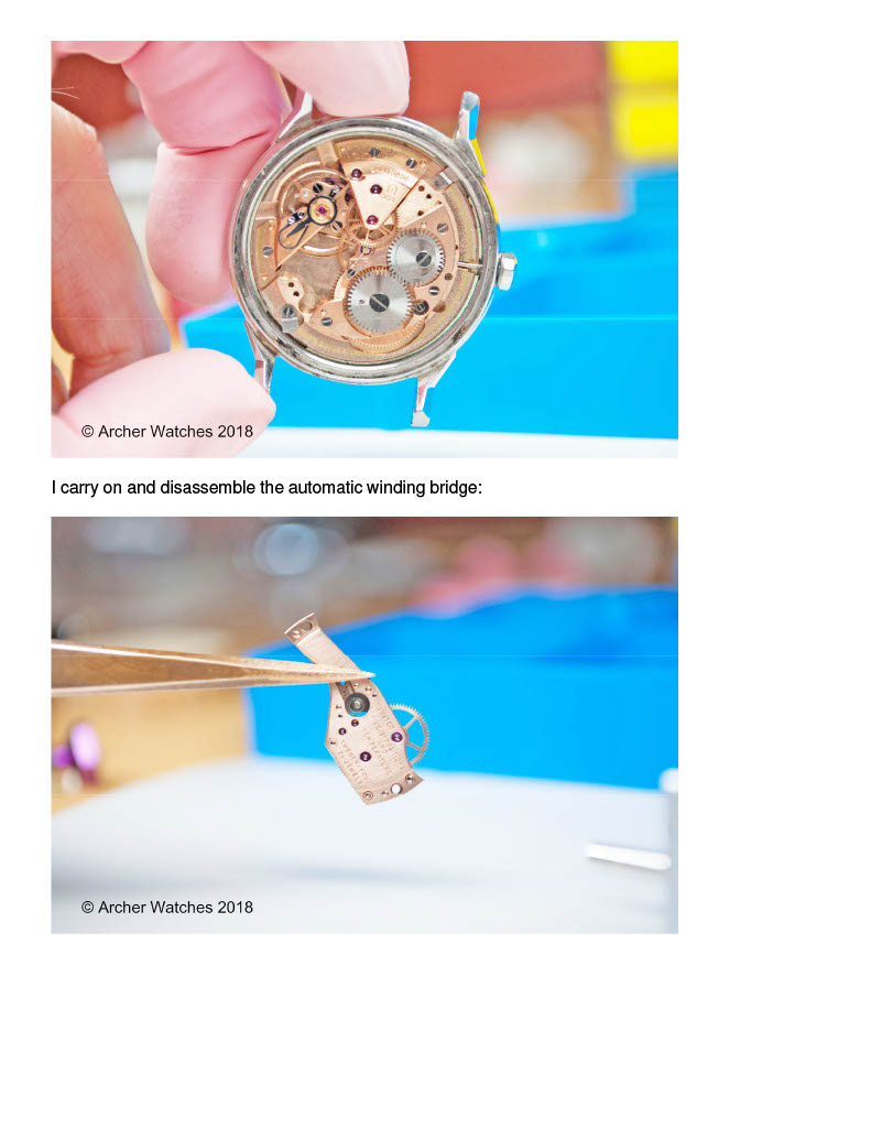

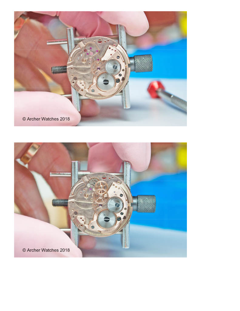

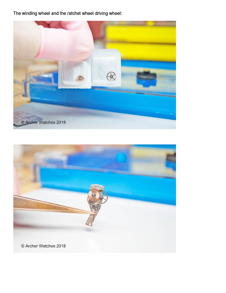

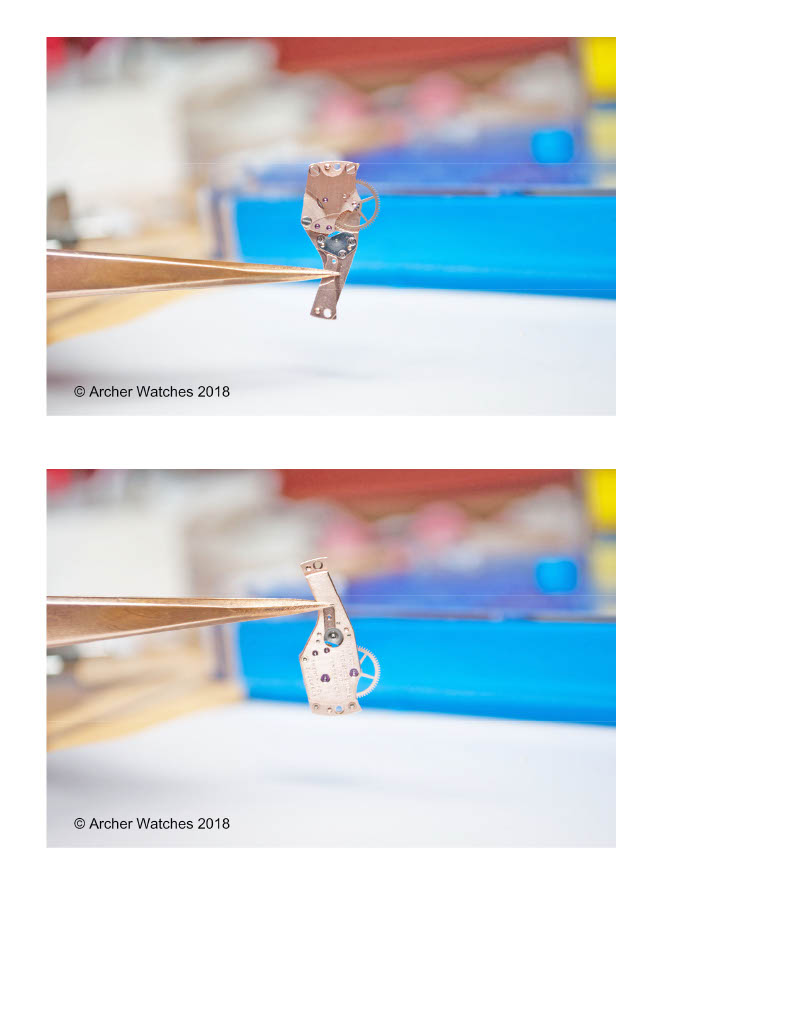

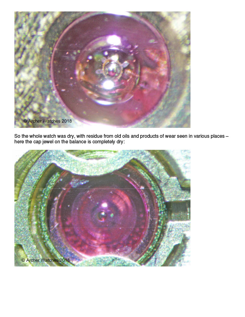

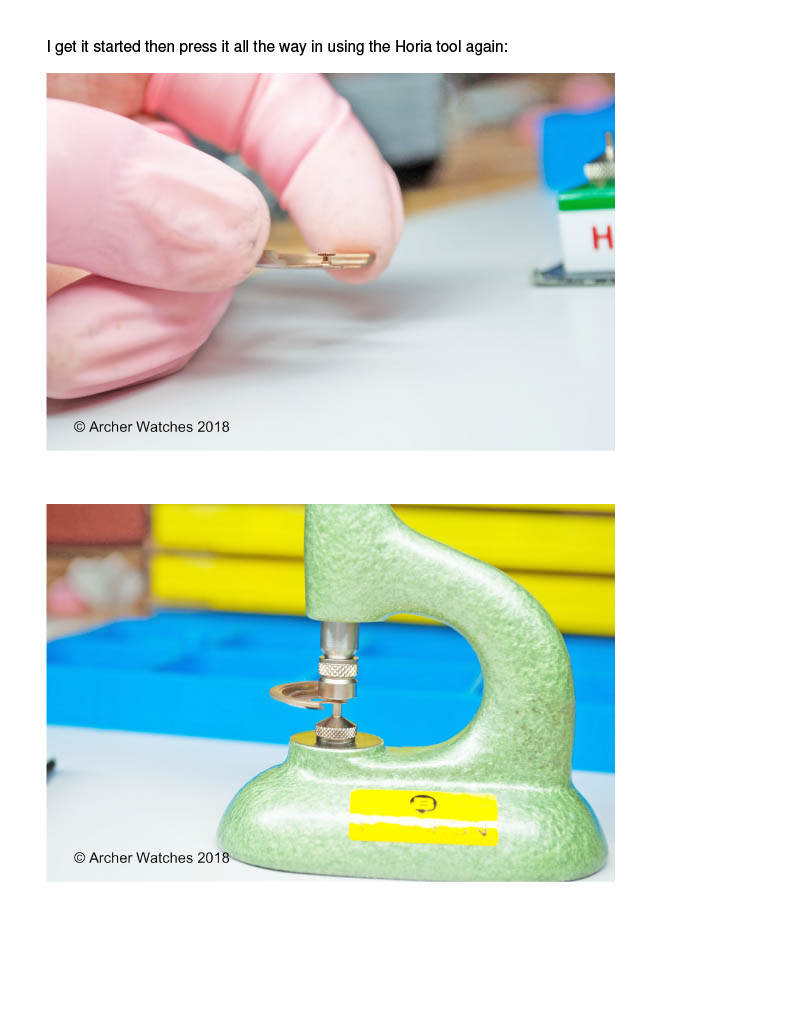

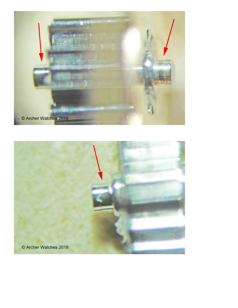

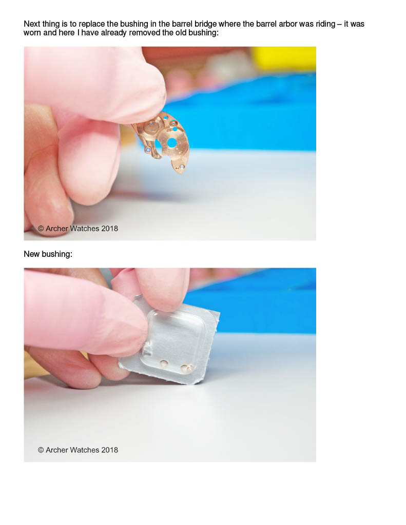

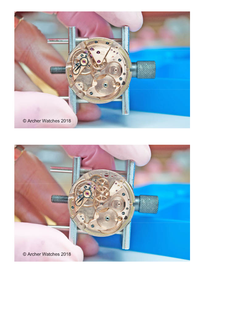

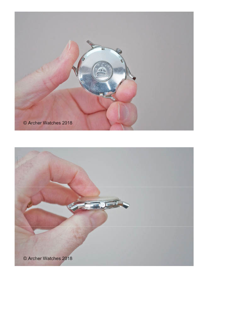

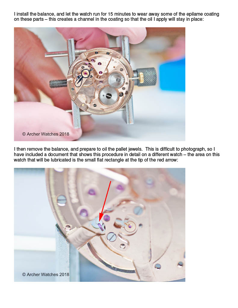

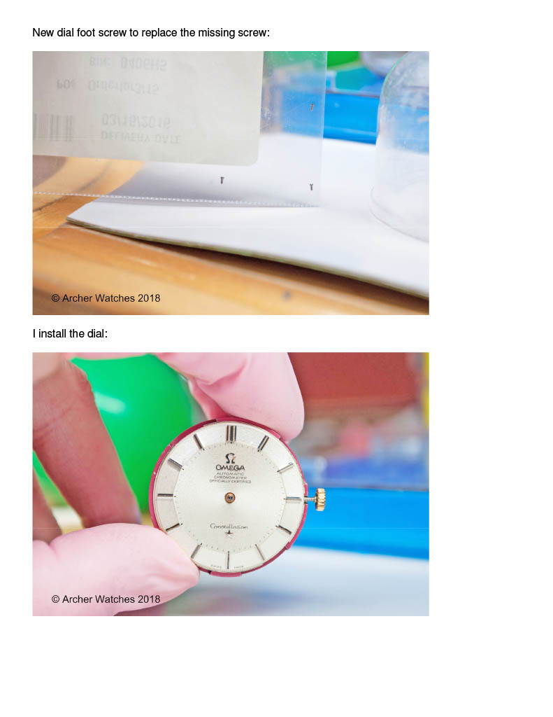

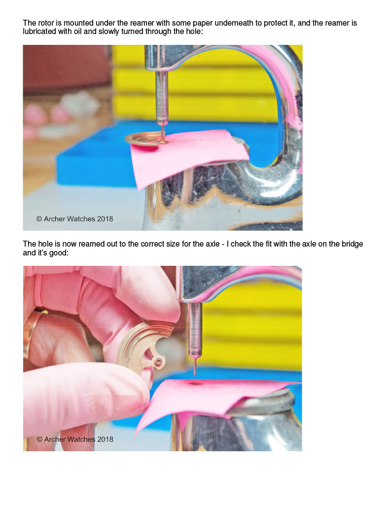

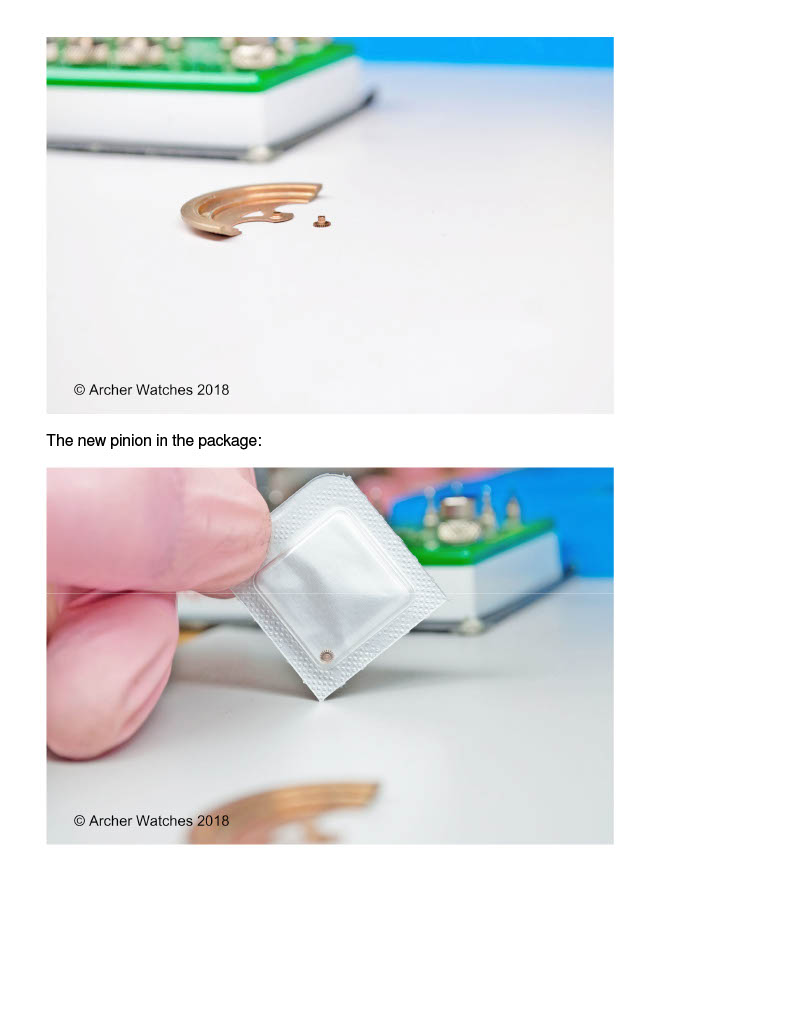

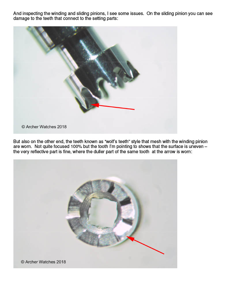

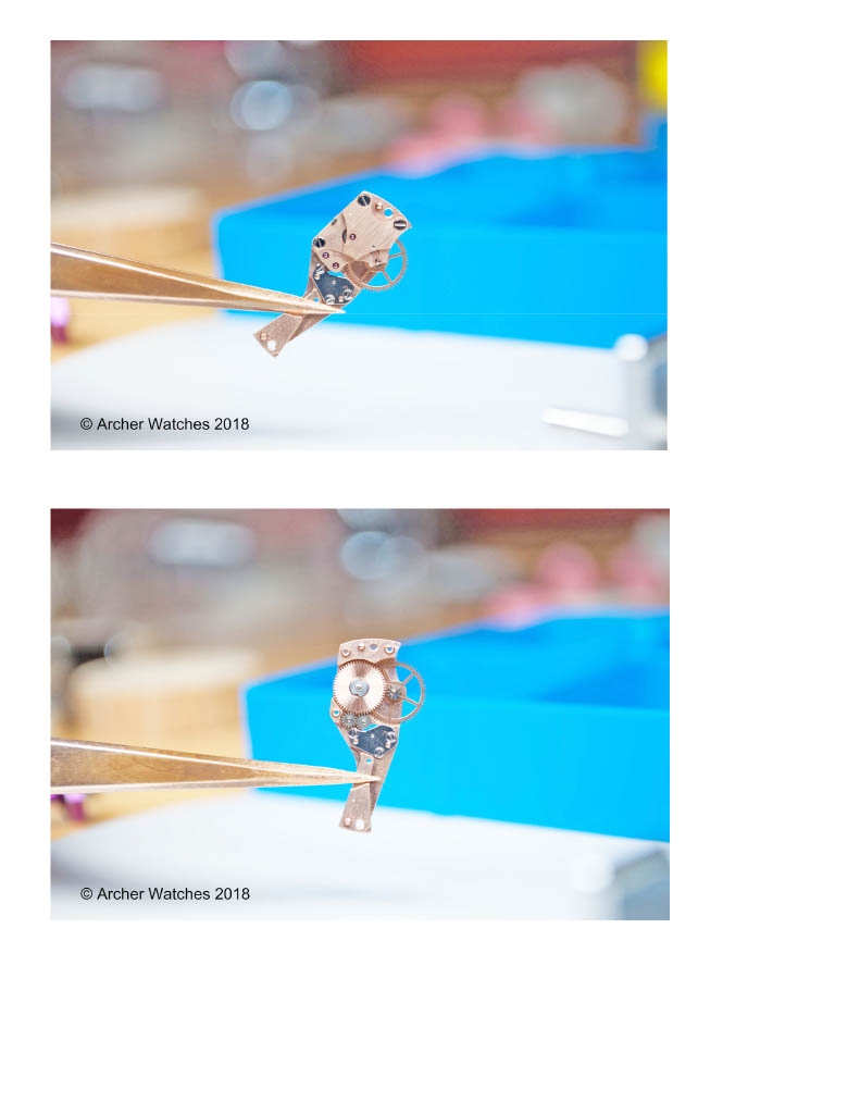

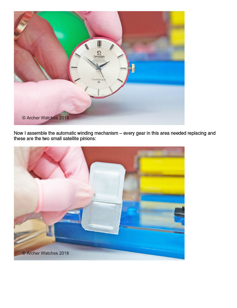

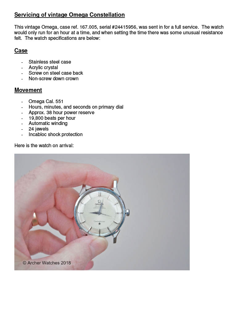

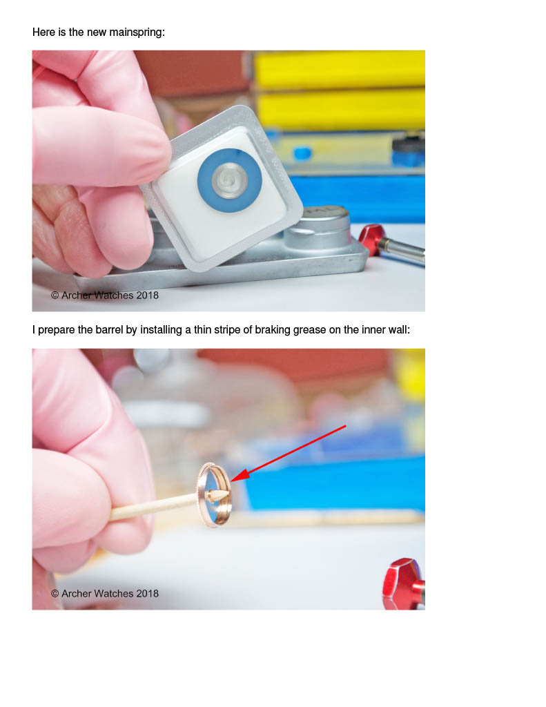

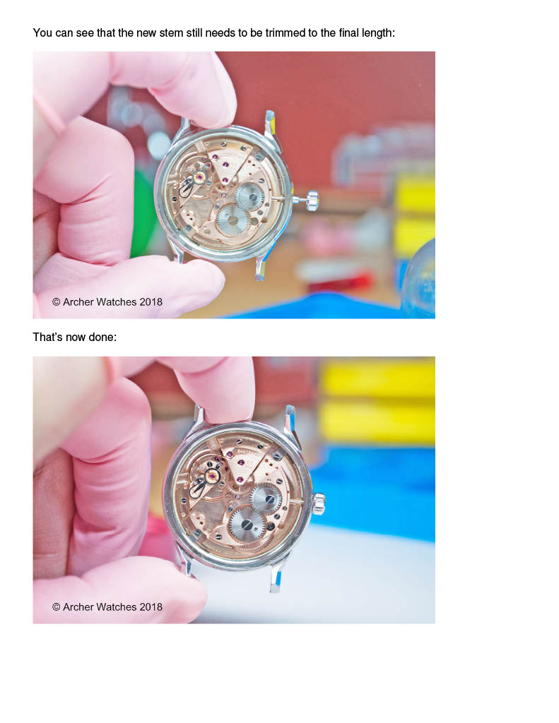

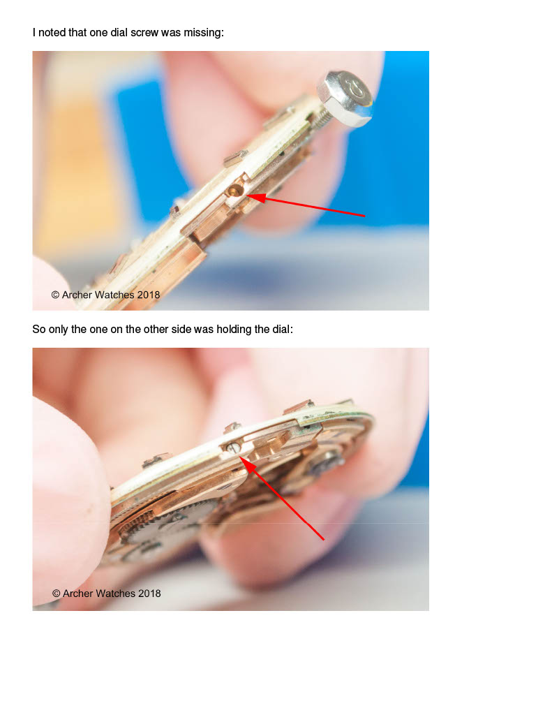

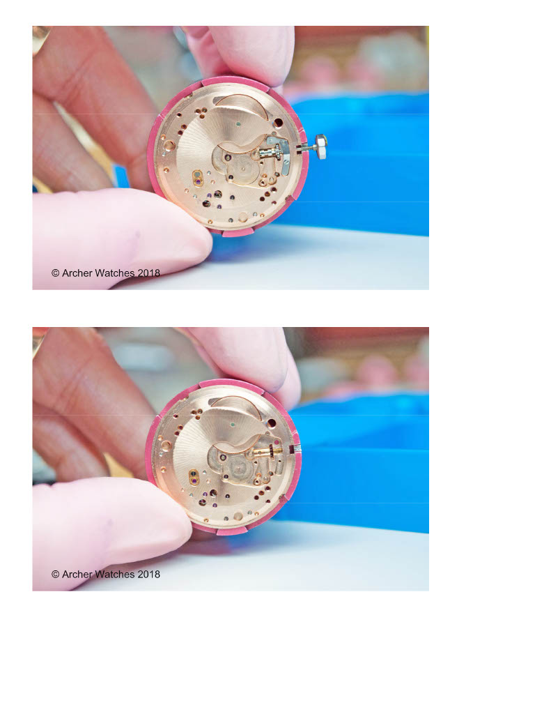

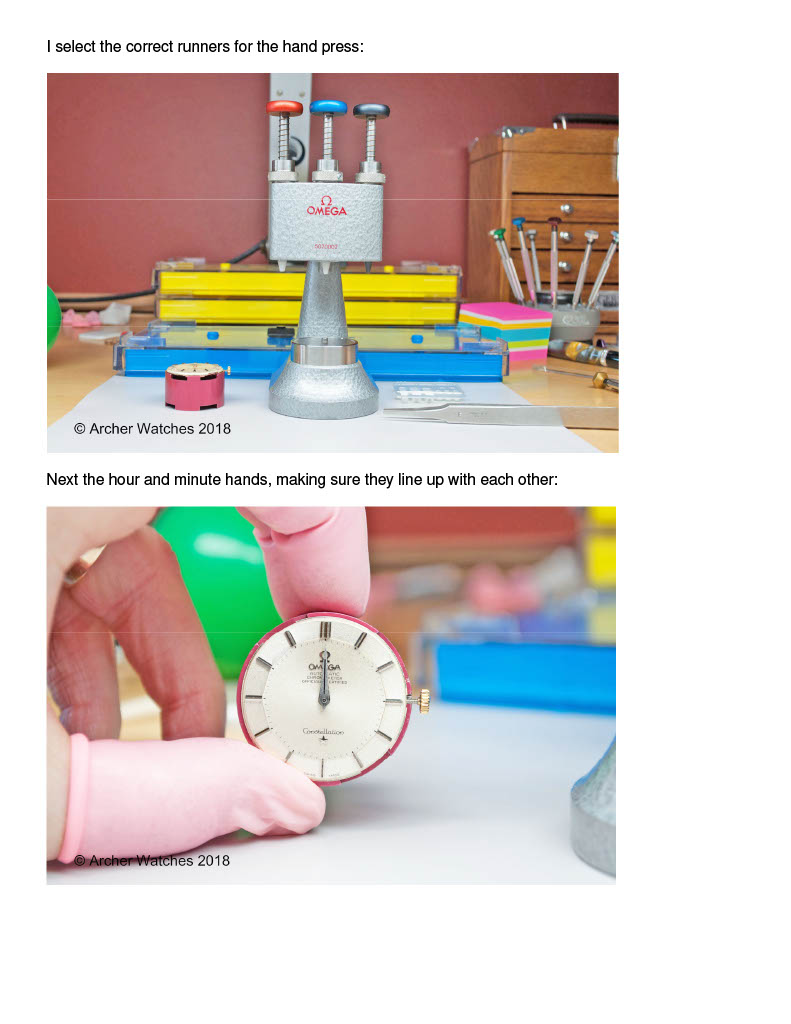

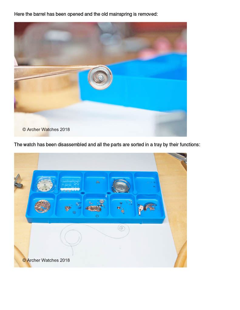

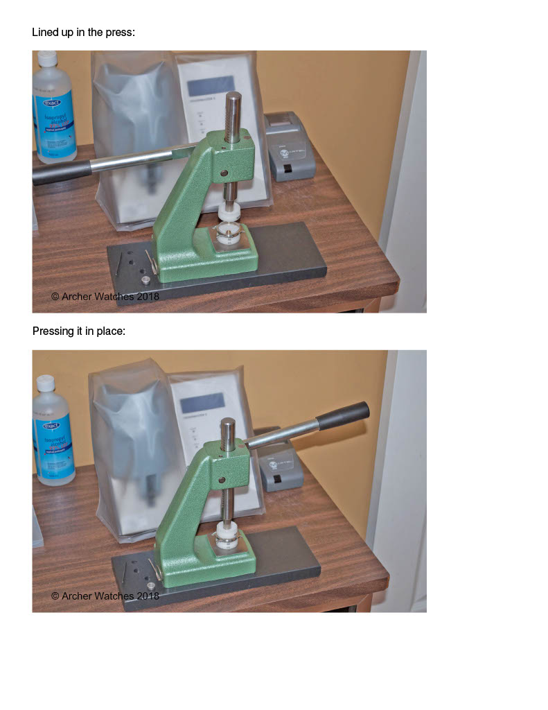

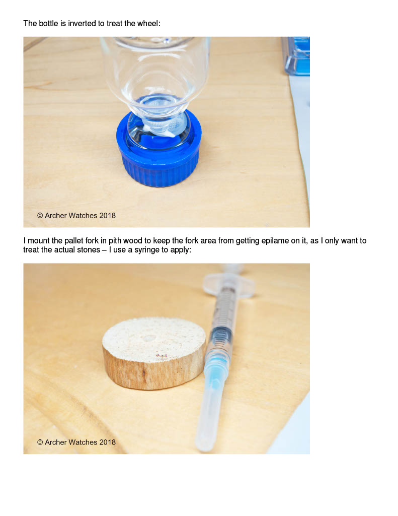

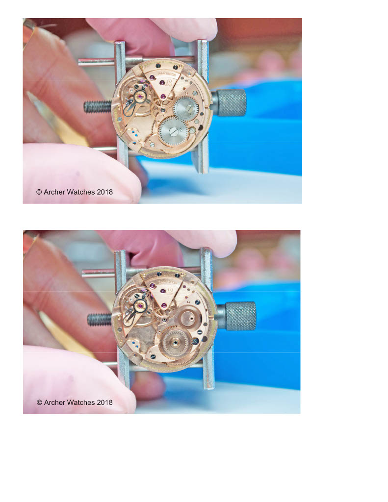

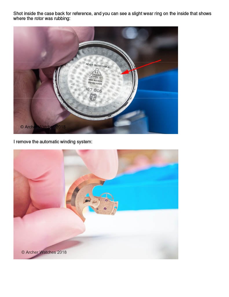

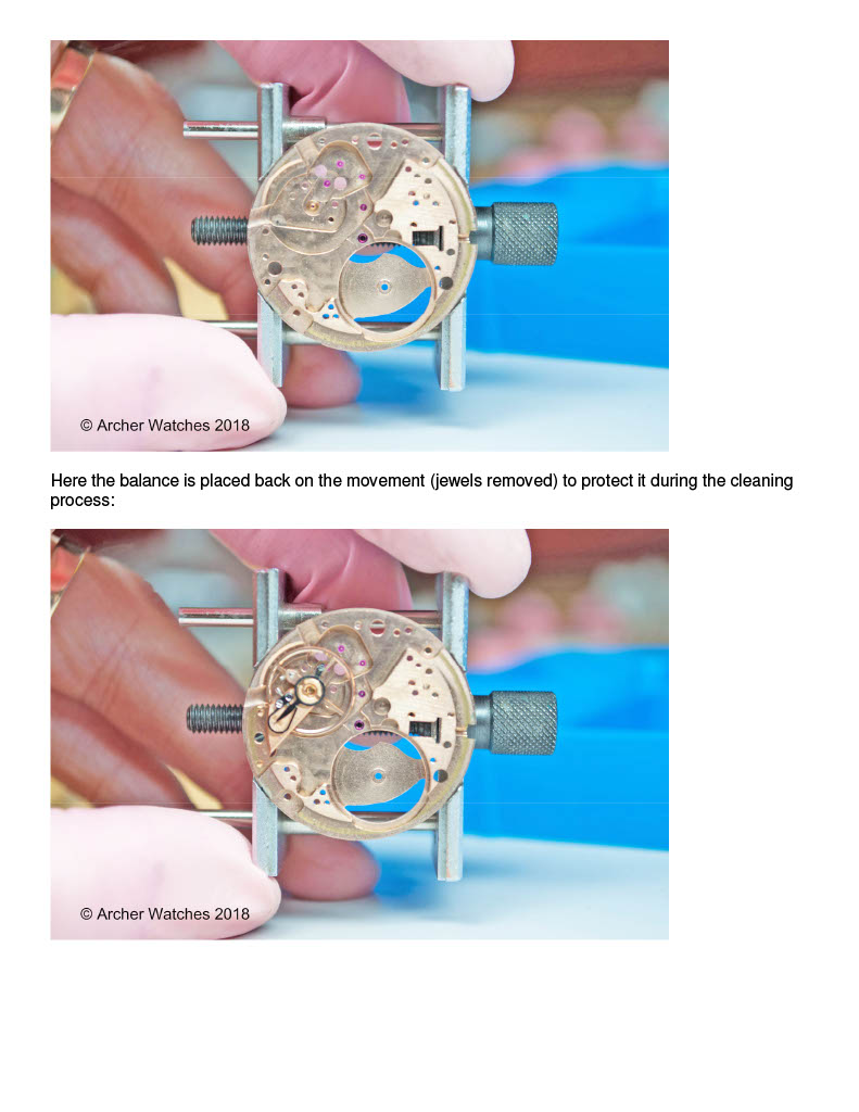

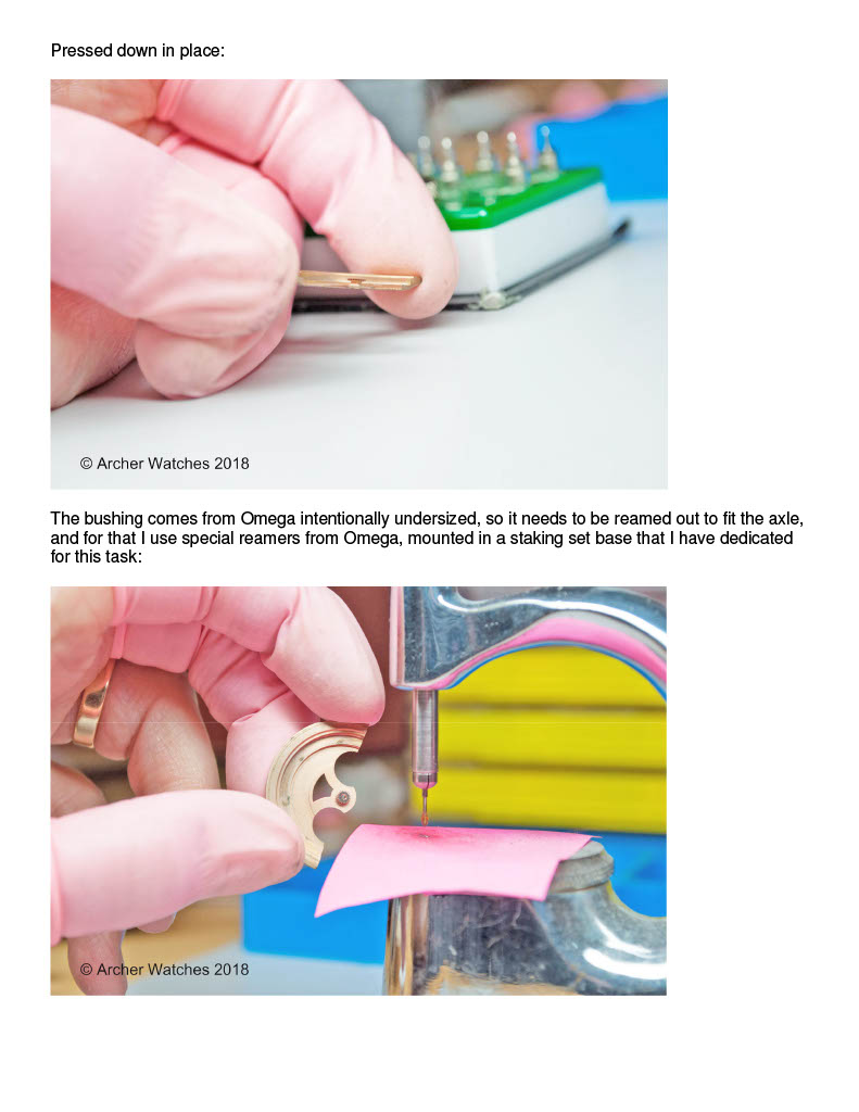

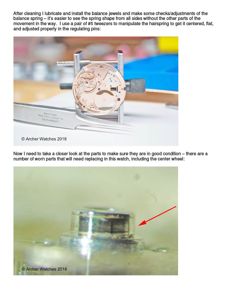

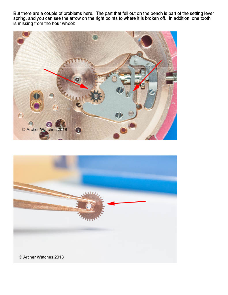

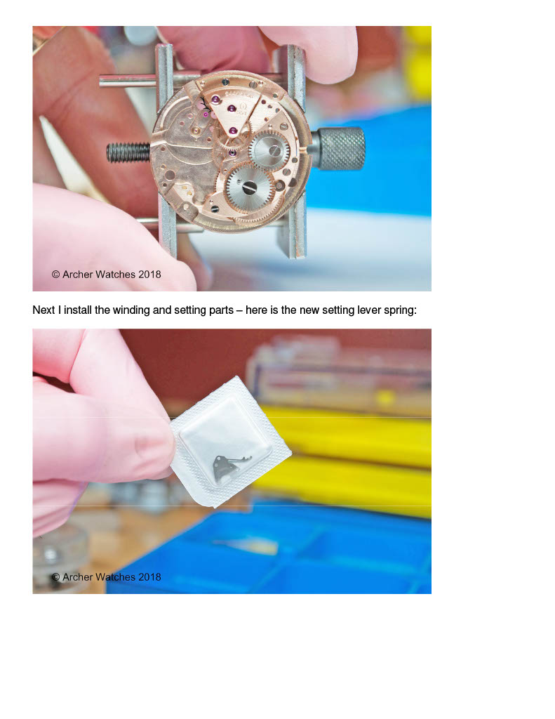

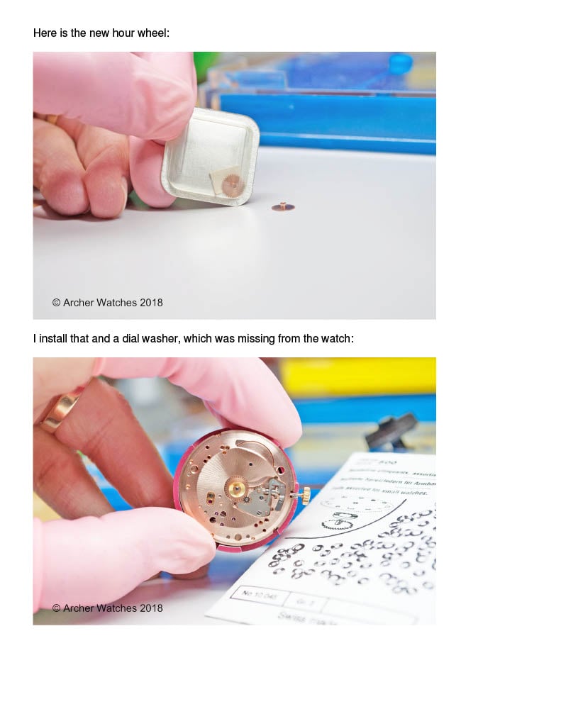

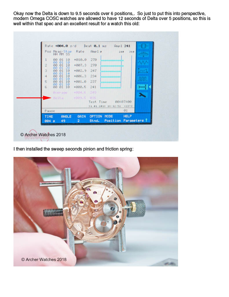

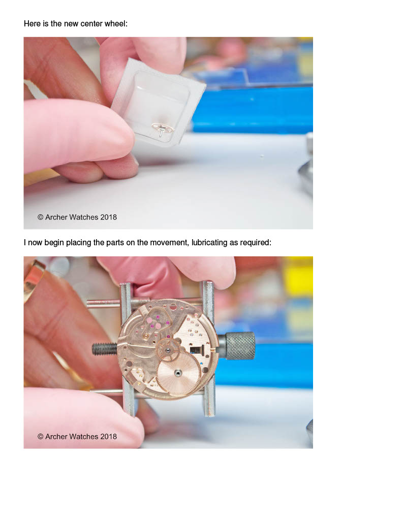

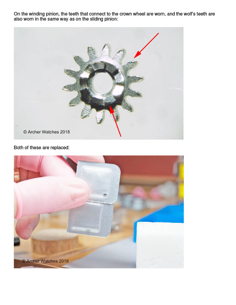

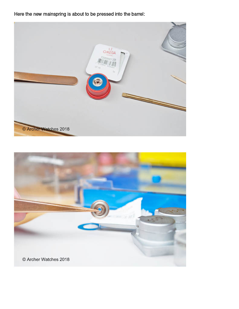

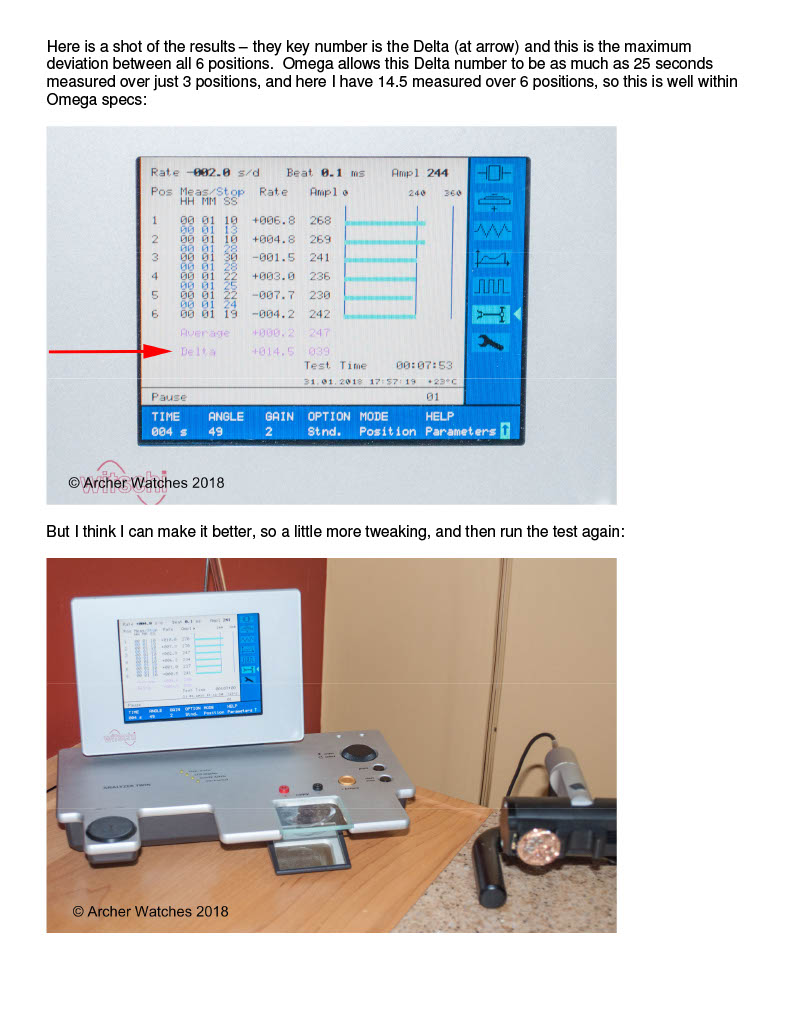

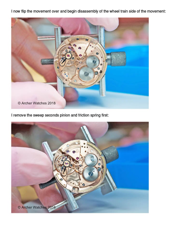

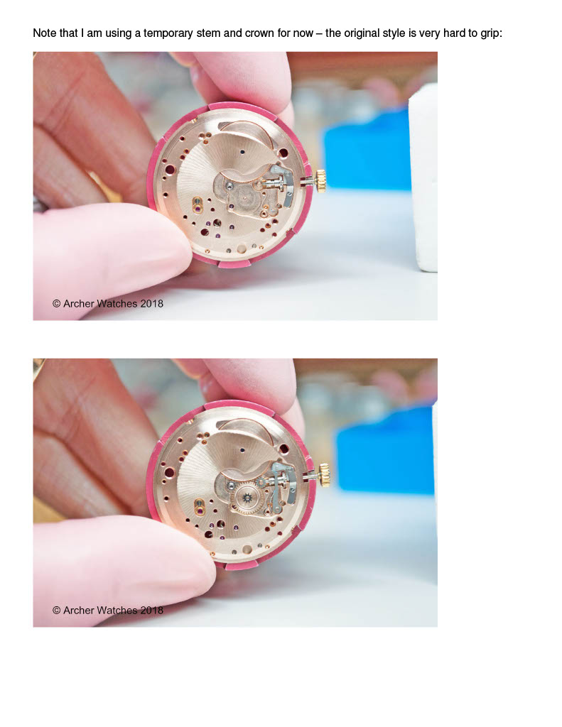

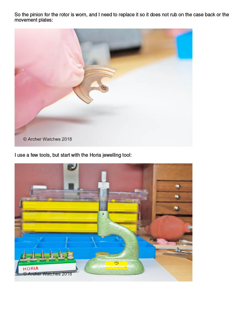

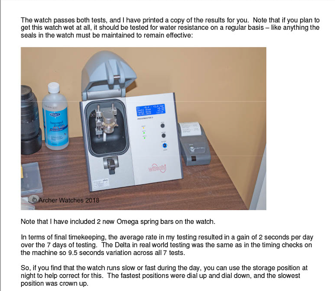

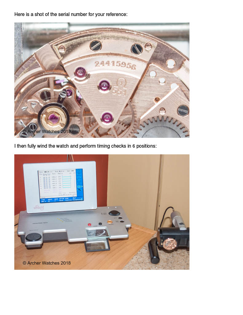

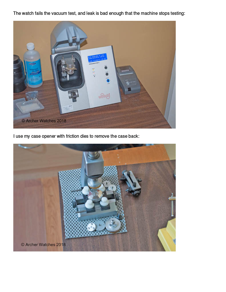

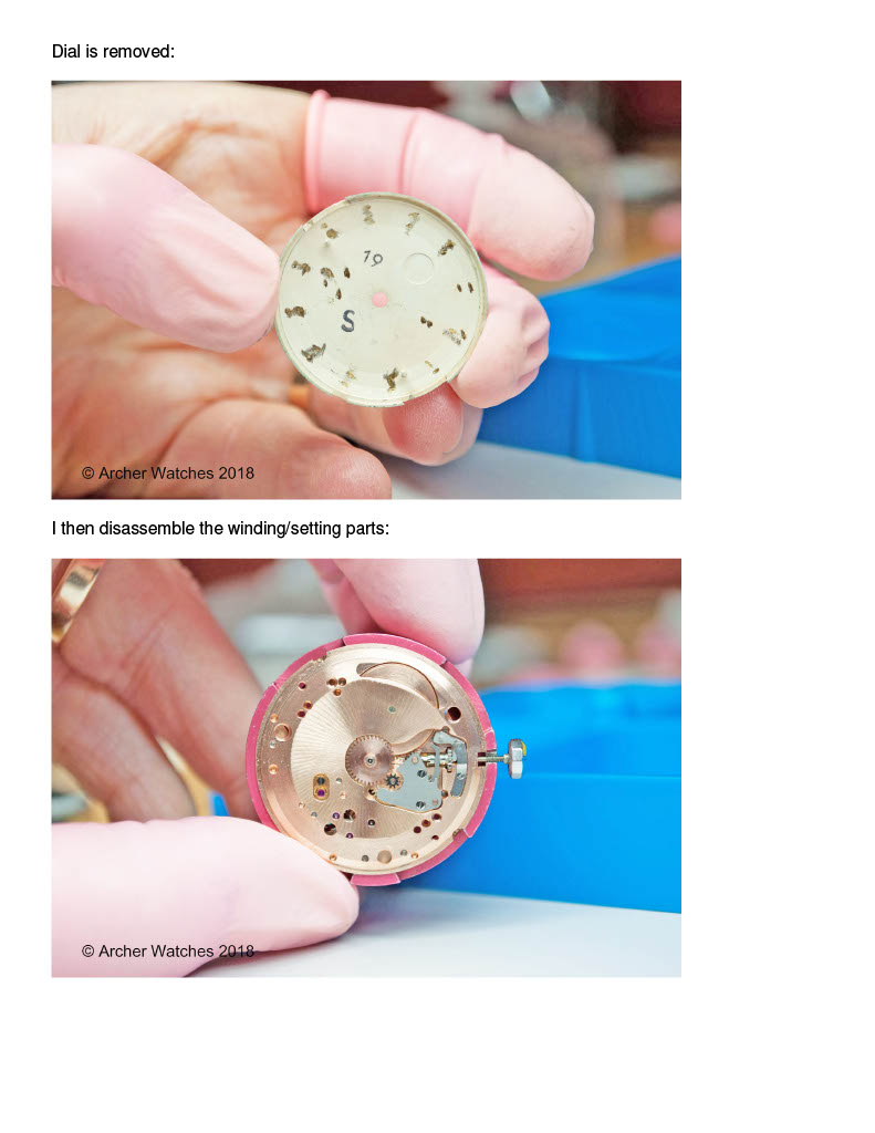

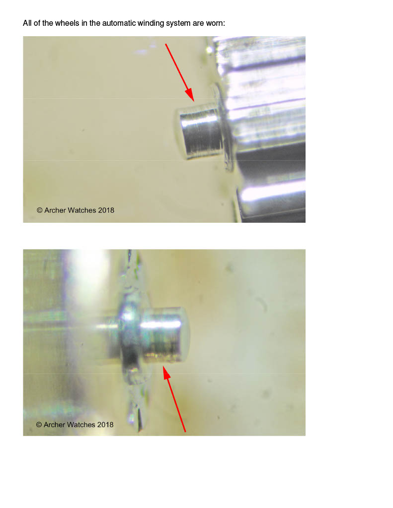

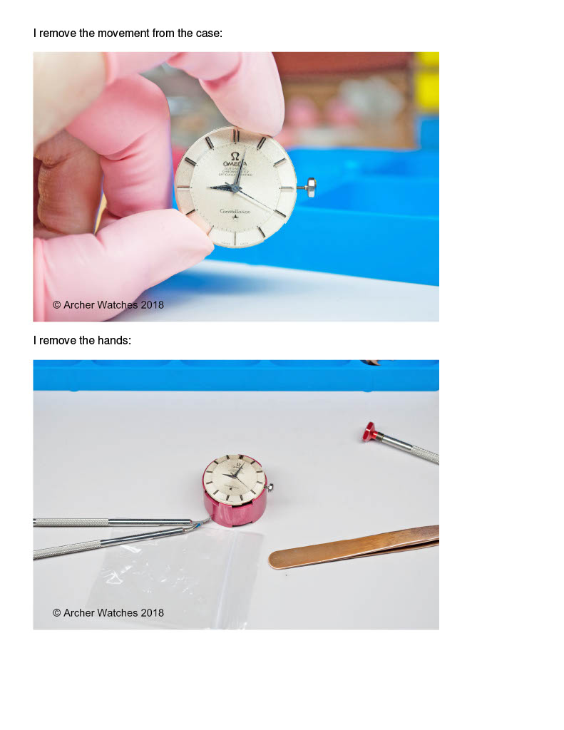

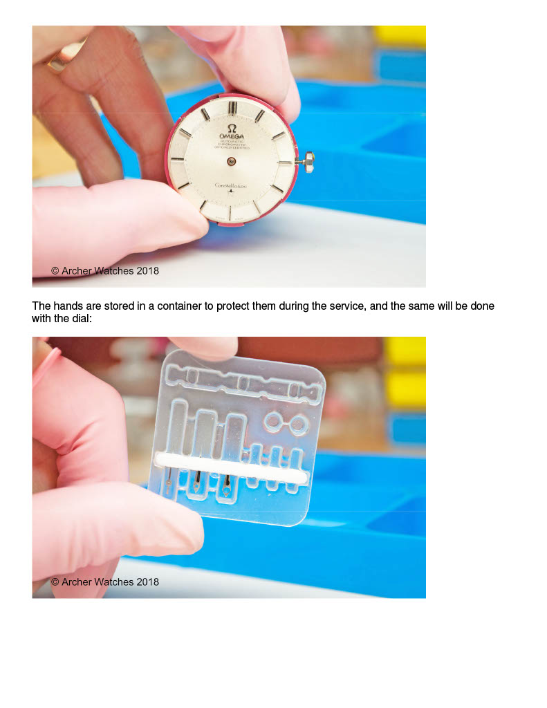

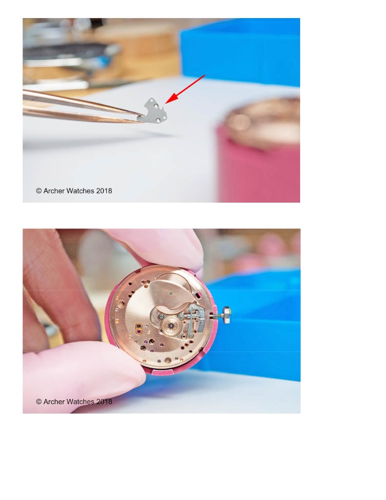

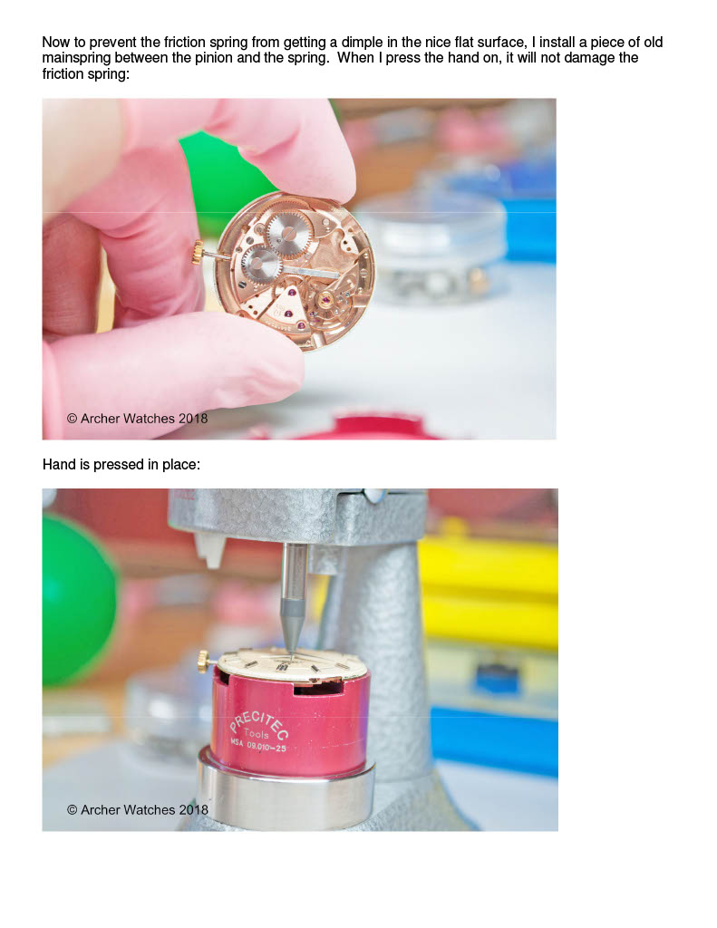

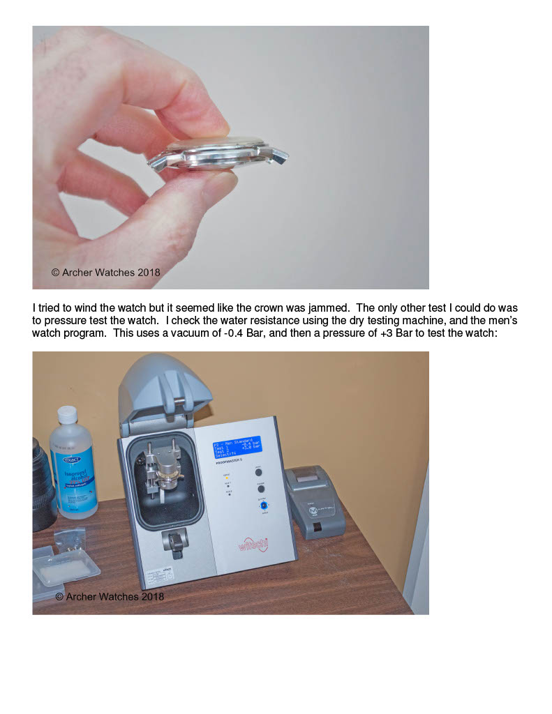

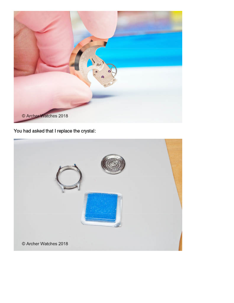

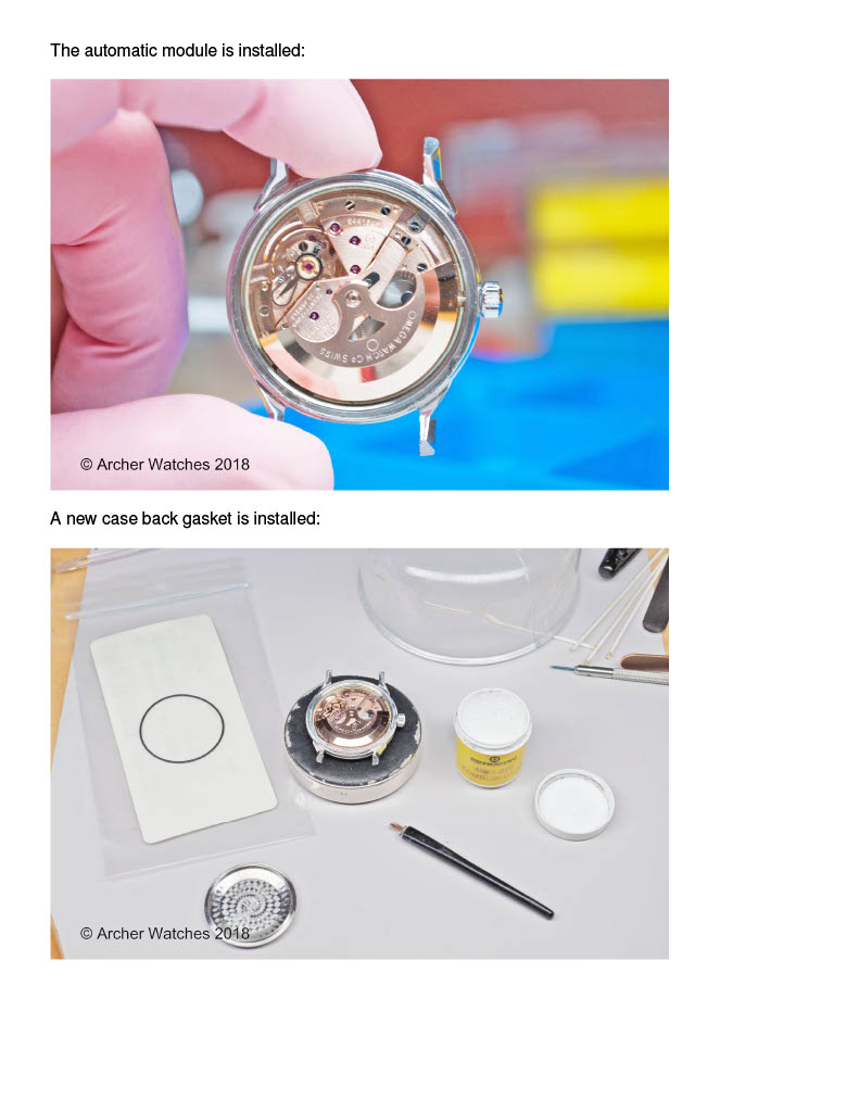

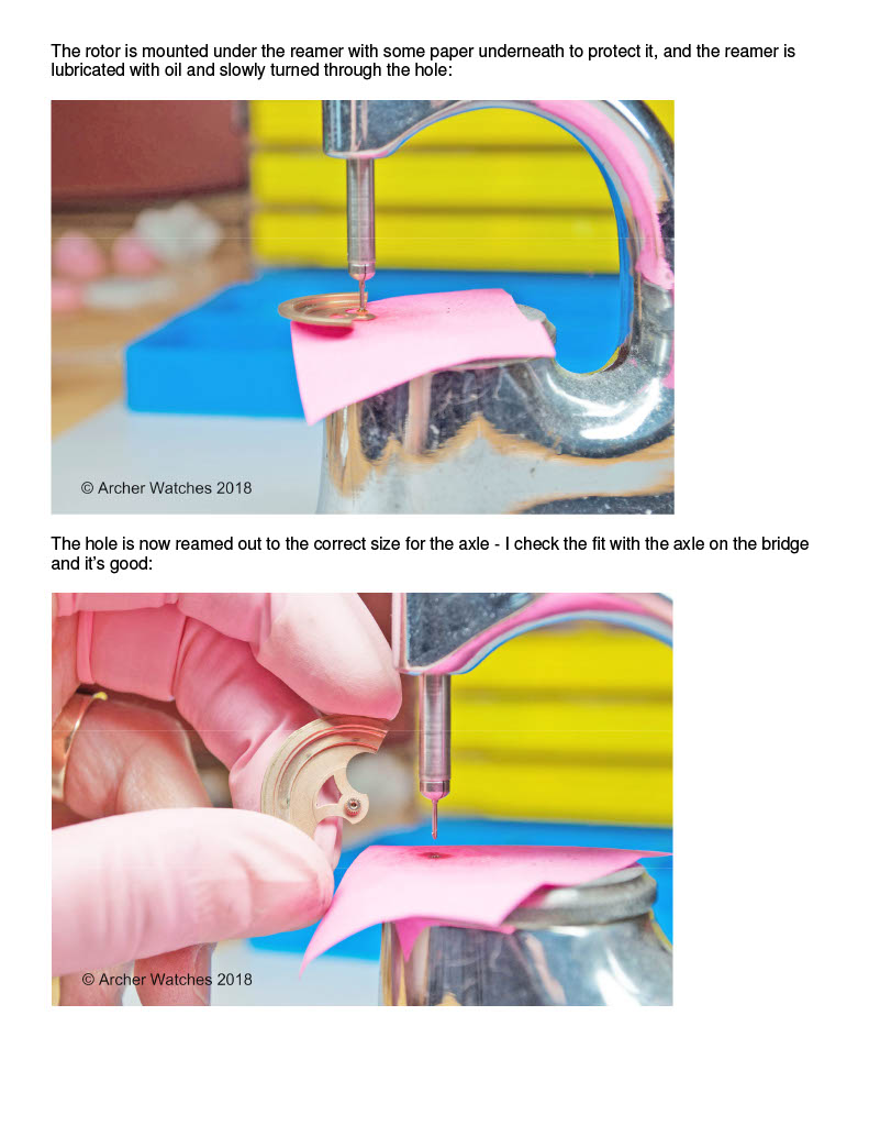

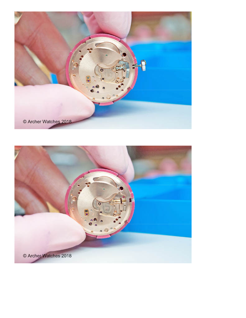

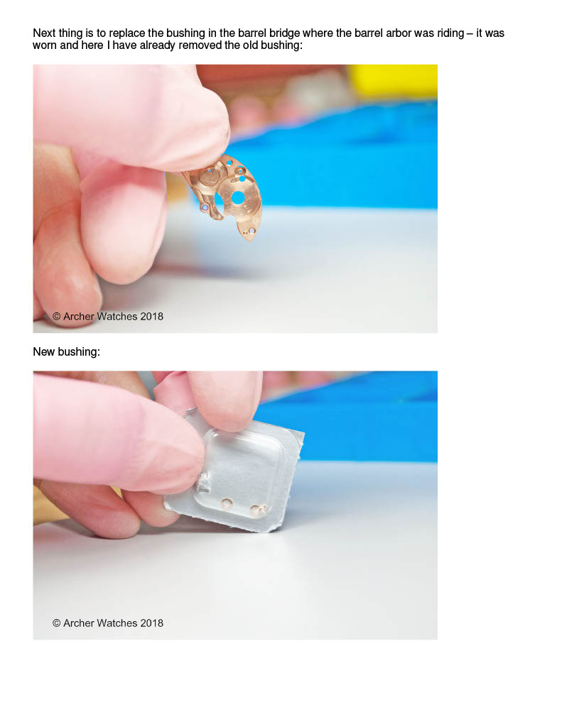

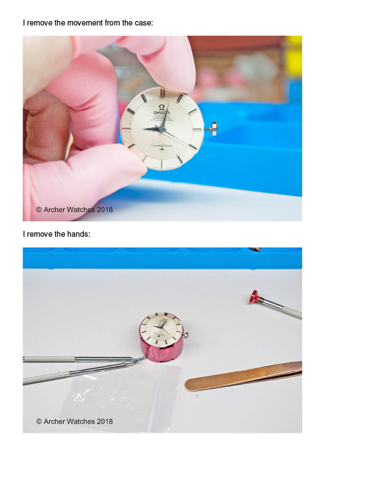

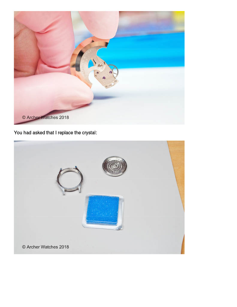

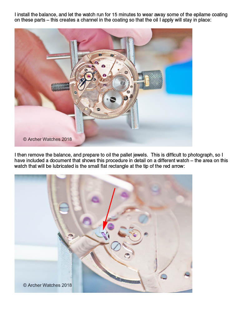

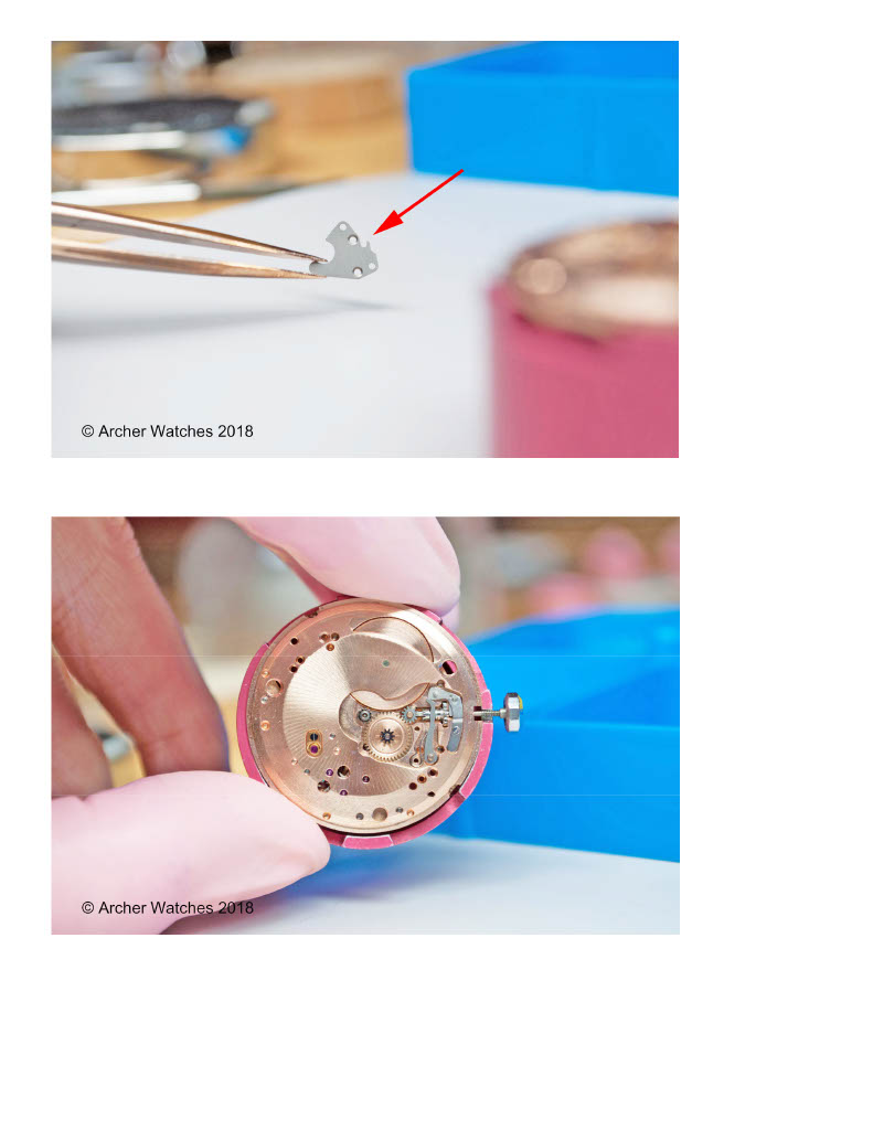

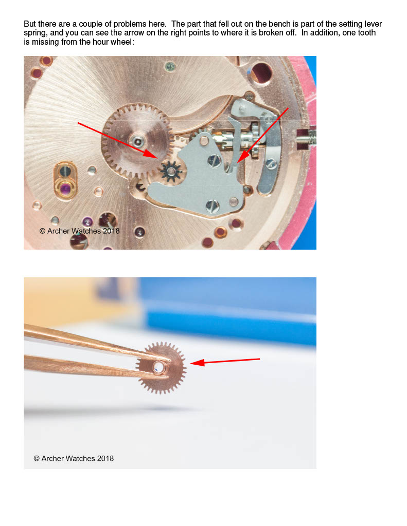

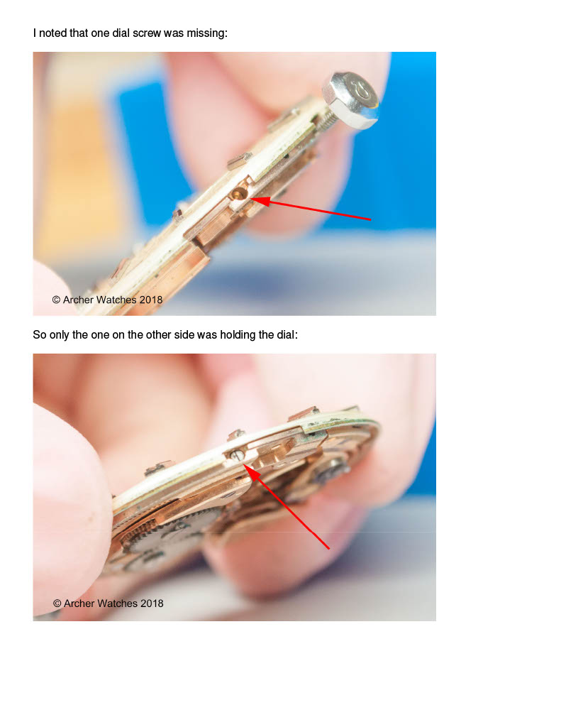

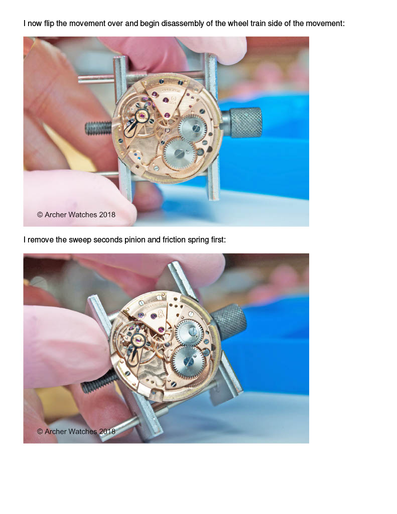

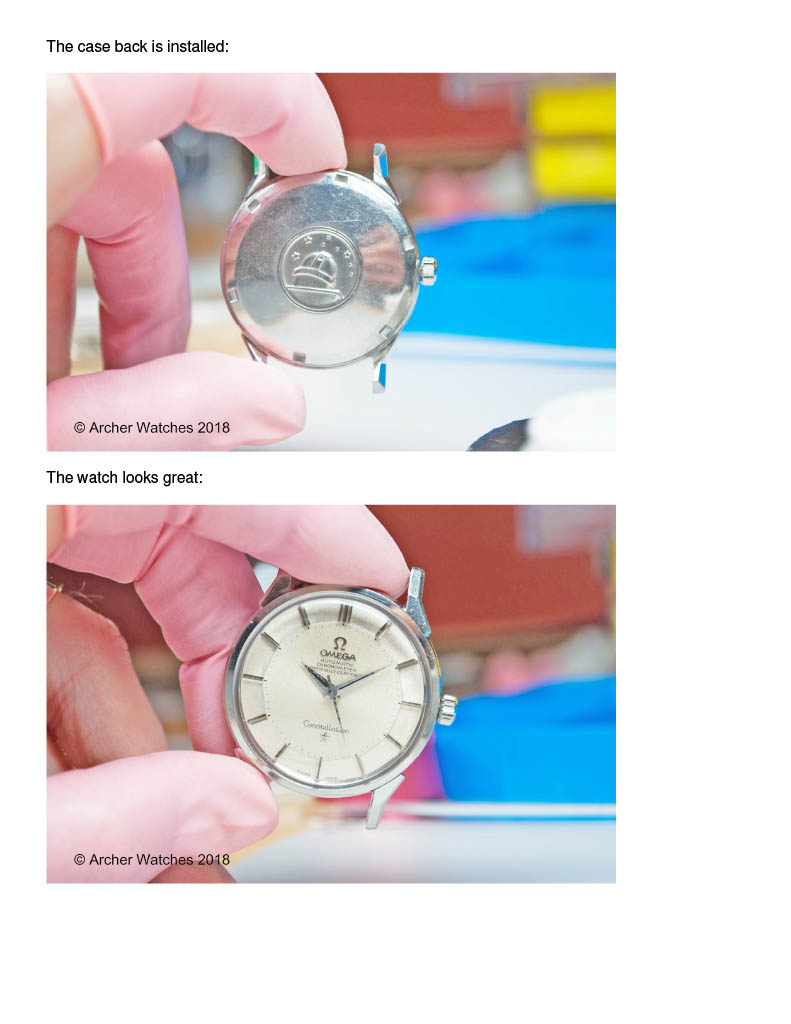

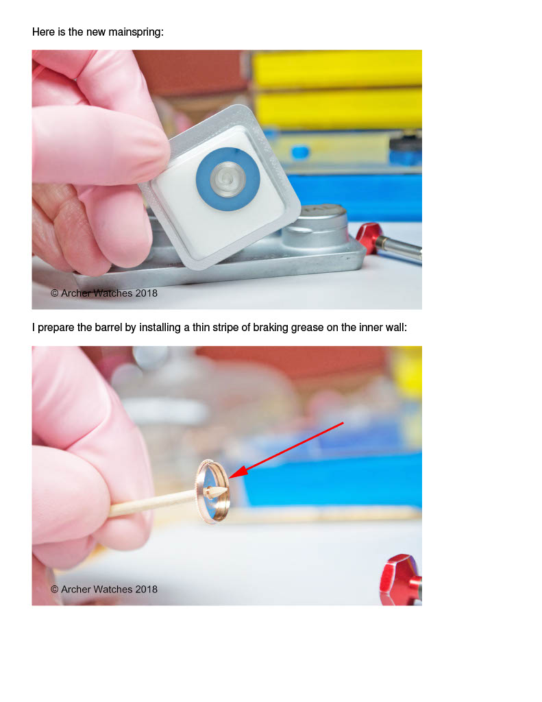

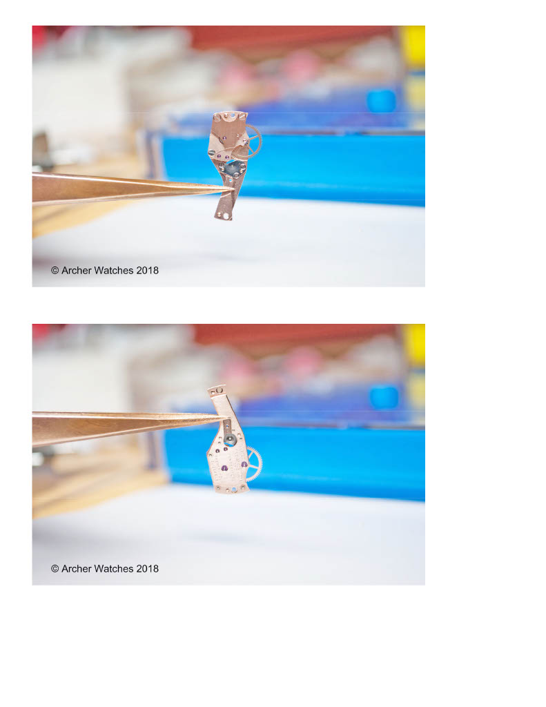

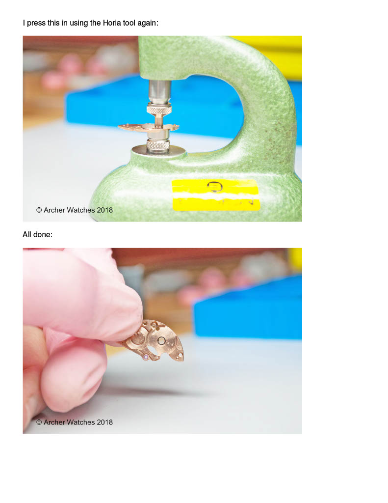

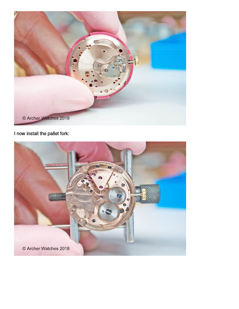

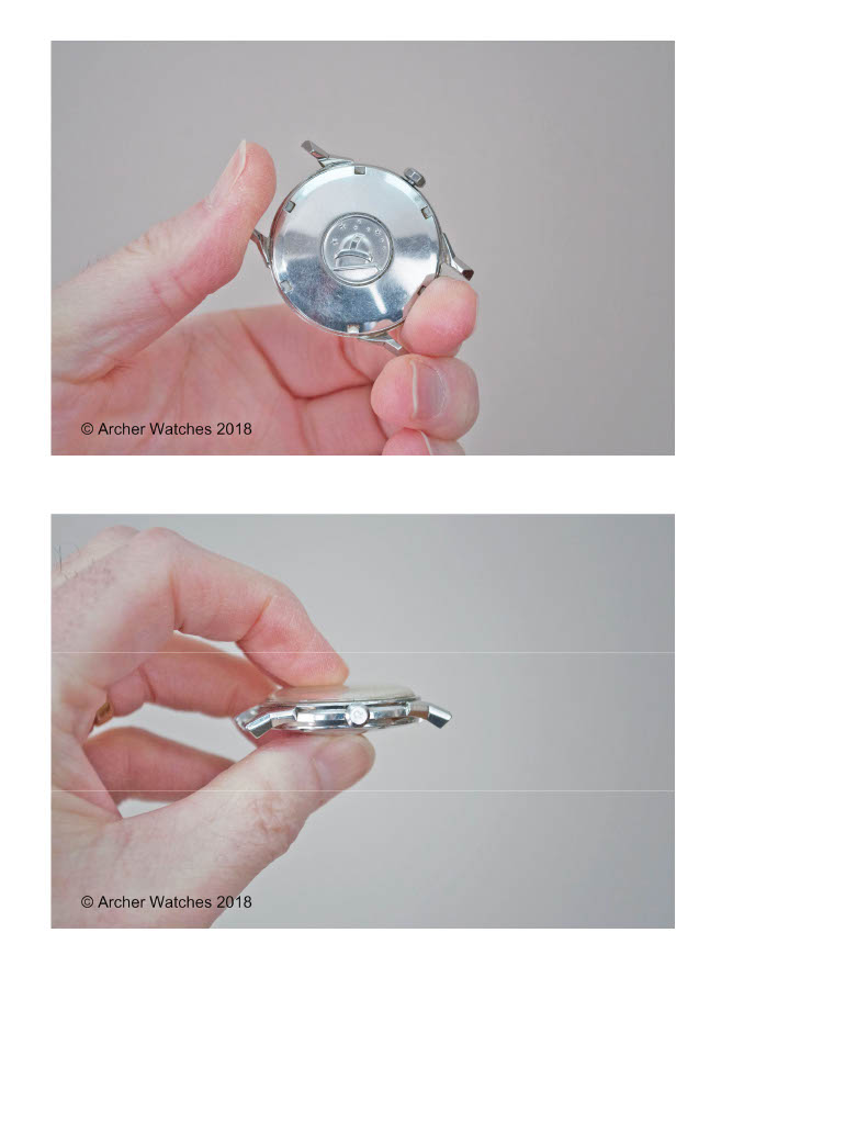

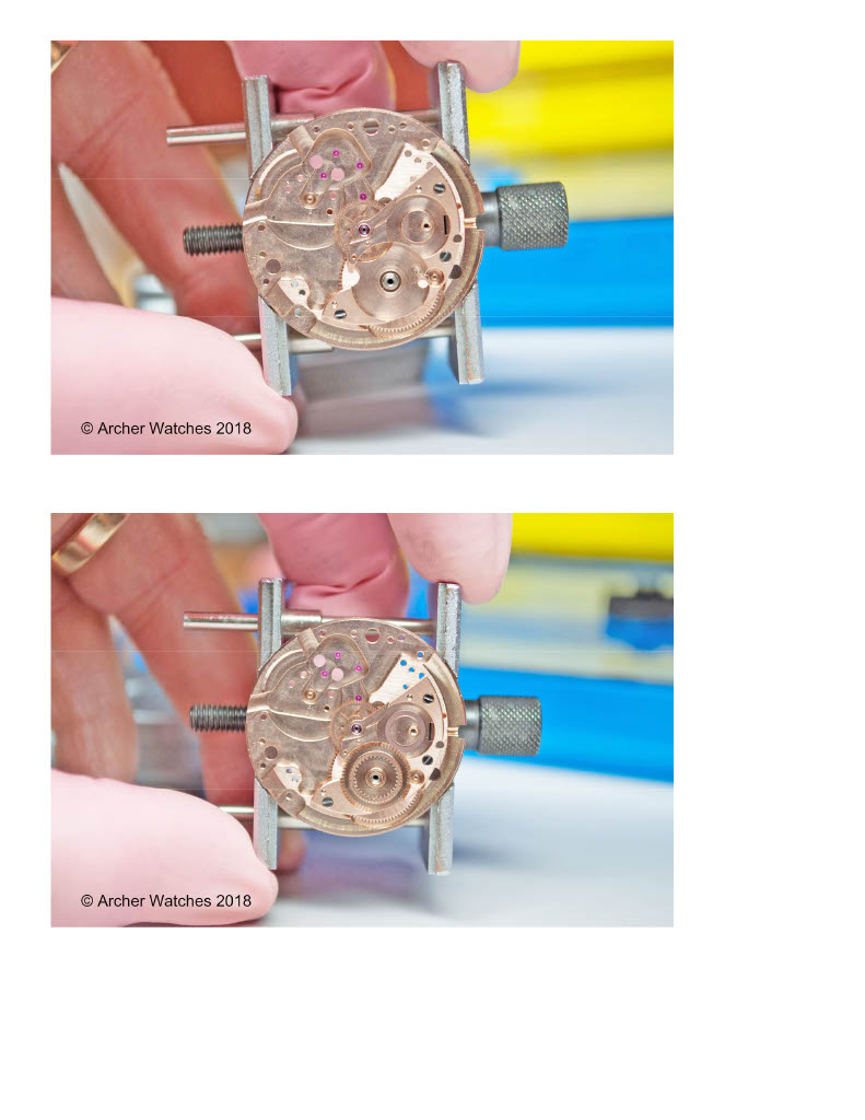

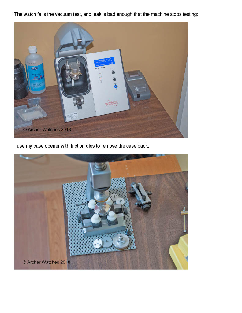

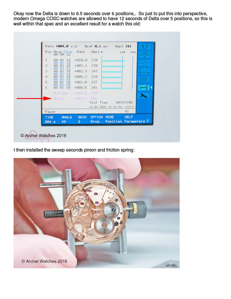

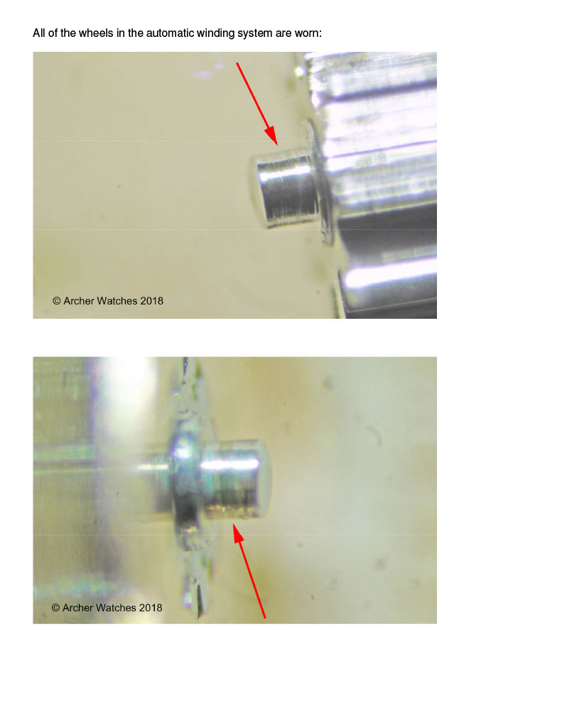

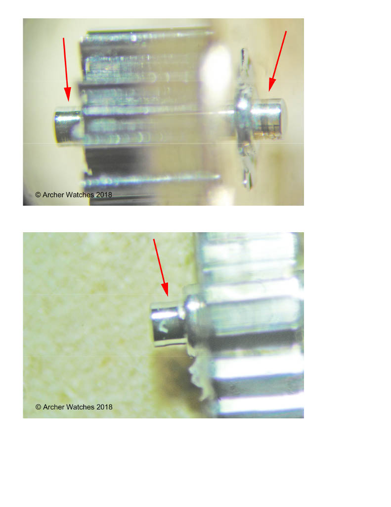

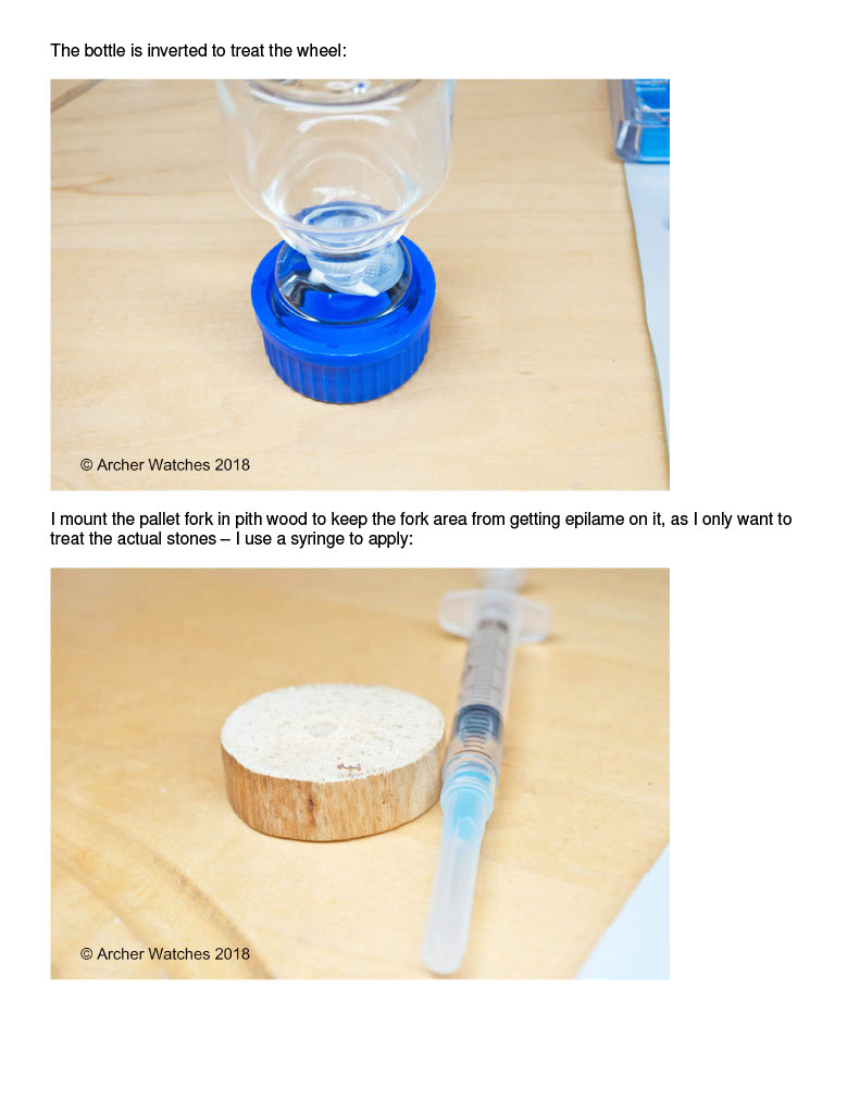

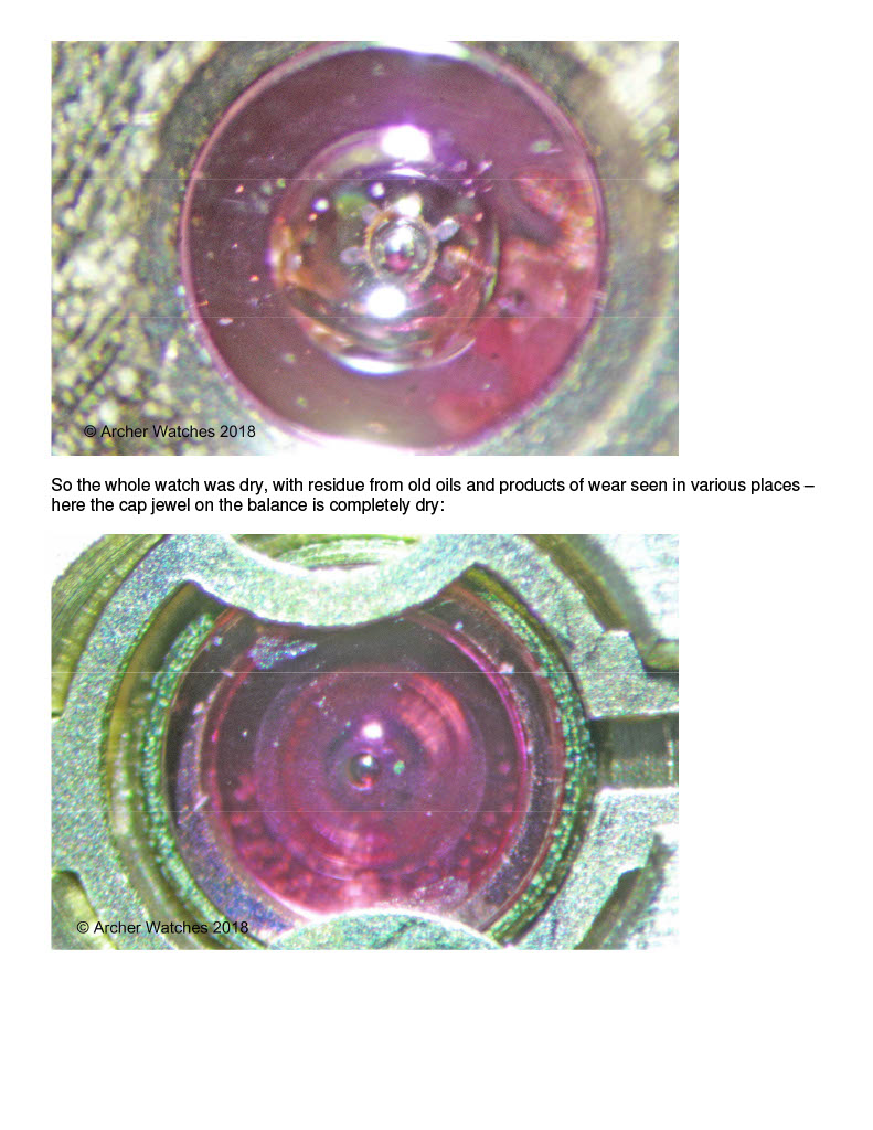

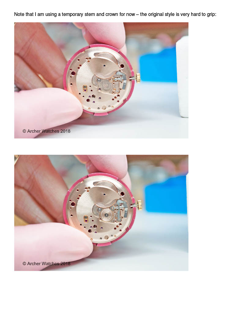

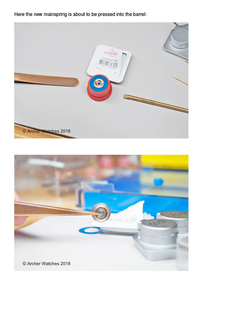

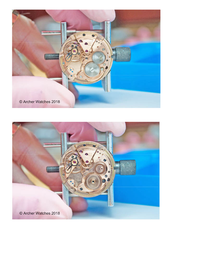

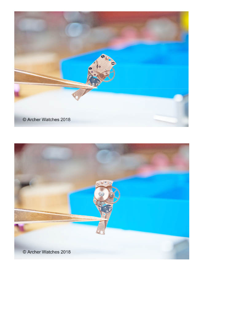

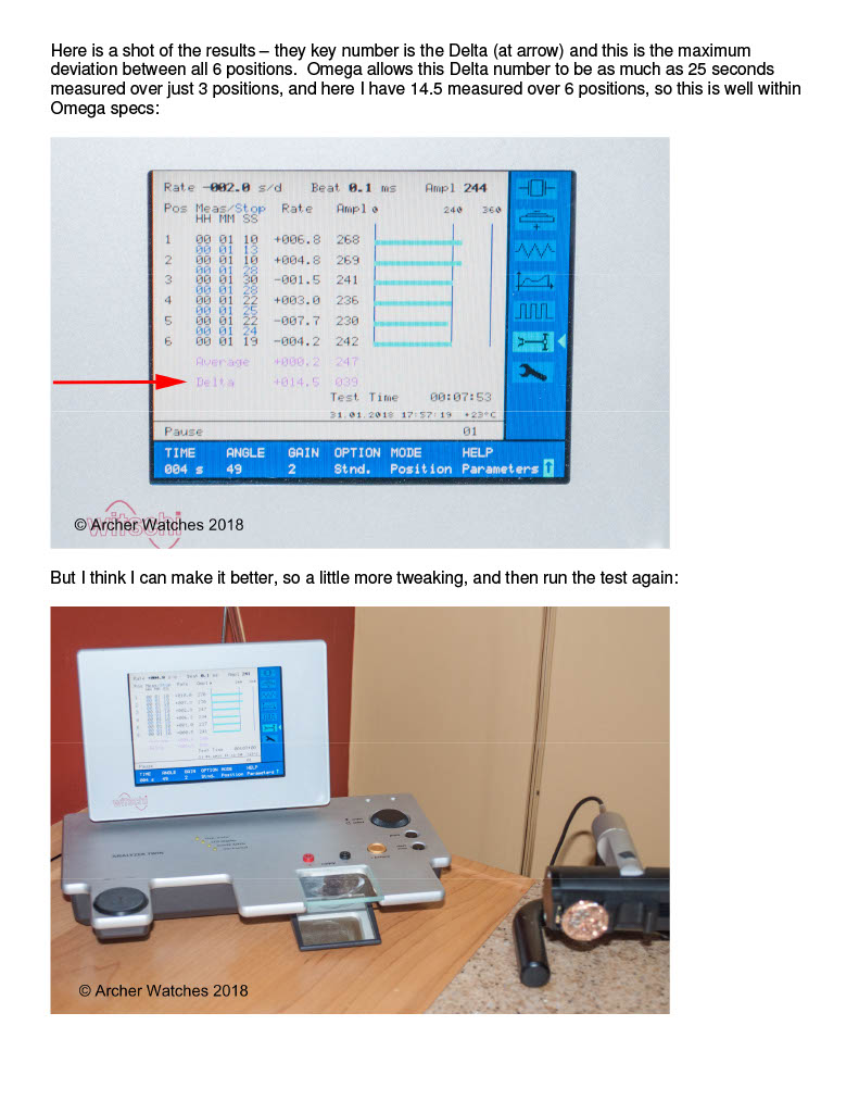

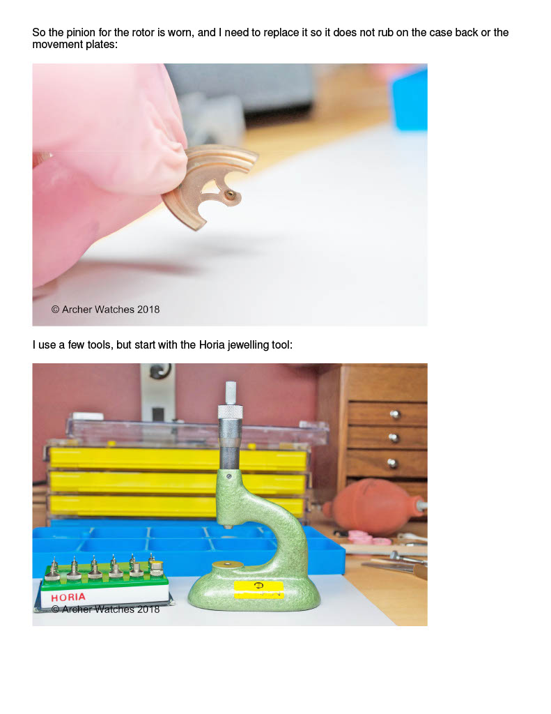

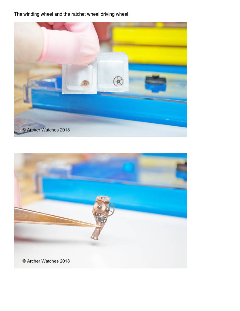

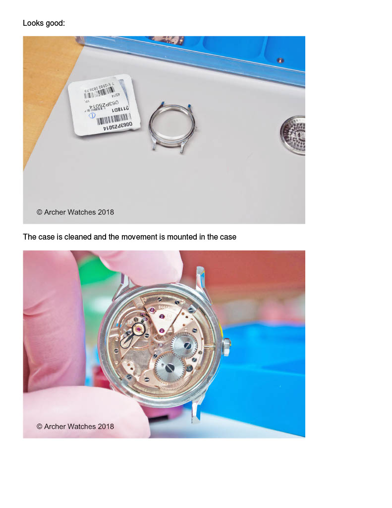

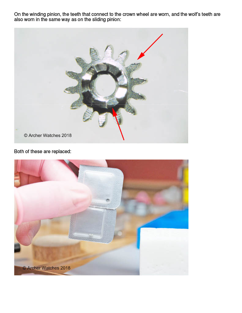

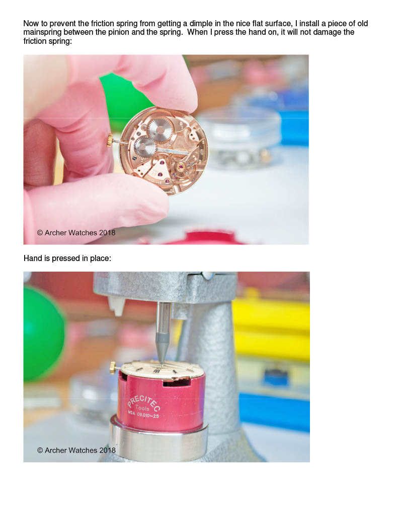

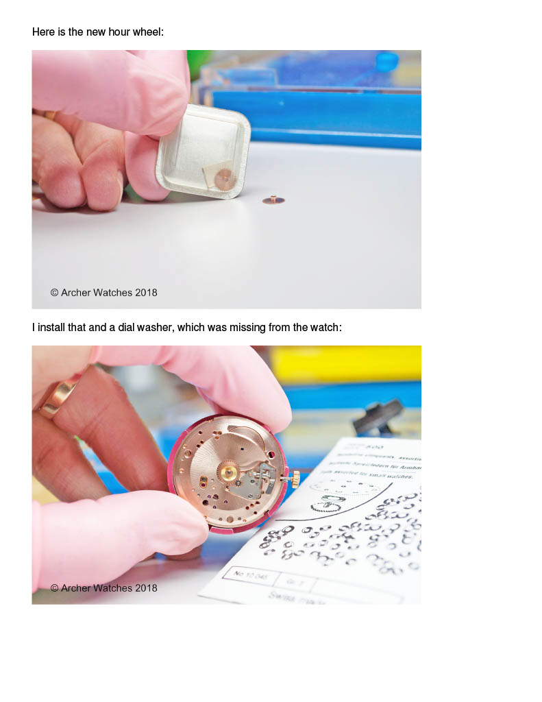

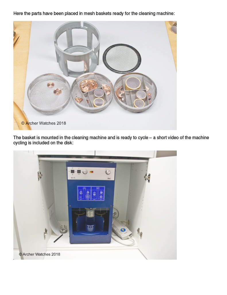

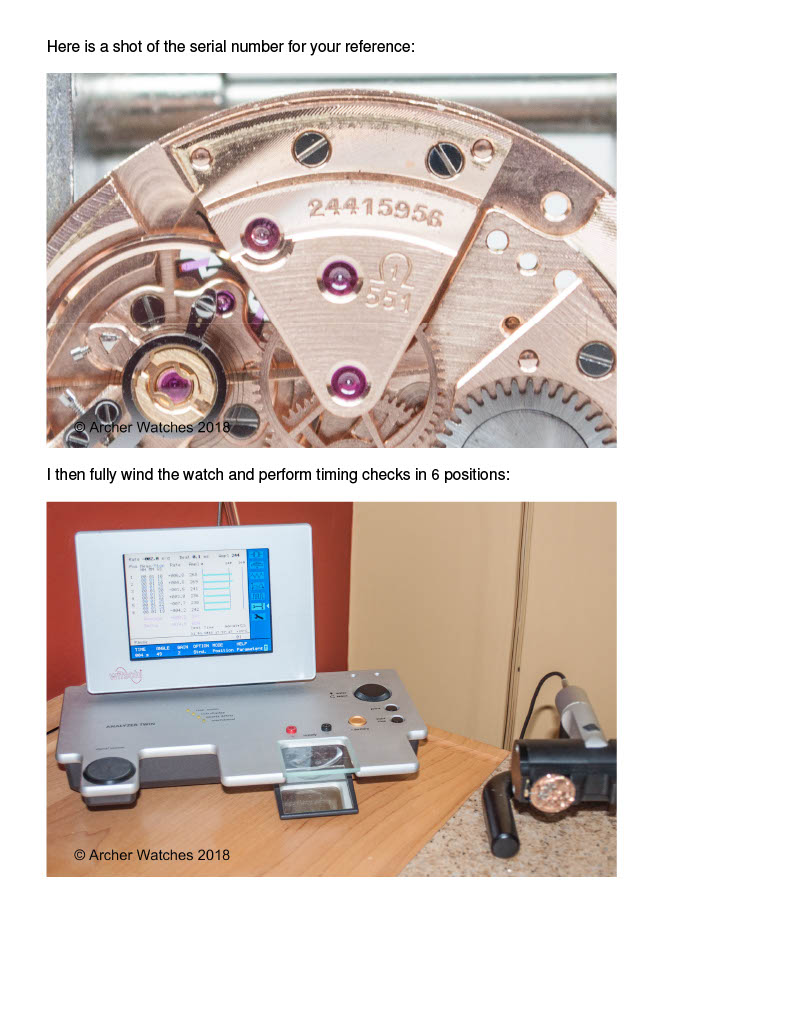

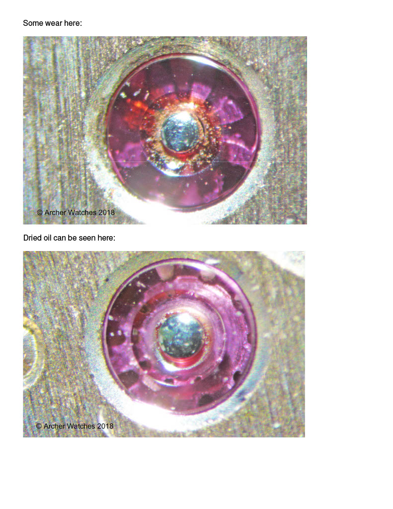

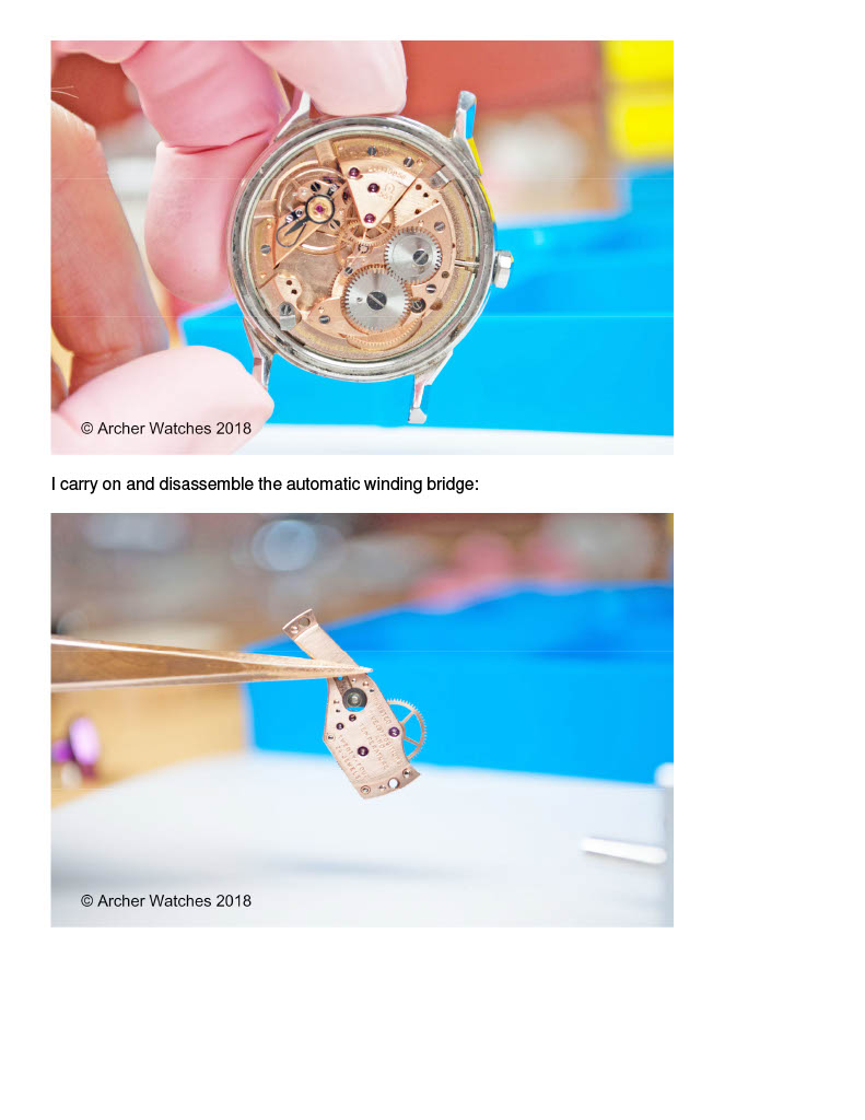

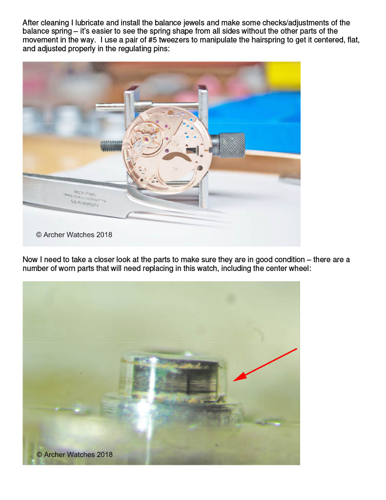

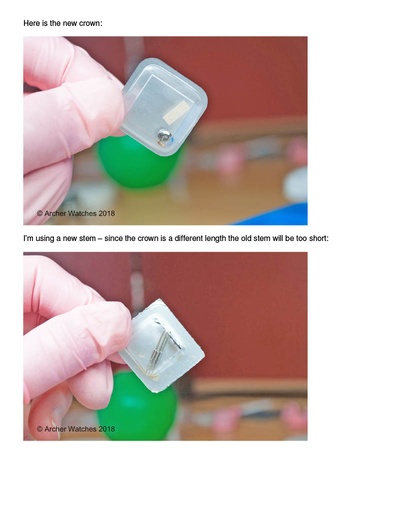

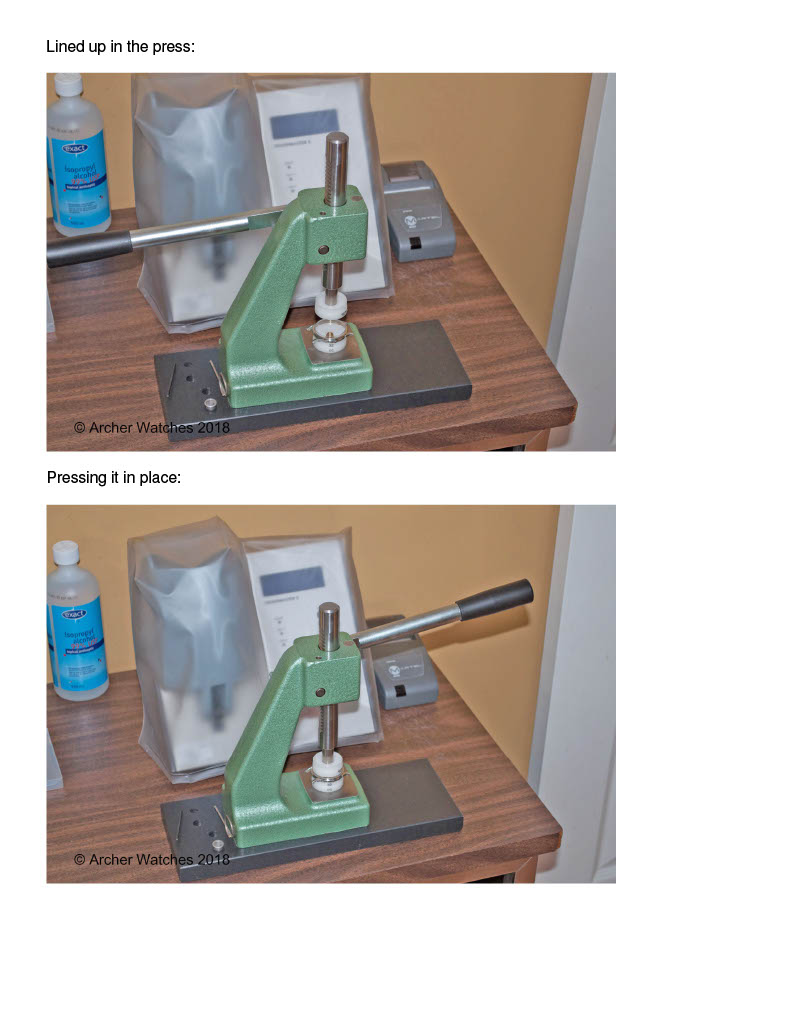

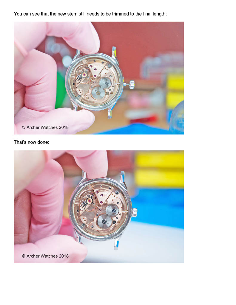

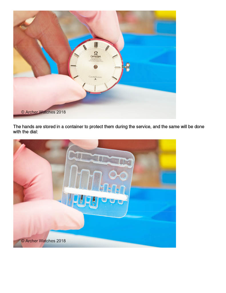

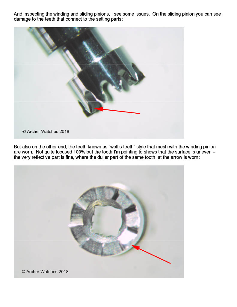

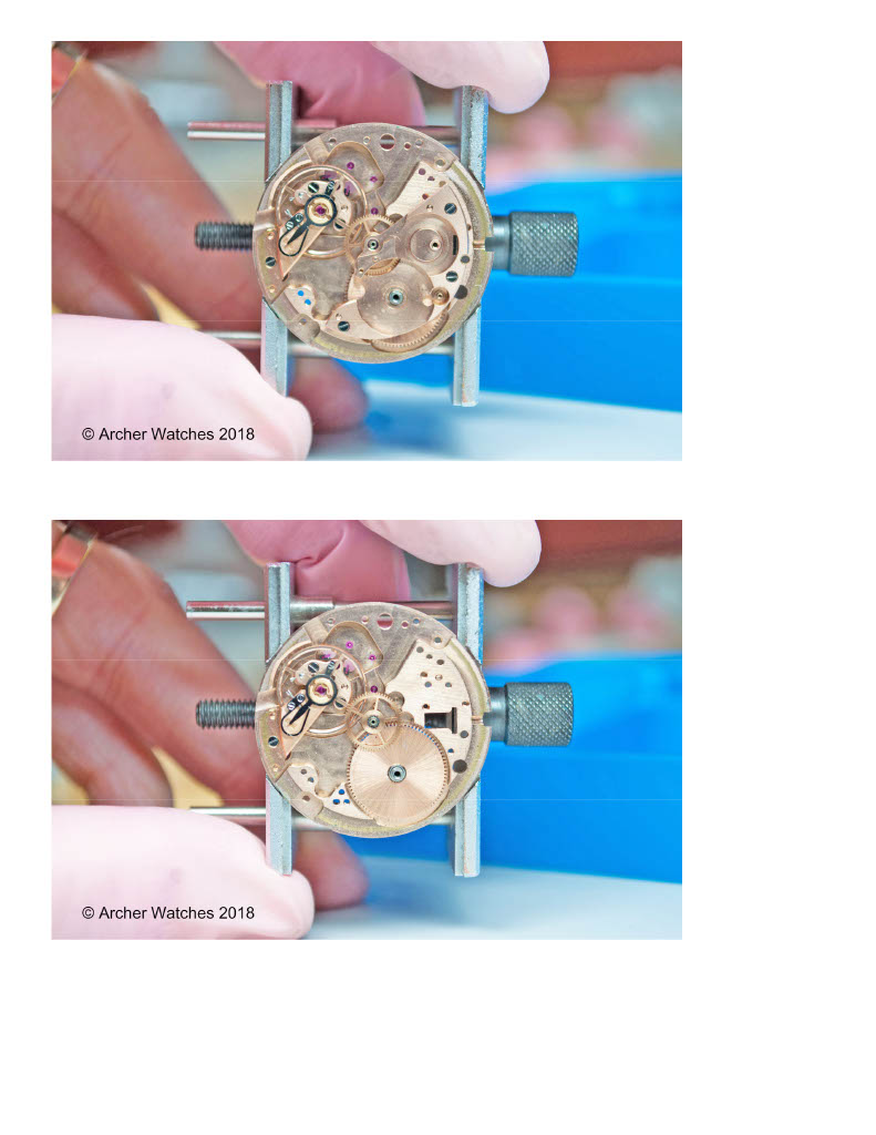

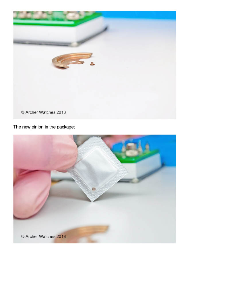

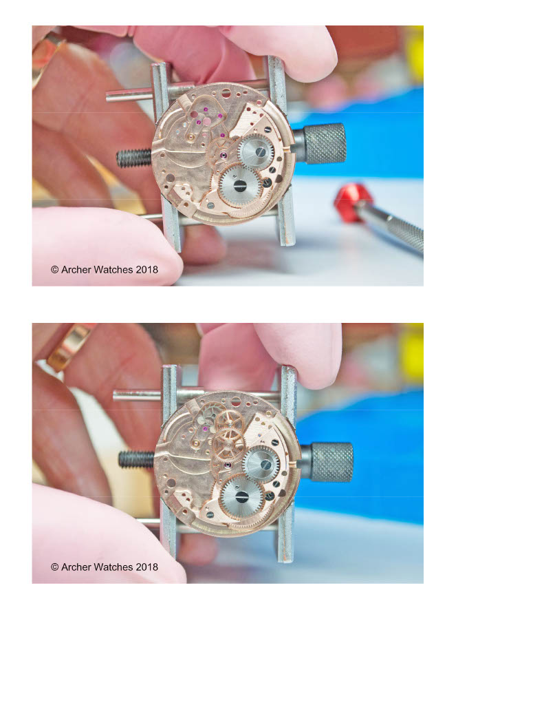

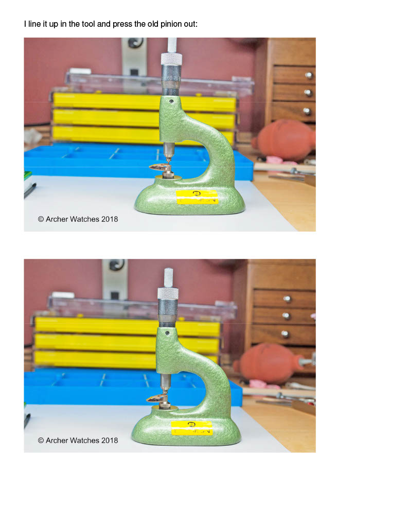

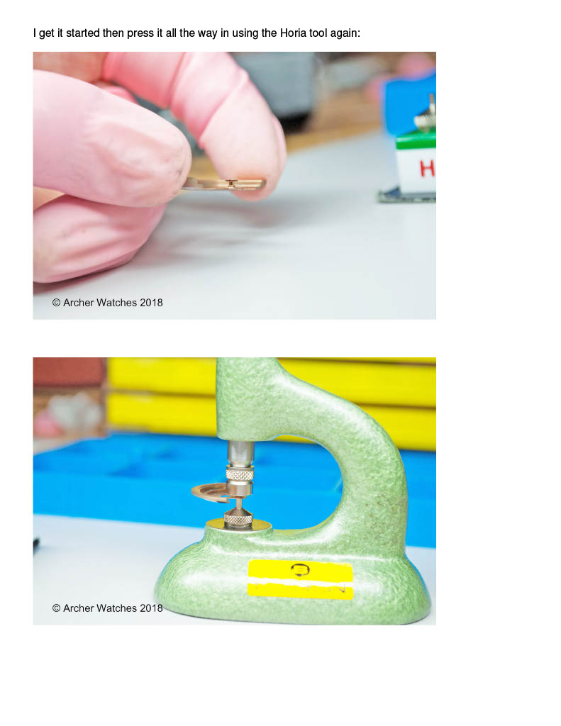

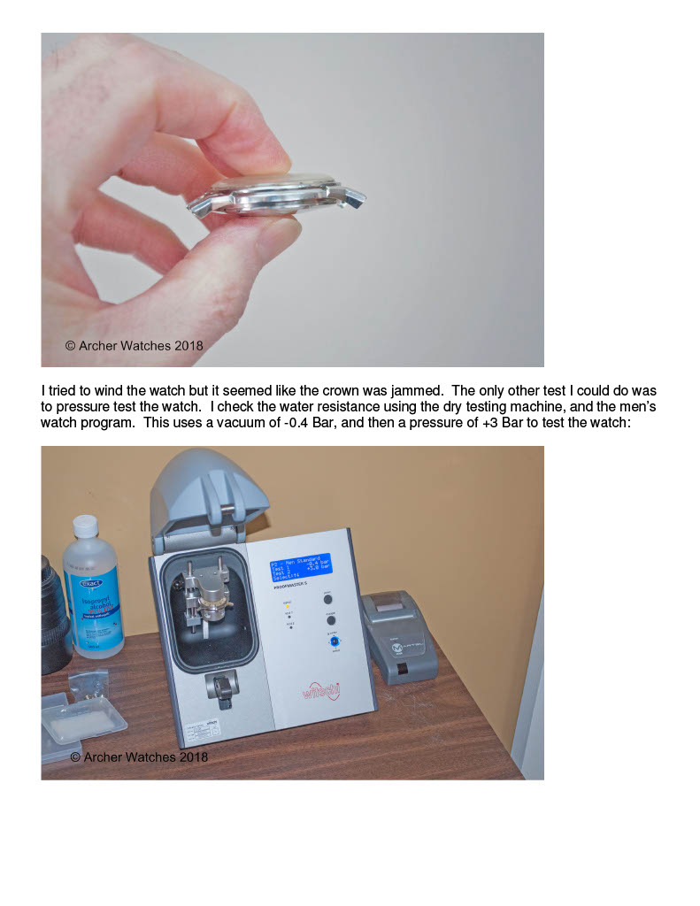

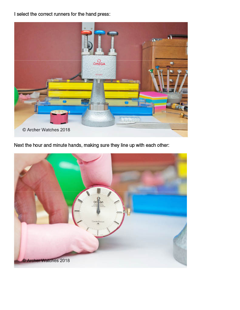

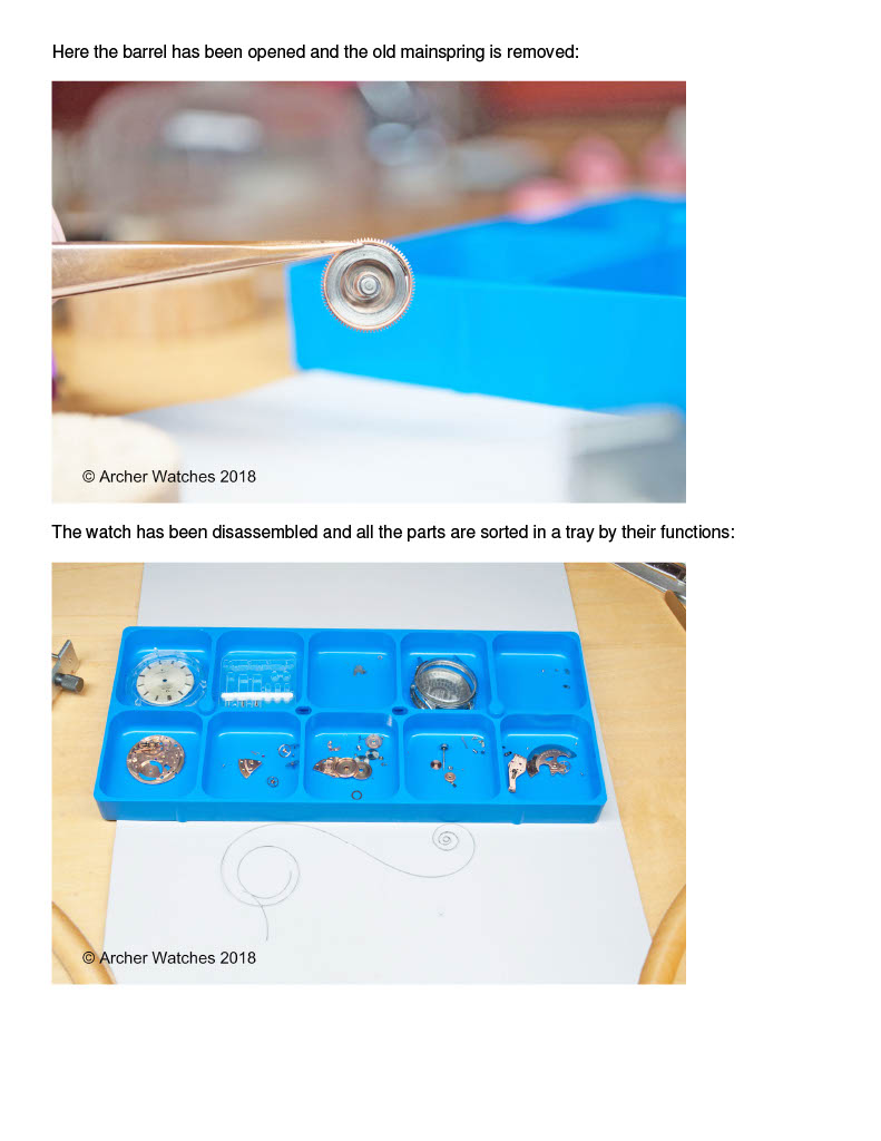

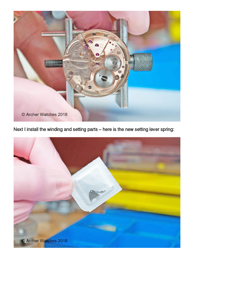

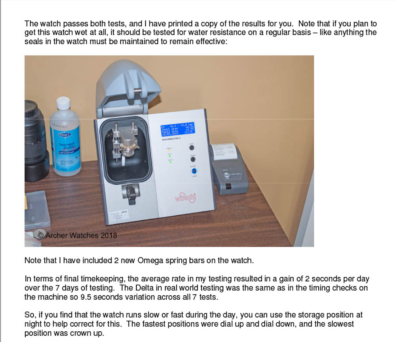

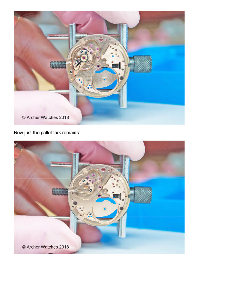

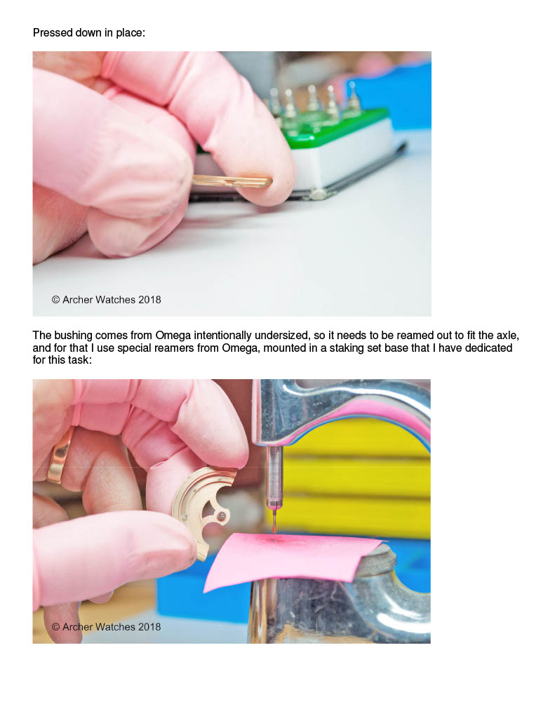

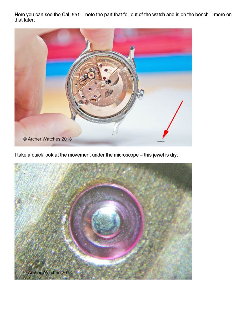

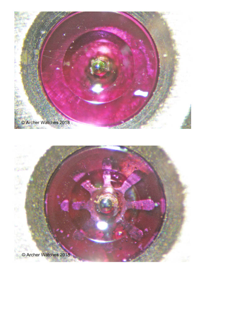

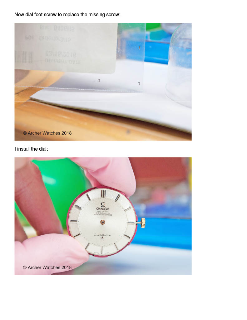

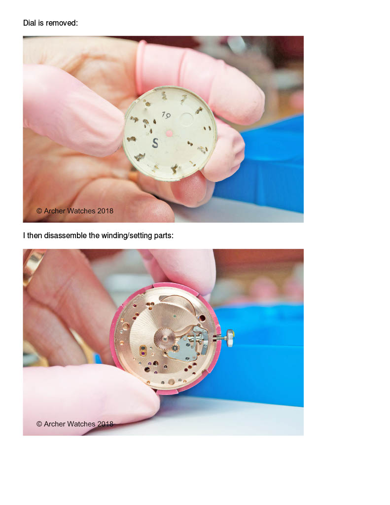

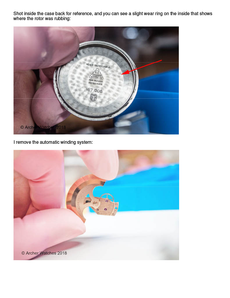

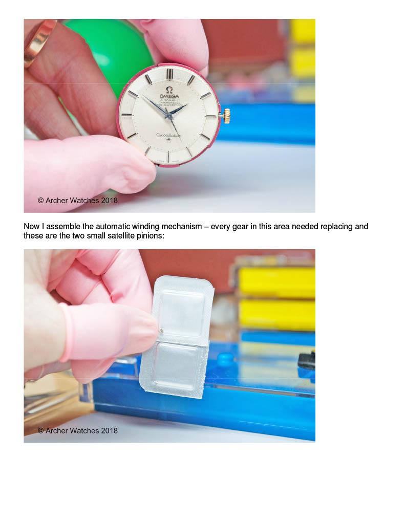

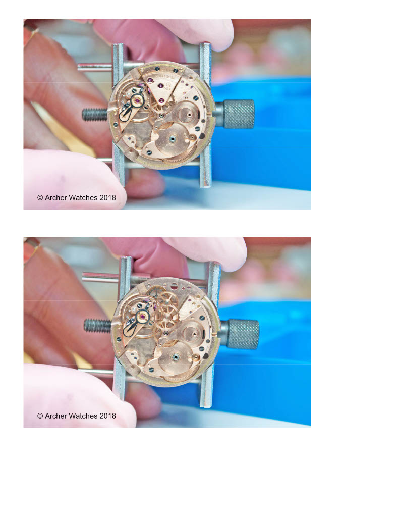

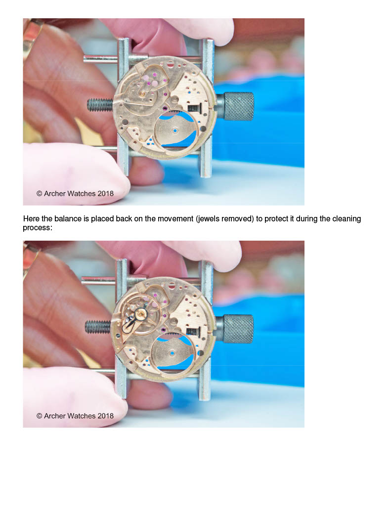

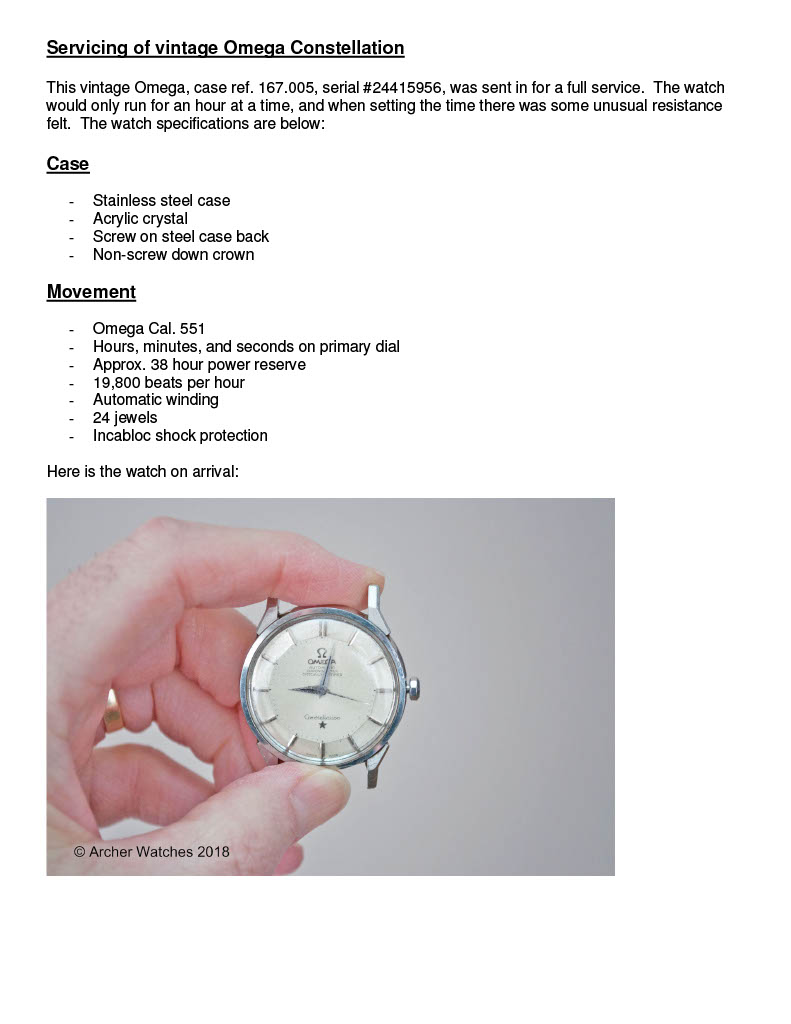

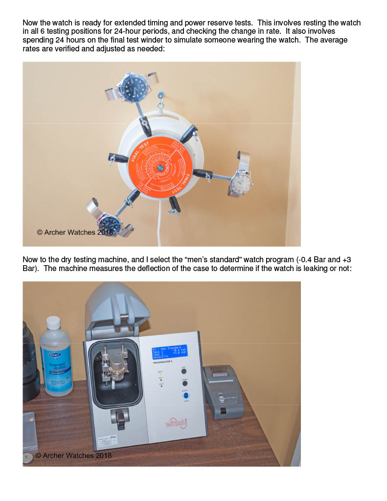

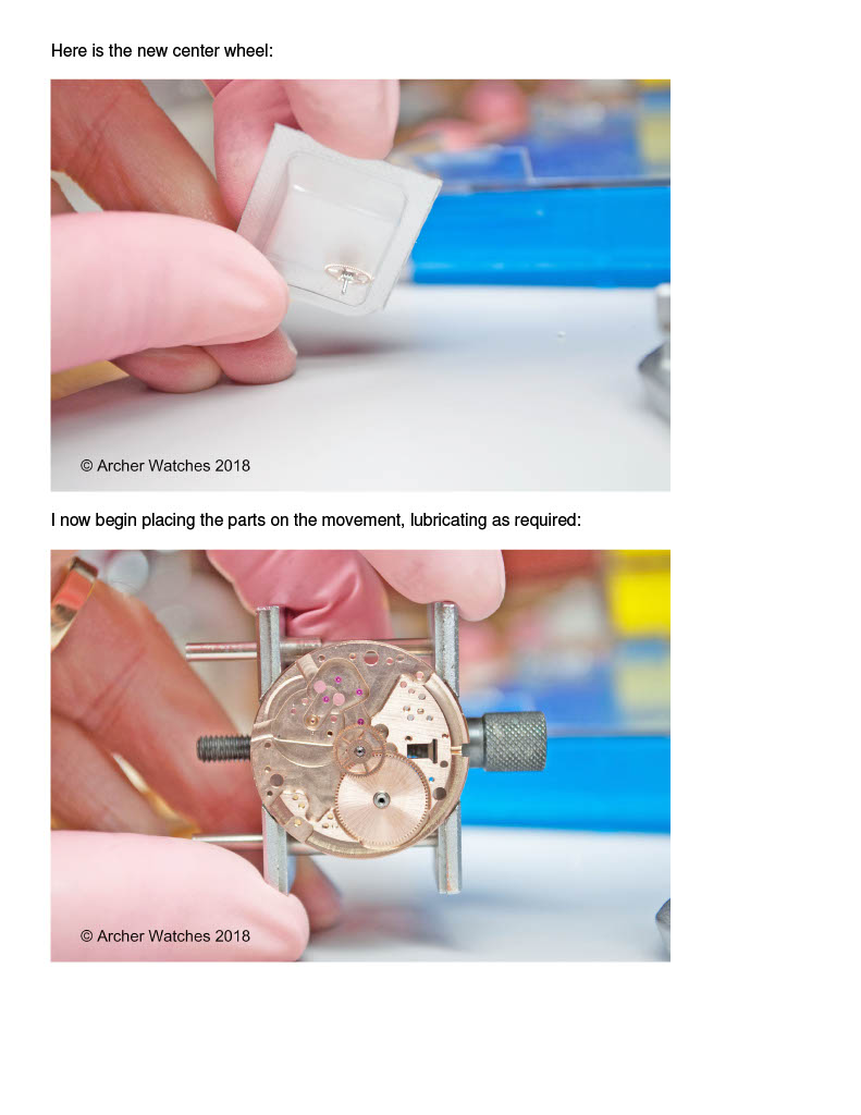

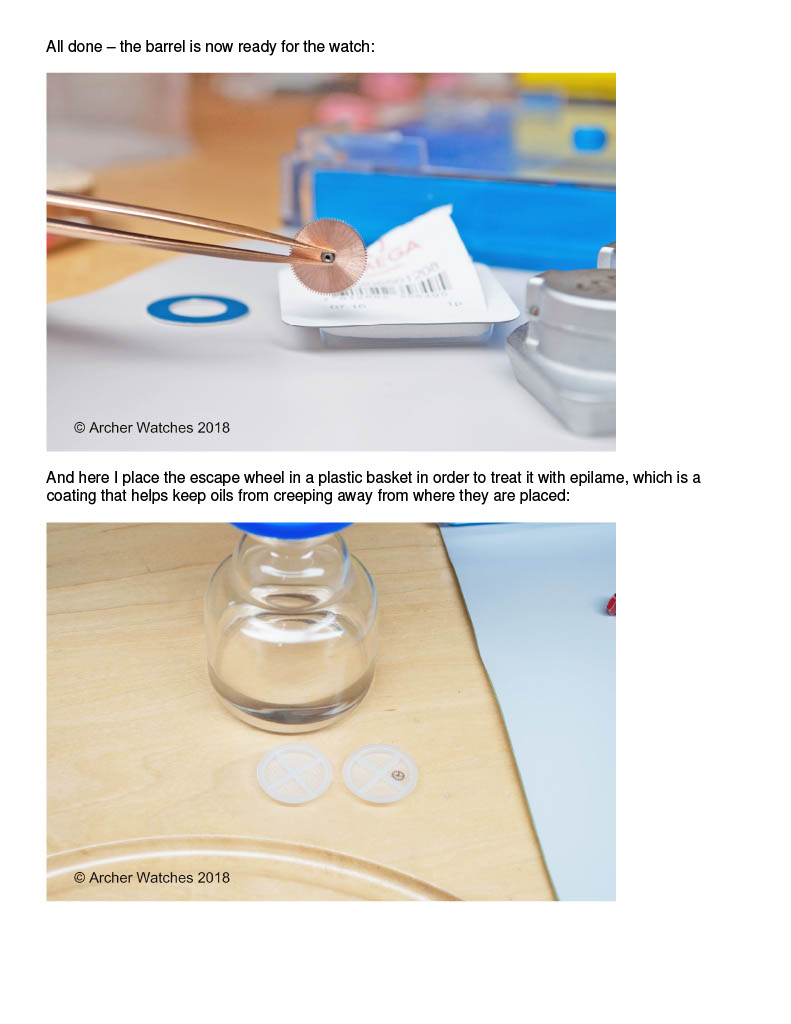

In late 2017 I picked up a nice looking but non functioning Constellation. I'd sent it out to a watchmaker that a local watch shop uses but he wasn't confident he could source all the parts so it was returned to me. Archer had an opening in his schedule and took on the job.
Below is the service doc sent back with the watch. I've really enjoyed looking through it over the years and I hope others will enjoy it as well.
