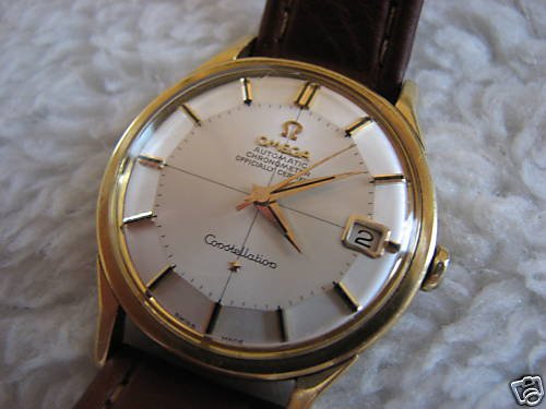

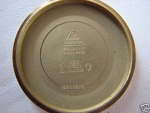

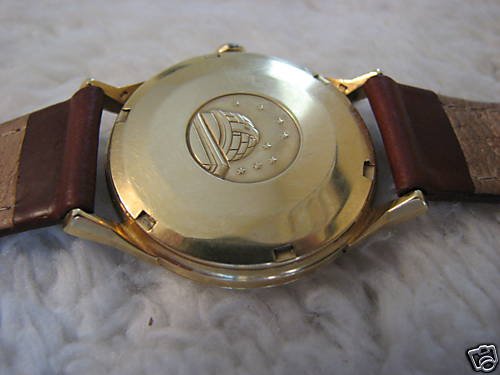

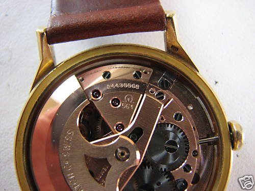

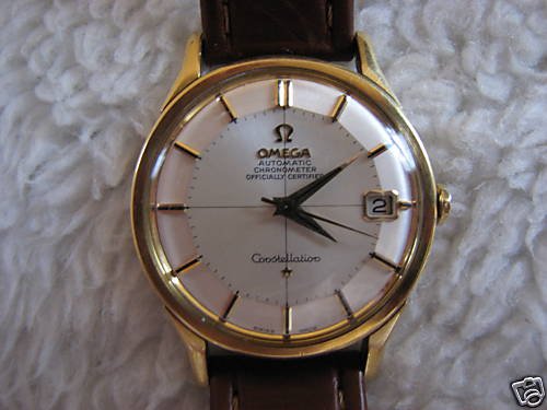

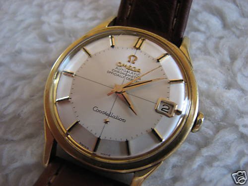

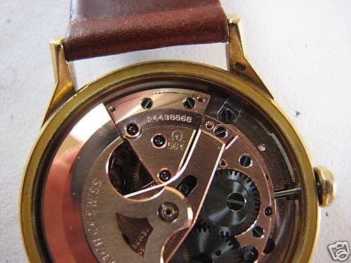

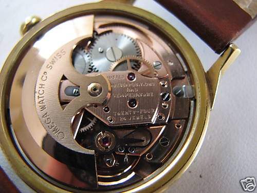

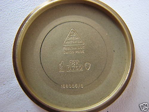

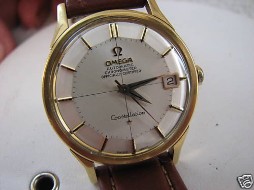

Looking for help in selling a 1966 Omega constellation 18kt solid gold (rose color) gents watch with a pie pan dial.
that I purchased in early 2000 as an investment.
Serial #24498868/561 - 1996
Case markings: 352/18K/0.750/168005/6
Strap is Speidel leather.
I purchased this watch from a watch maker over twenty years ago as an investment to my collection. The watch was purchased by the watch maker from the original owner; I have no paper work other than a description from the watch maker. The watch has been in storage since purchase. It is running well. Pictures are from the watch maker.
I'm planning to sell my watch collection and seeking advice on where to sell, what additional information would be relevant to potential buyers, and an appropriate selling price. Thanks in advance for any information. -- Richard

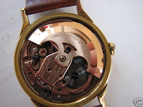

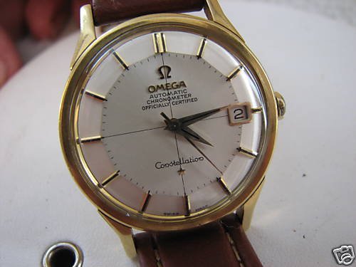

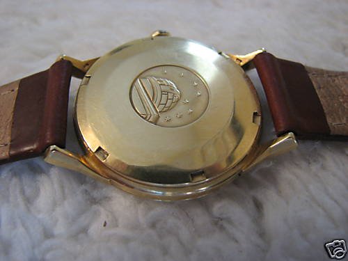

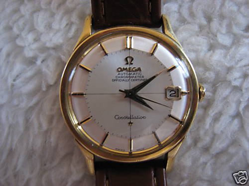

First of all, I I realise you say the pictures are from your watchmaker but if you want to sell the watch, good clear pics are a must.
Secondly, it may be the colour balance but I think your watch is yellow gold not rose as you suggest.
Value is difficult to assess as the pics really aren’t good enough to be sure all is ok with the watch.
Like a lot of gold watches, the case is quite soft through polishing.

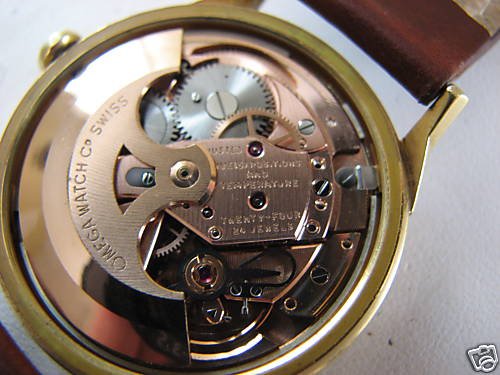

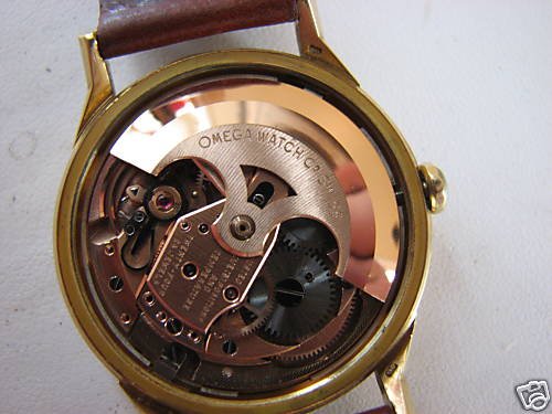

The movt requires servicing as there evidence of rotor rub and the regulator is off a bit.
Assuming the dial is ok, it’s still a handsome enough dress watch but don’t expect top dollar Constellation collectors’ prices.

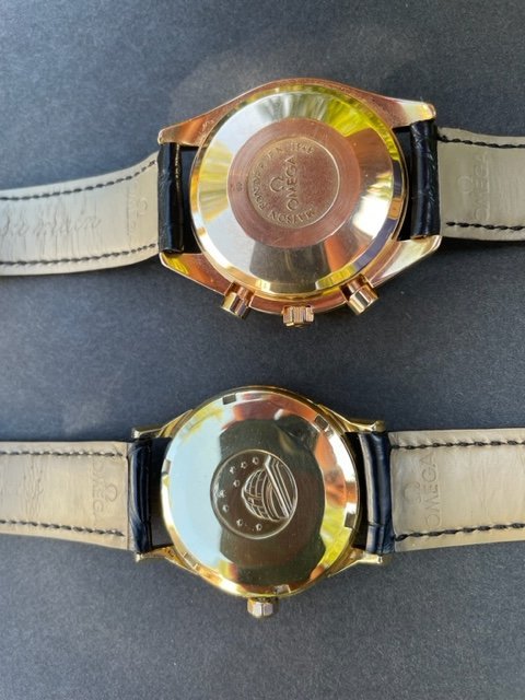

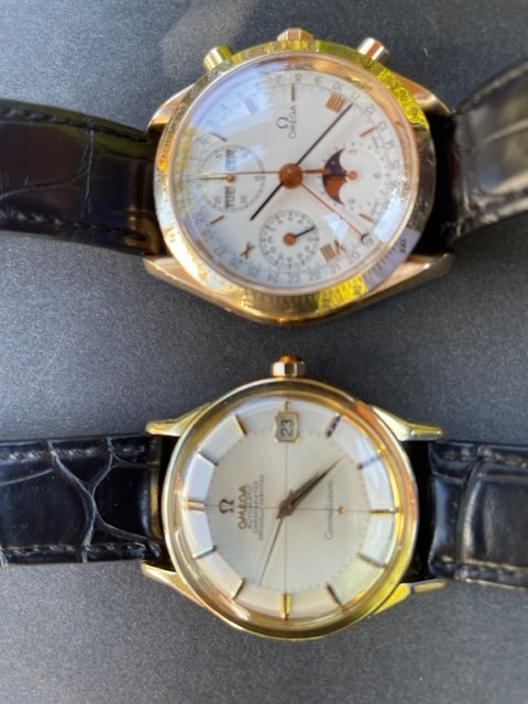

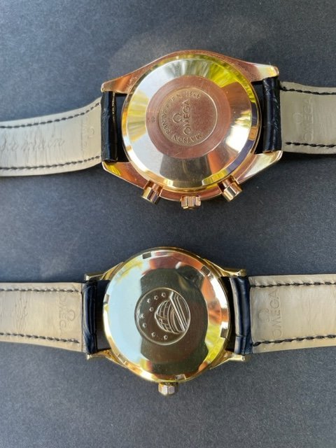

My intent was to solicit information on selling vintage watches with no expectation of a private sale. Since I have not participated previously in the forum, I reviewed the recommended instructions for posting. It stated to be direct on your request which I followed in my first sentence of my post. I apologize if my intentions were not clear.

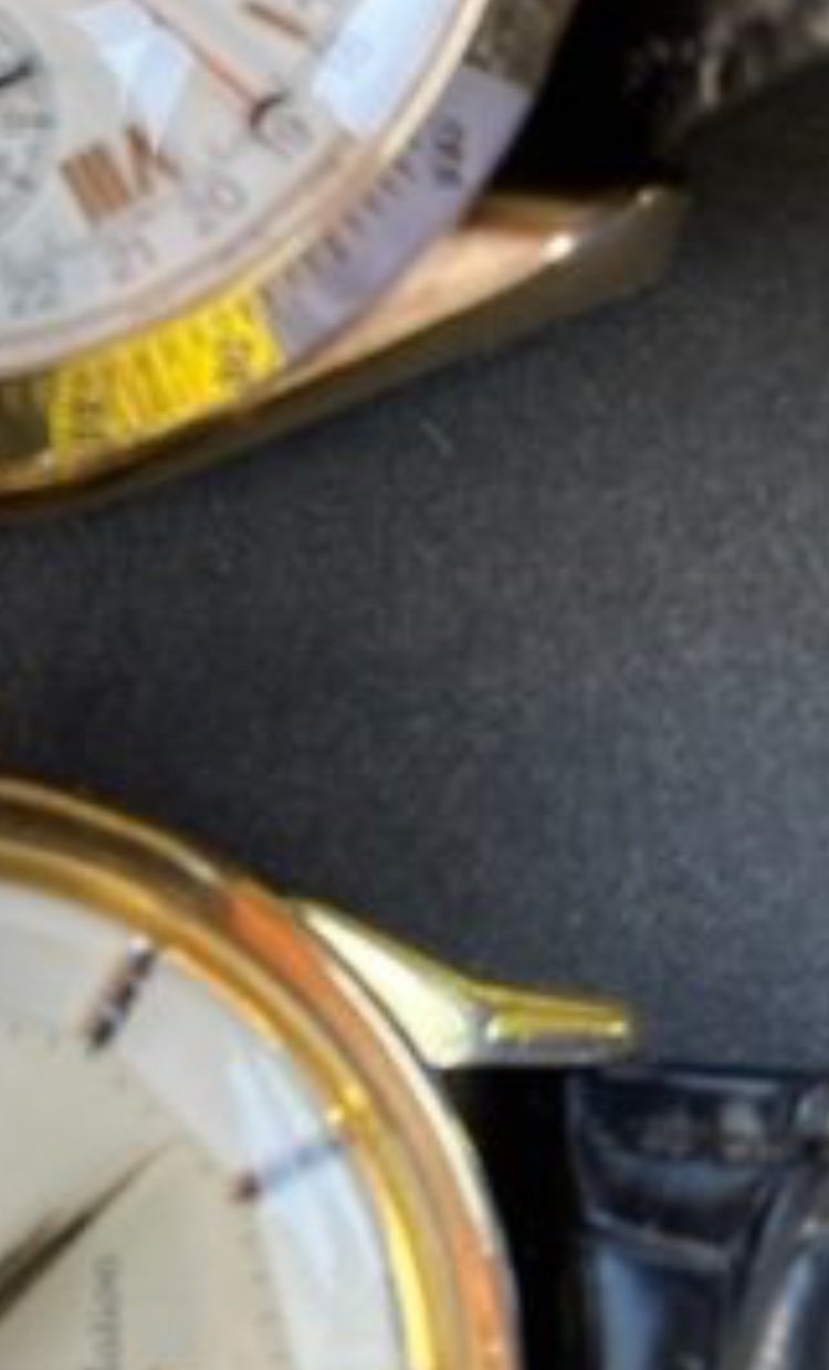

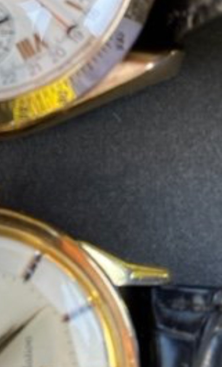

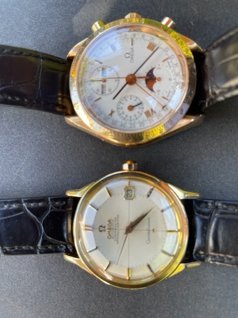

Regarding the question on whether the watch is rose gold or yellow, the watchmaker stated a "rose gold movement" in his initial description when I purchased the watch. Yet, when I compare the Constellation with my Omega Chronograph, the Chronograph has a more red/rose color (picture attached). Nesbit's has authenticated the Chronograph to be rose gold. The watchmaker may have made a wrong assessment regarding the movement. I do not intend to open the case to confirm a wrong assessment. Nor do I intend to risk having a local inexperienced jeweler scratch the case in an attempt to open it.
Has anyone encountered an Omega watch where the movement and case are different gold metals?
Regarding prices: So far, the listings of comparable Constellations on eBay are: Asking price range, $2.5K - $5.5K; selling price range - $2K- $3K for case only.

It’s a common mistake regarding the movt. ( IIRC because of something Omega once wrote)
The movt colour is a particular plating rather than gold (rose or any other)
The 50s & 60s constellation movts were all this colour - regardless of the case material.
regarding the case, Omega rose gold was very subtle in the 50s&60s.
However, you can see the difference in the lug colour of your two watches ( looks like a yellow gold bezel on the moonphase?)

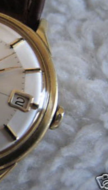

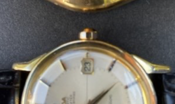

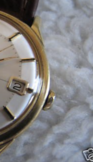

Did you change the crown?
The original pics show a correct, worn yellow thin gold crown.
The latest pics show an incorrect ‘fat’ crown.
Price
If the dial is good (still need a decent pic) due to the condition of the case, you are looking at the bottom end of the range I’m afraid.

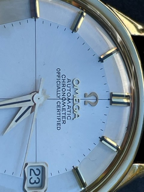

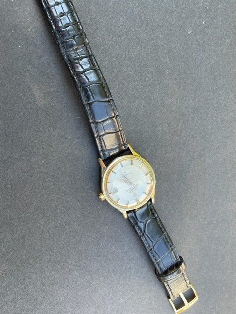

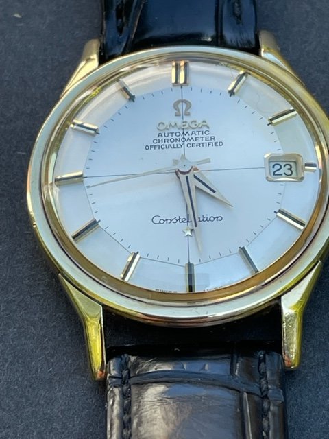

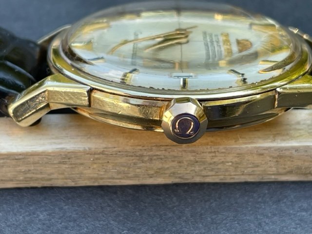

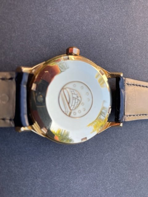

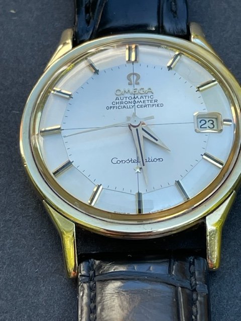

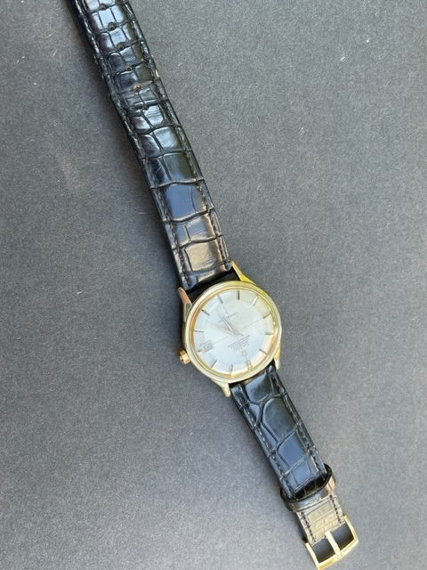

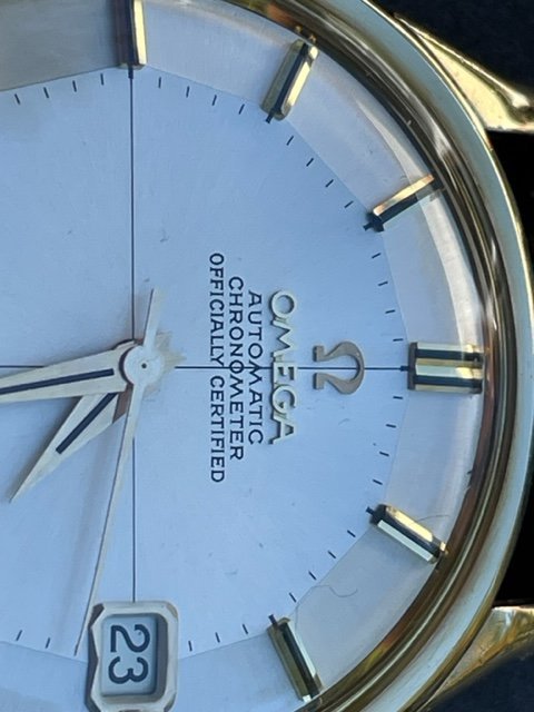

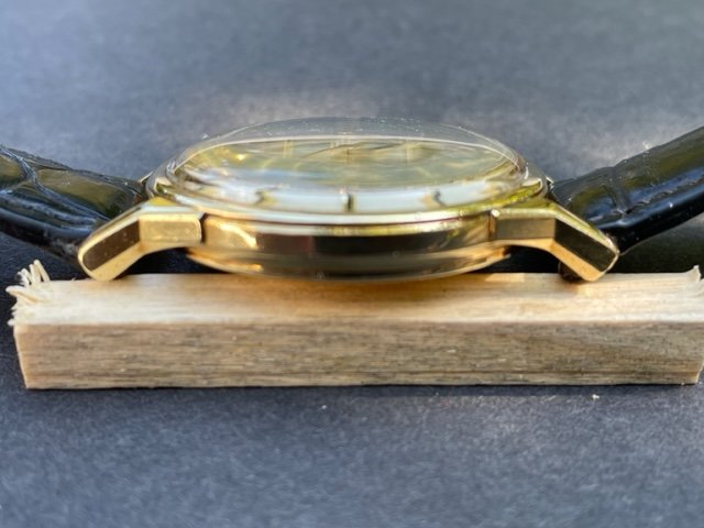

Thanks for the info. I will advertise the watch as yellow gold based on the info from this posting.

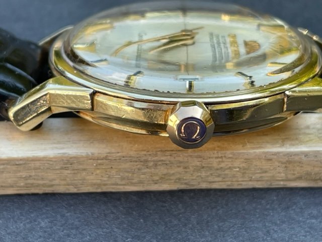

I did not replace the crown. It is the original with the watch. I did replace the band with a preowned original Omega black leather band.

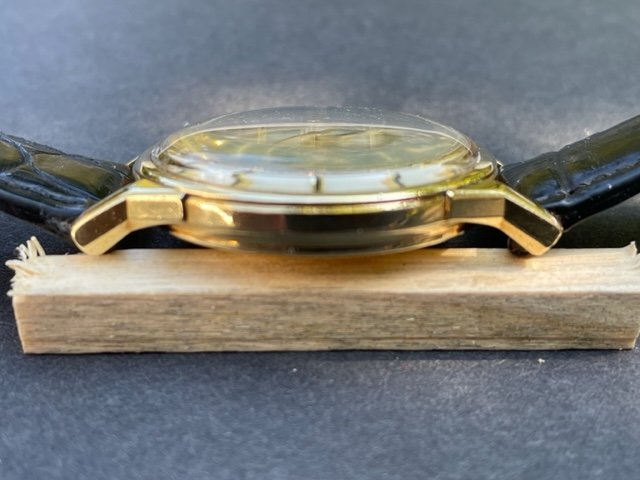

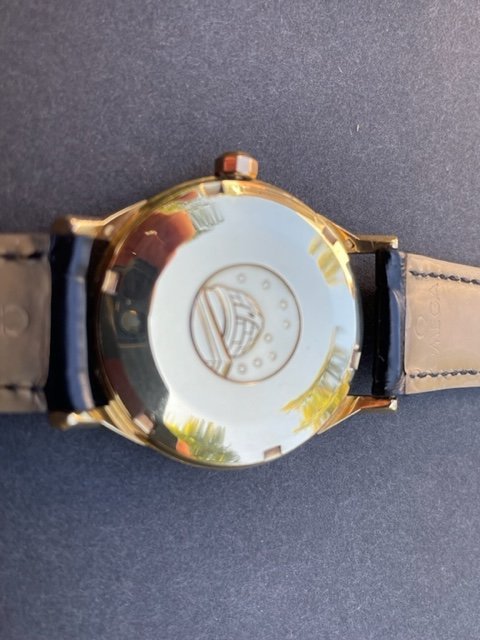

Attached are more recent pictures showing the crown, dial, and case. In my opinion, the dial, crystal and case back are very clean for a 1966 Constellation compared to listings I've seen on eBay. The case show scratches on the crown side, not much on the other side.
What do others think - high or low end of the price range?

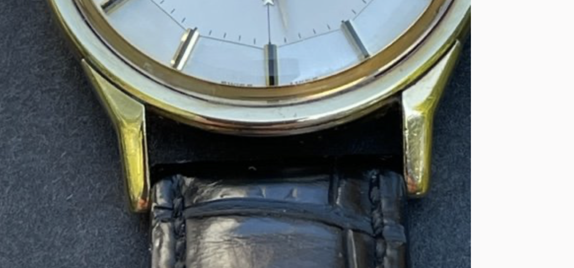

The case is very soft which will certainly prevent it being at the top end.
6,835
10,505

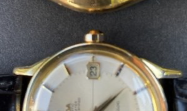

regarding the crown
the original in the watchmakers pics was this correct (if worn) thin decagonal crown
the one you show latterly is a thick decagonal incorrect replacement crown meant for earlier constellations (more or less late 50s)
(a newer replacement because it has the modern logo on it)

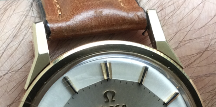

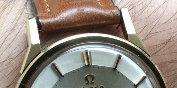

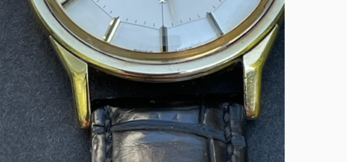

regarding case
it is quite clean and the case back does look pretty good
when I say soft, I mean the lugs have been quite heavily polished which will affect the value
compare your lugs and bezel, where the facets have all but disappeared
and how sharp they would have been originally
7
Thanks for the visual clarification on a “soft” case. That was very helpful.
As I stated earlier, I did not replace the crown. I can only assume that the watchmaker replaced it after he took the initial pictures that he used to advertise the watch when I purchased it. This is also a learning experience on trusting sellers.
