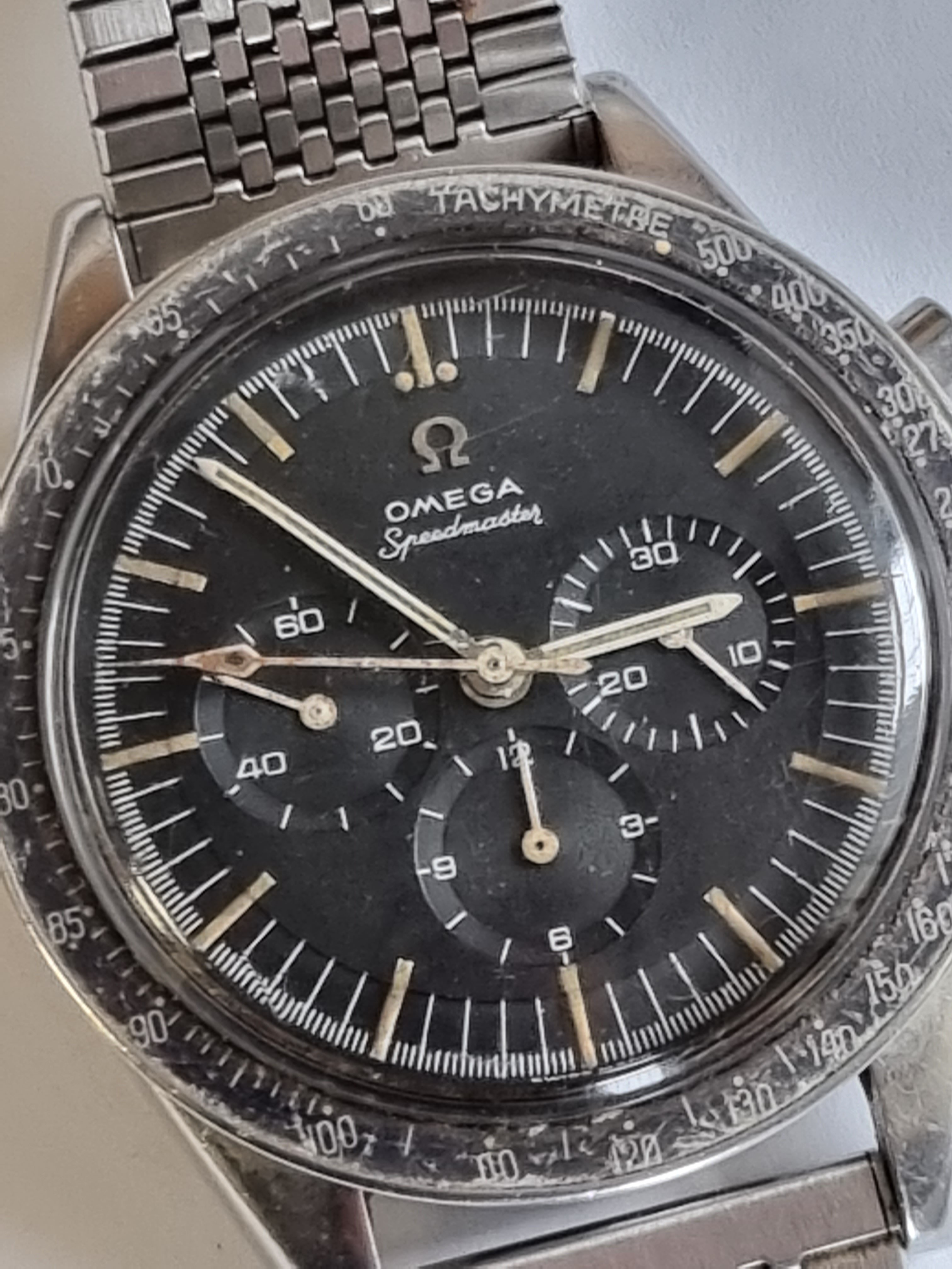

I have seen 2052's with Alphas that look original, and I have seen 19m versions with batons, that owners swear have not been altered.
The way I deal with this conundrum is to value alpha handed examples 2000-5000 more than baton hands - regardless of serial.
Here is a baton version, 19m serial, does it look original? Yes. But Is it? I cant say, so cant use it for evidence.

I found this on Speedmaster 101
"A very rare reference, produced for about six months. Initially it is actually an unchanged 2998-62, but with a new Omega reference number in line with the new number system. Then, part way through the production run, the hand specifications changed from alpha to baton. I am unclear when this happened or if there is a pattern to which hands were fitted when. I also do not think the serial can dictate which hand set is/was/should be fitted. I now believe that either handset on any serial is possible. While intuitively, we might think that the alpha’s are on early watches and batons on later, there is so far not enough evidence based on known one owner watches."

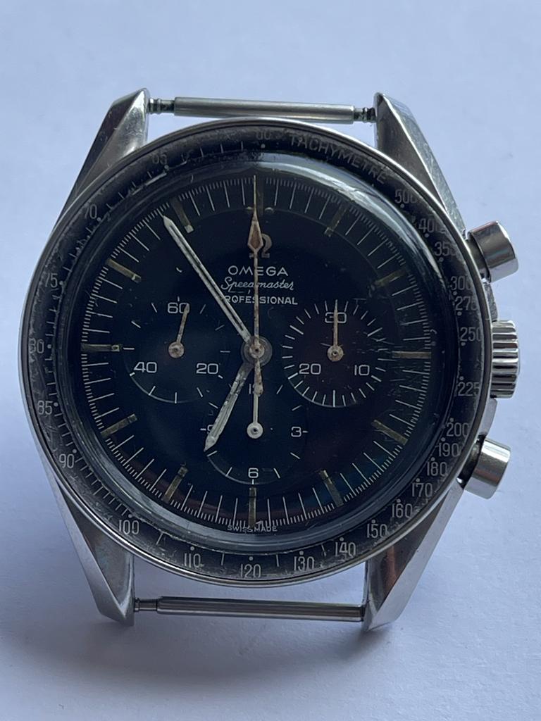

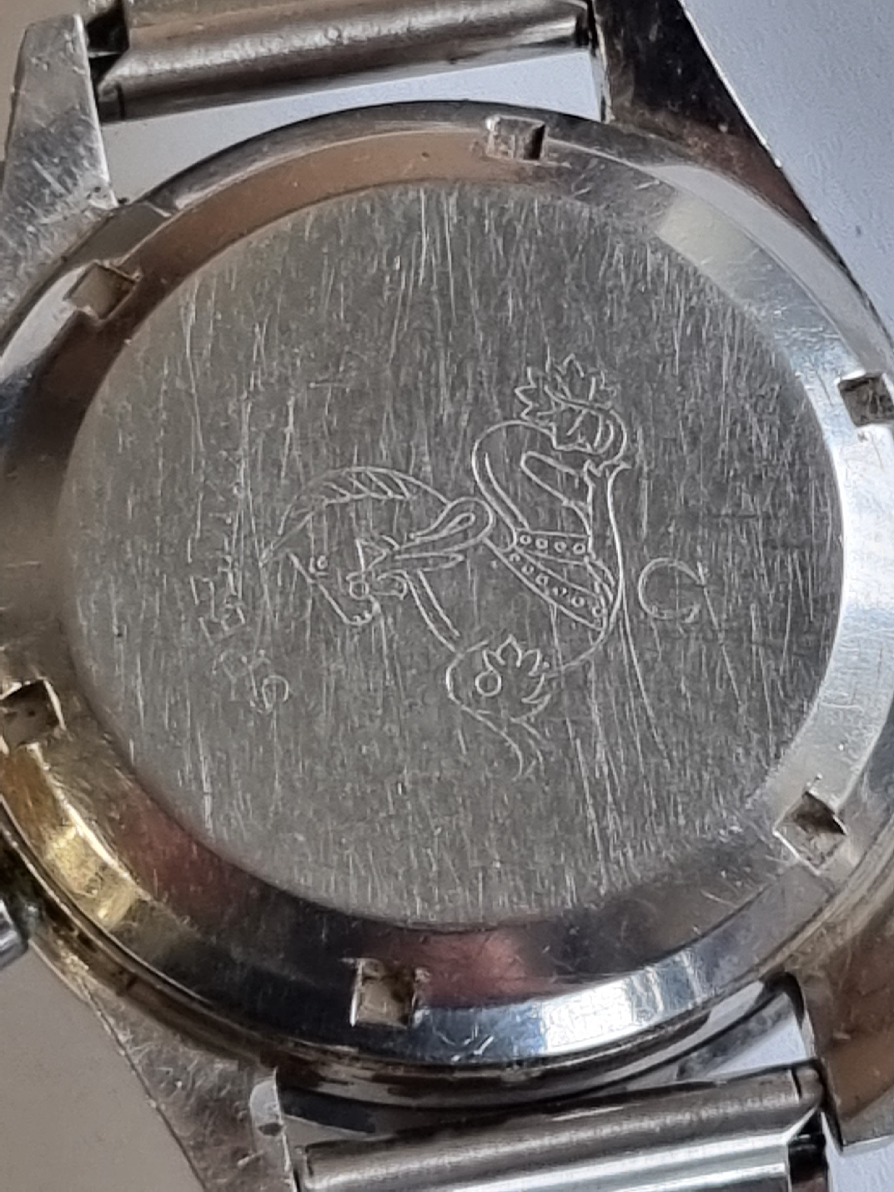

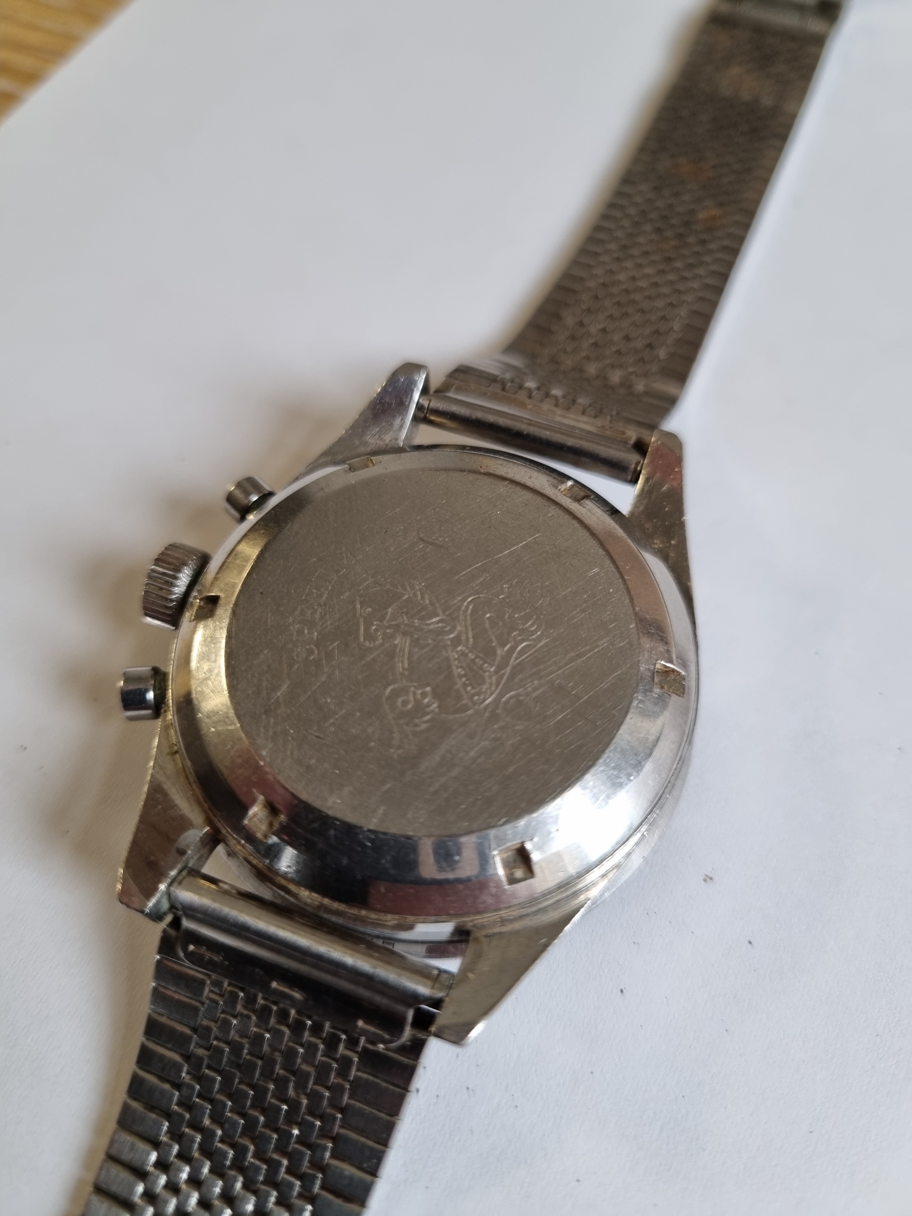

Thanks for the post, I understand the difficulty in this and I too only have the story that my Mother In Law can tell us, I have asked Simon Freese if he can give me his opinion if the watch is in its original state or if its ever been serviced before. I took a couple of more pics before it was sent off for reference.
13,556
23,504
I have no dog in the fight either way, but you can clearly see small marks where someone has tried to remove the case back. Of course this could be a watchmaker quickly removing the back or a layperson try with pliers at the kitchen table.

I will ask SImon if in his experience is it all genuine and if he thinks the watch has ever been serviced?
I wouldnt really worry about whether the hands are original or replaced, you know that either hand style is found on these and the experts are telling us nobody can really know by the serial numbers- so it doesnt matter, other than someone may be willing to pay you more for the alpha hands were they present. But they are not, and you have a great family treasure to enjoy.

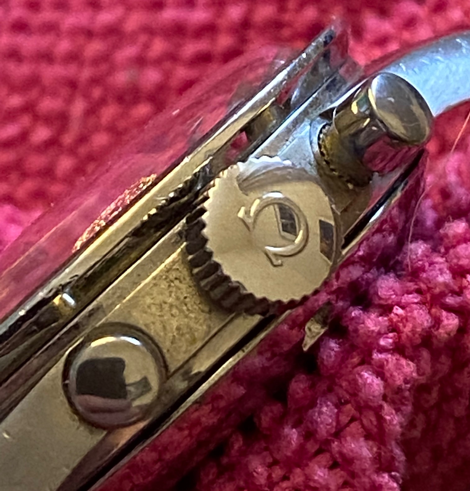

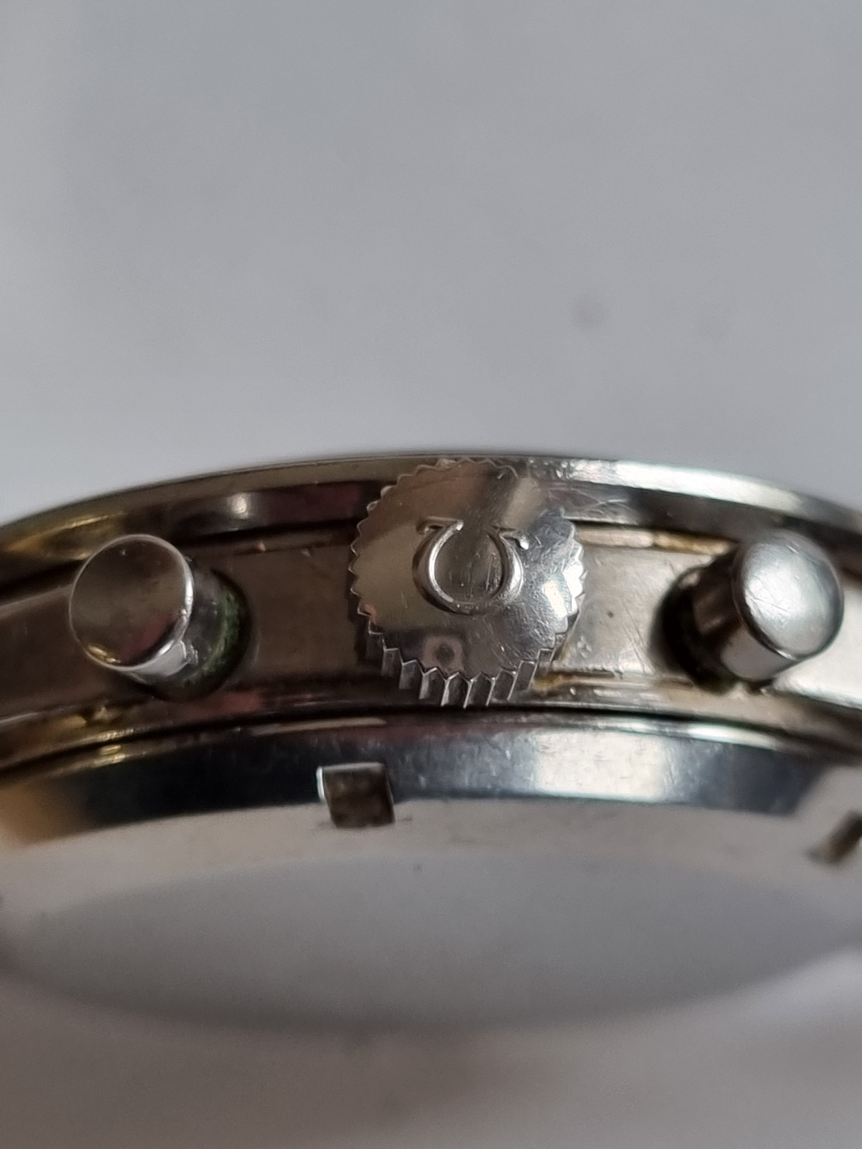

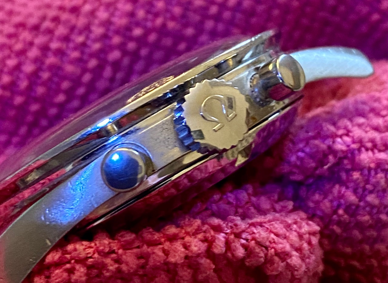

Could someone explain to me how the crown has be replaced without removing the case back!?
This is my watch with the service crown installed, like the one shown by the opener:
The same watch with a A1 crown, as it should be:

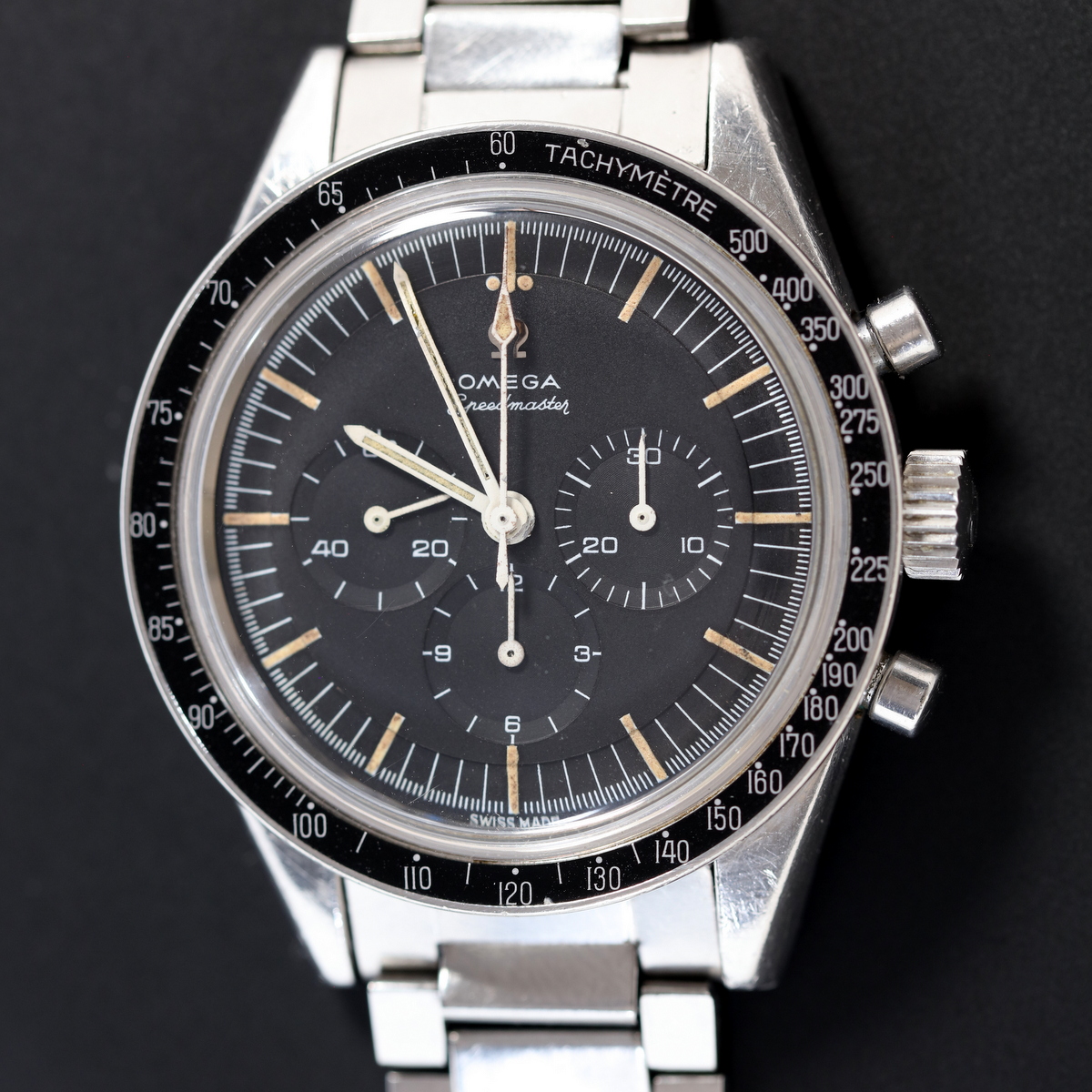

The only version of the ref. 105.002-62 that for sure were originally fitted with baton hands are the variants with the "high" Swiss Made"
dial version and a serial beyond 20.520.2XX IMHO.

Could someone tell me the difference in between a 105.002 and a 105.003 case?

It must have been an overlap of the two references 105.002-62 and 105.003-63.
In some rare 105.012-63 high "Swiss Made" dial versions can also be spotted:
Here my 105.012-63 "Swiss Made" with serial 20.520.4XX, that a friend of mine bought for me in a pawn shop in Bogotà.
The extract tells that the watch was originally sold in Spain:
The watch is undergoing a well needed revision of the 321 movement and a case restoration...

If it were mine, and I really wish it was😉 I would do the following:
it has a service crown so just replace it like for like; and apart from service with STS who are pretty good and have worked on a few of my watches, polish the hesalite, and keep everything else as is, and really cherish it 😉

Umm the post above by ortope makes a pertinent point. There is no way the OP watch left the factory with a 32 tooth service crown, ergo it was at some time serviced, which is rather at odds with the assertion that it was never opened. It doesn't follow that any of the other parts are necessarily not original, but that and the marks to the caseback do rather suggest some kind of previous intervention, regardless of the family collective memory otherwise.

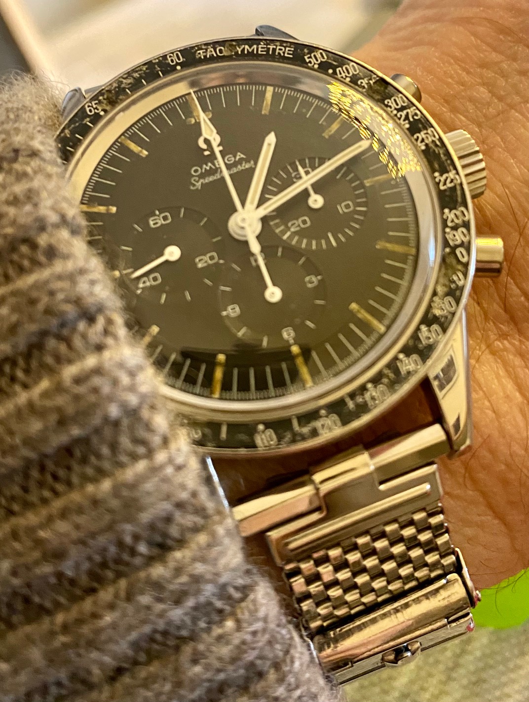

I don't think the paint is missing from the hands (near the center of the dial) just because they have been sitting untouched in the watch.
3,678
8,007
So the evidence of a prior service includes a service crown, toolmarks on caseback, and central paint loss on the hands. While tempted to conclude "case closed", a more correct statement here is "case OPENED"
But this still does not prove that the hands are replacements, with the uncertainty of date of transition.
