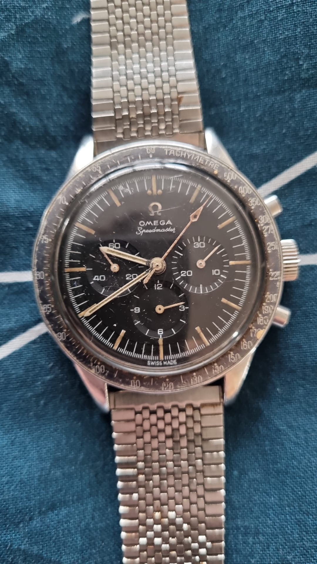

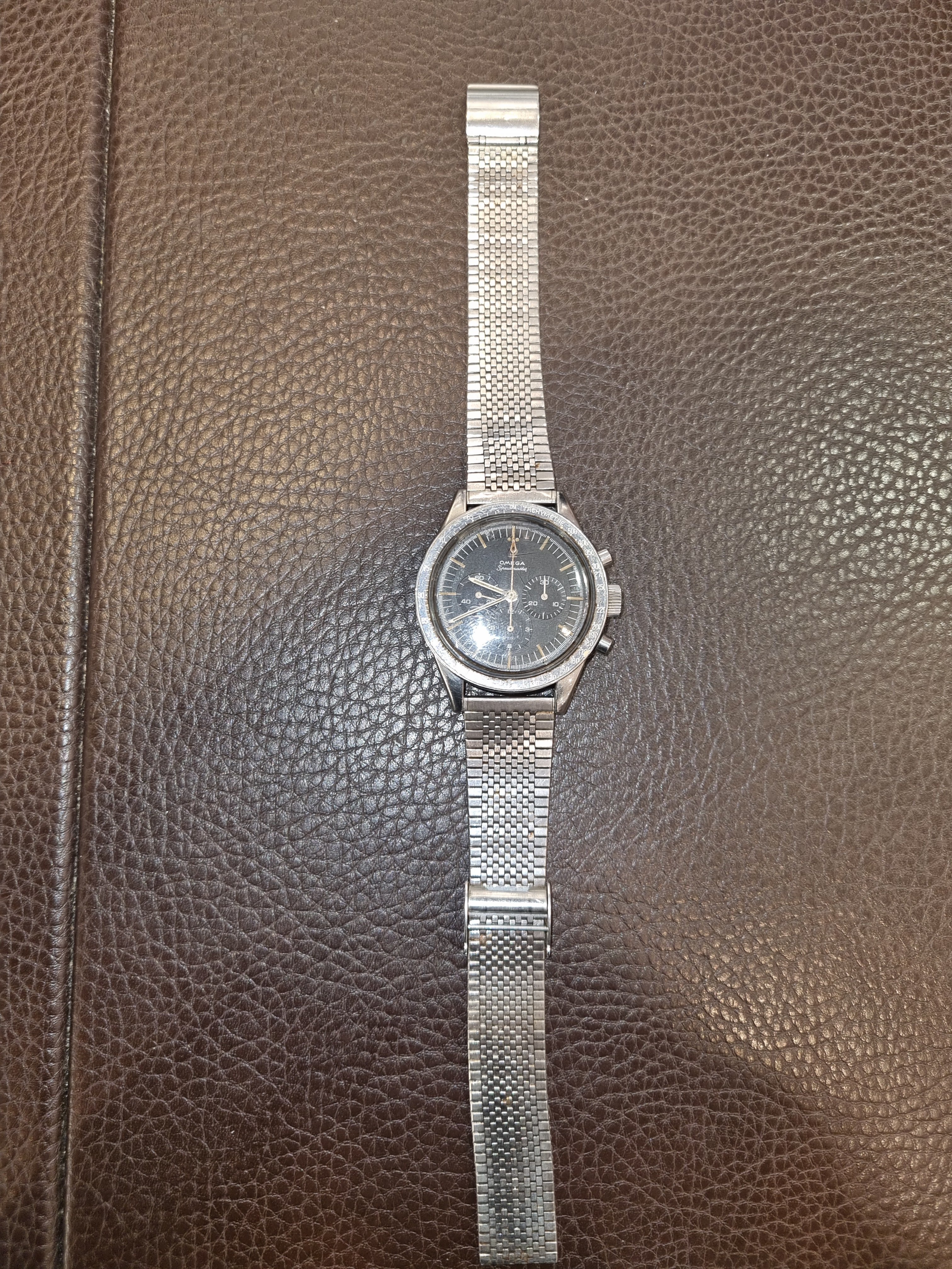

Hi, my name is Dave, I have been recommended this forum for some help. I don't know much about watches and I have never really been a wearer. I was given my father in laws watch when he died 20 years ago, unfortunately at the time I just thought it was a piece of cheap rubbish (i didn't know what omega was). Anyway, last week my son asked if he could wear that old watch to his prom to which I said yes, the next day 2 men at work were talking watches and I happened to mention that I had an old watch and proceeded to tell them what was wrote on it, they were a little gobsmacked that I didnt know what a Speedmaster was but hey, if you know you know but if you dont you dont. I took it to a jewellers and to cut a long story short it has now been sent off to STS for a quote to service it. The help I need is knowing what to have serviced, what to have replaced without ruining the watch and keeping it as a collectable. I appreciate any help I can get please. Even just general advice on the watch would be helpful and many thanks in advance.
My son wont be wearing it to prom now I know what it is!

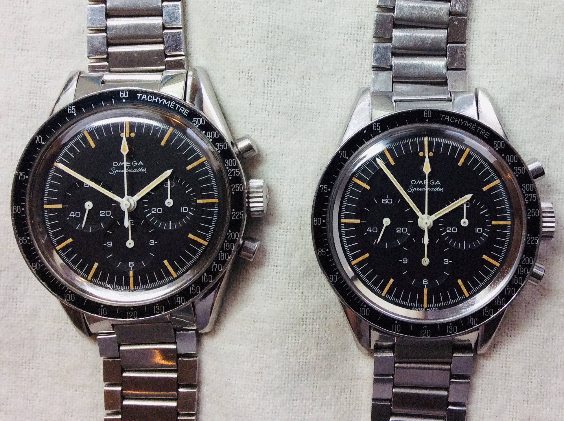

I’ll wager that you are the proud owner of a Speedmaster reference 105.002-62.
A very limited production reference, circa 1963.
Here are a couple of more pristine examples.
PS. As you can see your watch, while worn, appears to contain many original components.
The bracelet is not original.

Hi Gemini, while very early days for me as a Speedmaster owner I assure you the reference number means nothing to me but i do plan to learn. Could I ask, do i have any cosmetic work done or just leave it as it is and have the full movement serviced?

I would do no cosmetic work personally. Just clean and service the movement and keep the rest original.
IF I wanted any cosmetic it would be to the chrono hand which could have the paint and lume touched up, or replace with a period correct one in better shape. But I don’t think I would, it is tough to get it to look right after such a swap.
