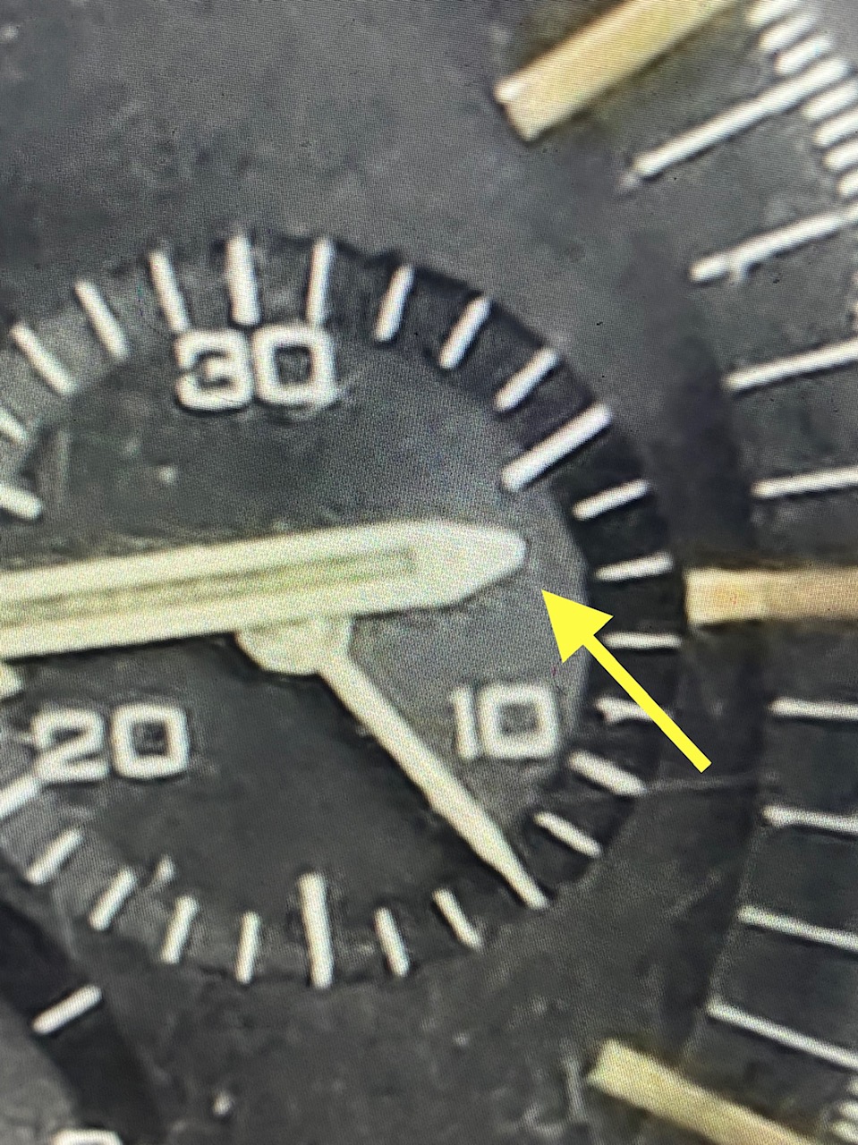

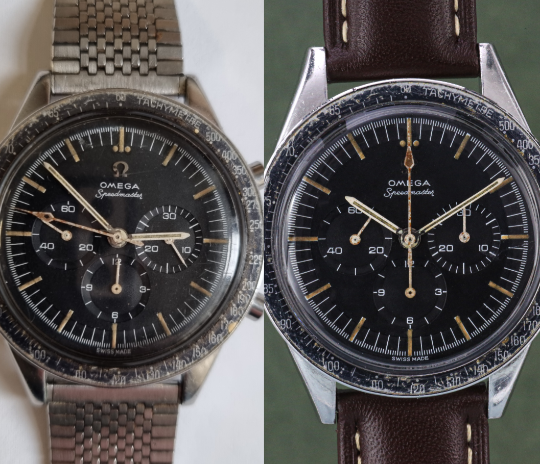

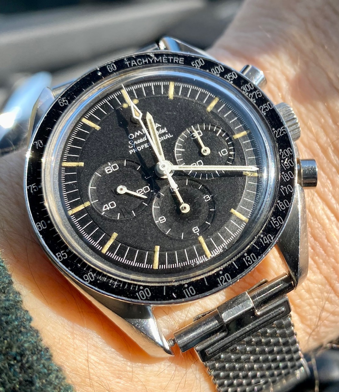

Another little suspicion that something isn't 100% correct with the hands of the openers watch:
The shape of the hand's tip is blunt and not pointed how it should be!?
This is a picture of my 105.012-63 asymmetrical "T" (20.521.XXX) sold in Mexico 29th May 1964, that apparently still has its original hands.
Note the difference...

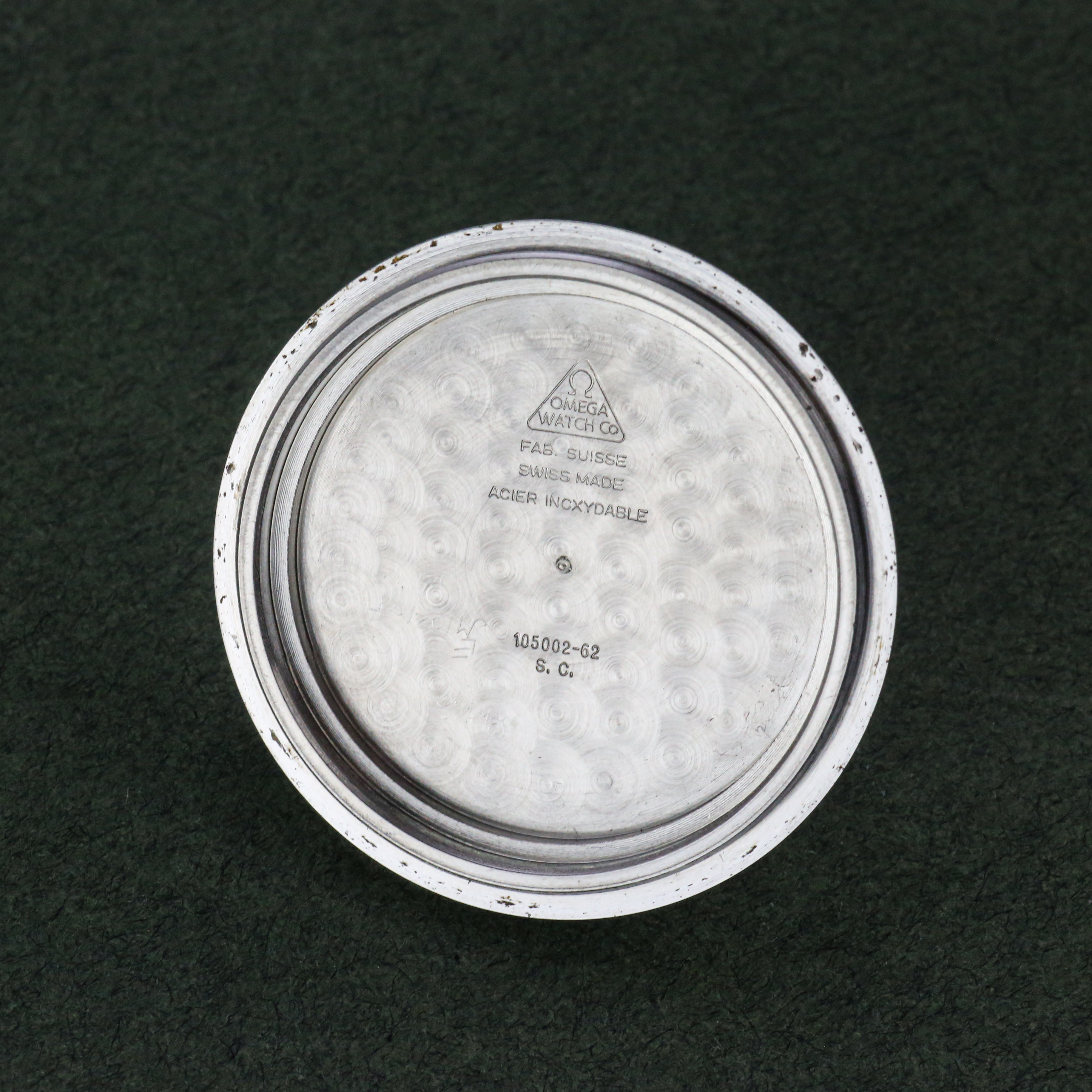

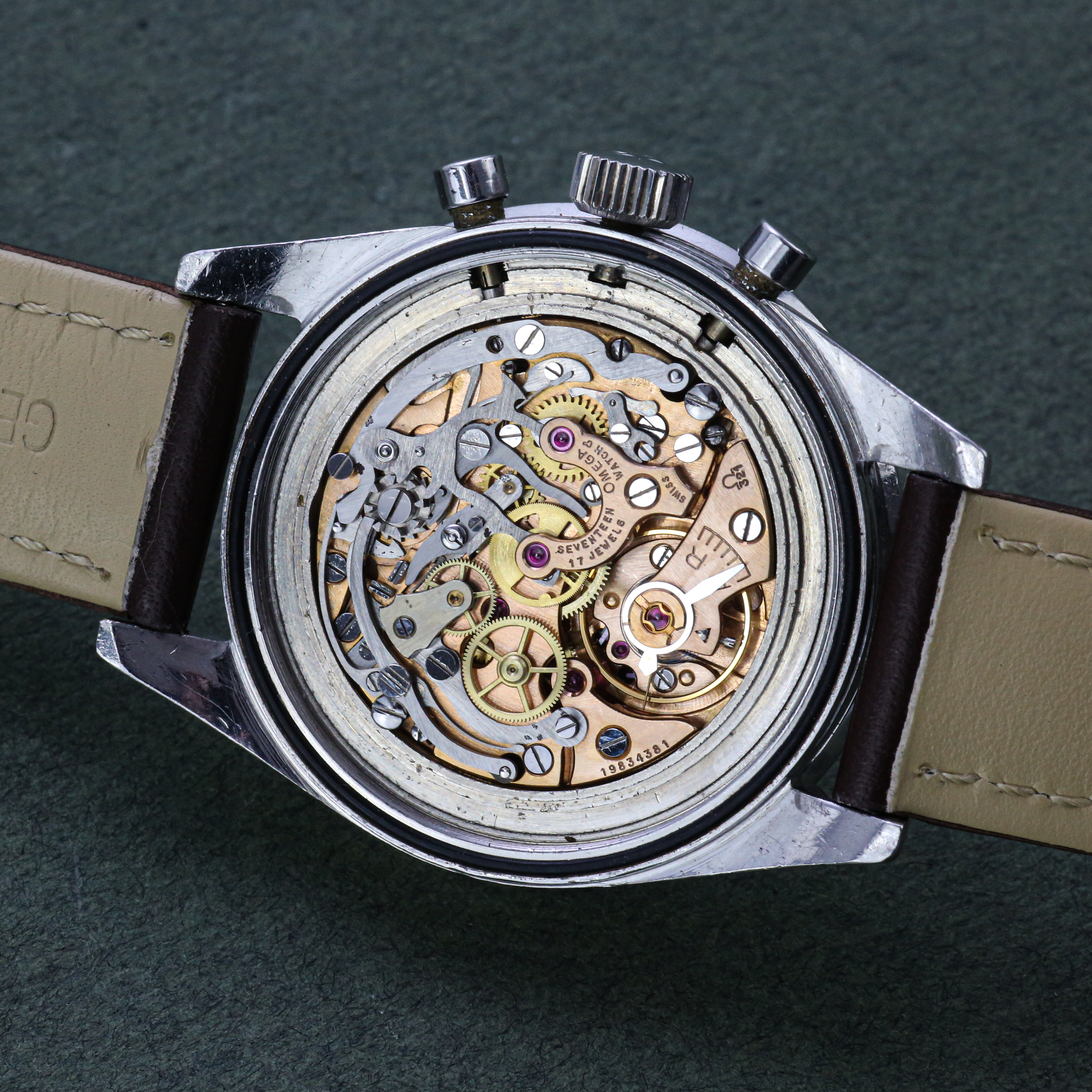

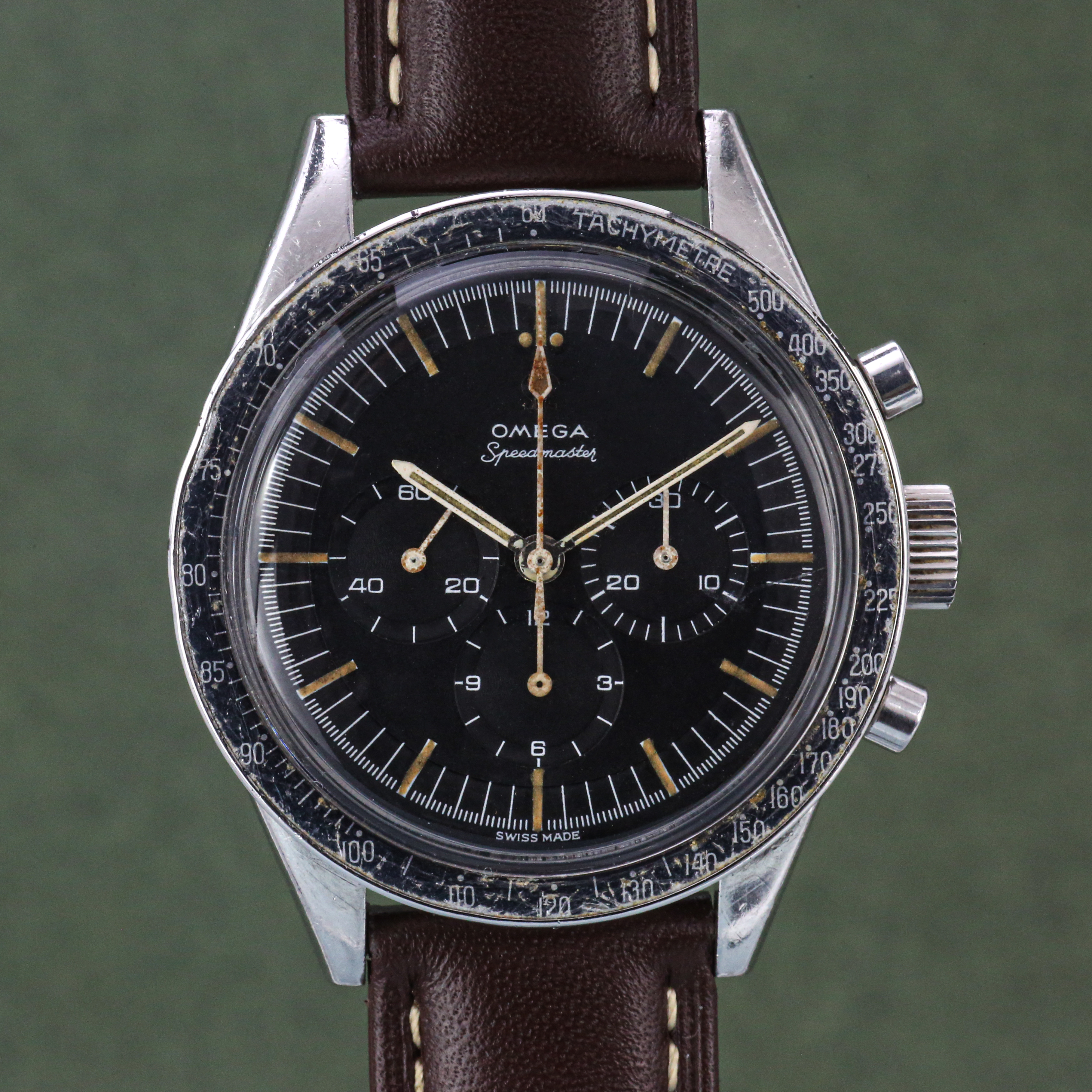

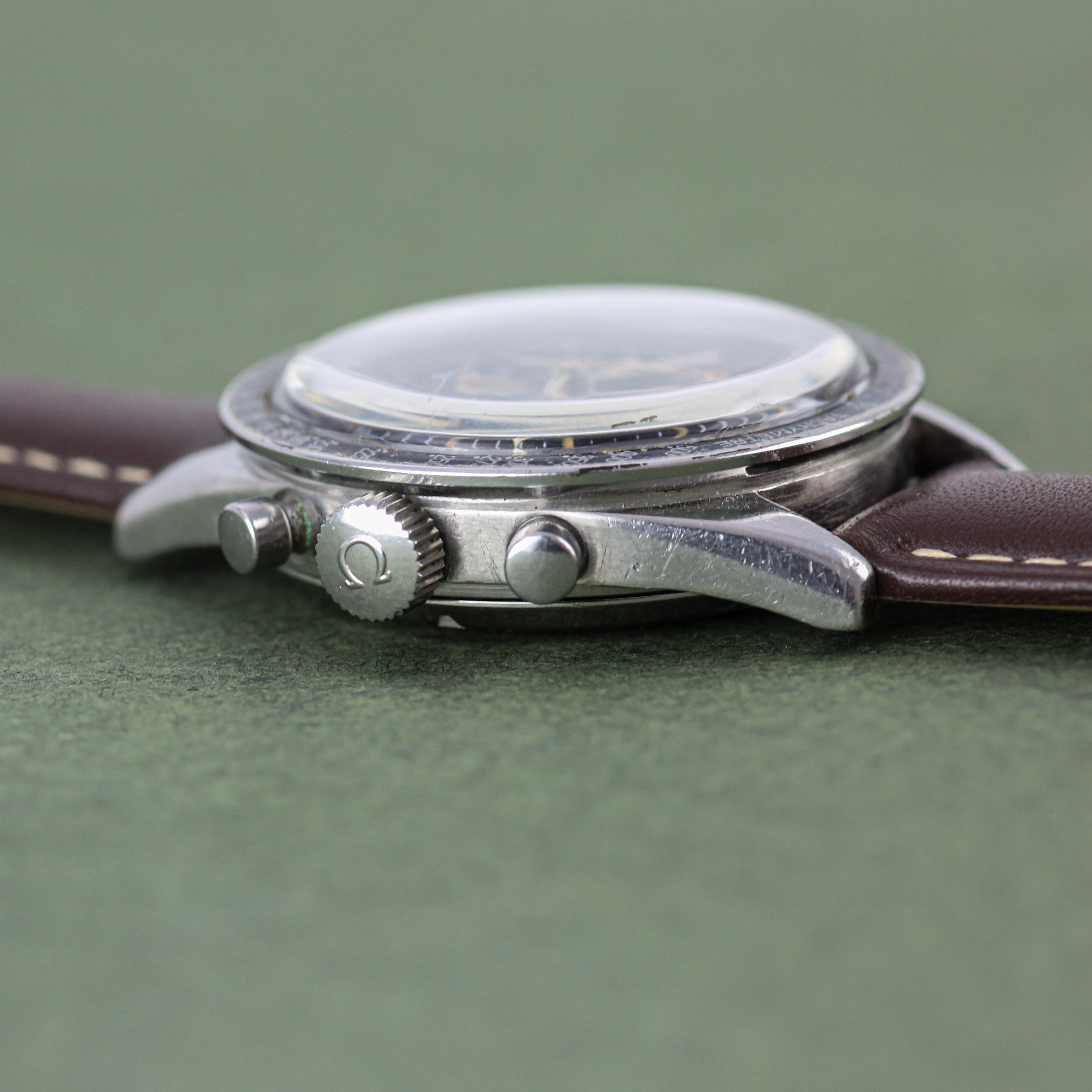

Amazingly Simon has sent me a report this morning, I need to have words with the Mother In Law about her memory ha! He could of had it serviced without telling her, report is below
Dear Dave
Thank you for your email, I have checked the watch for originality and evidence of previous work.
The watch has three watchmaker engravings in the case back, which would suggest that it was repaired at least three times. There are slight marks on the movement screws, showing that it has been disassembled before. The movement ring and dust cover have scratched from previous removal. This is all quite normal for a watch of this age.
The crystal is original as you can just see the original thin Omega logo at the centre.
The pushers are original

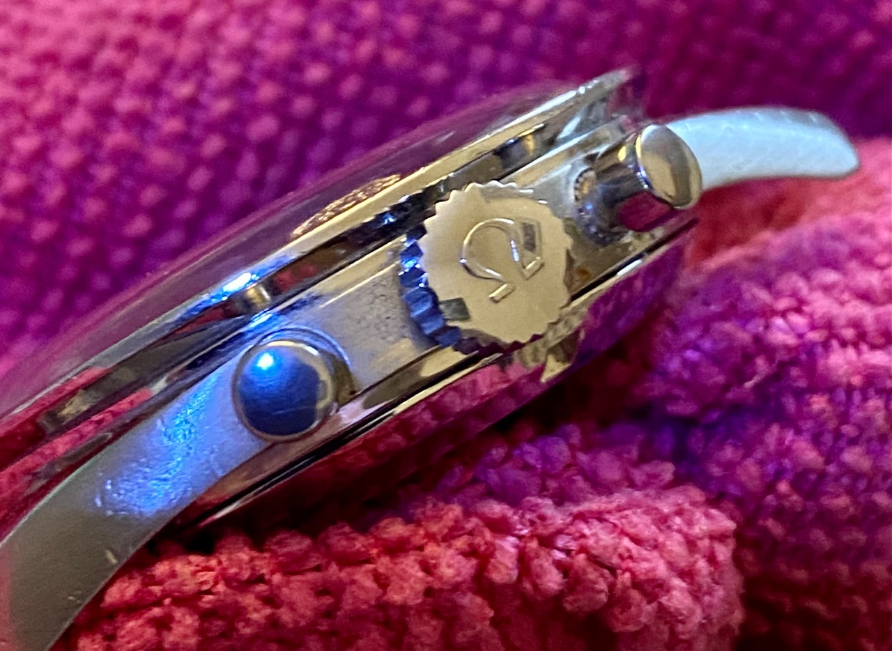

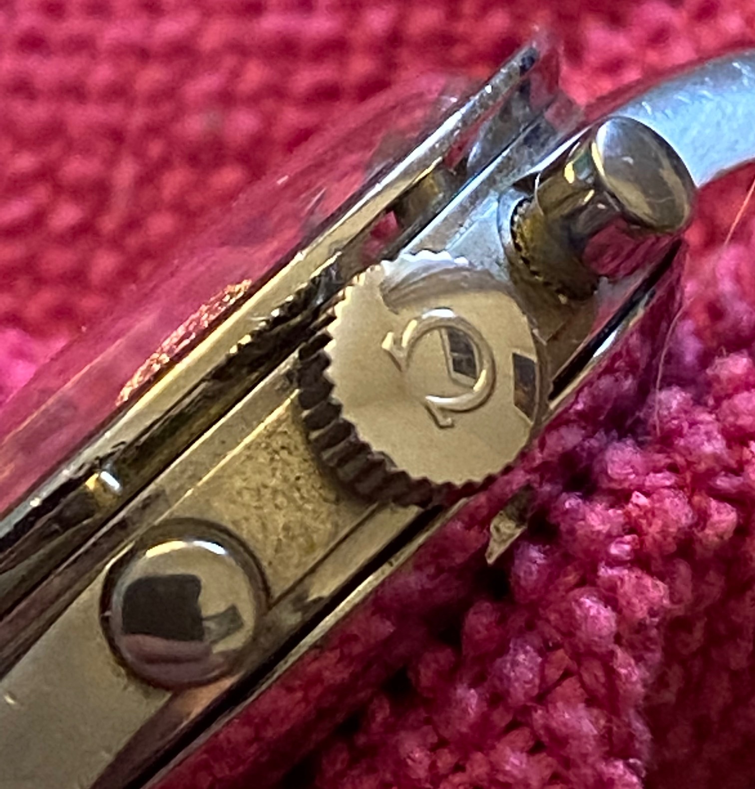

The crown is a service replacement from slightly later in Omega’s production it has 32 teeth rather than the 24 of the original. This could have been replaced as far back as 1970.
The bezel is original.
The dial and hands are original, they have an attractive patina and I will be sympathetic towards this when I stabilise the hands.
The 105.002 is indeed a relatively rare reference, as it was quickly superseded by the 105.003, which was in production for a number of years
I will proceed with the repair and be in touch as soon as the watch is ready
Best wishes
Simon

hands are original
Ok... But like @ortope , I still don't understand the round shape of the hour hand.
This model is however a rare treasure...👍

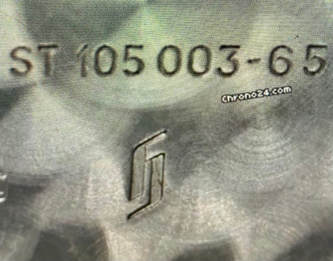

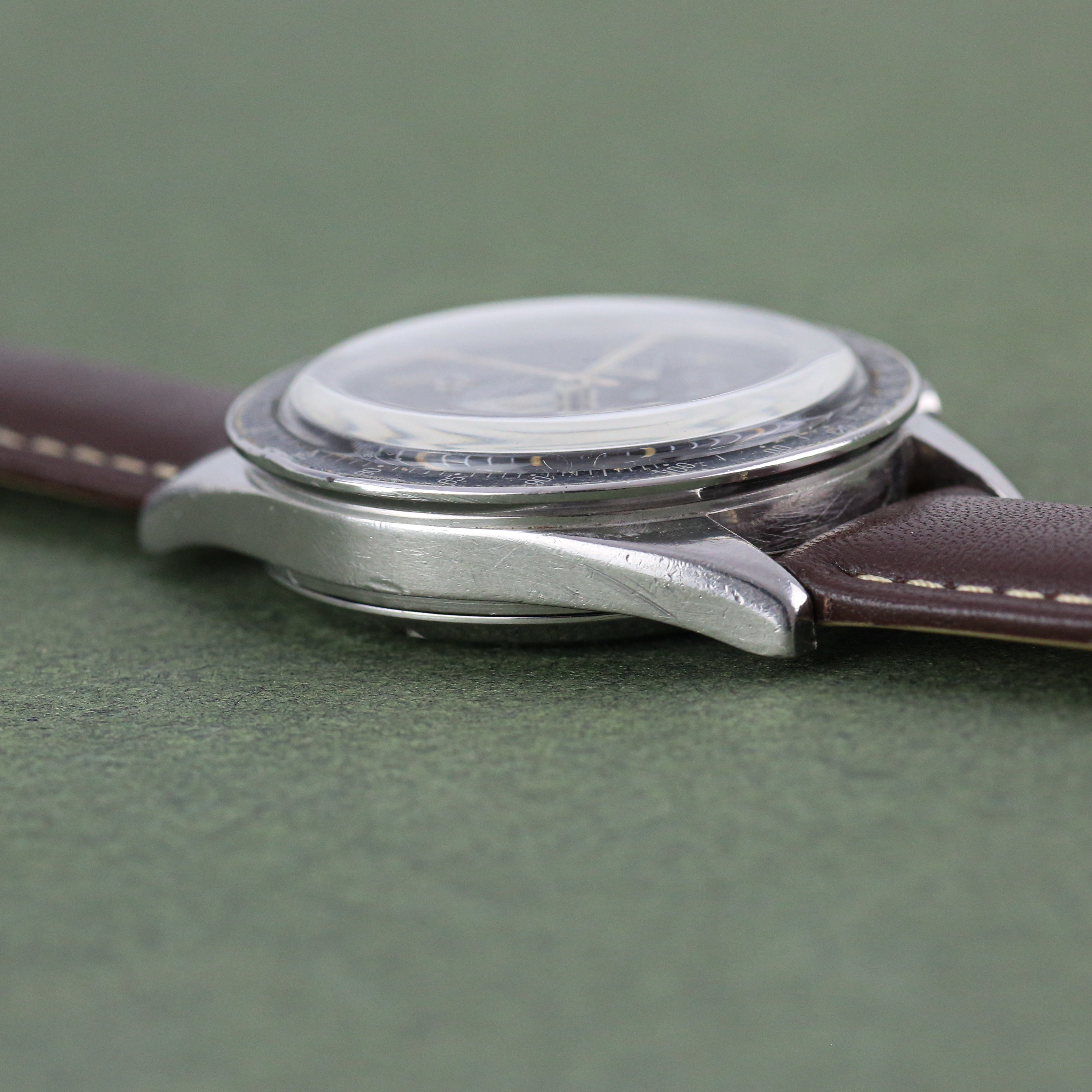

No answers received yet:
Does anyone know the difference in shape in between a 105.002 and a 105.003 case?
Cheers
The picture isn't fully clear cut. Some 2998 examples seem to have distinct lug bevels/facets, others just a compound curve lug profile. Same for the later Ed White. What is certain is that the 105.003-65 has distinct lug facets and is made by a different manufacturer to all the other earlier cases which were I think made by Hugenin Freres (HF). The first two 105.003 iterations, the -63 and -64 seem to have the curved lug profile. A better question might be does the 105.002-62 have the same case profile as the 2998-62 and 105.003-63? I suspect the answer is yes, but does it match all the 105.003 and 2998 versions? It seems not. Those with multiple 2998s might have more of an idea than me but we've gone down this rabbit hole before and it often ends in people claiming that all the examples with bevels were refinished that way, which personally I think is nonsense.
362
597

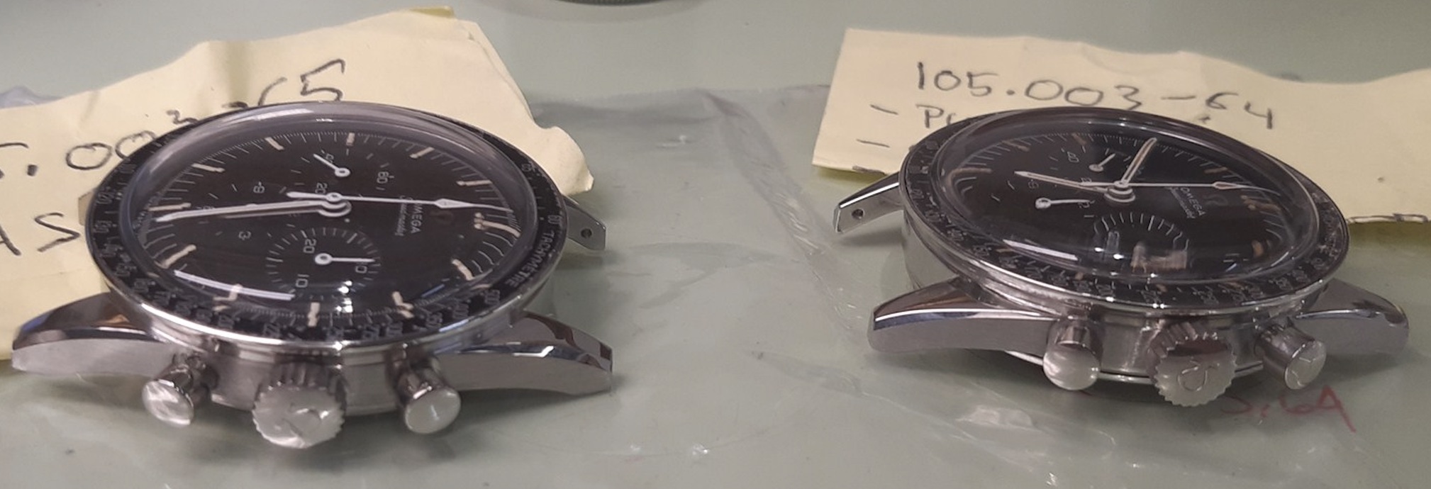

The small difference can be seen on following pictures:
105.002-62:
105.003-65:
To be honest the 105.003-65 is from a different case manufacturer, not from HF, but as far as I can remember the other 105.003-64 that I own has the same shape.
on the left a watch with the case from the unknown producer, on the right the one with the HF case
Unfortunately I didn'tt find a picture of the case back's inside of my 105.003-65, but I found this one on Chrono24:
Cheers
10,806
16,814
See what I posted above. No the -64 and -65 do not have the same shape, as you say (and I already noted) they were made by different people. If the watch on the right you show is indeed a -64 then it has been refinished and bevels added. The lugs on the -63 and -64 HF cases did not originally have defined bevels, the -65 did. This is why the modern NEW321 reboot has no bevels as it is a carbon copy of the -64. As I say this rabbit hole is deep and has been discussed many times here.

Nice watch, indeed, but I would have changed the crown...
44
61
Changed the crown for a new one or find an original?
