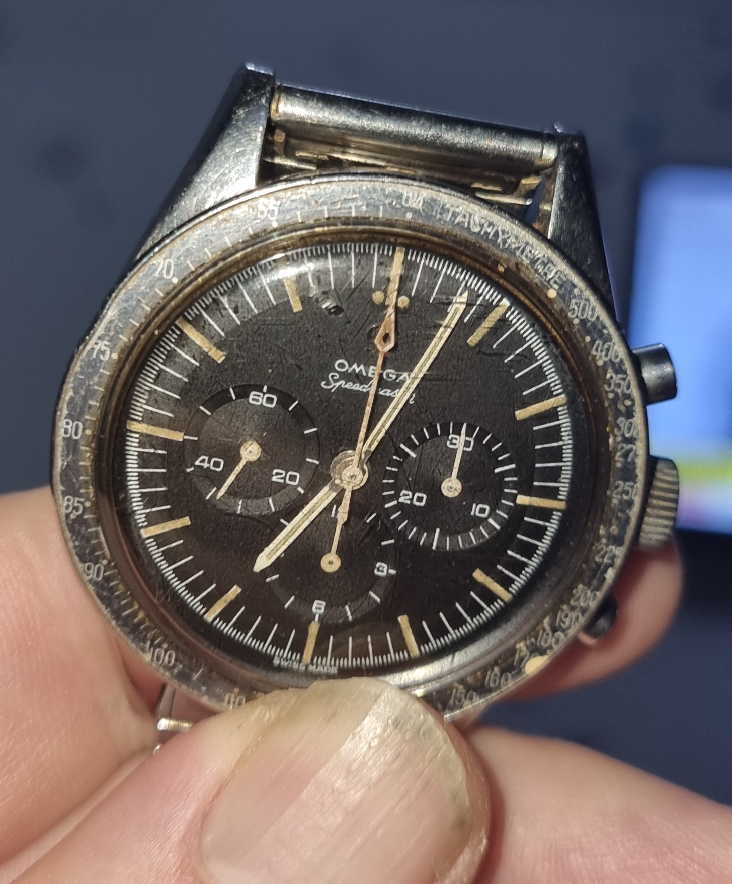

Hi, just a little update, I returned to the jewlers today to see if the watch was still with them as I wanted to get some more pictures, turns out it was dispatched to sts on Monday. However, the jewlers had taken about 40 pics of the watch which he showed me, in his opinion they are all original parts except the strap obviously. Here are some points raised,
1, He thinks the fingers wont be able to be saved (obviously he is not an expert and that was his opinion), there is a hole in the tachymeter finger.
2, The bezel has quite a dent in it, I like it and it tells the story of how the watch was used everyday while digging holes. The jewler said that sts may say that it must be replaced to warrently their work.
3, He said as standard sts will replace the crystal, is this true in everyones opinion.
4, STS will prob cost me between £1000 and £2000, could I ask if it was your find would you be willing to spend that kind of money on this watch please?
I am really excited about this and having watch become a wearable item again, what strap would you put with it? It has a smaller face than newer models so not sure the big metal strap would fit the or match the watch.
Many thanks,
Dave
You are not getting good information or advice from your jeweler, they are not treating your watch like the vintage collectible that it is. I seriously doubt that the jeweler is qualified to determine whether the parts are original, especially the crown and pushers. You need to post good photos of crown/pushers on the forum, this is probably the major unresolved issue and will impact your decision.
The sweep hand (not finger) can be re-lumed if you would prefer that to the hole, as I mentioned on watchuseek. I would definitely not have it or any of the hands replaced. That's terrible advice.
I would also not have the bezel replaced, a new service bezel would be a waste of money.
If STS requires replacing hands and/or bezel, just have them return it and send the watch to Simon Freese directly. In fact, why not just do that right now. The idea that you will have to communicate indirectly through your jeweler is a total dealbreaker.
Regarding your email to STS, respectfully, I think it's somewhat TLDR and a bit confused with incorrect terminology. If I were reading that at STS, I'm really not sure what I would make of it. It would be best to slow down, gather your thoughts and compose something clear, concise, and accurate.
You are right Dan, I need to get the watch to Simon but STS have it now so I will at least let them send me a quote prior to having it returned.

While I am still waiting for STS to get back to me I found a pic I took of the watch which I had forgot about, as you can see, its seen better days
13,556
23,504
You’ll be surprised how nice that will looks with a good deep clean and a polished/new crystal.
Speak to STS about hand choices. If the paint is flaking, getting the repainted in off white and resumes to match the dial might be the best option.
