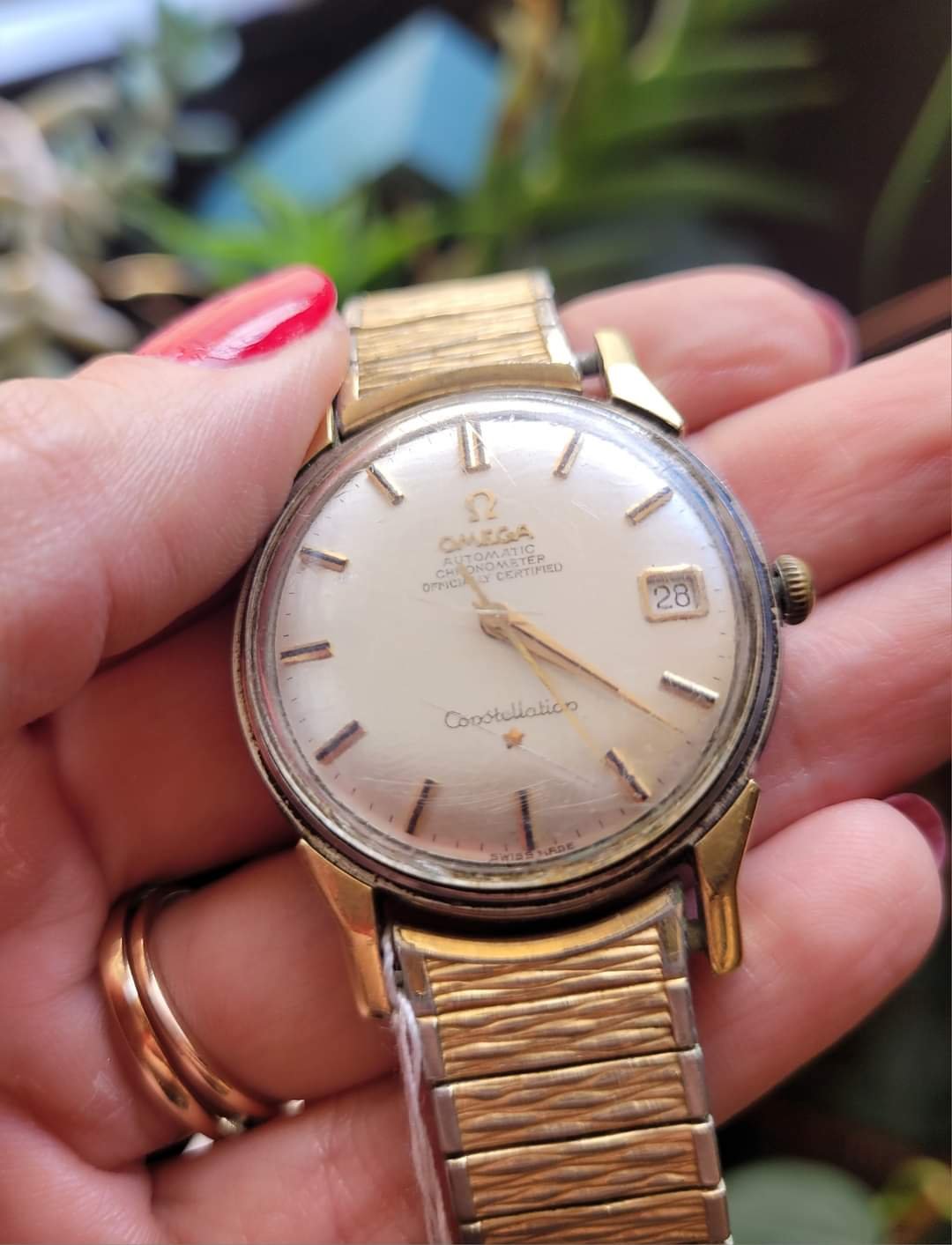

My wife picked this up for me today from a thrift store. My understanding is it needs a bezel which may be hard to come by. It also has a no name crown on it.
Looking for any info on the watch and it's case number designation. Also any tips on searching for a bezel either original or not.
Also what's the story with the case. It appears two tone, the case seems stainless and the lugs are gold plated I assume. Not seen one like that.

Unfortunately the bezel will be near impossible to find.
These were 14k solid gold and was possibly scrapped.

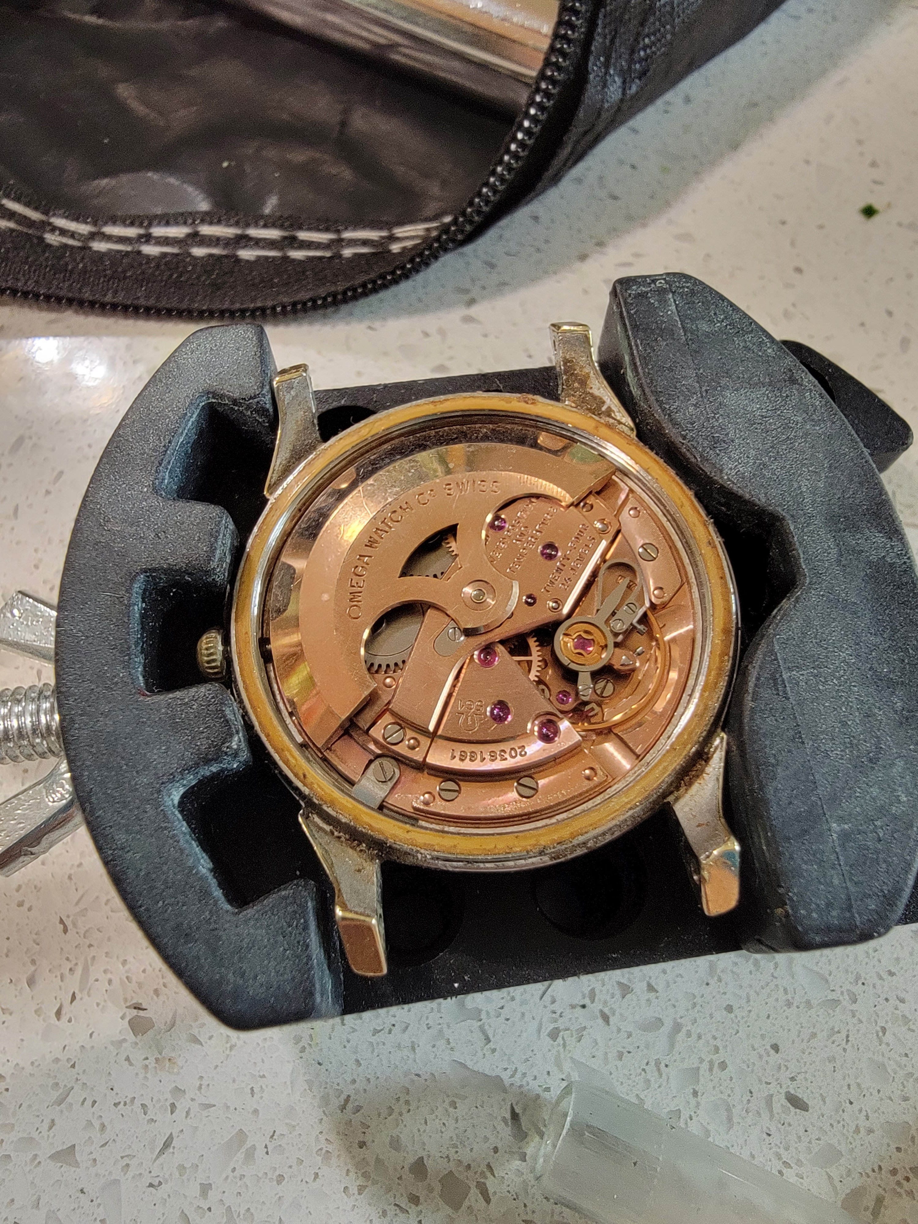

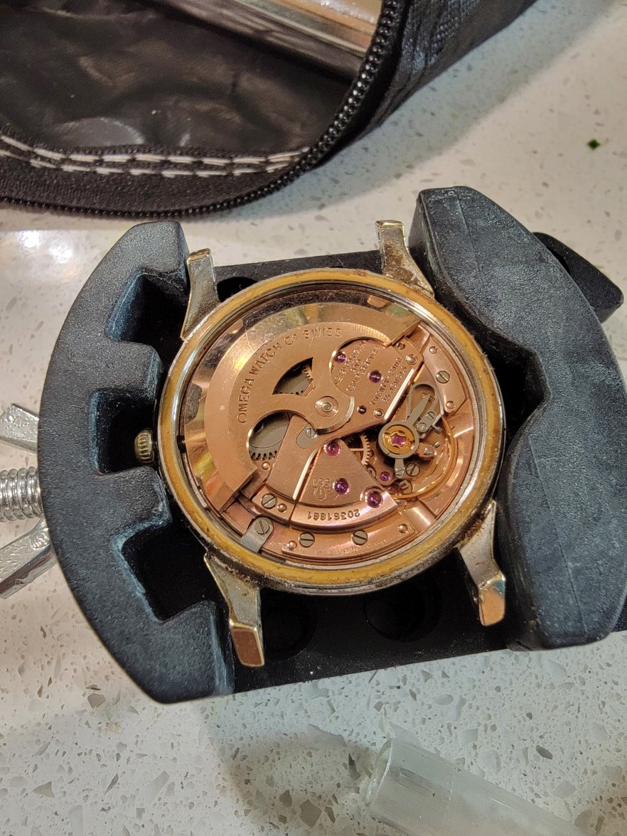

The watch is a gold capped dome dial most likely ref 168.005 known as a dogleg Constellation.
( there is an outside chance it has the earlier reference 14902 - the reference is inside the case back)
Cal 561 movement.
The dial looks good from the photos.
You’re pretty much spot on for the date.
The Bezel would have been gold which is why it was probably melted down

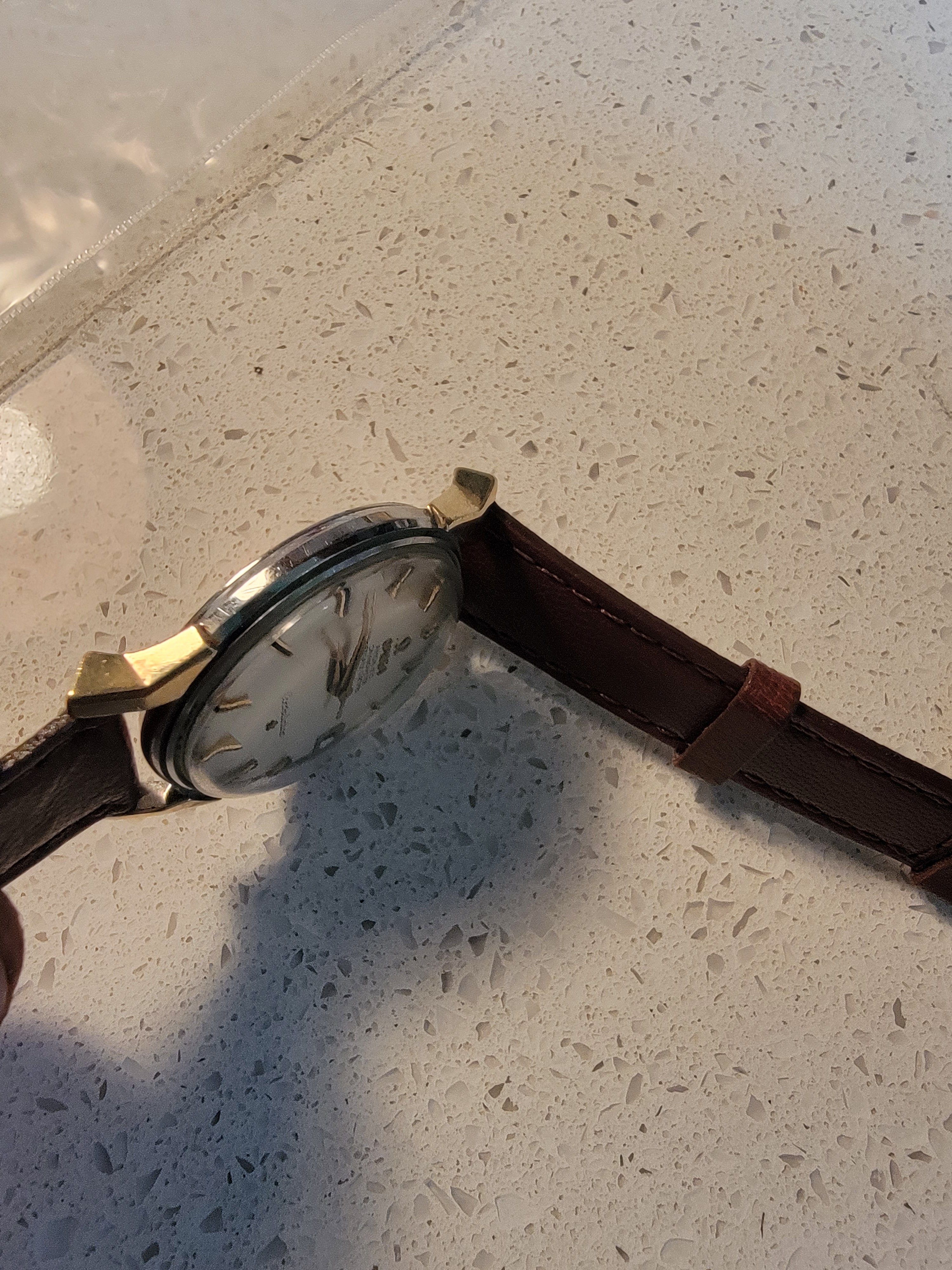

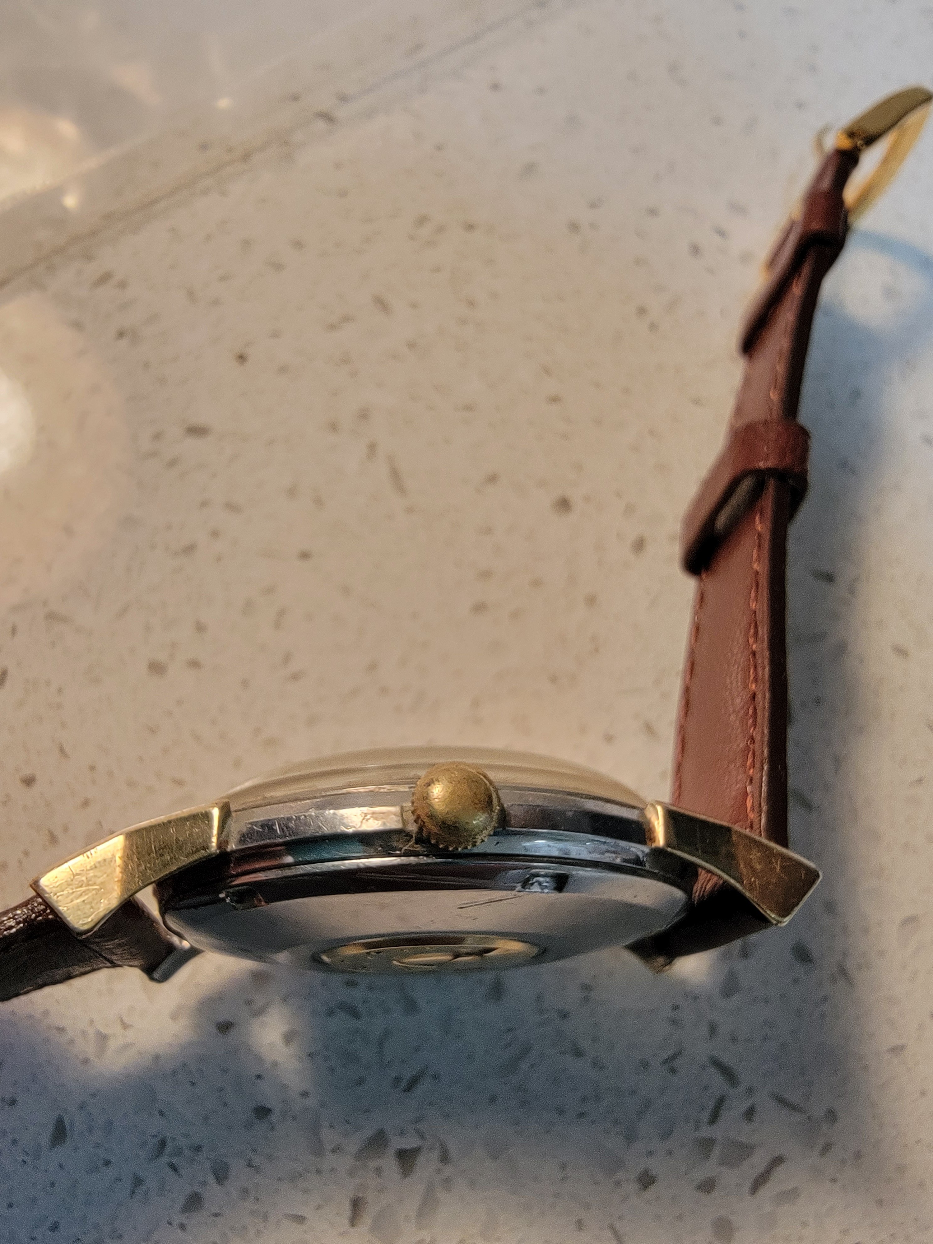

The bezel is unicorn poop, unfortunately. People sometimes have a gold bezel fabricated, but it won't be cheap.

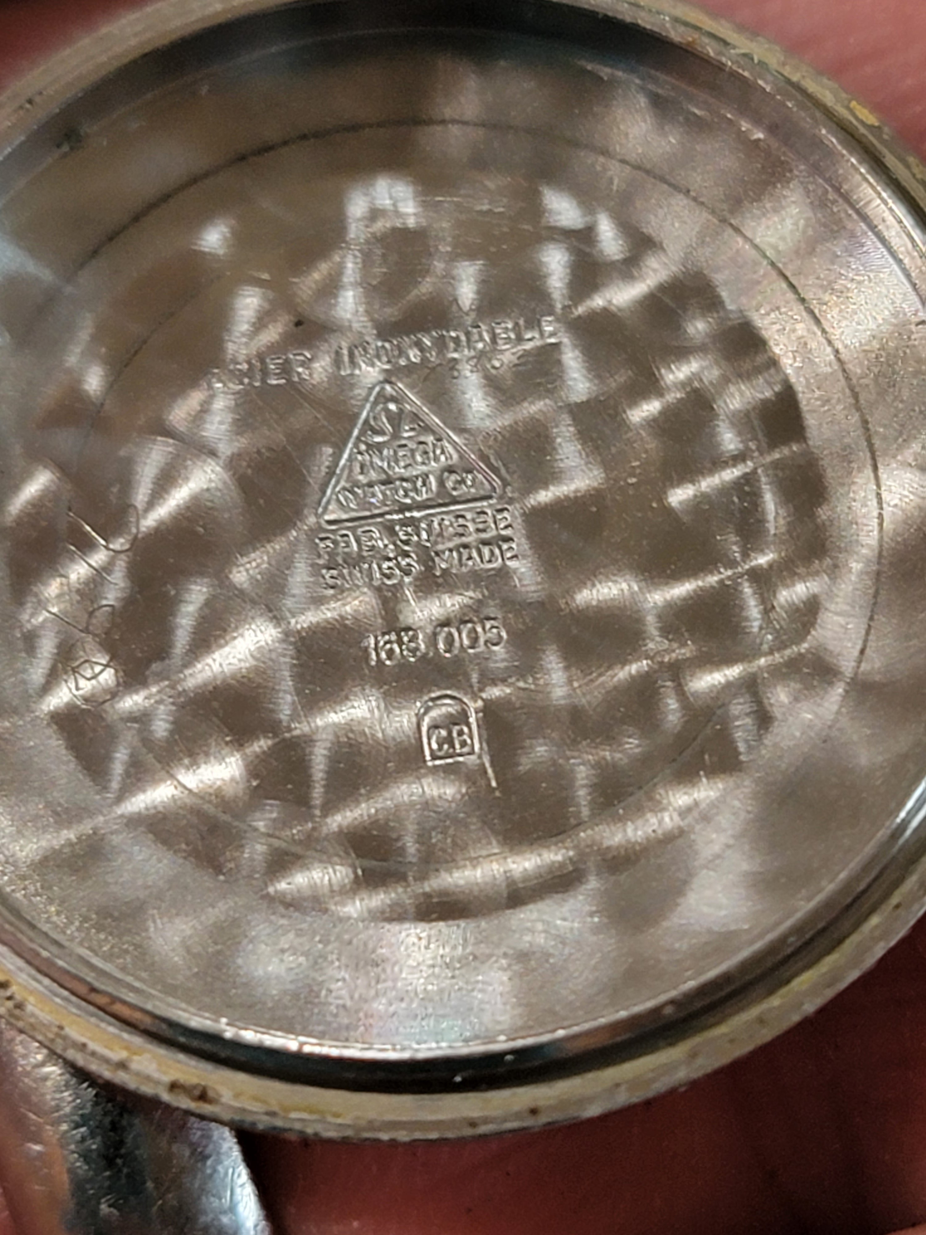

I see you've now found the reference number inside the case-back; it appears to be 168.005.
This type of case is called gold-capped, with a relatively thick shell of gold covering SS lugs (which can be seen from the back).
5
3
