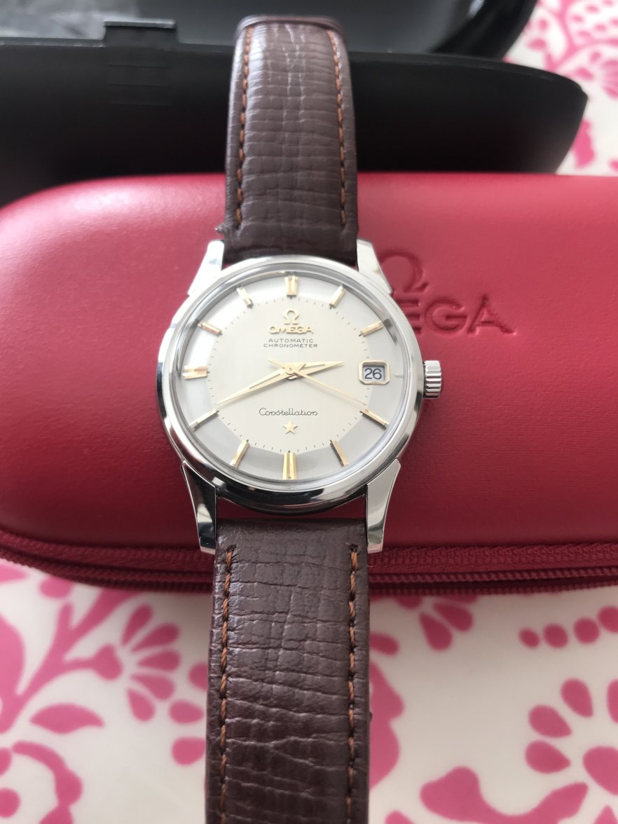

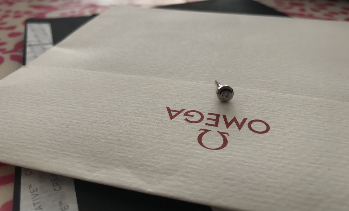

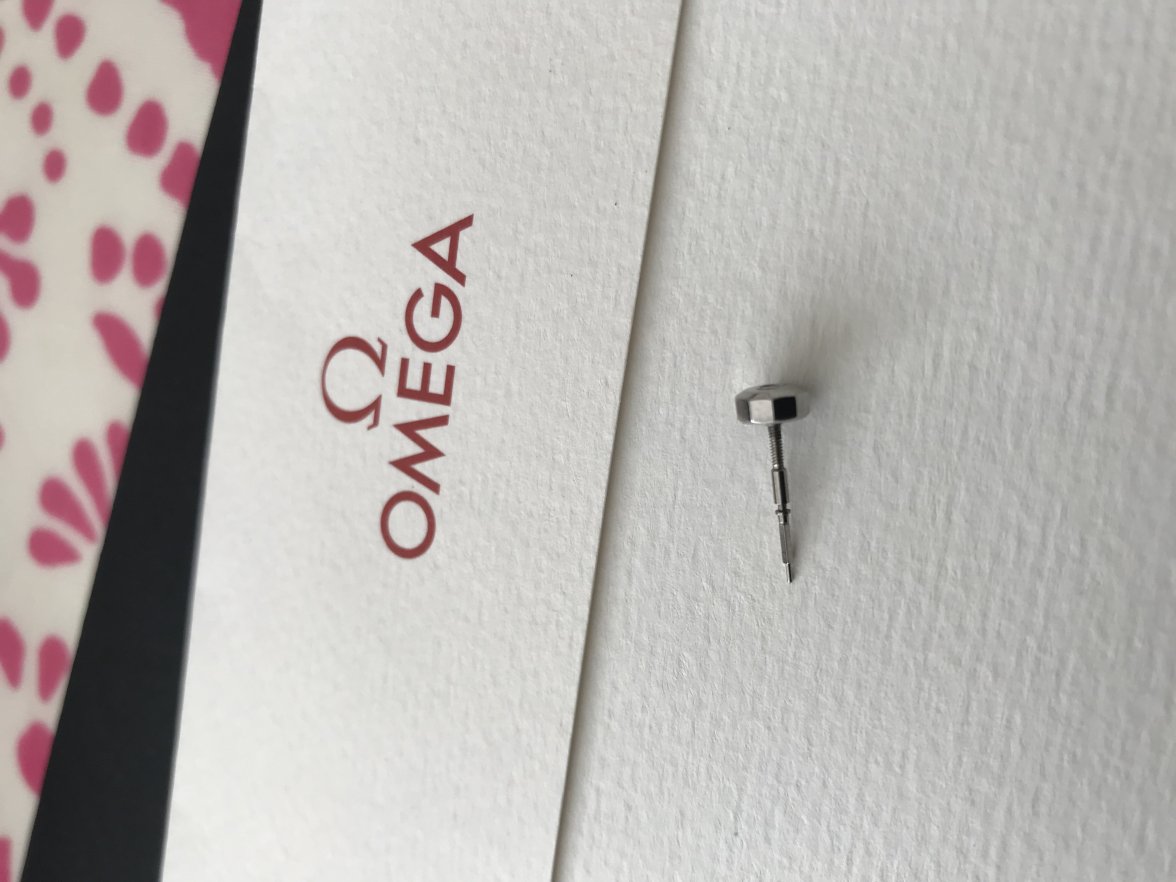

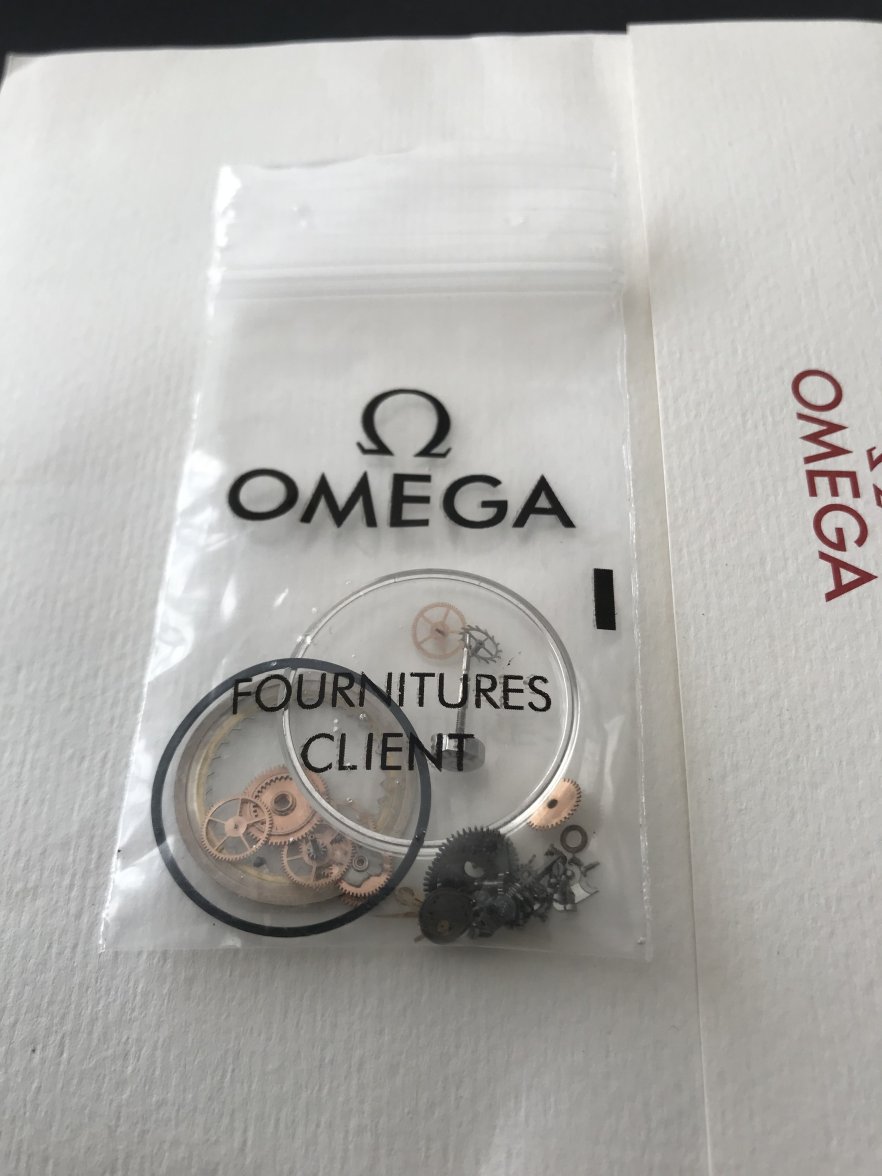

Hi, I’m new to the forum and have been lucky enough to have a 1962 Constellation (14393) bought for me as present. I’m aware that the crown is a service replacement - the watch was serviced by Omega earlier this year and as part of the service the crown was routinely replaced. My question is, as have all the parts that were replaced on the service, including the original crown, should I go back a replace the service crown with the original or leave alone. Phots attached - thoughts would be welcome. Cheers

To provide an alternative view: I'd have the decagonal crown installed. It's not extremely waterproof anyway, even with the service crown, and if you take a bit of care - make sure it doesnt get wet when washing hands/when it's raining etc, you might as well wear it in it's original look. To my eye, the crown does make a difference. I've been wearing vintage watches that arent waterproof for quite a while and it was never really an issue to look out for them. Worst comes to worst, let's say when I was on the bike to work and it started raining, I just take it off and put it in an inside pocket of my jacket.
The crown that was returned to you is also a service replacement, by the way. I wouldnt mind, it's the correct style, but since you brought up the matter I figured I'd mention it.
