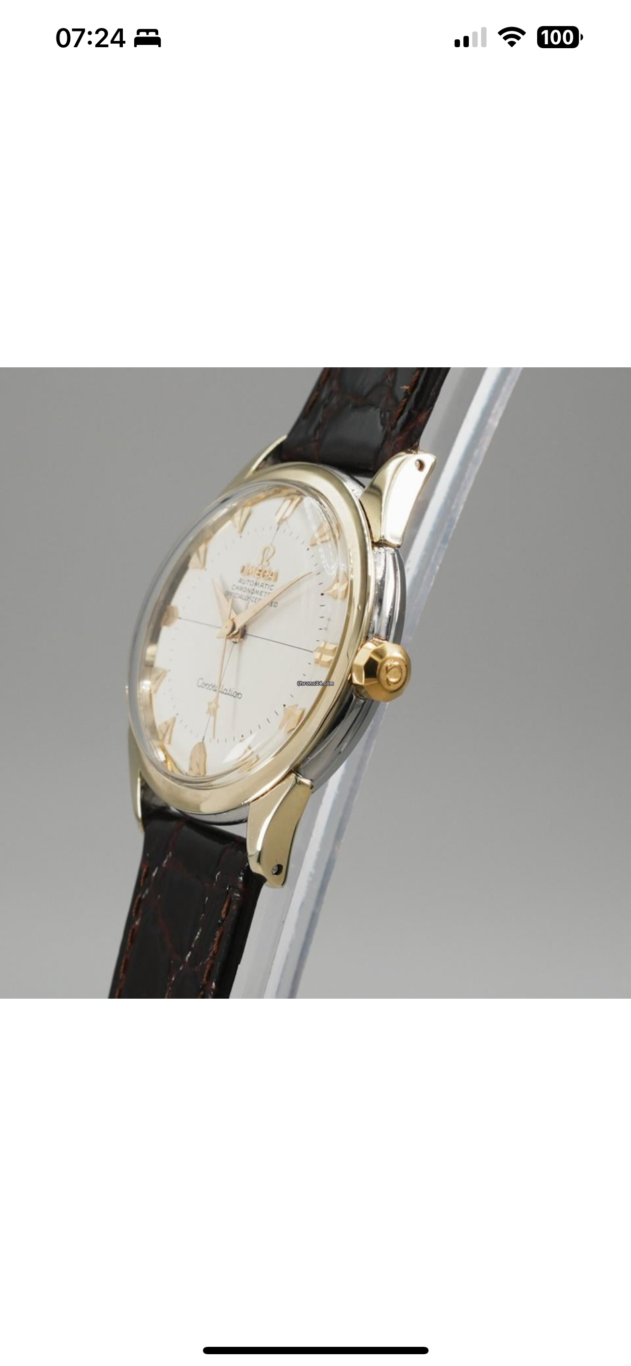

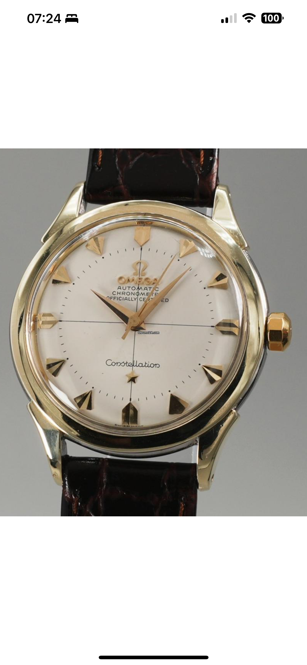

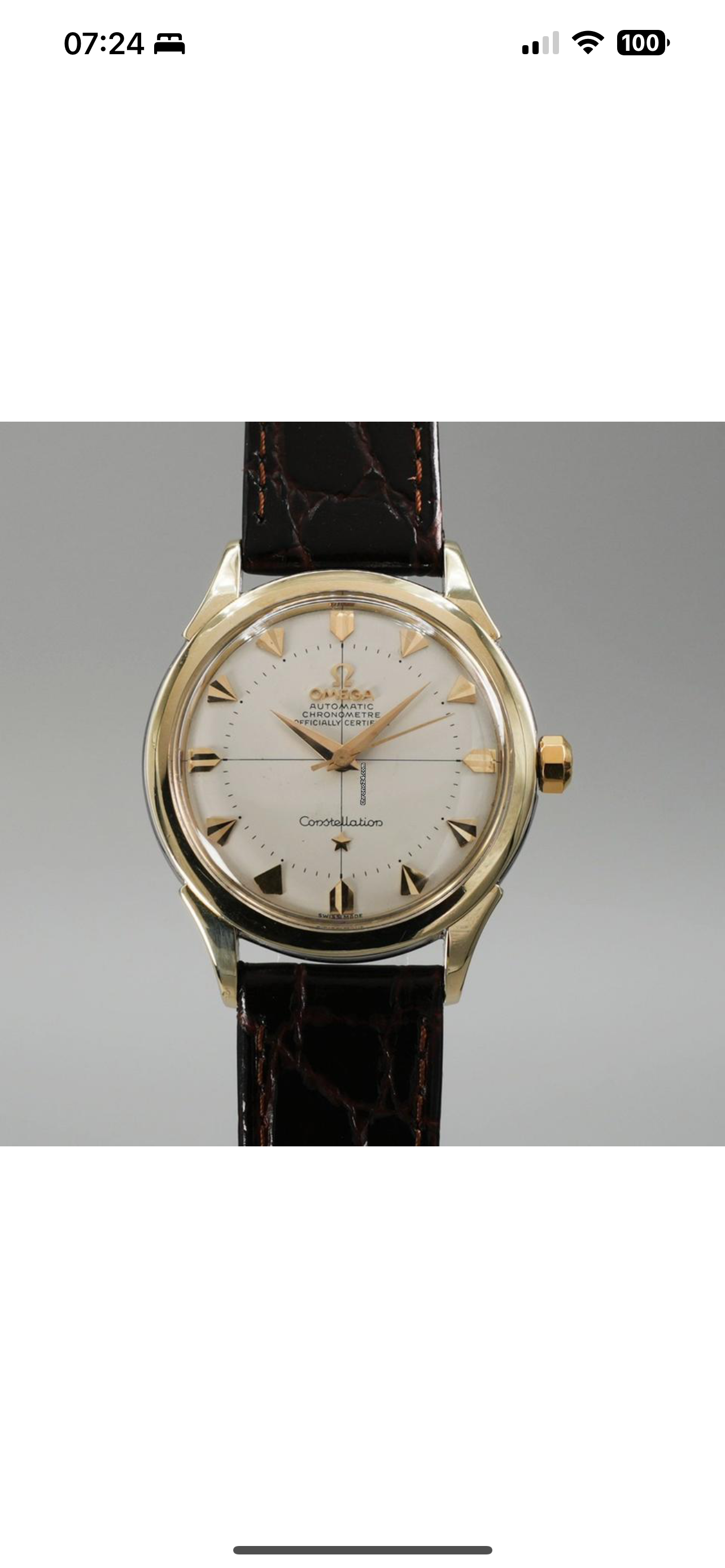

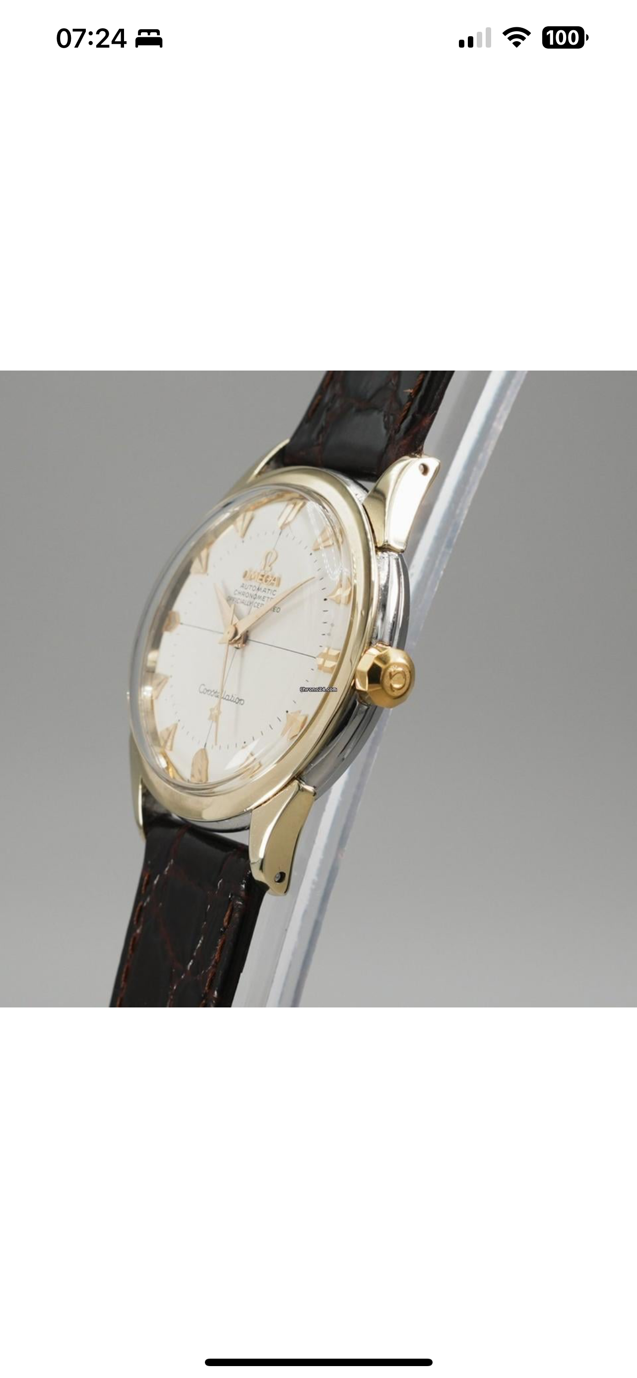

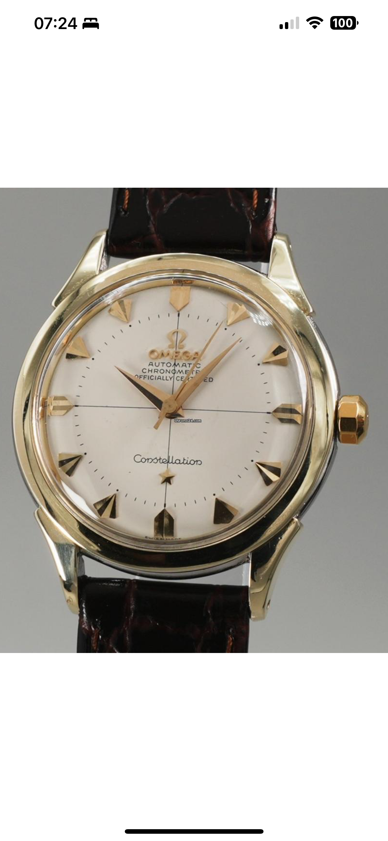

Hands look correct, text looks crisp to me. I do wonder about the “chronometre” as I think the French spelling is less common? I am suspicious that perhaps it looks slightly too good for the age and price.
3,136
6,515
Jordan, check e.g. the other examples at C24 😉 and train you eyes. Look and check the swiss made. As @JBSMP mentioned: perfect dials are suspicious.

I would say the cross hairs are too heavy, the bottom one touches the l, font is heavy, the Swiss Made is bunched up, the s in constellation doesn't look right, the case is too polished .
Ironically that's one thing that's OK. With RE spelling, it's not a question of rarity, it's a question of date. RE is actually correct for this year of Connie, ER was seen later. The rest however is rather more questionable.
282
396
Looks likely to be a skilled redial. I would not buy this watch based on photos. You would want to look at this one in the flesh, with a loupe. Then you would be able to tell.

May I provide a differing opinion about the font?
In my ‘beginner’ view, the font looks good, but the casing and the price are not appropriate.

However, near-pristine dials do exist on 50s Constellations, line thicknesses can vary, the cross hairs on dome-dials do often invade the personal space of the 'l' in Constellation and 'Swiss Made' does look bunched up when in this location on a dome-dial 2852.
For this reason I'm siding with the 'beginner' @qazwsx1 on the question of good dial or redial 👍

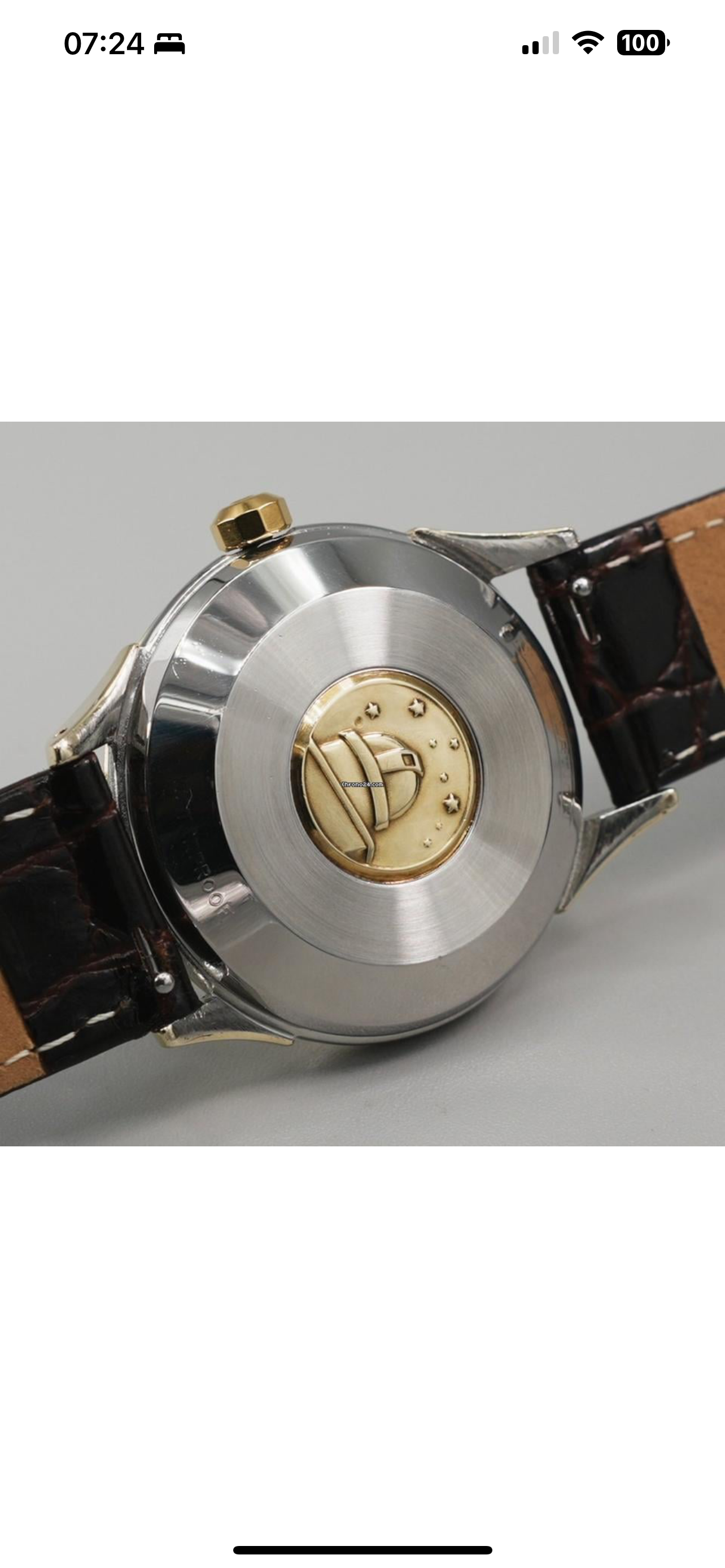

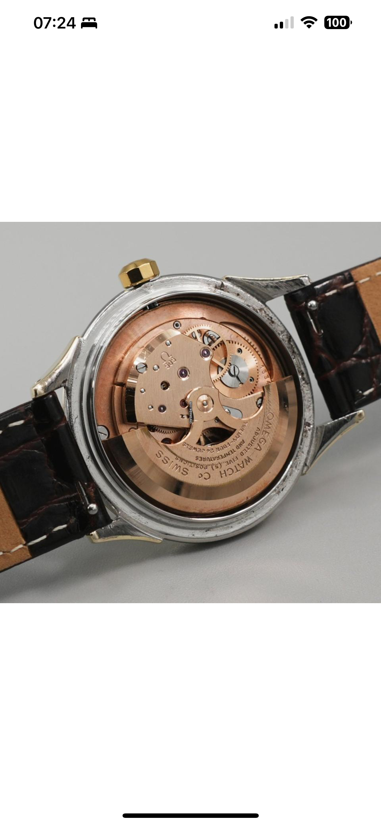

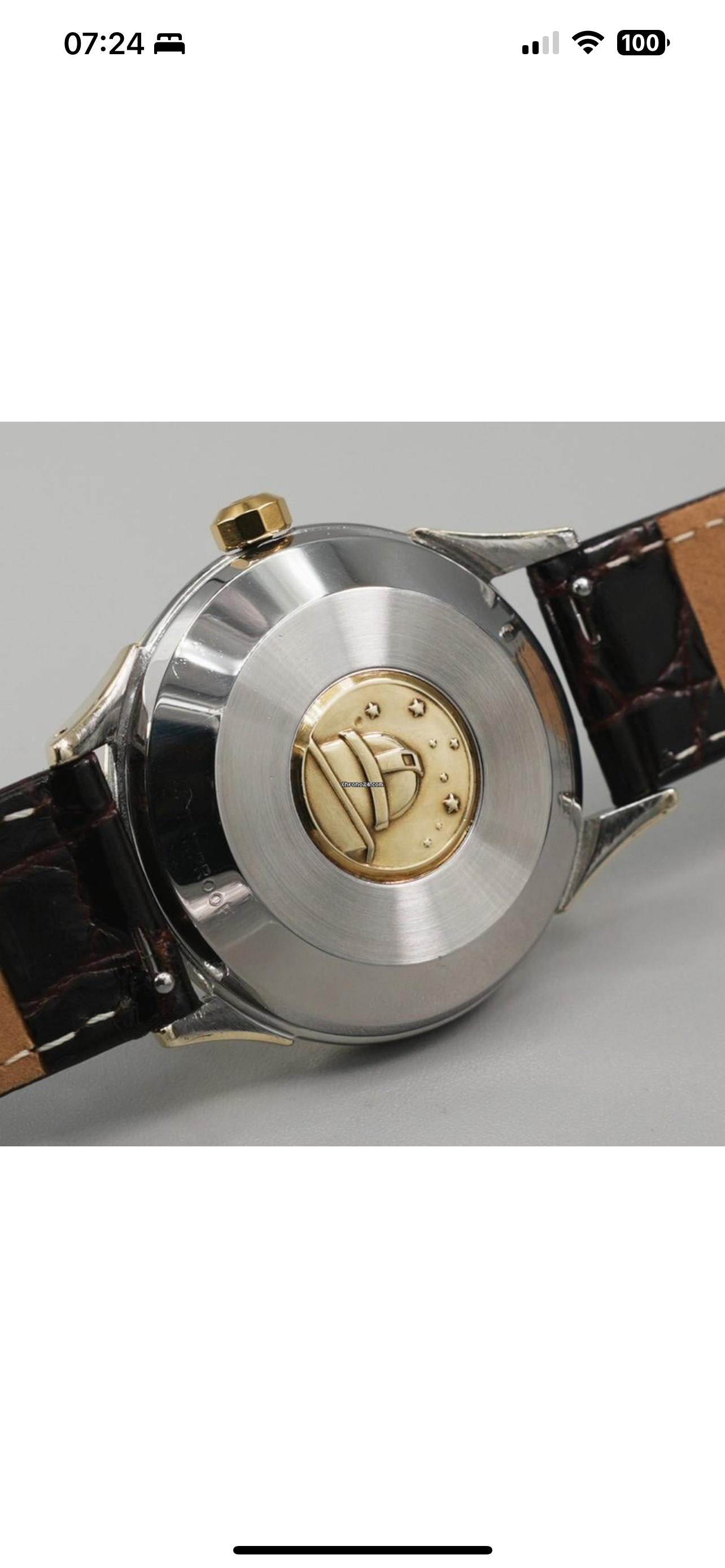

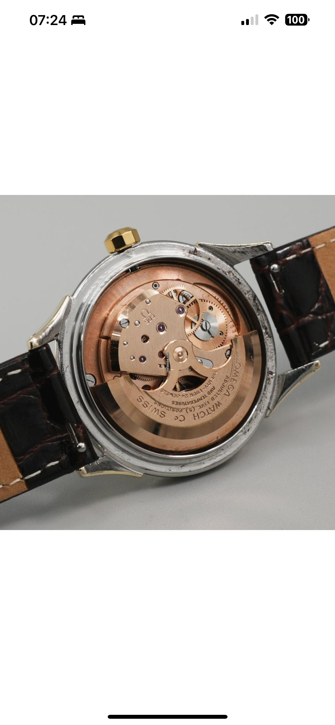

However, the case is heavily polished, the mid case is quite badly pitted and there is obvious signs of rotor rub (and no pic of the inner caseback) so the price tag is ambitious to say the least.
