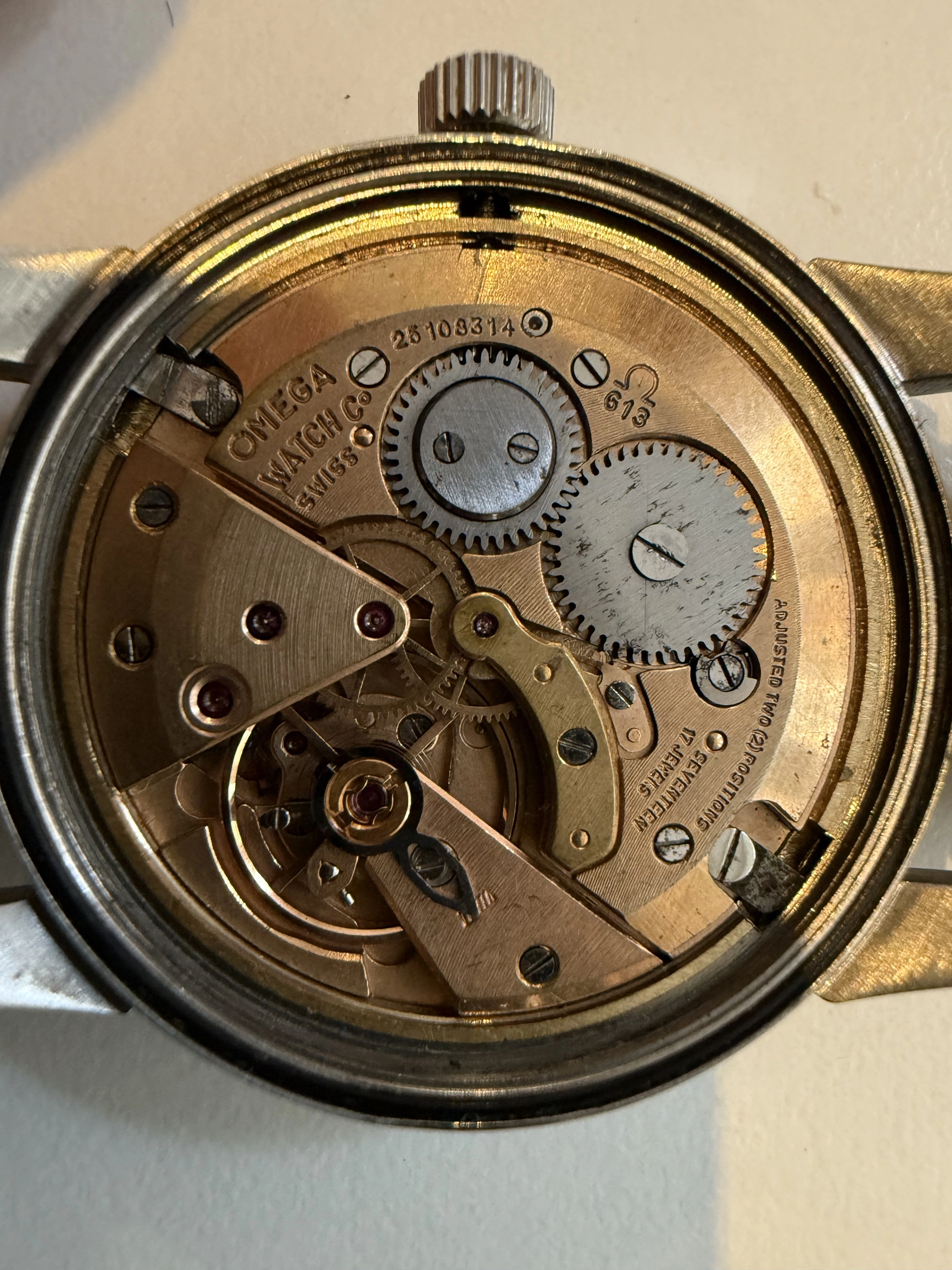

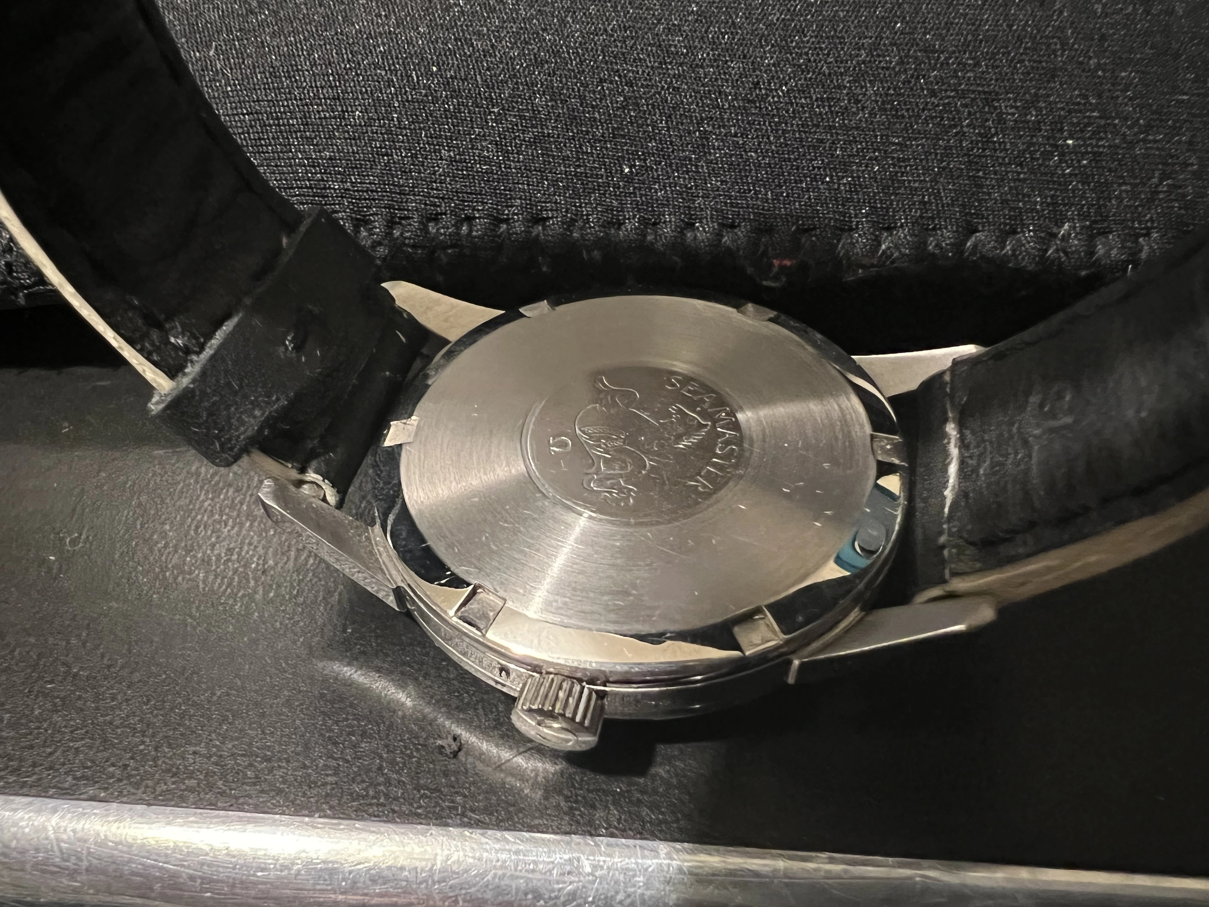

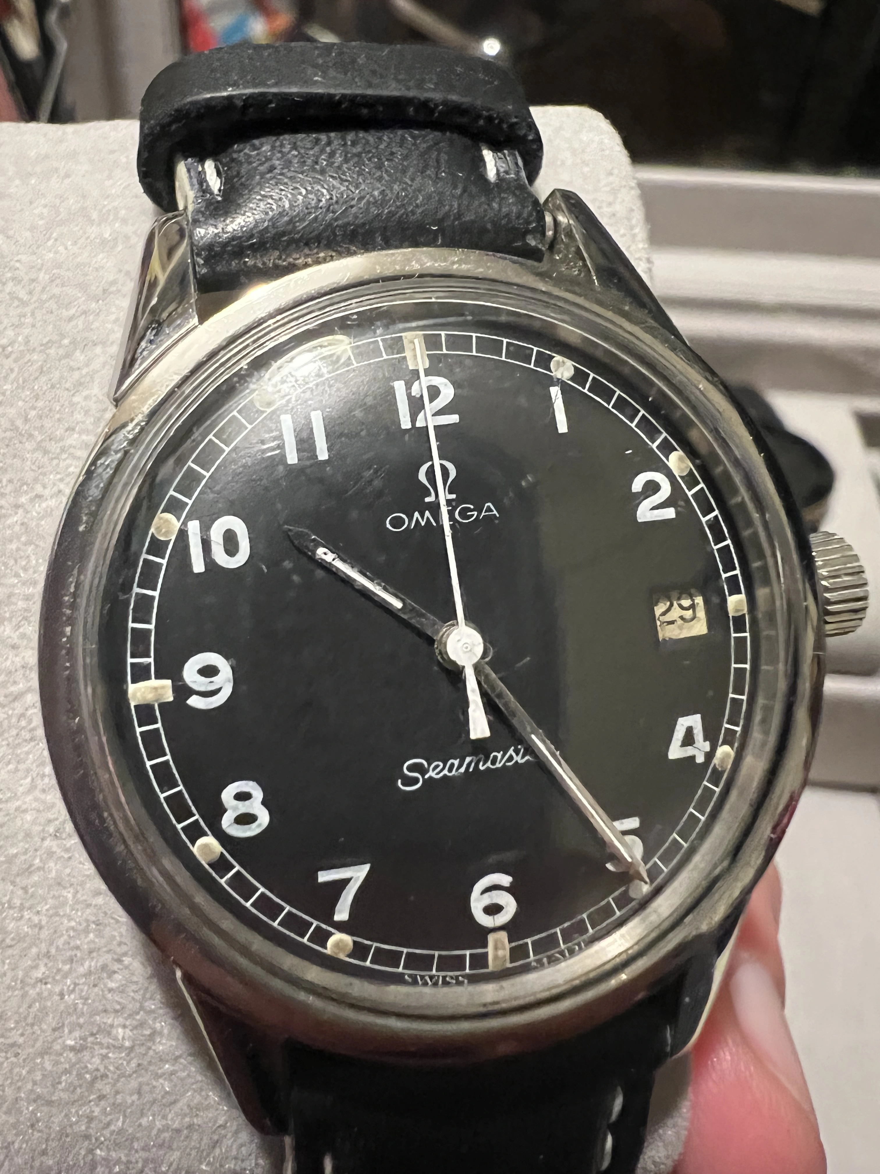

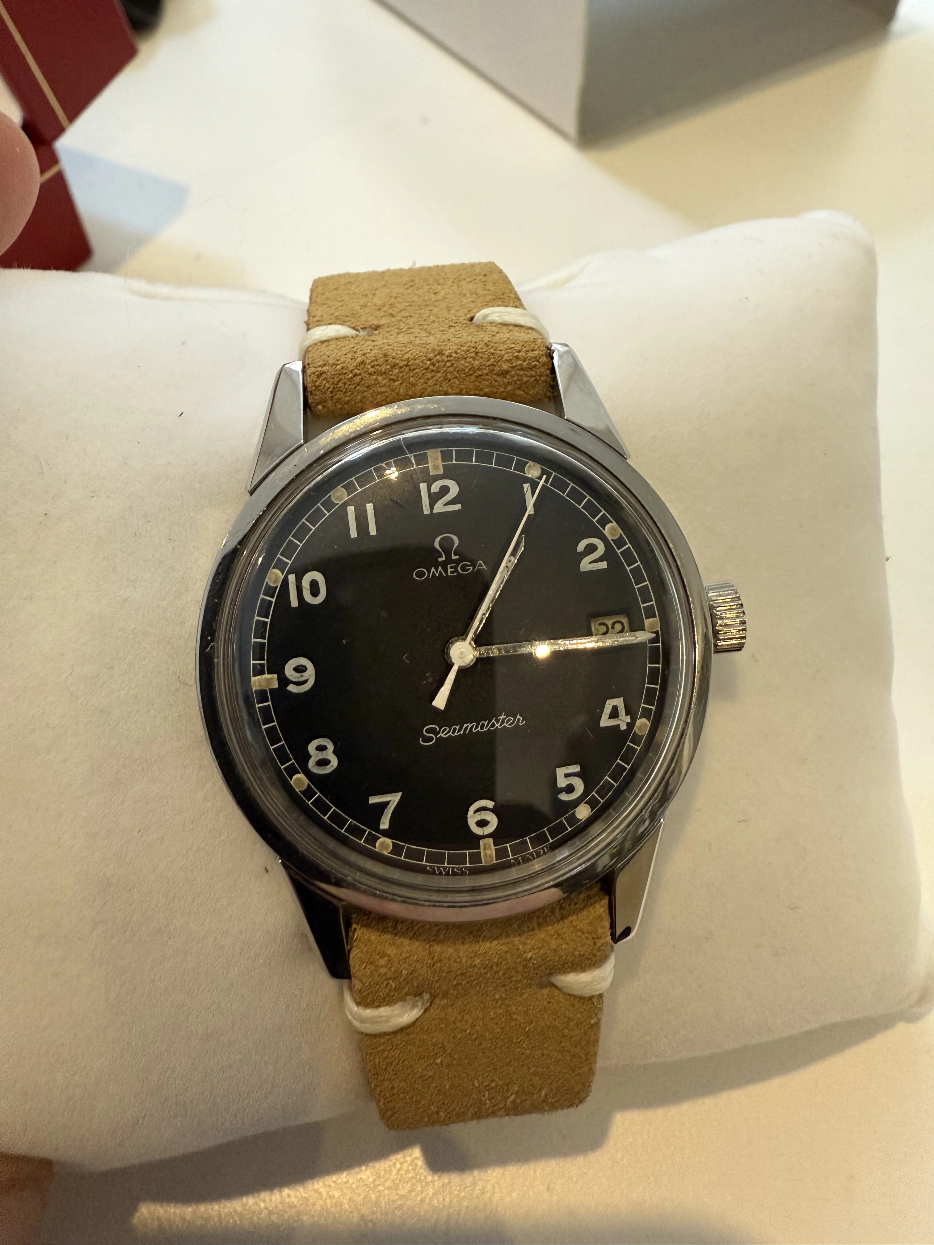

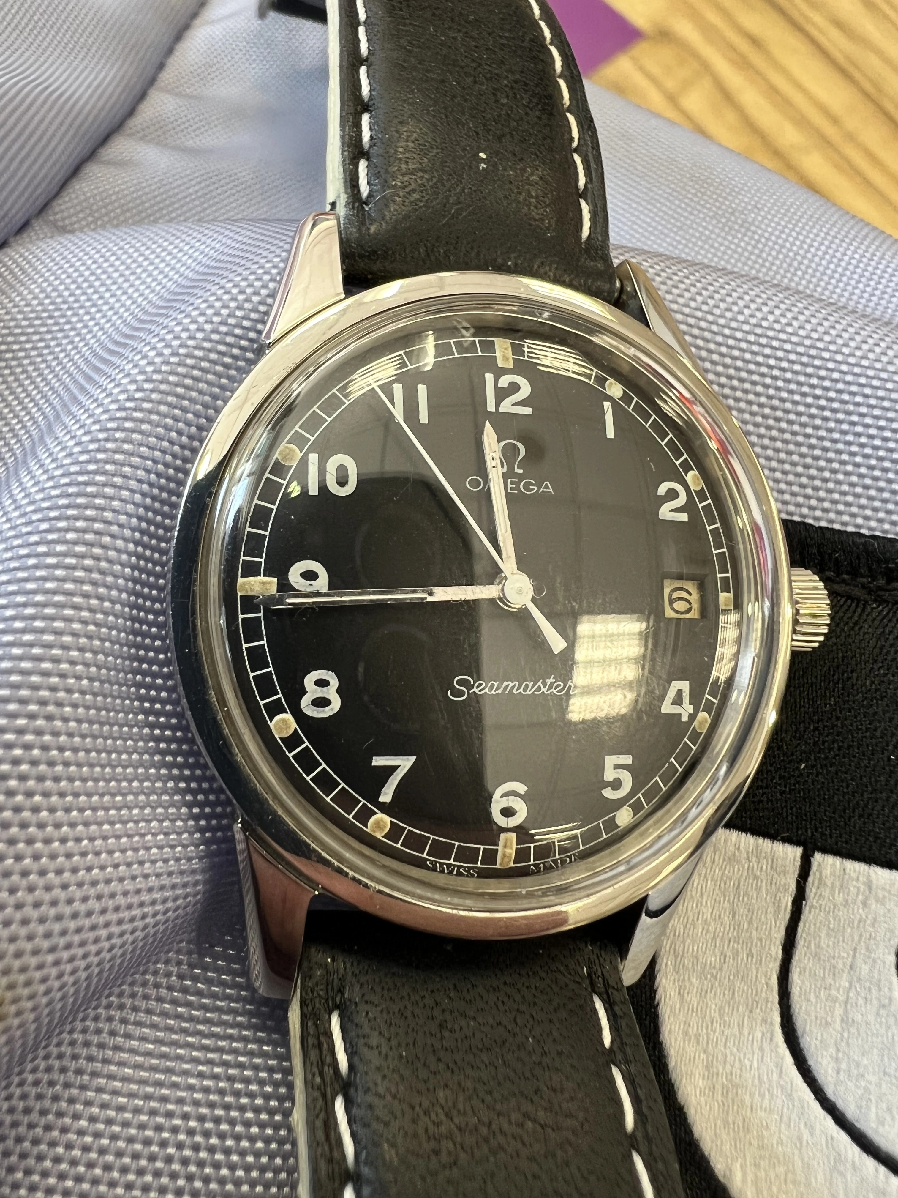

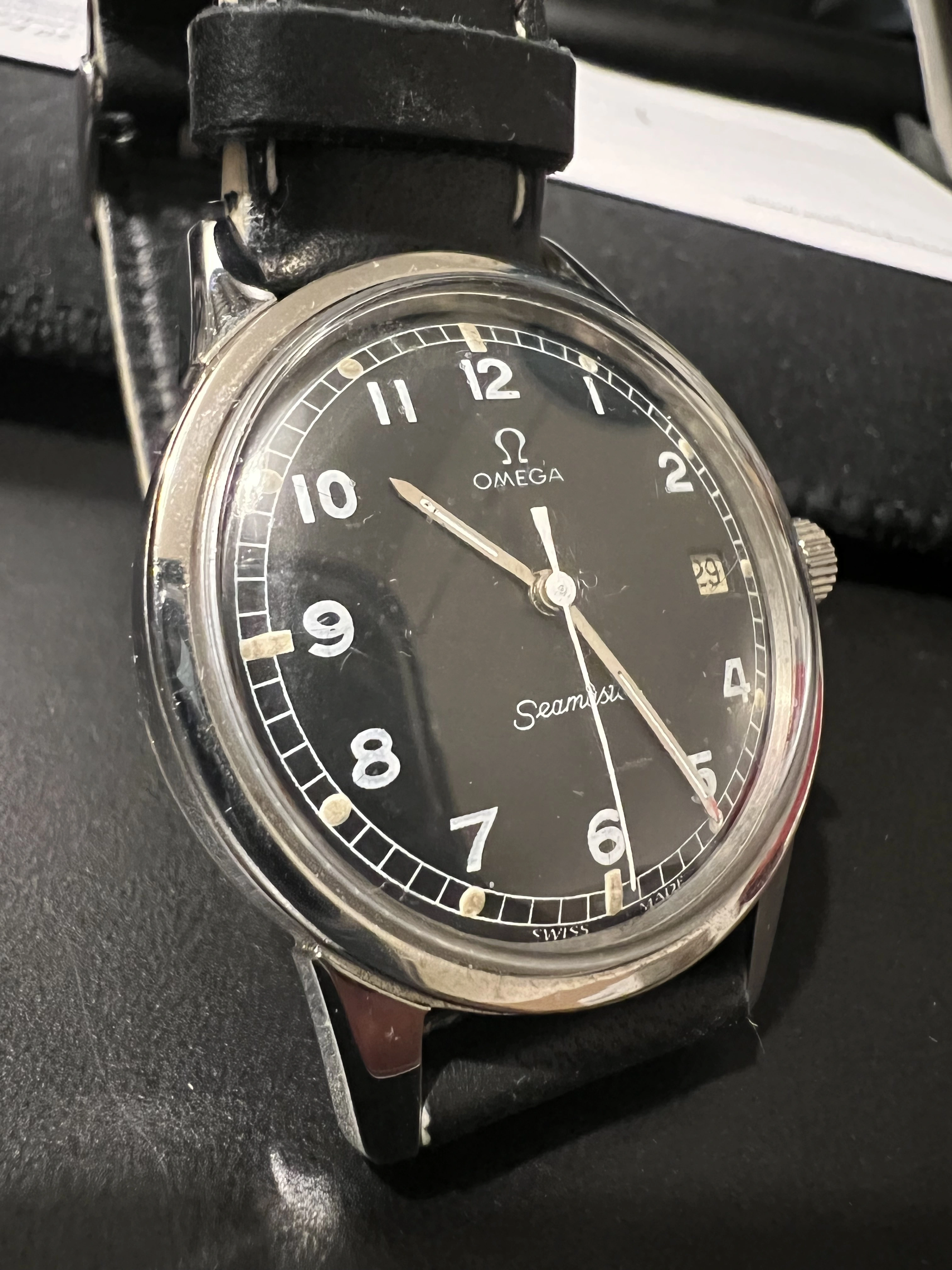

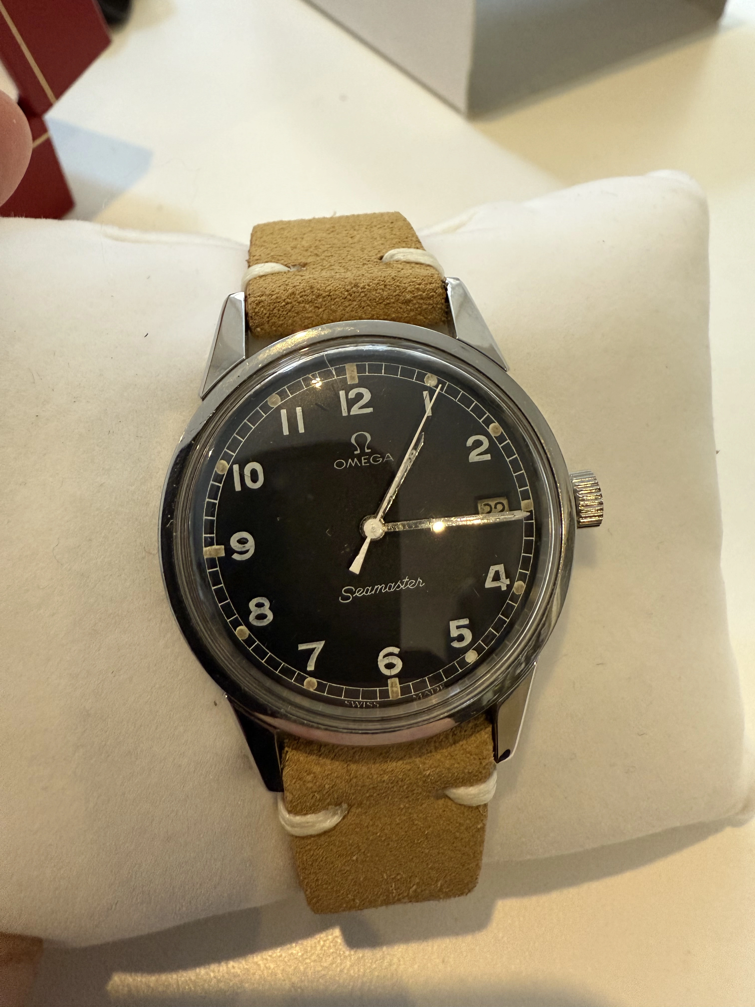

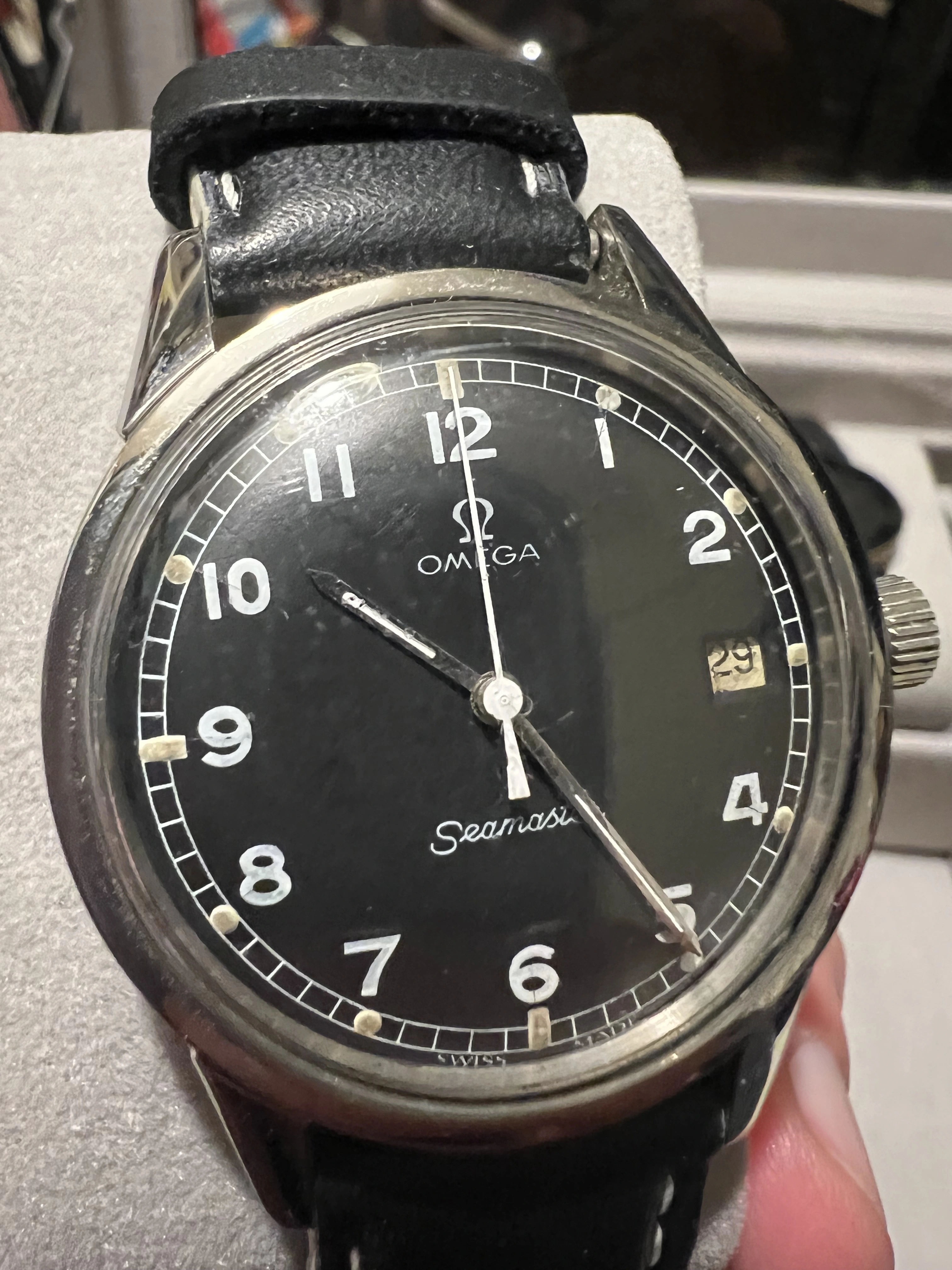

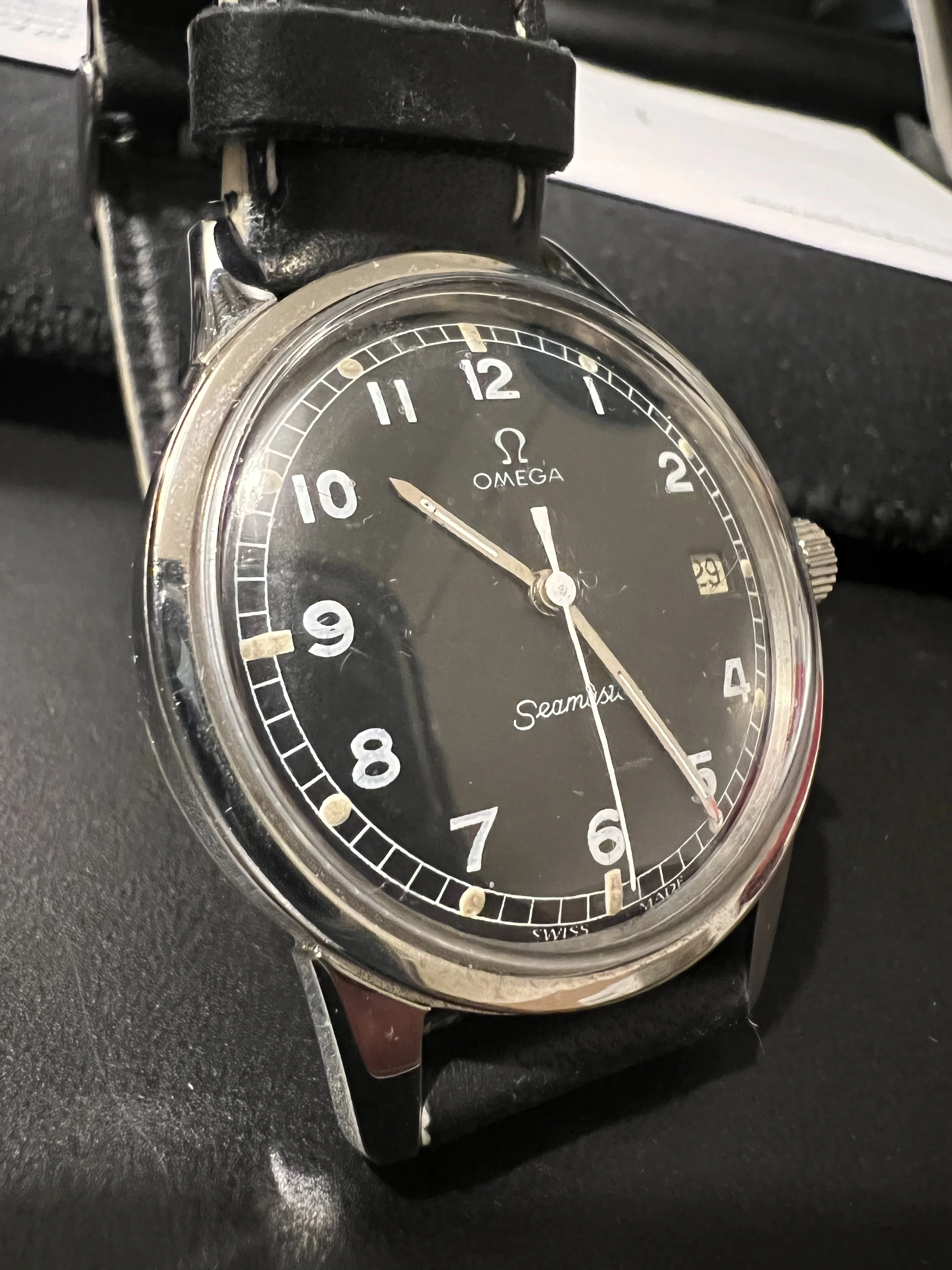

Hi, I’ve had this Seamaster for a few years and would love some opinions as to whether it’s a redial or not. Serial suggests 1967 vintage, and while the markings look like military variants I’m not sure about the logo, which seems painted or printed on. Any thoughts?
30,270
78,121
Frankenwatch? 🙁

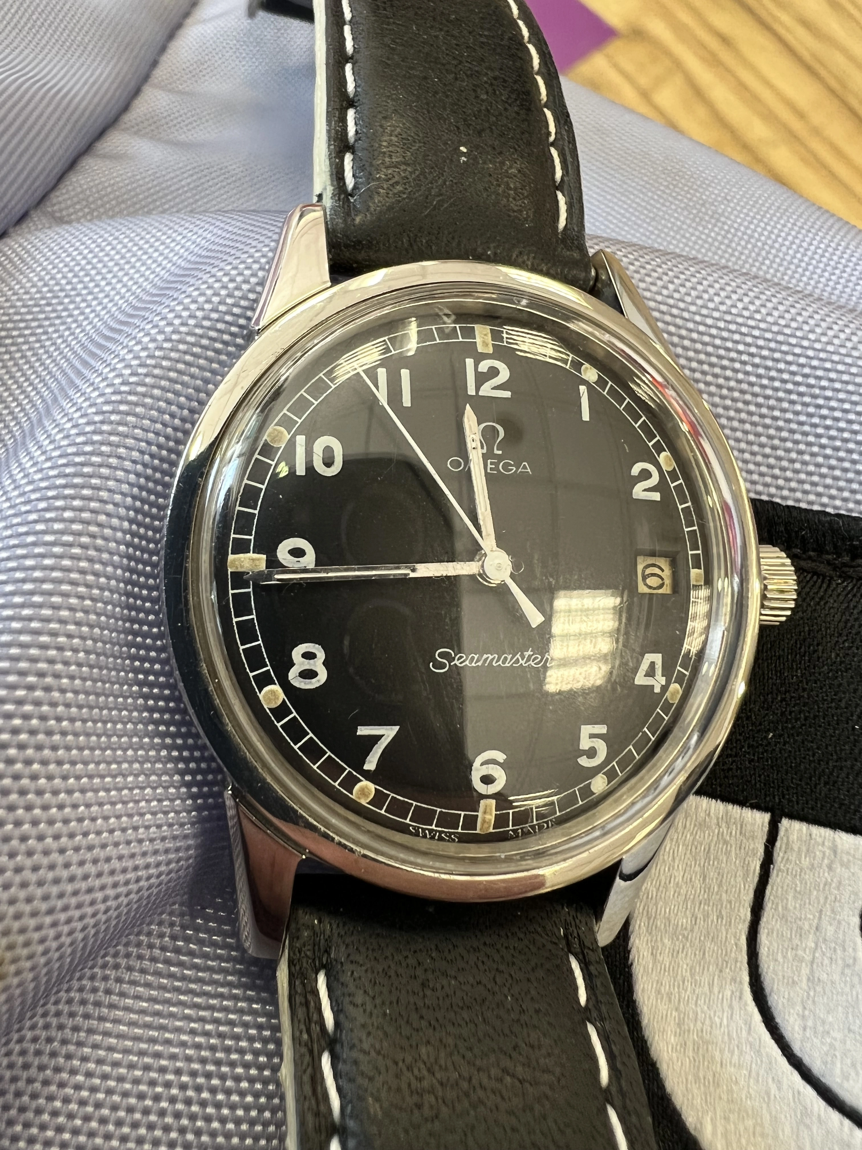

I would say yes. You can see that the dial really doesn’t fit in the case as it should. It appears that there is a small gap in some areas and you can see the very edge of the dial.

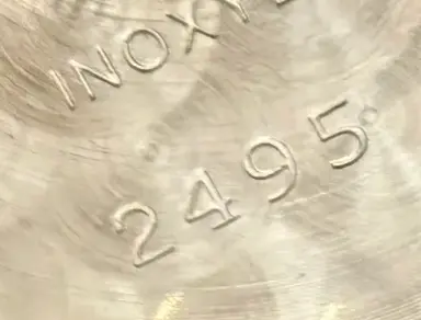

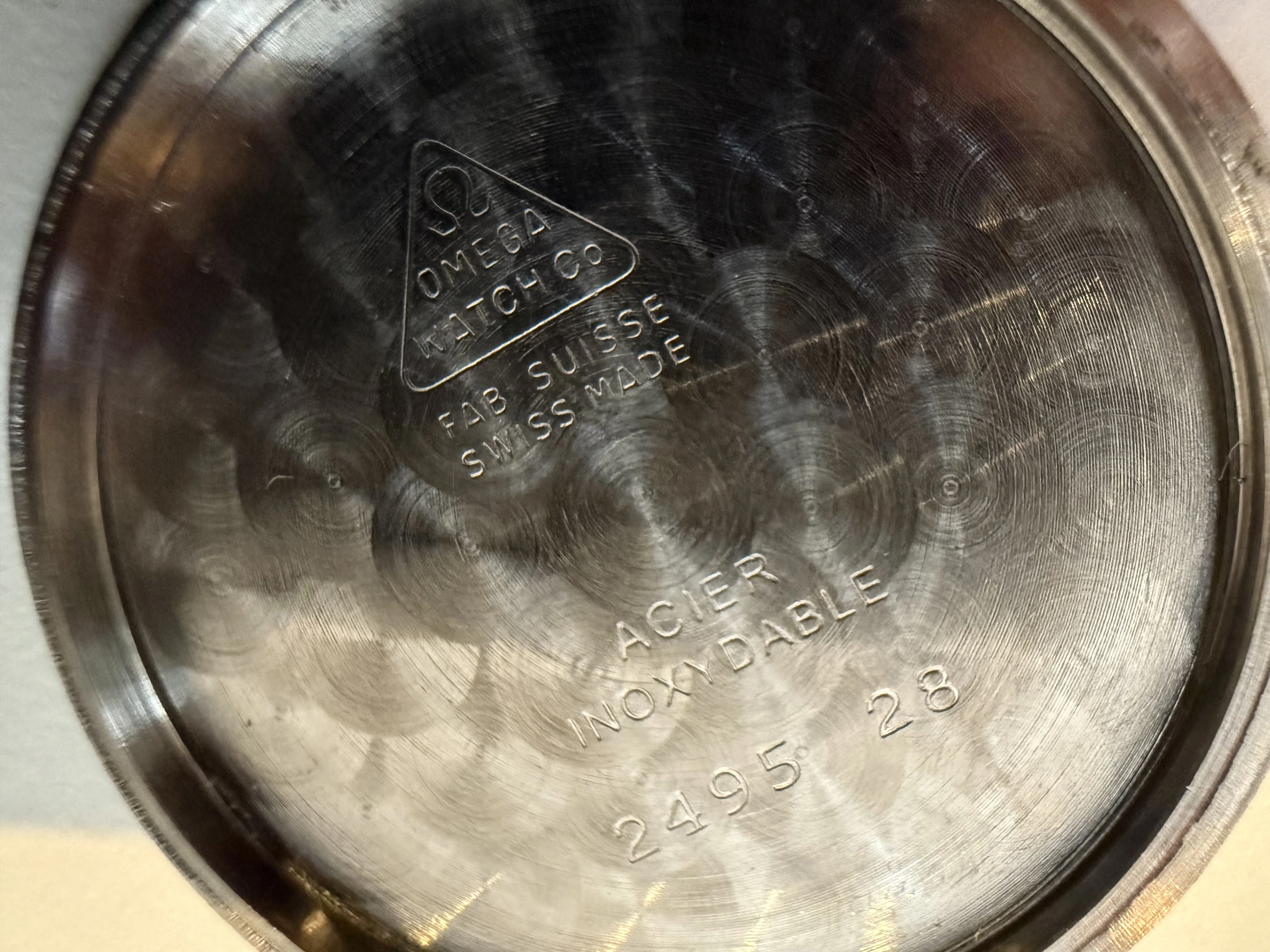

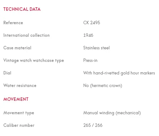

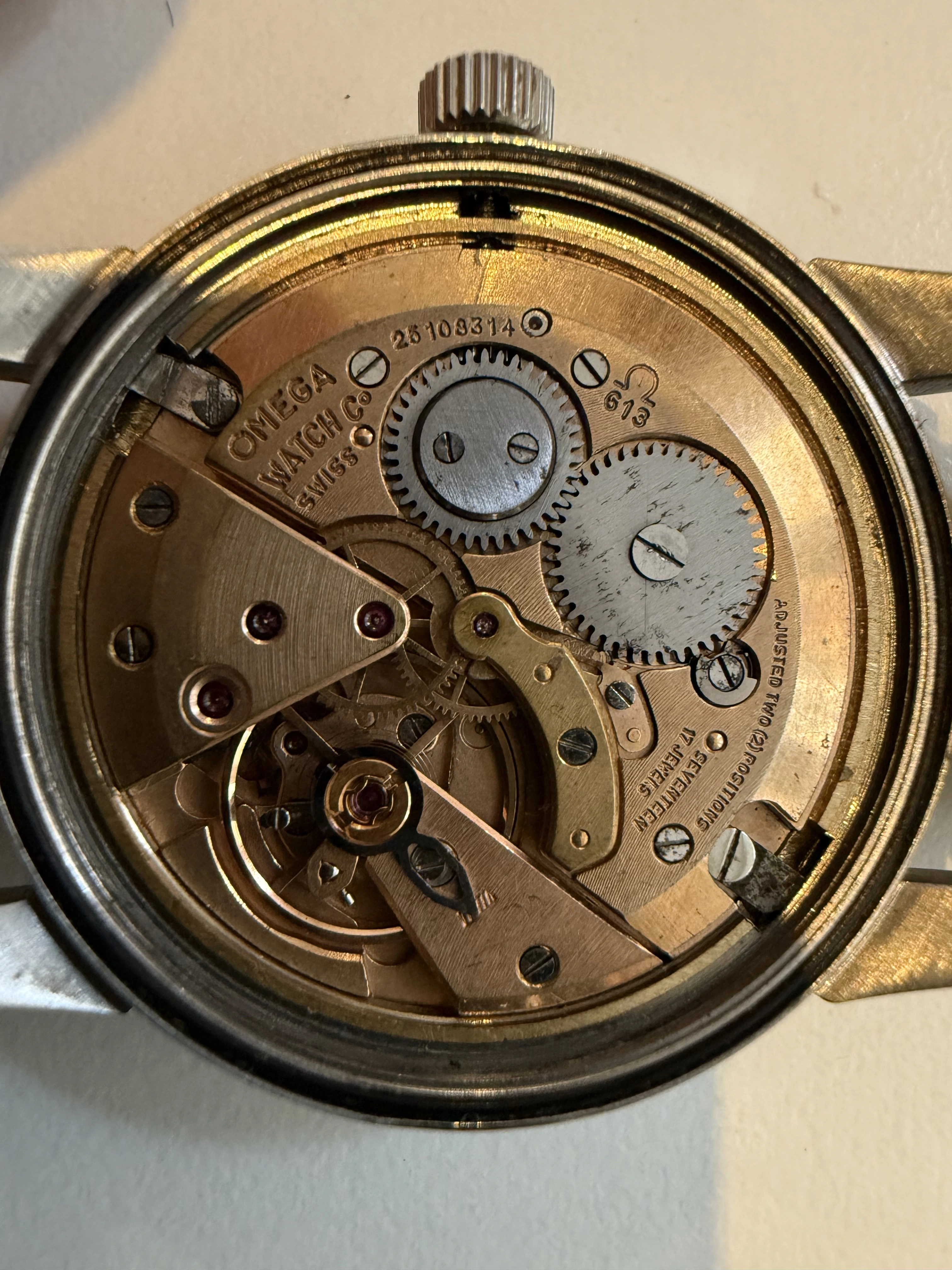

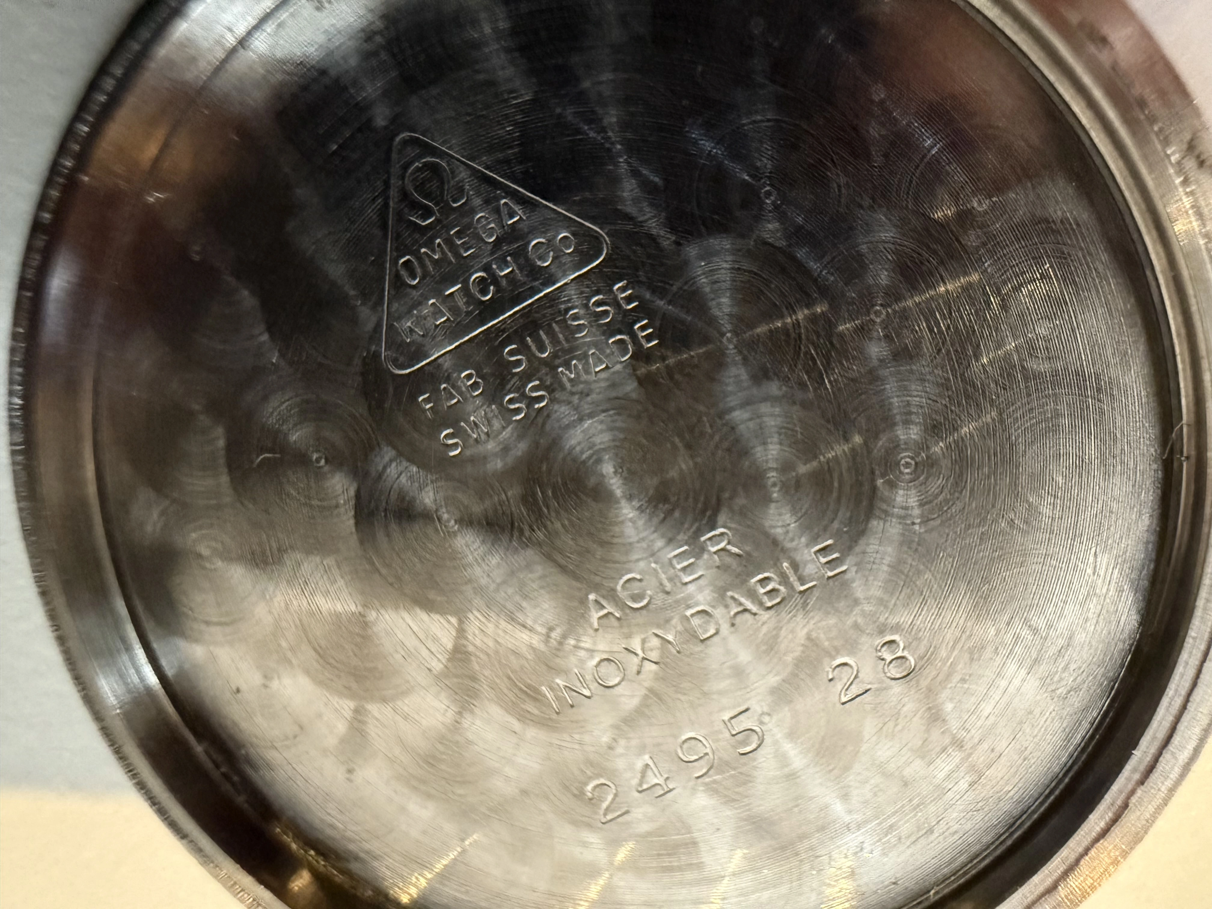

That case is for a 265…

Ah, that’s disappointing, but not totally unexpected. Thank you all for your comments!

One more question: I like it and do wear it, although it’s a bit small for my wrist (but maybe I’ve just been thrown off by more modern 40mm+ watches), but what might it be worth like this if I were to try to sell? Anything?
13,555
23,503
You’re asking the wrong crowd really. No collector would pay anything for it due to it being a franken with a redial but a non collector may pay a couple hundred of more on ebay
