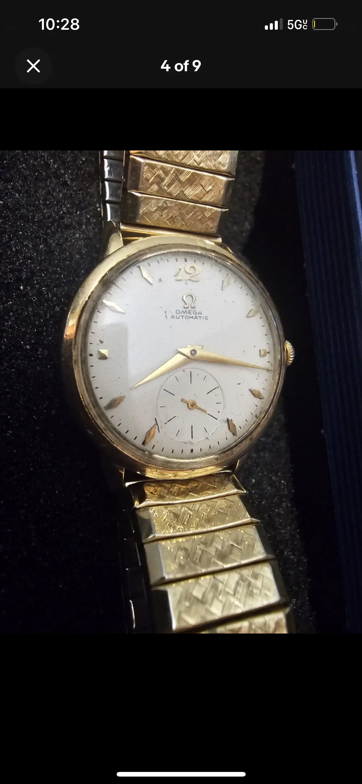

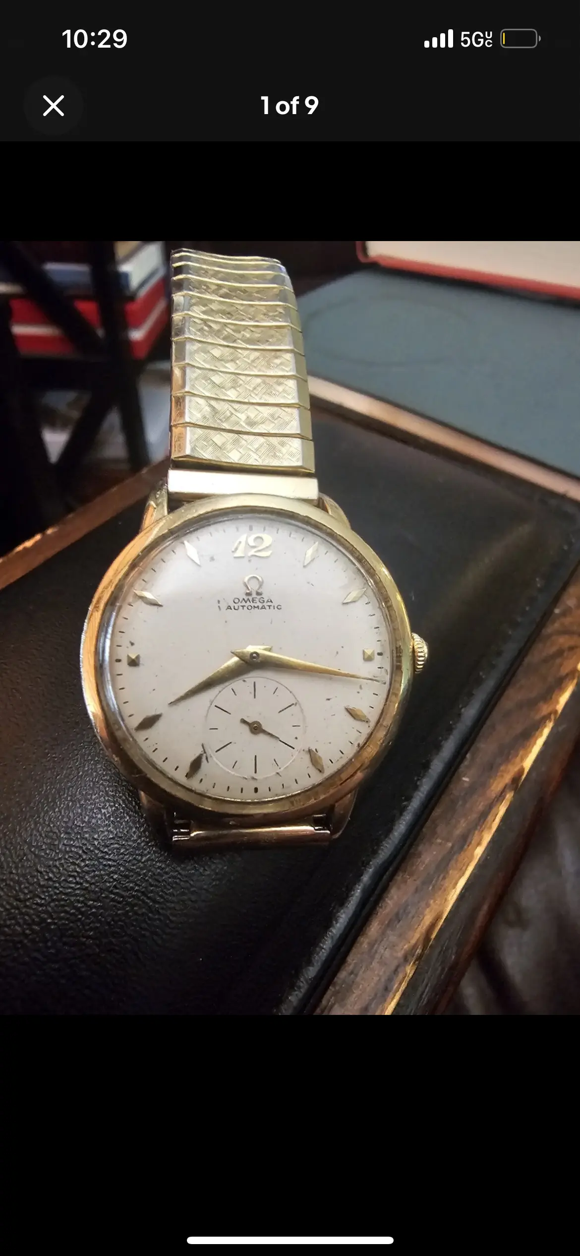

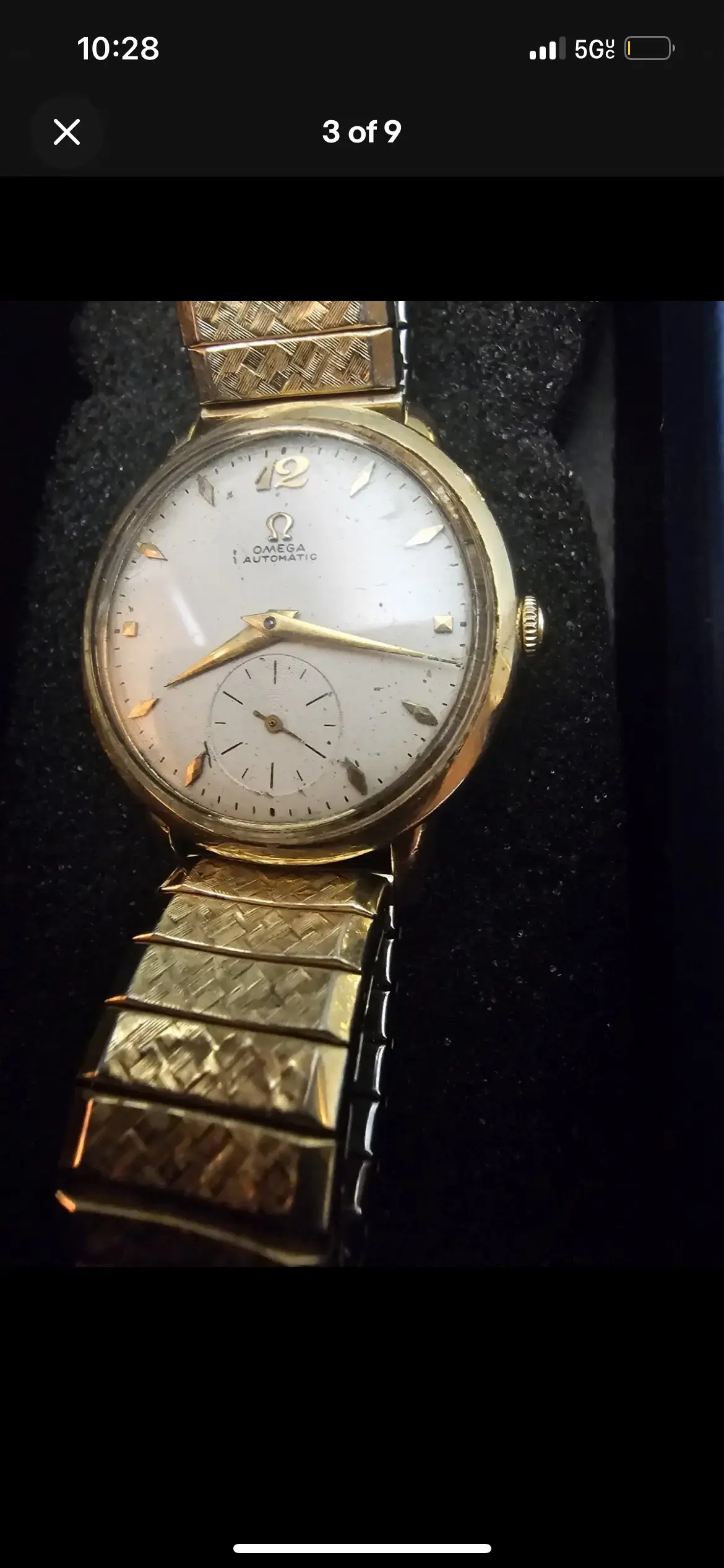

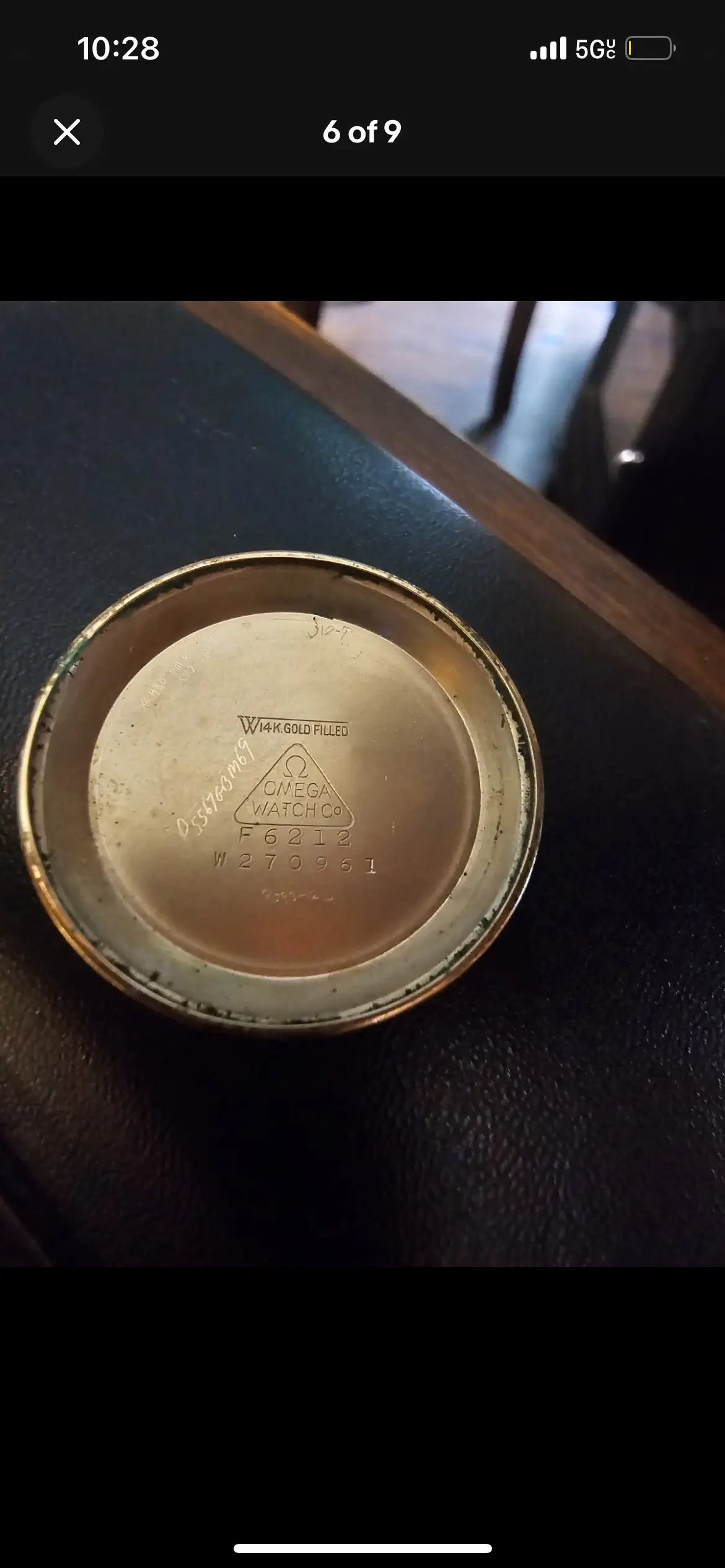

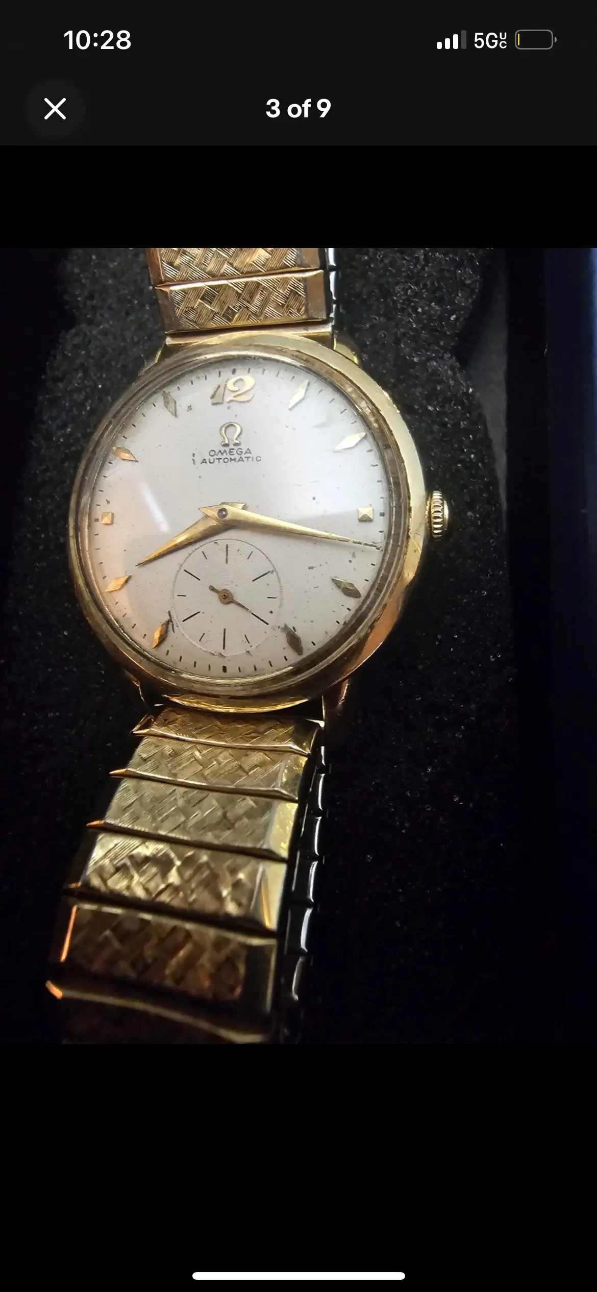

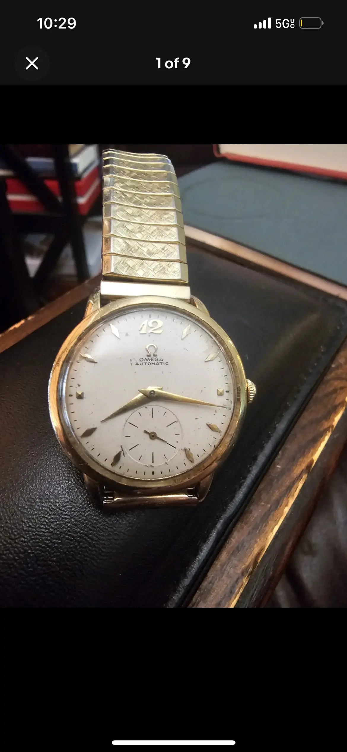

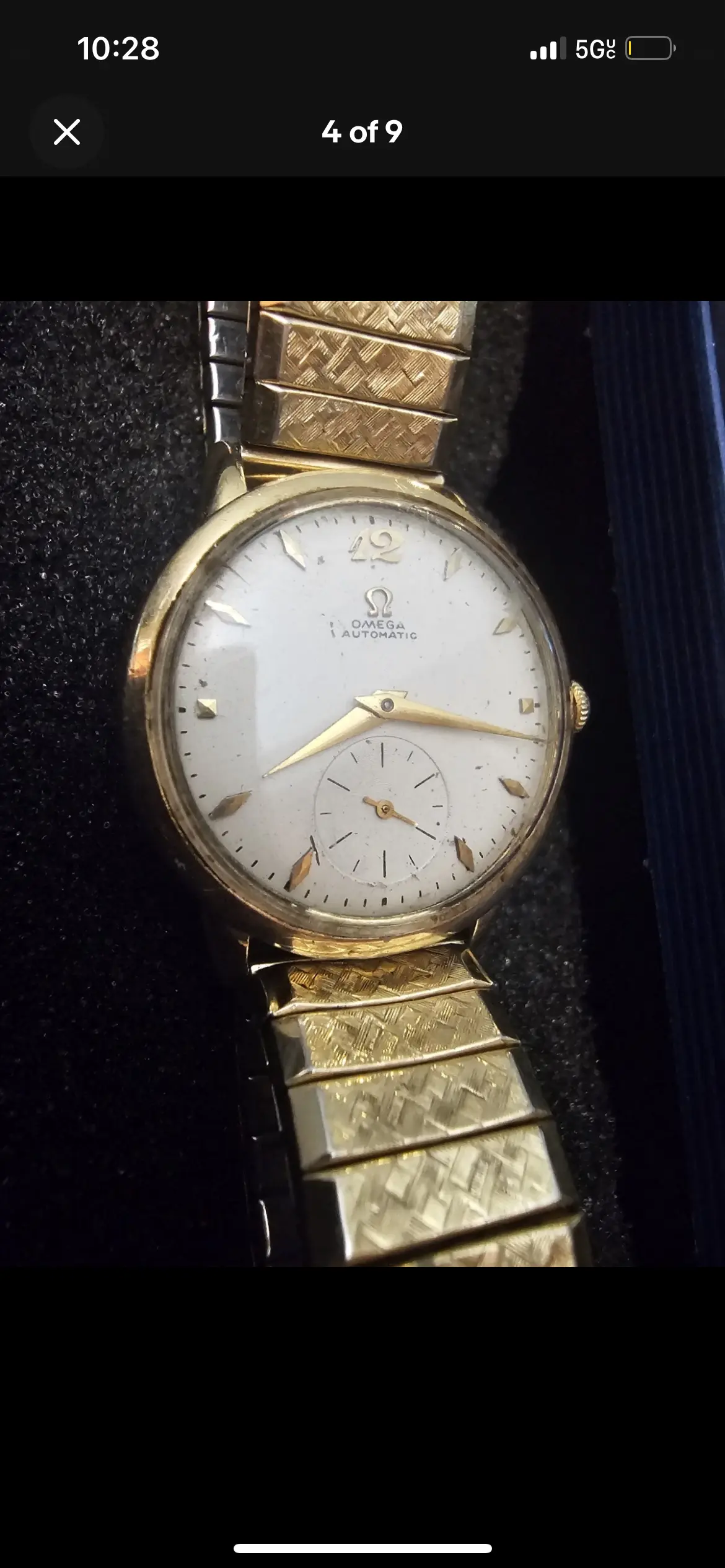

Does this look legit to you guys ? Any parts that look out of place or not original. Do you think it’s worth 250 in working order ?

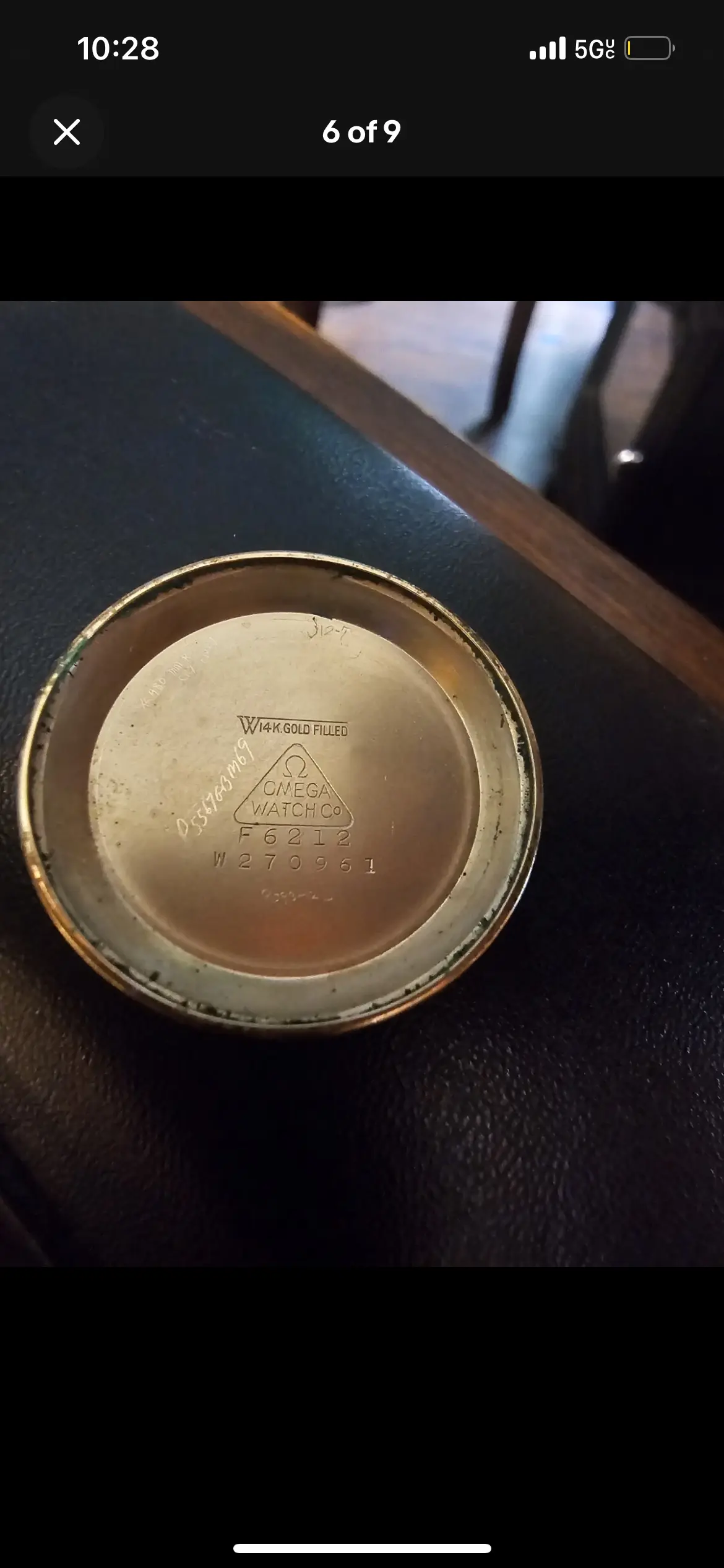

Hard to judge if all the parts are right seeing as you had the back off the case, and you don’t show the mechanism !

Sorry it’s a cal 344 movement f6212
Please read my post again. You want to know if it is all original! How can we offer an opinion without seeing the movement? If your pictures are from the seller, and they didn’t include a movement shot, that might be an explanation. You should plan on having it serviced if you buy it. Price would depend on the replacement parts that might be needed. A favourable opinion from anyone here could still result in an expensive restoration.

I think its redial based on irregularities and varying lengths of marks on subdial, irregularities in minute track, and lack of SWISS or SWISS MADE at bottom.
Inner caseback markings are consistent with US market watch
Second hand on subdial is broken off, and you may notice that all 3 dial photos are taken with broken second hand aligning with the subdial marker line (coincidence or to make this less obvious?)
Need better photos that clearly show lugs and rest of case to assess case condition, wear
And need movement photos of course
Overall based on what we can see I'm not very optimistic that this is worth $250
10,770
16,769
Its a $100-150 watch at best unless verifiably recently serviced.
