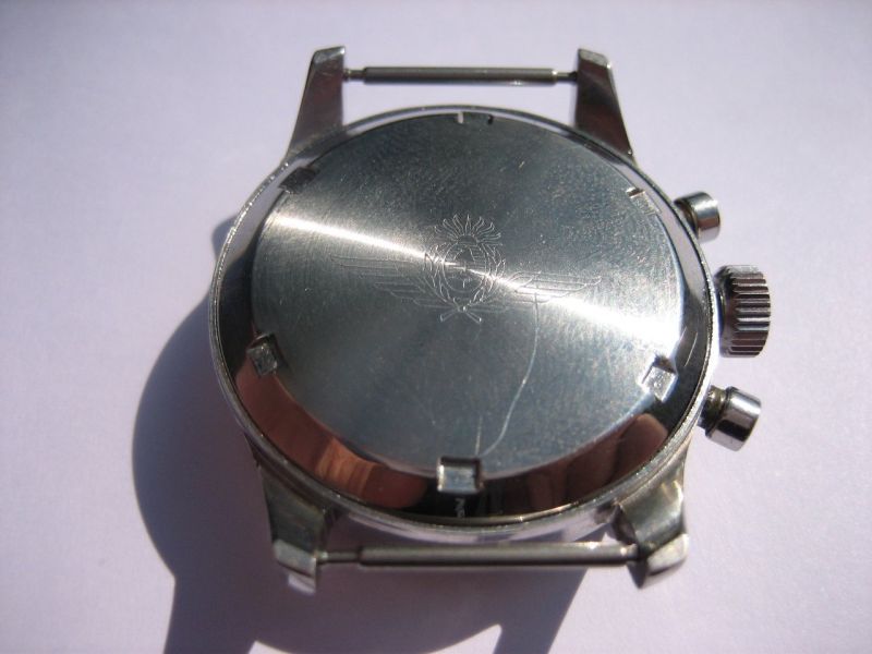

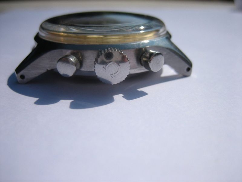

I have been collecting and buying as a foreigner for 15 years in Argentina . And had a few Argentinian military pieces most most of them bought from first owners or families only two chronographs where used in the Argentinian Airforce The Heuer Autavia from the 1960s , and the omega 2451 . The davidoff example is a fake one.
Original one
2,052
5,995
that is a nice Watch... is the drop hand original to the Watch?

Thank you , the hands are original , note the difference in the finesse of the lines in the wings .

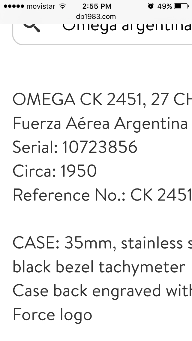

So is the watch in the link in the OP not a genuine Argentine military watch? The engraving on the case back looks the same but t here are clear differences in the dial and hands.

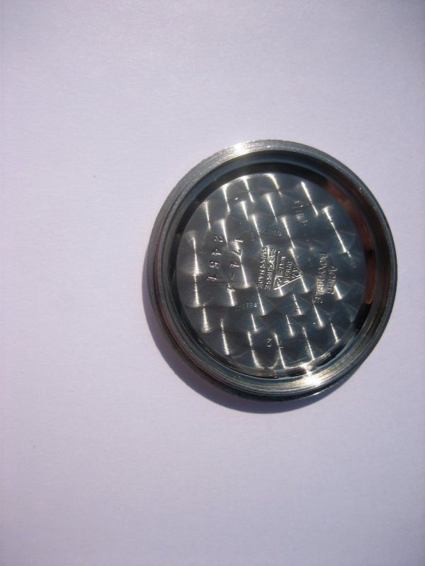

Compare the left wing the lower lines , OP is thicker and diferent from the right lines , the stamp really raw.
Besides it's is such a bad fake I know exactly who made or sold it . It's a small world in Buenos Aires.

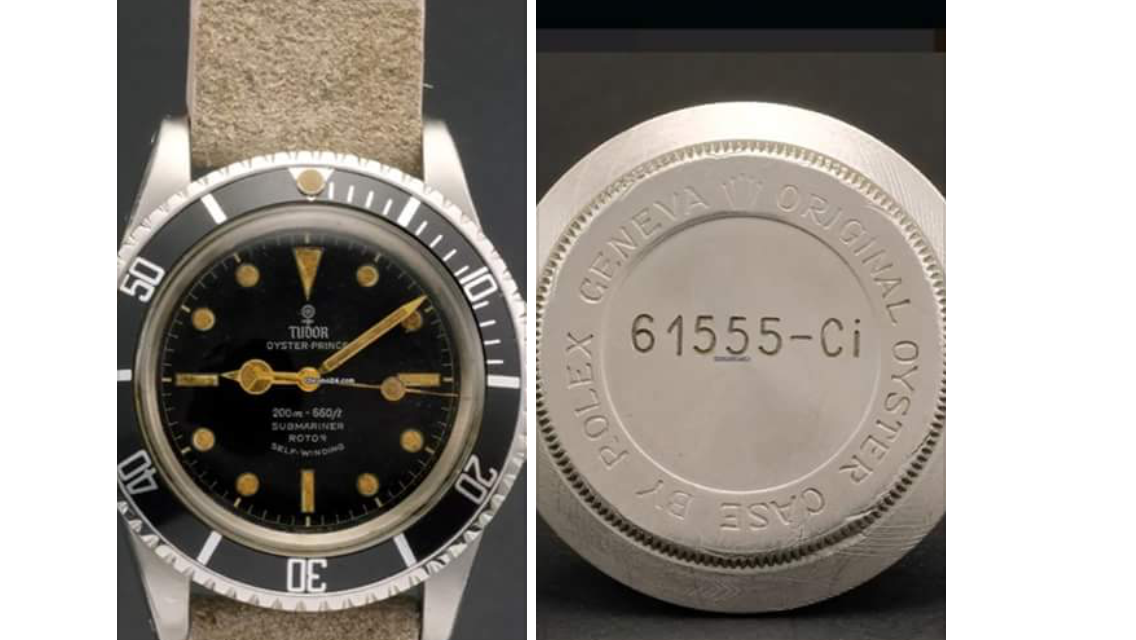

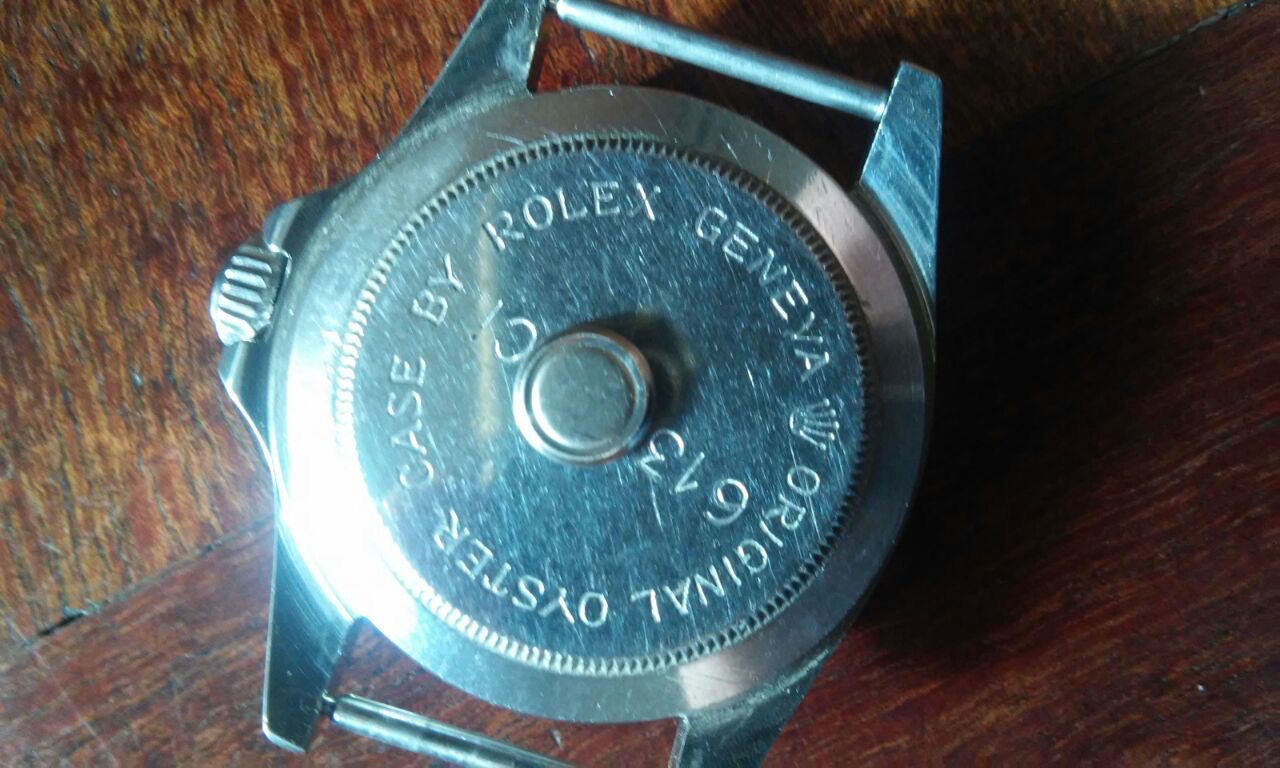

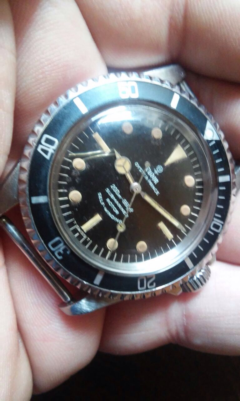

Anther example of a fake Tudor Mil, cuerpo infanteria sub offered by a respected dealer in Switserland ,
And an original one
The number sequence does no correspond with the serial number and year , the case back has been grinded and the font is different.

Typical for Argentine military watches is that the engravements are always consistent.
As for the Argentine C.I. Tudor subs there are some consistencies kept secret by afecionados to prevent faking. But anotherone is they all have clean case backs without engravings from watchmakers and I believe it is the same for the Omega and Heuer chronos.

Interesting. We disagree. Having had two Autavias and this one and seen several Omega Chronos with the FAA engraving on the back.
First, the engraving is genuine.
Second, the Omega Archives wouldn't state Argentinian Air Force if it had been delivered elsewhere.
Lastly, military engravings are not perfect or always comparable, but the technique is usually the same. If they were all engraved the same day and in the same workshop, there would still be slight differences.

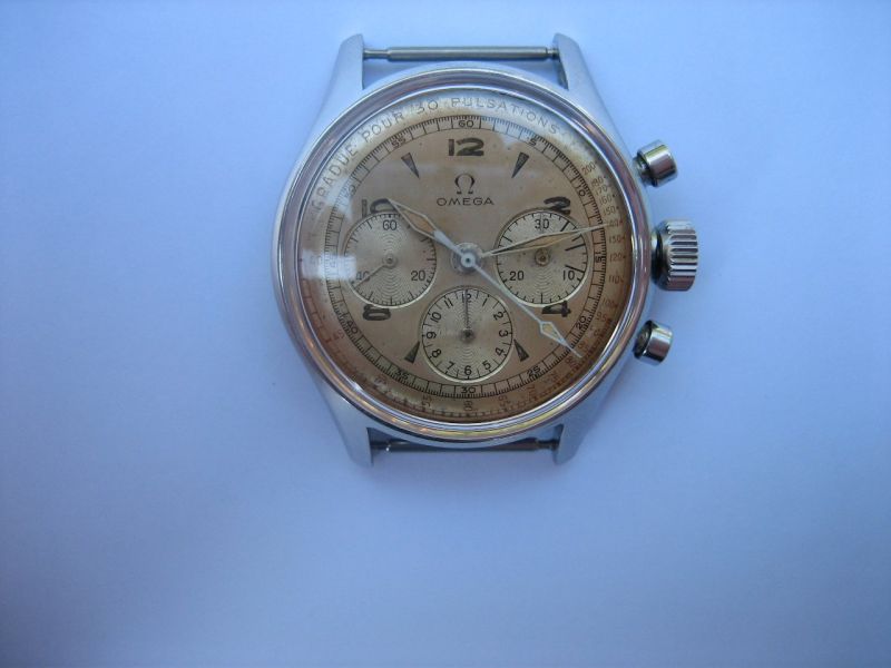

i`ve had a few Argentine mil. watches over the last 25 years. when everything was cheap and there was no need to fake engravings.... but your original here makes me wonder...... there is absolutely NO Benefit for any pilot on this planet to use an issued Airforce chrono with a pulsometer scale for doctors. so, mil. watches are a tricky field. you should know a bit, before dressing things up . kind regards. achim

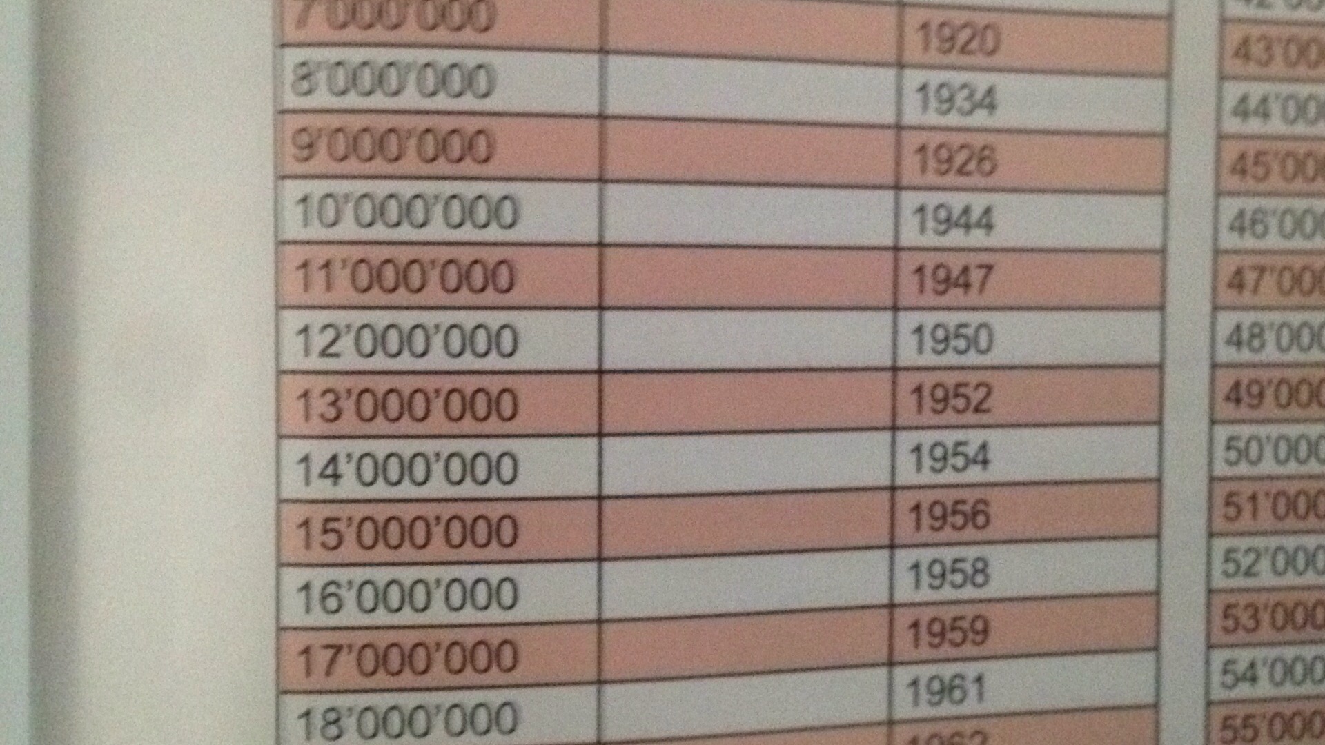

So I did some inquiries about the Omega for sale, just to be sure with Argentina collectors and major dealers.
We all agree it is a Fake. And trust me we know.

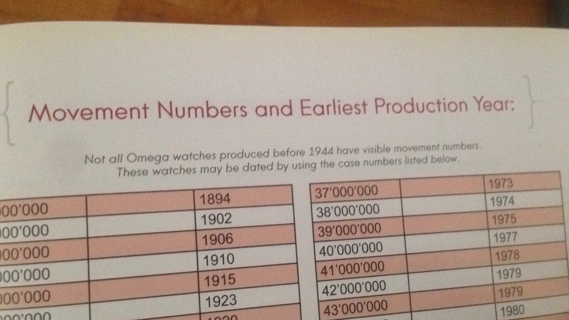

Omega chronographs for the F.A.A. Where introduced from 1951 . Which is serial range 12,000,000 chro 27 and above.
The davidoff example is serial 10,000,000 1944 range. ( second world war still going on by the way )
Also a fellow collector major dealer from Argentina commented that if you look at the serial number of the Davidoff example is laser engraved and does not match the color of the engeavings on the bridge. And it very probably a lemania converted into an Omega.
