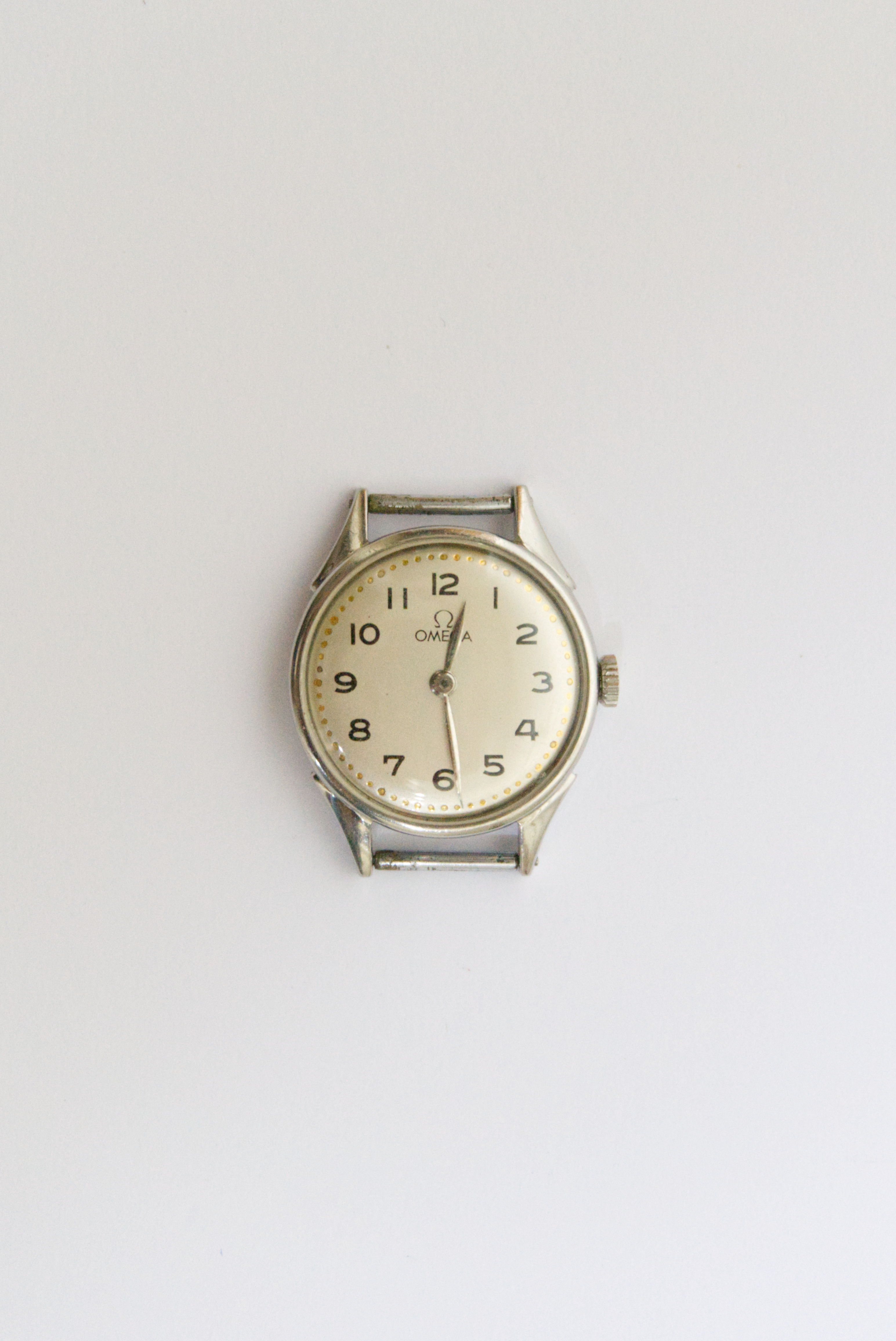

Posts 1 Likes 0 Monty6755 ·Aug 7, 2021 Hello all, this belongs to a relative who inherited it a number of years ago, small (23mm) omega with the serial number putting it early 1940’s - also 15 jewel. Do you think the watch dial is original, I cannot seem to find one similar? Thank you 😀 Edited: Aug 7, 2021
Posts 5,631 Likes 5,815 SkunkPrince ·Aug 7, 2021 I would say the dial was refinished, but that was common back in the day.
Posts 10,804 Likes 16,814 padders ·Aug 8, 2021·Oooo subtitles! Modern Omega font = redial some time after ~1975
Posts 352 Likes 308 Azveld ·Aug 8, 2021 padders Modern Omega font = redial some time after ~1975 I agree, the logo is too modern and corresponds to the 70s
