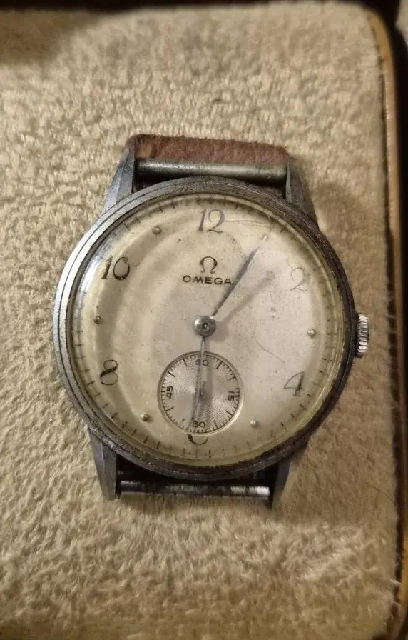

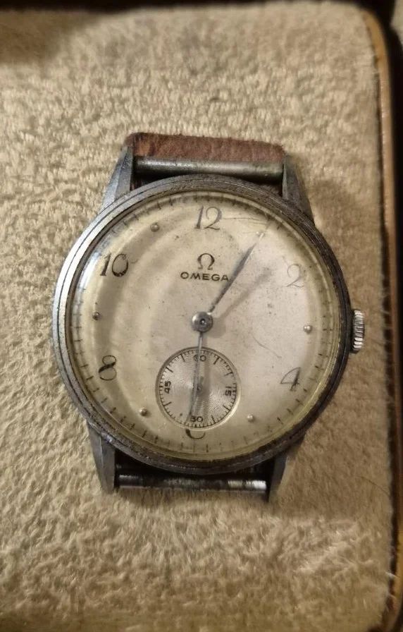

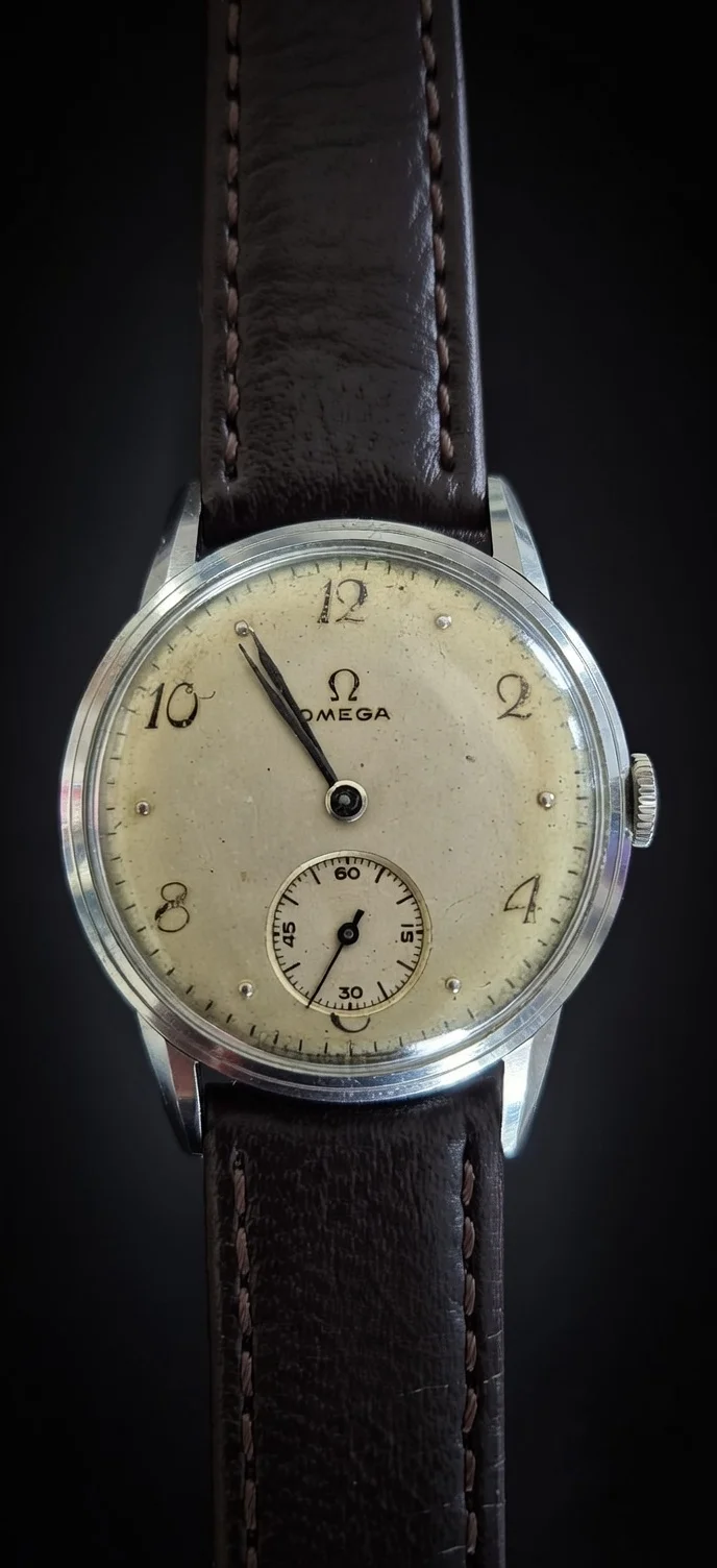

Dear OmegaForums community,
I hope this finds you well. I recently acquired this vintage Omega dress watch and would greatly appreciate your expert eyes and knowledge to help identify it more precisely.
Key details:
  • Case: Stainless steel, exactly 30 mm (without crown), straight lugs, original signed crown.
  • Dial: Original cream/silver with beautiful, even tropical patina (natural uniform aging - no heavy spotting or damage). Selective Arabic numerals (positions 12, 10, 8, 2, 4), small seconds at 6 o'clock.
  • Movement: Manual winding calibre 30T2 SC (small seconds), fully original. Recently fully serviced by a specialized vintage watchmaker: full maintenance, one main part replaced with genuine Omega part, exterior cleaned preserving the tropical patina. Runs perfectly with good amplitude and accuracy. Certificate from the watchmaker included.
  • Condition: Excellent for its age - fully authentic, no redial, no refinishing, no major scratches or over-polishing. High-quality leather strap recently fitted. The attached image shows the watch prior to the professional restoration, full service, and cleaning by a specialized vintage watchmaker.
  • Year: Circa 1940–1945 (post-war early production).
From my own research it appears to be a CK 2181 or very close variant in the CK 21xx series (small 30 mm case, selective Arabic dial layout), but I would love confirmation from those more experienced with these early 30T2 watches.
Questions:
  1. Can anyone confirm the exact reference or narrow it down further (perhaps based on serial/caseback markings)?
  2. How rare would you consider this configuration (30 mm steel case + cream tropical dial + selective Arabic layout)?
  3. Any known production numbers or catalogue references for this size/dial variant?
I'm based in Spain and happy to provide additional close-up photos or details upon request.
Many thanks in advance for your time and expertise - this community is always incredibly helpful.
Best regards,Juan
1,453
3,023
Firstly the image is not great, please try to take photos during the day is a brightly lit area, perhaps on a window sill. This will make our assessments more reliable, as it will make the process as close as possible to having the watch in our own hands.
Now, on first inspection, it looks to be all original, with an original dial in good condition, and original hands. The crystal might be a bit foggy or scratched which can be replaced and greatly improve the look of the watch.
If the case measures exactly 30mm as you suggest the movement is not a 30T2 as this is physically impossible, the case has to be at least a couple of mms larger than the movement otherwise how will it hold it? If you can remove the caseback and provide a photo we can assess the movement. It could be a 26,5 or maybe even one of the rectangular shaped movements. The year can be more accurately determined when we see the movement serial number.
This is not a CK2181 and in fact it's nothing like it so I'm not sure why you've come to this conclusion. Just look at the lugs they are completely different. I recognise this case but we need to confirm what information you have provided is correct and what isn't before proceeding, either by remeasuring the case, or removing the caseback. A snap back case can be removed with a knife, a screw back case will need to be twisted off.
In terms of rarity, a watch from this era in good condition is rare in of itself, and make them certainly more rare than say a 1960s seamaster by the order of magnitudes. This does not necessarily translate to a more valuable watch though, as people 'know' seamasters, as a name immediately makes a product more saleable.
I look forward to learning more about the watch, it's a nice example.

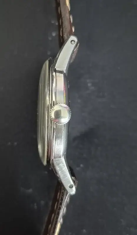

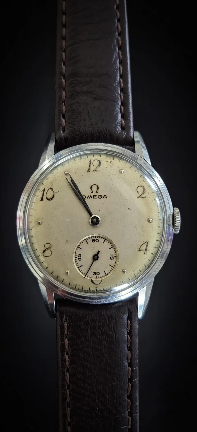

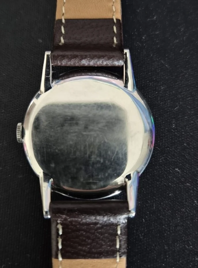

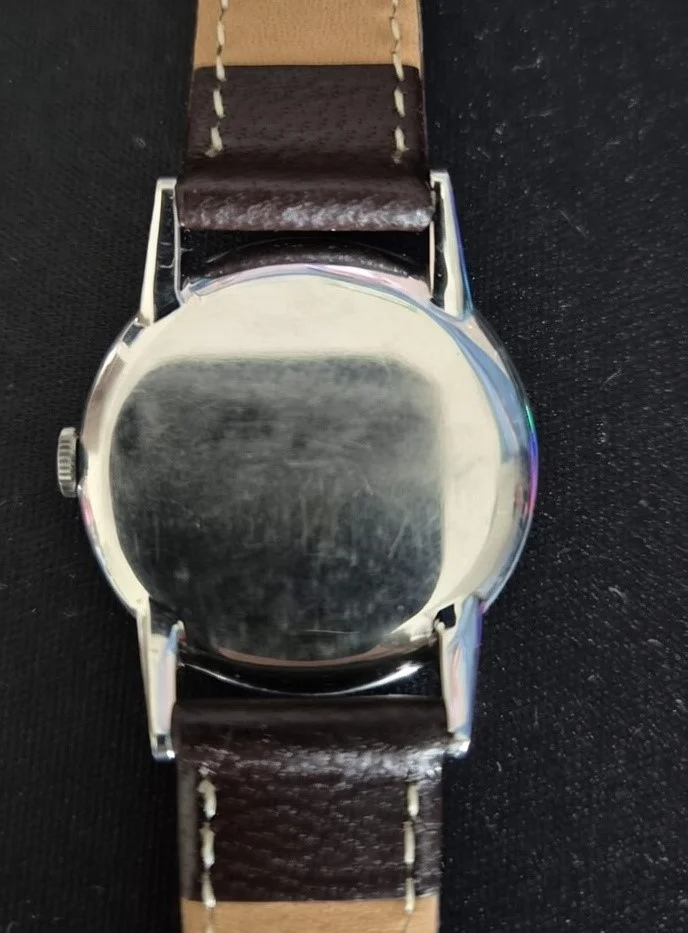

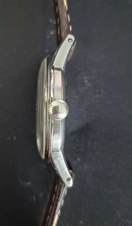

Hi, OllieOnTheRocks,
As requested, here are more details and additional photos (all taken after the recent full service by a specialized vintage watchmaker):
  • Case reference (engraved inside the case back): 9789785
  • Serial number (also inside the case back): 10230511
  • Marking on the movement (bridge/plate): R178
  • Dimensions:
    • Diameter: exactly 30 mm (measured without crown)
    • Thickness: 5 mm (including the domed crystal)
  • Other notes: The watch has been fully serviced (complete overhaul, one main part replaced with genuine Omega spare, exterior cleaned while fully preserving the original tropical patina). It now runs perfectly with excellent amplitude and accuracy. A high-quality brown leather strap was fitted.
Attached are several new photos showing the watch post-restoration and in running condition: front dial views, side profile, case back with engravings, and a couple of close-ups of the movement markings and tropical dial.
Many thanks again for your help - I’m really looking forward to your thoughts!
Best regards,
Juan

Thank you for your details - the serial that we generally refer to is the one found on the movement. Are you able to provide us this?
As suspected the movement is not a 30 calibre, you note it is a R17.8 which is one of the rectangular shaped movements I was referring to. If you search this forum you will find an interesting thread where people have posted their omegas with this movement. It serves as a nice reference for the references available at the time. It’s quite enjoyable too seeing what else is out in the wild so to speak.
This now all makes sense , however I would
Note that now that we can see the watch more clearly there is an issue with the hands - I suspect the one on the right is the minute hand, but as they are practically the same length it’s hard to tell - the minute hand should extend to the minute track. So at least one of these has been replaced or more likely by the looks of it broken, as the one on the right does not appear to be symmetrical in shape.
Armed with the correct movement calibre (R17.8), case diameter (30mm) and the reference image showing the shape of the case you may be able to do a little digging to find the case reference online or on this forum. It is a fairly common case that I have seen on numerous occasions so you will likely find other examples for reference.
Do not be concerned if the dials are different as unlike modern watches Omega made tens of different designs.
Best wishes,
Oliver
