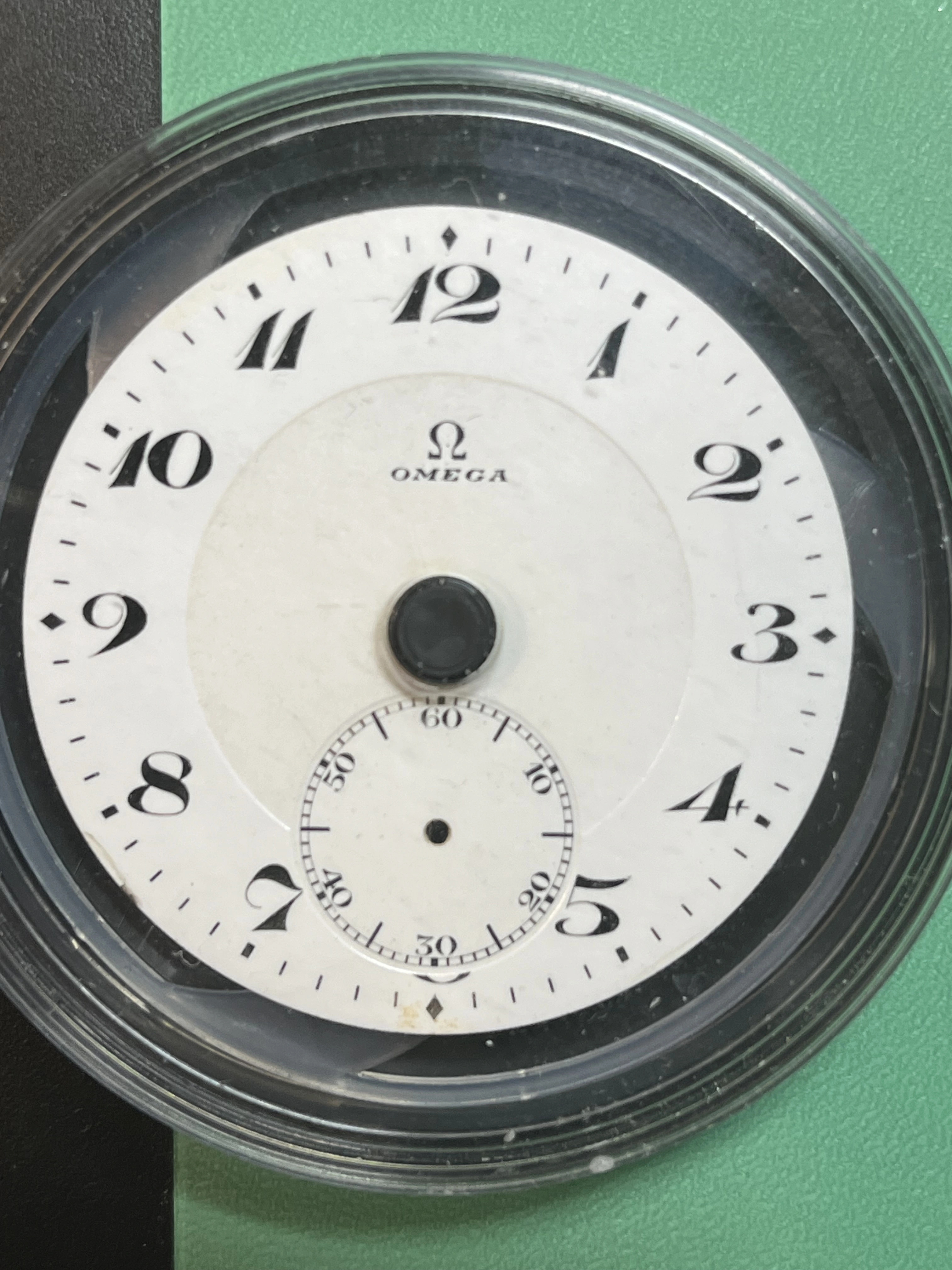

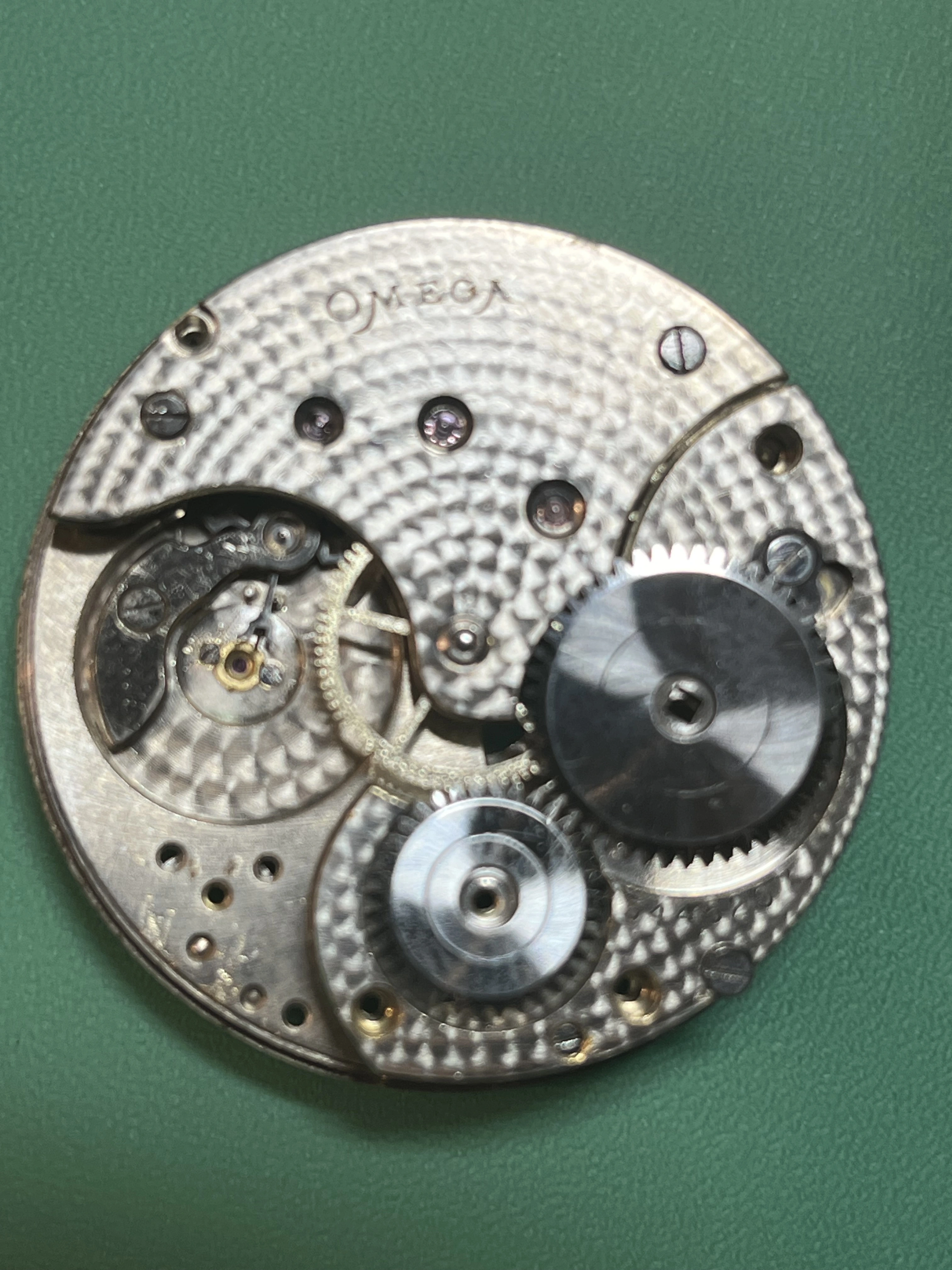

I have an Omega pocket watch in pieces I am trying to identify. I am hoping you can help me. I want to order parts for it. I measured the baseplate and I get 38.4mm. My latest guess is that it is 19”’ lignes LOB (Lepine, Omega, B quality) with 7 jewels. The finish seems unusual. Any input or advice will be appreciated.
8,889
62,985
fish scale finish less common the Geneva Stripping in that era
3
Thank you, Tex. So, do you think it’s a 19’” LOB?
18,851
39,205
If the plate is 38.4mm then it's probably an 18'''.
