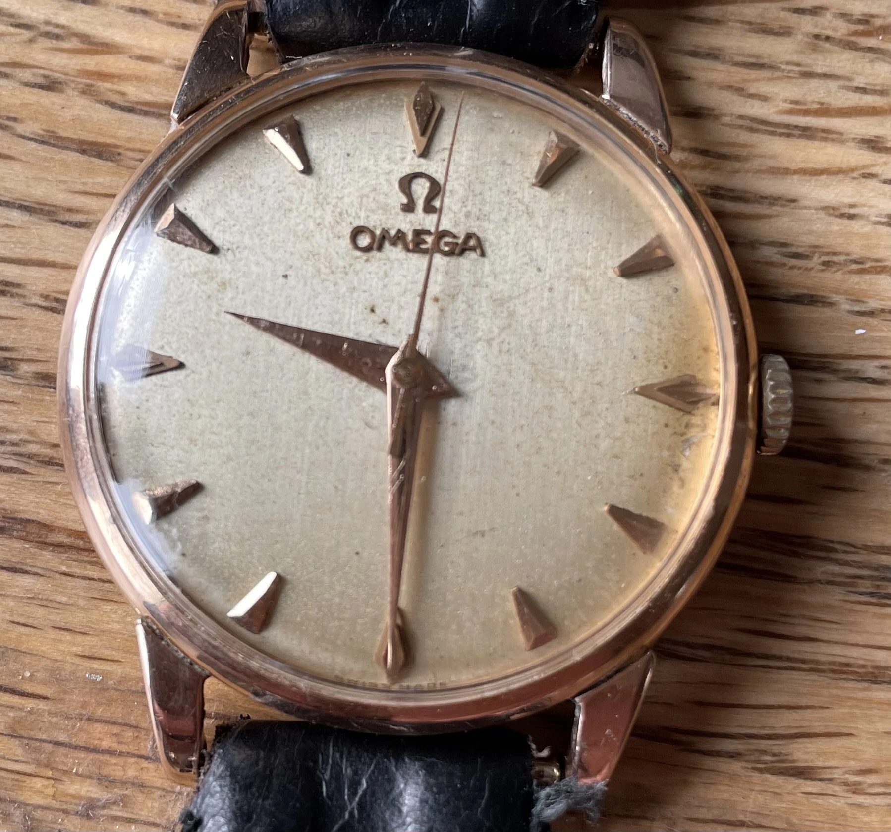

Hello people …. New omega forums member here
I’m trying to find more information about this specific omega 2895 Tresor .
With 284 movement and it dates to 1958
It’s in 18kt omega stamped “Swiss “ case and indices are 18kt but the dial is lighter coloured gold
Would anybody know if dial is actually real gold or just coloured or plated or something ?
This watch has a replacement plated crown without omega symbol and in poor condition.
Are 18kt rose gold hermetic replacement crown available?
Also the hour hand is scratched and buckled slightly by someone who repaired it previously are these also available in 18kt rose gold ?
I’m in UK if anyone can point me in the right direction
Any other info is greatly appreciated

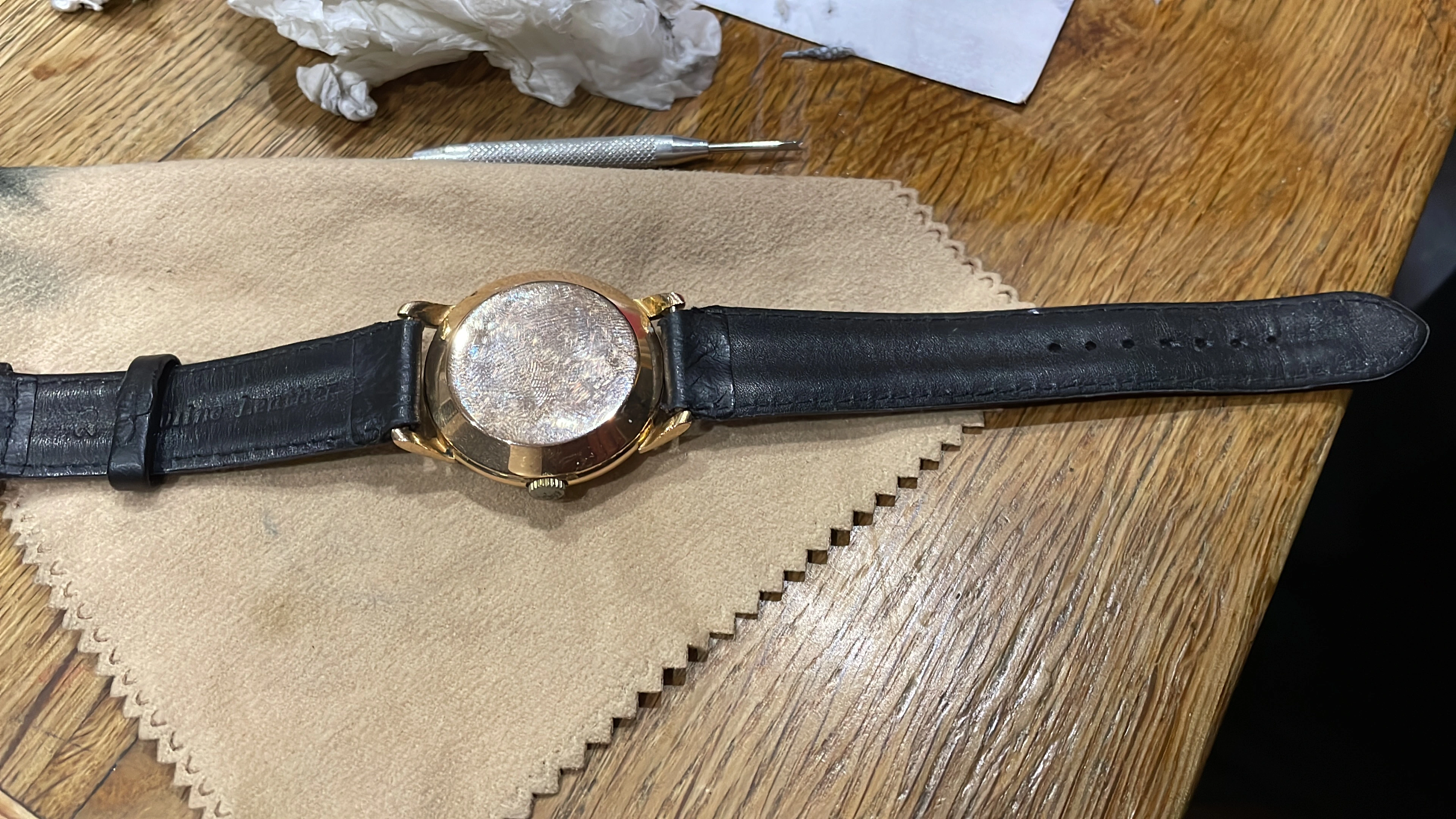

IMO these are not the only problems with your watch.
Most likely the dial had a harsh clean as I can´t see any minute hashes.
The crown will not have been solid gold on this model originally, so search for a gold-capped crown which are available on ebay.
What about the strange pattern on the case back? Is this some kind of a protection sticker?

I’m not sure regarding minute markers but Swiss made is still there at 6 o clock on mine
And the only other 2895 that I’ve seen which is same doesn’t have them either -https://www.alexandrelandre.com/en/lot/151698/25394768-omega-ref-2895-bracelet-watch-in-18k-rose-gold-round-case
Which leads me to believe they didn’t have them on this dial variant?

The watch shown in the link has what seems to be an 18K solid gold dial - so these are easy to "wash" if the lacquer had deteriorated.
You will have to pull the dial on your watch and check the back if there are any gold hallmarks - this is the only way to find out if the dial is made of solid gold and not just gold plated.
I must admit I am not an expert on these Tresors but I doubt that the dial left the factory like this - but I will gladly stand corrected if any of the Pros who own the same model chime in with better insights...

Ok thanks…
Regarding caseback it’s just greasy fingerprints and my terrible pics ,sorry

Back of the dial, not caseback.
Sorry Dan but I’m at a loss to what your actually saying
The other poster asked what the marks on back of case were ,They are greasy fingerprints
I’m well aware the dial would be stamped on the back if it is infact gold if this is what you’re referring towards ?

Sorry for any confusion .The watch has great sentimental value but it’s in pretty rough shape as you can see
I’m trying to weigh up my options as to wether it’s worth trying to get the dial cleaned “if it is gold”
Was hoping someone with experience of this dial variant would know the answer one way or other
The handset/crystal and crown have all seen better days
Been collecting watches for 20 plus years and already have too many to be honest
And in the end may just decide to leave this one as it is with battle scars from my ancestors
