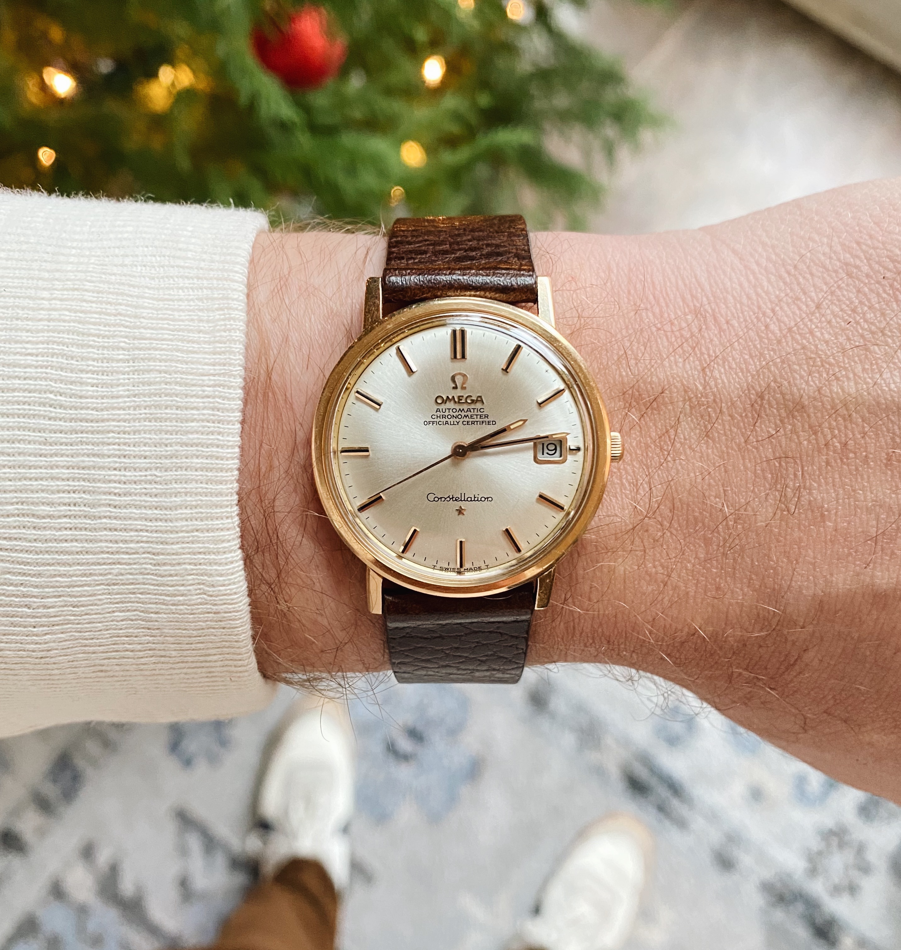

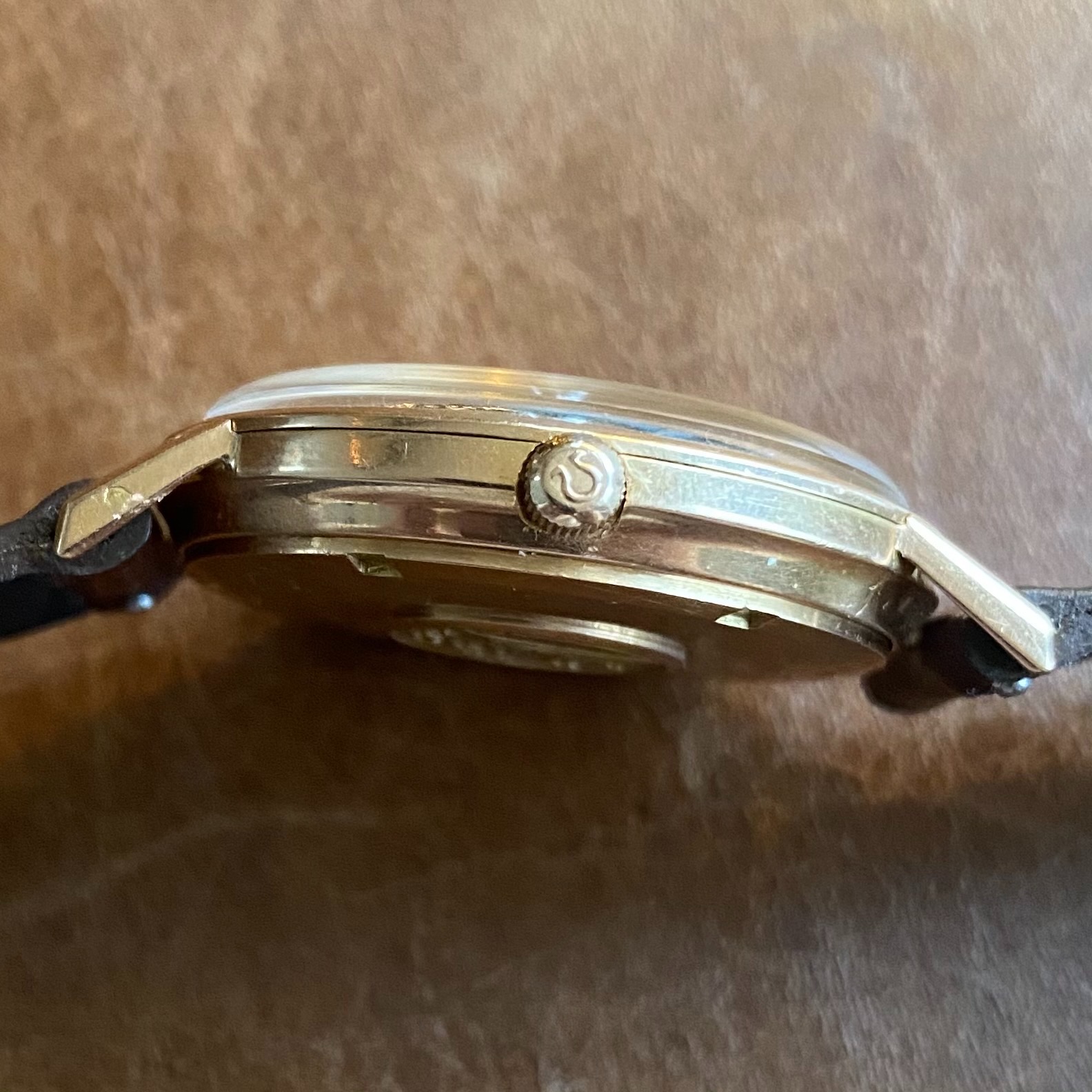

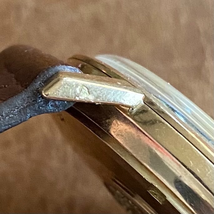

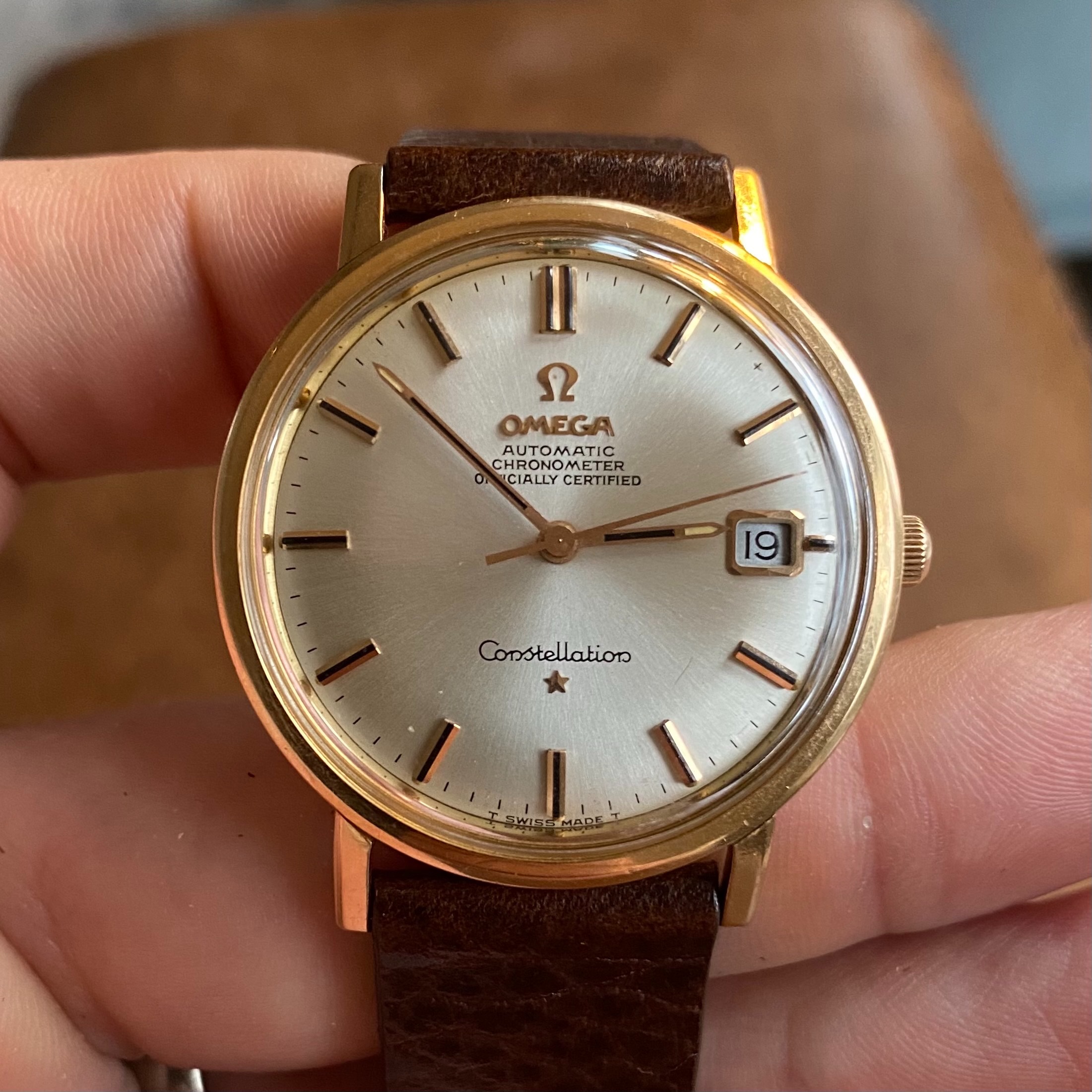

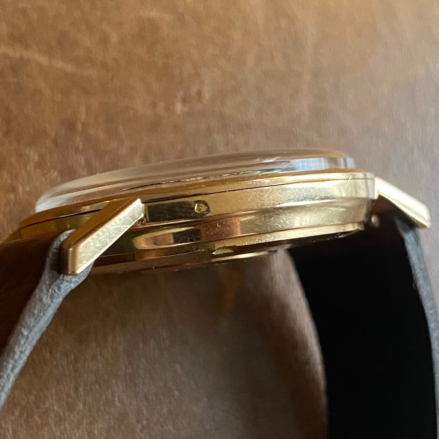

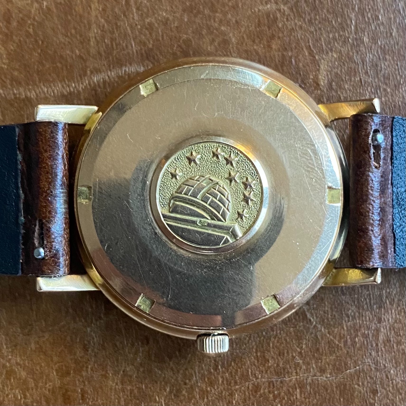

Hey guys!
I'm pretty new to the forum, but a big fan of vintage omega dress watches and speedmasters. I wanted to get some expert opinions on on a recently picked up. It has the eagle head gold hallmarks on the medallion, the side of the case and on the bottom right lug, which from what I'm told means it was cased in France.
My only gripe with it is the crown is tiny. Basically impossible to hand-wind.
Do y'all see anything off with this one?
308
965
Yes nice French cased Connie 😀
Not sure about originality of crown but being French it could be correct. Constellation crowns do tend to be tiny and difficult to wind but fortunately being automatic they don’t need winding often if worn or kept in a winder when not in use.
A tip for a winding charge when you need to though, use 1 finger at the back of the case and wind crown clockwise ie slide your finger downwards over the crown and repeat. You’ll soon get the knack of it and once wound 15-20 winds get it on your wrist, the best place for it 👍

Nice Connie.
French cased equivalent of a ref 168.010.
Lovely sunburst dial with pencil hands, onyx inset indices AND lume. (Very unusual)
The crown is one of the larger options for this reference - the smaller ones are much more difficult to wind.
Almost certainly will have the cal 564 inside with quickset date.
Congratulations.

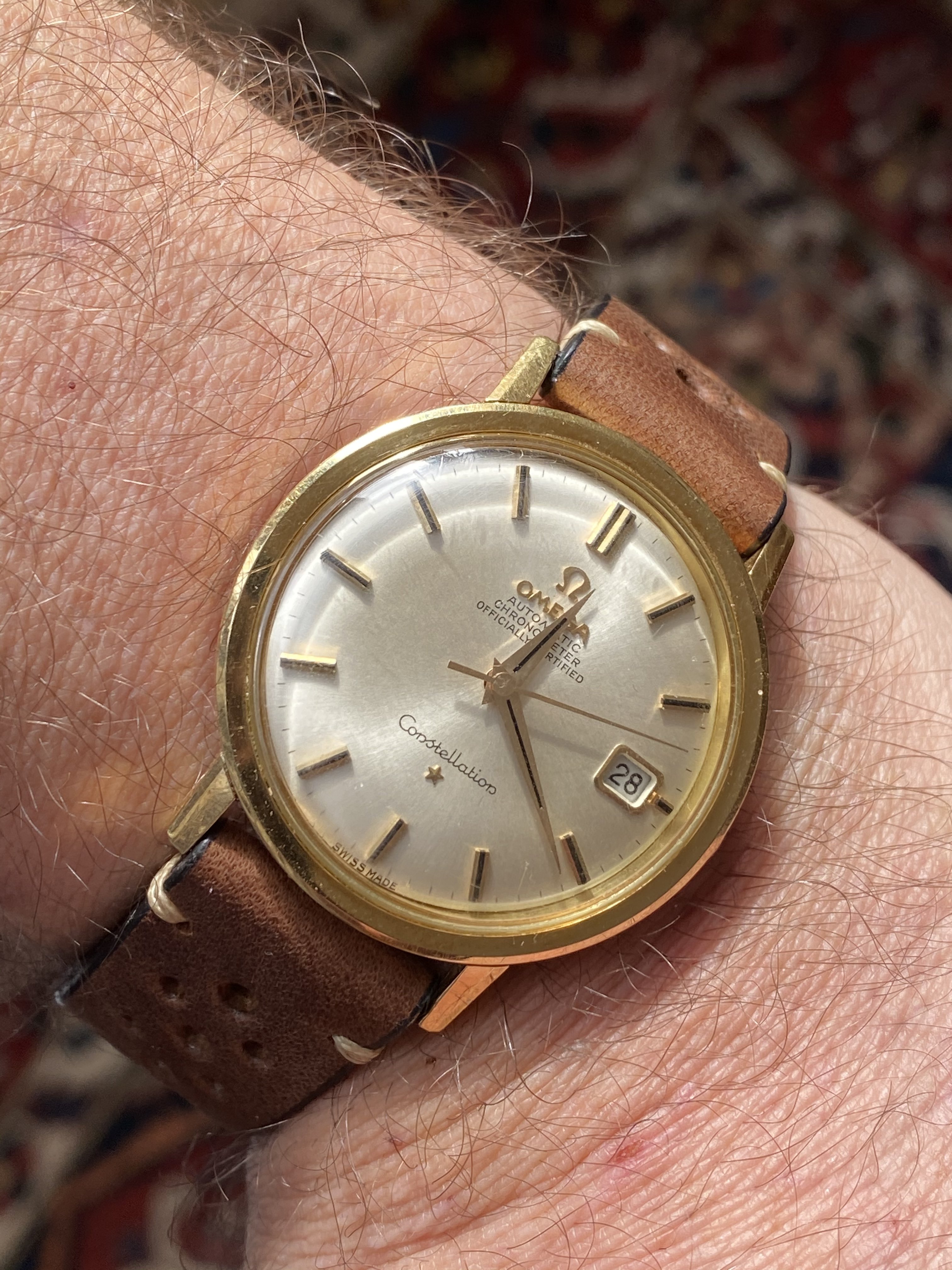

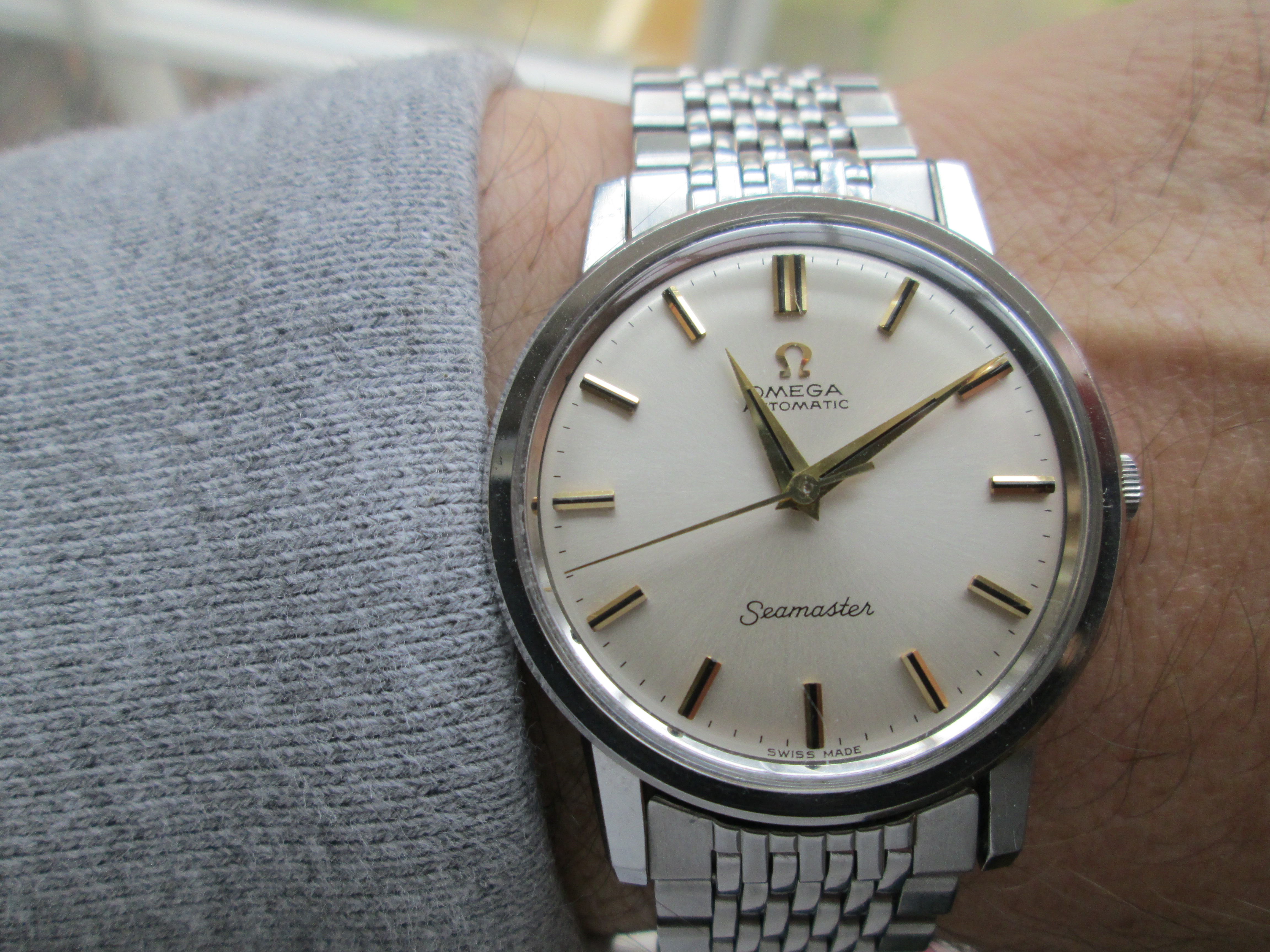

Very nice. As for the crown, it might actually be a larger replacement for the original.
For example, I am sure the the crown on the attached watch is original and obviously designed to be hidden, but it is a real pain to use.

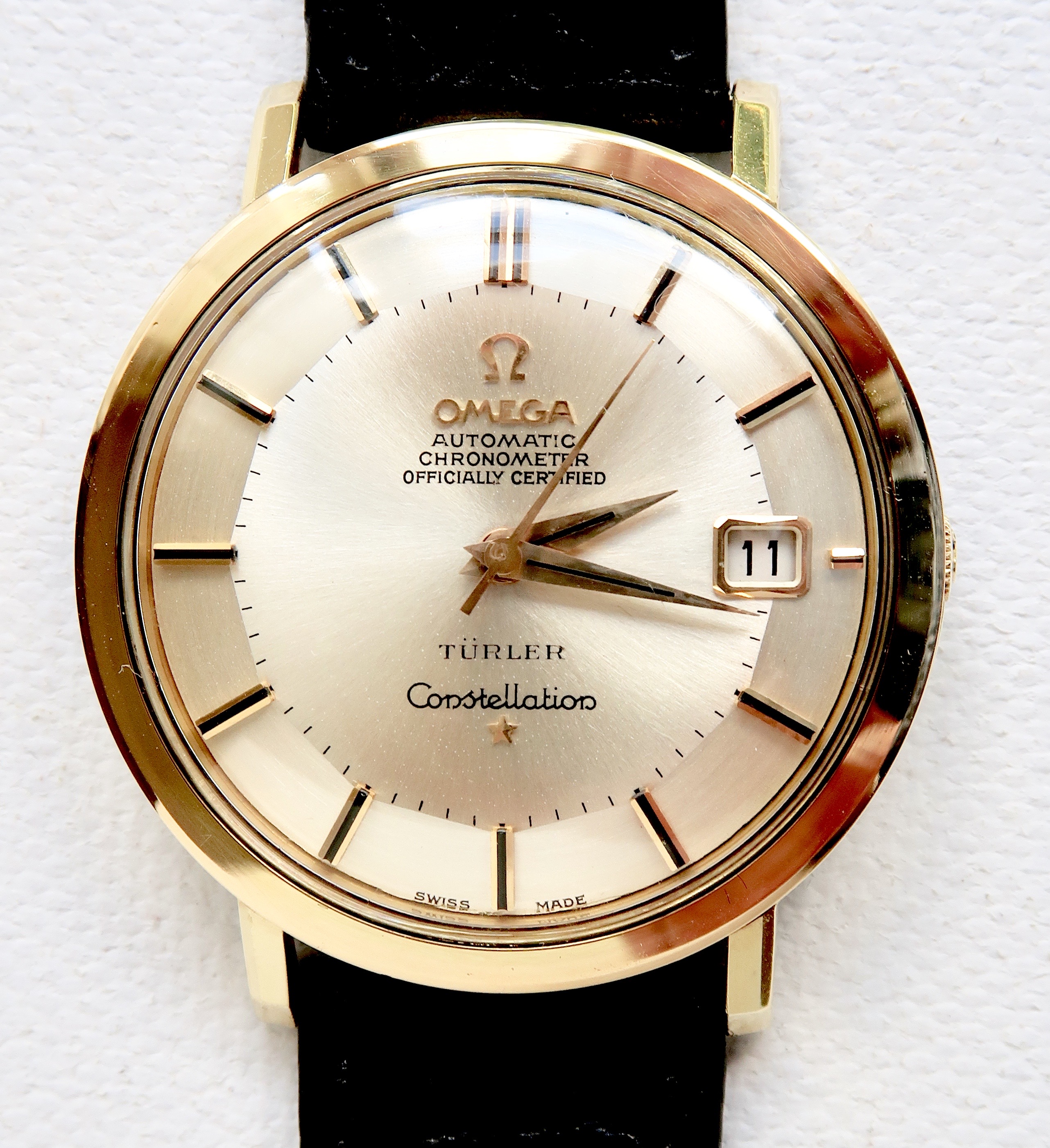

With Connie's, I don't feel bad about replacing crowns that are difficult to use--so I'd say grab another on ebay and swap em. The pie pan crowns with the ten sides are pretty but inoperable, so even those can go.
6,832
10,502
The beauty of these ‘hidden crown Connies’ is just that - the hidden crown.
I’m not sure what the OP would swap it with - he already has one of the bigger versions of a crown for this reference -although there is a flat ended version which gives slightly more purchase area.
Blasphemy!
