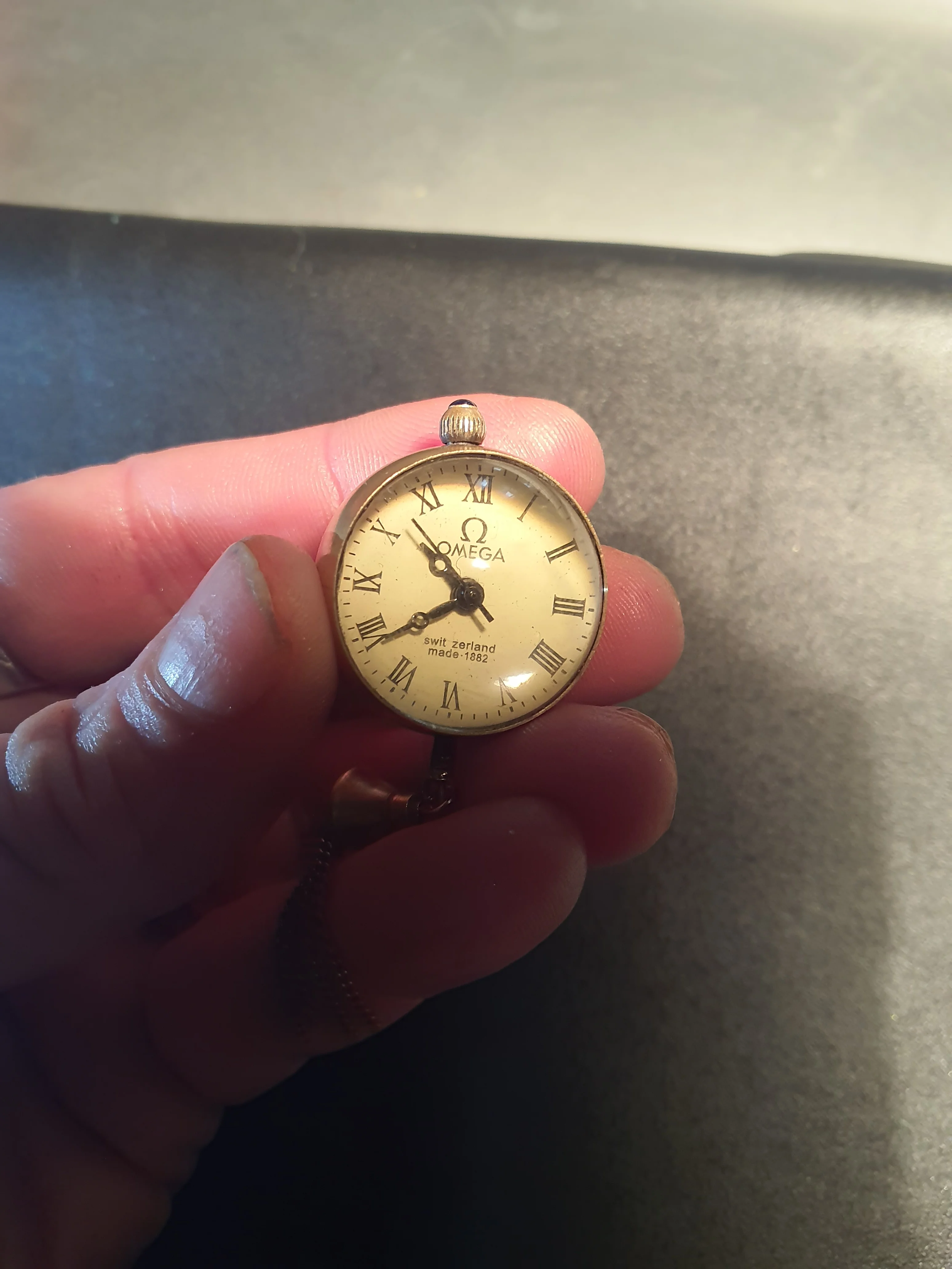

Hi

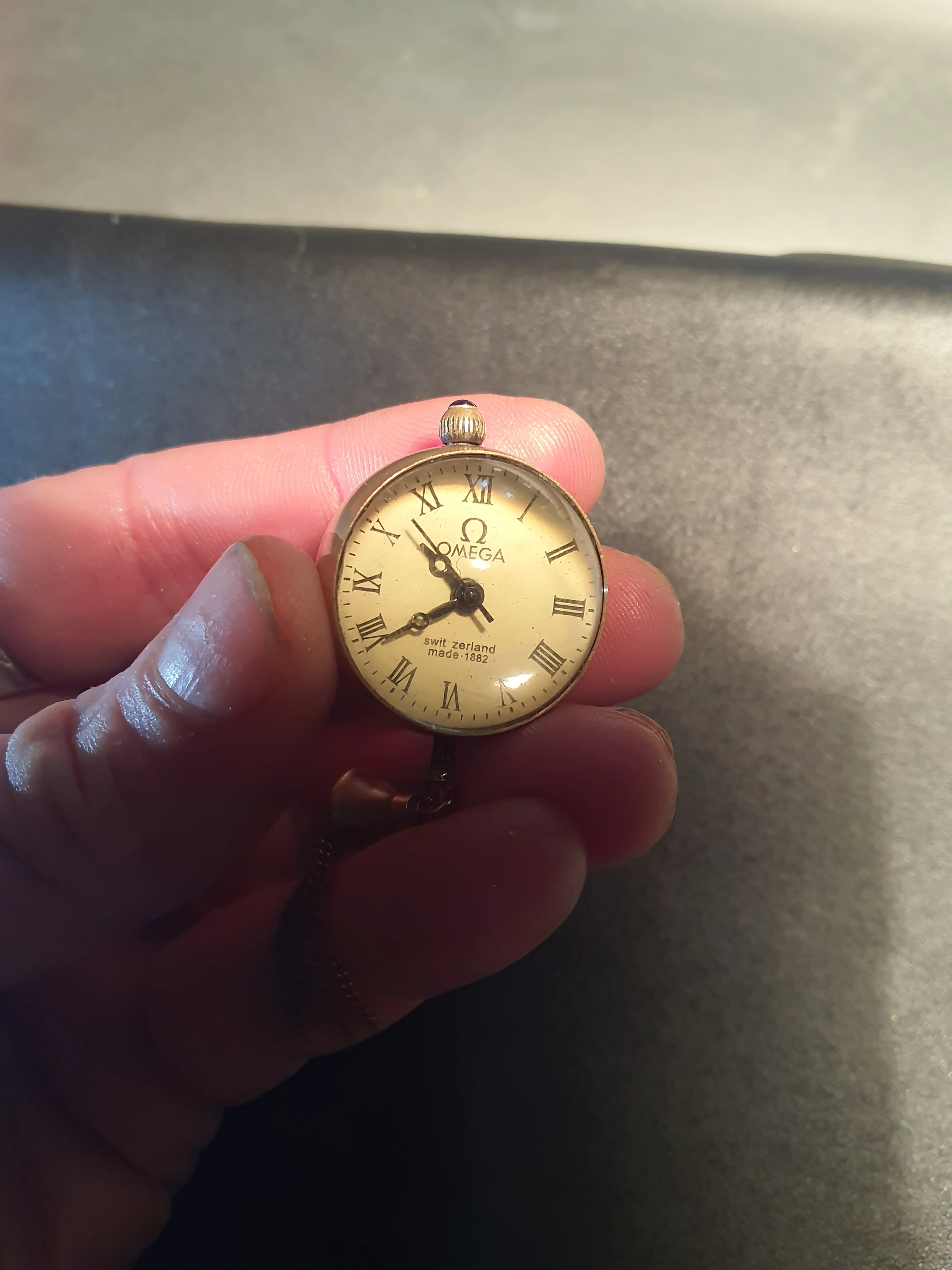

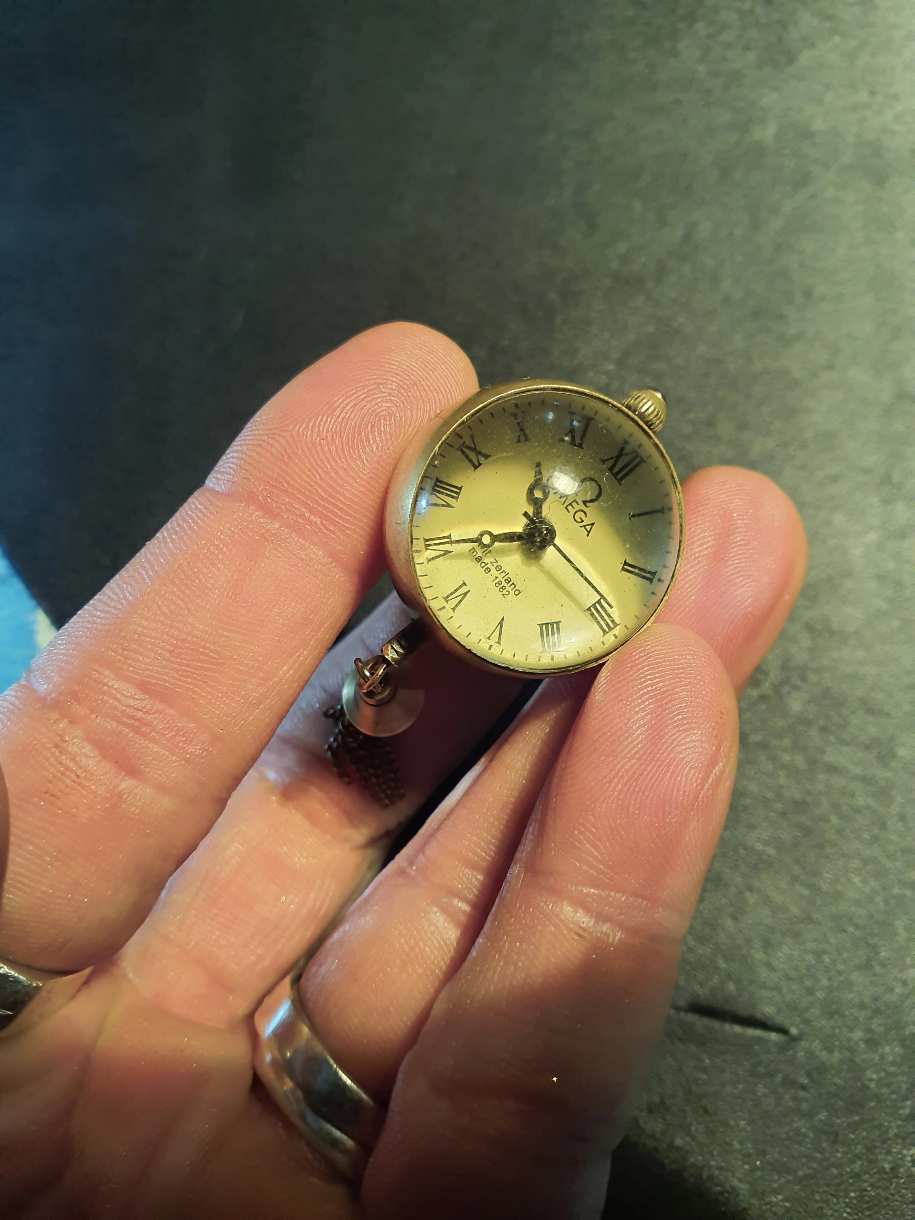

A friend gave me this pocket watch and oim wanting to know is it a authentic omega? Is it worth anything? Didn't come with anything other than itself. No paperwork or box etc

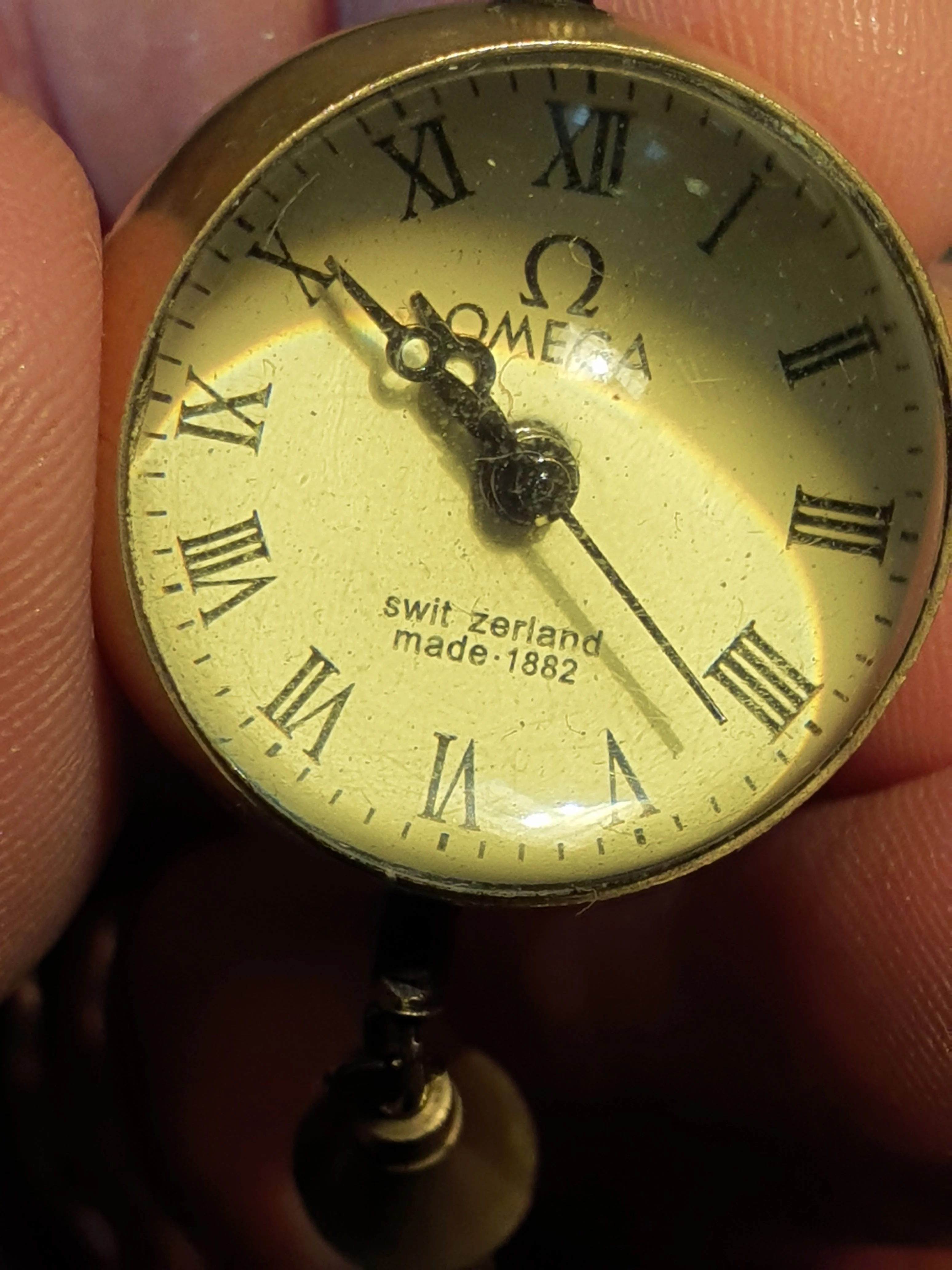

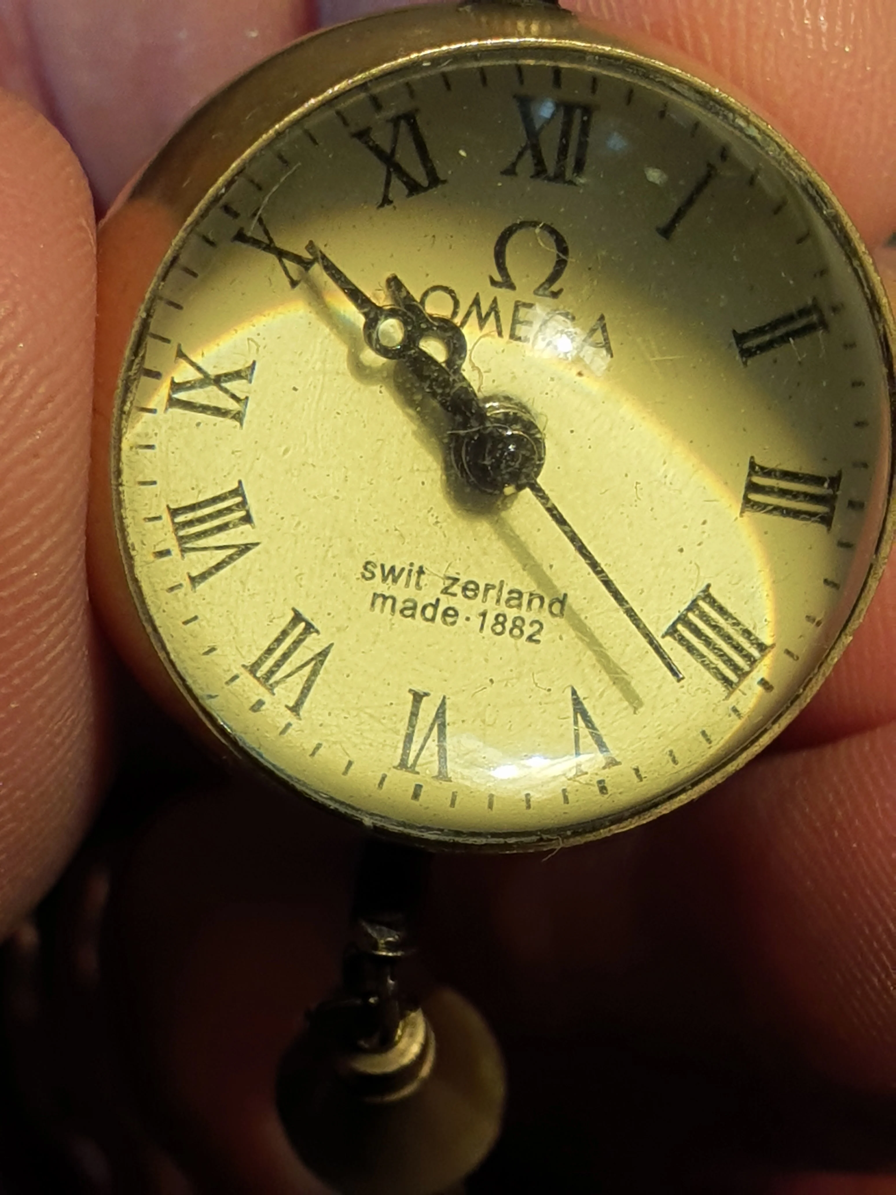

Why? It is fake in every way. Where should we start. The old adage goes! “If wishes were horses, beggars would ride”. Nothing about it is Omega. Even the name on the dial has been stolen. This kind of detritus comes out of Eastern Europe (for one place), regularly. We see them quite regularly. Hope you didn’t buy it!

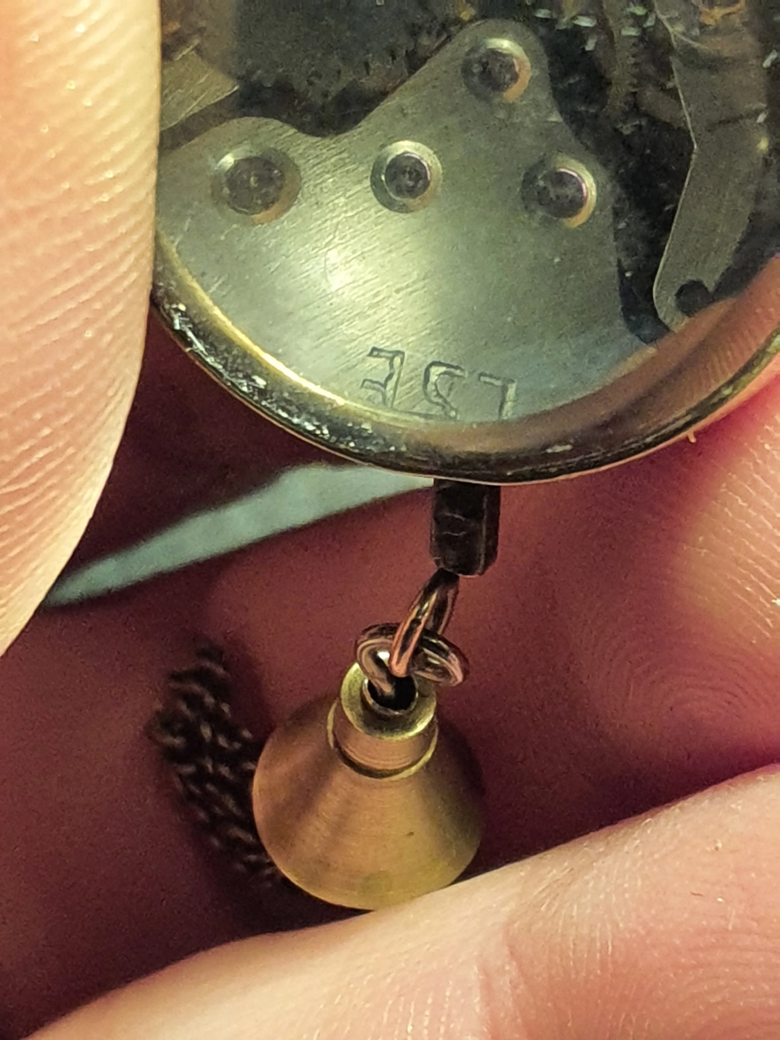

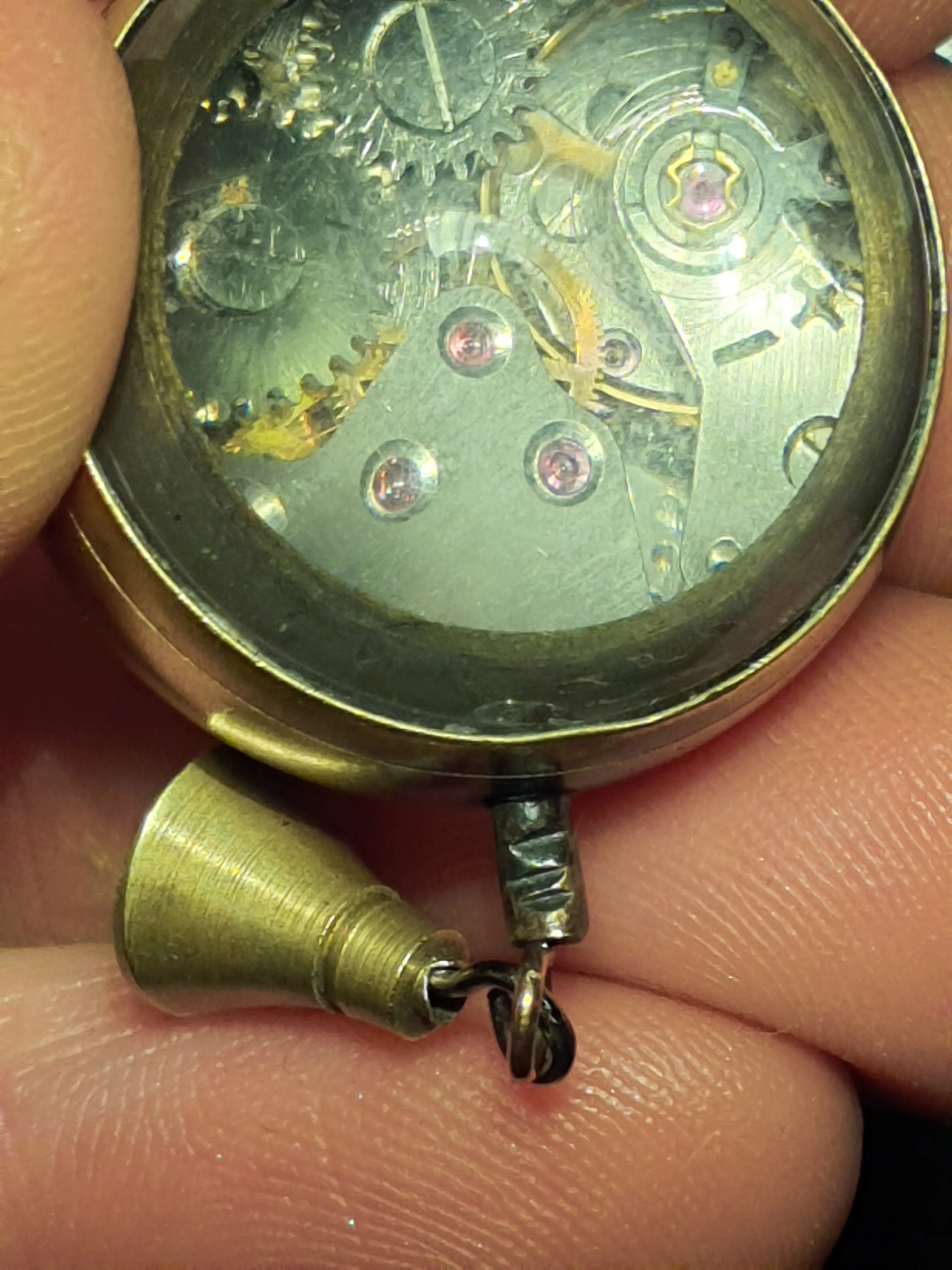

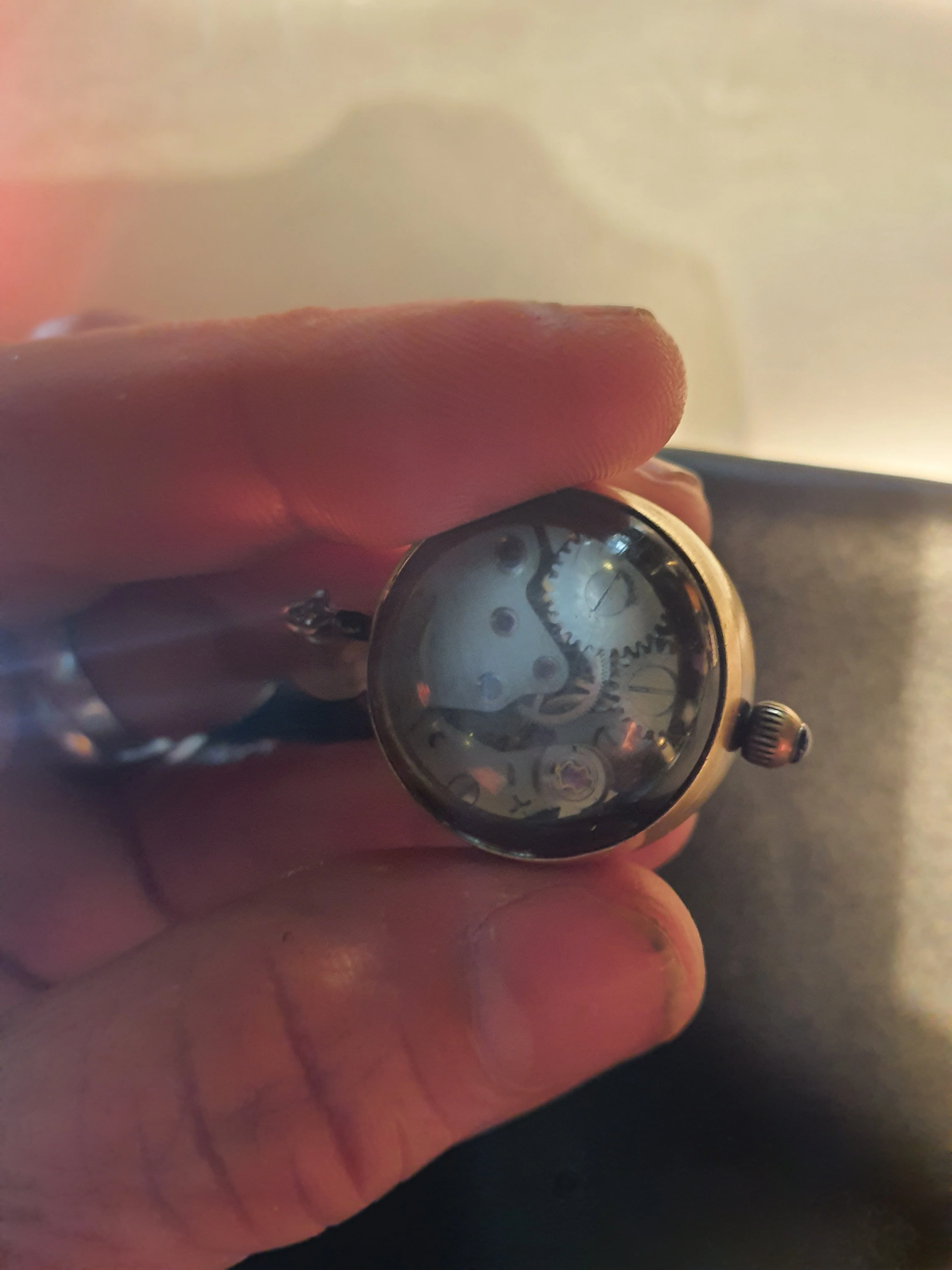

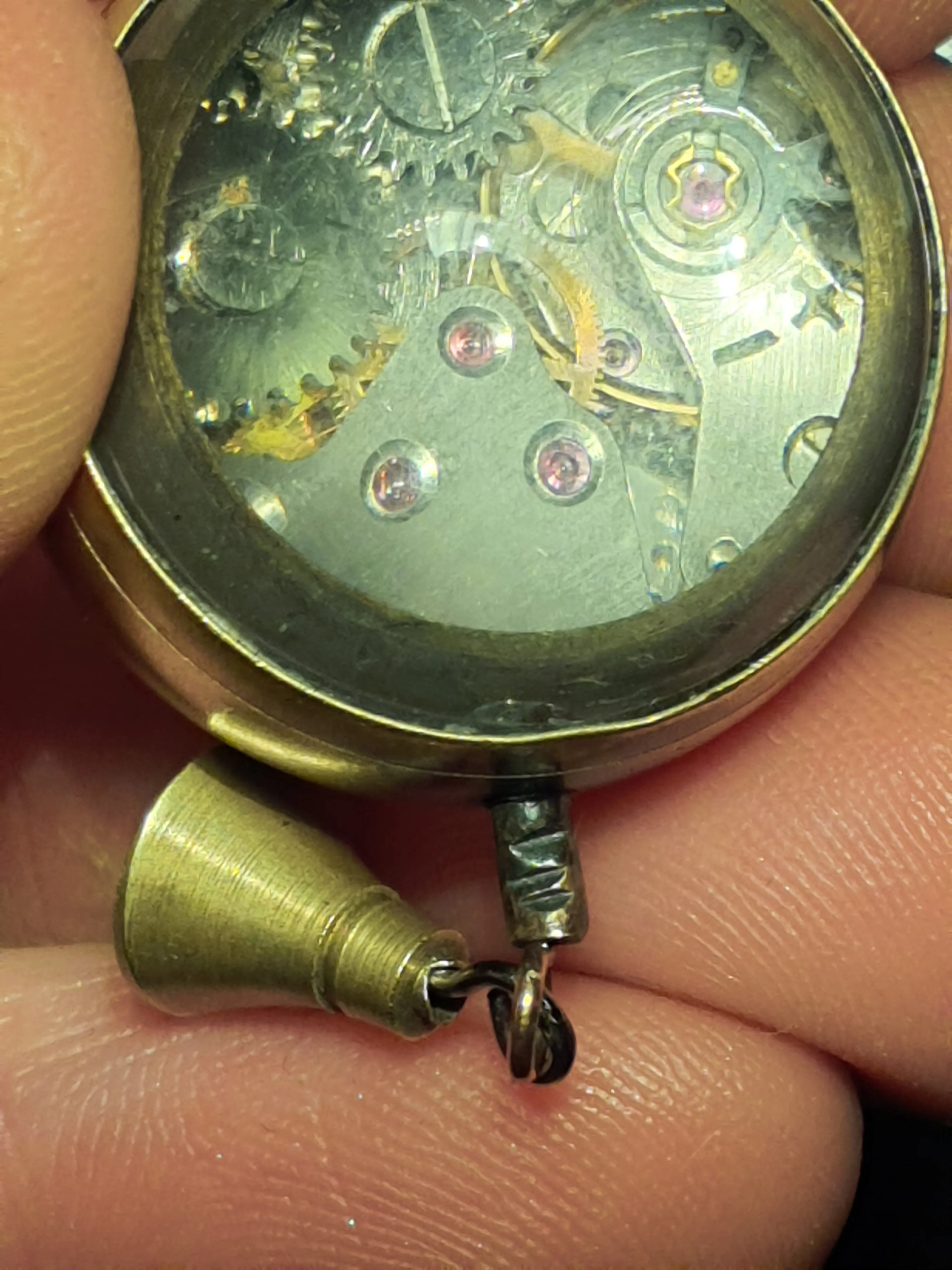

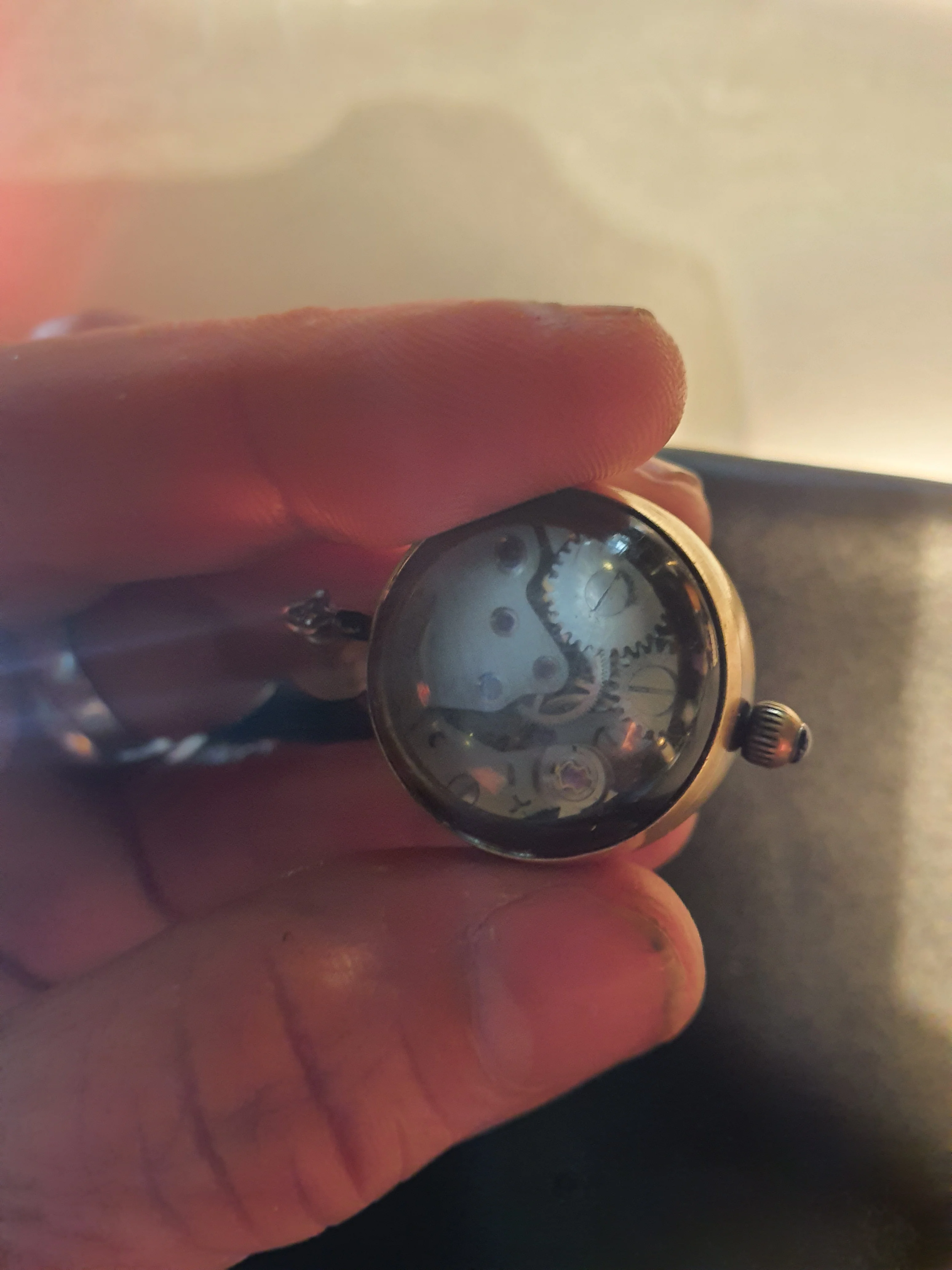

Design anachronism. Incabloc shock protection seen in the movement did not exist in 1882, having been developed in the mid 1930s.
Omega as model of Brandt watches did not appear on watches until the 1890s.

Fake.
