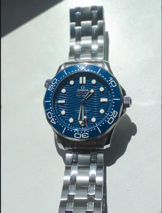

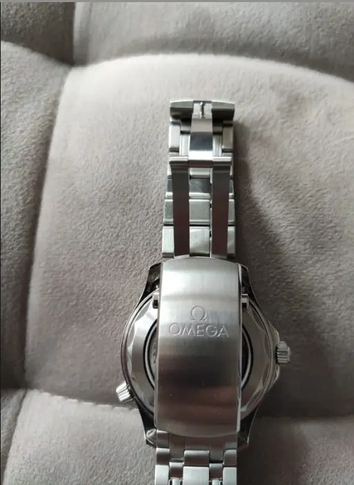

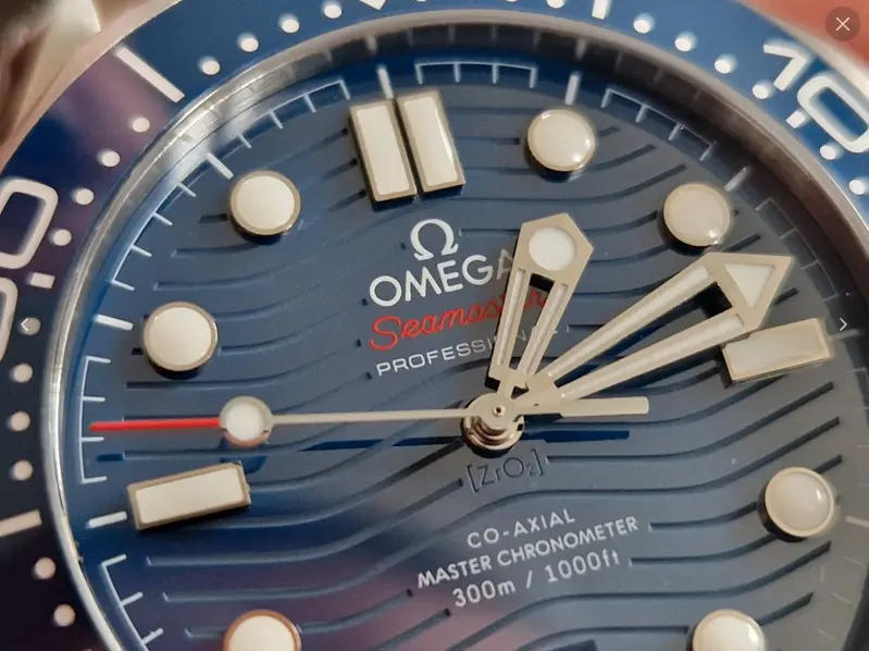

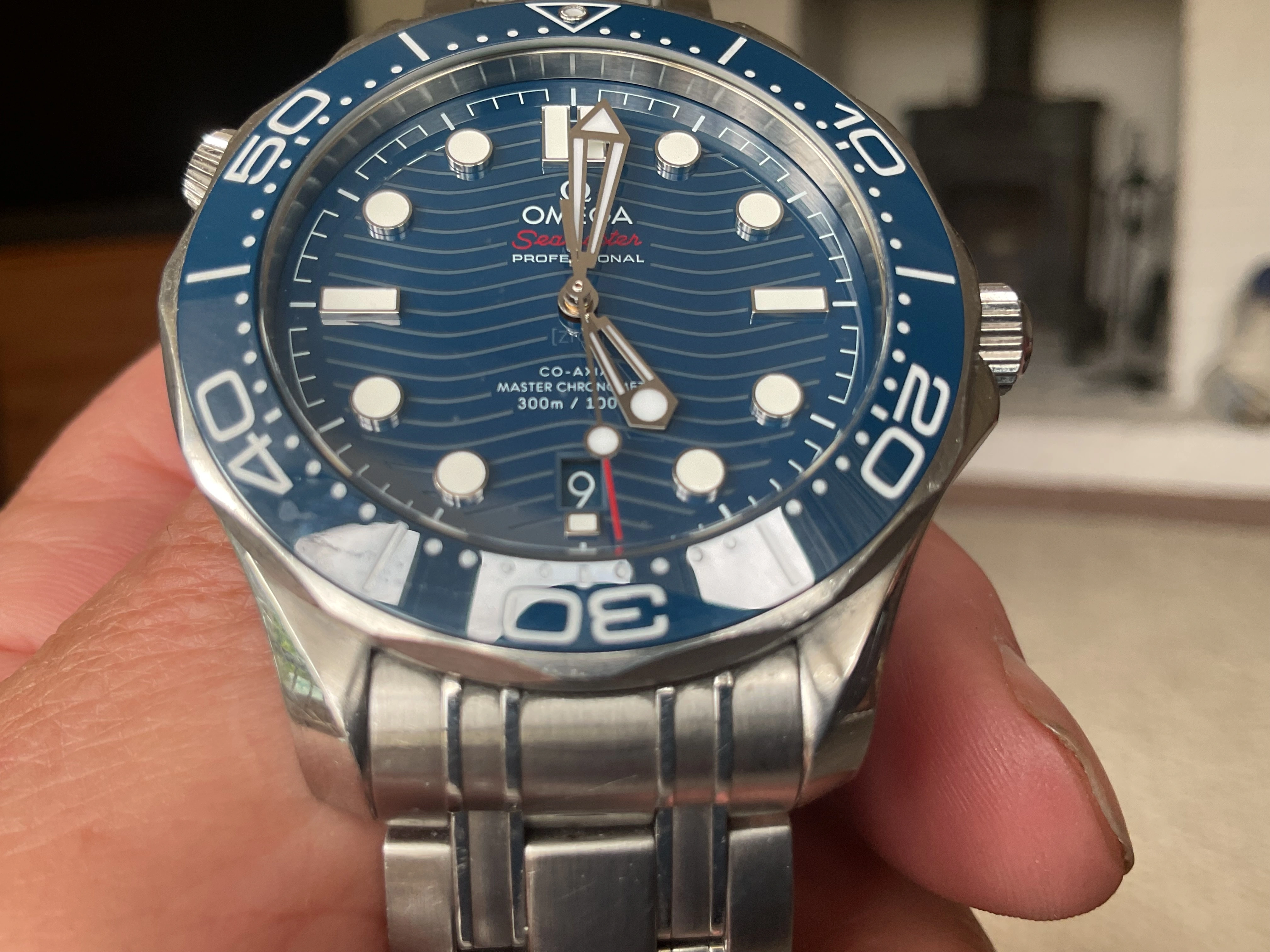

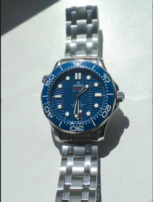

Im looking to buy this clock but wanted to make sure because there were no pictures of the id card and box

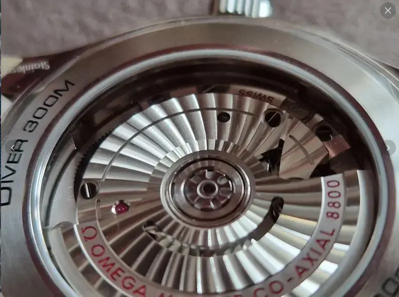

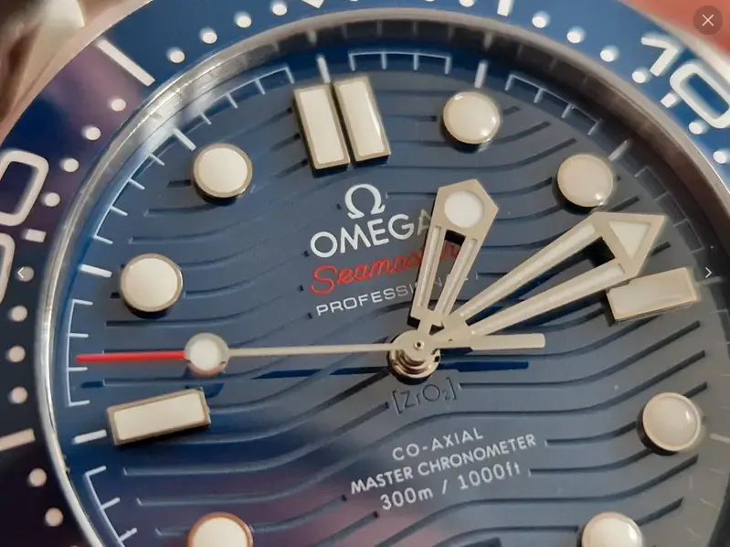

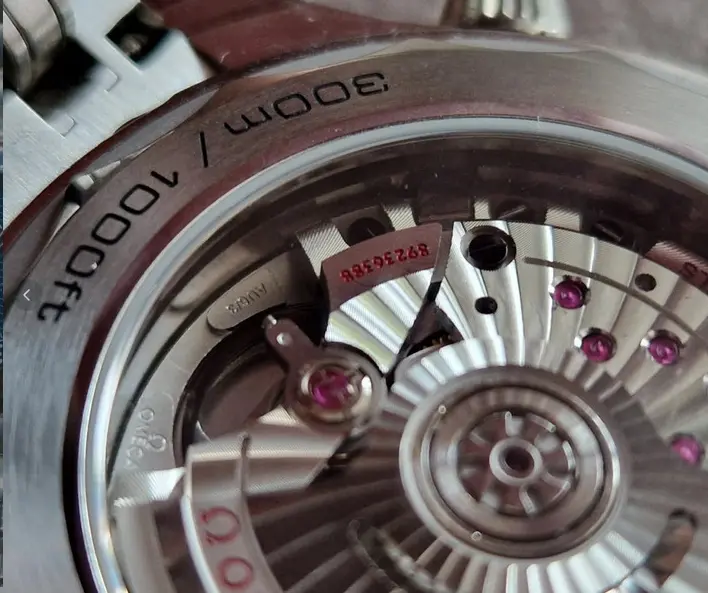

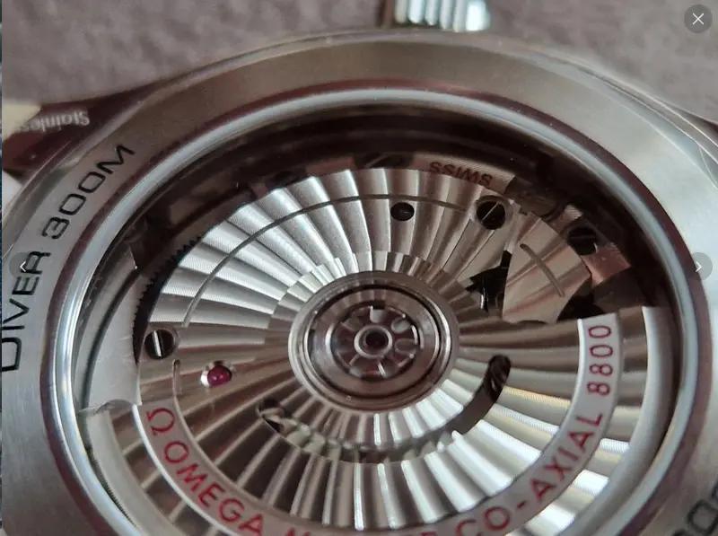

For me it was the extra engraving on the plate, plus the top of the balance bridge is wrong, confirmed by googling the serial.

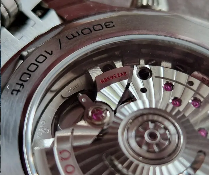

Take 30 seconds to Google the serial number from your last pic: 89236388
Serial number is for an Aqua Terra...
Serial number: 89236388

2,876
Article ref: 22010412106001
You don't even need to go that far 😉 All the google results for that serial number are either "is my watch a fake?" or "Check out my fake watch!" (on rep/fake sites) posts. Actually, image search actually shows a DHgate listing.

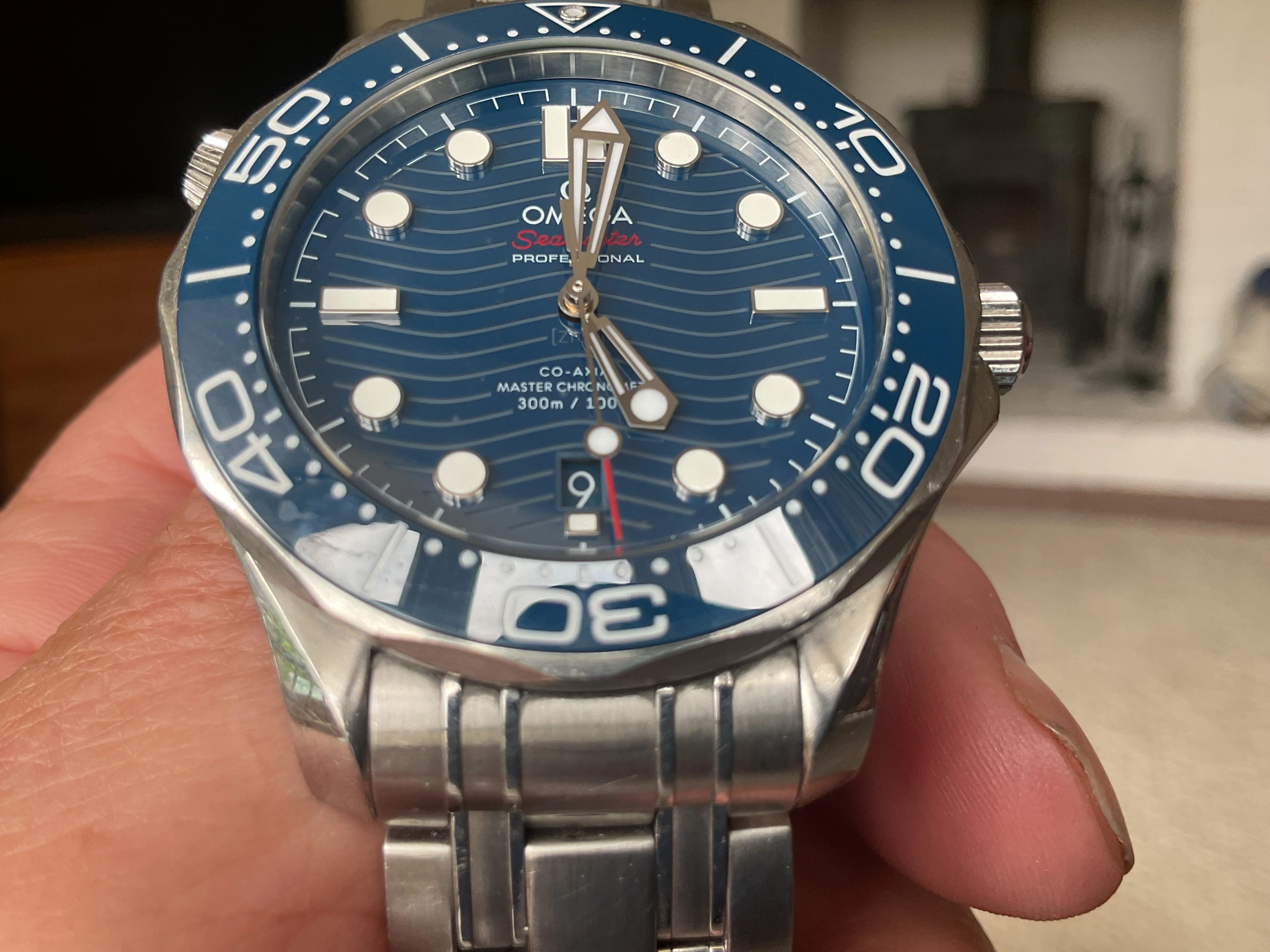

I don't need to go that far - I can just look at the photos and see that it's fake.
I'm putting the serial/model number out there so that there's more evidence for anyone who might search in the future.

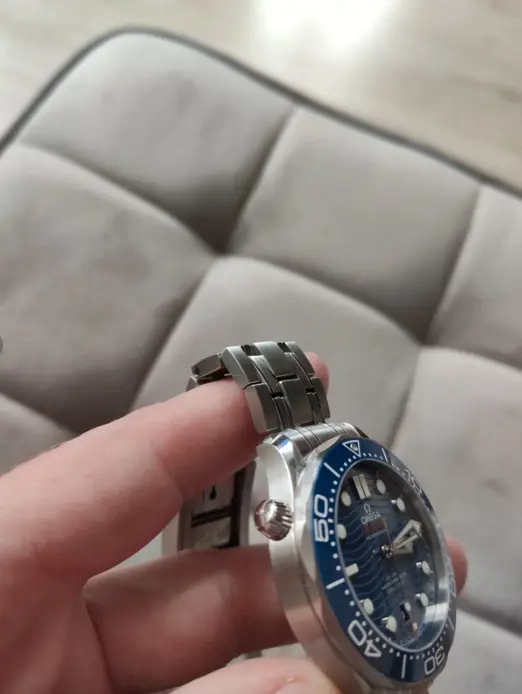

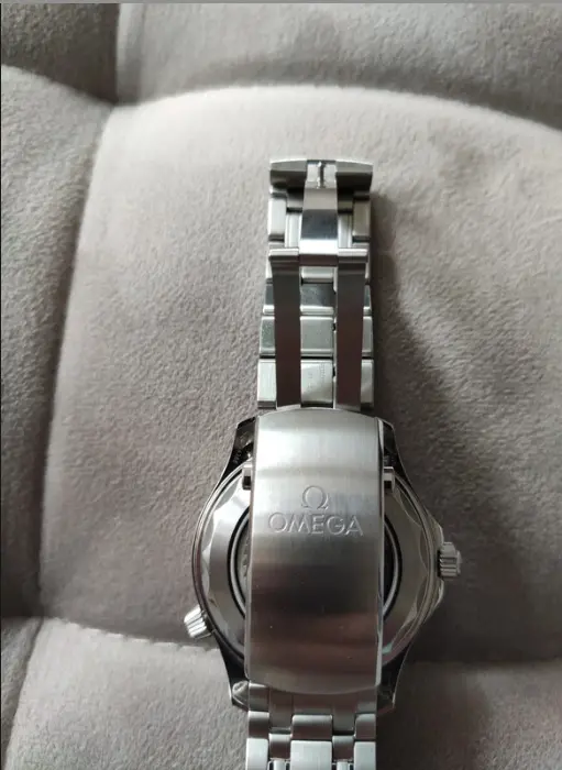

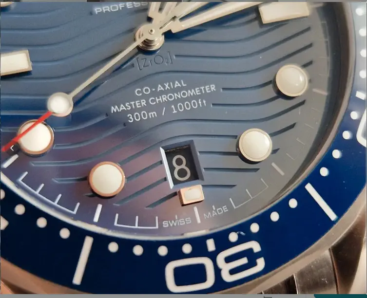

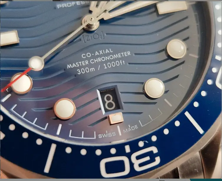

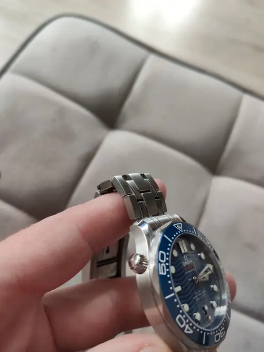

The end links at the lugs are not polished and the ZR02 should have light blue embossing on the letters.

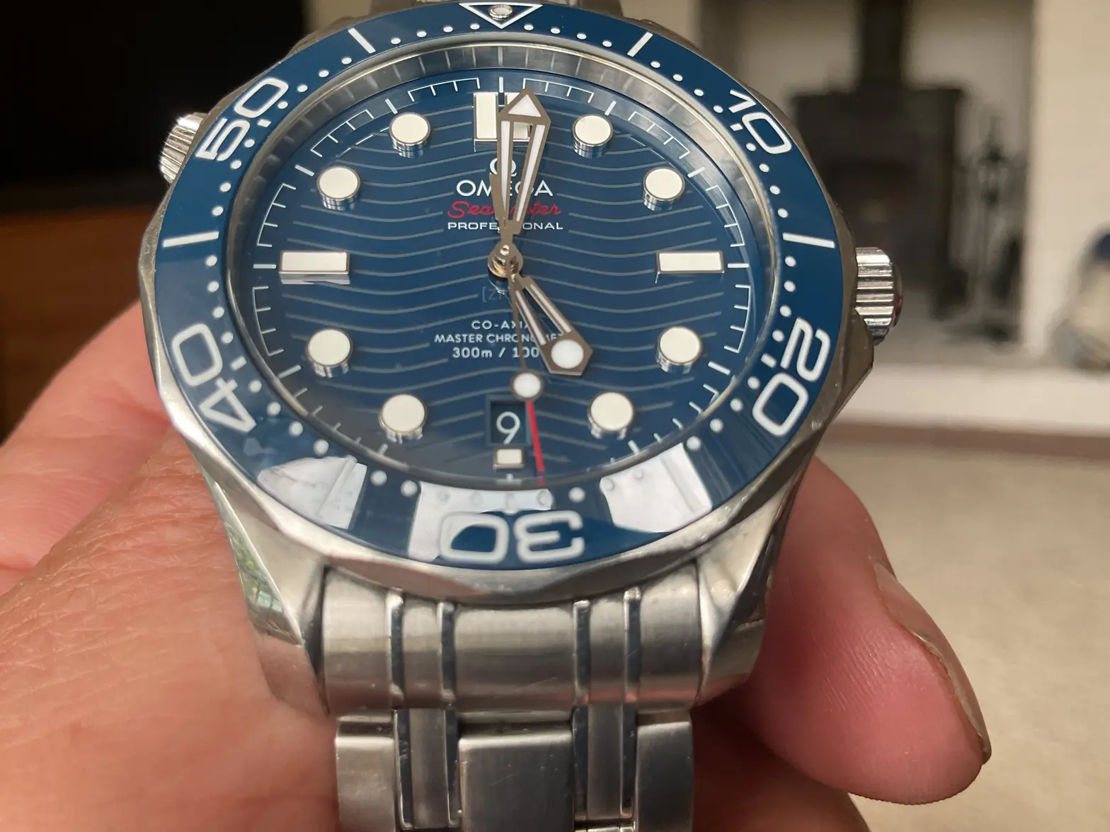

Movement doesn't look right and the bracelet has an unrefined look compared to the real thing.
