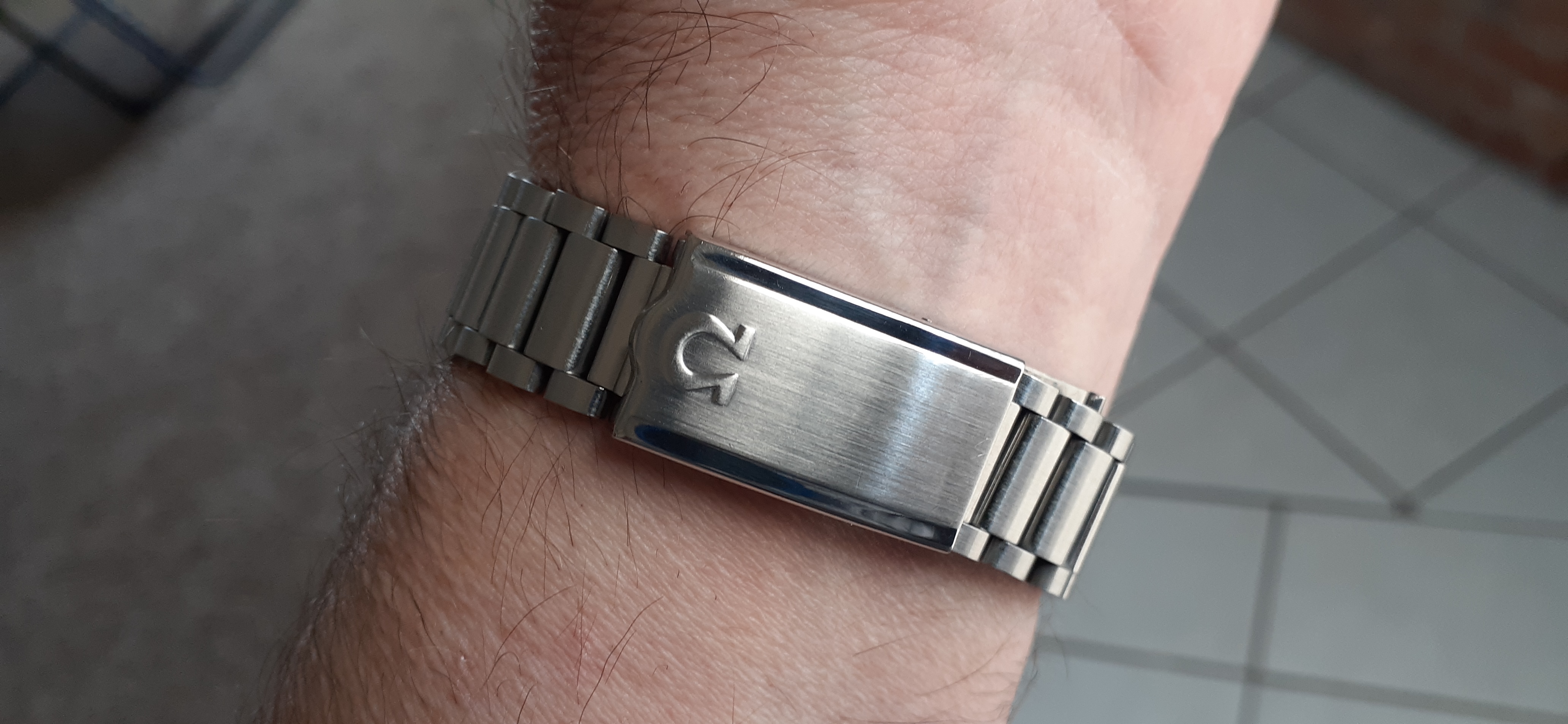

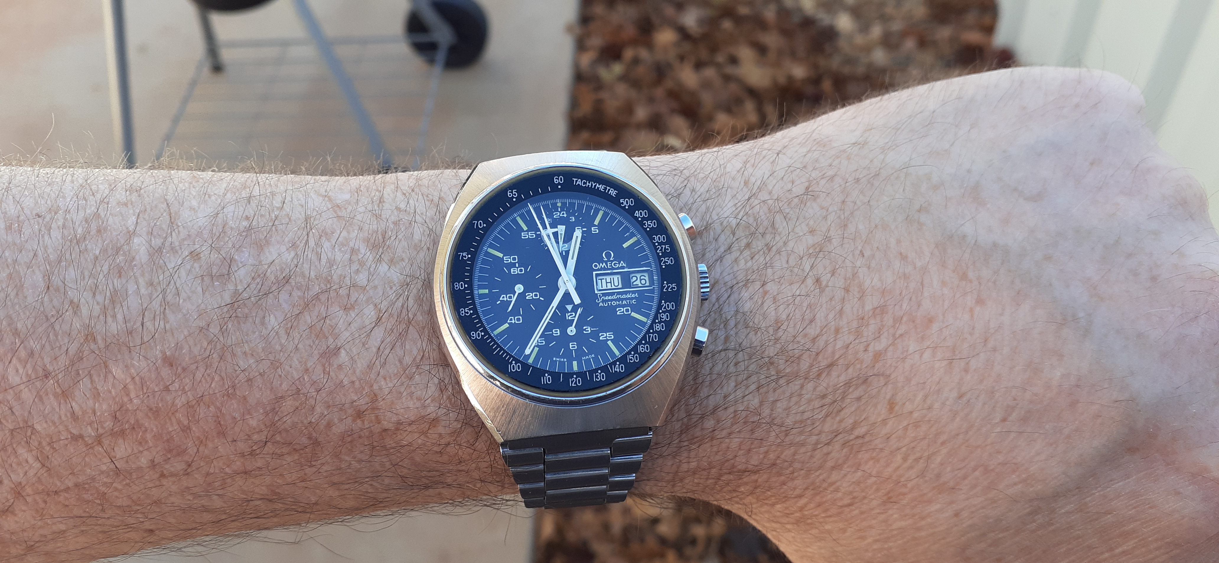

After searching for years for a nice example I could afford, I finally found a Speedmaster 176.0012 that seemed like a great deal. I planned to get whatever I ended up with serviced and I don't think I have a problem with having Omega doing it since I imagine they have the best stockpile of parts and I also would like to have the case brushing and polishing done by someone who knows what they are doing.
Has anyone here had an older Omega serviced by Omega lately? If you ask them to save the dial and hands will they try to do so? When I emailed Omega I was told to send it in before they could advise me about anything so I thought I would ask here. Yeah, I know nobody can speak for the company but I thought someone might have a recent experience they could share.
I also thought about The Watch Guy (UK) but am worried about complying with their request to value all watches sent to them at £20 (I am in the US). I would also hate to have it sit in his shop for months while we both look for replacement parts if needed. They also don't brush and polish cases apparently.
Thanks for looking at a new guy's post and I appreciate any advice you might have.

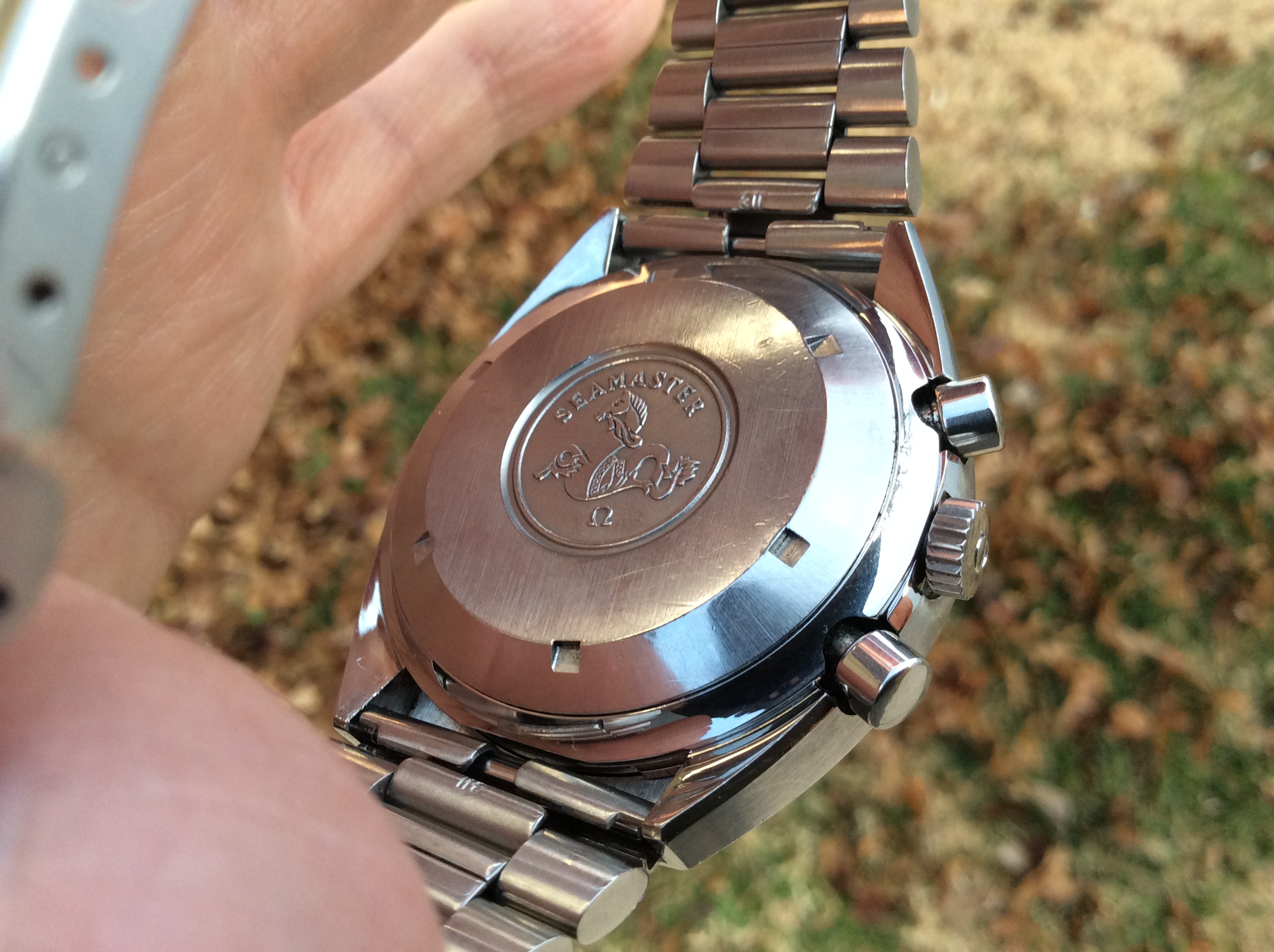

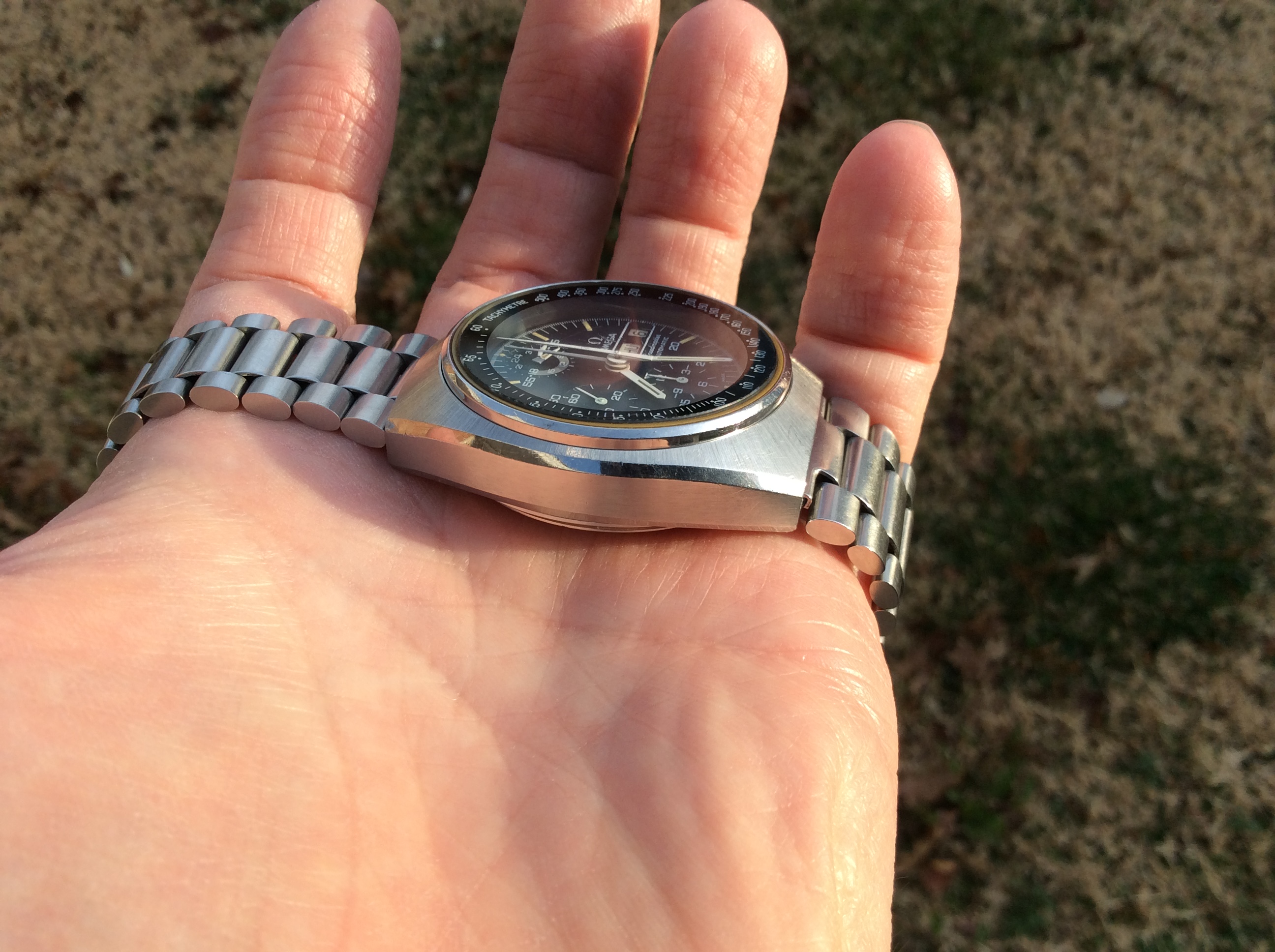

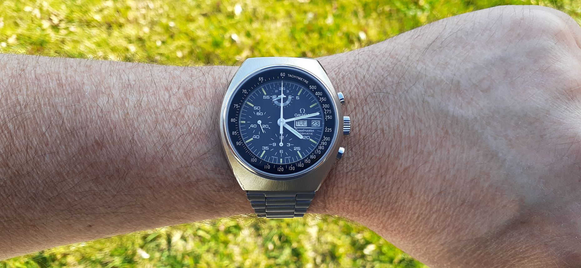

Here are a few photos.

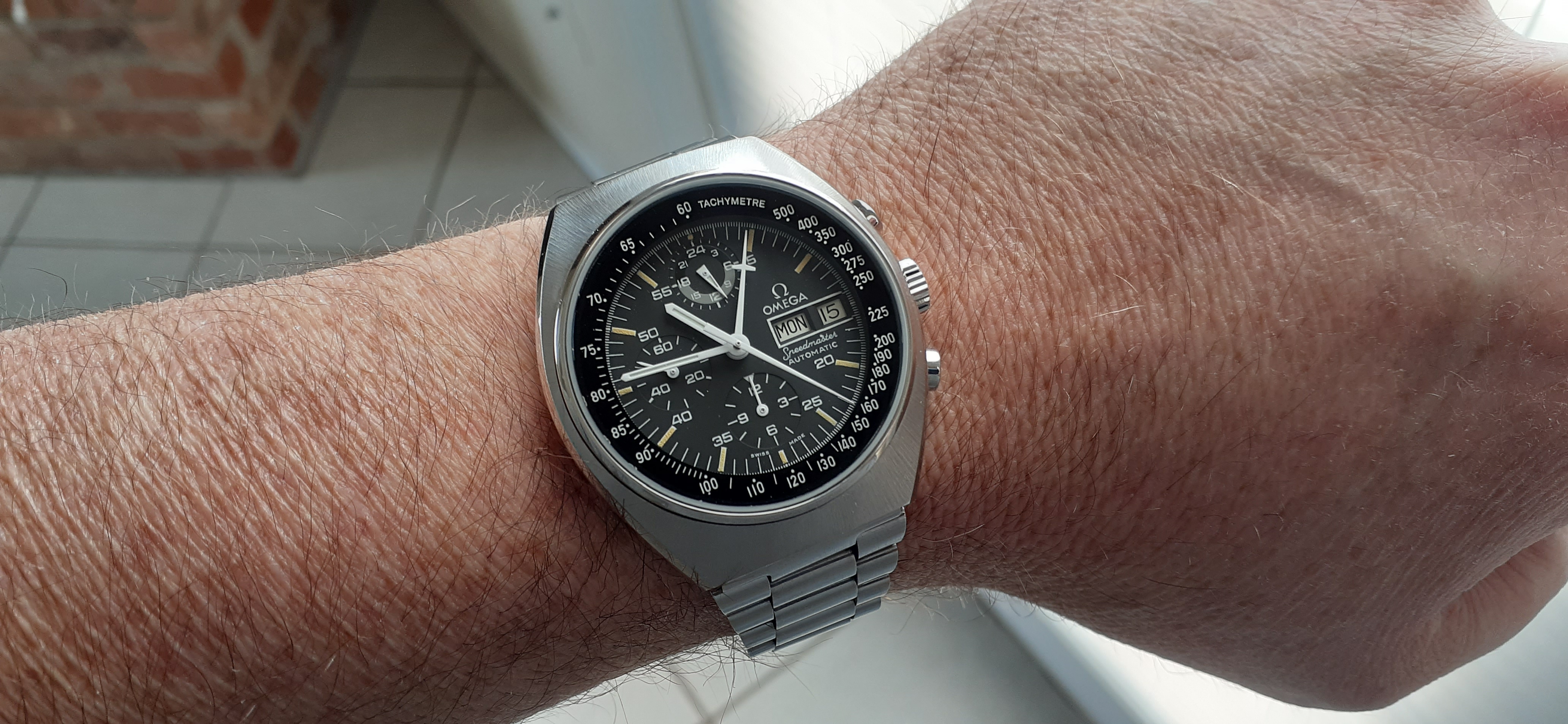

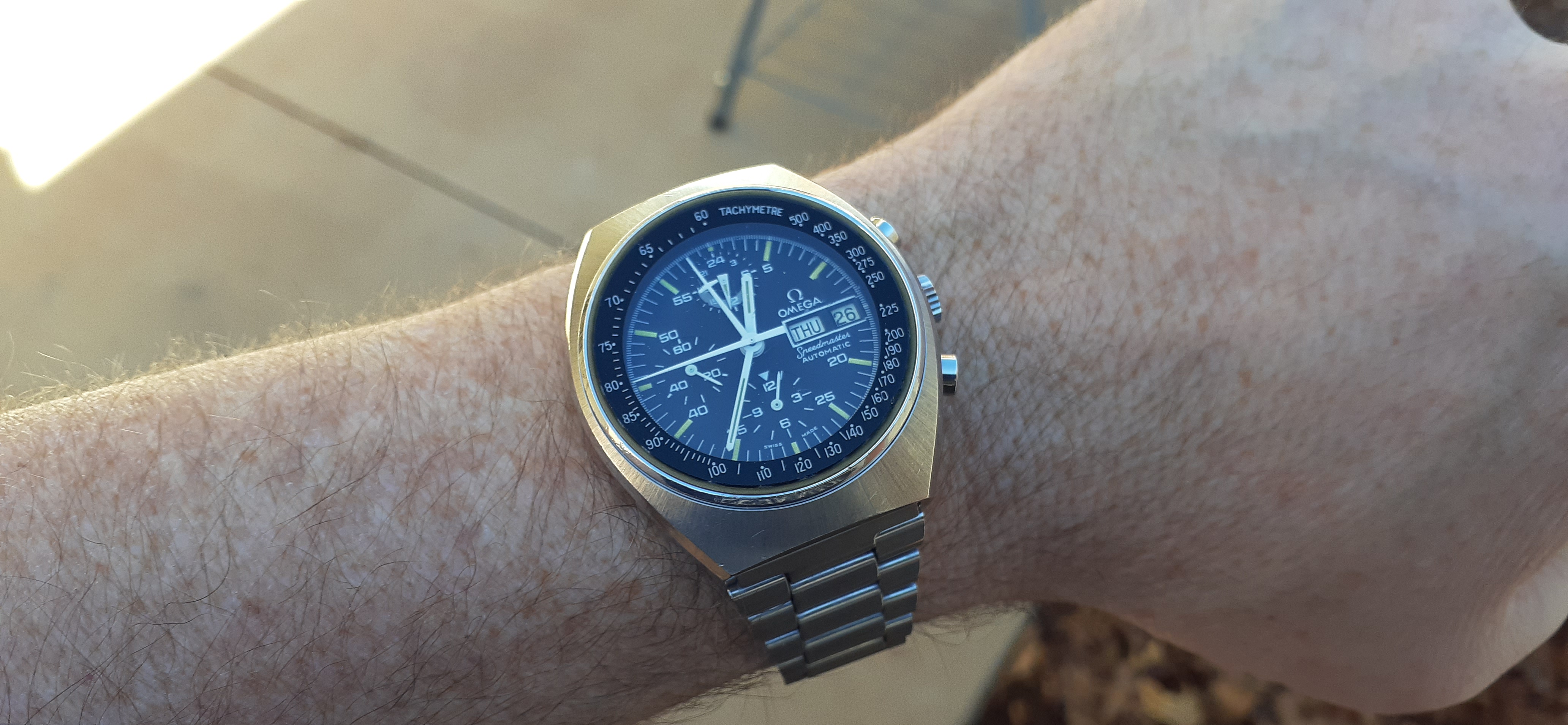

I received my Speedmaster back from Nesbit's today. They wouldn't save the hands but overall I think they did a great job. I will probably wear it all week to see how much time it gains or loses.

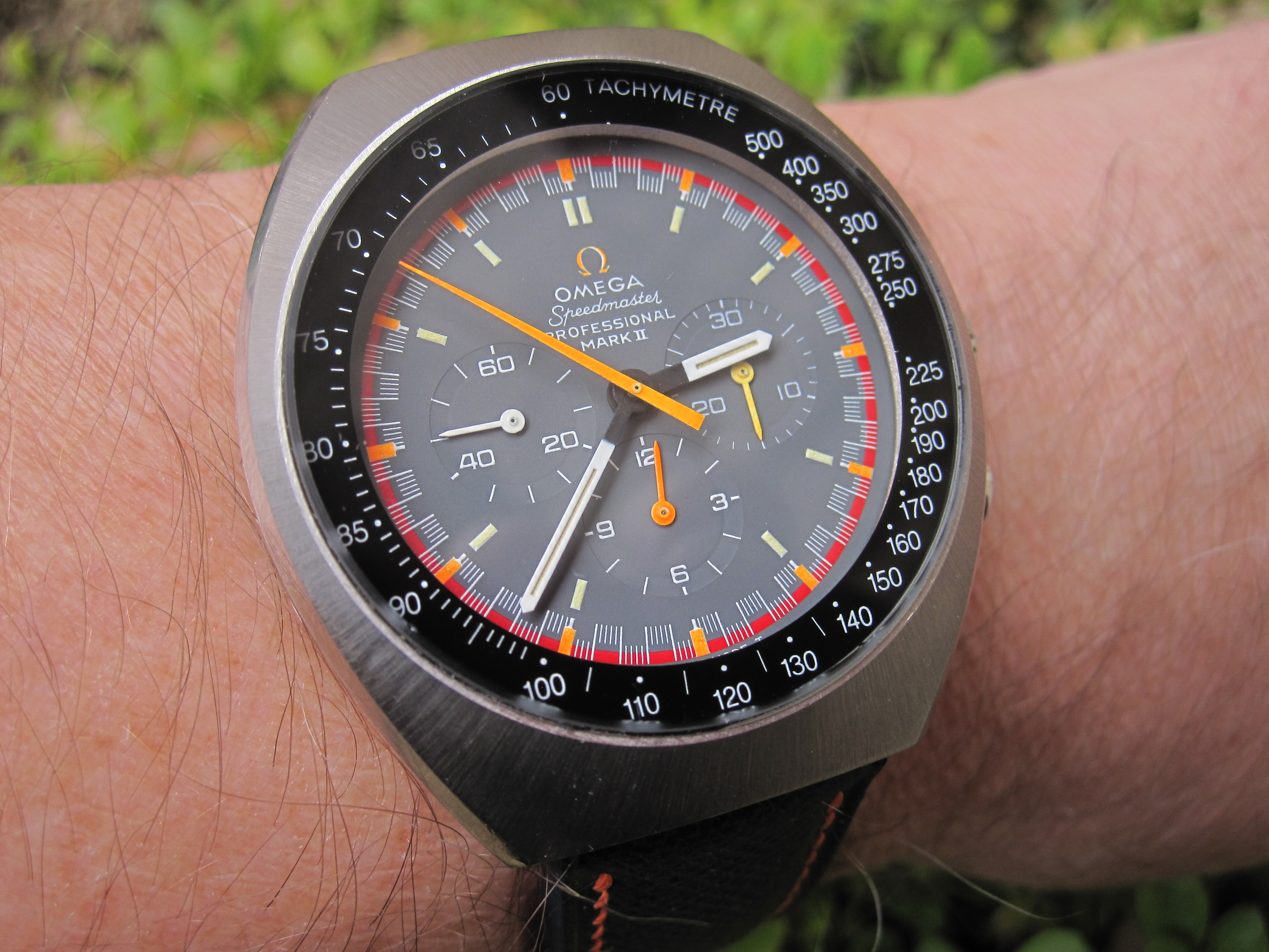

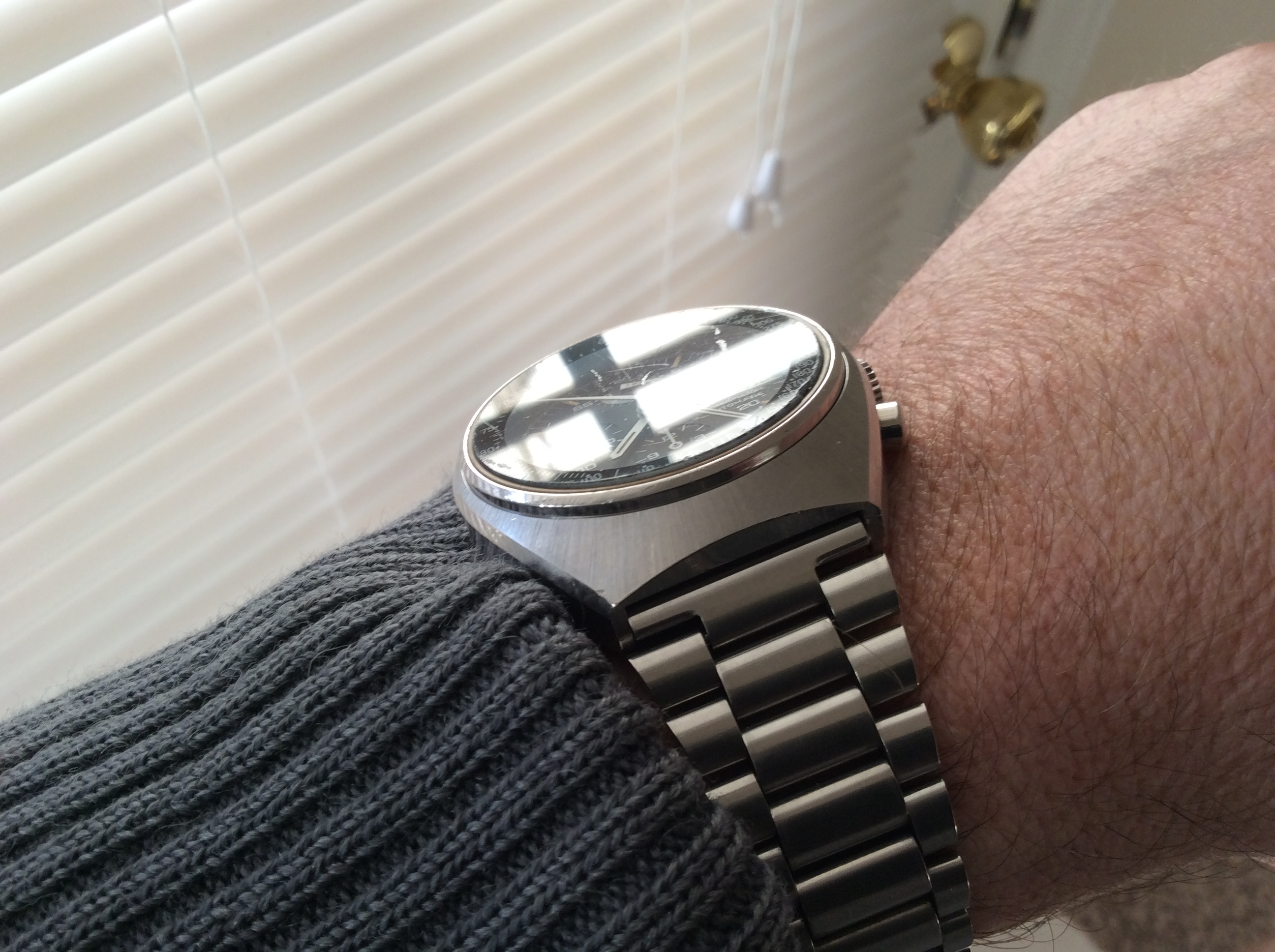

Looks good, too bad they couldn't save the hands. I just got my MKII Speedmaster back from Nesbit's this week, my wife-to-be gave me the watch in 1972 and it was long overdue for an overhaul. They cautioned me that the hands were deteriorated and they might not be able to save them, and the crystal sometimes cracks when they remove it and may need to be replaced, but I told them to try to save those items if they could. Fortunately they were able to reuse the aged and somewhat faded hands (none of the orange hands ever quite matched, even when new), and the almost perfect crystal that was a replacement for the original way back in 1981 was salvaged. Case refinishing was well done, too. Happy with their work, and it comes with a 3 year warranty. Looks good for an almost 50 yo watch that has seen the battles. Put it on a Genteel navy goat strap with orange stitching, with an Omega DP buckle. Now looks sharp.

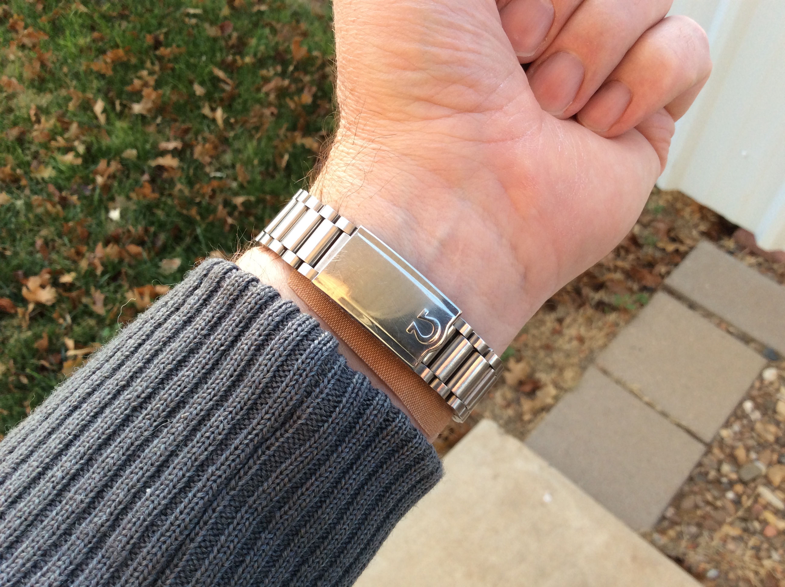

Your watch looks great. The 12 hour register on mine decided to reset to about 11 o'clock so after wearing it for two weeks I had to send it back to Nesbit's a couple of days ago. The minute chrono hand is also advancing to the next minute at about 44 seconds instead of 60 and it's running +13 seconds per day. I don't know if they will regulate it any better but I hope so.

Yeah, I am hoping for better the second time around. Cosmetically I am very happy but it is supposed to be more than a nice bracelet.

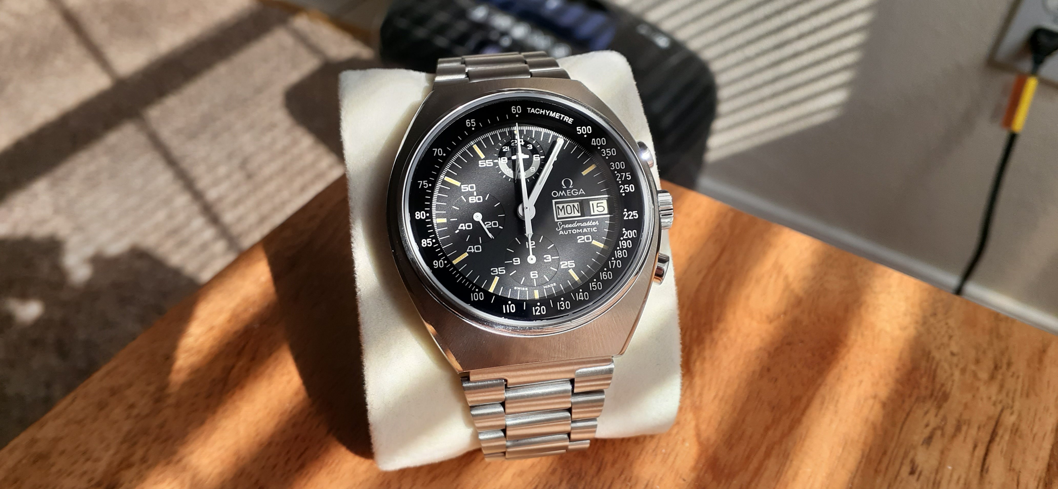

I received my Speedmaster Automatic back from the second service with Nesbit's. The six O'clock sub-register now resets just a fraction to the right of dead center on the dial. I guess I will live with it for a while and see if it gets better or worse since I don't want to send it right back. I will wear it for a few weeks to see how much time it is gaining or losing. Nesbit's was very courteous again and paid for shipping under warranty.
