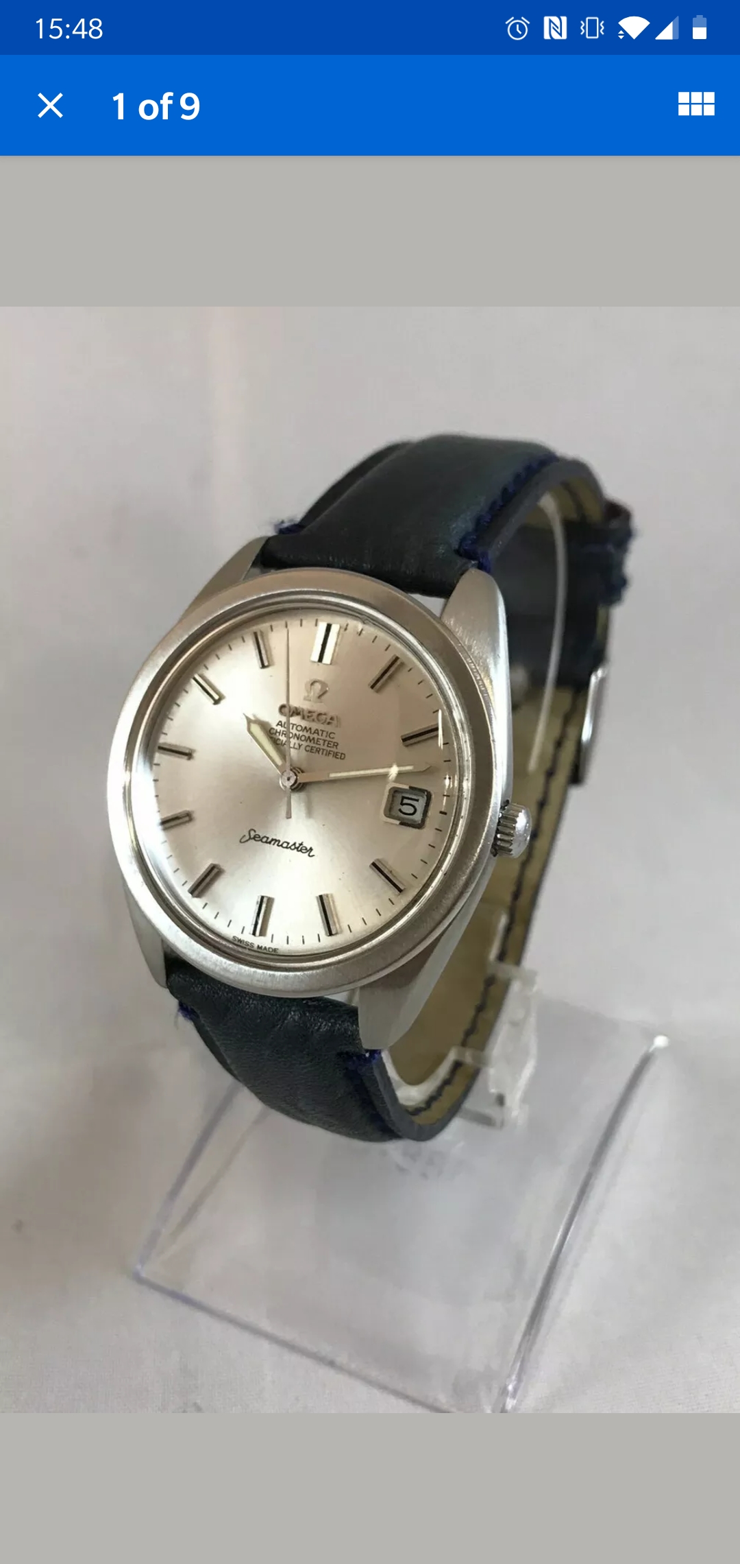

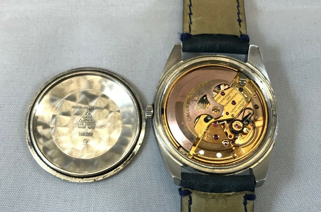

I stumbled across this Seamaster on eBay (which is fantastic for furthering my learning) and whilst I can tell the case back is highly polished and it looks like a redial, I focused on the movement and I think it might be a franken but totally appreciate I may be wrong but for the following reasons:
1. The two tone movement, am I right to think movements should be bronze colored and not a mix of bronze/gold?
2. The Omega Swiss Watch Co (and circle below) looks off to me, not a clean and crisp stamp?
3. The Cal is barely legible, it is advertised as a Cal 534 but almost impossible to read?

I鈥檓 pretty sure a 168.022 should have a 565 cal.movement. Don鈥檛 think Omega ever made a 536

Shouldn't the a Watch with a 16(8) have a chronometer rated movement? Then a 564 would be the right movement, the 565 isn't a Chronometer rated Movement. This movement looks very tired.

I sit corrected. Was trying to go from memory, probably not a good idea anymore:whipped:

Rotor possibly replaced. Just sayin'.

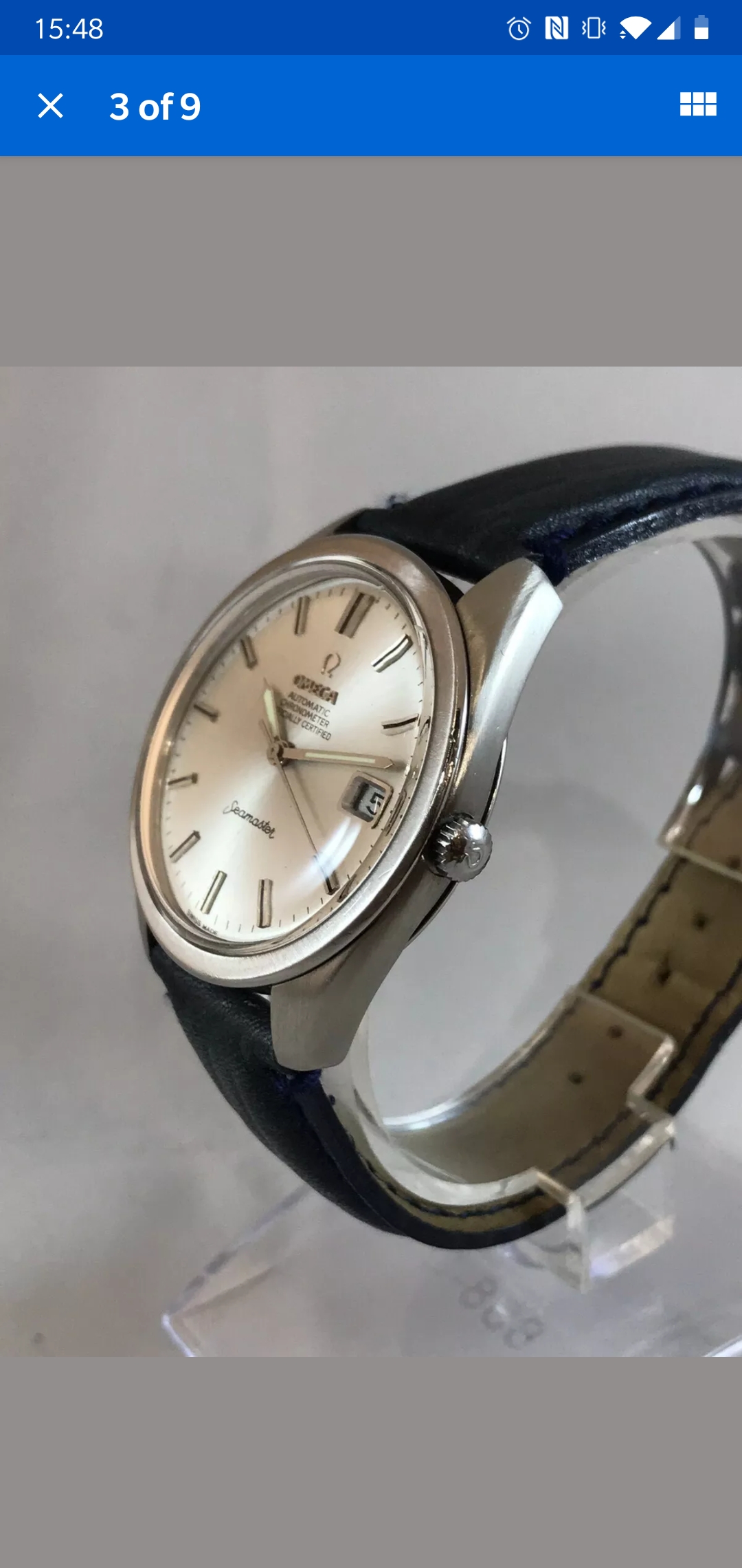

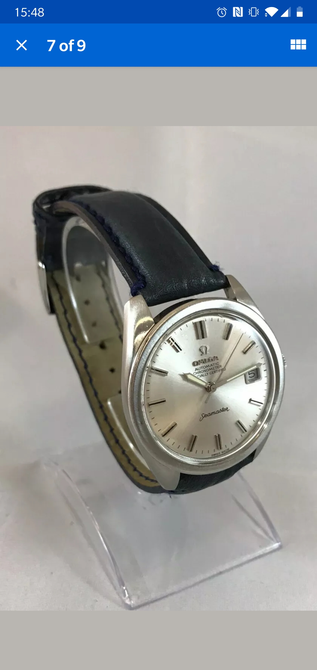

Here are some more pics of the Seamaster if it helps...
Looks like the case was badly refinished.
I did think the same myself and the case back looks very over polished.

Looks more overbrushed... 馃榿
Based on the pics I can't tell for sure it's redial. Maybe it is. At least hour and minute hand are wrong.
Edit: Redial, yes.
Edit: Redial, yes.

+Hands don't fit, no lume on the dial, lume on the hands. The hour hand is wrong from the design.
Hard pass.
