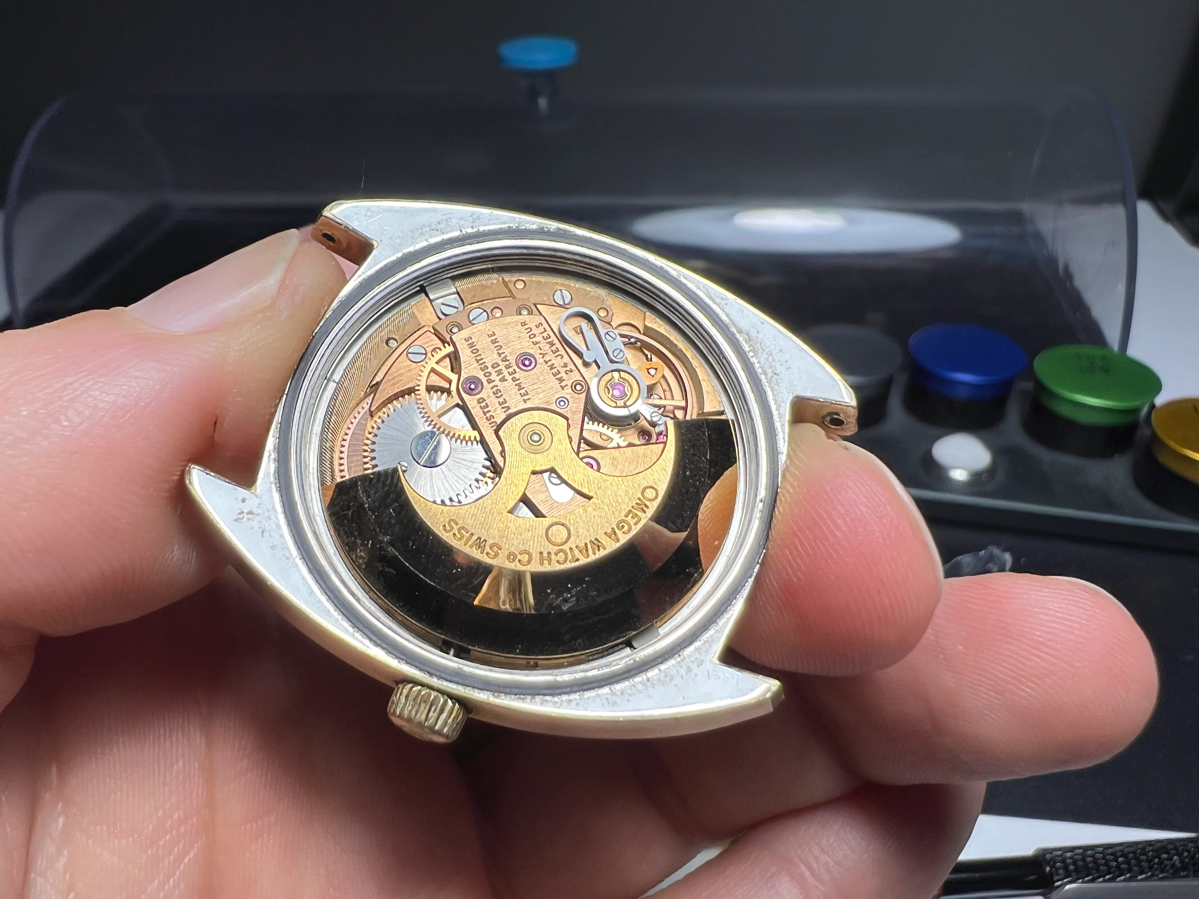

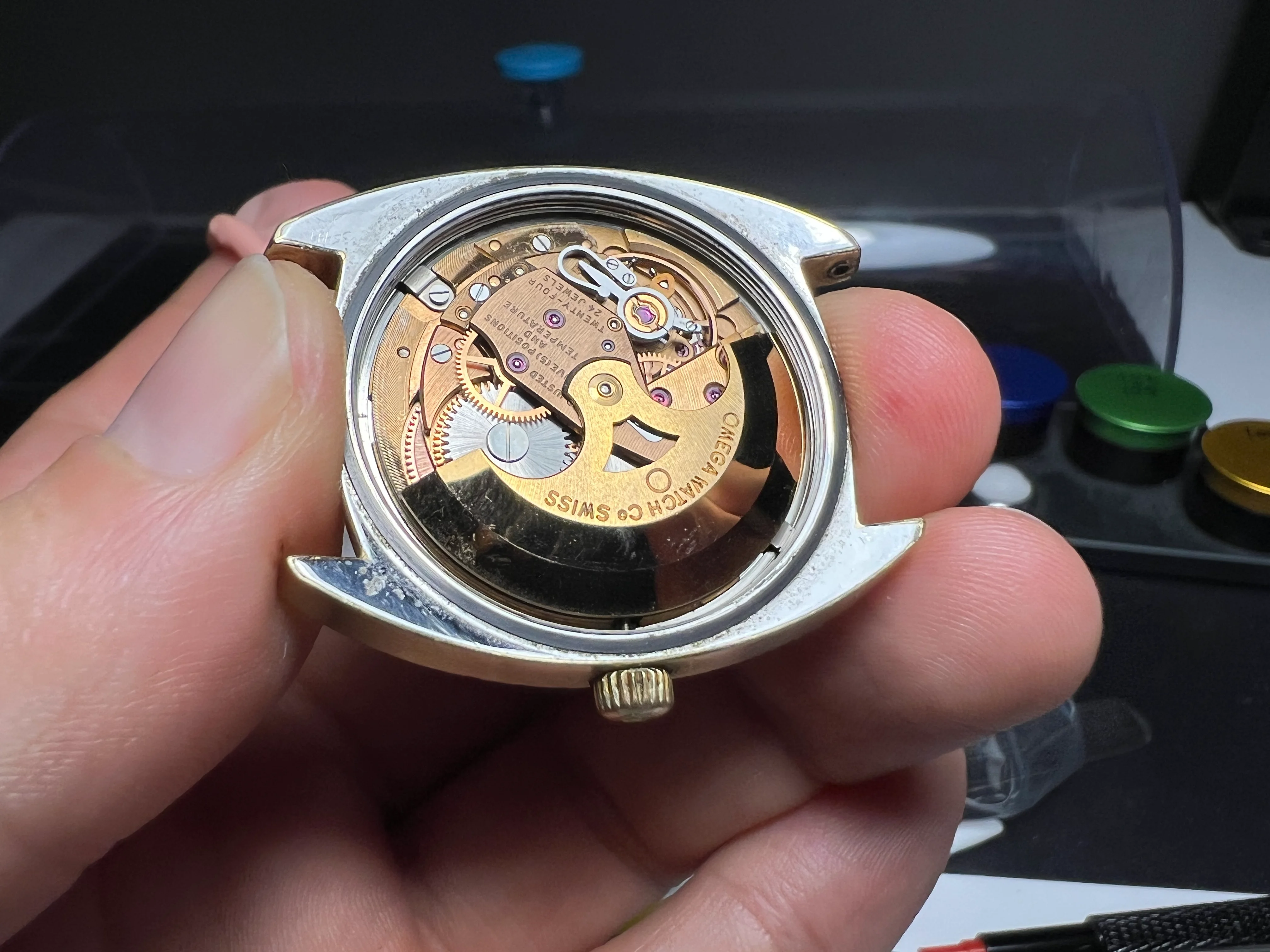

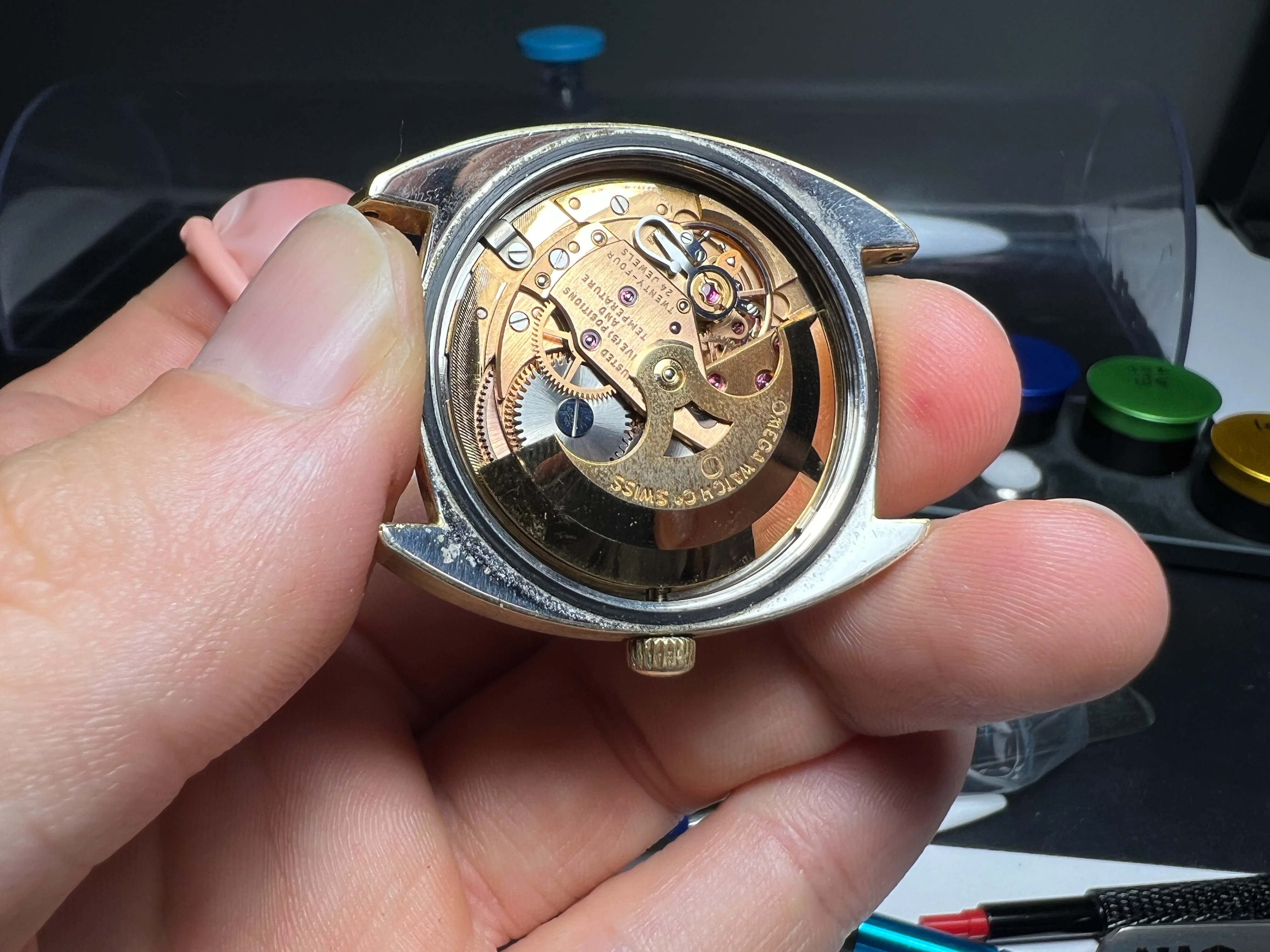

Hi everyone,
I do wonder if its expected for the weight to match the hue of the movement 1:1 - on this watch its 1-2 hues yellower - also came with a fingerprint, could belong to the culprit 😁
Do you guys care about the weight matching color? Since these gold coated parts patinate, maybe a longer/different chemical process could've altered the hue of the weight too, otherwise everything looks original
13,555
23,503
It’s got the older style pivot (or whatever it’s called) so I’d say if it was swapped, it’s period correct
6,833
10,502
There was a comment on a thread recently suggesting movement parts were often supplied in different hues.
However, I remember reading an essay (on Desmond’s site IIRC) noting that Omega took great care in matching the movement parts colour-wise.
Given that your rotor has the little circle and that it is a distinctly different colour it is likely a replacement.
Is it an issue?
Aesthetically perhaps but as @Davidt says, it’s the correct shape for the age of the movt.
So if you were to sell, a simple explanation of the colour difference should negate any negative feelings towards the colour variation.
