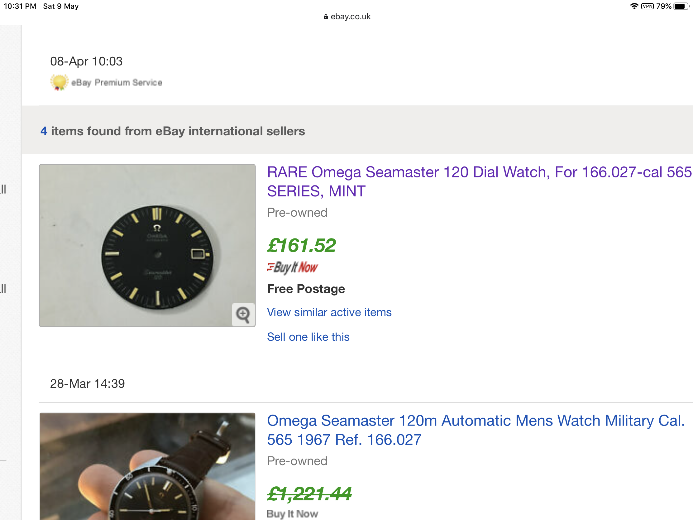

I would imagine there will be dials available for this and they appear on eBay every now and then (one sold at the end of March), another solution would be if @Archer can help

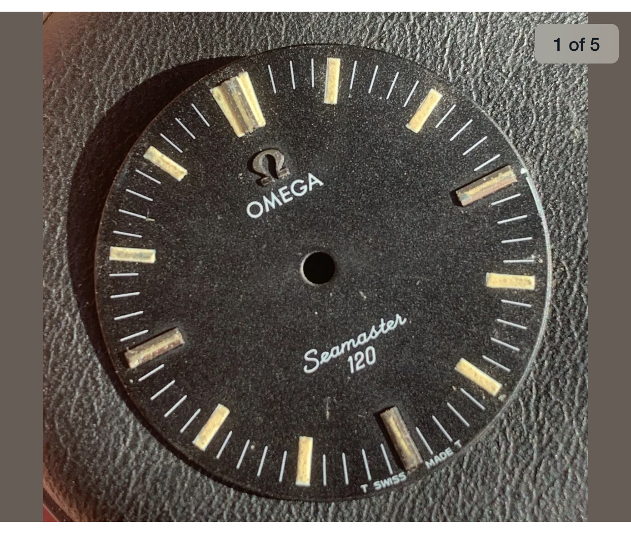

Are you referencing this one?
https://www.ebay.com/itm/114160764620
If so, I was watching it, but it’s for the no-date reference 165.027.
If you’re referring to a different auction, would you mind sharing a link? Because I totally missed it and
might need to adjust my saved searches on ebay.
499
749
That dial is for a 135.027.
If I were you I'd use dialpads for the moment and keep an eye out for a replacement dial on eBay etc.
Right... no automatic on the dial. Should have been obvious to me. I’d like to blame that on not having had my coffee, but I was thinking it was the automatic reference the entire time it was in my watchlist ::facepalm1::
I was referring to this one, no link but here is a screenshot

Just to confirm - no dials available for this from Omega.
Thank you for the image, but based on the grey text, I believe that is one of the fake dials outlined in some of OF’s threads regarding these references.
