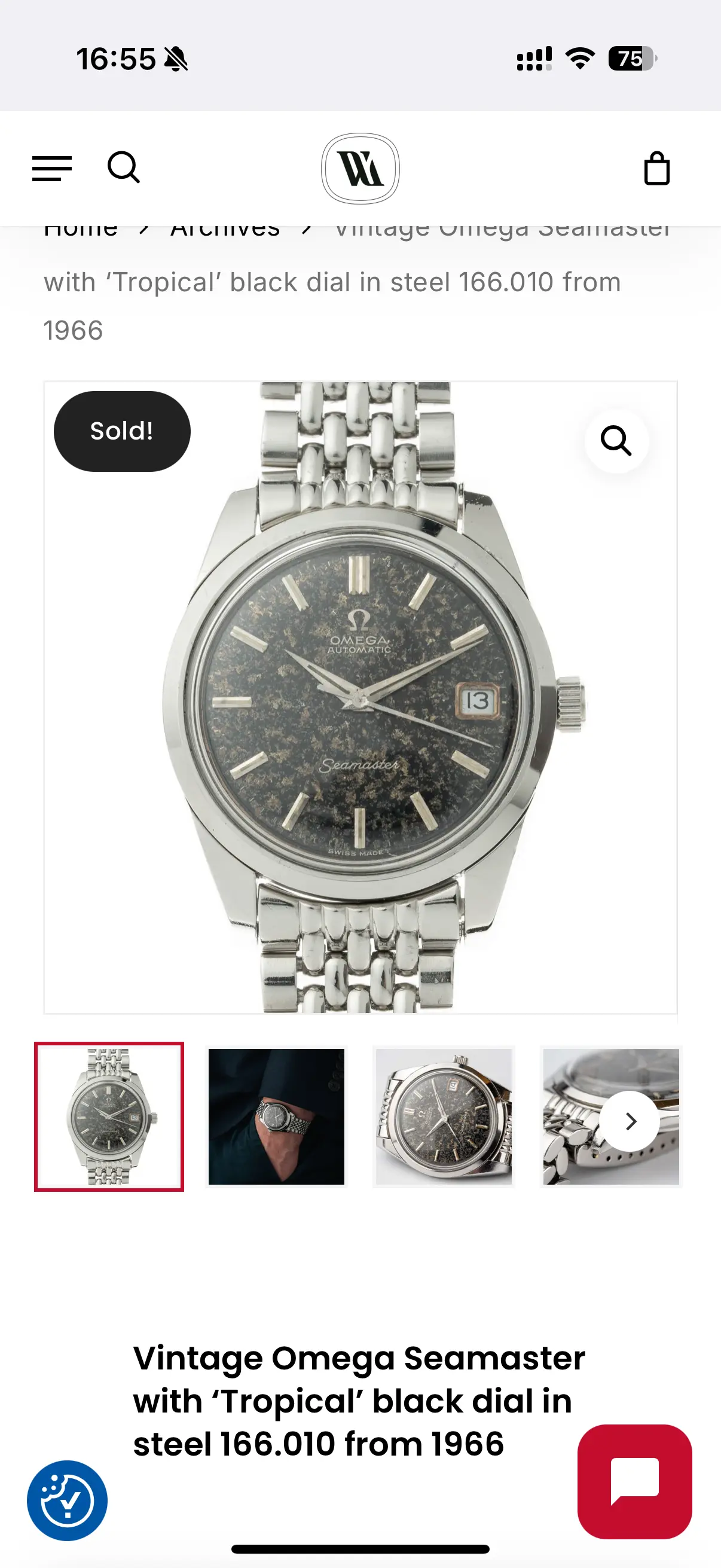

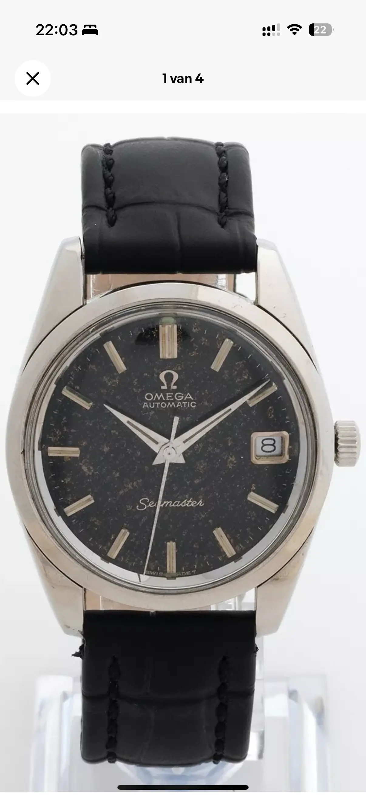

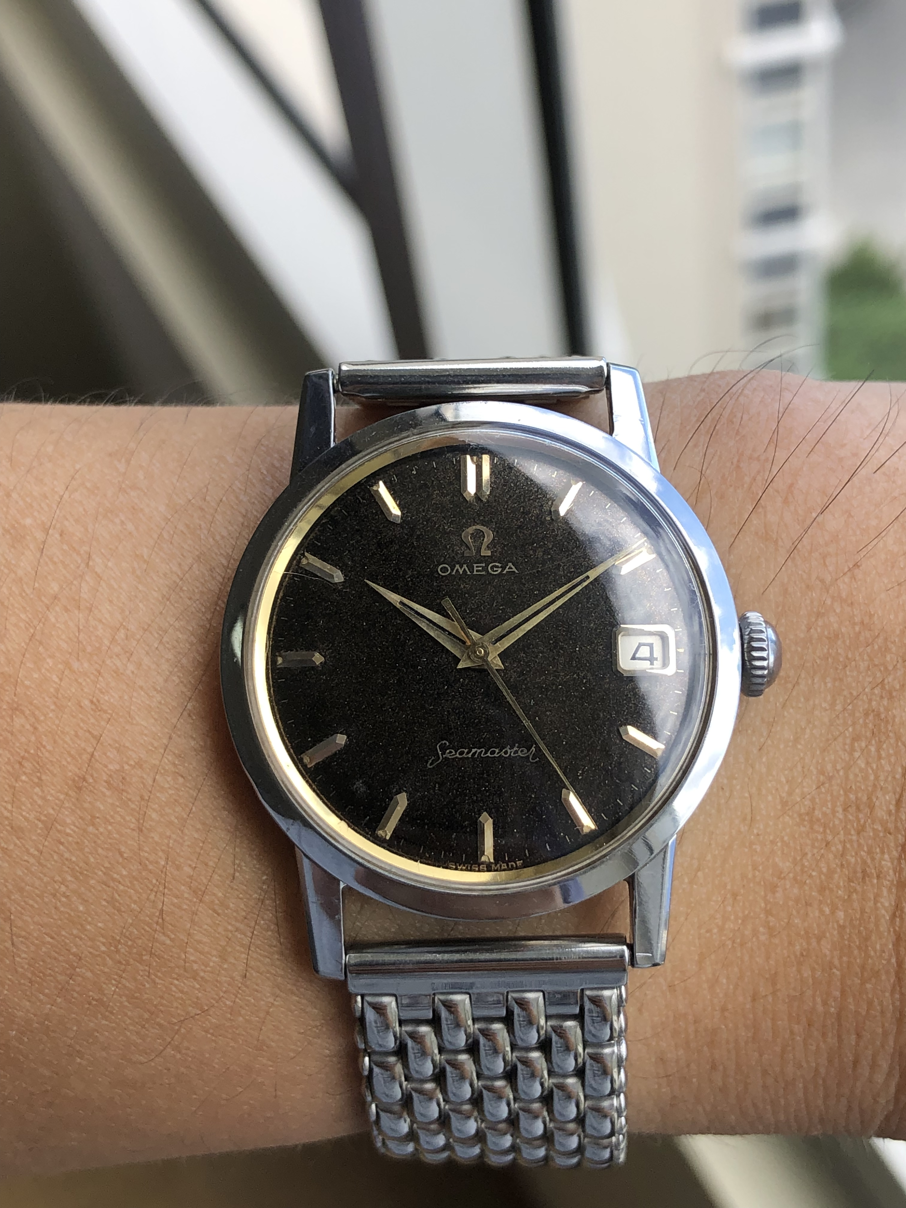

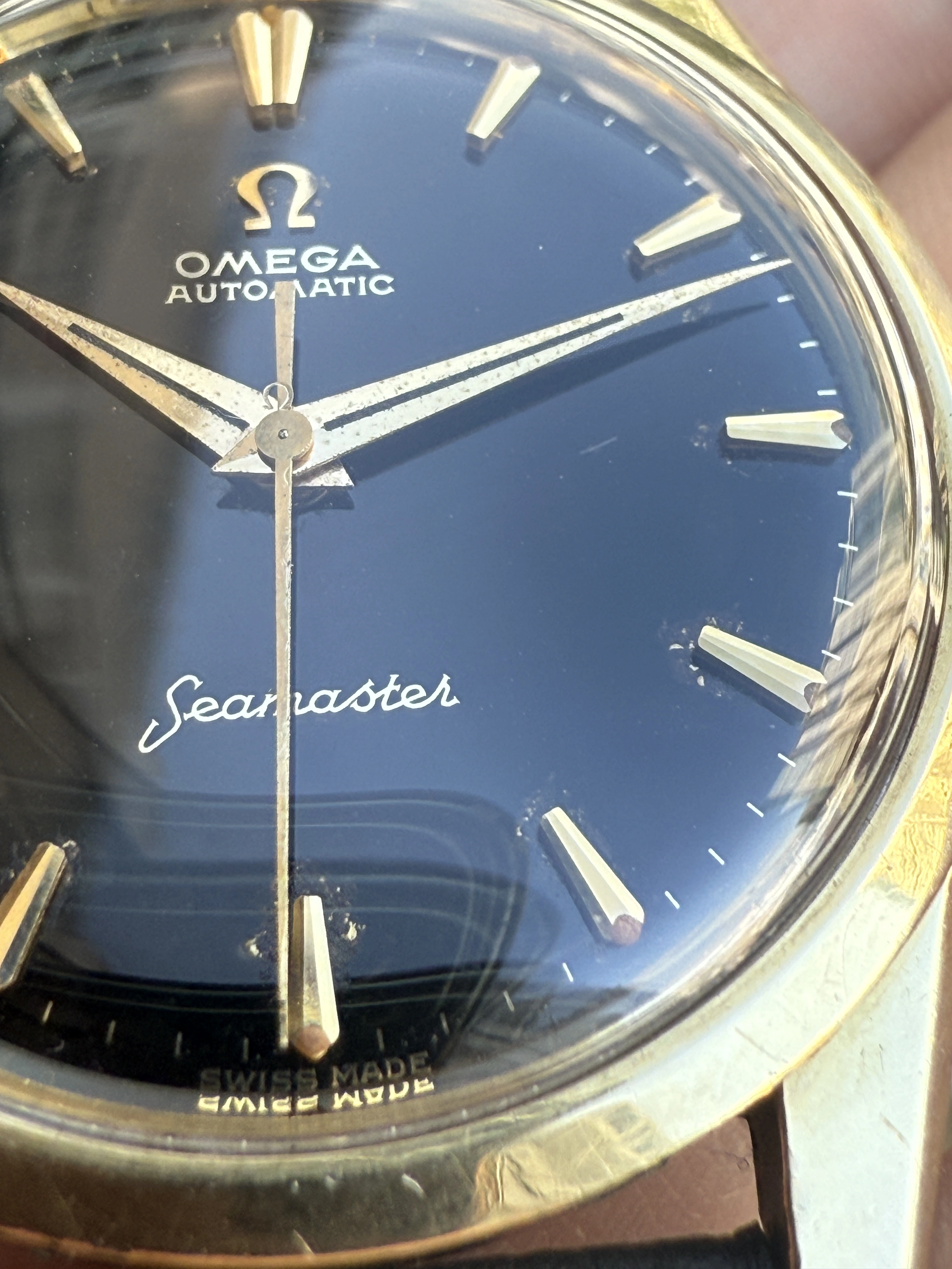

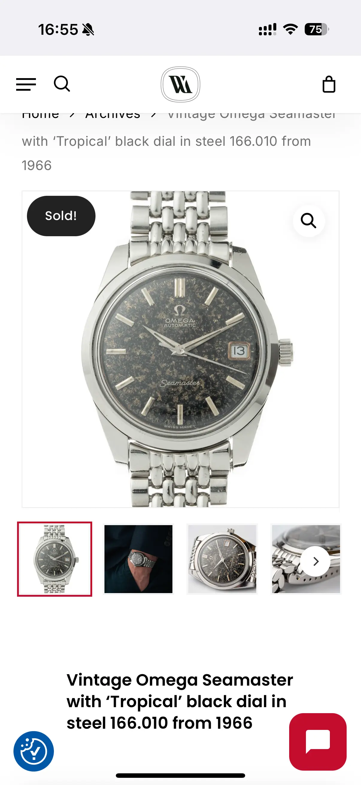

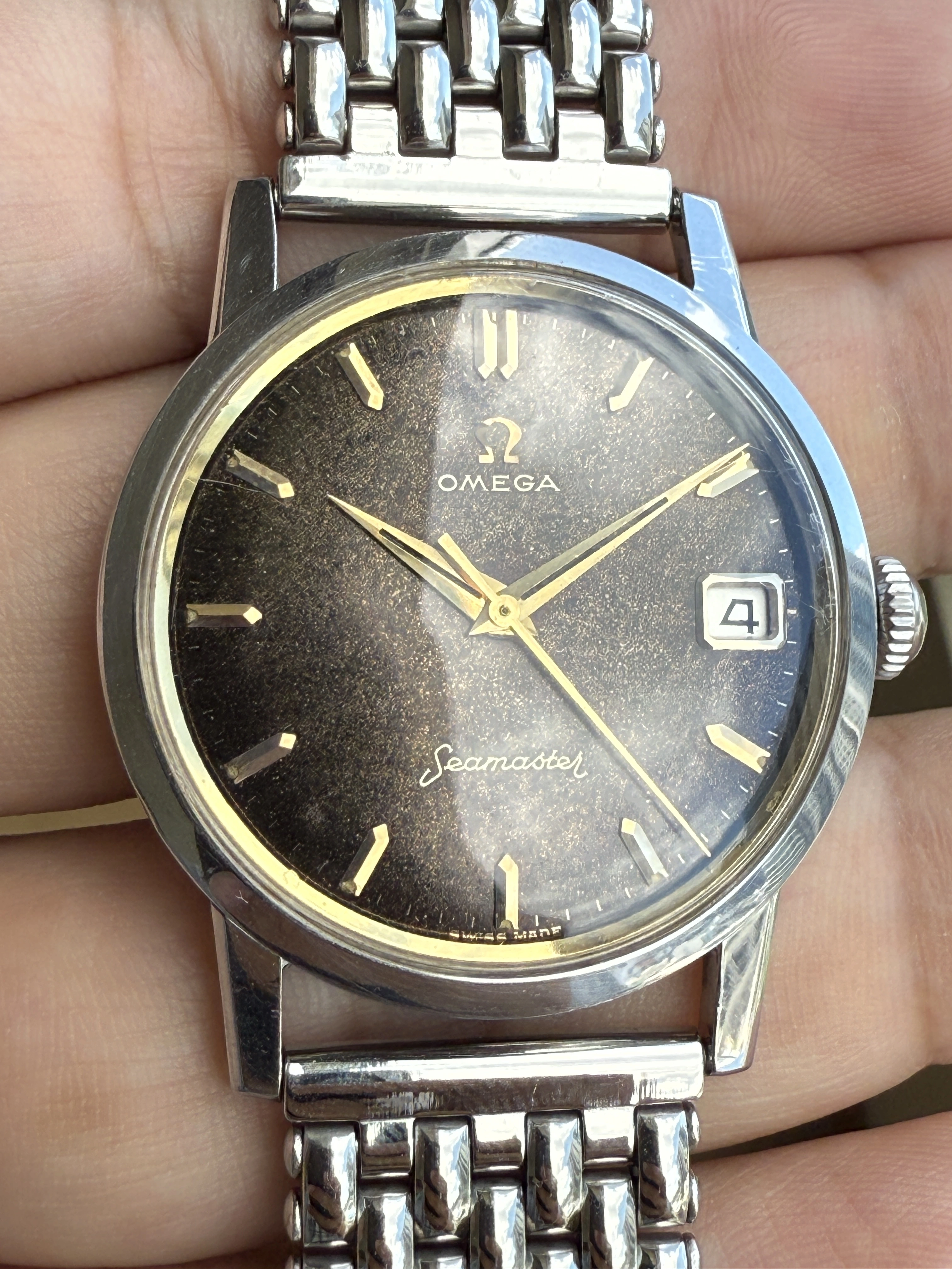

I love these 166.010 with the black tropical dials but am not sure on what to pay attention when I see one. What are the most important details in these watches? I’ve included a couple examples. I’m looking to buy my first Omega seamaster and would love to buy something special.
24,670
54,795
You are already looking at dials that are damaged, so I suppose the remaining condition issues are important, e.g. lack of polishing of the case, original finish, condition of lume, condition of the movement, etc. Also, you want to look for originality of the parts.
13,321
23,124

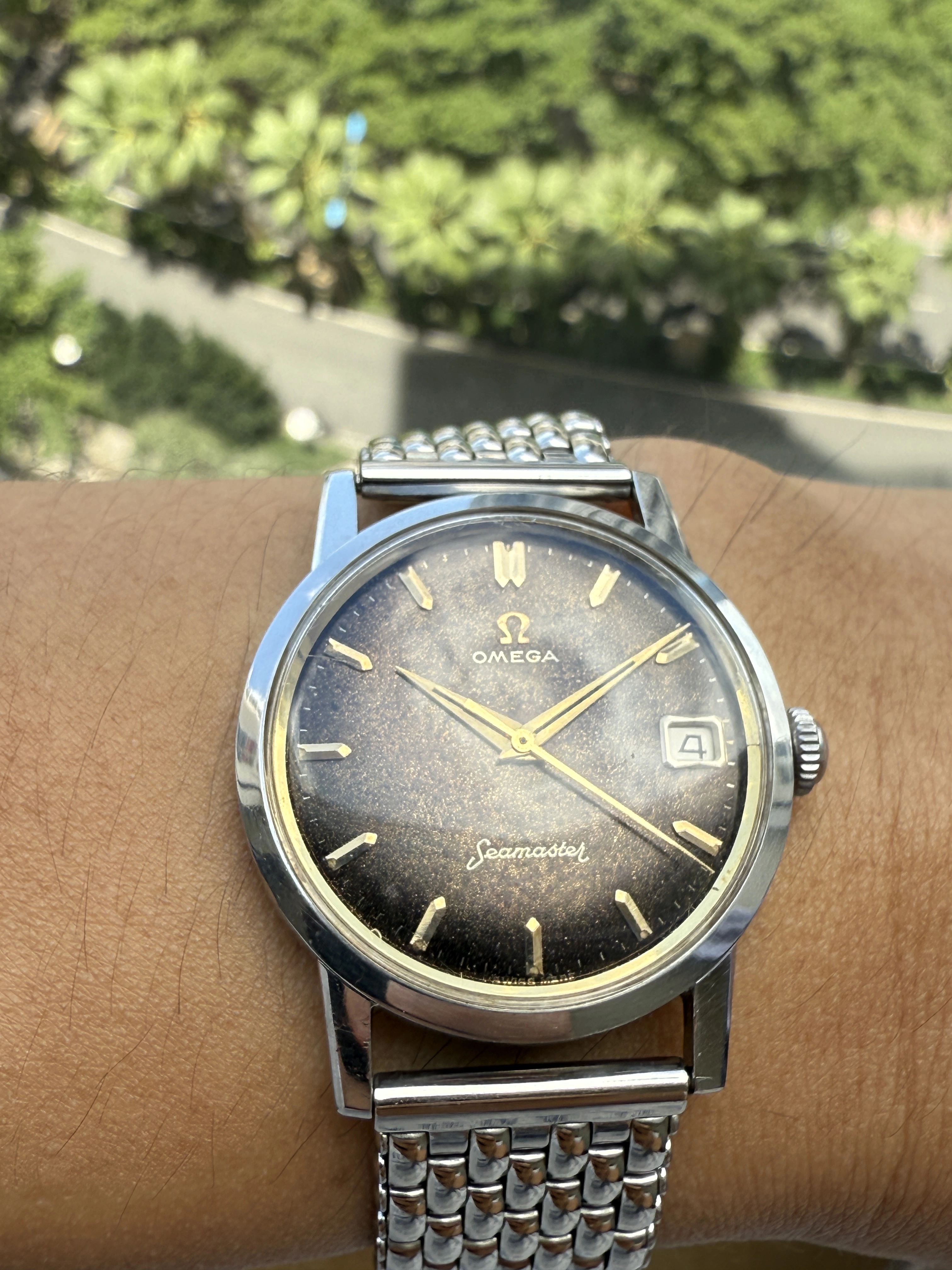

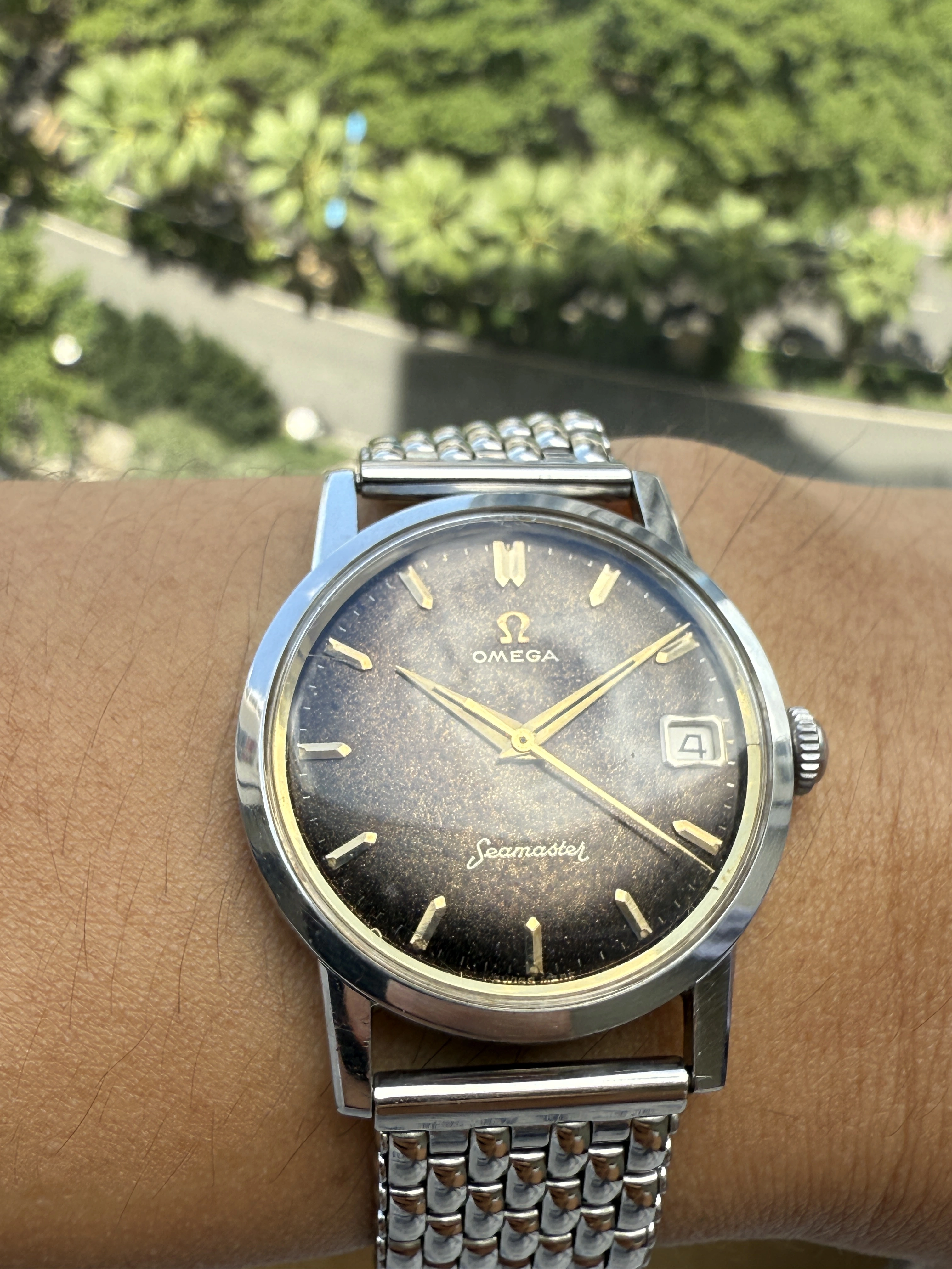

The second one you’ve shown is my old watch that I believe the dealer above bought from me. I really like these both with good and patina’d dials.
I agree with Dan that you want to avoid over polished cases and as patina can be a result of moisture/humidity, make sure the movement is ok and there isn’t corrosion around the caseback seals.
Also with this ref the correct crown is important to me as it’s key to the overall look of the watch

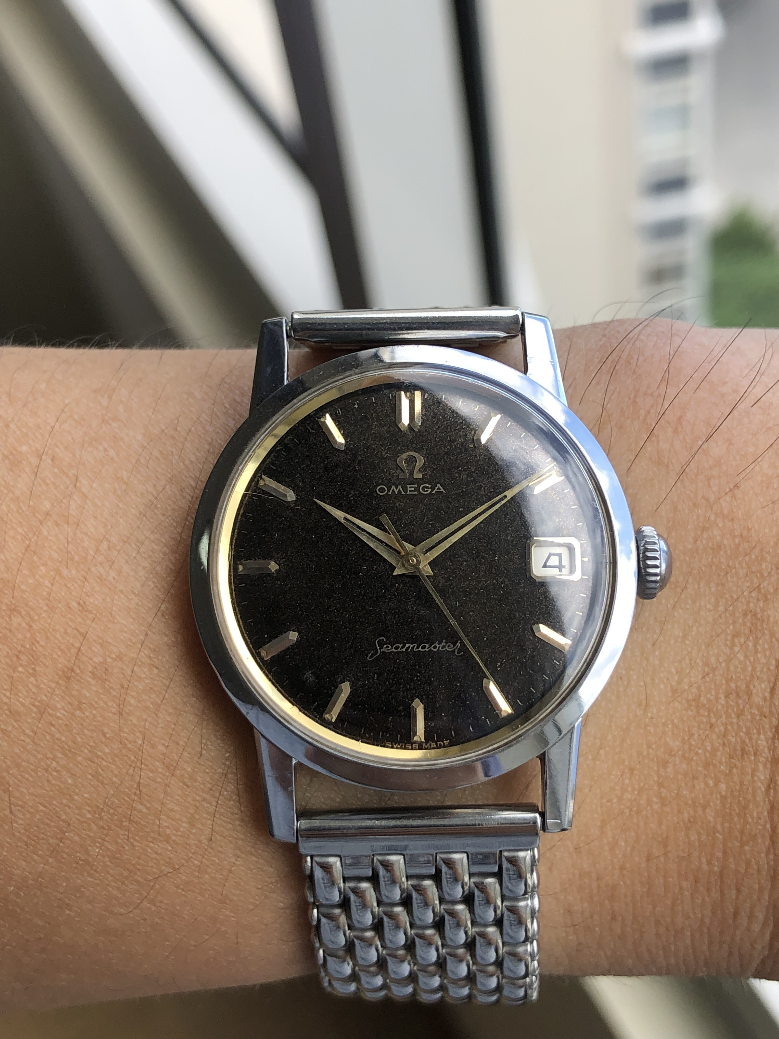

Since when have damaged dials been accepted as “tropical?” I was always under the impression that “tropical” meant it had more or less uniformly faded from black to a nice, chocolate brown.
I’m sorry, but those are not “tropical” dials. I could accept “patina”, but not “tropical”.

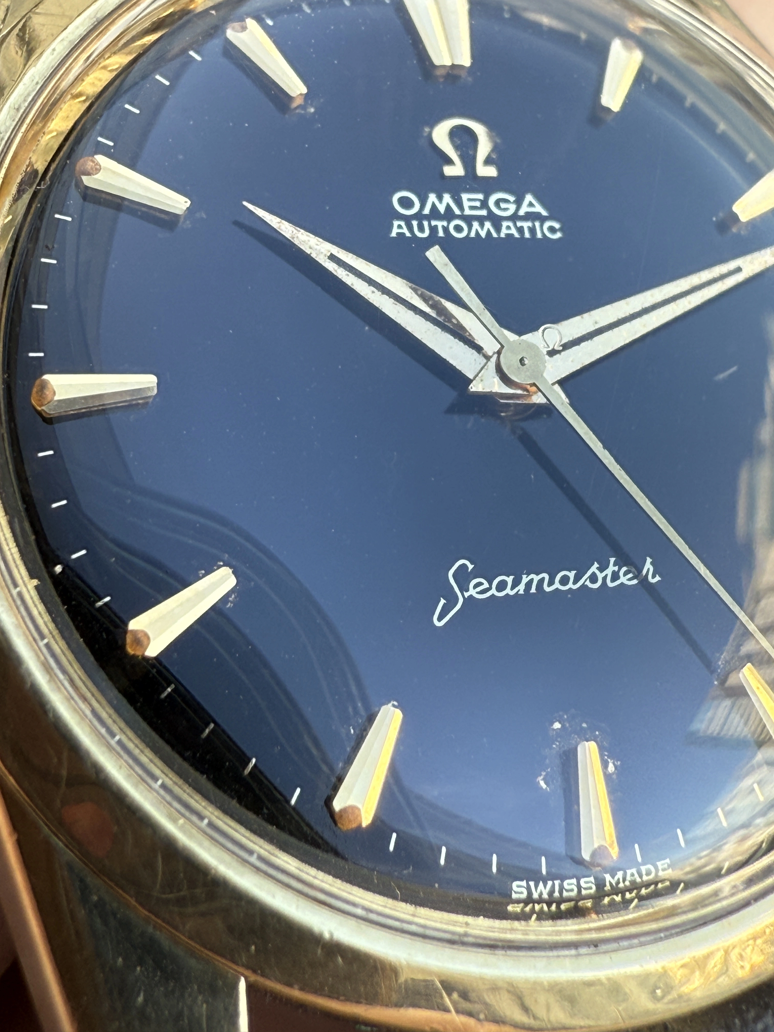

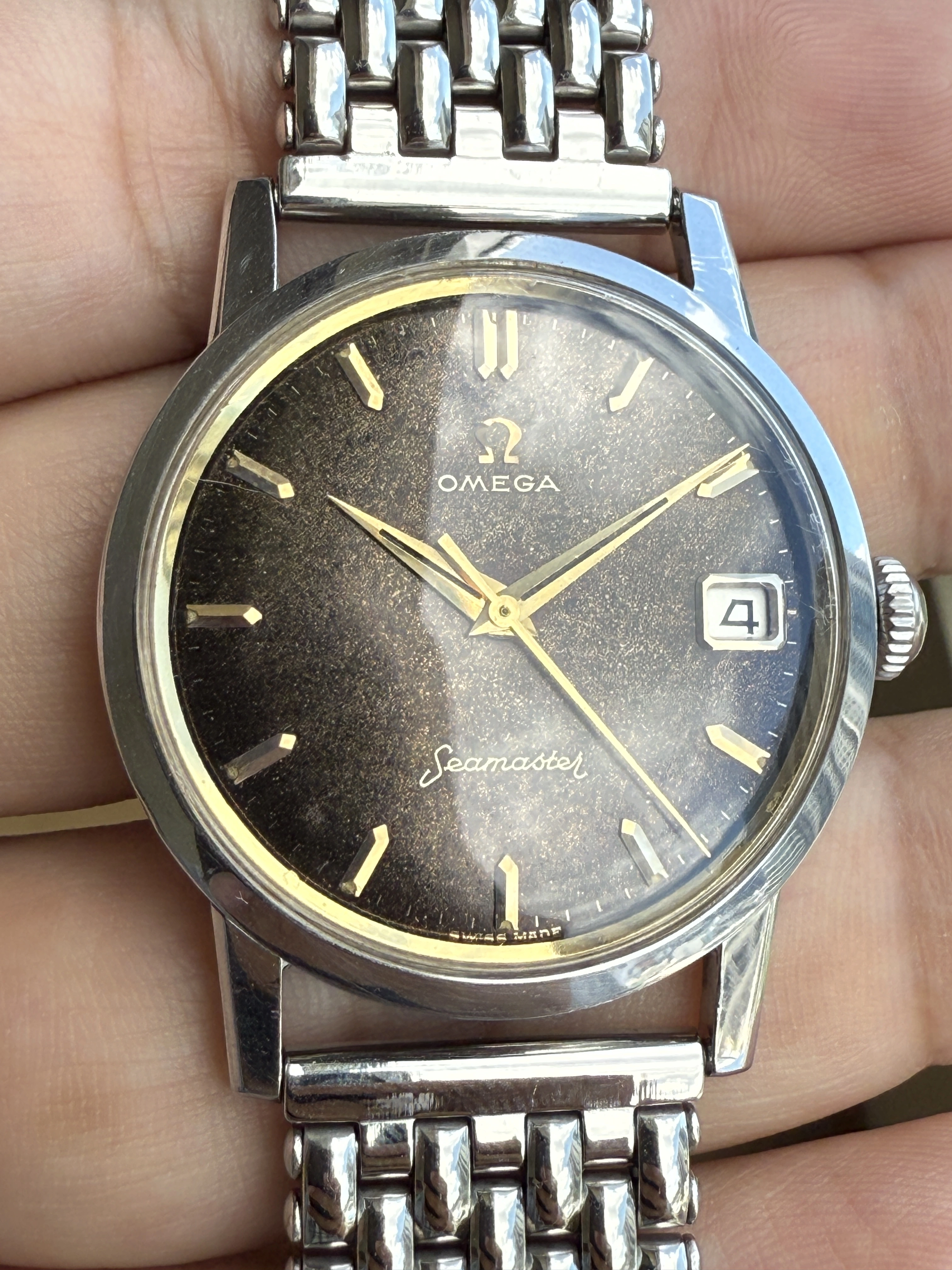

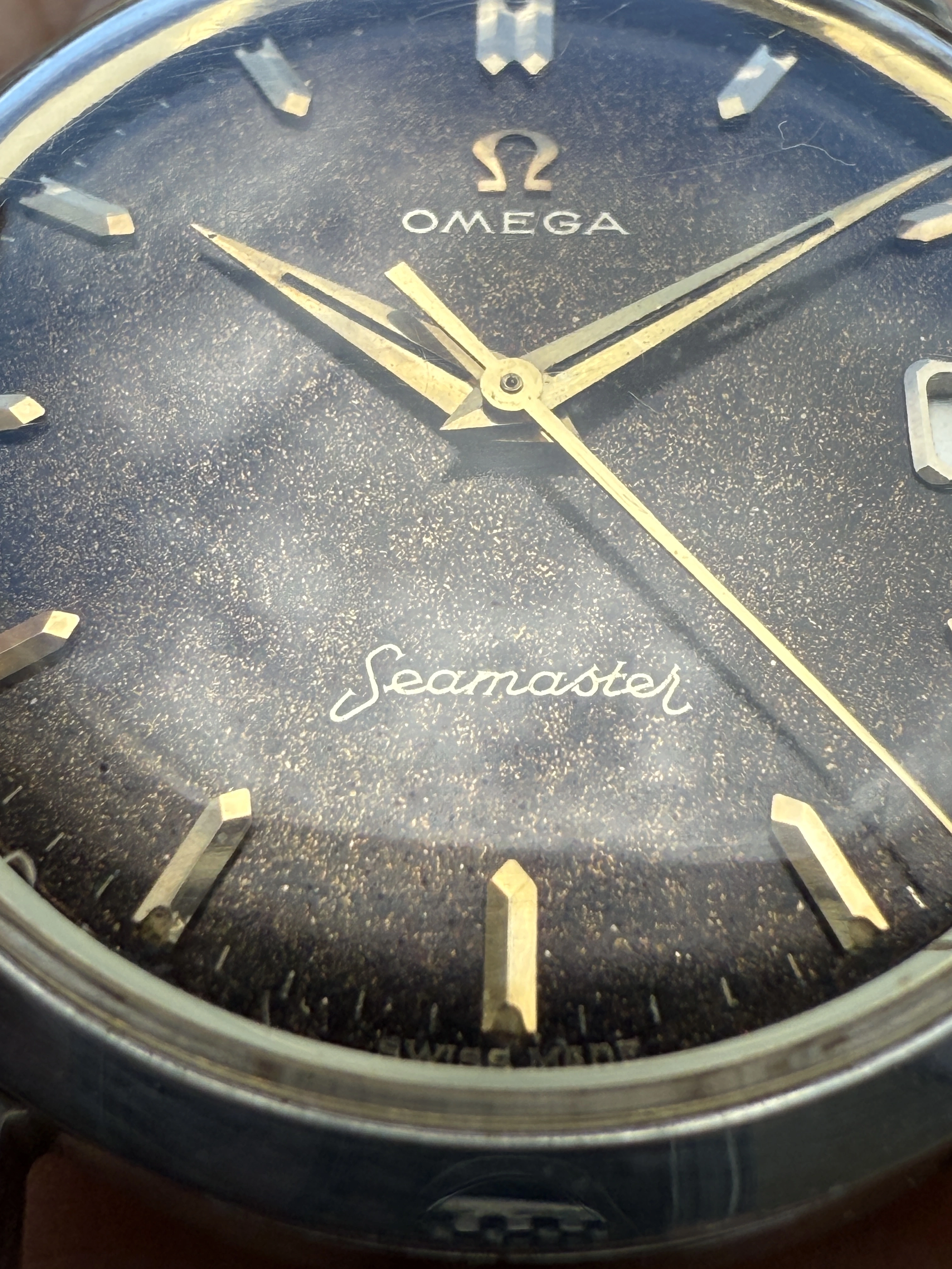

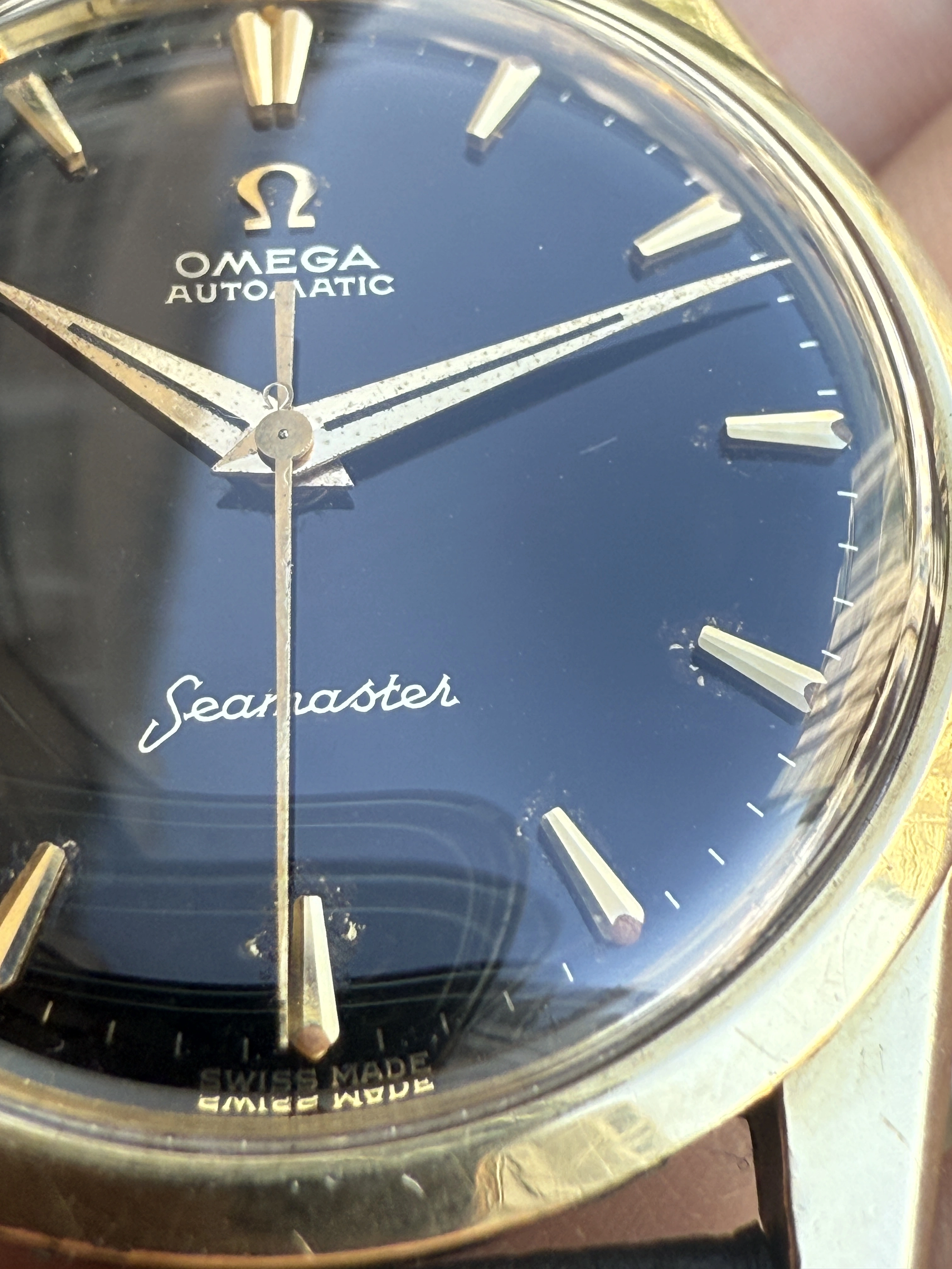

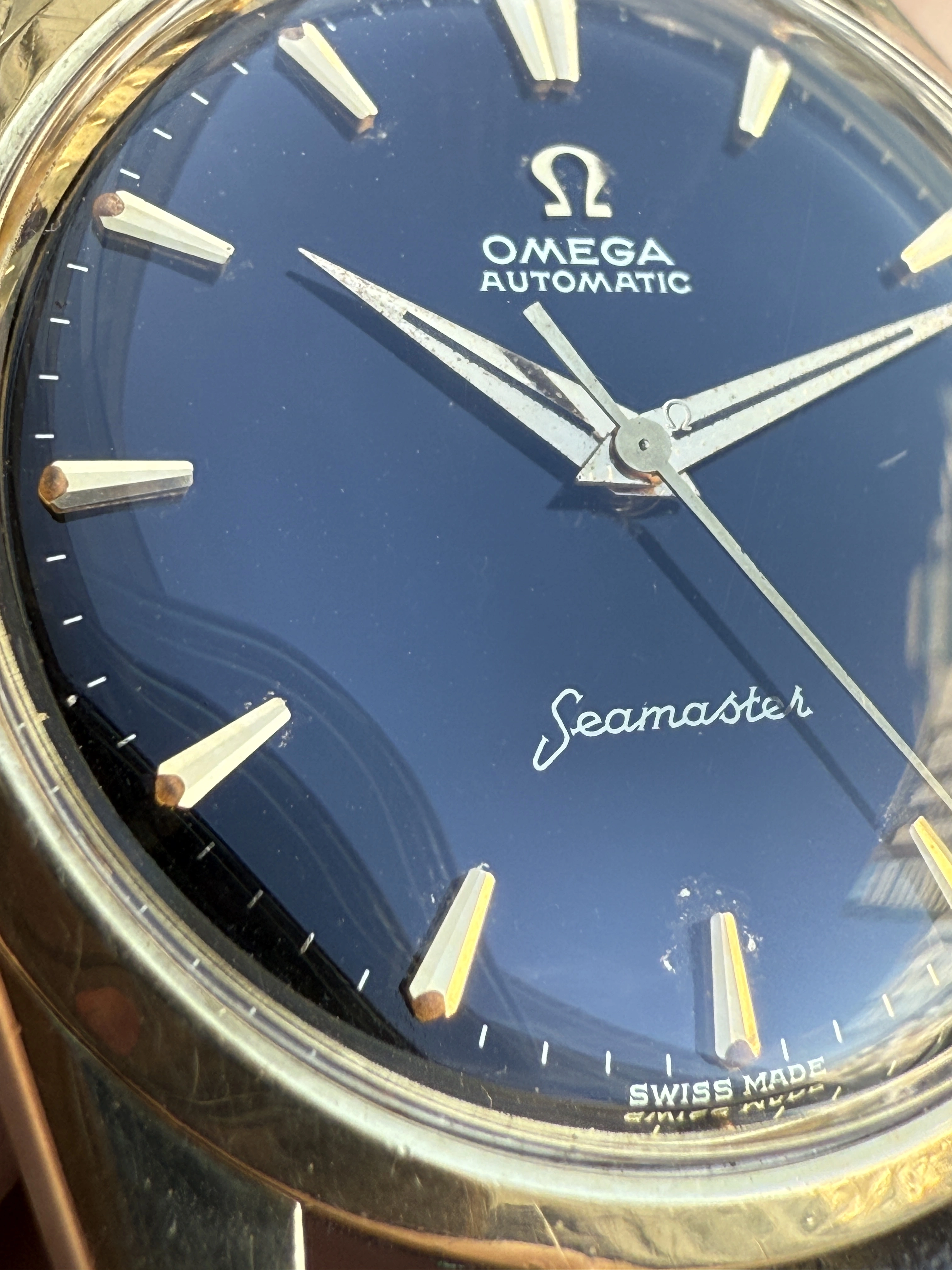

Here I have 14384 with a nice damaged dial and a 14700 with a not-yet damaged dial 😀.
14384
14700

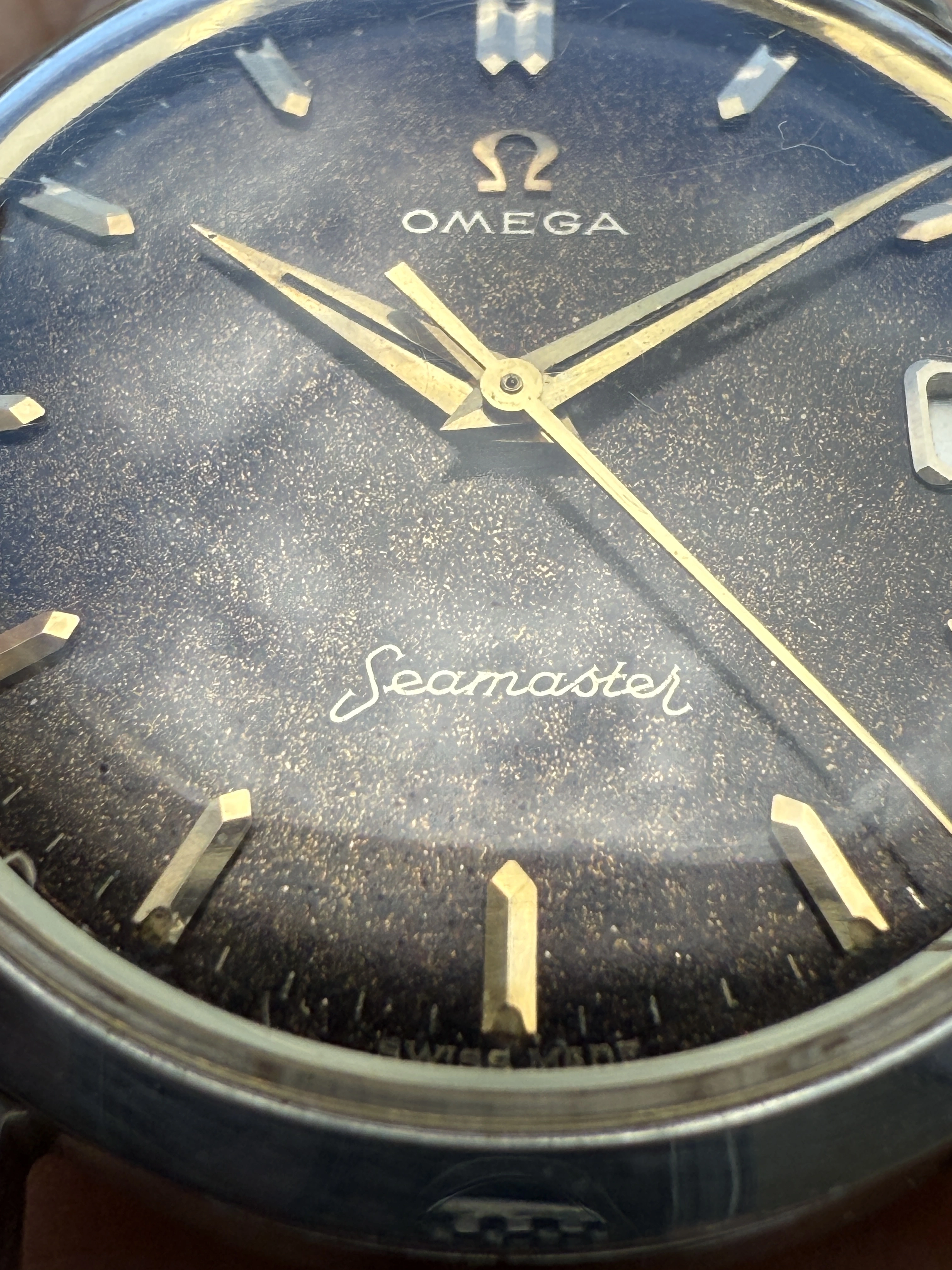

You may want to read this interesting recent thread from @hant26. One thing he notes that I hadn't read elsewhere about detecting dial refinishing is that when the hour markers are removed and replaced, a small detectable gap is often left underneath.

I’m a complete novice so might be a stupid question, why would you want a lack of polishing of the case? Is that because it’s part of the watch’s history/story?
Thank you for the distinction, I did not know!
Thanks, cool that it was yours! By the way, is that second crown the your old one? Where could I find an original with pictures as an example?
13,321
23,124

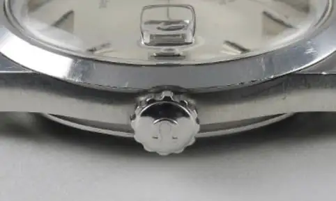

The original crown? Neither of those have the original crown. They should look like this.
