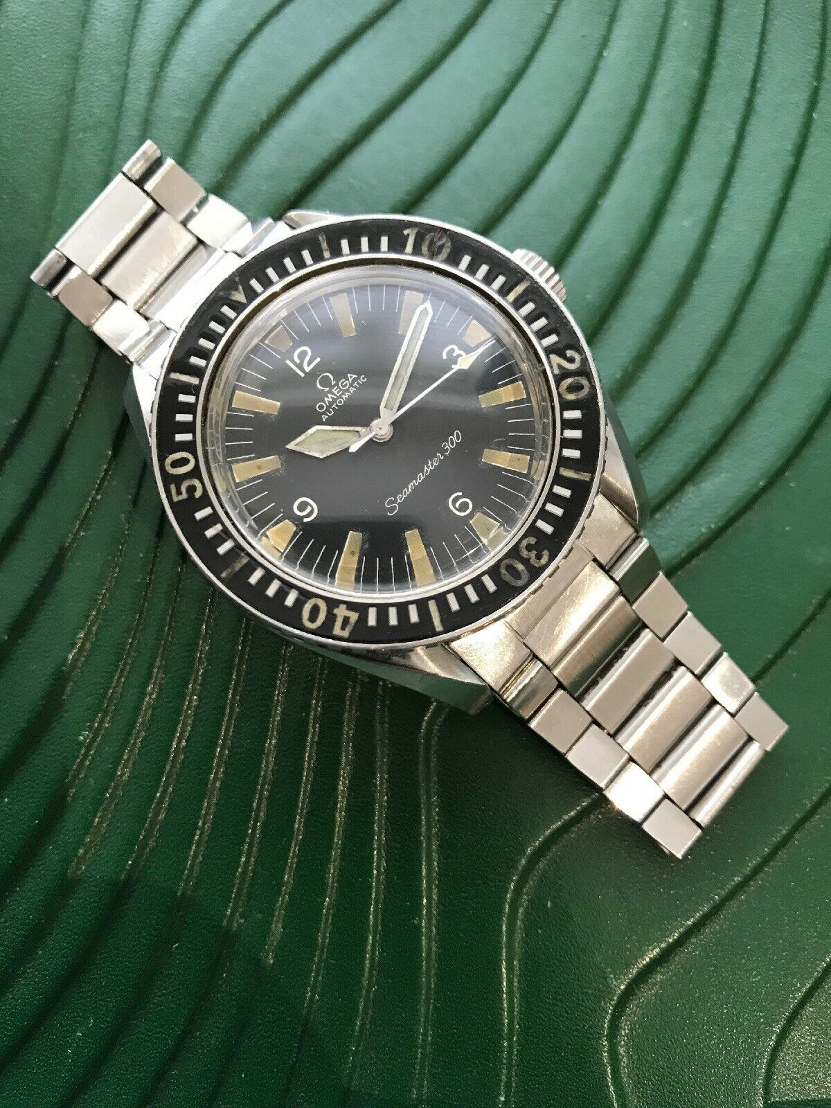

Hi,
SM 300 is always difficult for me due my lack of experience 馃檨
Would some of you be so kind to give me some input / feedback on an example? (Price is to be negotiated)
Watch is declared as 1967, so sn 2560... is in the correct range. EOA is there
The bezel is a bit difficult for me, is it this one?
Is there no tirtium in the 5 minute markers??? Or no tritium at all?
Is it "D" from here? If yes "D" is noted for CB production only but the one for sale is HF
Case seems to be in good condition, the caseback is a bit worn. Crown is original I think

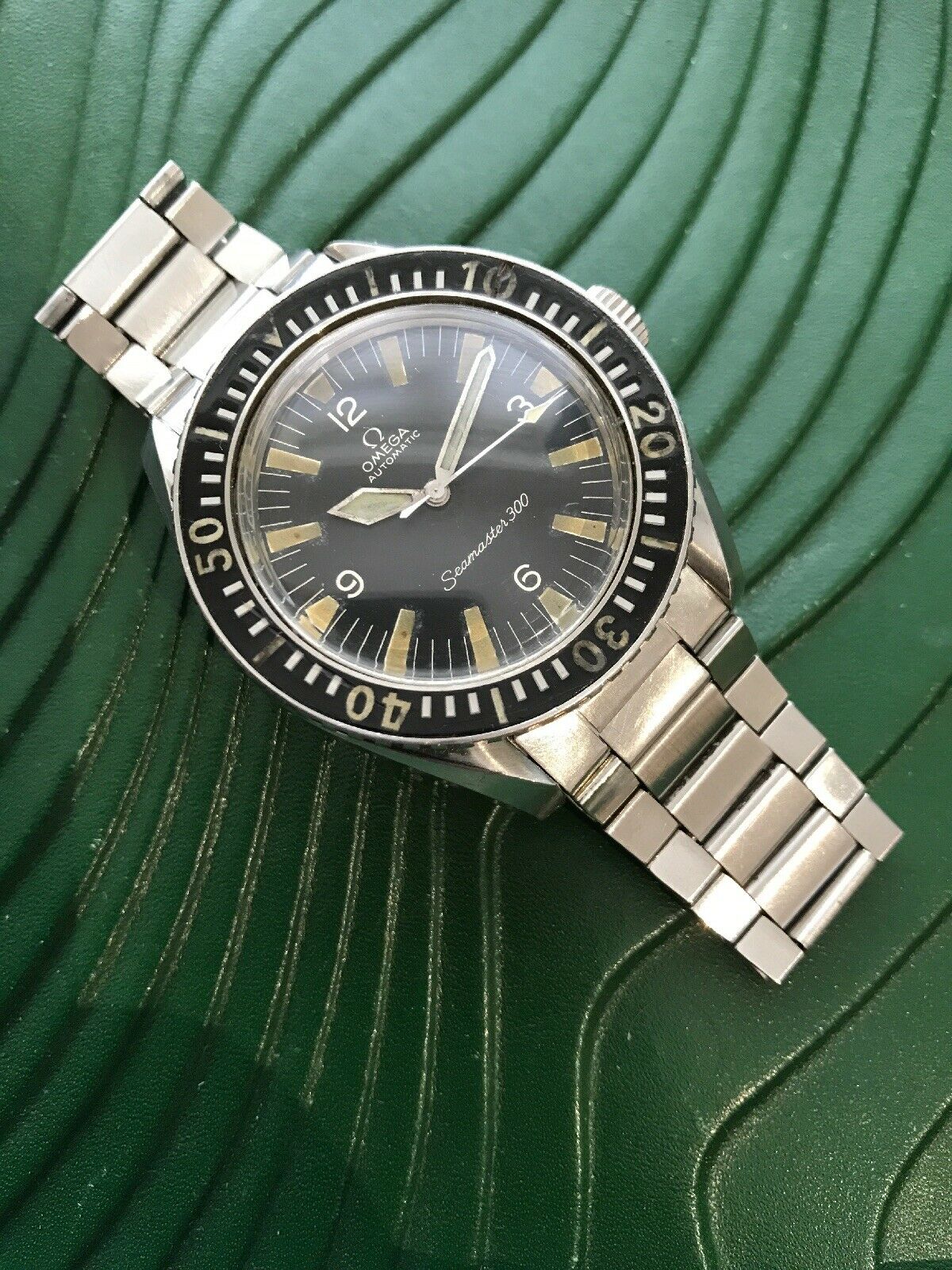

The lume looks good as far as I can see both on hands and dial. there seem to be some irregularities around the lume dots, for example at 8 and 9. These could be signs for a relume but they are very slight. What do you think???
So, curious what you think, thanks again for supporting me on that! 馃榾

I leave it to the experts but I just wanted to say that is a super attractive shade the lume!
Edit: Seems like the lume is indeed TOO nice
3,581
13,525
My thoughts exactly. The lume looks absolutely stunning!

My 2 cents. Relume with a service bezel and non original glass. But far better calls by people who really know.

Lume might look nice, but it's still a relumed dial/hands. Below is how the watch looked before the relume etc. - and yes, it's the same watch or at least the movement/serial is for sure.
And this is a november 67 production, so should be a CB case /caseback.
This one has been through at least one seller with a history of 馃が SM300 examples.
I wouldn't touch it, if you're looking for an authenic one.

And the movement is made up of at least different Metal shades.............

Impressive that the person who relumed the dial was able to preserve the pinholes at 6 and 12 o鈥檆lock. On most examples I鈥檝e seen the relume covers the pinhole up and is usually a giveaway.

btw the crystal is also wrong as the correct one has a flatter shape and is not domed

Thank you gents for your feedback, helped me a lot. Will pass it for sure
Using the questions / points raised here I will be able to look more expereinced at the next one.
