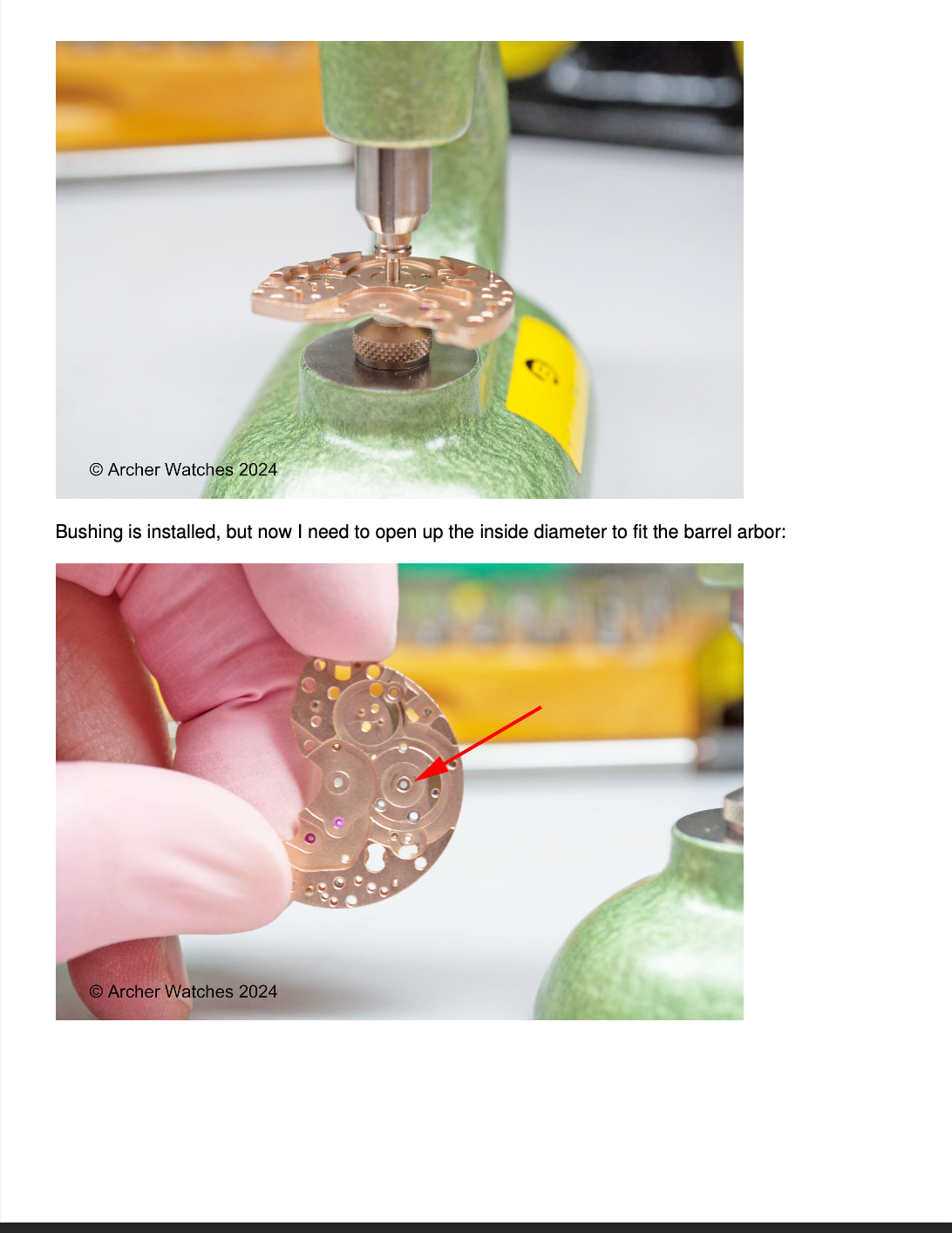

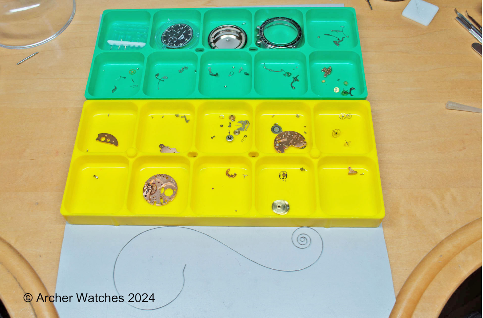

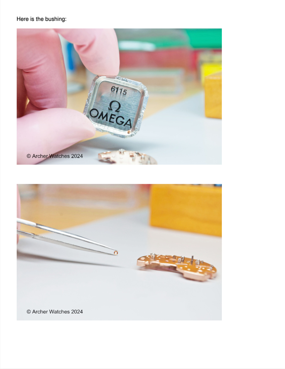

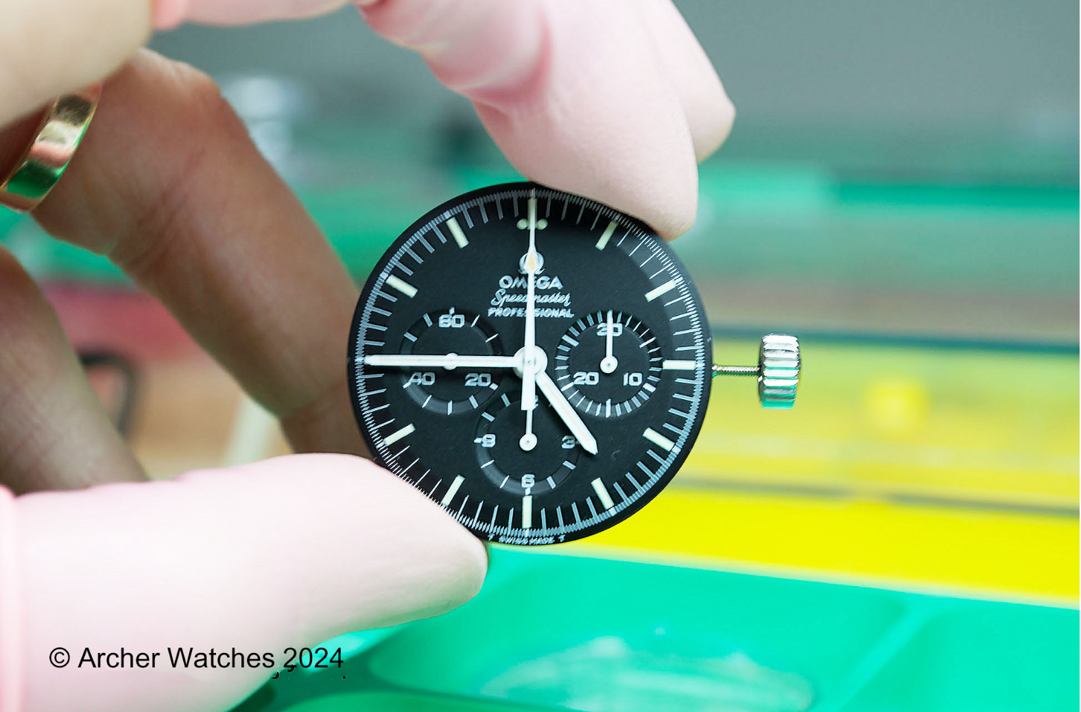

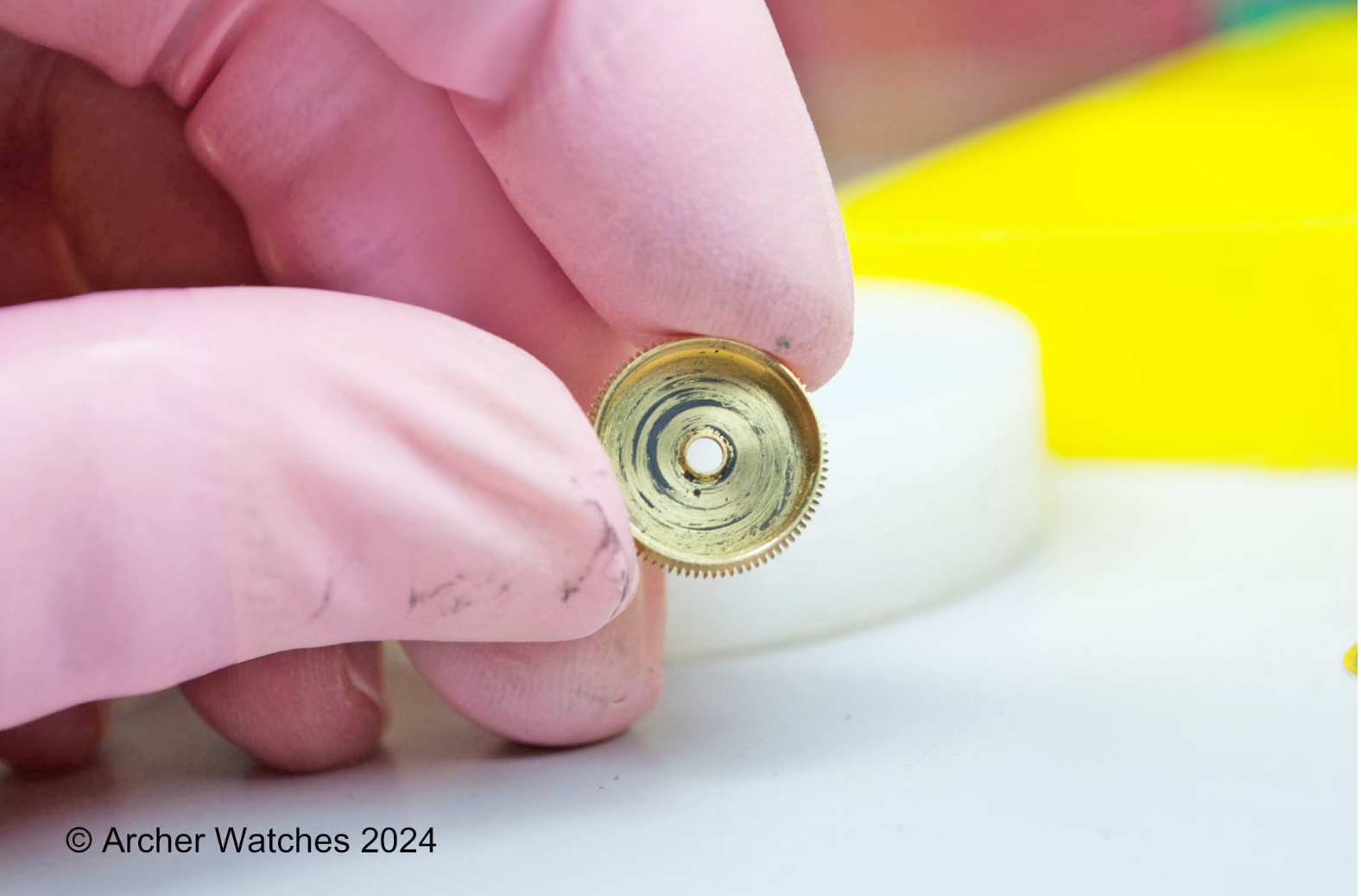

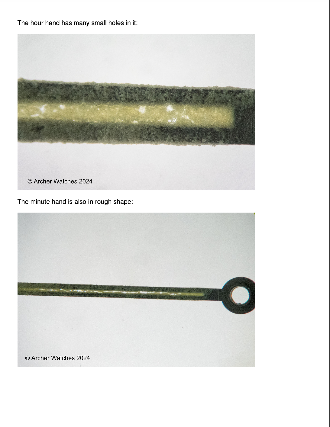

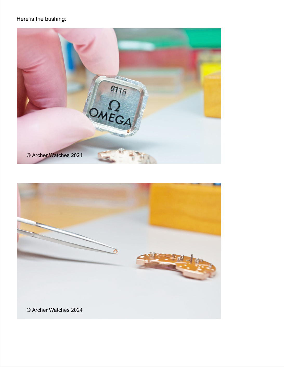

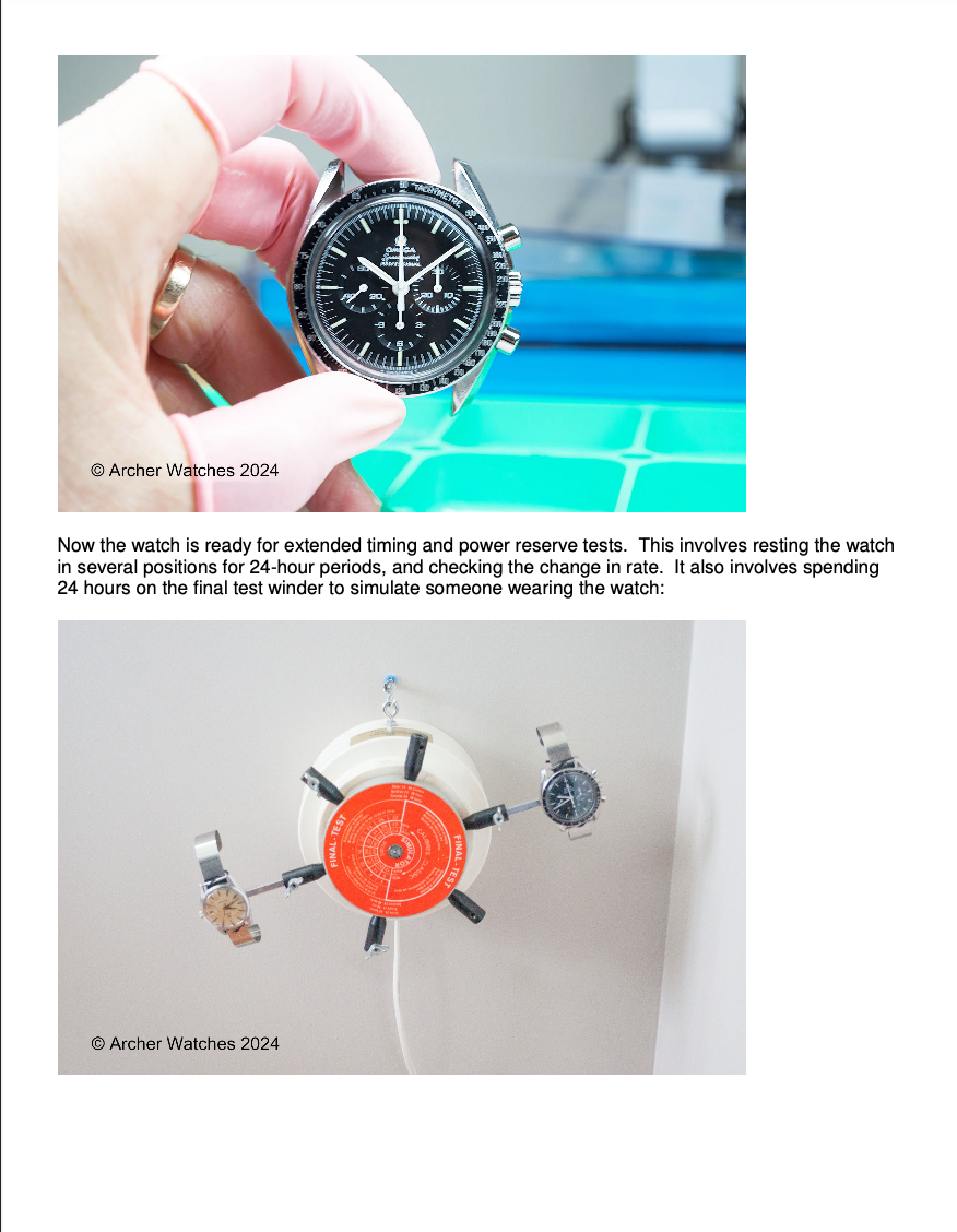

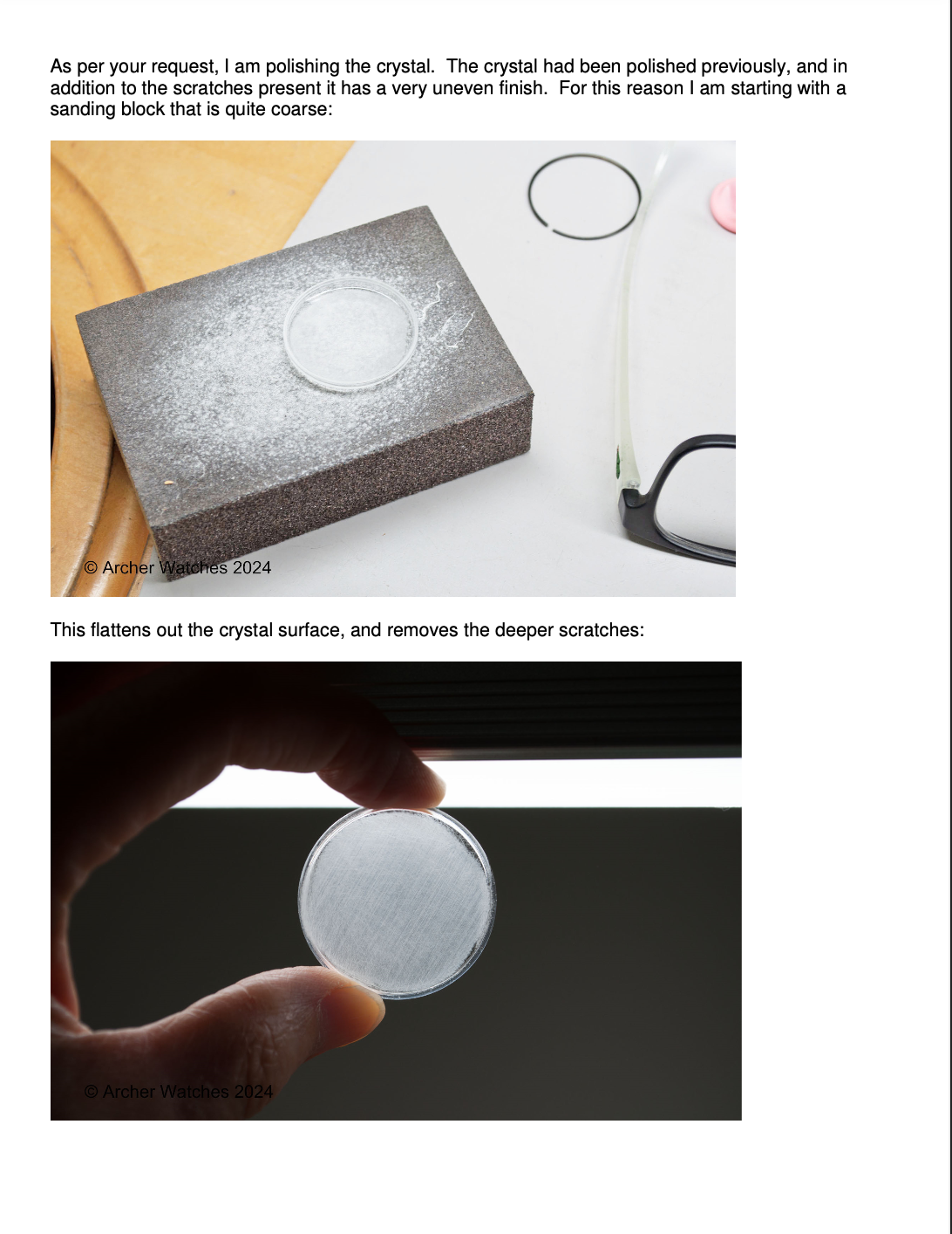

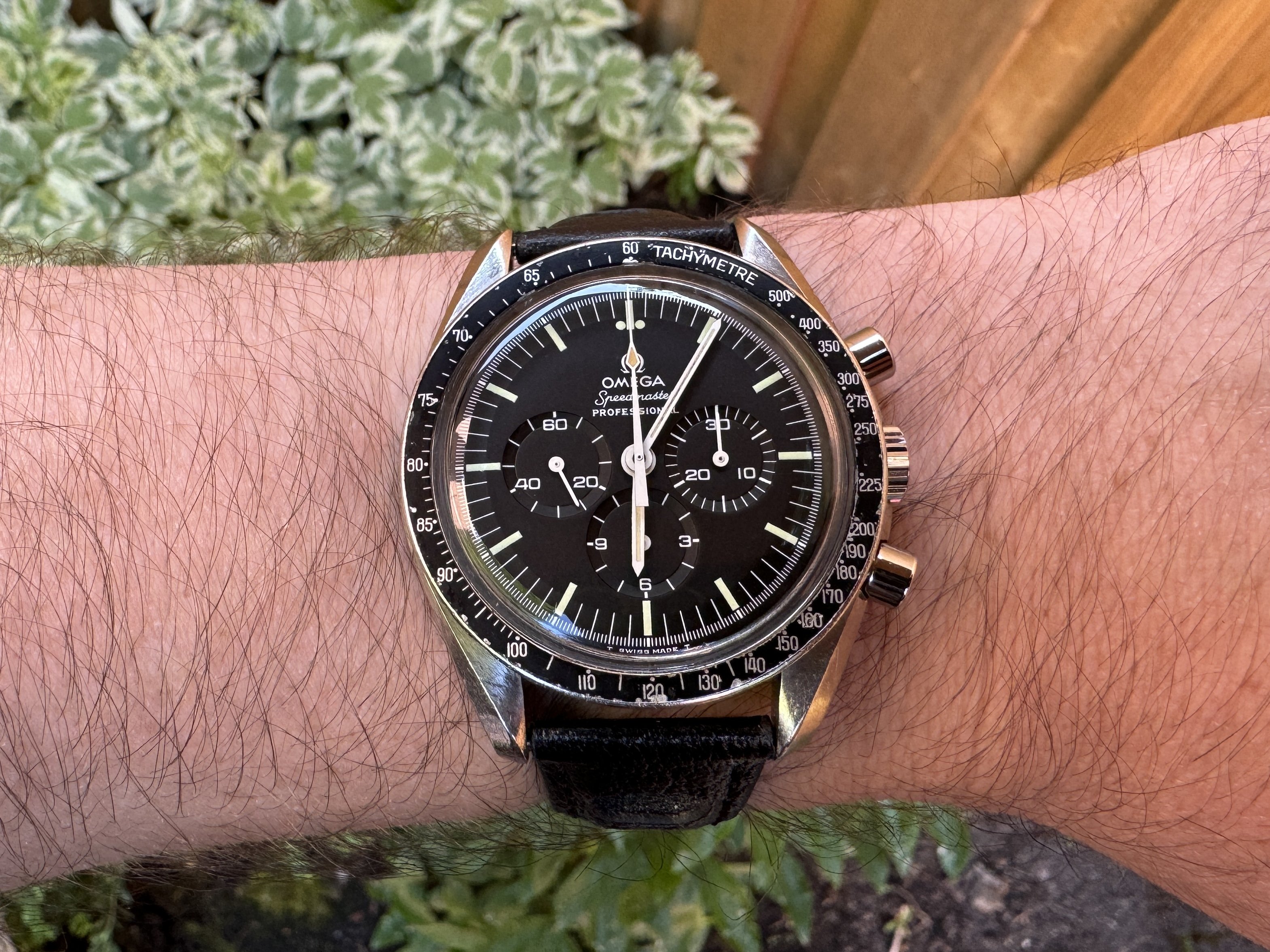

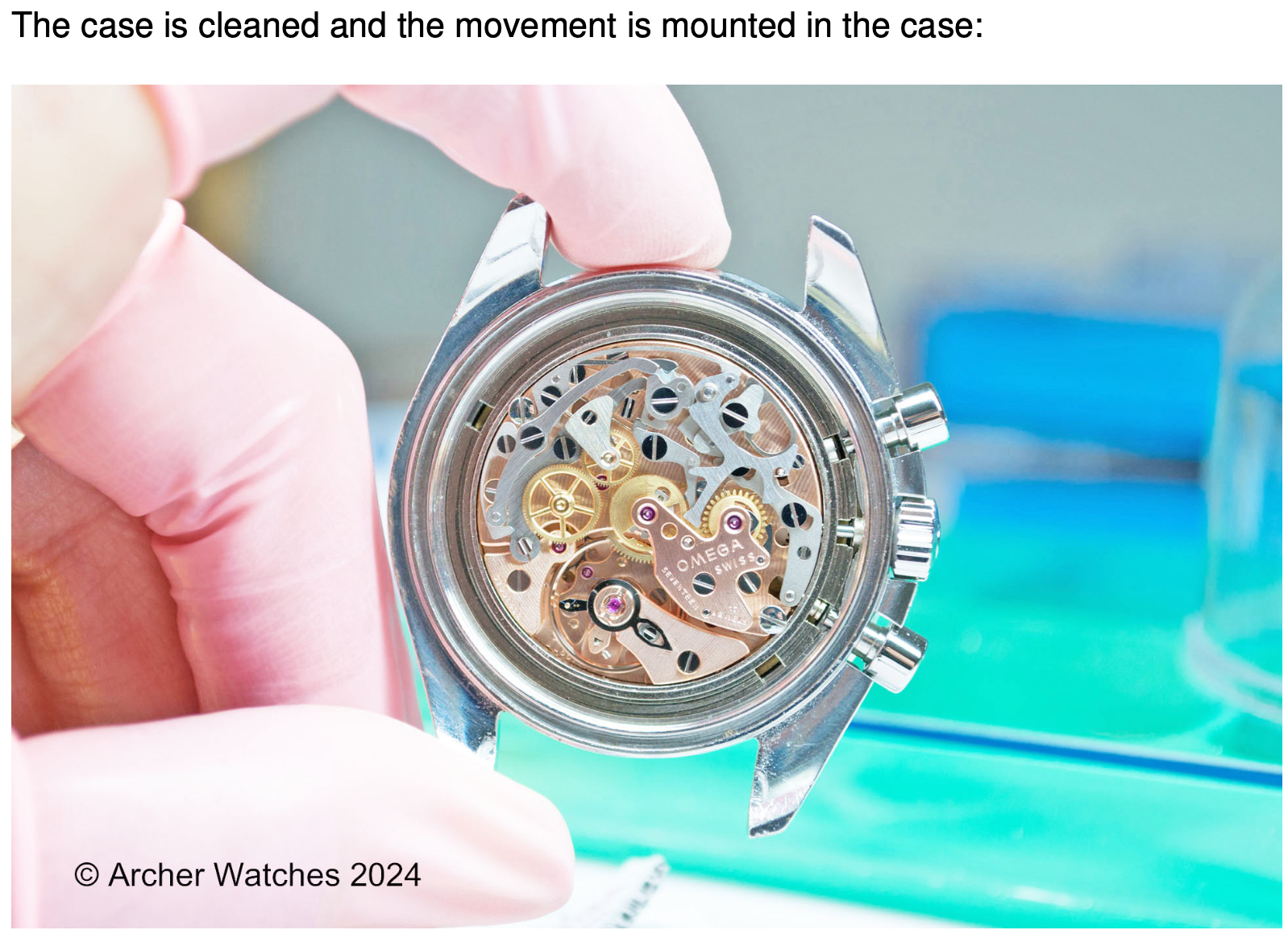

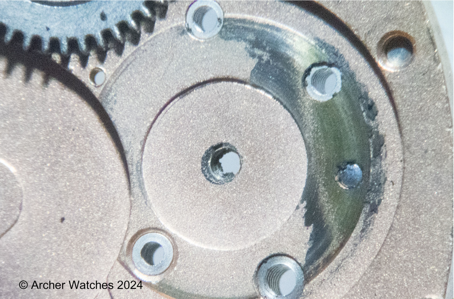

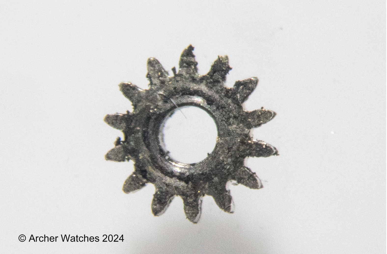

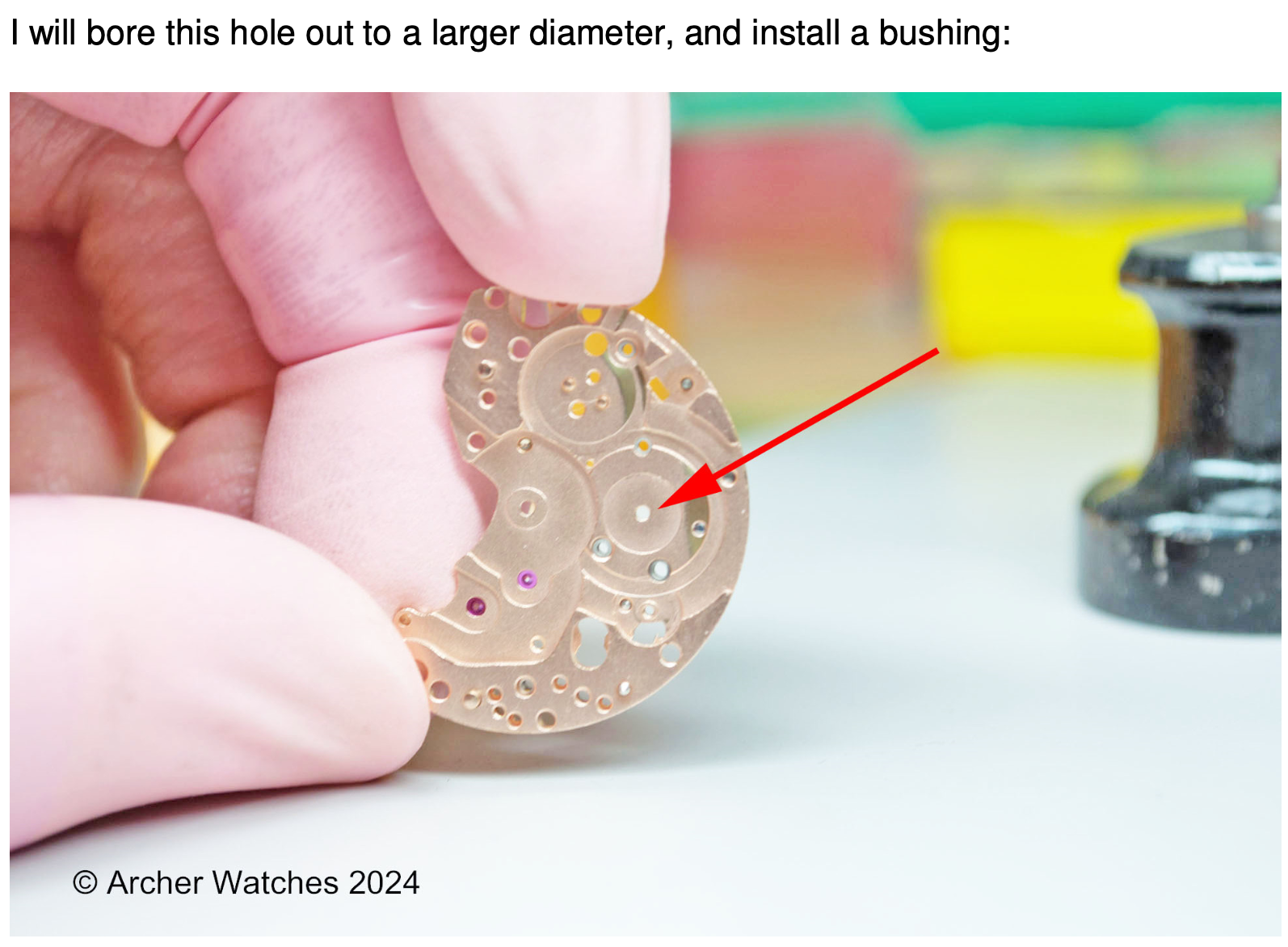

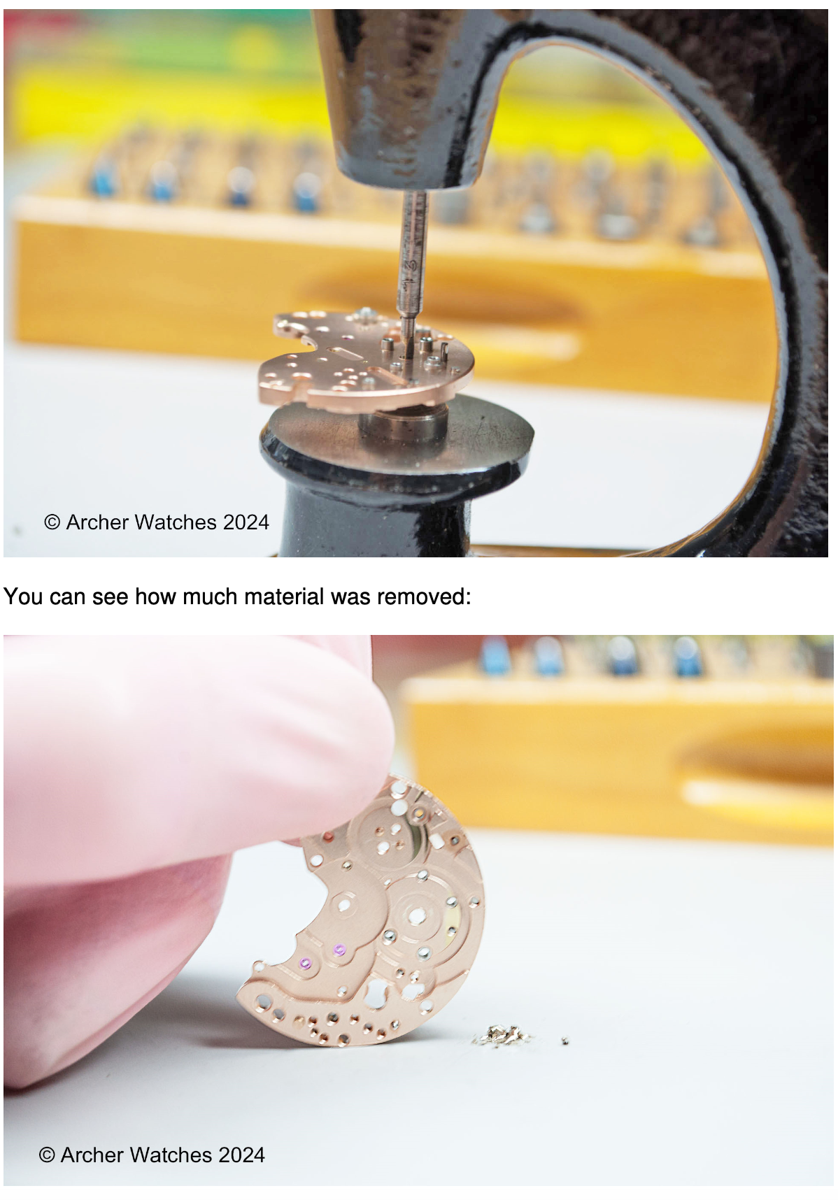

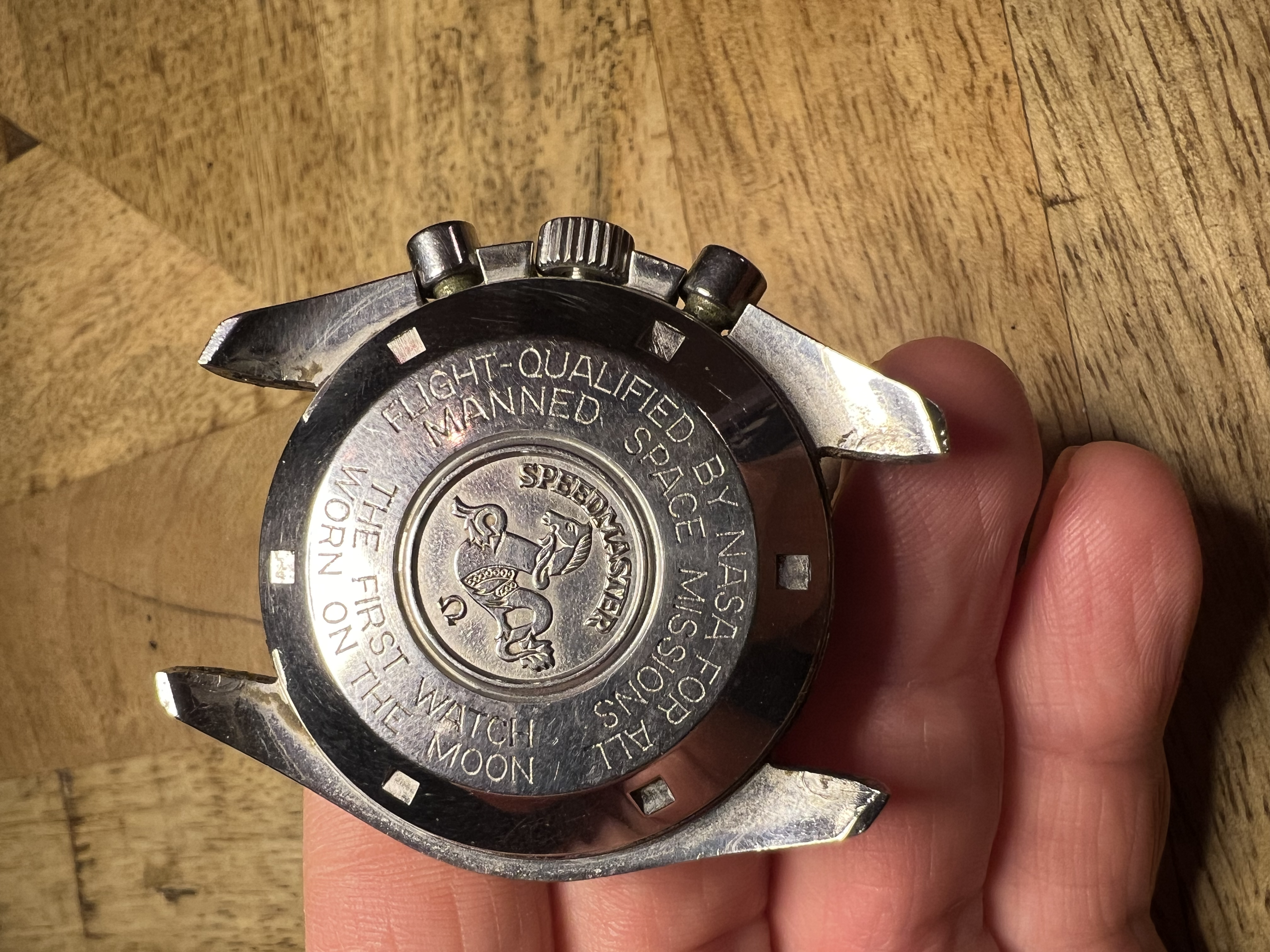

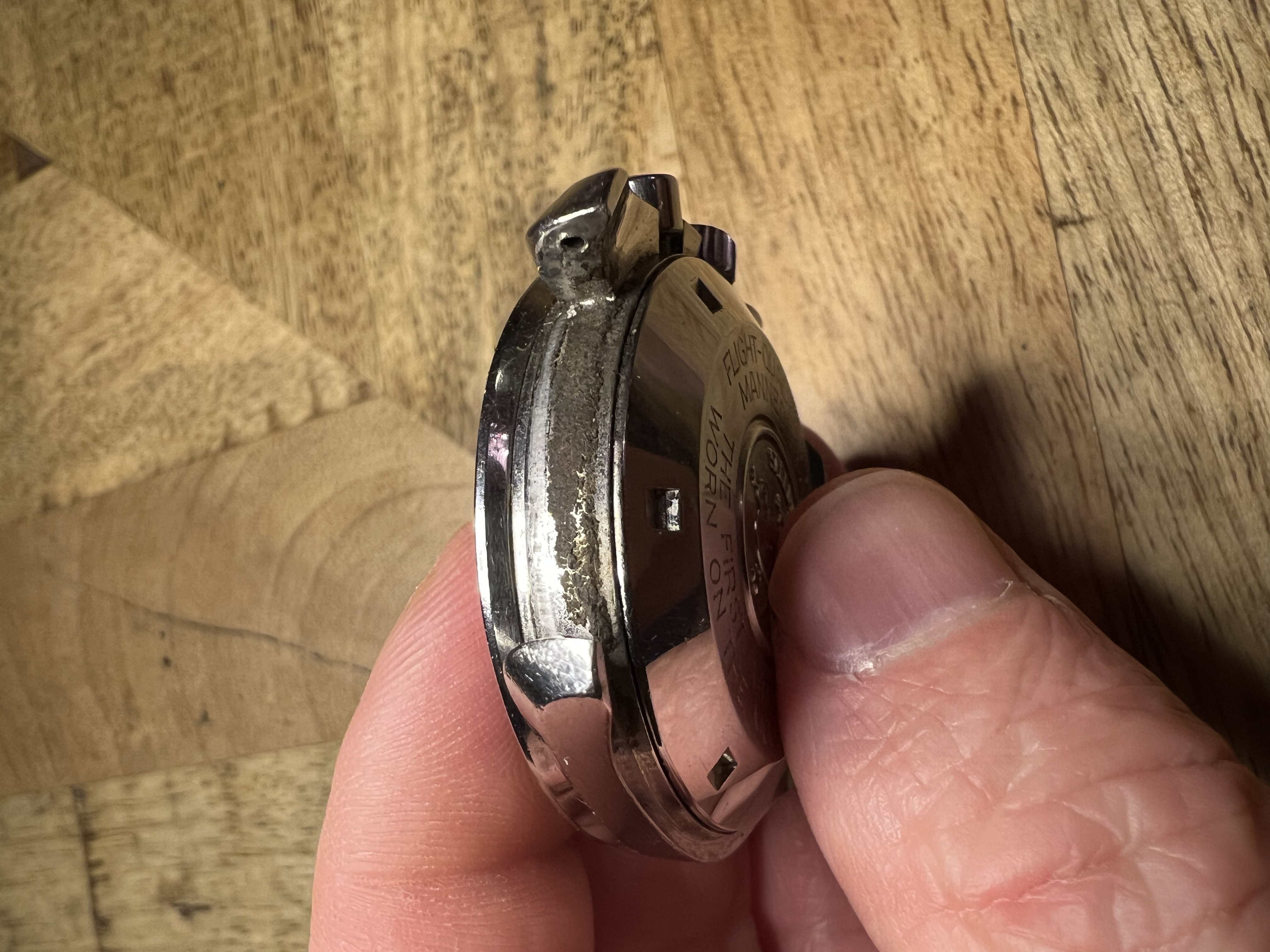

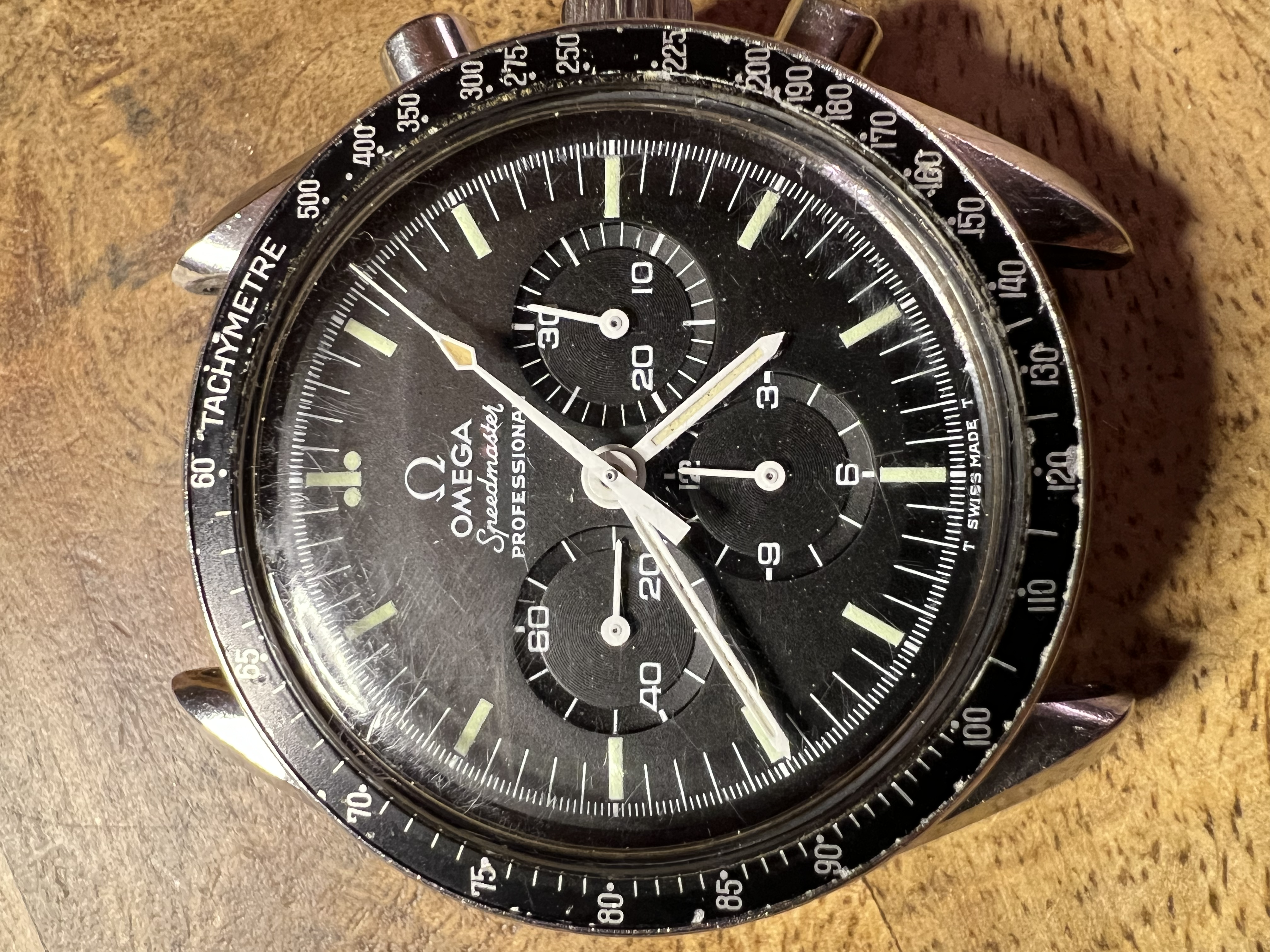

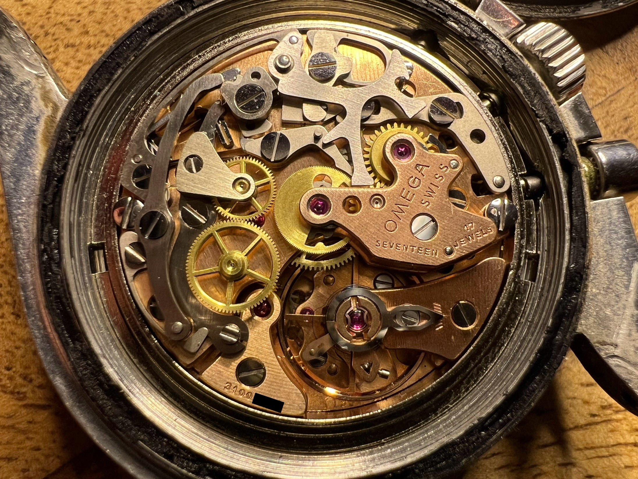

Back in January, I posted a thread on the day I purchased a well used Speedy. It was in rough shape and seemed to have never been serviced. I dropped it off to Archer's for a full service. Over a month ago, I got the watch back but was waiting to purchase a Corfam style racing strap from Heuertime before sharing photos and updating the thread. Unfortunately, the strap has been out of stock with no known restock date. I currently have it on a 19mm StrapCo rally strap, which I heated and stretched a bit to minimize the gap.

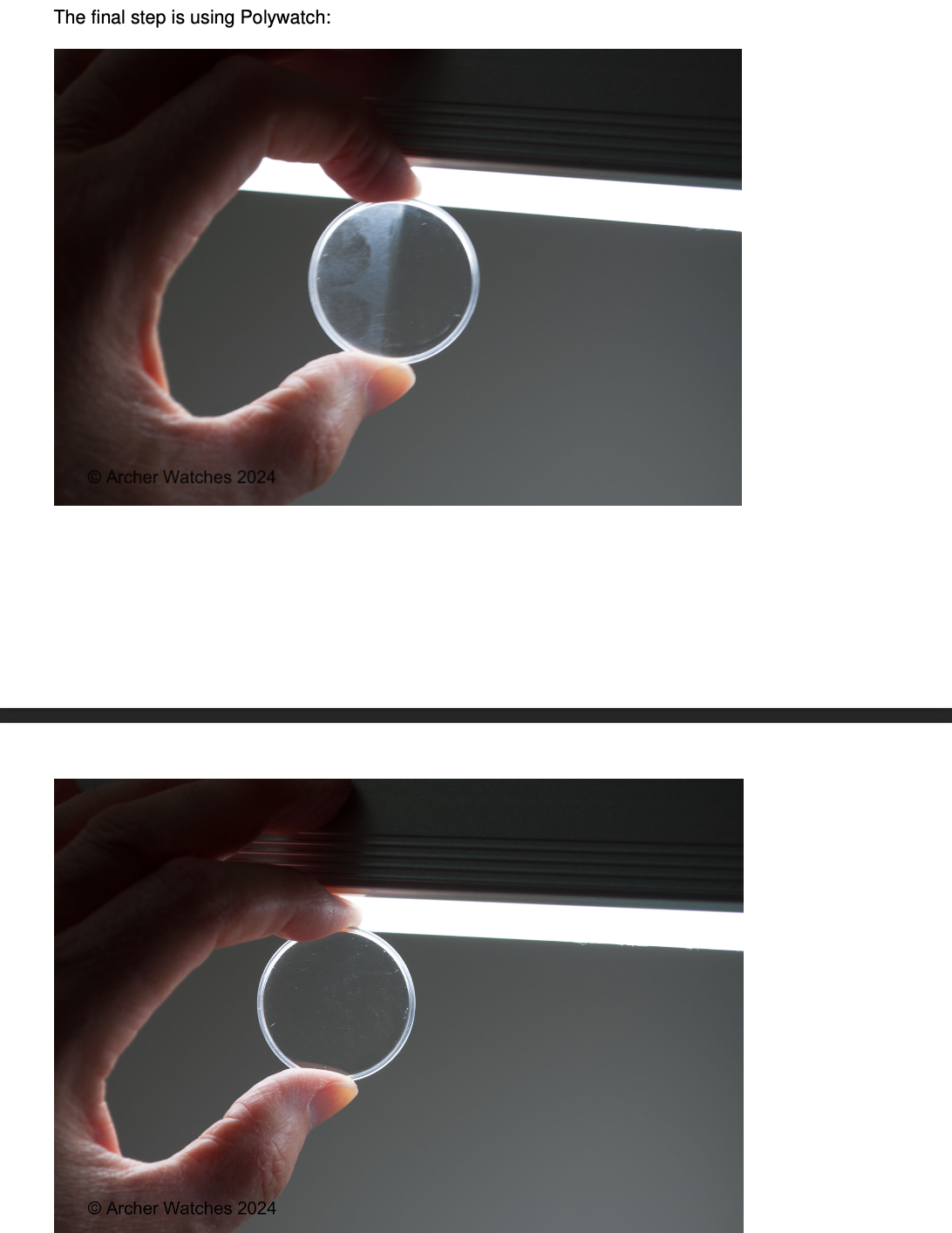

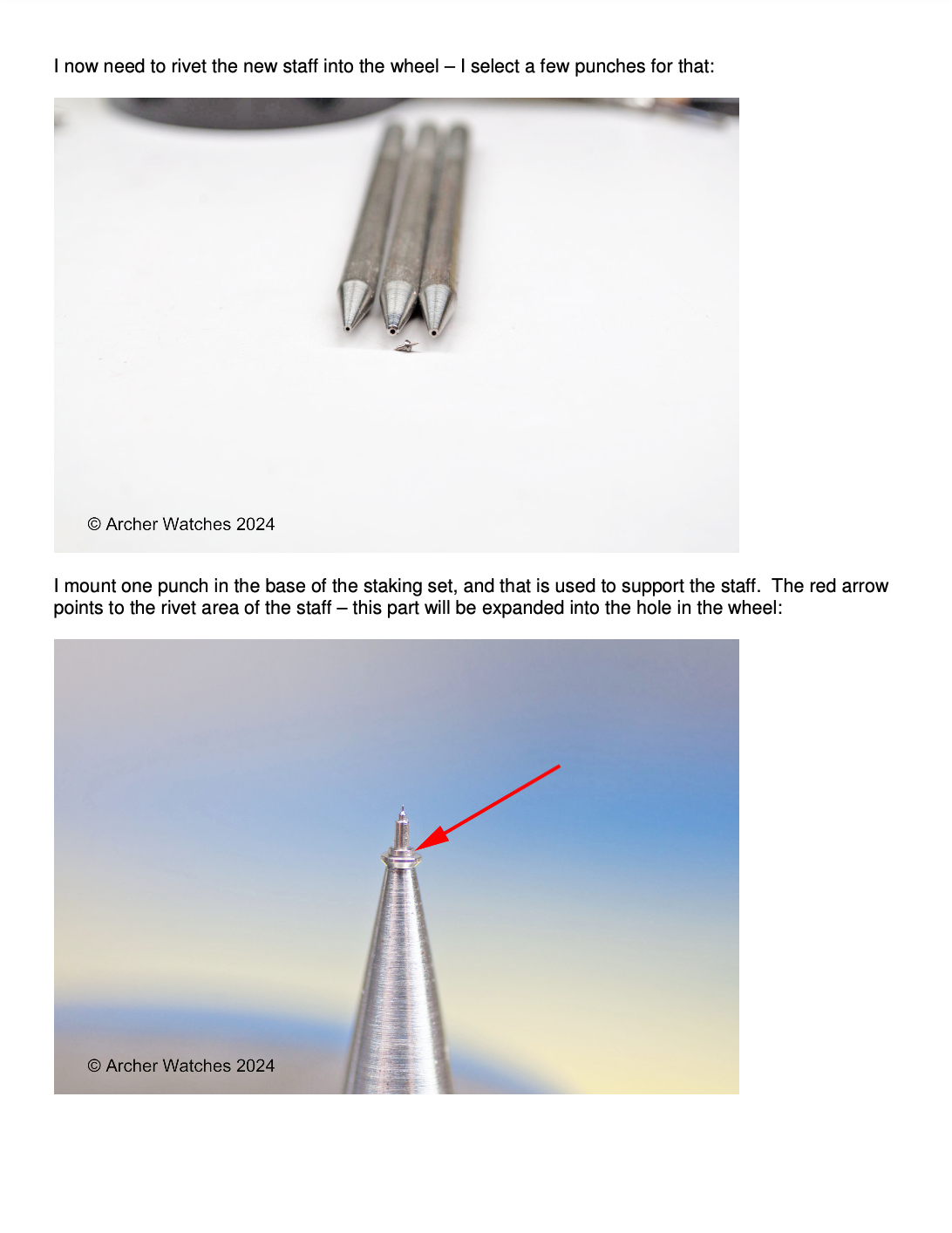

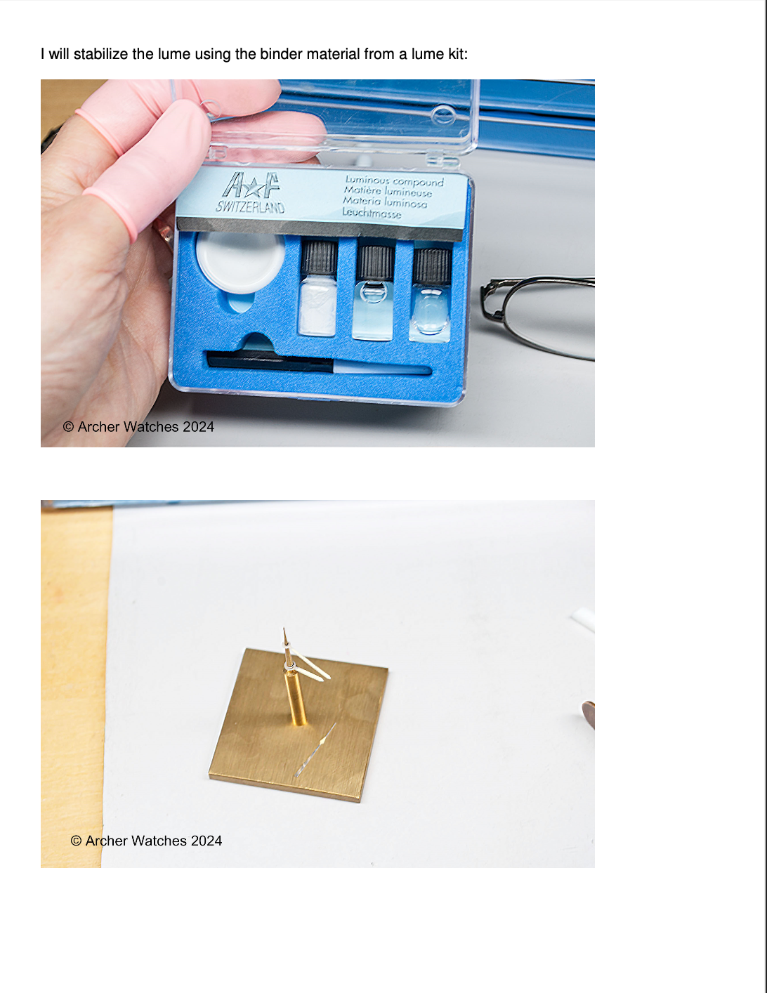

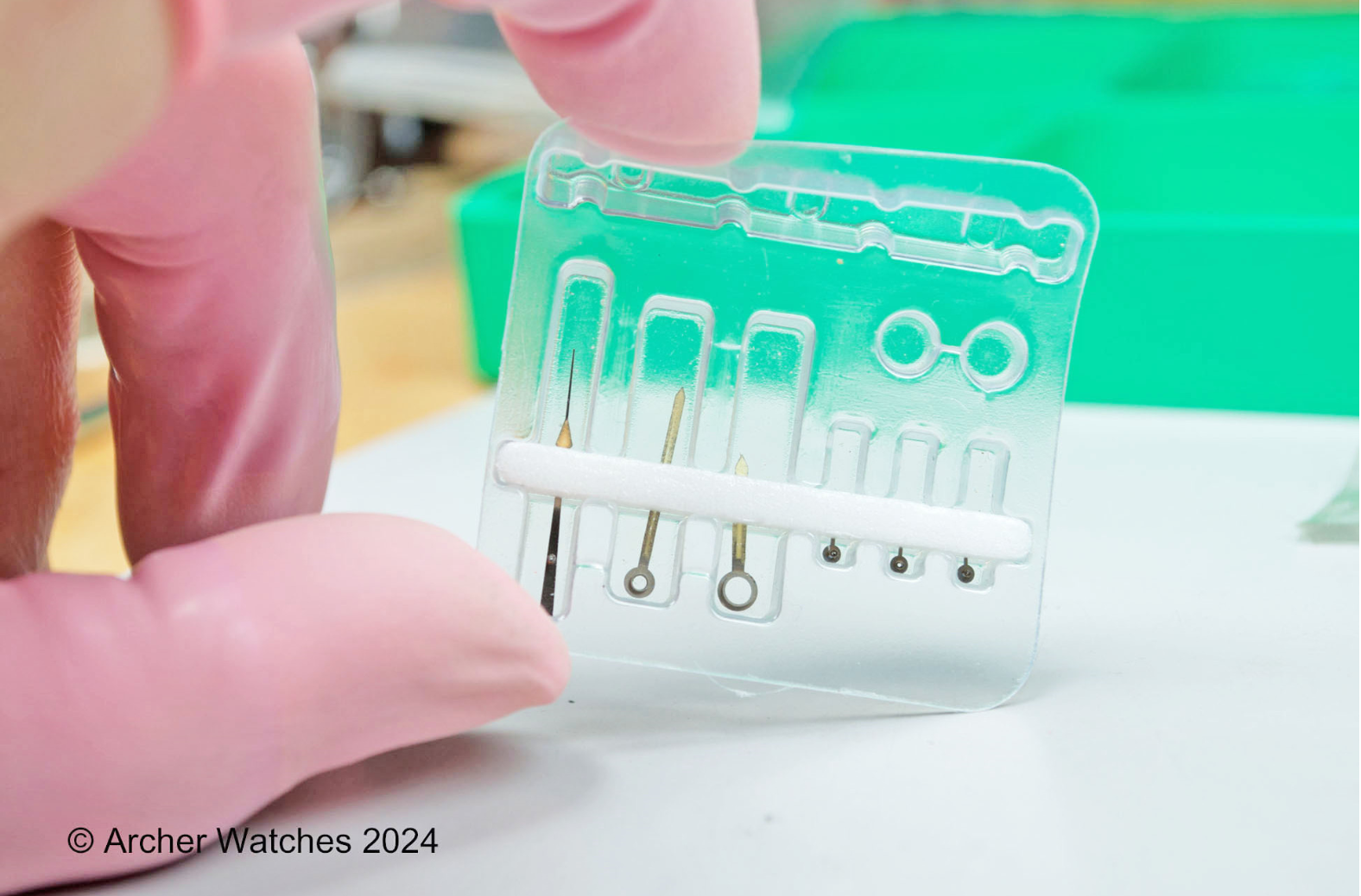

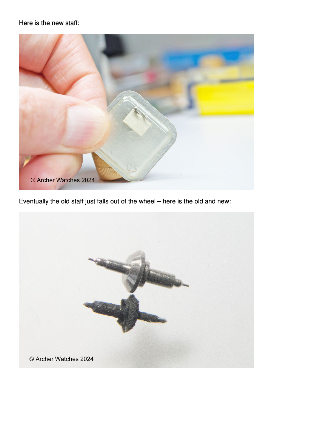

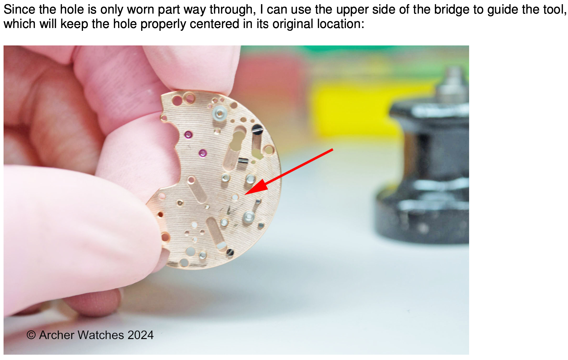

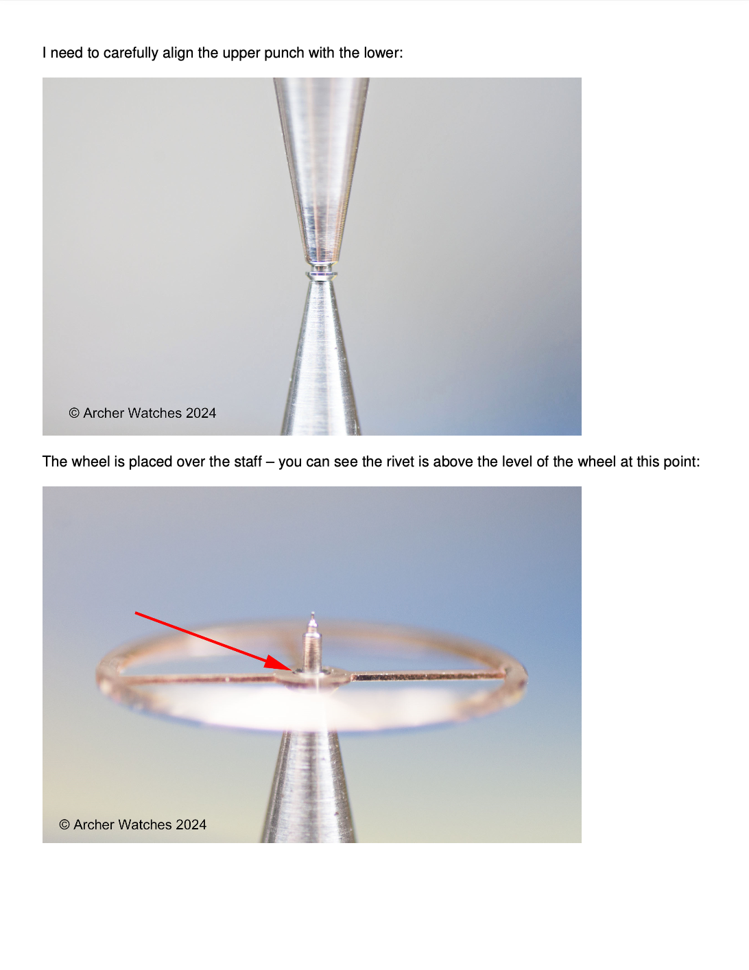

When I received the watch, it came with a 125 page PDF and a few repair videos on a USB drive from Archer, detailing every step of the servicing process from A to Z. While it's impossible to share everything, I will post a few photos from the PDF. I want to emphasize that Archer exceeded my expectations. He is a true perfectionist who brought this 861 back to life with skill of a true master. I think all who know Archer will agree. What I like most about Archer is his excitement to share his knowledge of watchmaking.

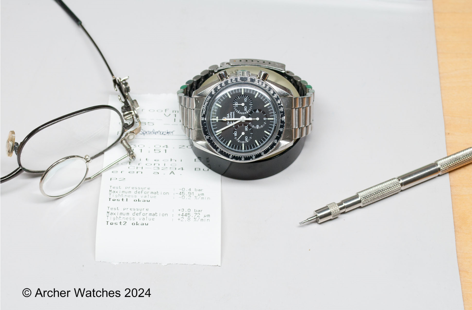

I chose to replace the crown and pushers to get some water resistance, as I'd like to protect the dial and hands (and the movement) from dust, humidity, and moisture as much as possible. I'm not planning to go in the water with it, but I'd like to wear the watch worry free and maintain the condition of the dial and hands as much as possible. Archer returned the original crown and pushers to me, and they can be reinstalled in minutes, so I don’t see it as an issue in terms of retaining originality.

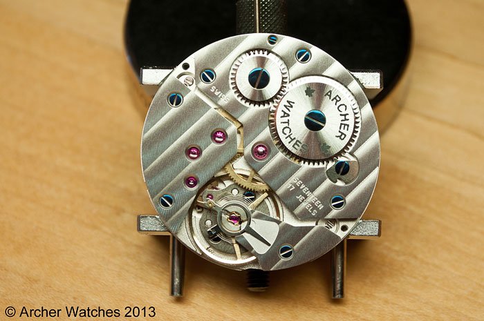

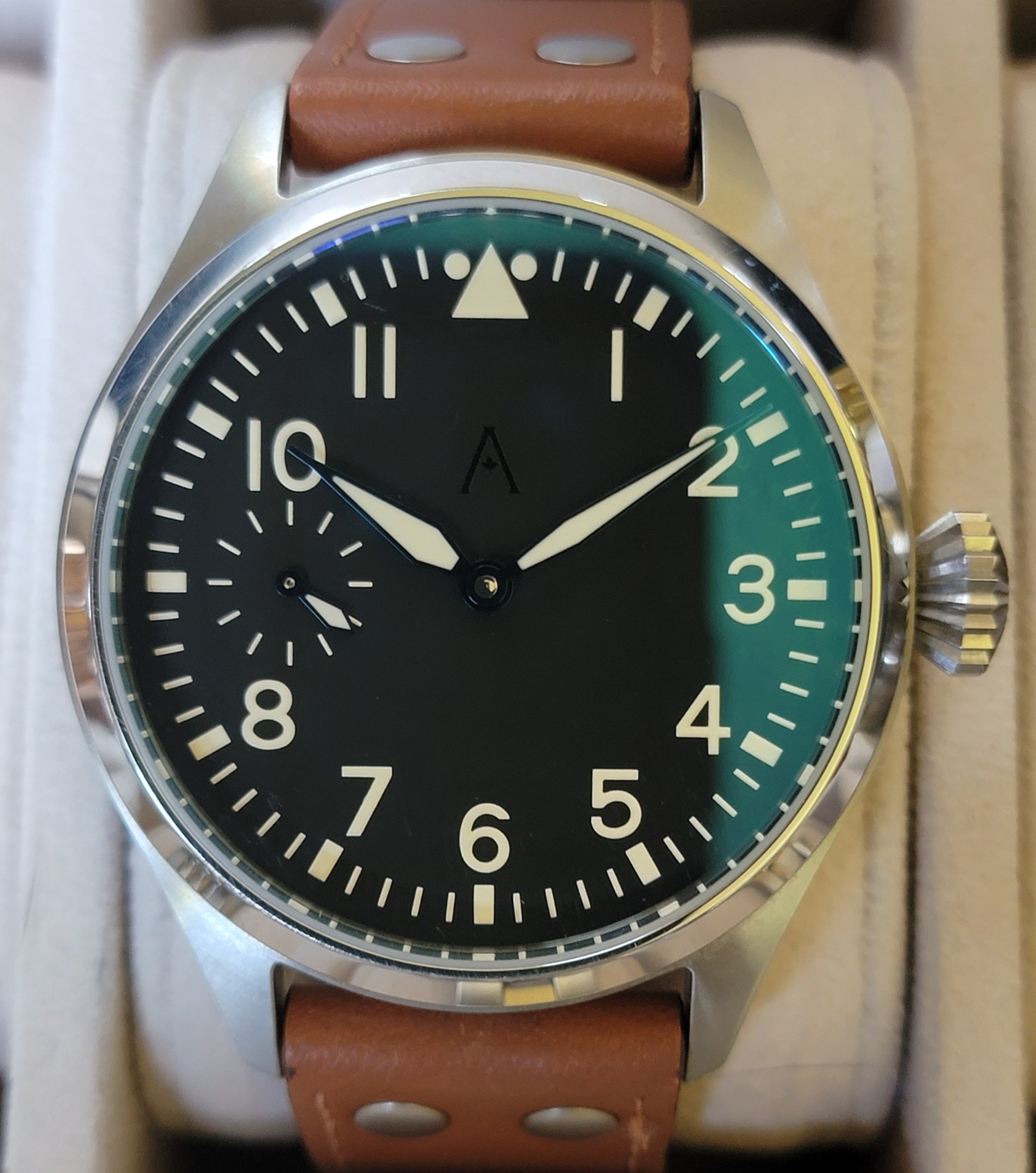

Archer used to sell watches. He made this great pilot watch using an ETA 6497. Before he sold the new watch, he dismantled the new movement, lubed it and poised it. Who does that?
