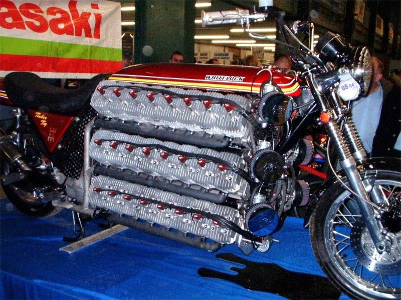

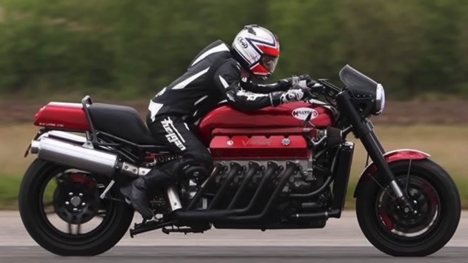

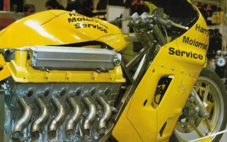

200 miles on an Africa Twin it gained 2 minutes 20 seconds. Gained time on a CRF250 Rally as well. So that covers 1, 2, 3 and 4 cylinder bikes. Anyone have a Goldwing so I can try a 6 cylinder engine?

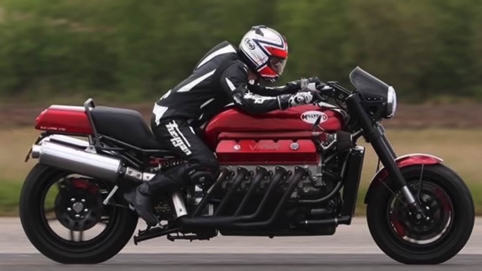

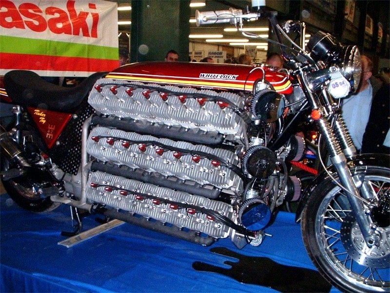

Go straight to this V10…..
cut out the middlemen…or for ultimate smoothness a V12
if you still have trouble then you need this….48 cylinders you’ll be to busy hanging on to give a shit about the damned time!

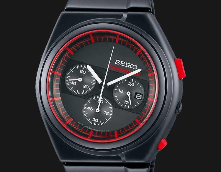

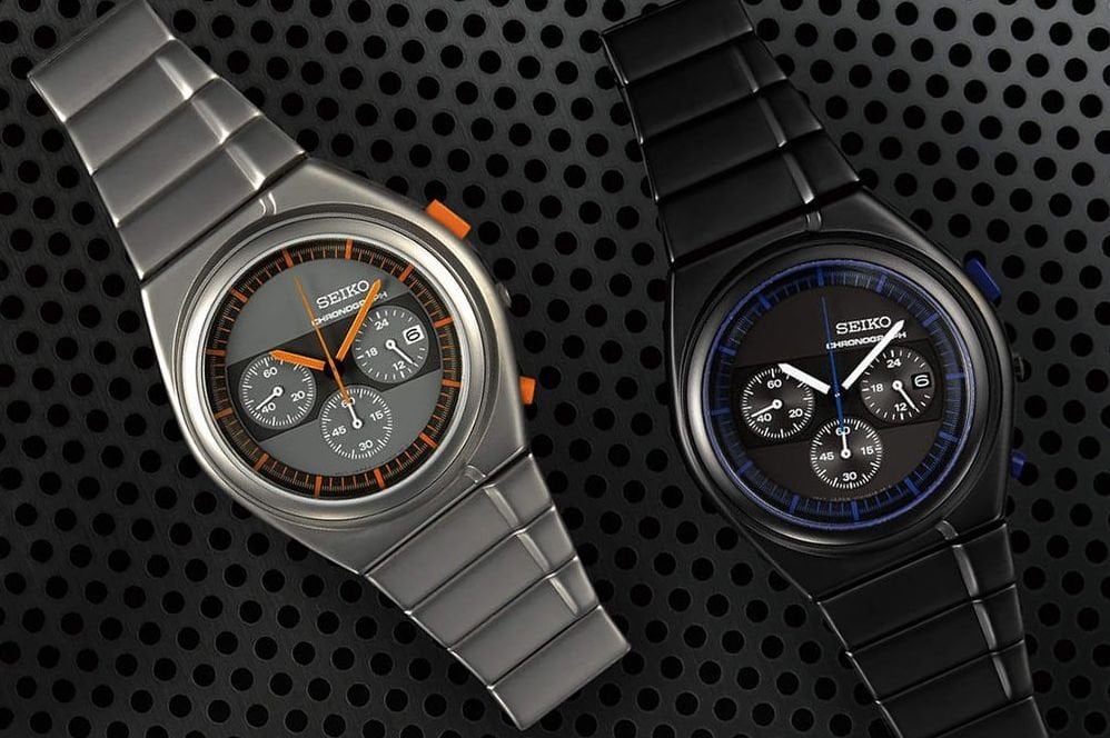

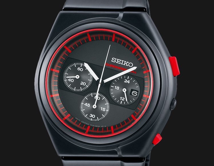

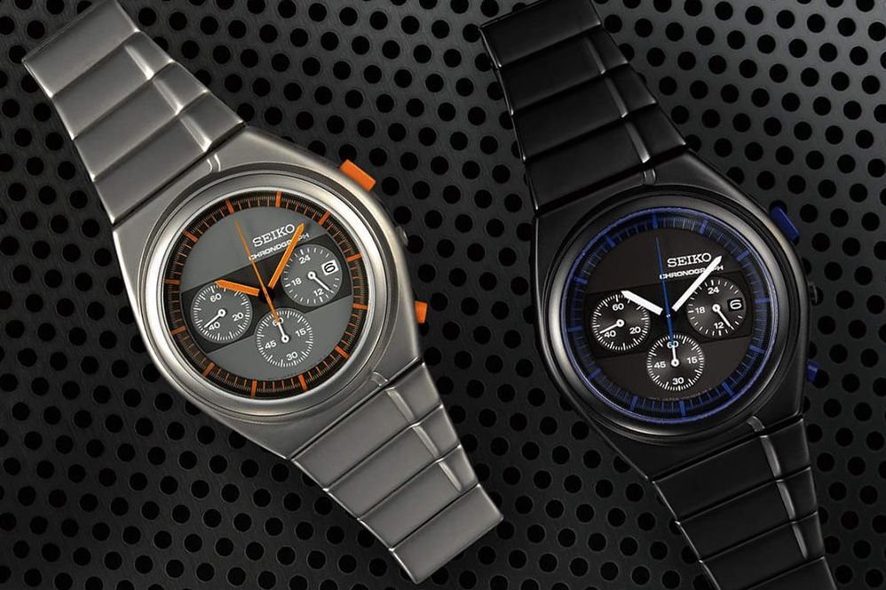

I remember Seiko made these especially for riding motorcycles years ago
obviously quartz so they shouldn’t gain time,
They also did digital versions with the same angled dial, but they’d be too hard to read quickly whilst riding

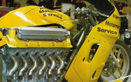

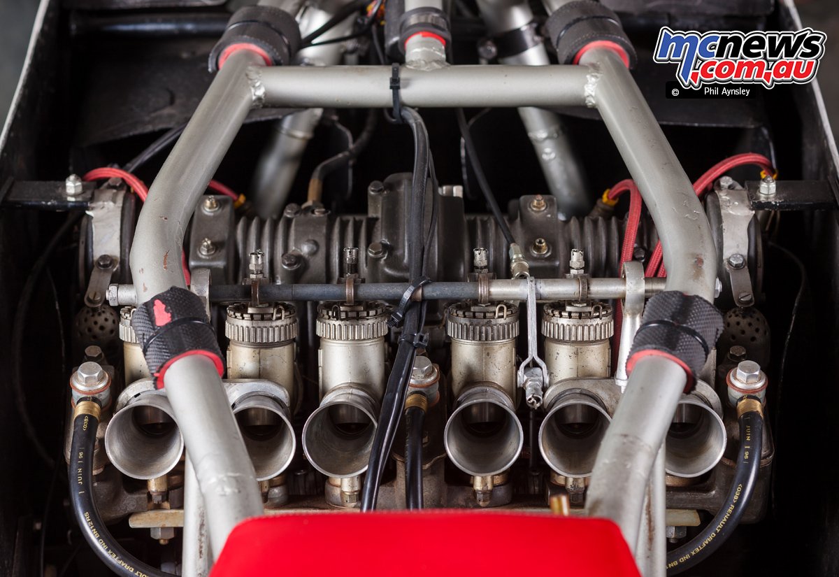

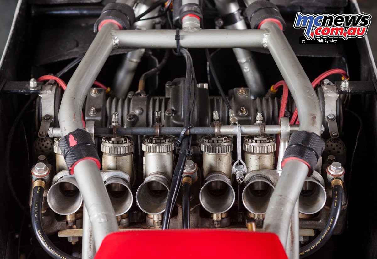

MV Augusta 500-6, that's the job!
