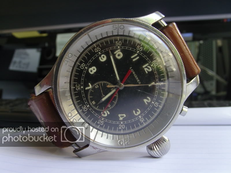

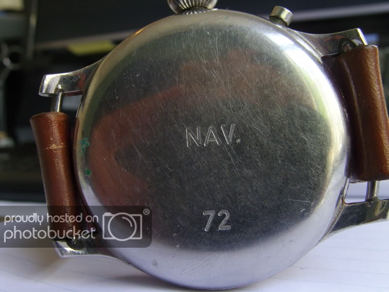

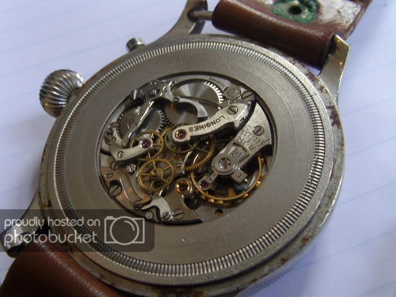

Sorry if a slight tangent, here is a Ref 3795 next to the 13Zn Ref 3721. Interesting for size and style comparisons, of military format pilot watches of the era.. Another original but wabii'd dial. This one is an issued piece, with the F5357

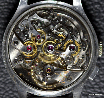

If anyone isn't familiar, this is a flyback military Chronostop made for many Airforces, Canadian Royal Airforce, Japanese Imperial Army, Israeli Defense Force, etc. 12.68z flyback monopusher. View attachment 732462

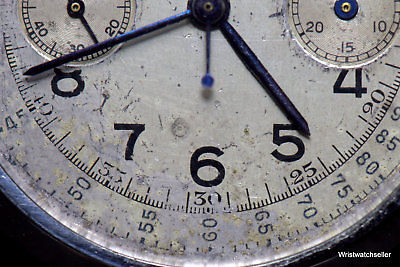

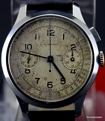

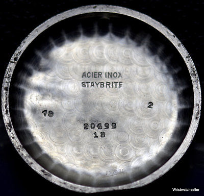

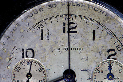

Interesting 13zn. 34mm steel case with tapered bezel. It was completely authenticated with a right subdial misaligned. It is too high and too far to the right. This is a counter-sunk dial.
1,525
4,430

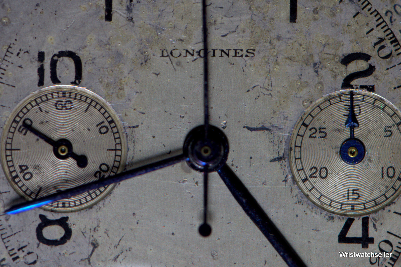

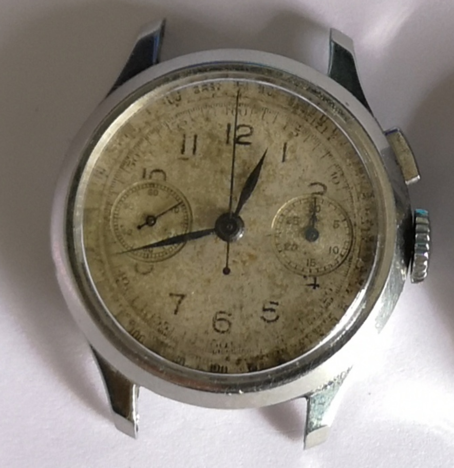

Another 34mm steel case tapered bezel and right sub-dial misaligned 13zn. The sub-dial looks too far to the right.

And only 3 movement serial numbers apart. Now with reinstated fixed bars.
10
34
Absolutely! Great catch Paul!
Well it's an ugly duckling Seiji , but I like quirky watches, so it fits in.
1,525
4,430
Original untampered 13zn steel monopusher...what's not to like?
1,525
4,430
It looks like a "military style" watch for sure! Monopusher 13zn don't come up often. Longines is often about rarity!
