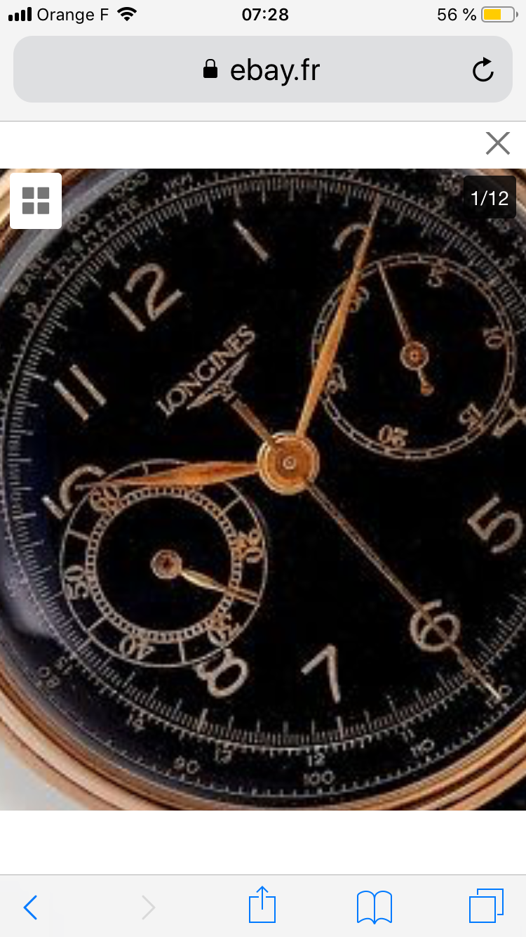

The serial number puts in in the early 40s. The print style is from the 50s. The logo does not look right. A redial.
Does the rounded 3's give it away?

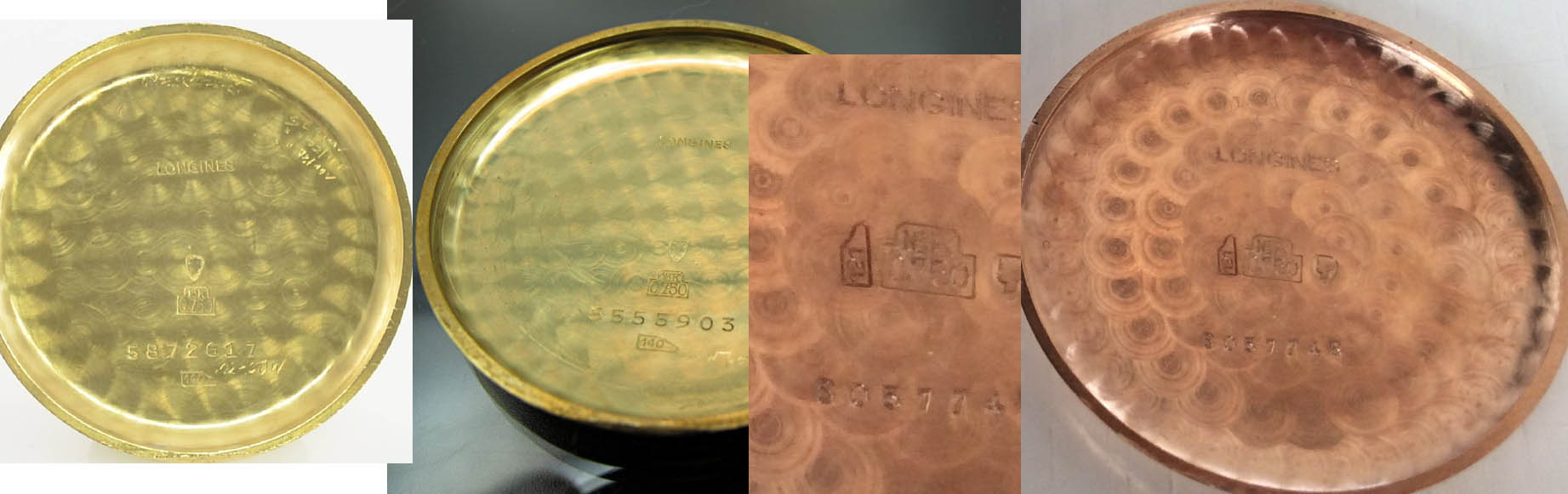

...and (to me) it don´t looks like a correct Longines case. The font on the inner caseback is wrong, the decoration as well. The cut/perlage (german "Wölkchenschliff") looks suspicious and not like other examples. The length of the h/m-hands is a further problem - too long.
242
272
I checked and there were many sandwich dials with this print style so I was incorrect in my statement. I guess I have never seen a sandwich dial from the 40s in that condition. The condition reminds me of 30CH chronograph dials from the 60s. Whatever lacquer they were using in the 40s has not survived well.
The logo is printed too large and looks wrong. The second track is also not correct.
+1 logo completely off.

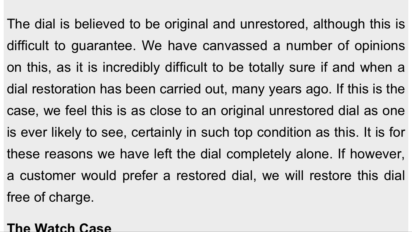

Are you suggesting that the watch is anything other than as described?
I think the description of the dial suggests quite a lot about the integrity of the seller.
Indeed suggests integrity completely lacking.
Agreed. To my eyes, the "Longines" marking looks very suspicious. Also, the style of the case looks more typical of the late 1940's and not circa 1941.

This redial is as unmistakable as they come. To describe this dial as "Original" and "Unrestored", shows an utter lack of expertise. I would expect someone with integrity, and without expertise, to either consult a specialist or refrain from claiming whether a dial is original or not. It is evident that a specialist was not consulted and yet an affirmative claim, regarding originality, was made. My conclusion is the same as @Syrte's.

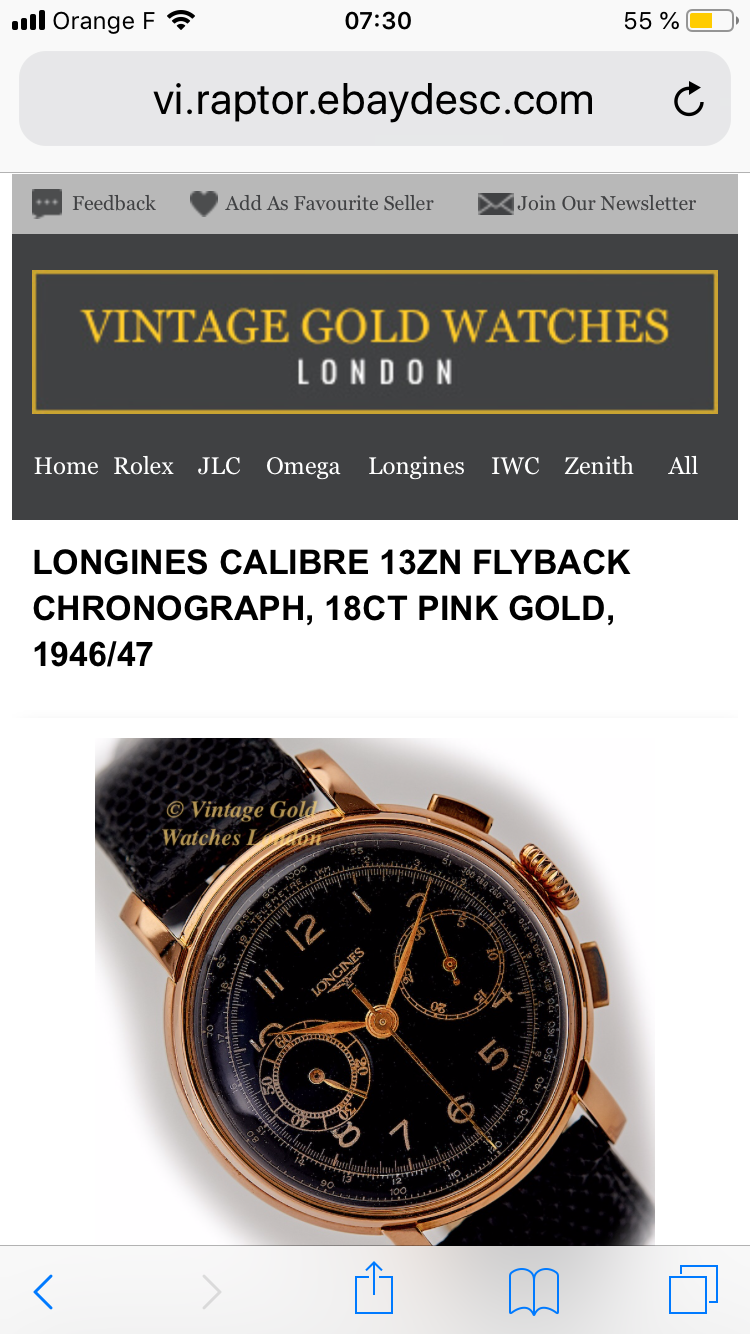

I suppose that I found the "it may well be a redial, but we don't believe so based upon input received of others," approach to be a fair warning. I simply would not know how to tell one way or the other. Some here suggest "buy the seller" when looking for a vintage watch and in the interest of full disclosure I have purchased a JLC watch from the seller and found them to be pleasant to deal with. "Pleasant to deal with" doesn't say anything about the authenticity of the the offers however. Note that they do offer an authenticity guarantee.
I am new to the hobby. (Under two years of avid reading and some half-dozen purchases.)
I generally word my posts in such a way that the responses may invite insights from the more experienced. The watch looks like a fine watch.
Can you share how it is you recognize it as a redial?

I linked to the seller's page. The listing will likely persist after the watch is sold as in the case for the one I purchased some time ago:
https://www.vintagegoldwatches.com/...-18k-pink-gold-1963-original-unrestored-dial/

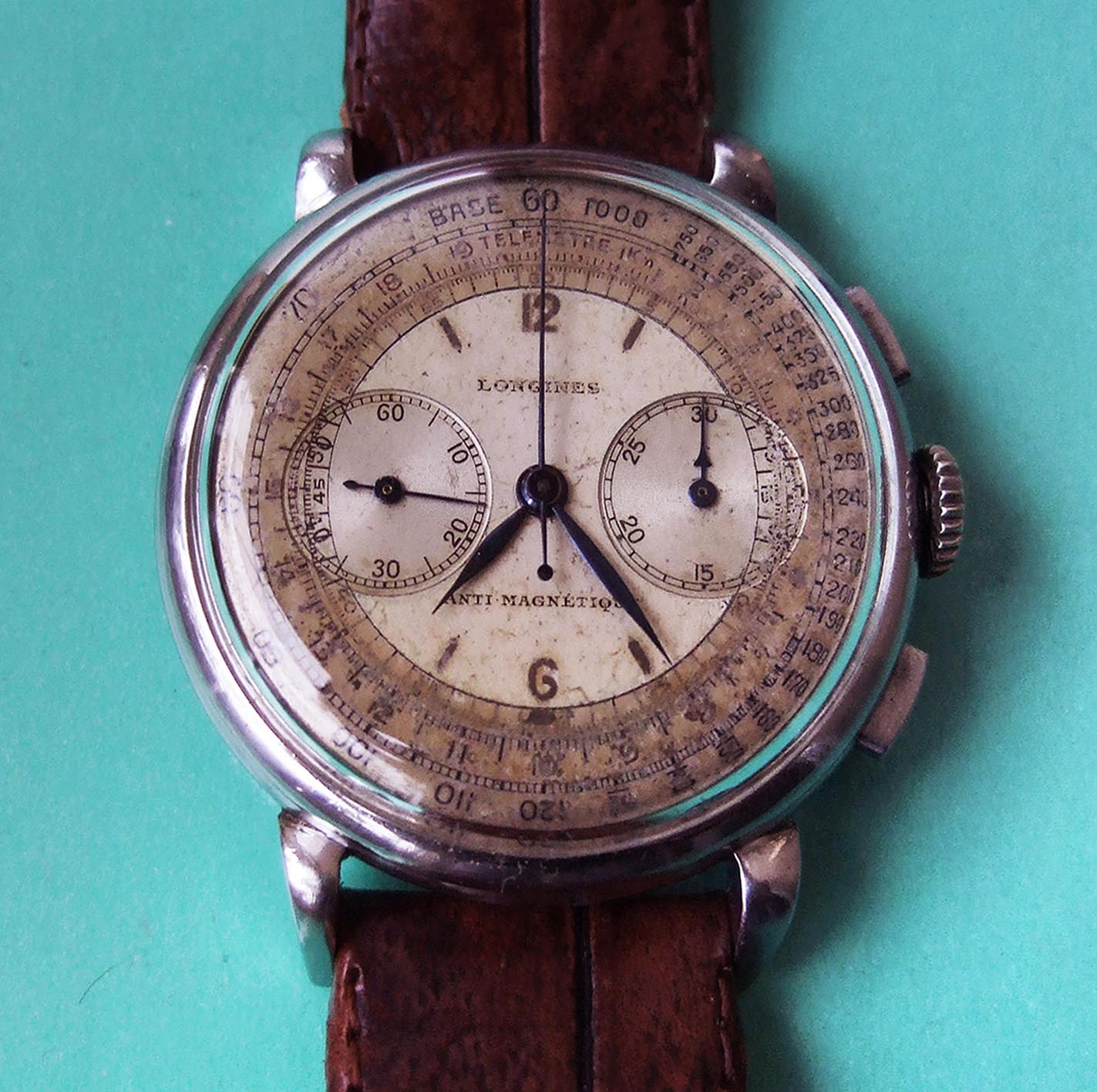

Here´s a correct dial and hands combination. The minute hand points on the minute scale, the hour hand reaches just the inner end of the hour markers. I believe that´s the usual design of "classic" chrono dials.
Otherwise it is not a reliable sign for a redial if hands and dial are not matching. But the watch should be assembled from parts that don´t belong together.
