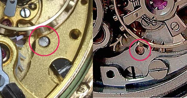

Looks nice. Typical french cased later 13ZN, movement number seems correct (Longines will answer an inquiry via email) - no issues except the silvered dial foot. maybe no problem, because the dial looks unrestored.

Usually 13ZN dial feet are coppered and a silvered foot is a sign for a redial. Yours seems to be one of the relatively rare exceptions.

Aha. thanks for that. To my knowledge it has never been redialed, but no doubt Longines would be able to confirm this and any date that it might have been done? I will keep you posted as and when I hear from them to definitively confirm.

I´m 95% sure, that your dial is fine and not refinished. I believe that other members of the Omega Forums are much more reliable than Longines in judging your dial. Wait a little bit and they will write something about it...

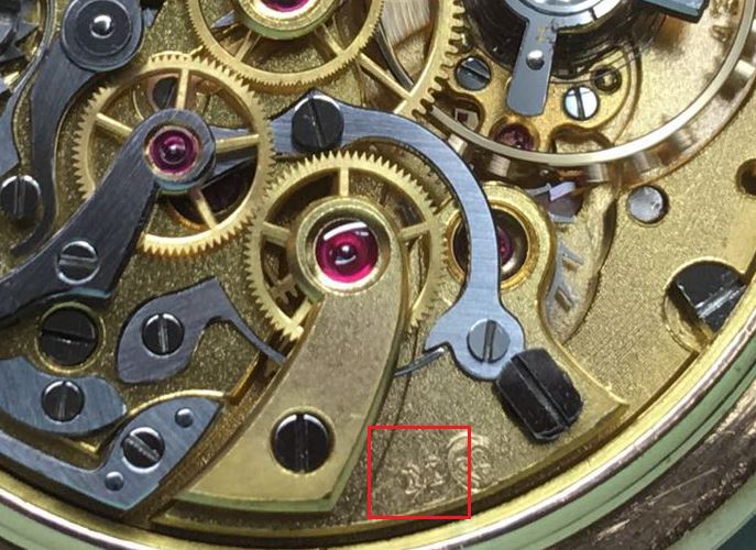

After only viewing the image of the dial, I had not doubts that it was original. The white foot is intriguing but the obverse displays nothing that suggests restoration/alteration. "Fab. Suisse" matches with the French case and "M" on the movement, which can be seen on watches that were bound for France. What is odd is that the letter is "M" (metal) and not "O" (or = gold), as these letters refer to the case material. I wonder if the watch was originally cased in stainless steel.

Wow! The serial number also suggests a production date of 1946. Maybe it is possible that it was shipped to France in a steel case and then placed into a gold case, prior to being sold. It will be neat to see what the archive says. I am also curious about the marking beside the "M". Quite an heirloom!

Yes...I would be heartbroken to ever lose it or break it! Where is the M that you mention? - sorry...this is new for me so was trying to see where that was on the photo that was taken of the movement.... I will certainly confirm what Longines says once they respond...If nothing else as a useful archive on this forum of a watch with a history that is completely known.

hmm...or maybe the watch shop read off the serial number incorrectly when they looked at it yesterday. Damned difficult to read and I couldn't photograph clearly with no lighting, no tripod and a shaky hand..... The photo I uploaded was taken a few weeks back, but Longines couldn't read the last few digits as they were obscured by movement so asked me to retake.... had to go back to shop to get caseback taken off and then a kind elderly gentleman read off the digits on the movement for me...
