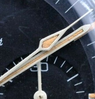

I agree about dial and hands lume
I state that spheres and dial are relumed for me.
As for transitional references produced for a short time such as 105002 I would not be so categorical.
Having said that, I believe that the Alpha hands are a continuity with the CKs that characterize this reference. If I had to take one, I would certainly like it with the Alpha hands, but these are personal tastes.
1,560
4,421
Dial markers are uneven, thus relumed I would say, and the color is not a color often seen on these refs...
However, when dial / hands color matches, it could just be that the hands only were relumed.

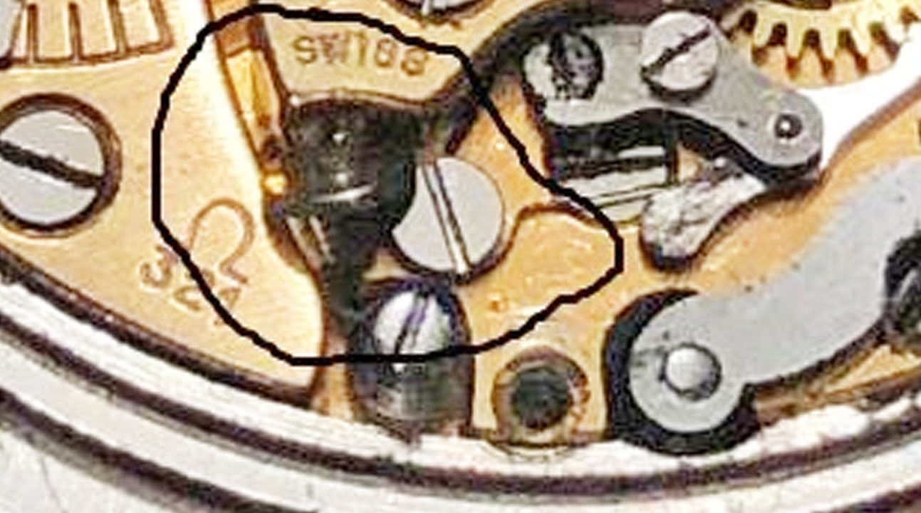

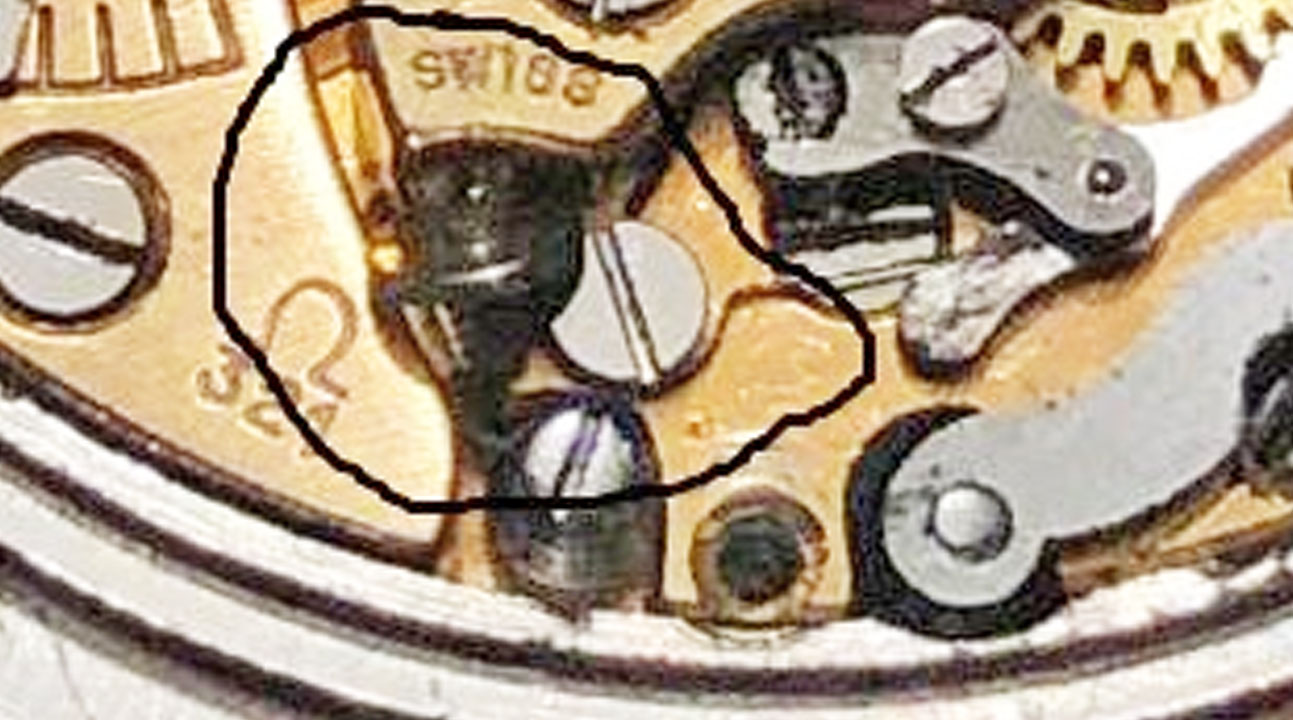

BTW, what is that???
I think that is just a very sharp shadow being cast by the light at the upper area and it makes it look as if there is something on top of the screw.

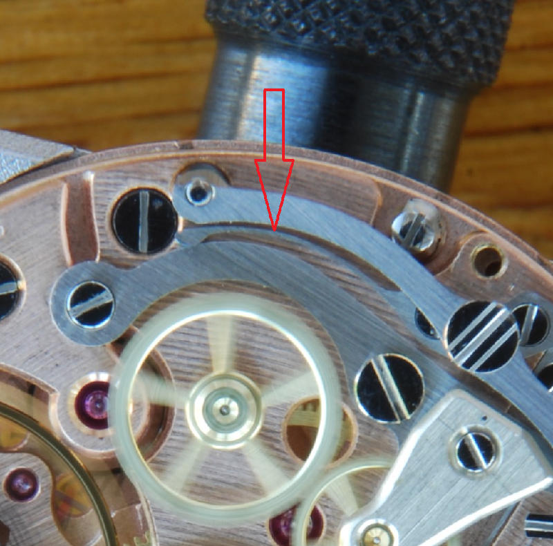

In addition to what @Passover has said, the spring that controls the operating lever and coupling yoke appears to be broken and sitting in the movement. This is how the spring should look and without this, the chronograph won't work.
Oh and owner says chrono function not working but the rest is running fine... so, cost of a service will have to be added...
In general, the movement looks tired and with some corrosion so I'd allow a lot more than a typical service when parts are included - say two times. You often find that where there is some corrosion on the rear of the movement, the parts under the dial have suffered even worse especially the keyless works that are directly connected to the crown.
Good luck, Chris

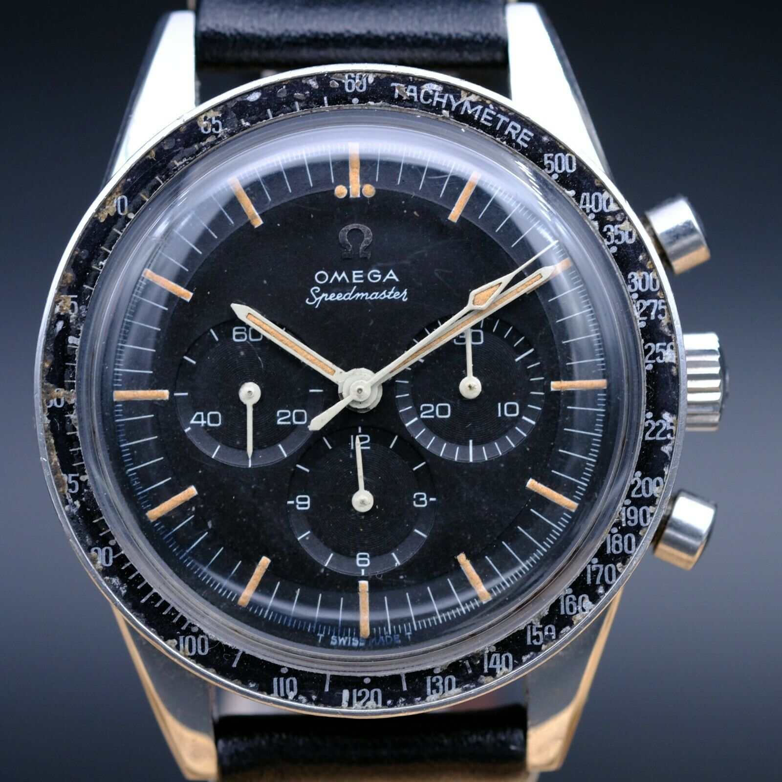

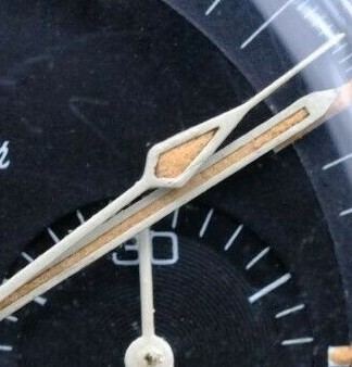

Thanks all-- appreciate all the input. FWIW, the seller has not been misleading about any of the details. It is what it is and he admits as much. Just FYI in case anyone should come across it in their travels....
For my own education, I would love to hear more about how how people go about judging original lume vs. relume. For instance, does this look like a relume? if so, why?
1,565
3,678
This one looks not relumed to me. Hard to tell why actually. Guts feeling 🤔.
Maybe relumed dials/hands look too perfect in terms of color homogeneity and texture. When I see some tiny discolorations, this could make me think of original lume. Furthermore, sometimes, the dial itself is damaged dur to old lume scratching by matchmakers. You can see marks around the plots resulting from the removal.
Finally, the lume texture itself is very perculiar as well. On old lume, it's a bit sandy (NB: not the case for 90's tritium dials).

I guess I might be a little suspicious of the lume on that last example. The color matches so well and it's such a desirable color. Also, the lume on the dial doesn't seem to show any indication of the underlying step.

The lume texture on the hands look quite strange to me, also a gut feeling.

Could it be the lume on the hands was re-done to match the face...? There is a bit of "dirtiness" in the 11 oclock marker, perhaps making a case for originality....
24,843
55,270
Yes that is possible of course, which is why UV photos can be helpful. And to be fair, now that I've looked more closely, I can see evidence of the step through the lume on several of the markers.

Hands seem repainted
I don't know that:
Is it possible to just repaint the hands without affecting the lume?
This one, to me, looks relumed. I have rarely seen a similar shade of orange / dark yellow on e tritium speedmaster, most one owner watches I've seen looked lighter in colour. Also, texture of the hands and the dial look similar, which was never the case, so I'd think they were both relumed by the same person. But pics are not high res, so its just my opinion..

Regarding the pic above: in my opinion, assuming the bezel is original to the watch, then its a bit beaten up, whereas the dial lume looks immaculate. Looks incongruous therefore screams relume to me. Hand lume is perfect colour match which is rarely the case. All in all, dial lume and hand lume look too clean.

My advice: with regards to cosmetics, buy the book Moonwatchonly and make your own opinion. If you start asking questions about lume on forums, unless it is poorly made, you’ll get all sorts of BS answers. Some watchmakers are able to relume dials in really perfect manners, so half of forum members will tell you it’s relumed and the other will say it’s not. The fact is they probably don’t have a clue or at best don’t know for sure, that’s all. For all other cosmetic questions about the dial, hands and bezels, the book is perfect. But besides all, trust your own judgement and stop scratching your head for a stupid dot above or close to 90. This is irrelevant. The only advice you should seek here is on the movement/caliber because it is far more important and because it requires a knowledge that is much more difficult to earn. Good day.
that reference is known for a certain lume application, texture and this one also has a certain desirable Rolexish color that might bring you more money but not very common to original pieces. Hands are a dead match which is uncommon. Like @harrymai86 said go with your gut

I think the balance too is wrong. It seems a new replacement.
