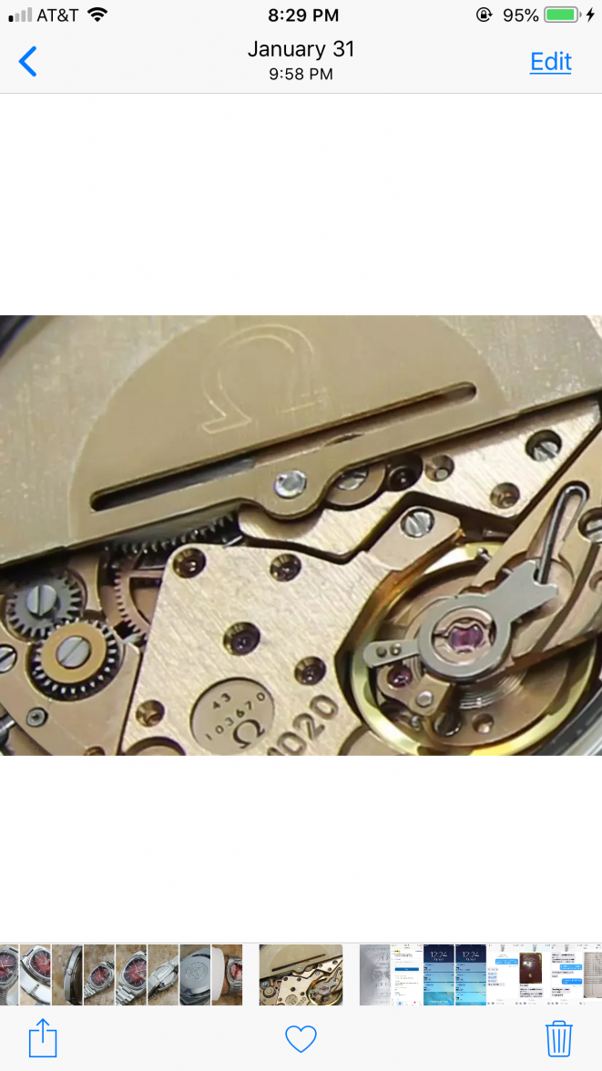

completely restored piece runs spot on in timegrapher when manually wound. Will not auto wind on wrist, two diff types of winders! Rotor moves freely with back off and no marks on inside of back. Why won’t it auto wind?

I bought it as totally restored from a watchmaker I’ve bought a dozen pieces from. I sent it back once and it returned after 2 months exactly the same issue. He’s out of the country so shipping is a customs pita. I do some services on low beat 56x but don’t play with any of omega hi beat pieces. Winds fine manually just not on wrist or winder. I have several watches with same movement so I suppose I could swap out the automatic sections and see if problem follows the parts or not

It seems you're comfortable with taking the back off and even some movement work so:
With the back off hold the watch upright with the rotor weight at the lower - let's say at 12 O'Clock high. Slowly rotate the watch in each direction and watch the rotor. It should stay basically still as the case rotates so, it's always hanging straight down. That's the first basic test to see if the rotor is free and the auto wind is not catching. Does it pass that?
Do this test with the watch let down (no charge in the mainspring) and then wind it a dozen turns of the crown and try again. When there is some charge in the mainspring, it may not be as free.

A NOT completely restored piece, sounds like. Two options. Take it somewhere and get someone to fix it, or return it to the guy who supposedly fixed it. On this movement, the ratchet wheel fits beneath the wheel that drives it. Someone who is not familiar with this movement might well have positioned the auto wind unit so that the ratchet wheel is ON TOP of the gear that drives it, and buttoned it down. Worth a look.

Nope the rotor doesn’t stay at the bottom it turns with the watch unless I move it.
You are now looking at dismantling parts.

I took the rotor off, center bearing, auto bridge and just took a tiny bit off the two screws that hold the auto wks together. If this doesn’t wk I’ll strip clean and reassemble it. I was mindful to slip the gear inbeteeen the others when putting the bridge back on. The rotor seems to be free now . I’ll give it a try before taking the gears apart

Yup I think he has a lot of these done in s Korea . It’s just a tad off if I shake the case just a bit rotor moved around. Sometimes even without now. There’s some resistance and it could be in any of those gears or pivots . I think the auto works will need to be stripped and cleaned. Must have a piece of lint or dirt someplace .
