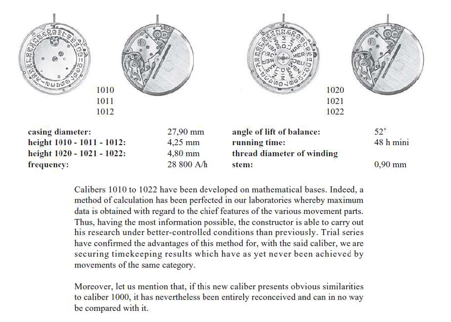

The 1010 to 1022 are not the same as the 1000 series (which have a poor reputation and partly justified) - here from an Omega document:

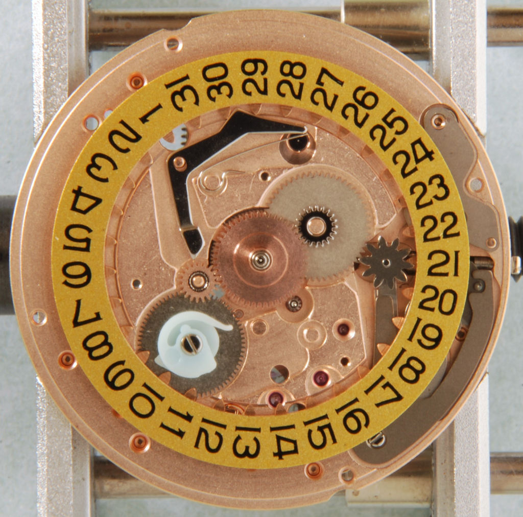

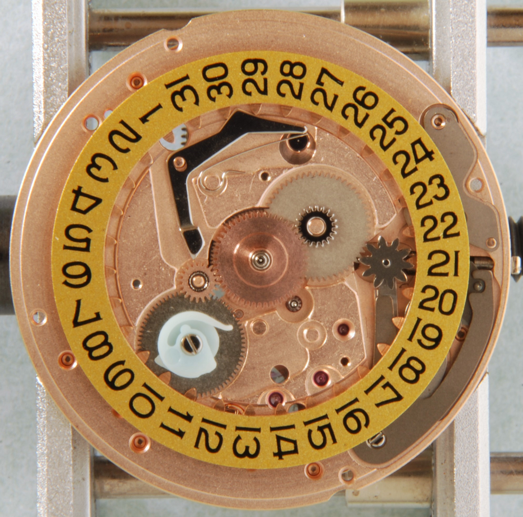

On any design with a day and/or date complication there are always quite a few gears under the dial side. This is a 1020 part way through fitting the dial side parts (and yes, you can see some plastic there but, I wouldn't worry about that)
If you have a quickset on any calibre with a day and/or date complication, then only use the quickset after putting the hands in the lower side of the dial (e.g. 6:30) as that way, all these little gears are not trying to change the day or date while you are trying to quickset. If you do that, then I wouldn't be concerned, although, as @ConElPueblo says, don't leave them too long between services. This applies to any calibre and is just a good thing to do - some calibres are very fragile in this area and will give problems if abused.

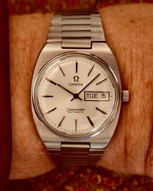

I have a model 1020. An excellent performer. Looks like the same case references yours.

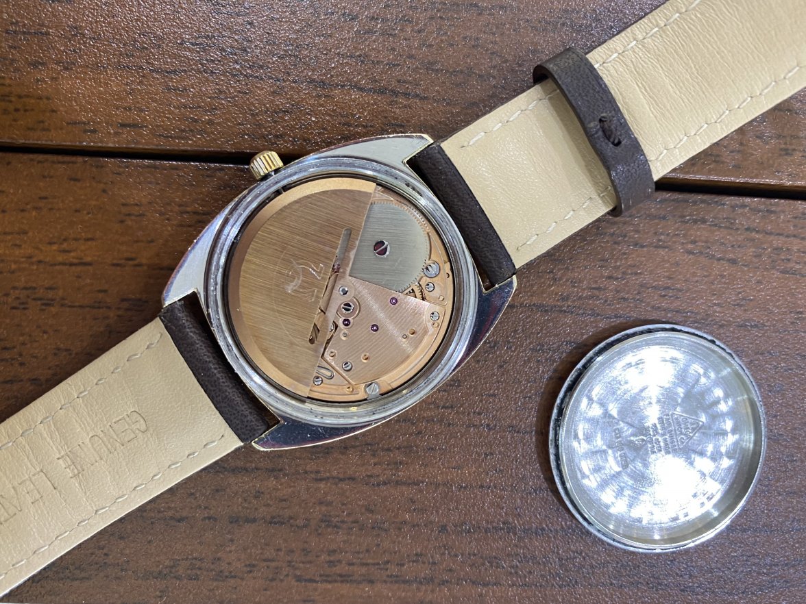

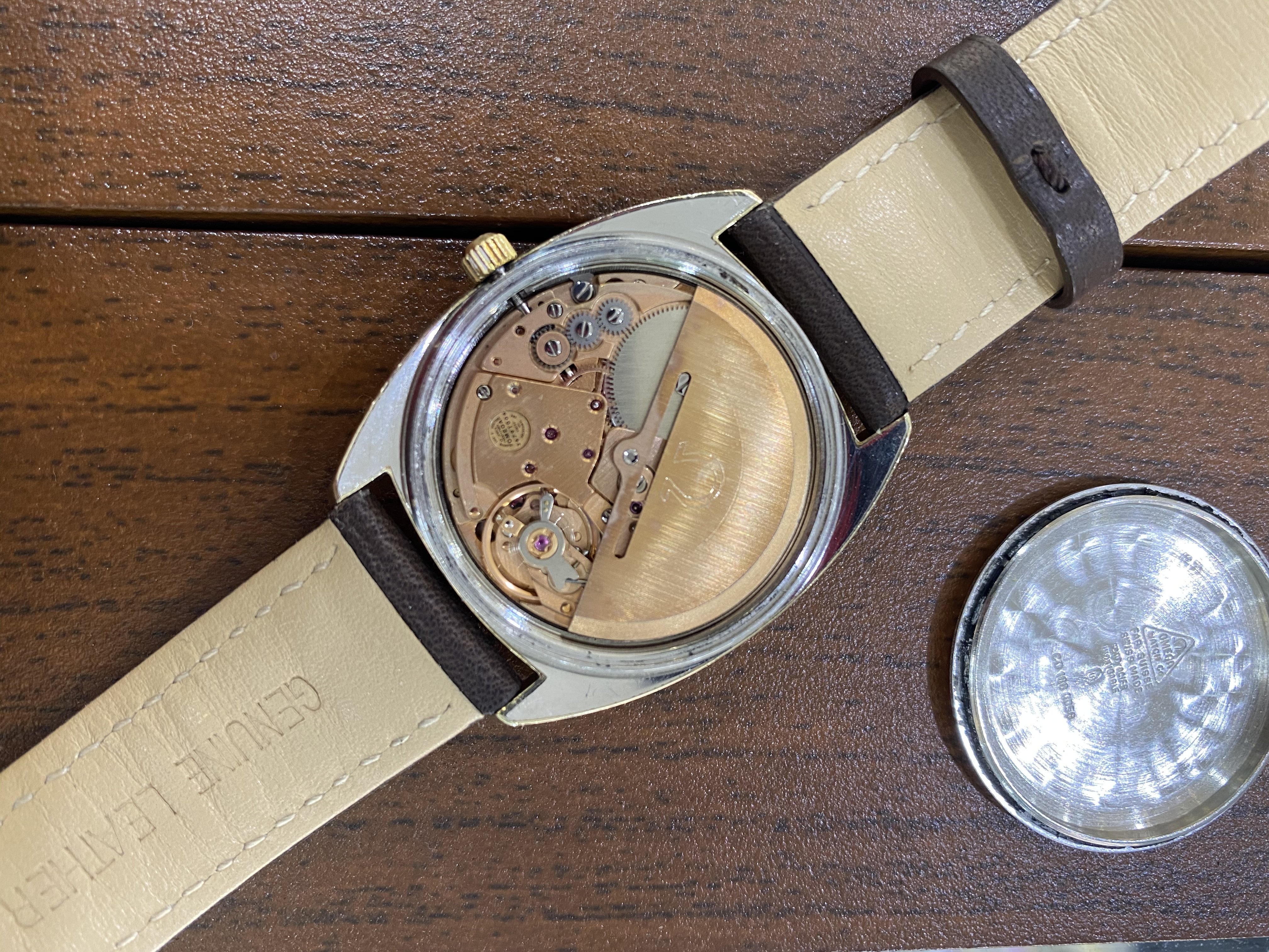

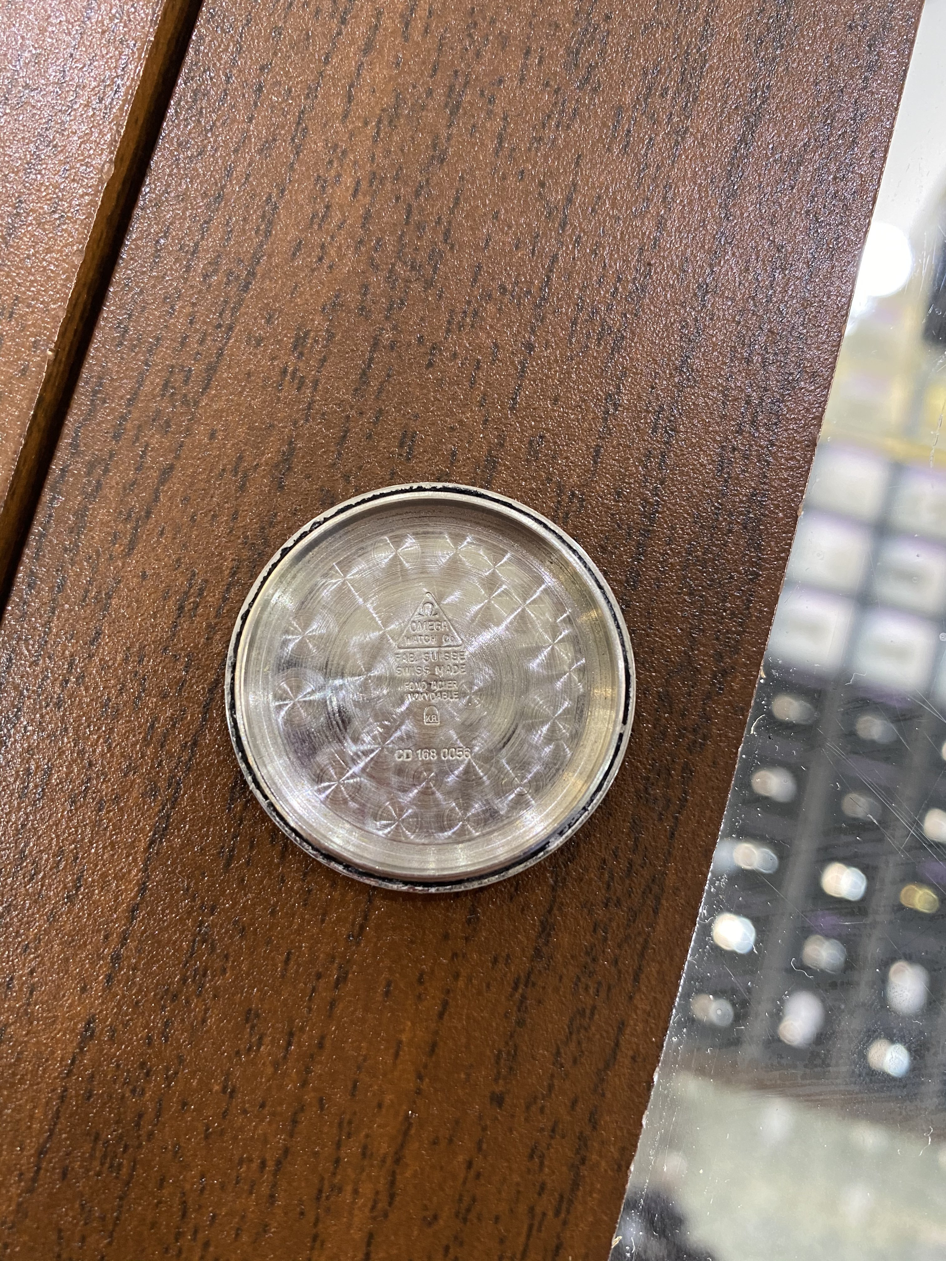

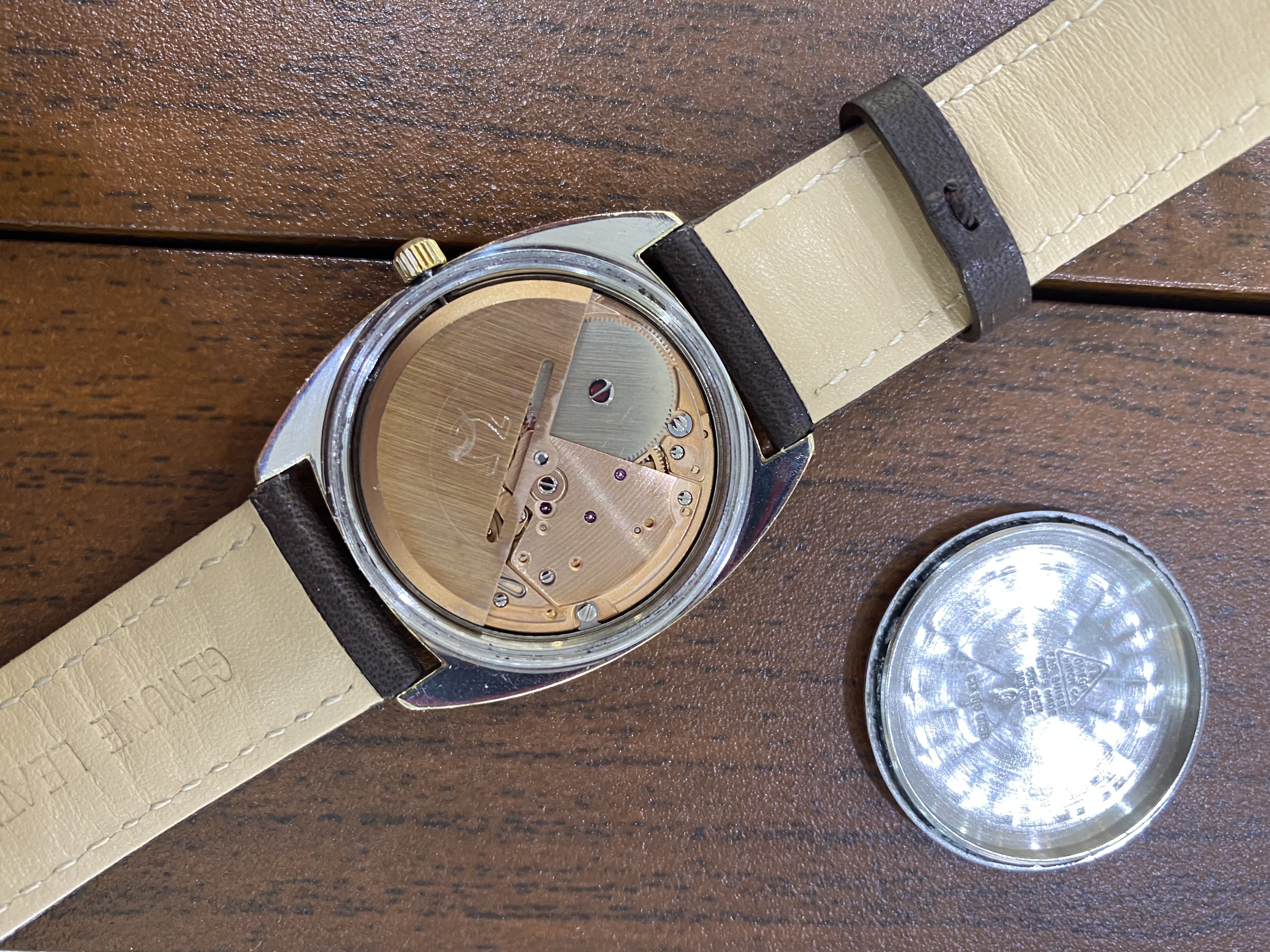

Here is a photo of my movement. It took 2 people to remove the caseback. It was on there to stay.

I really appreciate your feedback. Upon having this watch opened by my watchsmith, he stated that from appearances it looks to have been taken care of. There is a slight scuff mark from where the rotor has traveled and he claimed this was due to it needing a service as the rotor shifted over time. He believes this is not happening now and the issue was rectified last time it was serviced. He replaced the caseback seal as this one was destroyed from having the caseback on so tight. I mean tight is good but it took both of us to get it off so......
I think this one will be a keeper. I’m chuffed and it holds time at about +3 ish secs a day. The rotor is damn near silent and free moving and the overall condition is pretty good for its age.
