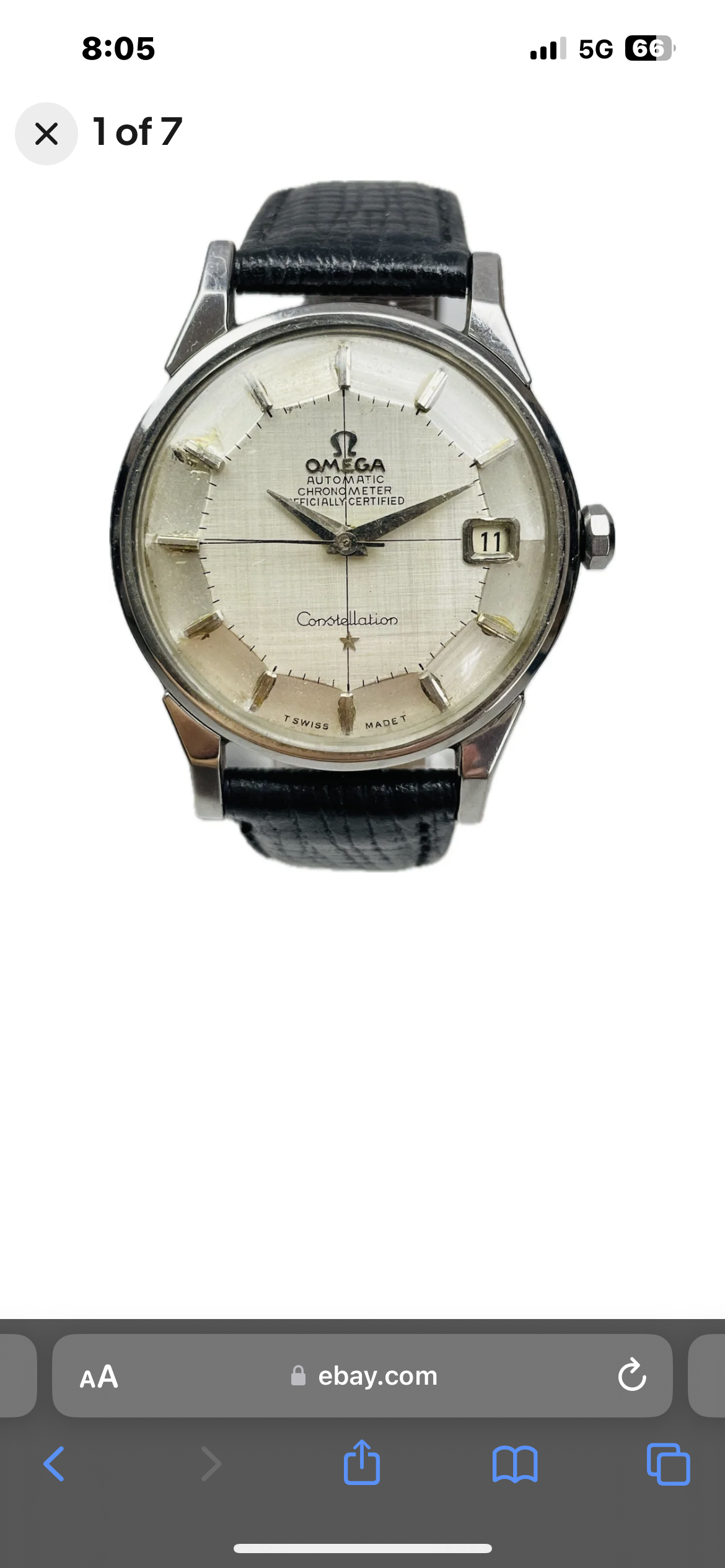

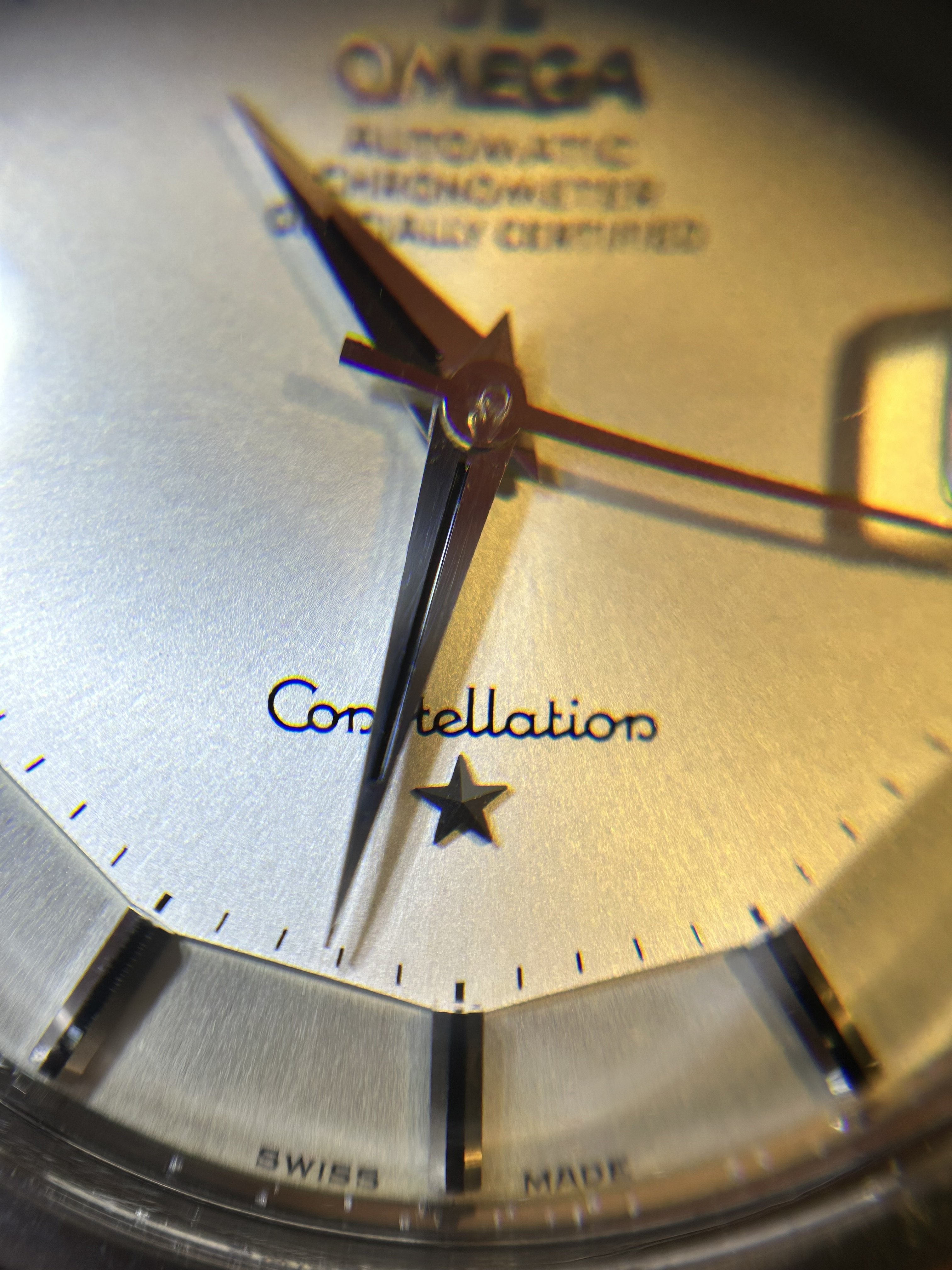

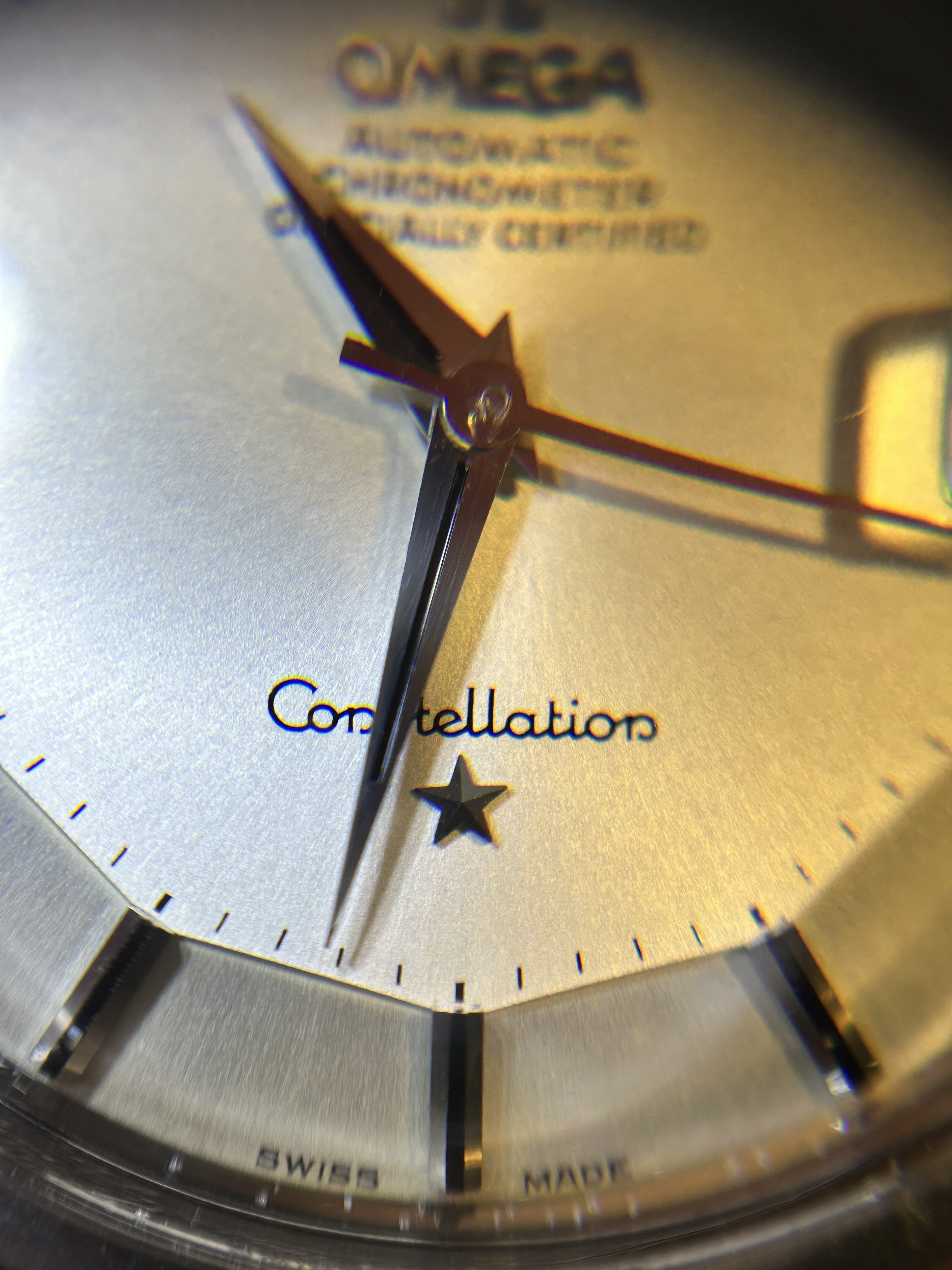

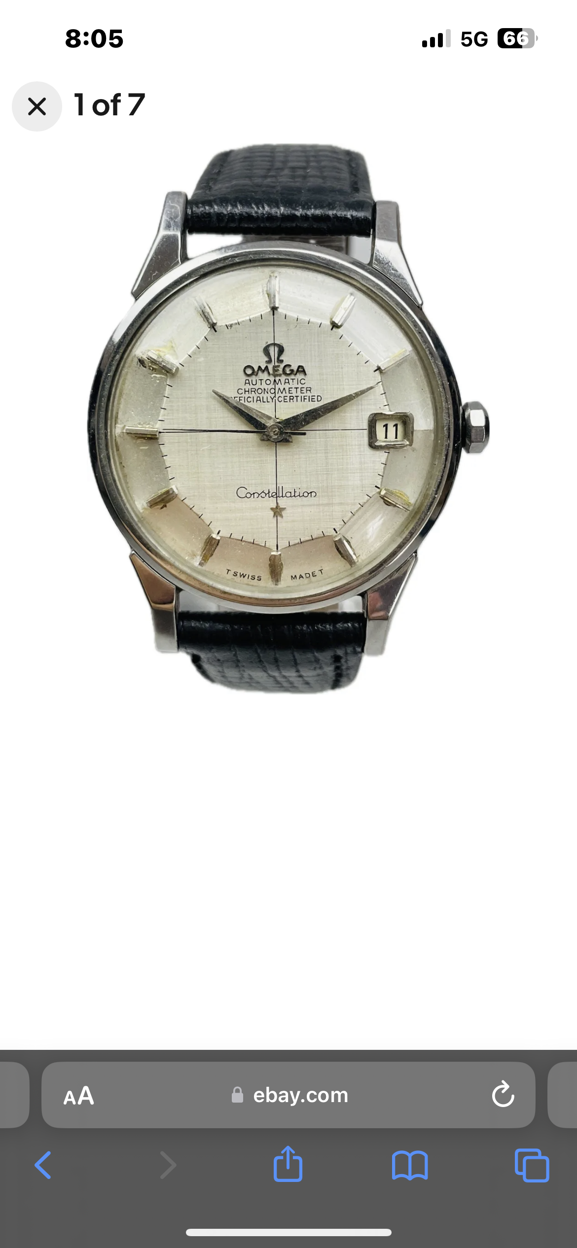

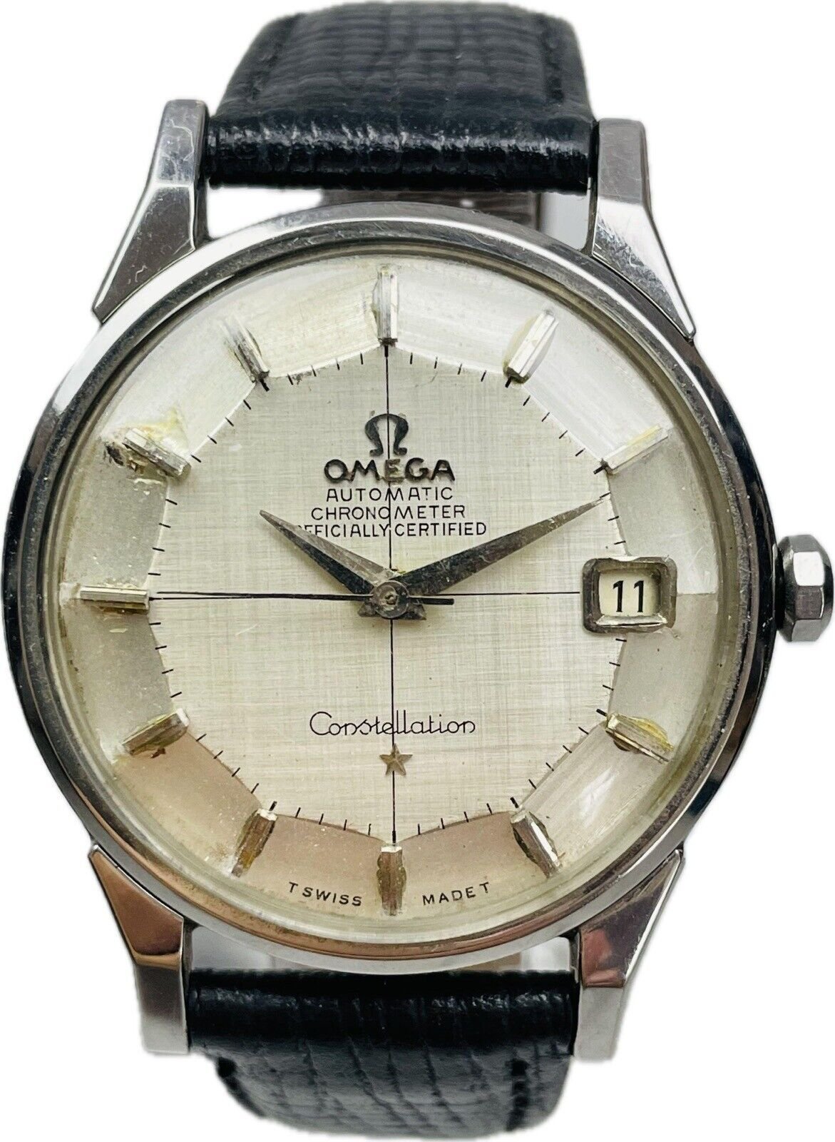

10 minutes on this auction for pie pan - is this a redial?
787
6,747

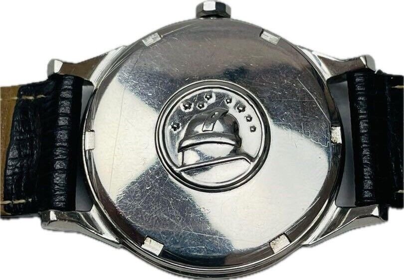

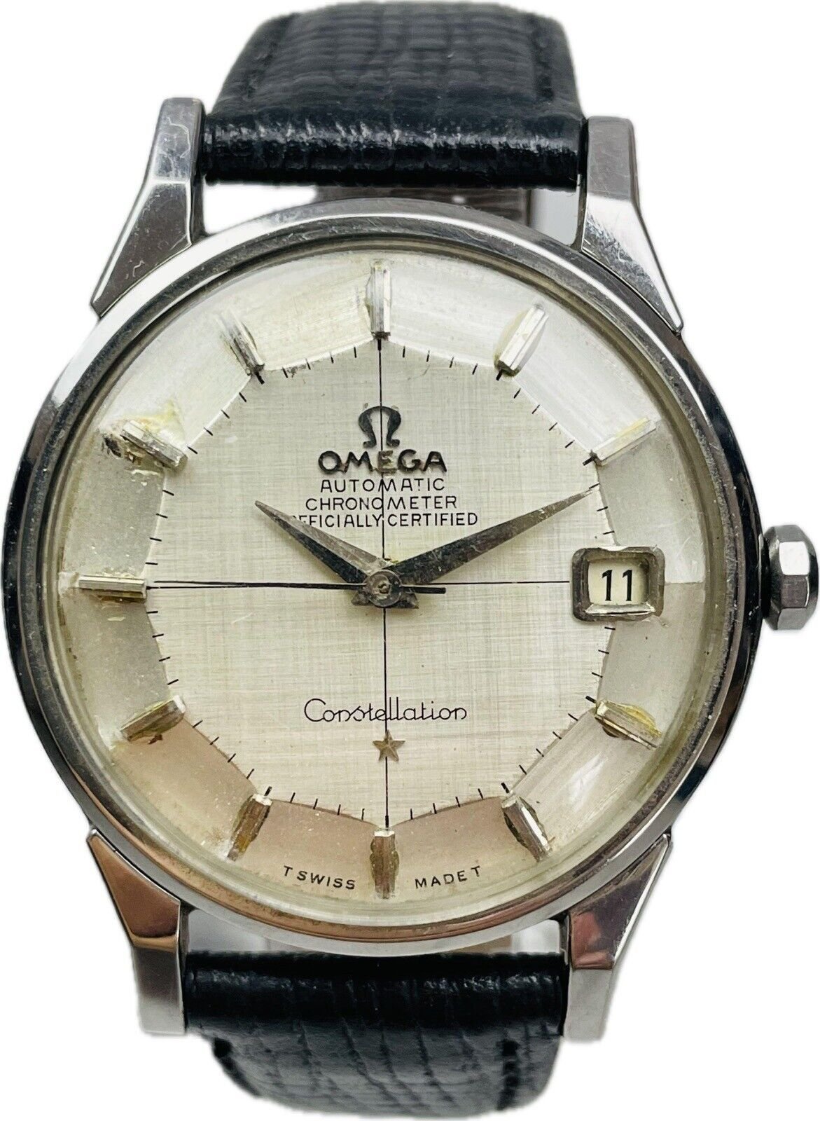

Oh God. My eyes. There's so much wrong with this watch. Some of the obvious ones.

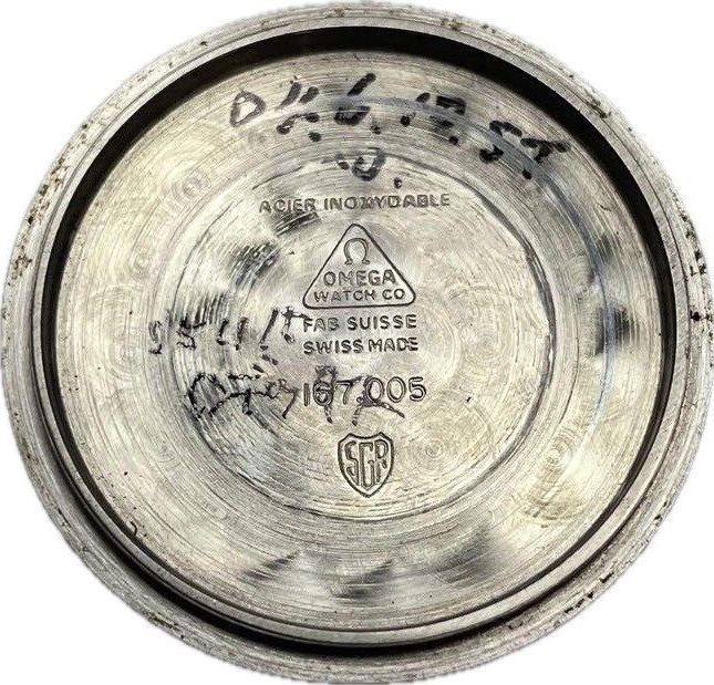

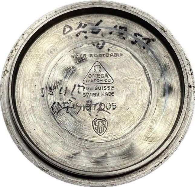

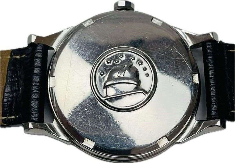

1. Caseback says 167.005, which is a non-date reference. This one has a date complication.
2. T Swiss Made T but there's no lume.

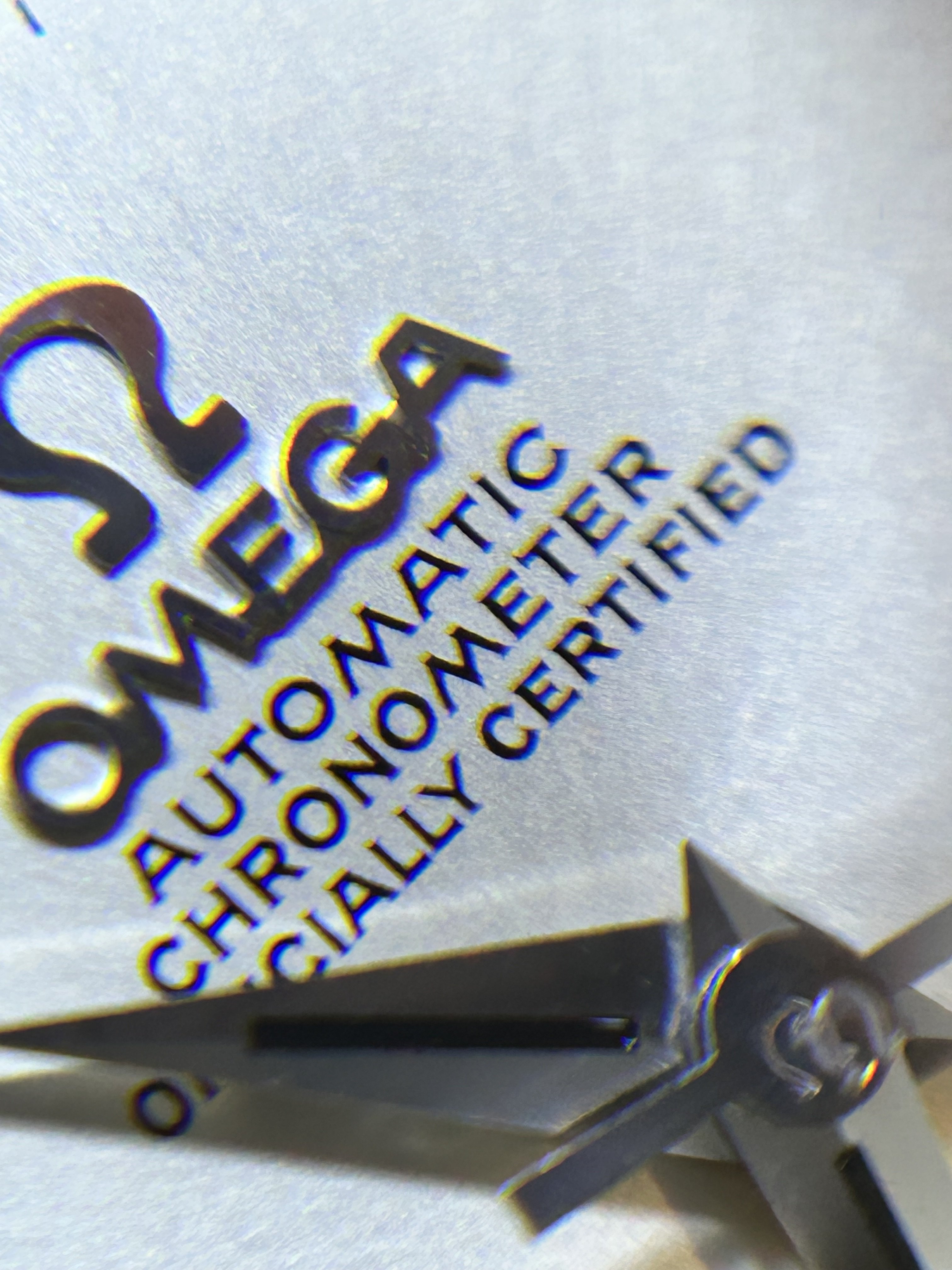

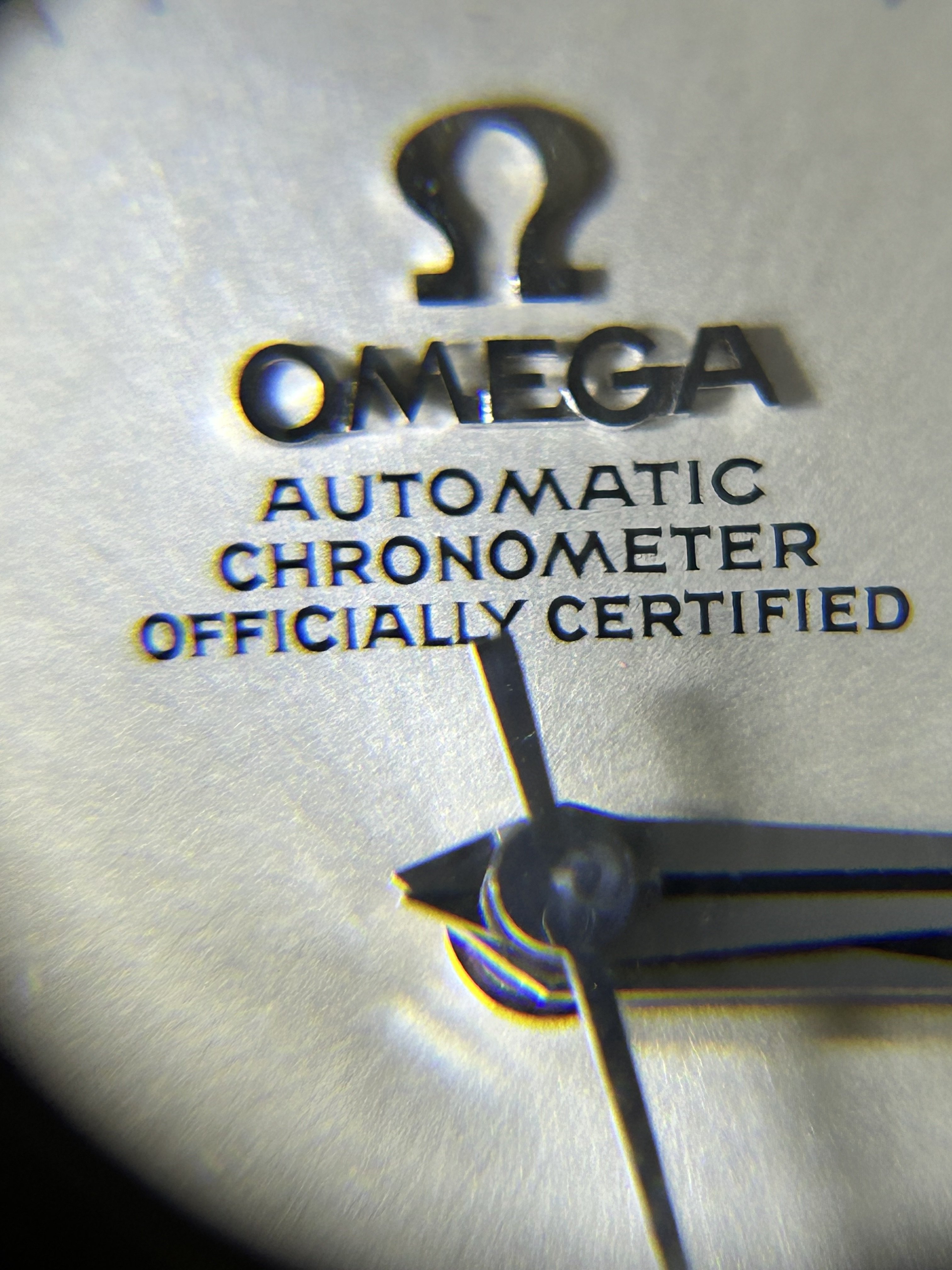

3. What's all that stuff around the minute markers and aplied Omega? Did some glue them in?
4. Font is wrong. Pretty sure it's a redial.
I should stop but that movement doesn't look right either.
So many red flags.
13,492
31,811
Fake dial and fake case.
Complete shit, someone got screwed badly!
13,674
19,043
Chinese made fake case and dial.
Cal. 562 movement is wrong also.
gatorcpa
13,674
19,043
No one got screwed. There were 70 bids, the majority of which were zero or one feedback.
All shill bids, I’m willing to bet.
gatorcpa
122
188
Thank you all. I greatly appreciate it. I didn’t bid thankfully, it just didn’t look right but all of your comments give me specifics. Always learning bevause of all of you, so thank you!
