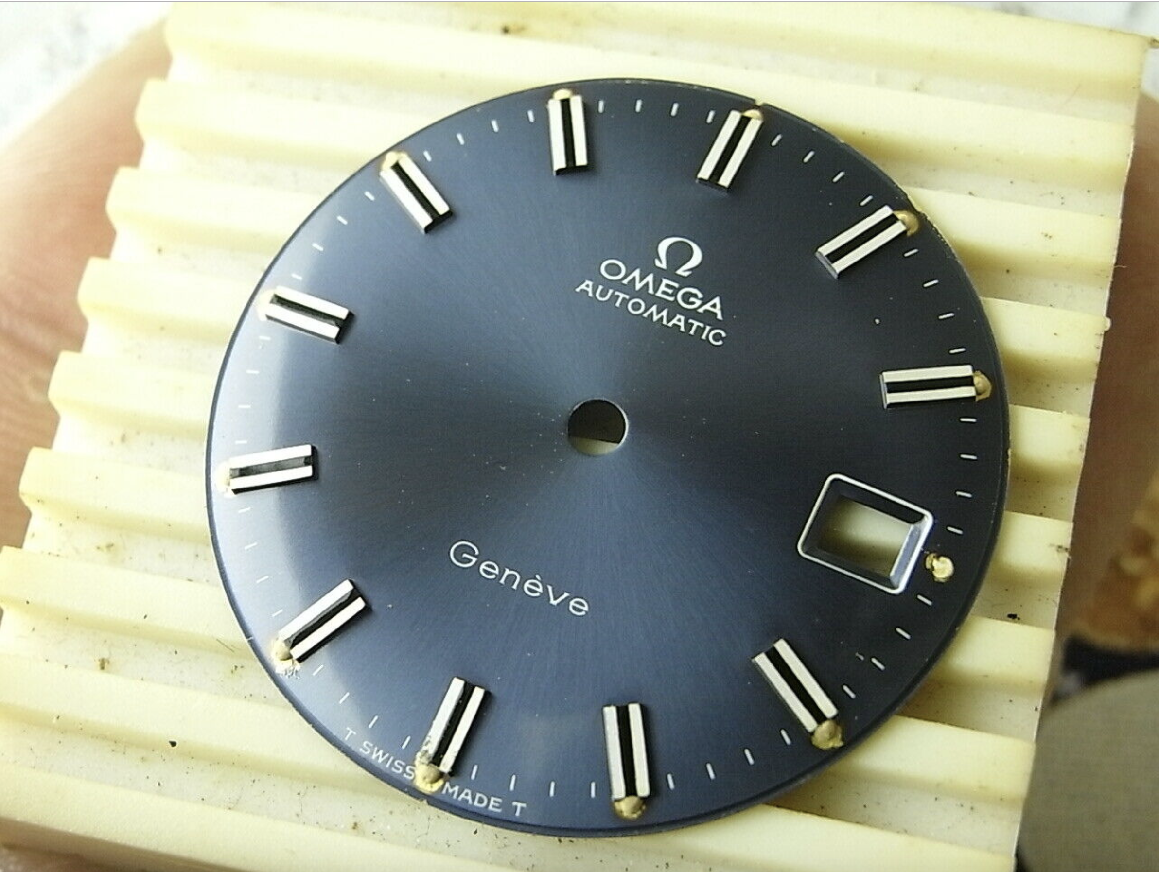

Is this a redial? (not a deliberate test for anyone)

The blue on this dial seems too good to be true, so maybe that answers my question, but I'd love some expert perspective.
I feel like I've seen dials that seem original to me that had the effect I think I see on this dial - where the tritium plots (is plots the right word) affect the paint around them. Is that a thing that happens, or am I making that up?

I'm not considering myself as an expert. There are far more expert guys than me here on this forum and I like it every time when I find that they answered in a wise way.
But I think this is not a redial, though the tritium lume looks a bit strange, which is most likely due to time.

I don't think is a redial. I often see the discoloration around the lume plots in the blue dials Omega made.

The lume plots definitely appear to catalyze the degradation of colored dials in watches from this era. Blue dials especially. If you search the forum, you will find other threads discussing this.

Looks fine and is in quite good condition considering it a blue one.

My opinion is original dial with blobby attempt at relume.
Omega leaves little dots or biscuits.

It is a nice blue dial. If if were a Constellation dial I would be green with envy.

Thanks for the replies everyone. I wound up making the seller an offer which was accepted. I'll post an update on what I'm trying to do with it at some point.

Appreciate the insight. I'll take a closer look once I receive the item, and will also file "Blobby Relume" in my list of terrible band name options.

Looks legit, I'd tend to agree with the "blobby attempt at relume" over lume degradation due to the, well, blobs. I'd expect degradation to have, if anything other than discoloration, flaking.
