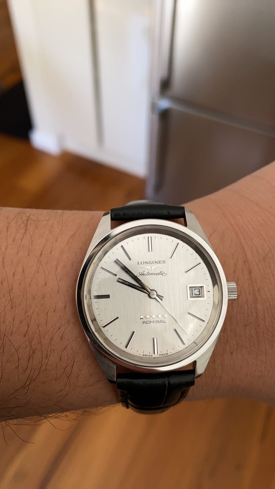

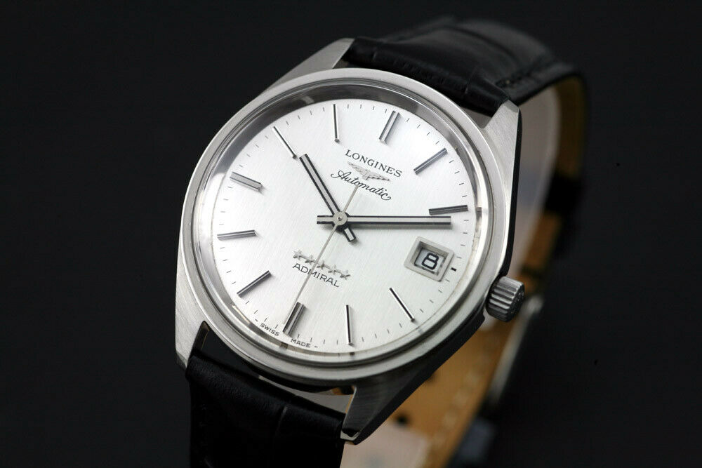

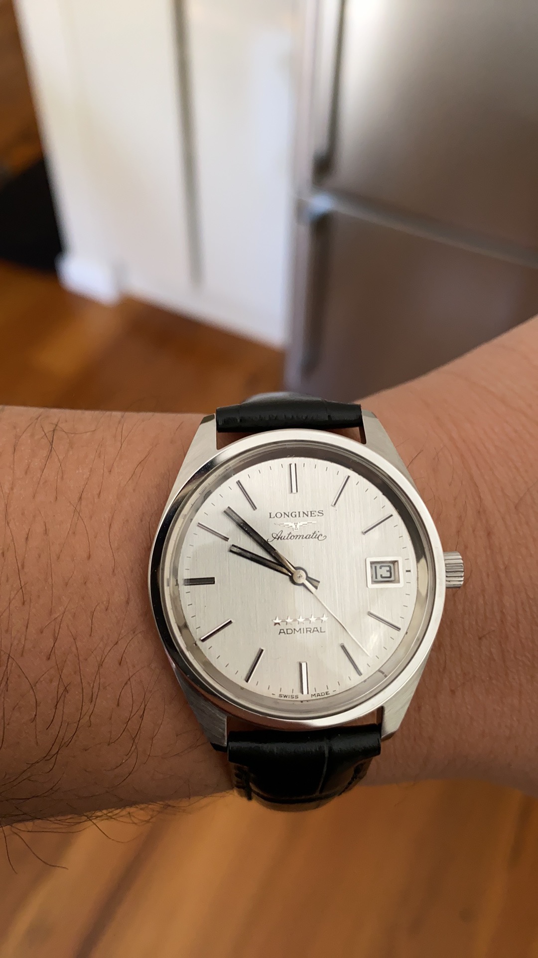

Just won this Admiral 5 Star... is this a redial?

Please post pics rather than links.
Looks OK, but for the date wheel.

Ahh... I see what you mean now...
I've posted the two the the pictures they had.

Dial looks correct and very clean to me, as does the case. The fact that there are no shots of the movement or interior caseback is a shame, hopefully all of that checks out. Assuming so, price is fair. Just one guy’s opinion of course.

Nice looking watch, great make, great condition, very reasonable price. You’ll get a lot of pleasure from this. Just wear it and enjoy it.

I appreciate the feedback! Thank you

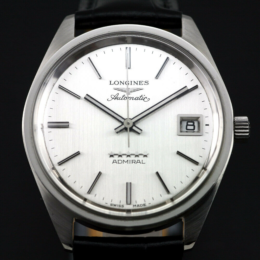

Found a very similar watch with a complete description:
https://www.blackbough.co.uk/produc...-steel-vintage-wristwatch-circa-1972-wwlaas1/
Movement should be a cal. 506 and there are pictures at the link above. It should have a push-in quick set function. Like this.
Date wheel would seem to be correct. The “8” in the above example is the same font.

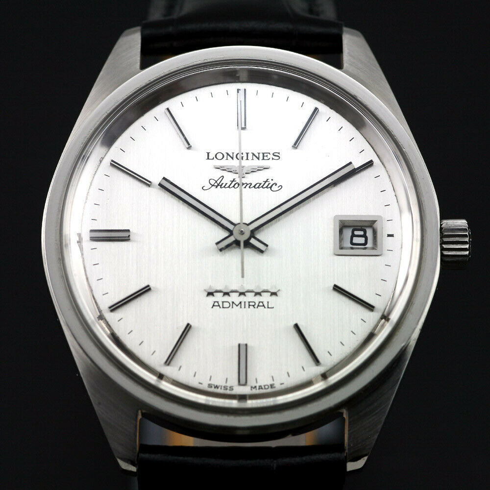

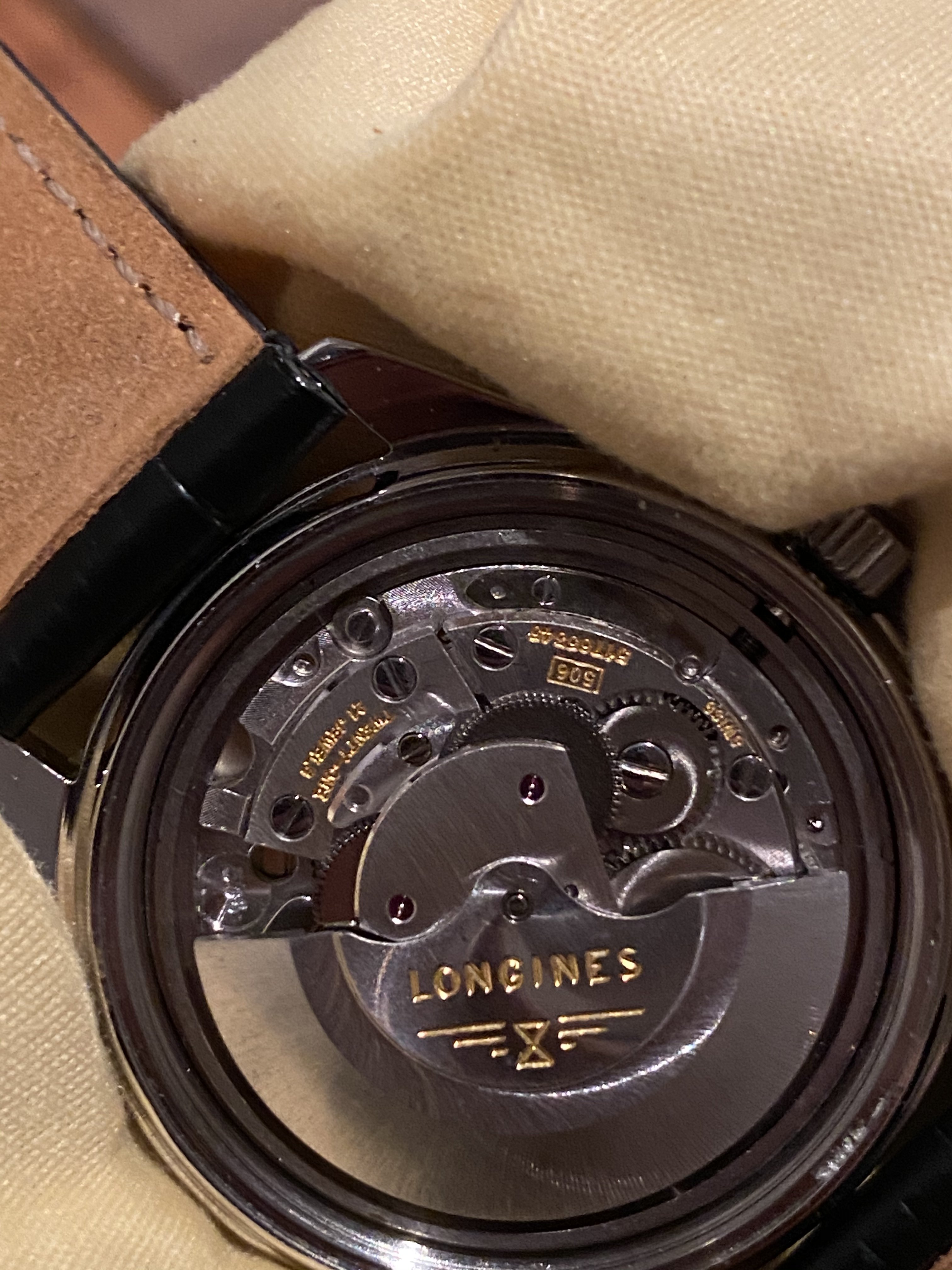

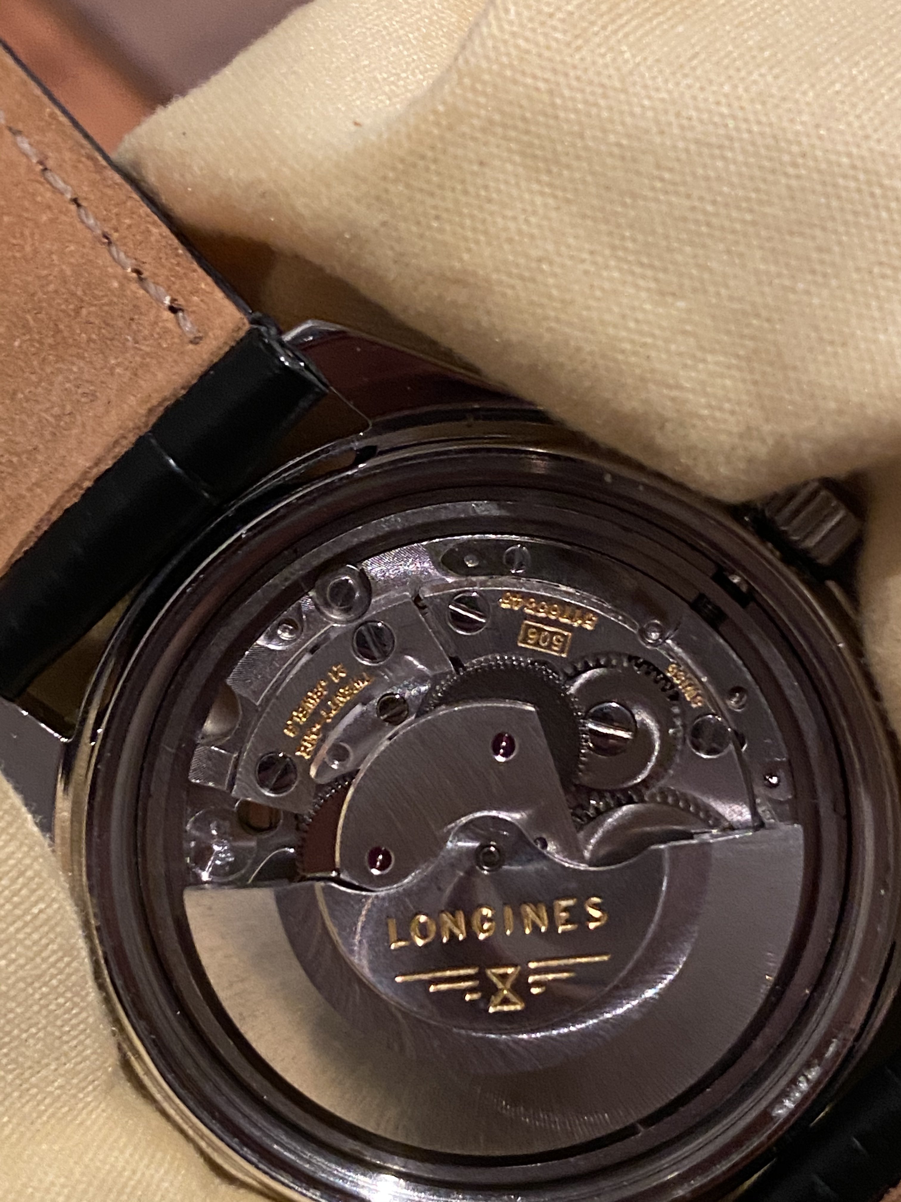

Hi all!
Thanks for being such an awesome community.
I finally got my toolkit and have opened the case. I’ve checked ranfft (http://www.ranfft.de/cgi-bin/bidfun-db.cgi?10&ranfft&2&2uswk&Longines_506) and it matches.
please see the photos.
So do I go back to the seller about this? As it was stated the movement was overhauled, don’t know whether that counts as a service? (Excuse my ‘beginnerness’) or do I just go and get a service done (thanks @JwRosenthal)?

Exactly what I was thinking, I love the watch and it’s a learning experience for me (I’ll get it serviced, just didn’t realise an overhaul doesn’t mean a service).
Additional question: does anyone know whether the serial number on the movement should match the case back? For a longines?
For this watch, no.
Longines case and movement serial numbers matched for a long time up until the early 1970’s. At that point, the movement numbers jumped up to the 50 million range and the case numbers did not.
Regarding your transaction, I would contact the seller through eBay and let them know of the problem with the date change. Ask for their suggestion. If they refuse do to anything, you will need to get eBay involved. Be prepared to ship the watch back to them for a refund.

Unfortunalty there seems to be varying ideas of what a "service" is in the watch selling community. A service implies that the watch has been fully dismantled, all parts cleaned, parts that are out of spec changed, then reassembled, oiled and the watch timed and tested. There are degrees of how anal retentive a watchmaker wants to be about how out of spec parts can be (some close enough is close enough) but the basics of a service are the same. Anything less than a CLA (clean lubricate adjust) isn't a service.
We have seen sellers claim a watch has been "serviced" and all they did was adjust the ragulator to get it close and maybe put a drop of oil in gritty parts (which only makes the grit a sticky mess).
If they don't offer proof of service (watchmakers invoice), then assume it didn't happen. If they claim it was and their price reflects this- then ask for proof- or it didn't happen.
Always assume any used watch needs a full service and parts replacement unless the seller can provide hard proof.
