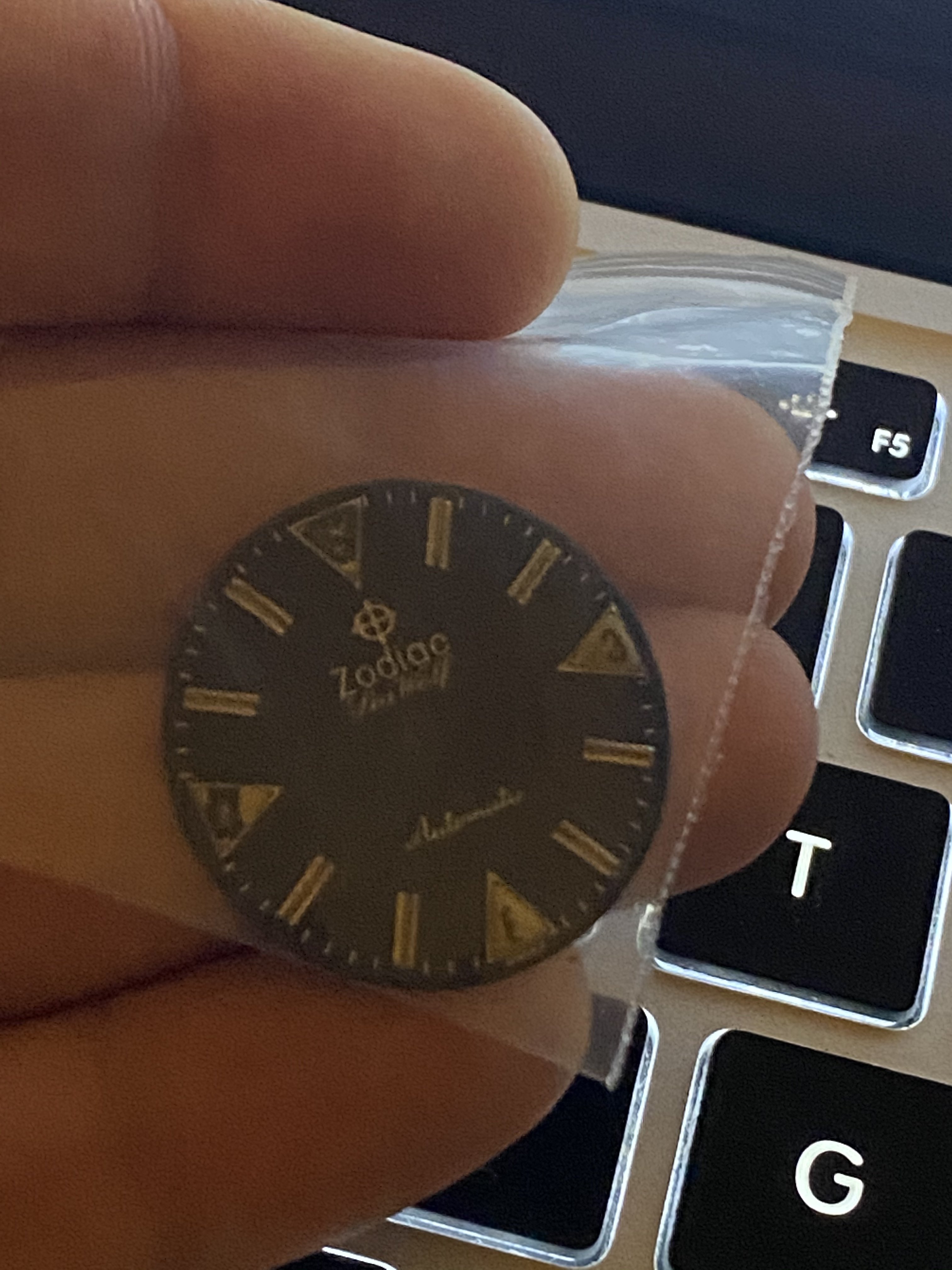

I have even bought a new dial for this zodiac, and I intend to relume the old black one. That’s what real love is !! 😀

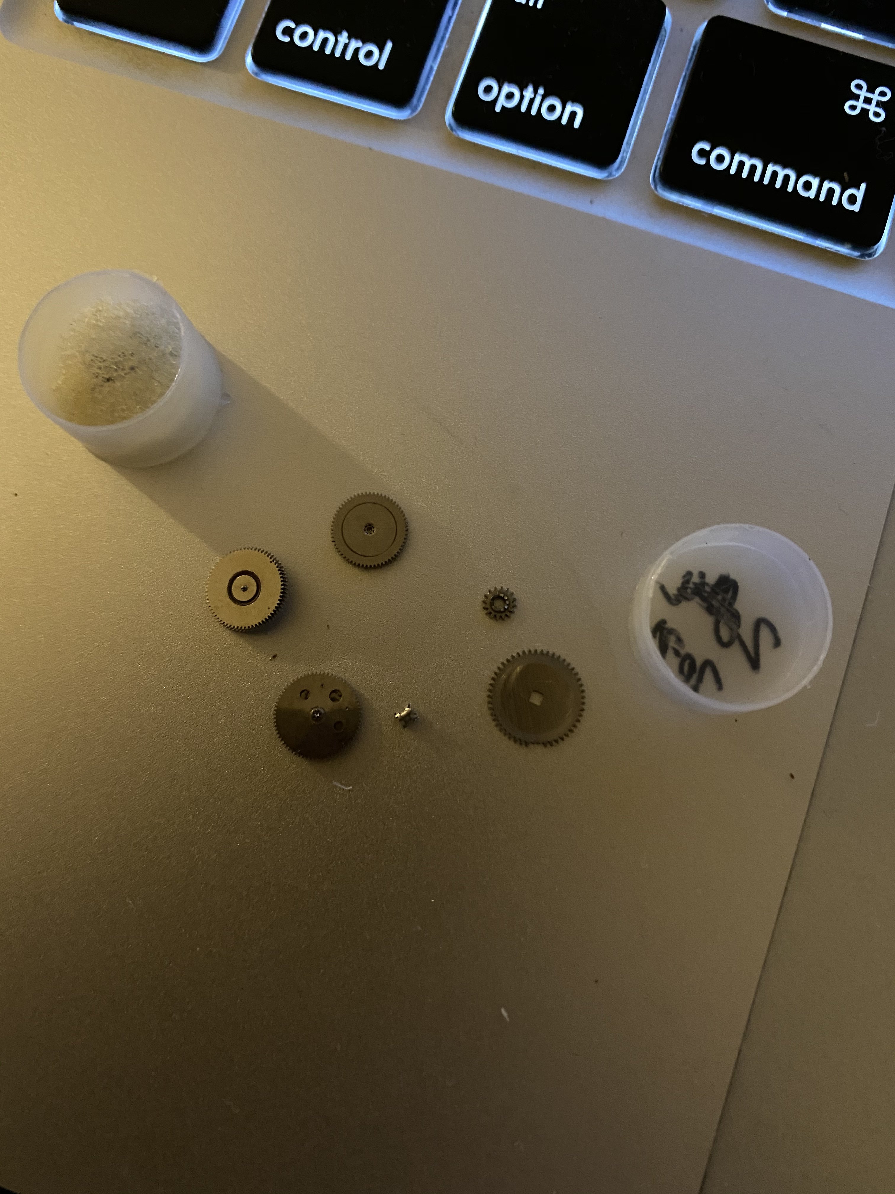

That’s all the parts that were changed :

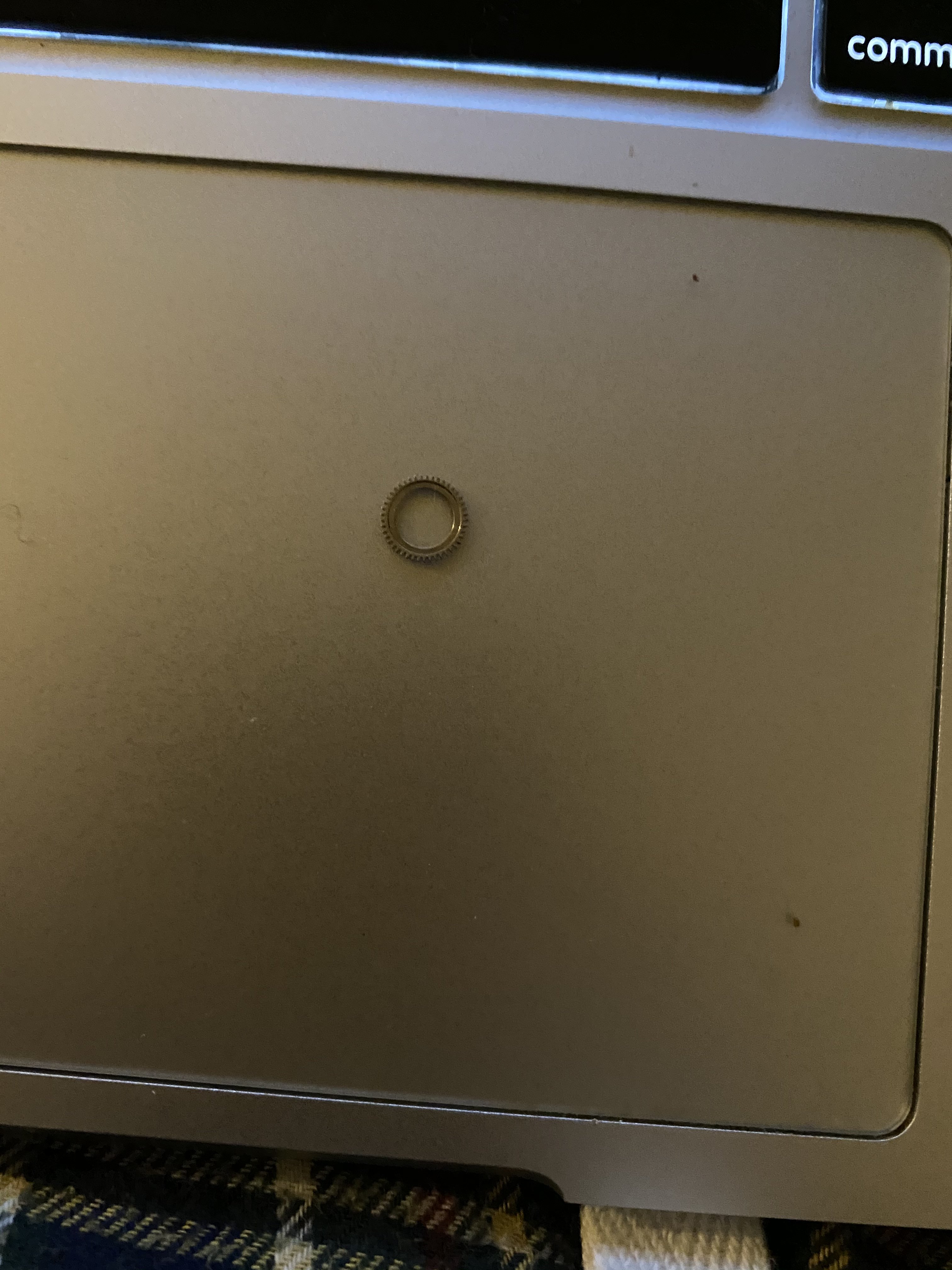

And that’s the one new part that didn’t fit:
