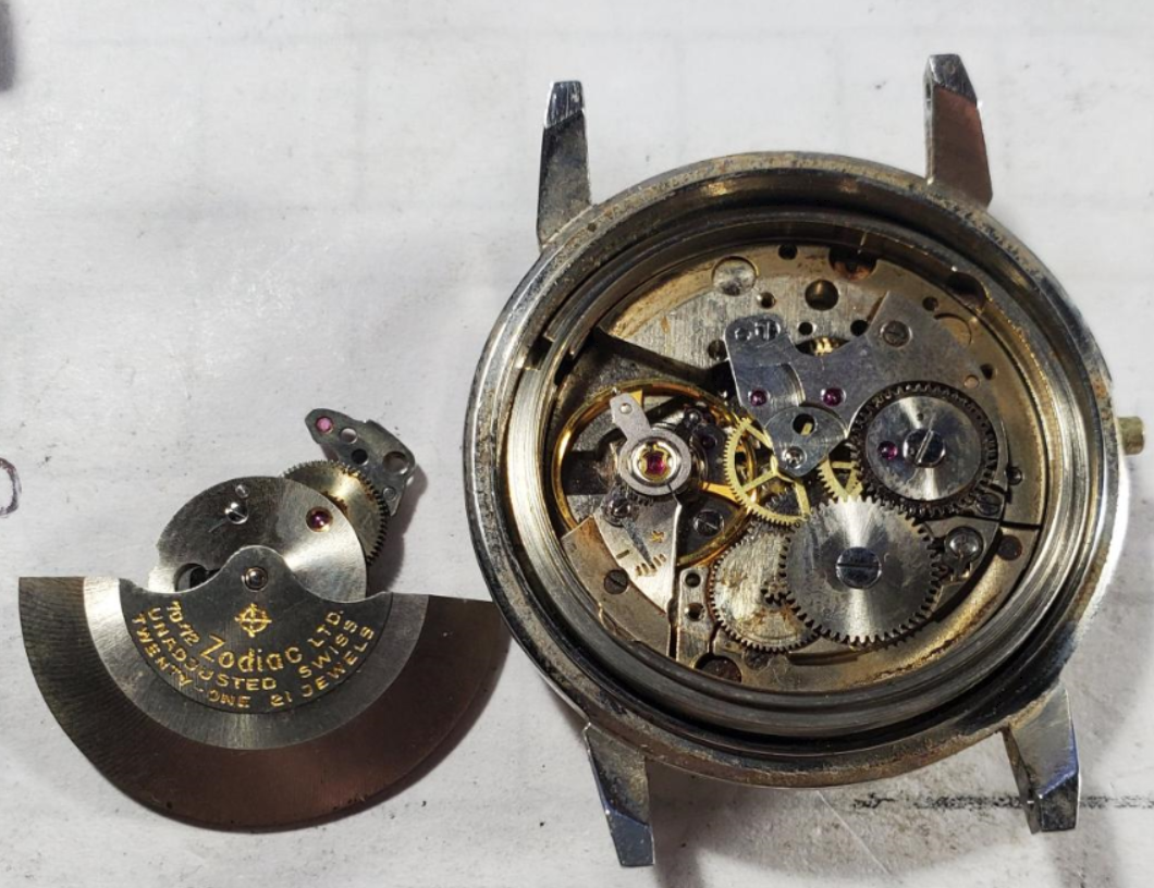

Zodiac seawolf around 1970 :-(, my watchmaker gave up on me!! Cal 70-72 help needed

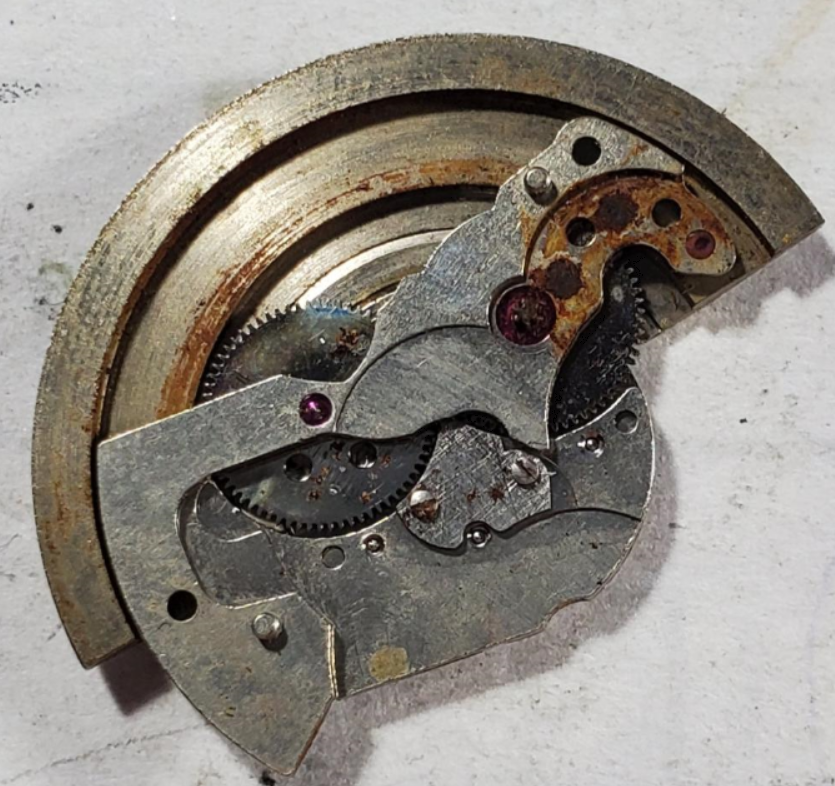

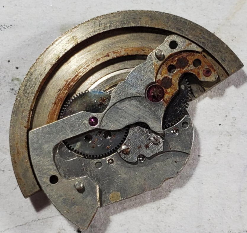

The early Zodiacs used bumper autos. I think their first rotary auto movement was the Cal 70. It is a risk but if you get it for $25, take some good pics and sell it on ebay 😉
I rummaged though my parts box and found a Cal 70/72 from a Zodiac Glorious. Rusty mess but...
The Axle appears to be functional.
So, expand your search to Zodiac Glorious and you should be good 😀

I think part of the issue is that we need clarification on of it was an auto winding issue or a manual winding issue. Your watchmaker said the auto winding was the problem and he suggested discarding it and having it just be a manual wind. But you said the manual winding was rough and it runs fine in auto- very different parts of the movement.
Thanks my friend . I will
exactly!! My problem was the manual wind that was awkward. However he told me to cancel the automatic so that the manual wind is fixed.. I realize now that this is stupid...
as posting continues here, I have trouble accepting that I can trust him anymore even he has done a good job with all my other watches..

I will see the watchmaker today , so I will post all the difficulties He encountered in a more detailed way.
Thank you all for helping and being so kind

Your watchmaker has changed all the keyless works parts and the Problem remains. I think there can only be two problems left. The winding stem, or the pillar plate itself. Maybe someone has changed the winding stem in the past and used a wrong one from a Girard Perregaux, Cyma, Ebel or Doxa movement. They all seem the same, but are slightly different. The pillar plate can be worn out, so that the winding parts have to much play.
Both the crown (manual) winding and the auto system are trying to charge the barrel so, they are linked by definition so, not stupid. There are many ways to decouple these two systems and I don't know this calibre but, I would ask the watchmaker to:
Remove the auto system.
Is the manual wind now smooth? If so, then it's in the decoupling system or auto system.
If not, then the first issue is in the manual wind parts (some of which you've replaced).
If the problem is in the auto system (and I see you replaced the reversing wheels) then refit the auto bridge and check if the rotor spins when you manual wind - it shouldn't. After that, it's a case of reviewing each of the auto parts bearing in mind their function - assemble part by part and test - sometimes this is all you can do.
