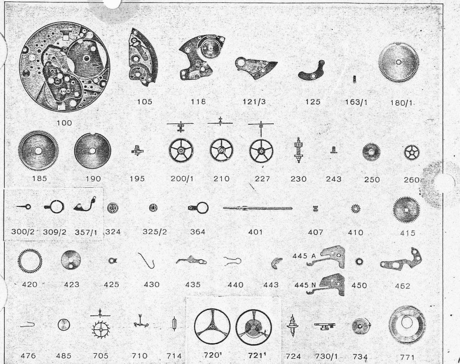

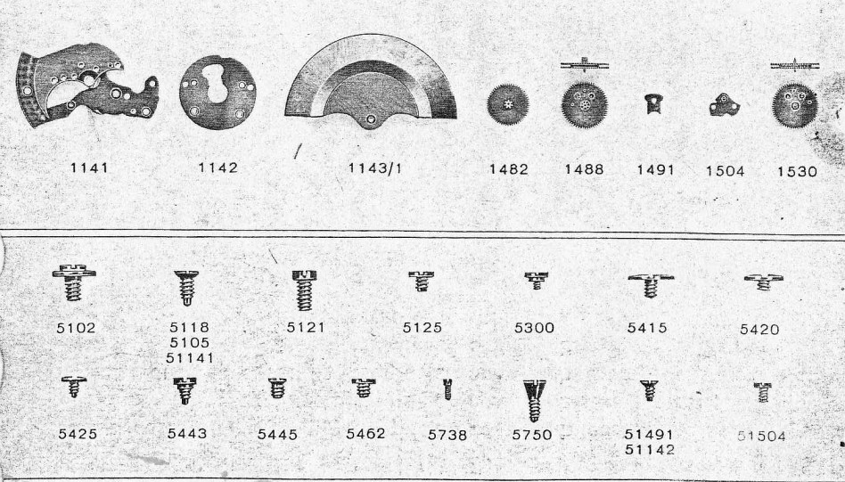

The first parts I bought were two gears for the automatic (part 1488 and part 1530). My WM changed this gears but still the watch didn’t work right. The second attempt and my WM’s advise, was to buy parts 407, 410, 415, 420, 1482. He also changed all these parts also but still the watch is not fixed, thus my WM gave up on me. He couldn’t spend more hours...

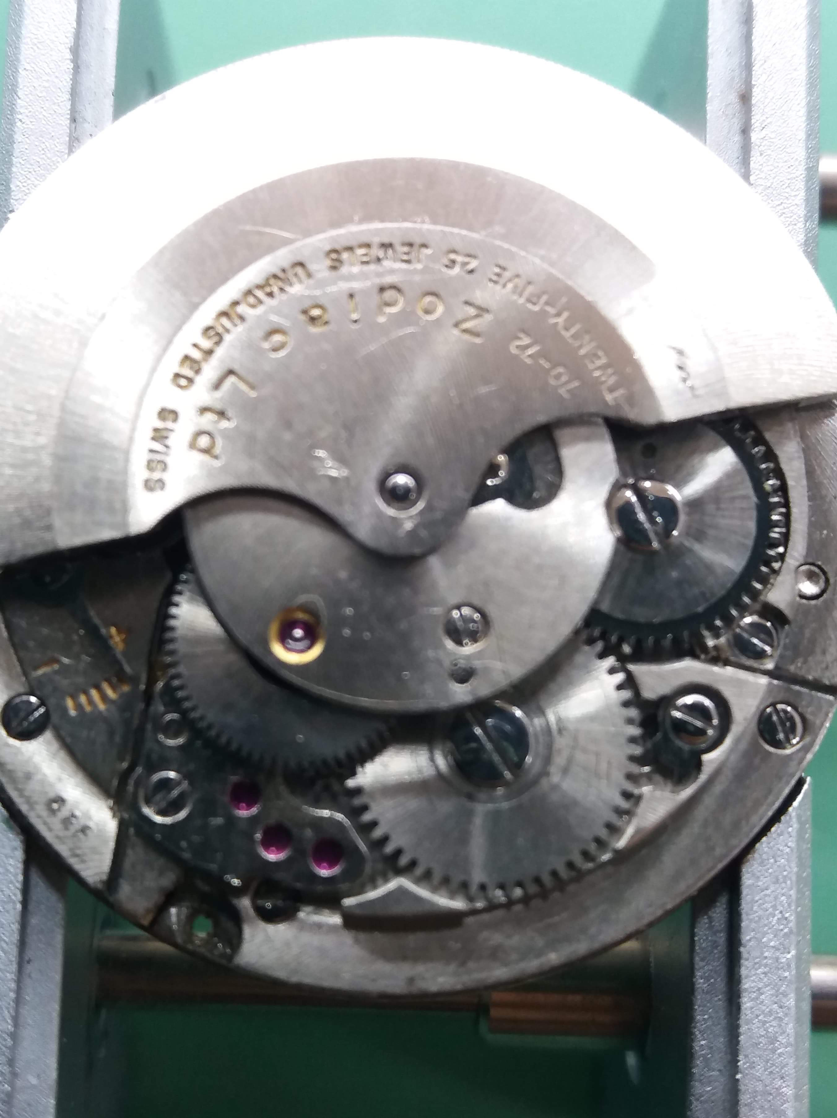

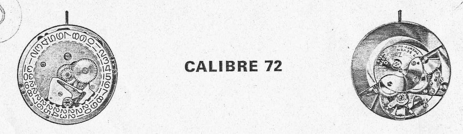

Other than a referral, we will need more information. It's painful to get the back off these. Do you have any pics of the movement?
663
2,030
Undo I have only these two but my WM keeps archives for me so probably tomorrow I can send more:

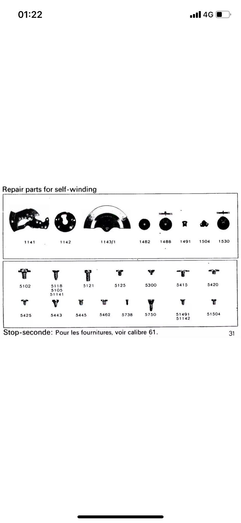

Usually when things get wonky with the counterweight, it's axle related.
663
2,030

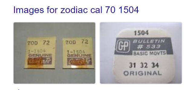

Did you replace the rotor axle? p/n 1504 above
I think I didn’t buy this part. I bought these : 1488, 1530,
Ok I will tell him. And I hope he starts working again, but he is also sad and bored with me I think ...

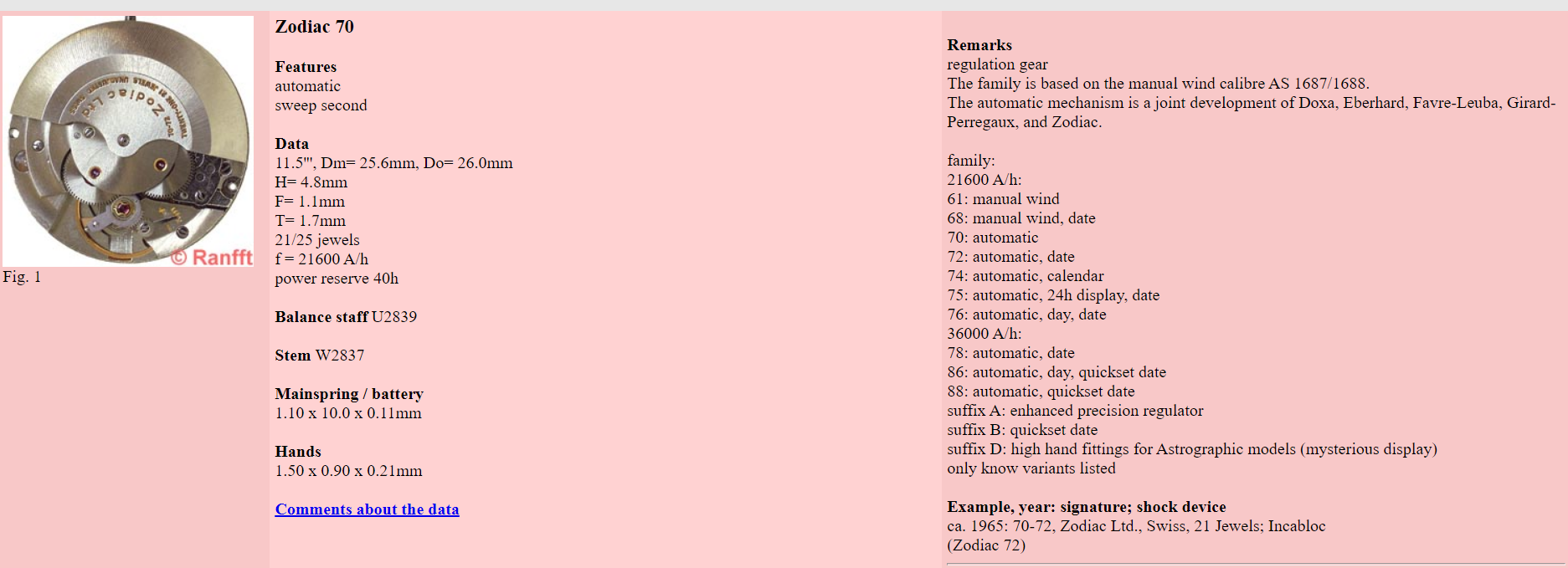

Use Google to search for your movement. Zodiac 70. Then you get many different makers, that used this base Schild movement. Then search for your Schild movement and no matter which maker, find one for sale, that is serviced. Buy that one for maybe less than $100 and change the rotor only. Voila. Good luck. Kind regards. Achim
663
2,030
Yeap, done than been there. I ve never found this movement for sale and believe me I have searched everywhere . Also and the zodiacs with this movement are priced like gold nowadays .
Although I don’t know all the watches that use this movement , but I have tried some zodiacs

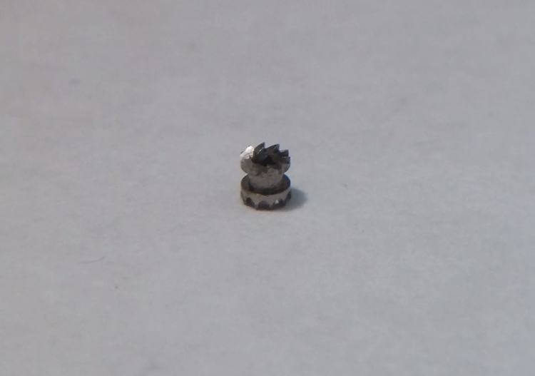

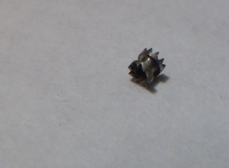

I ran into similar issue with my first Zodiac Seawolf, but had the opposite problem- auto wind was fine but manual winding fet like gravel. My watchmaker did a full CLA and even did the same research on the AS compatible parts. The problem was the winding pinion and gear. He tracked down the pinion and gear for a “compatible” GP movement and it didn’t fit. At that point he had done all he could- he was done.
Apparently Zodiac did some proprietary changes to this movement that are Zodiac specific- so I found out- just like you have. It doesn’t matter what ranft says about compatibility- if it was a Zodiac specific tweak, it throws the compatibility lists out the window when you are trying to fit a part that says it should fit but it doesn’t- hearsay doesn’t matter.
Luckily these movements were used in other Zodiac watches. I found someone on eBay parting out a 70-72 and had a list of parts with prices- I specified the pinion (which was the real problem as it was missing a tooth), he sent both pinion and gear- winds like silk now.
Don’t give up- these watches are very special despite them not being worth much in the grand scheme of collectible watches. Your best bet as suggested before is to find another Zodiac with a 70-72 and buy the whole watch. Hopefully the donor movement will have less or other issues that will allow you to make your Seawolf whole again.

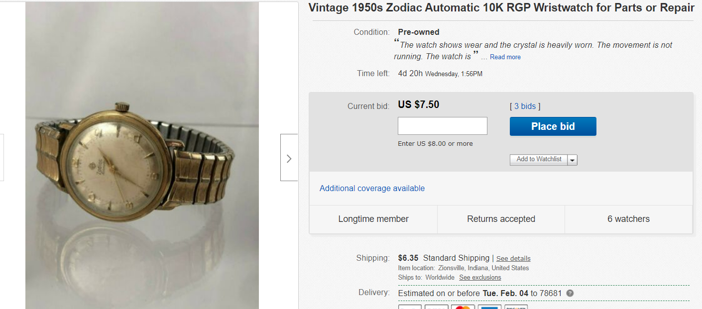

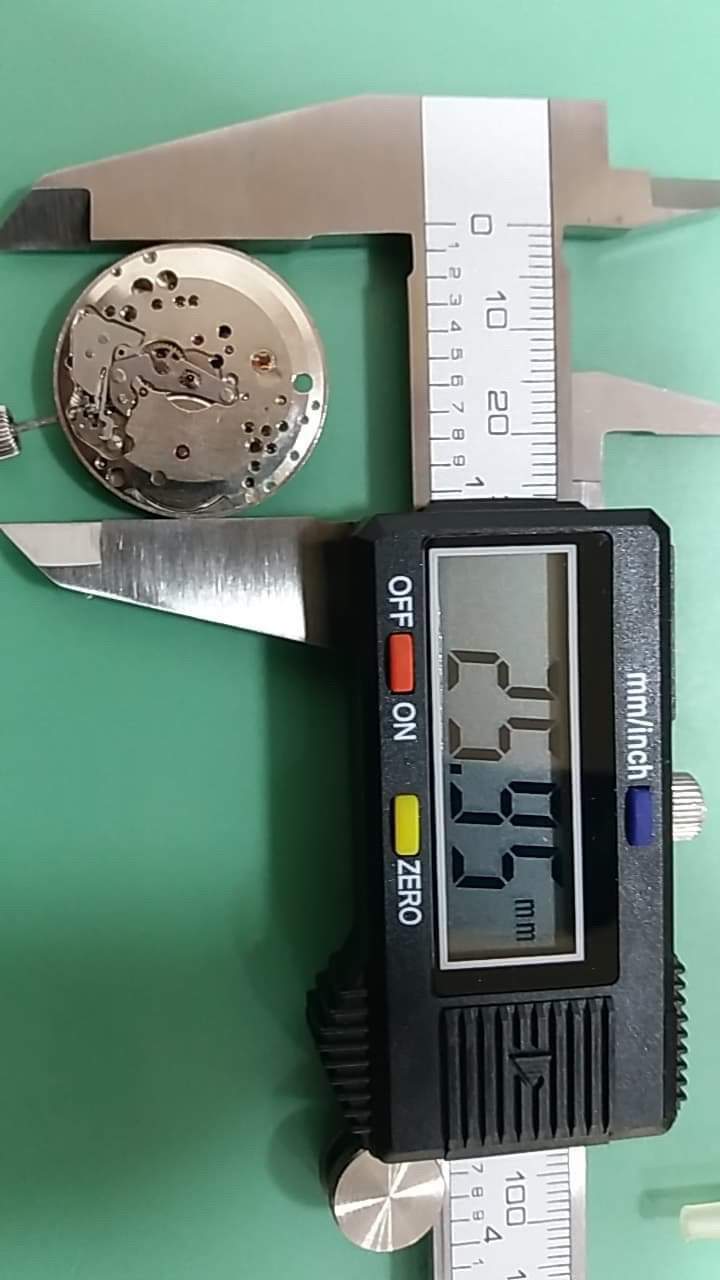

You can always take a chance on something like this:
Thank you for your research my friend, But the description says clearly that it’s not running! Would you take a chance ?

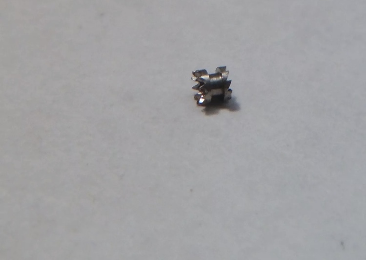

The term that was used for the part that was my issue was the “clutch wheel” & “sliding pinion”. At least according to the listing from which I bought it. I paid $25 for both parts and the watch runs/ winds perfectly now
This was the offending part- and it meshes with a flat gear that has teeth. The GP/AS compatible part was very different looking.
663
2,030
